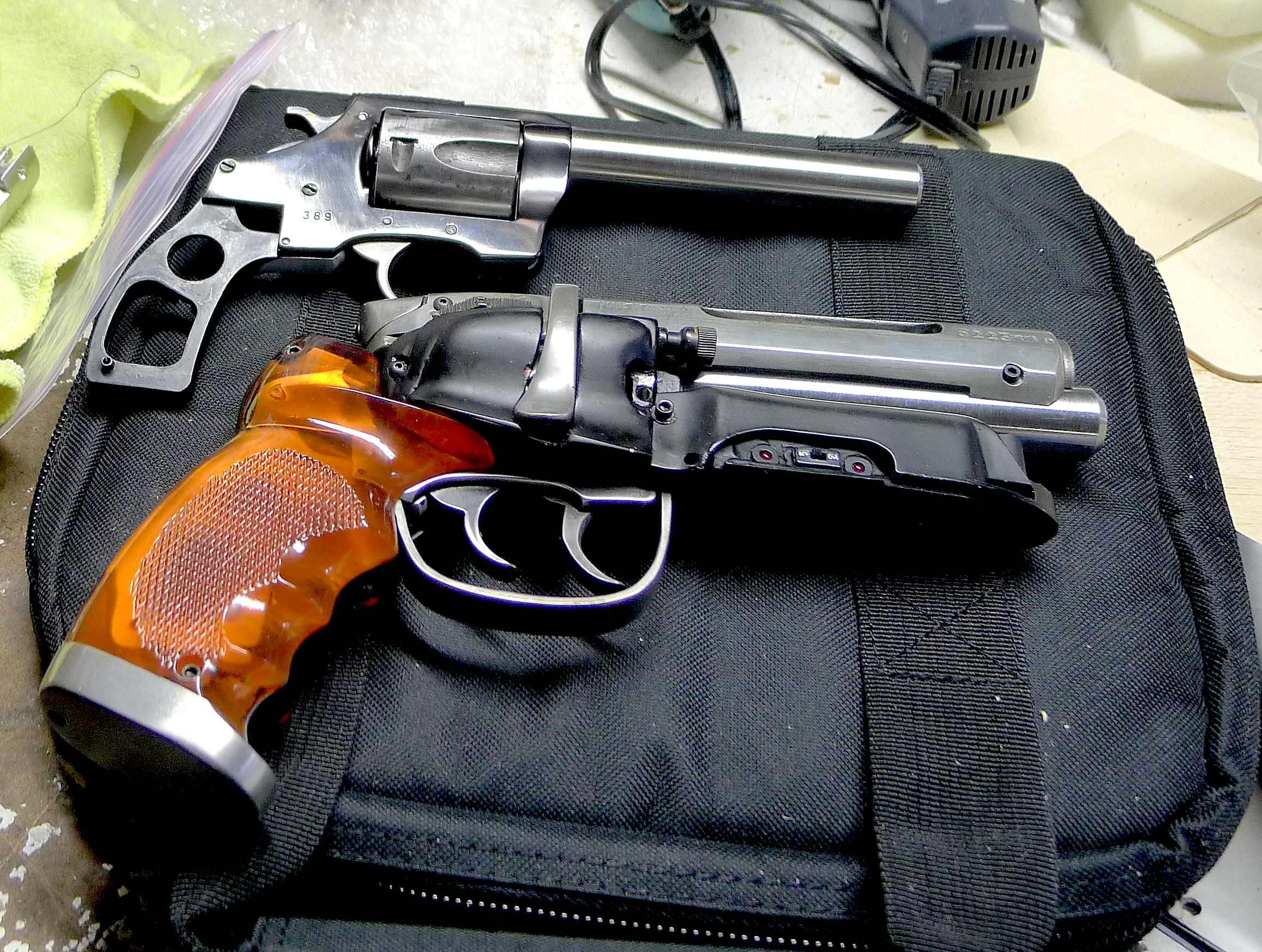

Here's the finished Bulldog with the new barrel. Torque, flash gap, and lede all set. It is shown next to my other Blaster with the working Bulldog and Coyle upper receiver. I still have to bob the hammer. The pin, which is frame mounted, is left out for now. NewBulldog.jpg

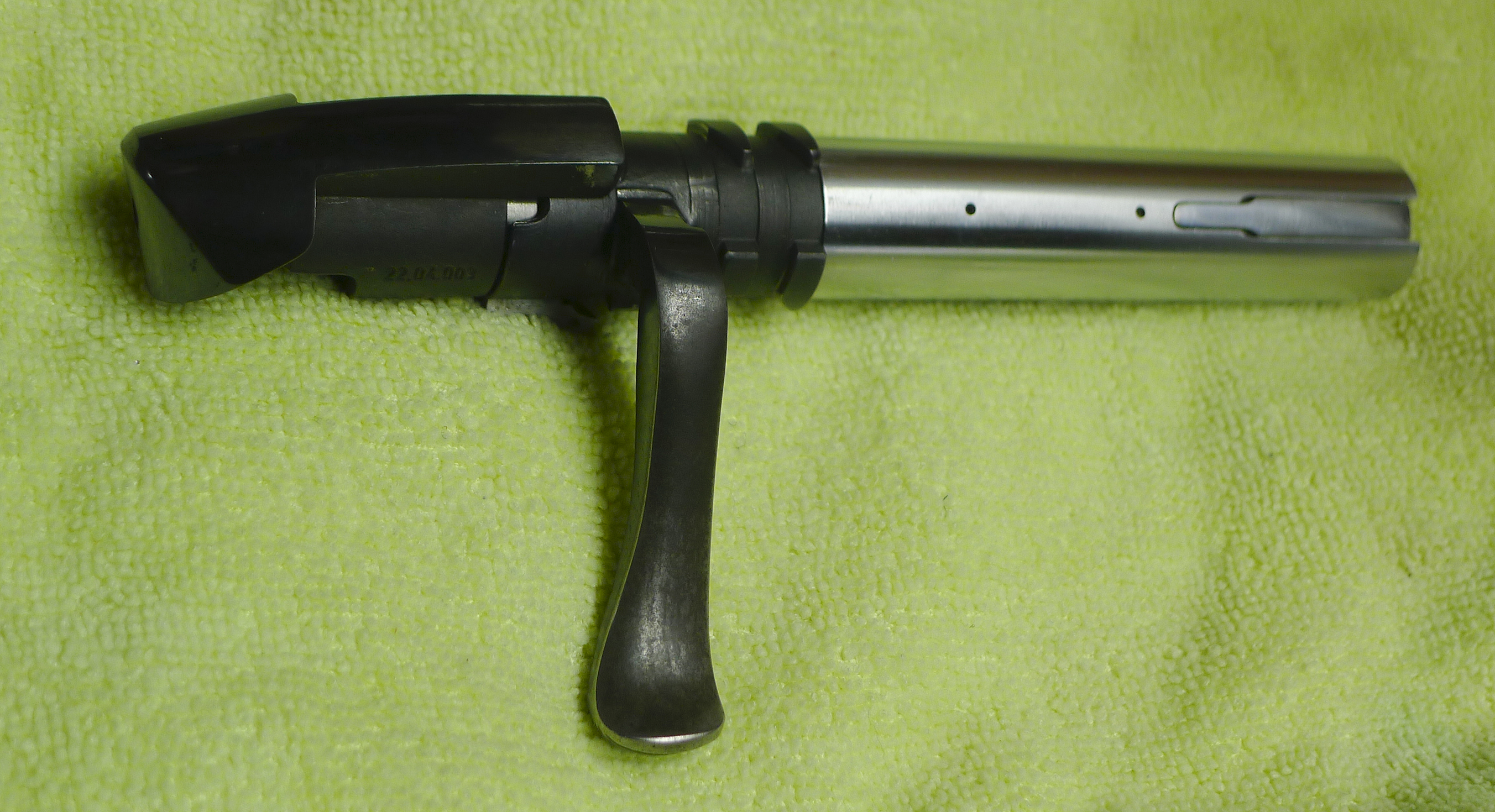

Somebody asked me to post a pic of the original Steyr SL .222 short action bolt. Here it is. Sadly, we only use the end cap and the handle based on current plans but I am trying to determine if there is a way to keep it intact. The bolt handle gets heated and bent to fit the contours of the blaster, as well.

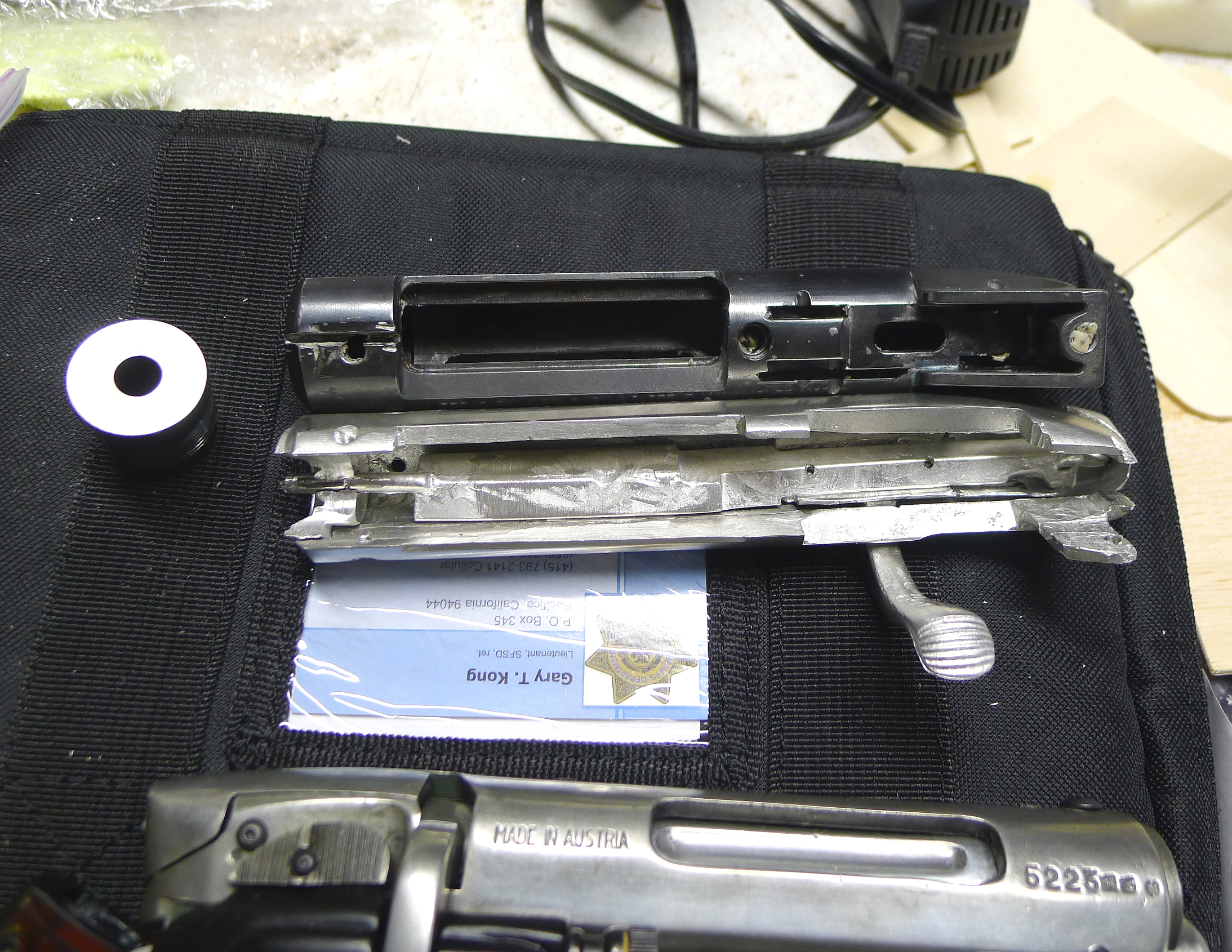

A real Steyr receiver and the replica receiver made by Coyle. He's done a really nice job replicating the original.
The cylinder on the left is actually the cut barrel stub from my receiver. I'm hoping to make it into an end cap.

Being a firearms user, collector, lover and a licensed firearms dealer and gun builder I get what you say about taking a complete Steyr out of circulation and agree, it would be cause for some tears. Fortunately, I was offered the receiver with barrel stub and complete bolt assembly as shown. I did not have to destroy a complete rifle.
eltee, that is a beautiful photo and description. It's very helpful man, showing the bottom of the receiver. That is going to be a lot of machining. I better eat my Wheaties!
