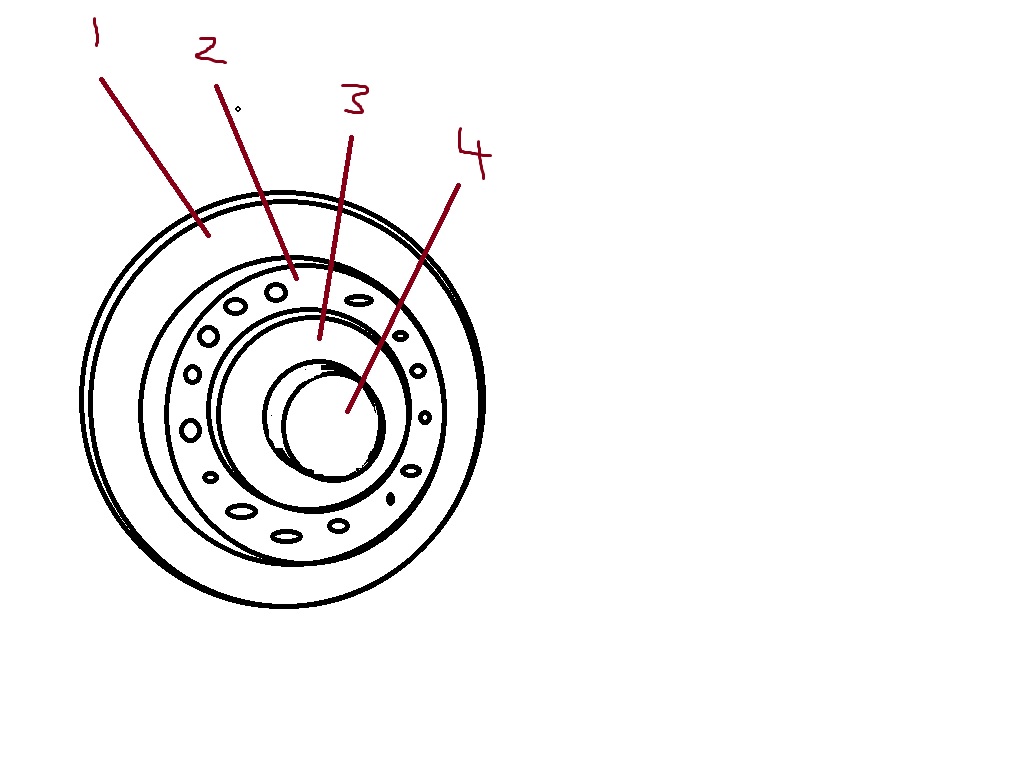

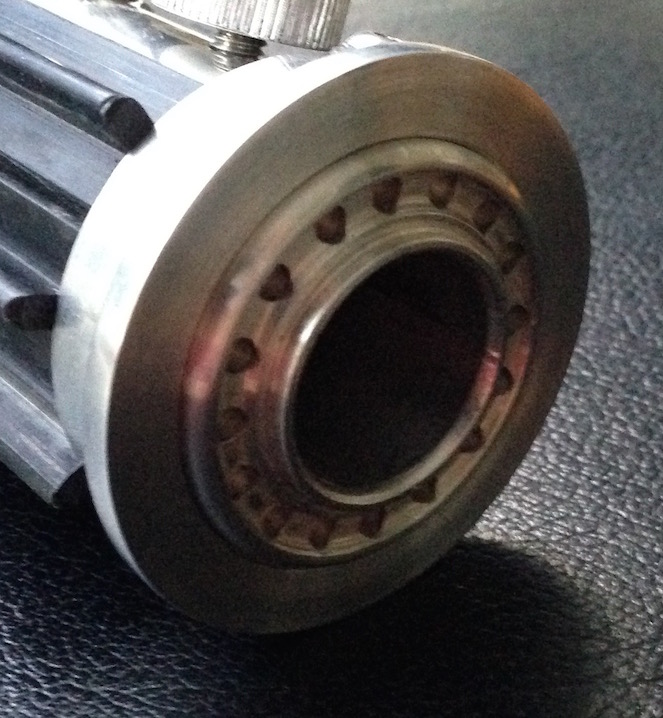

Forgive this because I did it in paint.... but is this a possible configuration?
meaning that 3 is like a washer between 2 and 4.... holding 2 to 1?
See what I'm seeing?

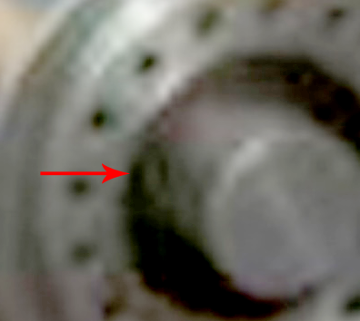

Looks to be a hole, or set screw hole on the side of the nub, down inside the recess. The recess also looks a bit deeper than you have it above.

And I'm pretty sure that activation box should be the same length on both sides, it wouldn't make sense to be asymmetrical and longer on one end, i think that's just an illusion from the angle.
Nice catch! And I agree about the activation box. It actually looks like it might have been put on the body slightly wonky? But if anyone gives a crap about my vote, I vote symmetrical. There's no reason it wouldn't be.

I don't see the hole, and if there is one where you're seeing it, it would greatly increase the price of the prop, so I'm not going to add it to the model. I think you probably are right about the recess depth. As to the box. The one on my model is defiantly to small. But, while I'm confused by the asymmetry, it is what I'm seeing, so that's what I'd go with.
You don't think the control box is just twisted a little? Like, not in line with the body?
