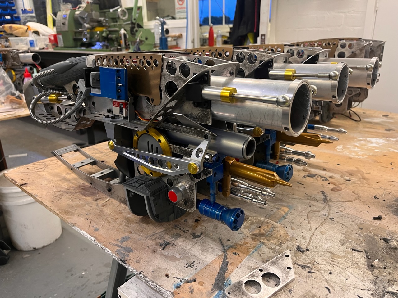

6 more nearly complete..
I have enough metal parts for 5 more, so please get in touch as these may be the last.
