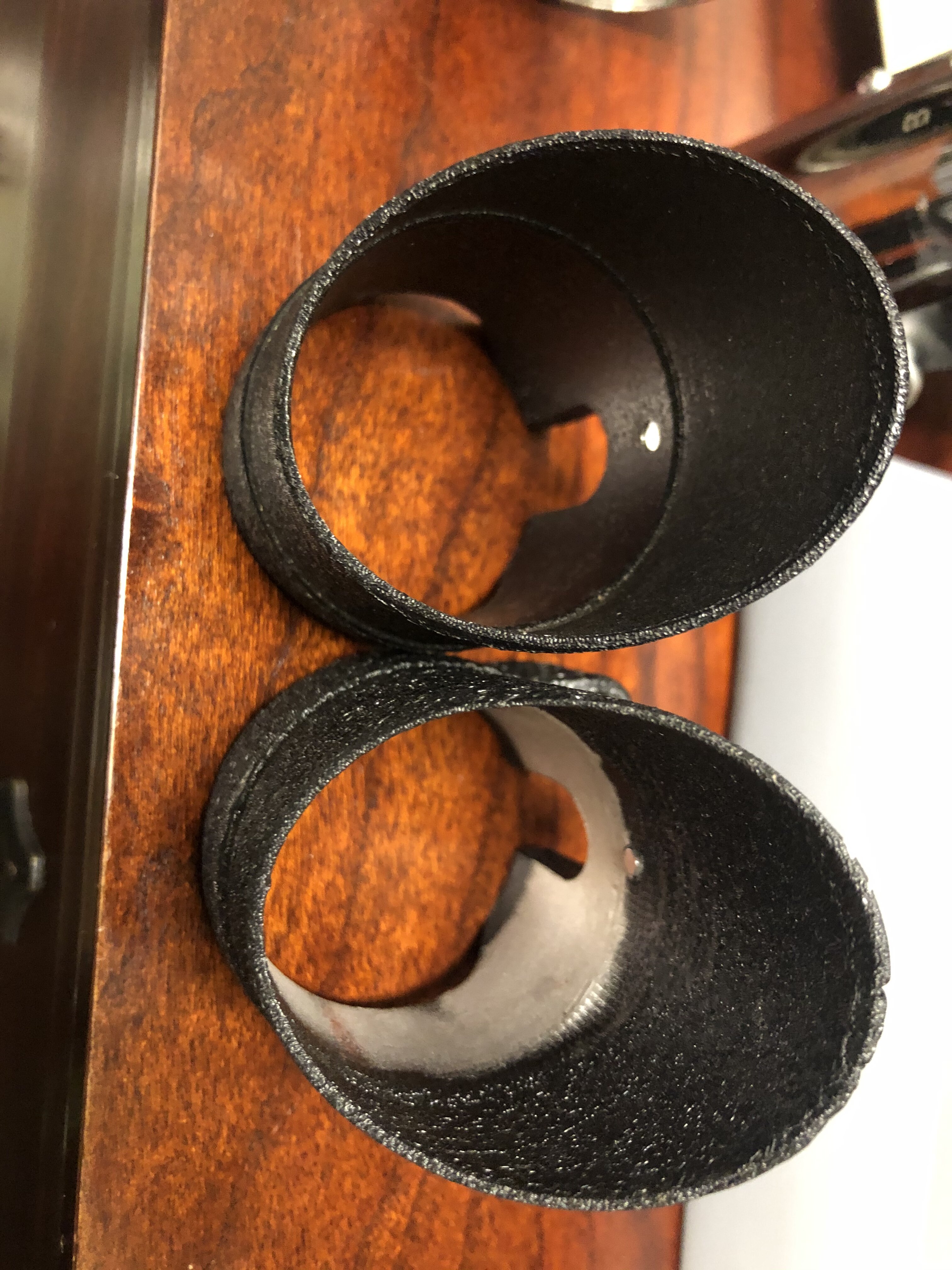

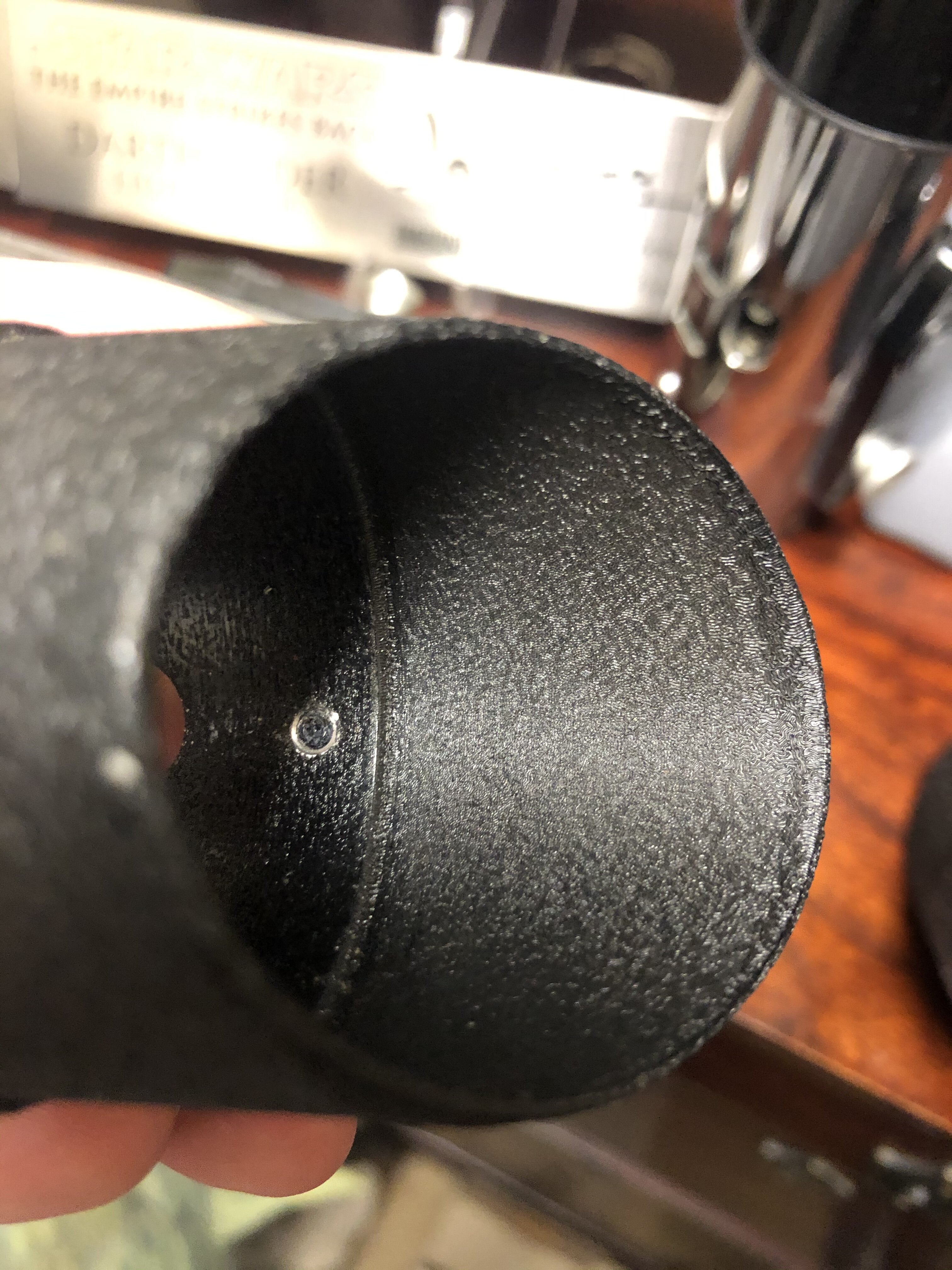

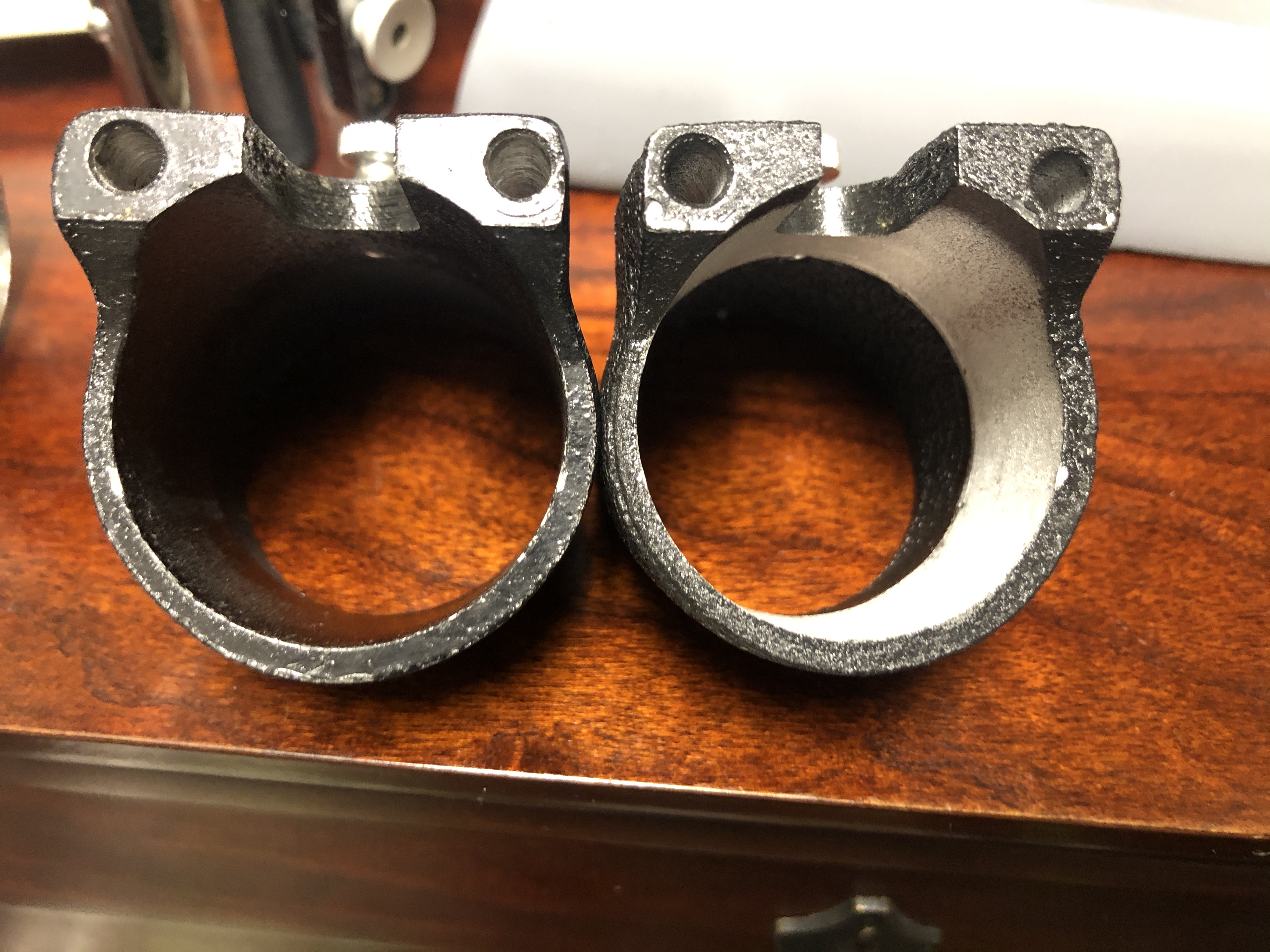

So the only thing holding the shroud in place is the thumb screw?
Yes, I have it seated in the divot. Exact same as my two vintage one step shrouds.
Actually, one of them has a step the opposite way. Thicker where the tube is and thinner on the open end.
9A00E924-9DAD-4048-ABAF-A068E75849B0.jpeg A744DF11-75AB-4228-B903-CE602599ABB6.jpeg E03D6BE1-B03D-4119-B07E-090C3C13D308.jpeg 23B70F11-B569-423A-A812-4D08E9D5C776.jpeg
v312
It's just the thumbscrew holding it from falling out from the tube in the other direction so that should be fine

Mine arrived today and tinkered with it, too. If you've got those larger, snap-on diamond cutting wheels, they're the same diameter as the insides of the shroud. It's made very short work of moving the step 1mm higher.
PoopaPapaPalps
skoota73
Yep, Dremel EZ Lock 1-1/2" diamond cutting wheel. I had a worn one and used that first to do some cutting first and once I had the new step ground out, I put on a full cutting wheel and sharpened it up.
Couldn't have put in more than 30 min worth of work like Teecooz.
Nice. I will give that a try.

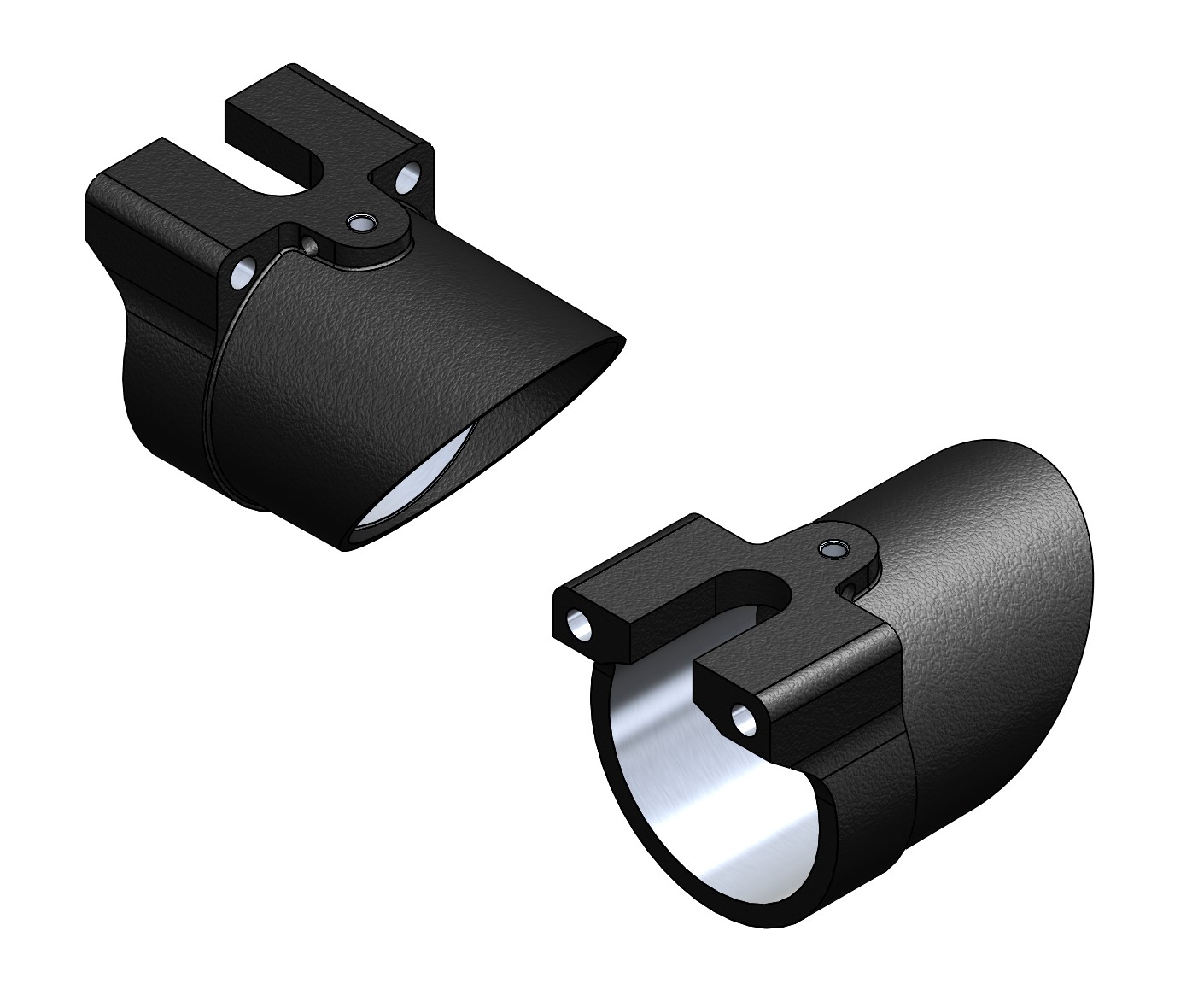

I have another shroud announcement! This time I'm talking ANH DV saber: the one-step aluminium version. Some of you might know I did a run of wrinkle painted alu shrouds back in 2015 when I just opened the WannaWanga shop. The shrouds were CNC machined and the wrinkle finish was done by yours truly. That was a dirty job!
So now, 5 years later, by popular demand, I'm finally doing another run!

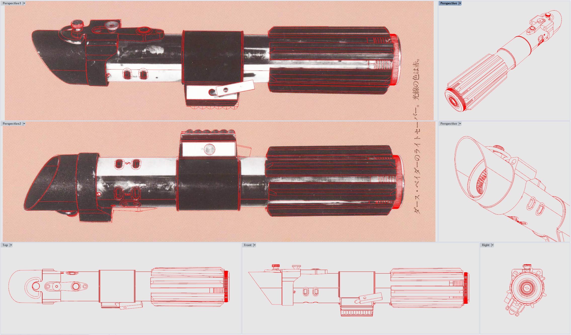

In my earlier version, the dimensions were based on a real one-step shroud. But this time I'm going even further and I have refined the model even further based on the famous Chronicles images. You can see some WIP images of the 3D perspective matched overlays. I also got help from IronDestinyProps who has a sharp eye for details. Thanks Nate!
This time, the parts will not be painted, but will be sold as bare, machined parts. So it's a DIY upgrade part.

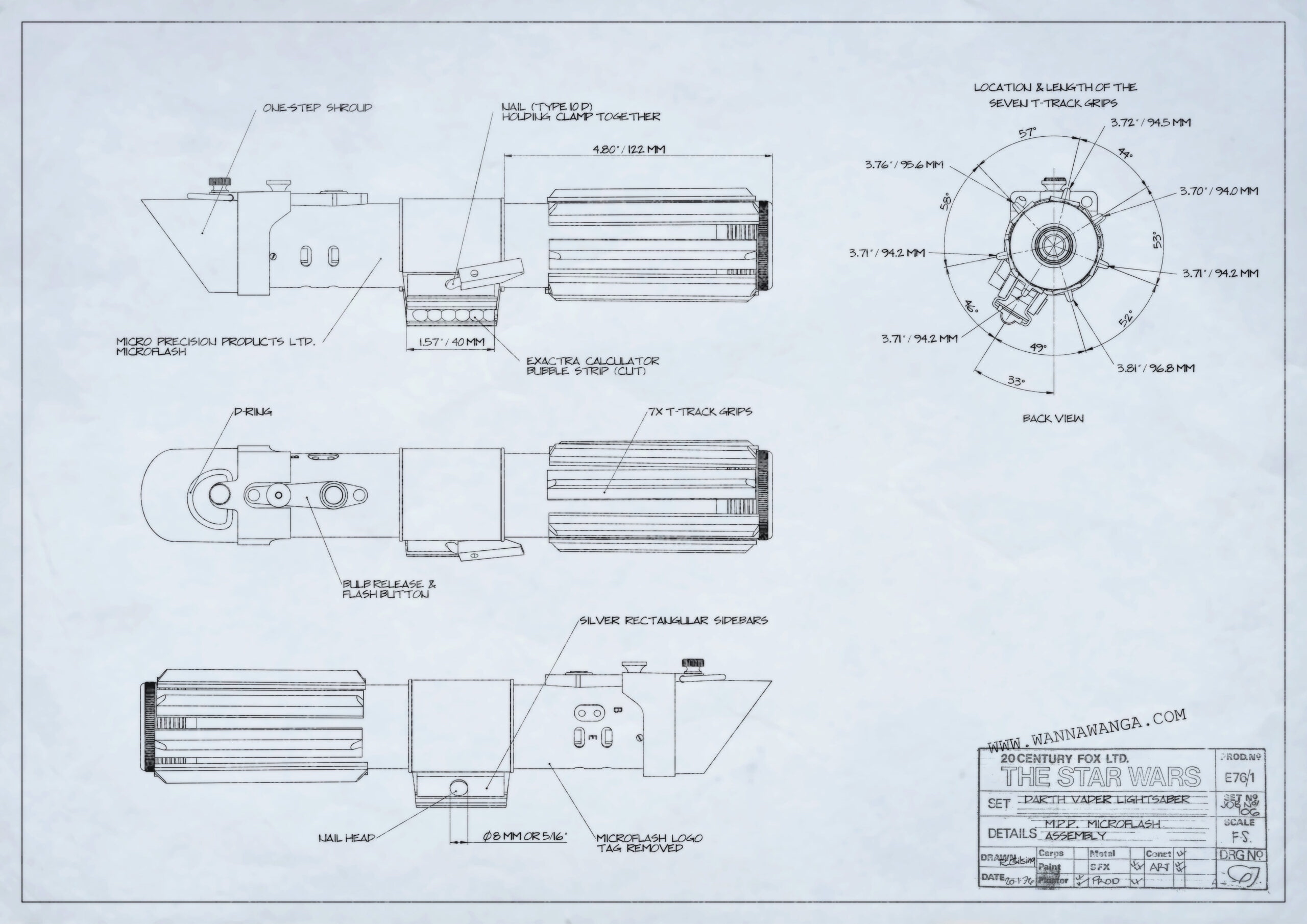

Because I did the perspective matching in 3D, I decided I might as well make an accurate new blueprint of this saber! Complete with grip length and location, for all you accuracy freaks! In the coming days I will finish this drawing and publish it when it's ready.

Correct. It's a common approach for flashes.MPP, Heiland ( for both their long and "stubby" versions), Busch, and Minicam use some variation of that method.
That's how it is on my original MPP shroud
Interesting. I've always thought there was an inner step that sat on the edge of the flash handle like my Roman's. On the Roman's, the inner step and the screw keeps the shroud level and secure.
teecrooz
Ah. I was asking that question specifically for teecrooz 's shroud. he'd mentioned he sanded the entire step away.
Ah! That’s me!
I removed the entire step. The side screws as well as the thumb screw keep it level and secure just fine. It still has the same ID so it sits pretty snug against the tube as before. Same as my two vintage single steps.
