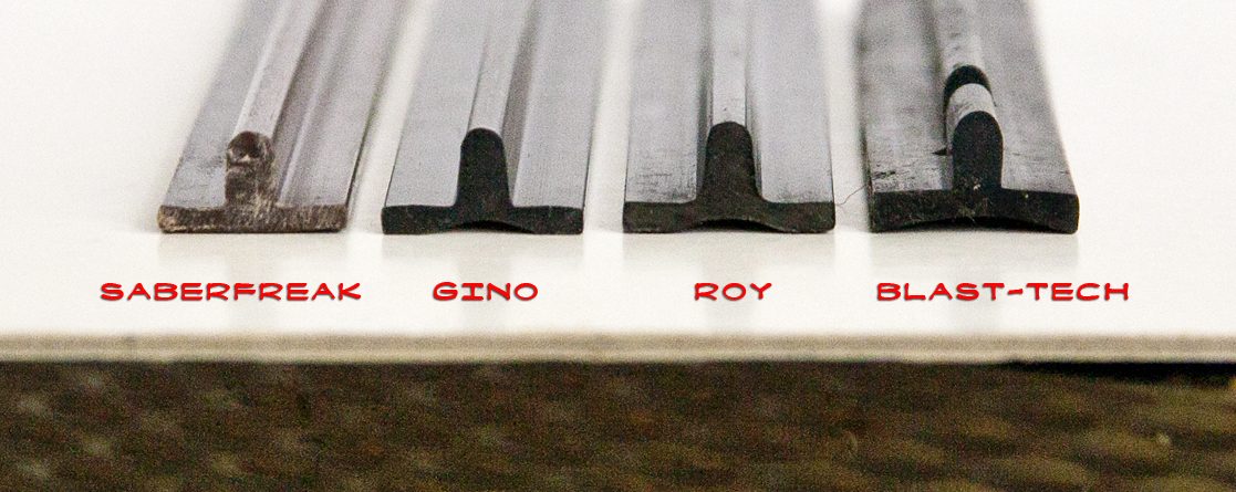

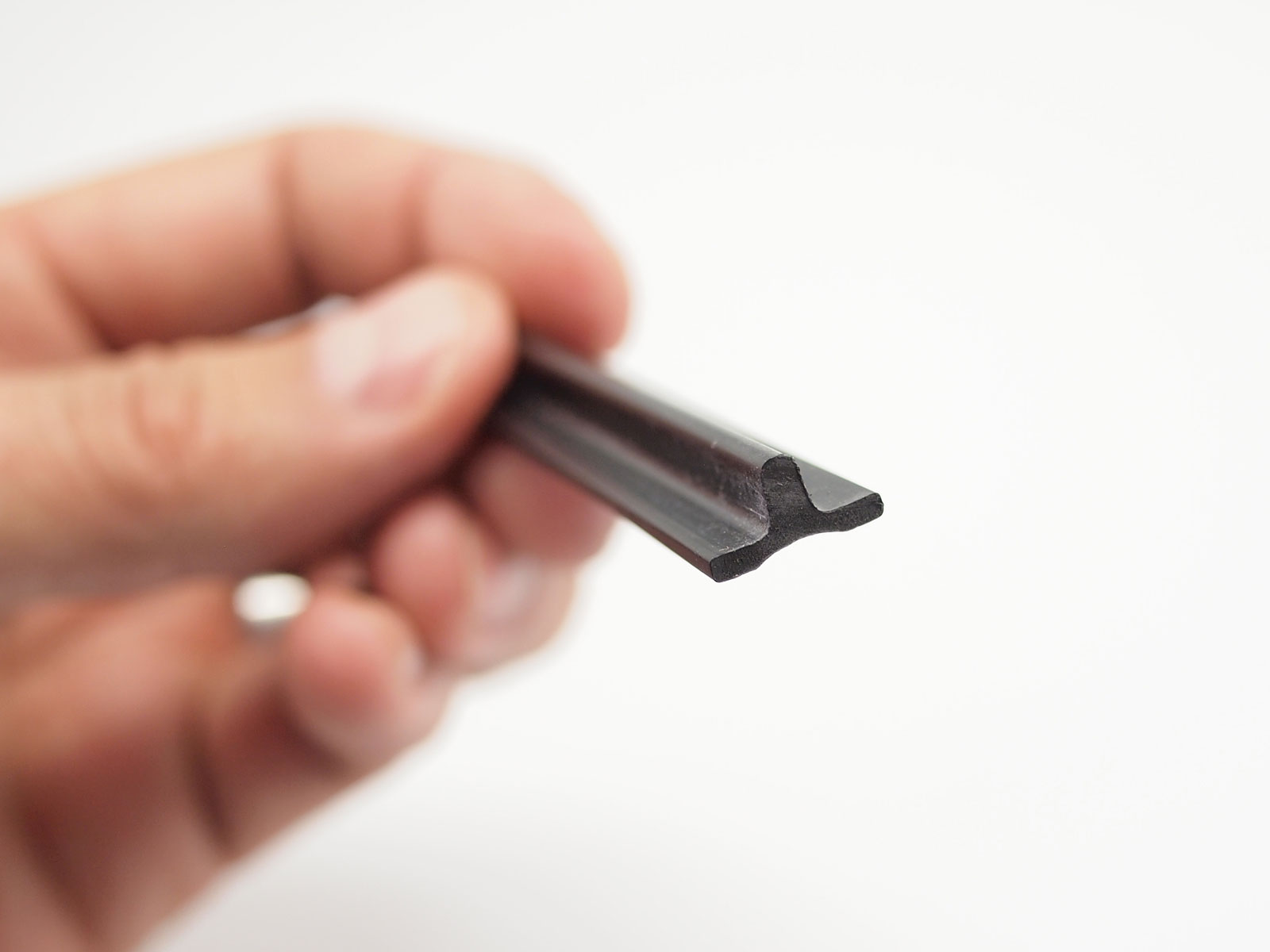

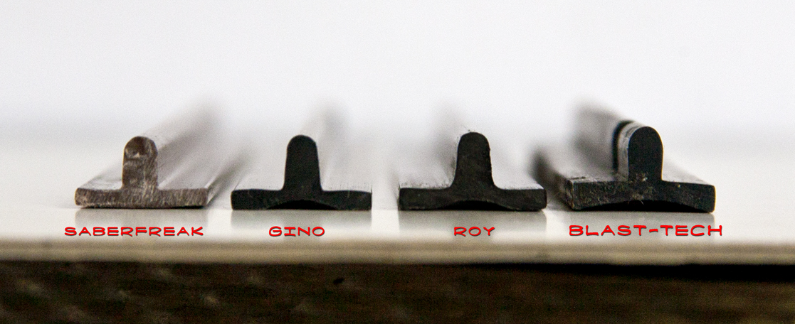

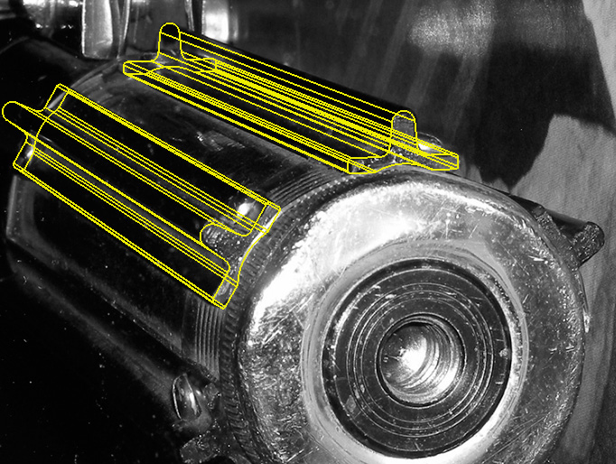

T-track
The references for the dimensions of the cross-section are archive pictures of the Vader MPP and Luke ESB and by using 3D CAD software for perspective matching and measuring. So I didn't take measurements from other replicas but based it purely on my own research.
Here is an screen grab of the perspective matching in 3D:
I invested in the tooling cost and in the production (extrusion); first in rubber (elastomer) but later in the screen accurate hard plastic (PVC). I now have plenty of profile for the rest of my life!!
The result is a beautiful and in my opinion a very screen accurate T-profile. I can cut it to any length. Here is a comparison pic (made by Sym-Cha):

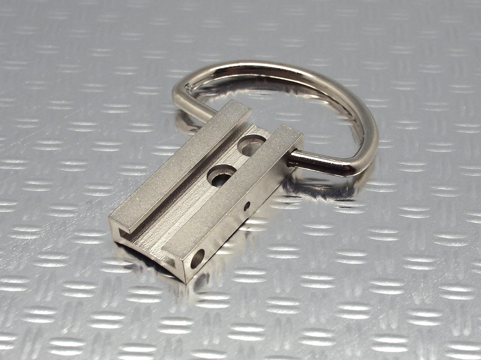

D-ring with clip (or strap)

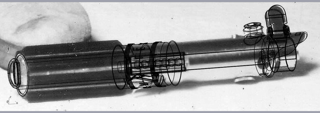

Very little is known about the shape of the D-ring and clip. They are therefore discussed intensely in other posts (here and here). Here you see a screen-grab in 3D to determine the correct size and shape in perspective as an overlay on the famous toe pic:
It took me MANY weeks to search for the correct D-ring, which I finally found in a small local shop. It is a 1” (25mm) ring, with an inner diameter of 0.9” (23mm), outer diam. 1 1/8” (28.5mm). The shape is very round (more than half a circle shape).
I then made a production run on the stainless steel clips based on Sym-Cha’s template, which proved accurate and which is considered to be pretty cool looking by many RPF members. You can attach the D-ring to the back of a Graflex with a vintage English rivet. Mine looks like this:

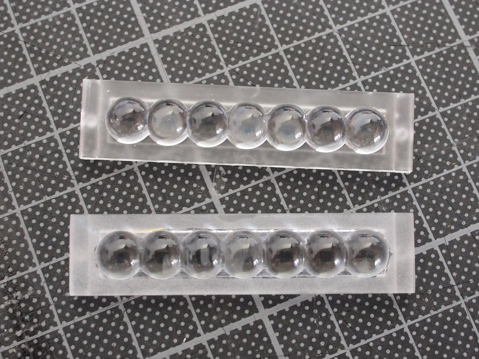

Exactra bubble-strip
The bubble-strip was based on real calculator bubble-strips from the Exactra 19 and 20. I first made a CNC machined version in PMMA which was extremely close to the original:
The top one is the original Exactra 20 bubble-strip and the lower one is my CNC version.
It was ‘uncut’ and could easily replace an original (don’t worry for fraud: I only made one and in case I will ever sell some, I will mark them as a replica). It is a bit pricey though to make in large quantities. Instead I did a run in casted resin. This one was based on the Exactra 19 and already pre-cut to fit a Graflex clamp. The result is very nice and accurate:
The bottom one is the resin casted version.
Maybe, later, I could perhaps start a production run in polycarbonate on a real injection molding tool. This is how the real strips were made, but the investment is high and the return on it is risky. I might have to sell hundreds to make it worthwhile. Let me know what you people think!

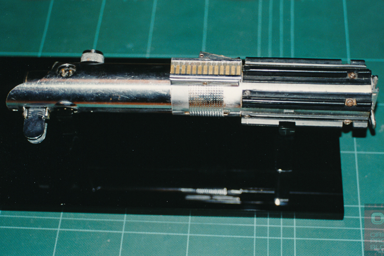

PCB Edge connector
The part clamped in Luke ESB lightsaber is a piece of a vintage computer’s edge connector. They say it's from an old HP multibus boards, like this one (I found this on the internet, it said Hybricon WW2):
I based my replica on this picture from the archive where the exact shape and size can be seen:
Rare-LFL-Lucasfilm-Archives-Movie-Prop-Lost-Photos-Star-Wars-Indiana-Jones-Historic-Visit-Origin.jpg
The 13 connector strips are rectangular shaped with a narrow bit on the right side. The PCB material is not commonly used anymore, but I have a good friend who managed to find the correct color and he produced the correct connectors for me. Here is the result:
That’s it! Thanks for your attention. Please let me know if I made any mistakes or if you think I can improve the parts. Let me know what you think and have a look on my website.
