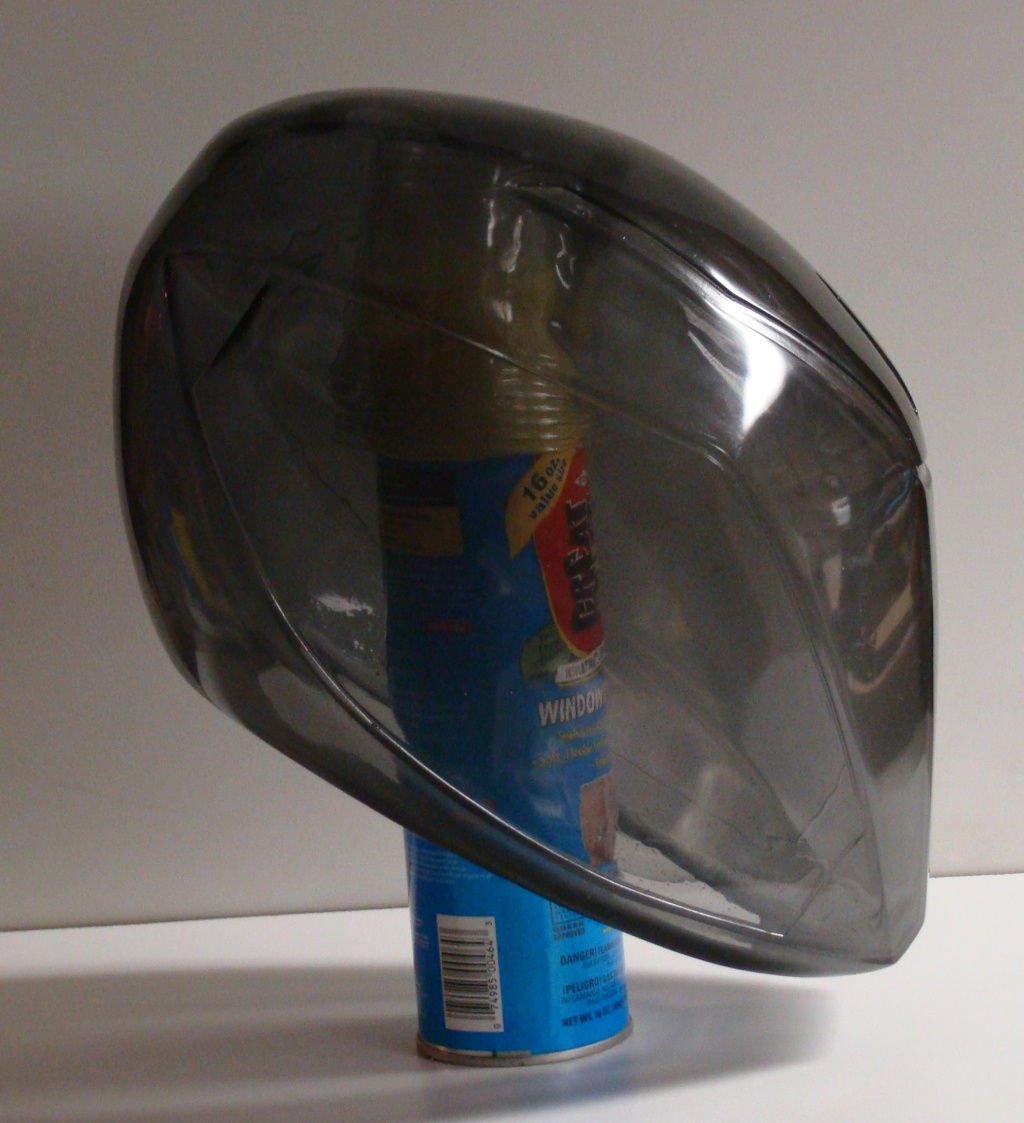

3 days curing, and it is solid enough to demold. I'm pleased with the transfer of detail from the sculpt.
I'll let it cure for 2 more days before I dig in to the finishing work.

Update:
Everything will be identical to how I make the Quorra helmets except for the lighting. It is proving to be much more complicated than Quorra. I can't just use EL wire, since CLU's light is much thicker. So my original plan was actually to use angel-hair EL wire, stacked 6 strands side-by-side to get the thickness. The angel hair wire has a thinner protective jacket, so there's less light drop-off between the stacked wires, and you can bend them tighter. Good theory, and it actually looked pretty good when done, but the whole process turned out to be very time consuming. Also, gluing down each wire is messy and makes it much easier to marr the cast in the process.
I've made another cast, and it will be ready to pull on Thursday. I'll be trying out a different lighting approach on that one, so we'll see!
