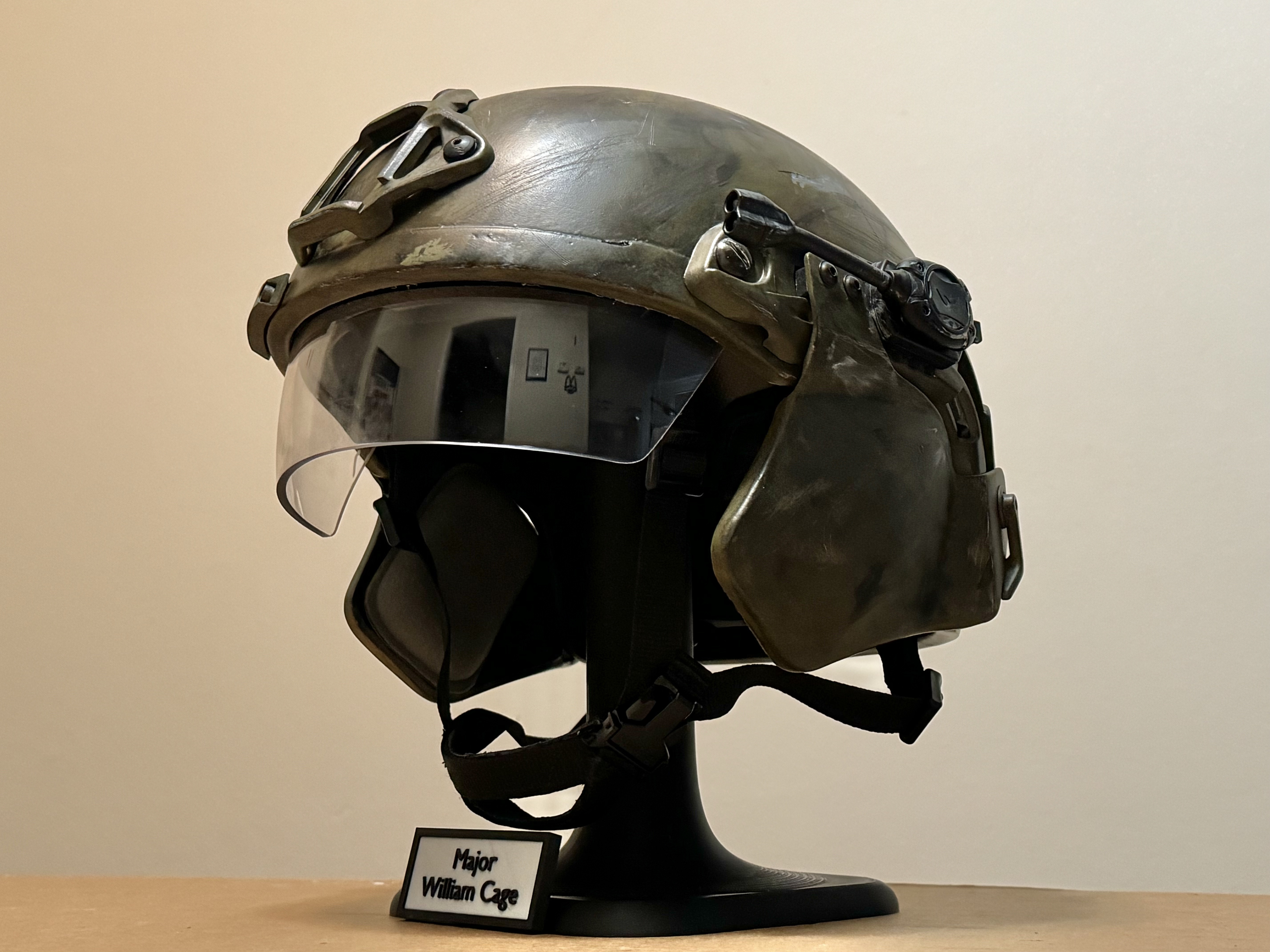

The Build:
1. Remove the velcro on the helmet
2. Unscrew the side rails, this removes the harness too
3. Depending on the version you have; cut or simply remove the bungee cords
4. Smoothing the helmet
-a. Ops Core: there’s this weird texture on the helmet like a 2 grit sand paper, I used 120 grit to remove all these bumps
-b. Ballistic armor co: this texture is even more odd, it’s uneven and bumpy. I used bondo glazing and spot putty + 120 grit to smooth it out
-c. Airsoft: nothing, skip this step
5. Mask the inside of the helmet
6. Priming the helmet, I used rustoleum filler primer
7. If you’re lucky enough to have ops core side armor, prime these as well. If not then smooth the airsoft ones using some method of your choice, then prime
8. Prime the rails, the ops core are glass filled nylon, ballistic armor co looks like plain nylon, the same primer works on these plastics
9. Prime and glue on the HUD detail, I used 24 hr Epoxy + clamps
10. Paint matte black (any kind will do)
11. Paint tan (any kind will do)
12. Paint green, the type I used was Testors Flat Olive
13. Reassemble the helmet
14. Weather, I used a simple acrylic wash of black and brown with tan highlights
15. Trim the visor, the angles should match the angle of the side armor and have roughly a 5/8” gap between the visor and side armor
16. Glue in the visor, I used e6000
17. Attach two helmet pads, one to each side armor piece, I used the velcro that came in the package
18. Make/ print a helmet stand
19. Rewatch the movie!
After Sanding
After priming
After Painting
