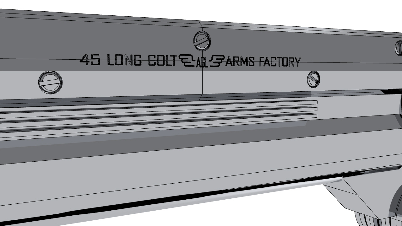

Had to rework the breech area because it was too small. Etched in the text areas, as well.

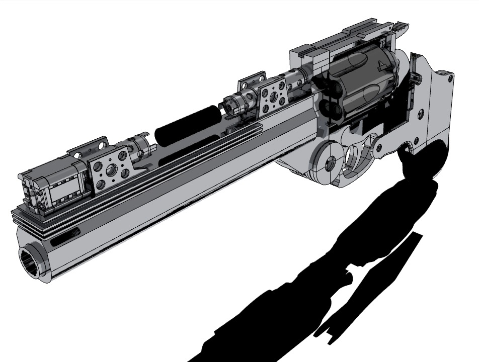

Started the tedious task of cutting out the side panel for internal access, as well as gutting it to allow the mechanics to move around. This will probably take the longest out of everything. Again, I could just make it super simple, and I might make a non-functional version for cosplayers or whatever, but for now I want this as functional as possible. Things will be easier once I get the resin printer in and can start printing the internals for test fitting.

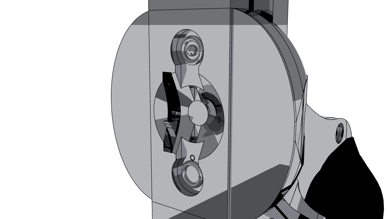

Worked on the rotating hand area a bit. It's not perfect because I had already designed it to fit the ejection star piece according to the original design, but I got it as close as I could. Still debating on whether I keep the firing pin at the top (like in the show design) OR move it to the bottom.. I'll probably move it so it makes more sense.
I think that this is the most in-depth build for that prop; you're raising the bar and I love it (y) (y)
Thank you. I set out to make it as close as possible to the actual design and functionality of the source material. It's a long and tedious process, but it'll be worth it in the end.
