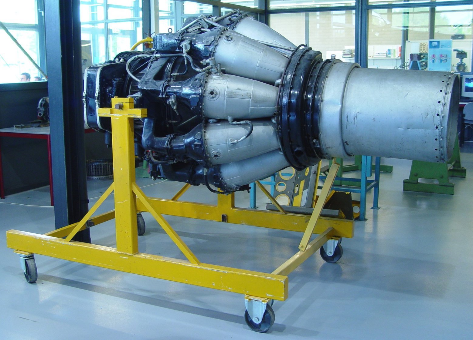

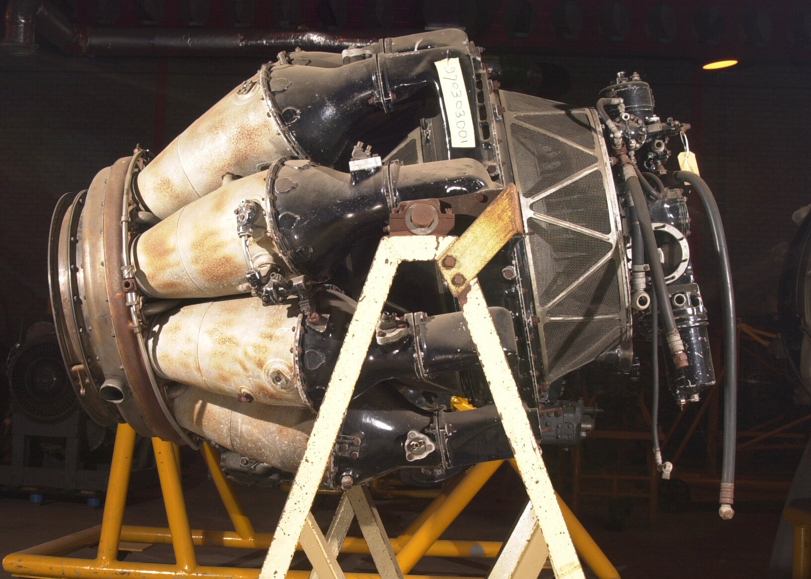

Having mentioned that 300 Gloster Meteor Fighter Jets were build under license by Fokker here in the Netherlands, I'd now like to present to you the motherload of Mk8 engines of which at least 2 have been confirmed to have had the Mk9 upgrade . . . unfortunately for us, Obi-Wan lightsaber builders, these jet-engines are being kept in a depot belonging to the Nationaal Militair Museum in Soest. I doubt they would become available for a collector any time soon ... nevertheless I'd like to share the pictures I found online with you all :

Wow chaim! That’s a beautiful aircraft!!

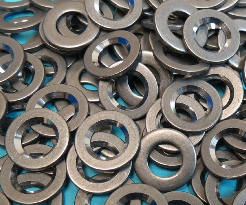

I now present :
From a seller which was already in the picture, yet now has the more accurate washers size-wise available in his ebay-shop.

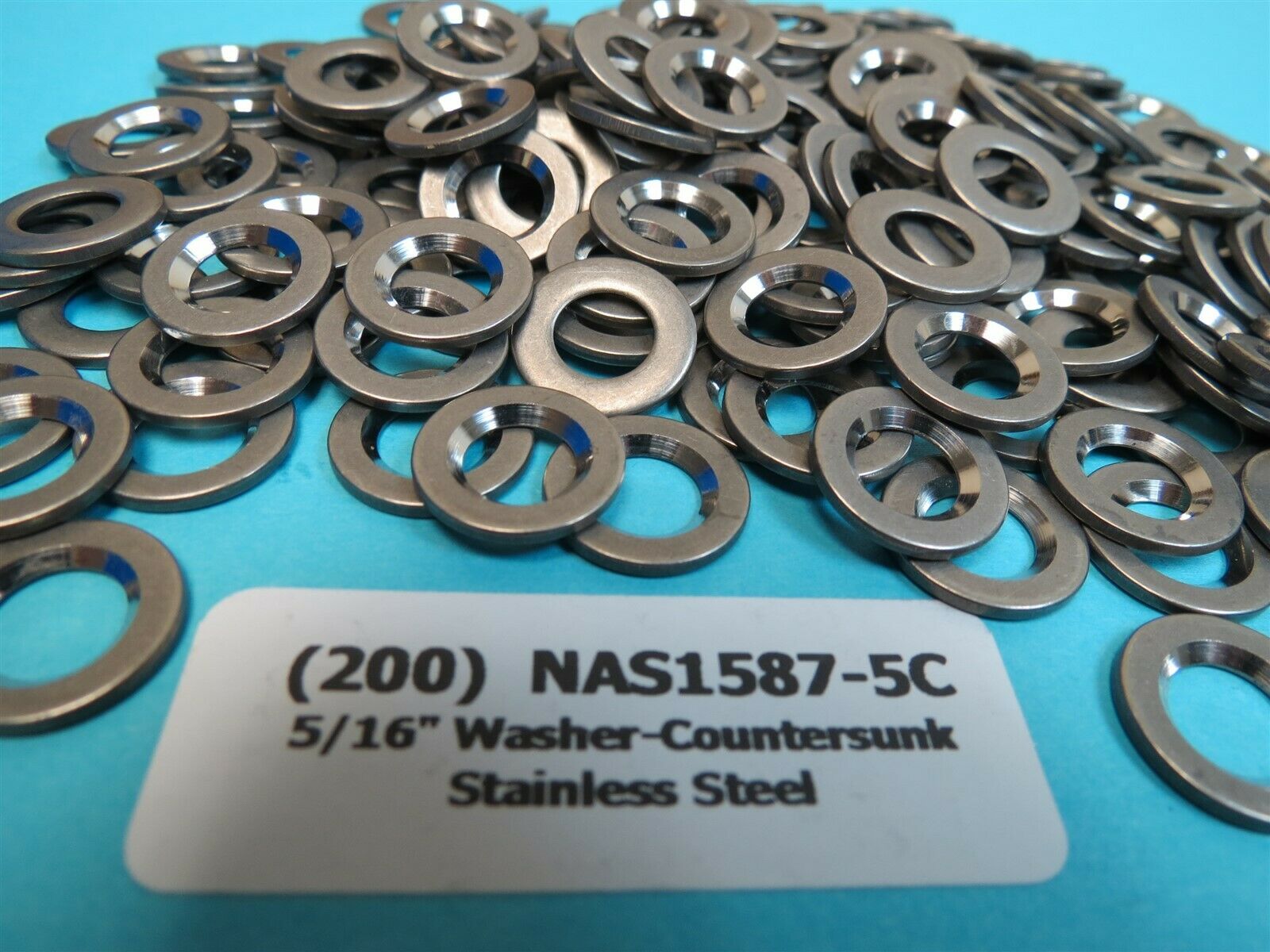

Here are some specs from the seller's auction :
... still the outer diameter is to large and some have an inner diameter that needs adjusting to accommodate our transistors.

Another picture from the auction :

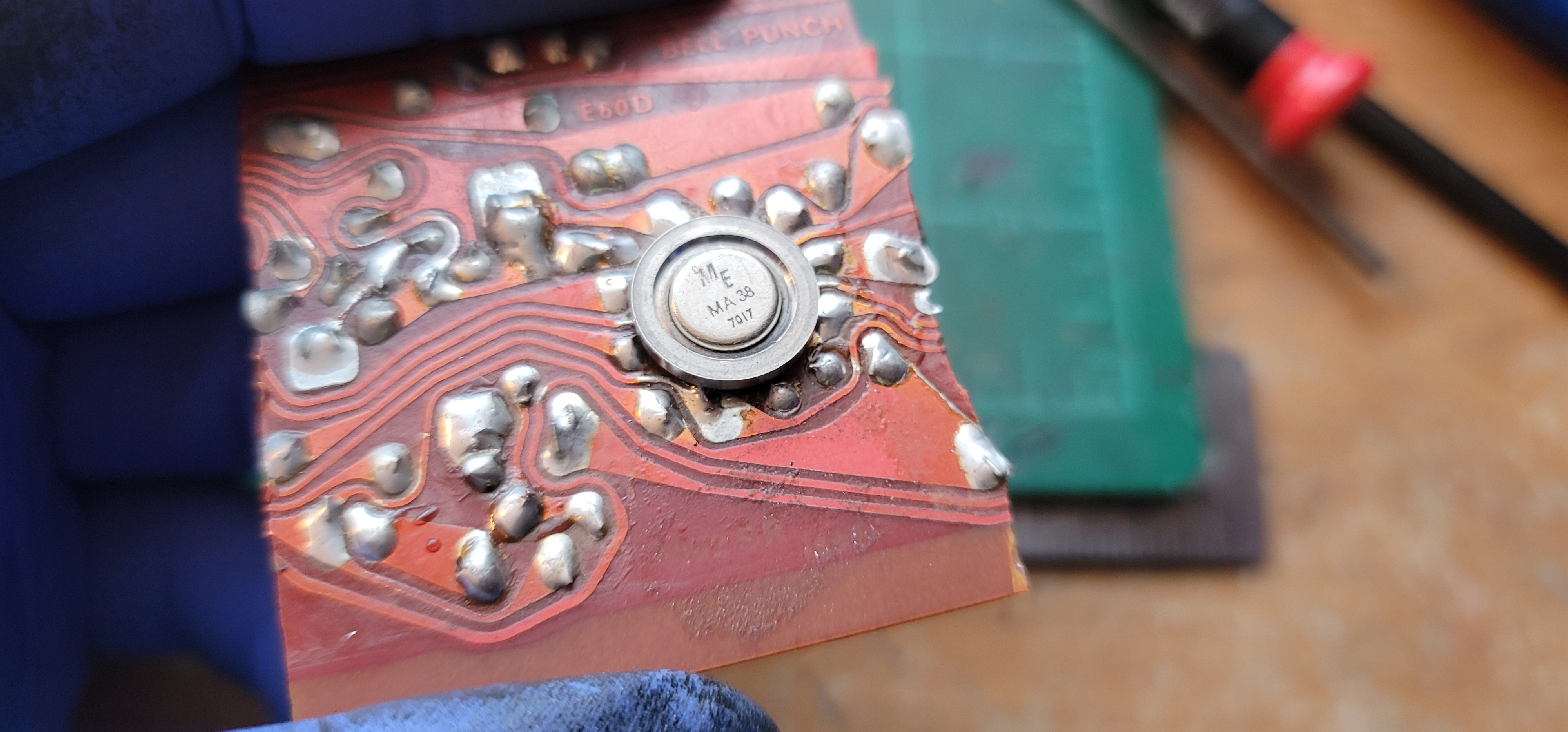

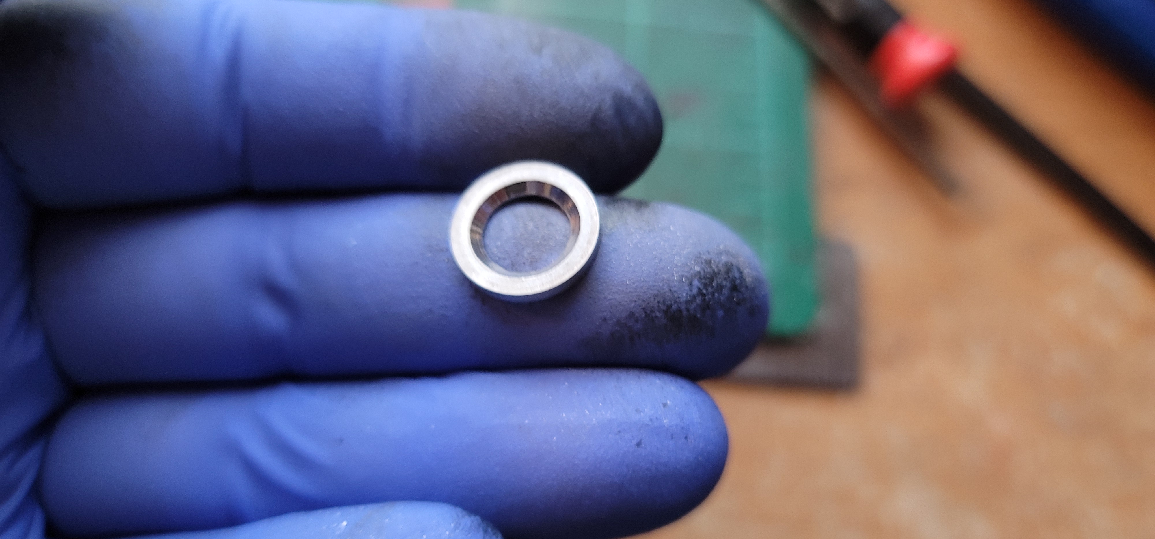

Since these washers are still a bit to large thus in need to be altered and being sold from Dallas, Texas I reached out to scottjua who was more than willing to investigate ... 'They're local to me. I sent them a message to see if I can pick them up' ... so he made contact with the seller and the next day went out to see them in person, bringing along an ME transistor to make certain those washers would fit properly.
The following day I received this message :
Scottjua even went to work on a bunch of them and resized to the specs as mentioned above ... here are those pictures in close-up:
So eventhough these newly found washers still need some adjustments to fit our transistors properly, at least the thickness of 0.078 in/ 1.98 mm is now more accurate to the calculations made by schrodinger555.
Now if any of you are interested in a set of these washers ... please contact scottjua for more info ... or perhaps even better ... wait until he joins us here with a link to an interest thread in the junkyard ;)
Chaïm
Whoa, great research you two!
Did he machine a step into them instead of the bevel?
At least we’re closer to a found part!
It should still be a bevel as in the first picture, though it seems a step (?) in the second now that you mention it, possibly an optical illusion ... I'm still awaiting some more pictures and perhaps then scottjua can enlighten us further :)
Chaïm
They already have the bevel but it looks like the degree is off.
Edit. It does look like a bevel step bevel in that last pic.
