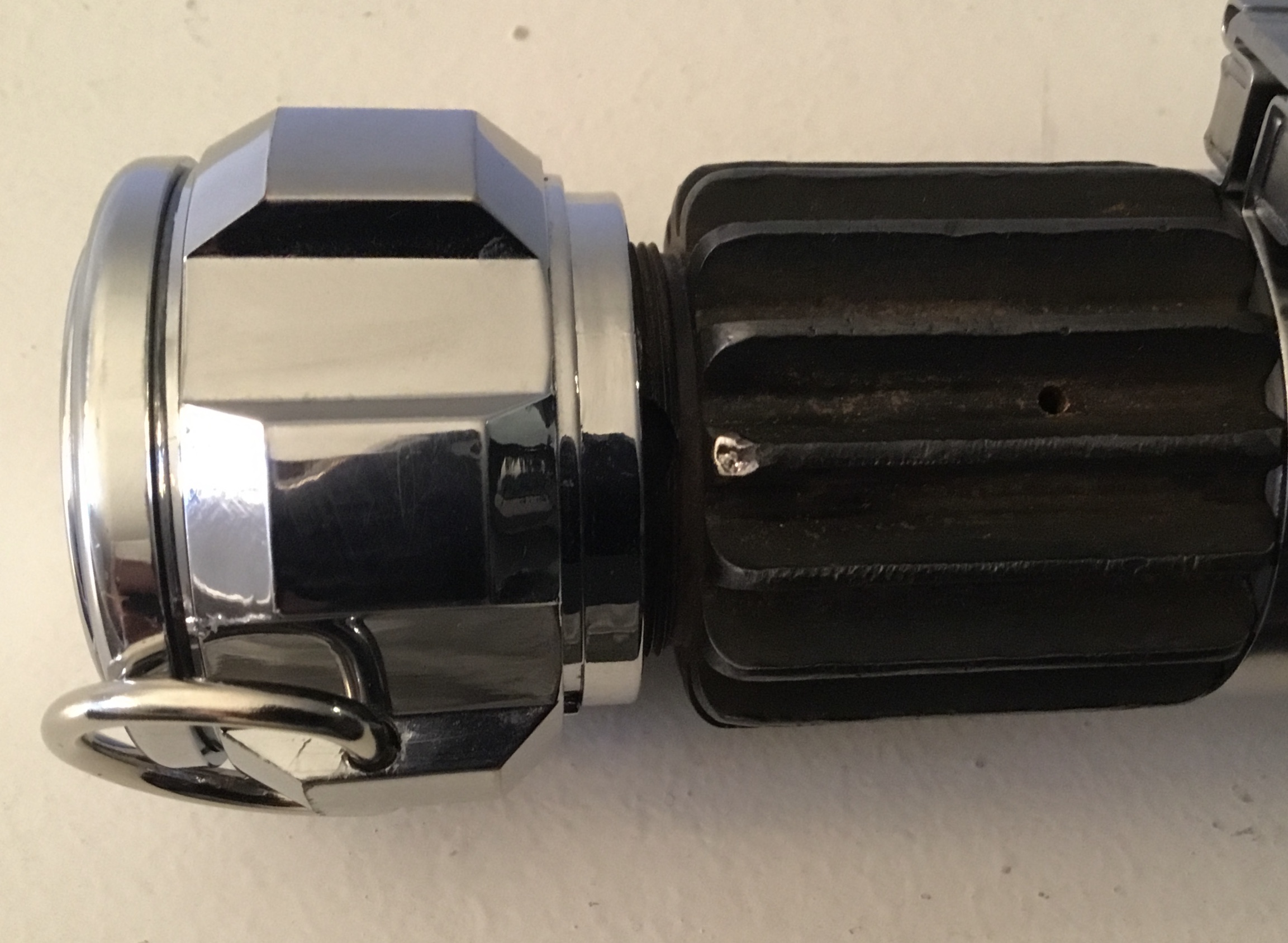

Added the weld on the booster by Dremeling away the edge of the fin at an angle, adding solder, then carefully shaping the solder blob with various Dremel bits and files. Might need some more work. Based on the limited (and mostly black and white) photo reference, I suspect that the weld was blued along with the rest of the booster after it was separated from the flash suppressor, so I’ll likely give it a dab of Super Blue to blend it in a bit.

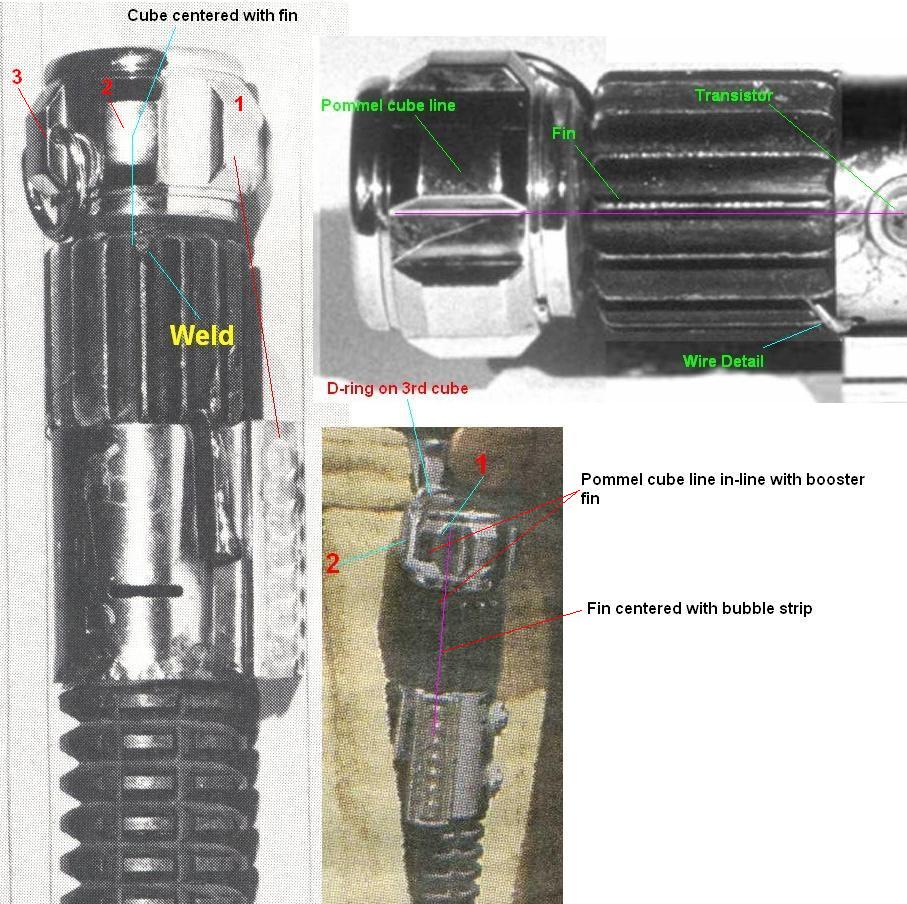

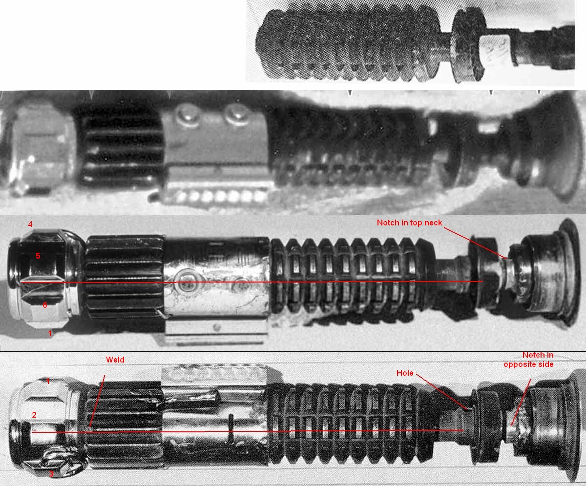

Also, Roman’s FX cage appears designed to clock the parts in a specific way. However, it looks to me that, on the real prop, the big hole in the booster (just above the threaded section) was actually aligned with the fin that has the weld. That’s how Scott Juarez and others have aligned their builds. Roman’s has it the other way, spun around 180 degrees.
So, I’m not fully threading the booster and grenade onto the FX cage, and I’ll just allow the balance pipe spacer to tension-fit the parts in place when aligned properly. In the final stages the FX cage and the center of the threaded rod which holds the prop together will be painted black, so as not to be seen through the holes in the clamp.

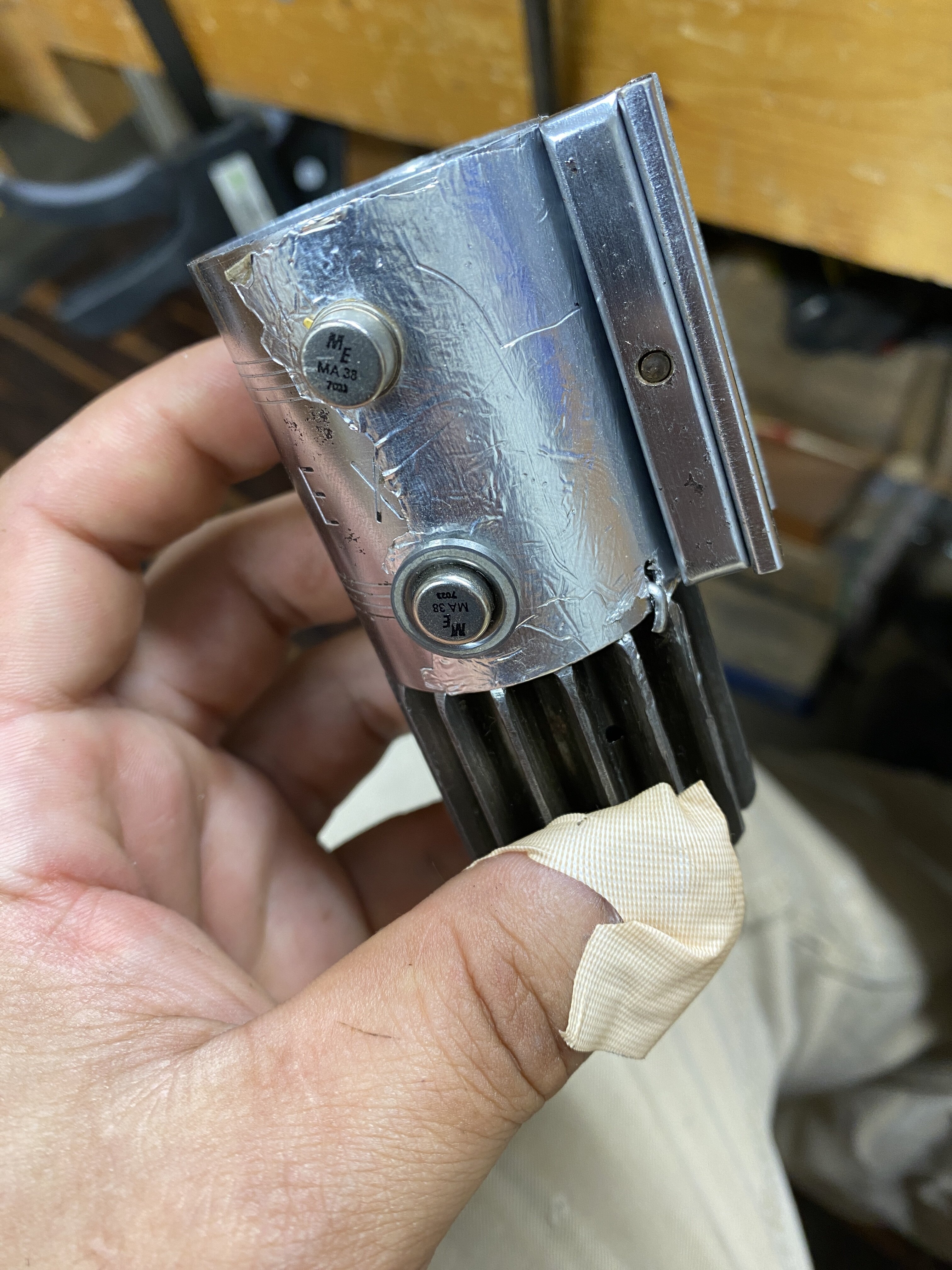

I also keep thinking about the clamp. If it did indeed have tape on it--which it appears to--, how did it it get SO damaged? Did they have to rip some of it off? Some kind of quick, on-set repair?

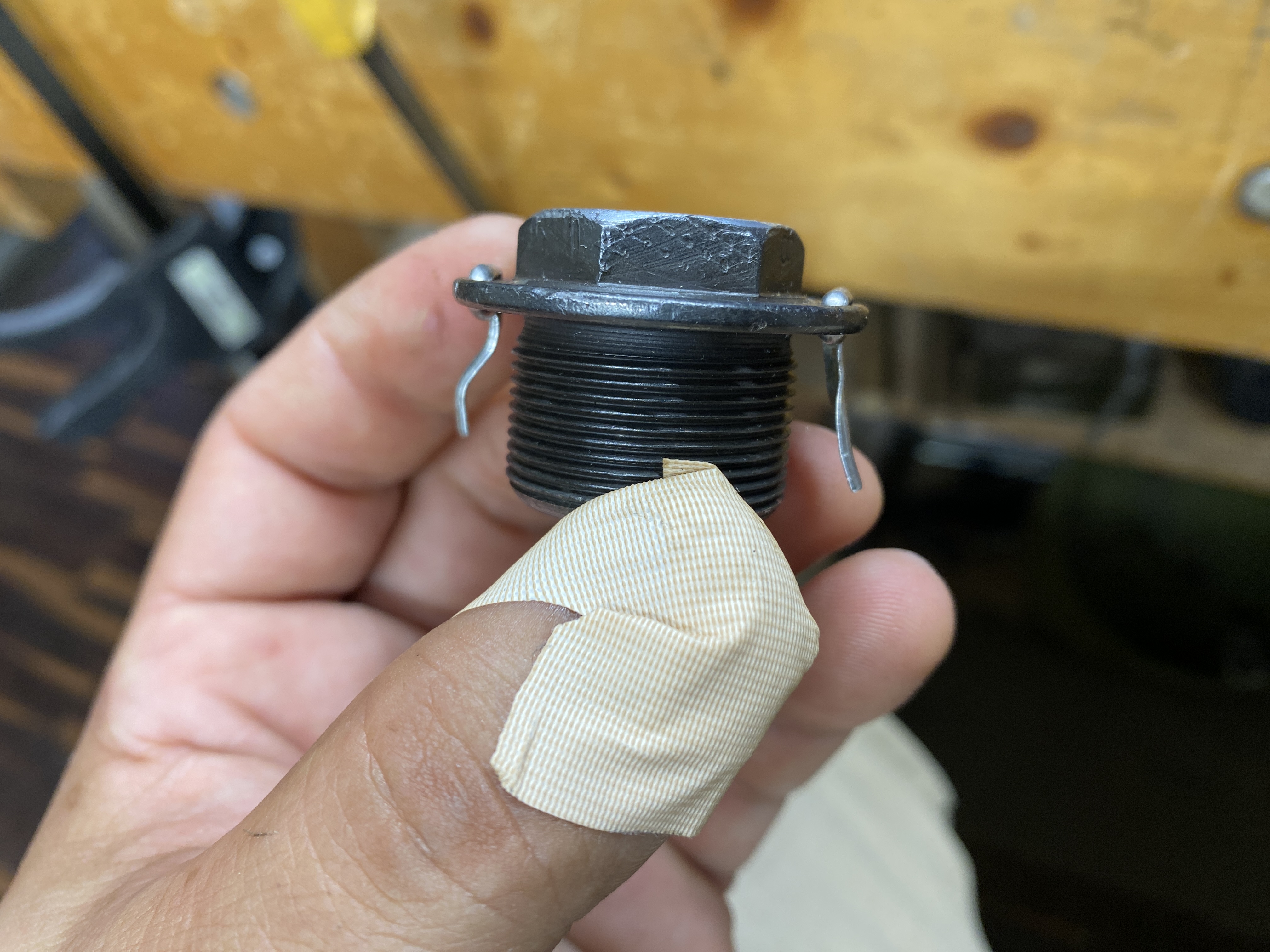

Are you going to do the cotter pins as well? I just did mine the other day and used the booster bearing to assemble the whole thing, it's conjectural just like a lot of these builds, but this way the cotter pins and bearing actually hold the clamp down onto the booster.
View attachment 1830173View attachment 1830174Are you going to do the cotter pins as well? I just did mine the other day and used the booster bearing to assemble the whole thing, it's conjectural just like a lot of these builds, but this way the cotter pins and bearing actually hold the clamp down onto the booster.
Obviously, my setup doesn't require the pins to hold the clamp in place, but I'll be simulating them, yes, since they can be seen onscreen.

The stamped lines on the clamp are also visible in the death-drop shot, indicating that the clamp's chrome/aluminum tape was partial (or nonexistent) even at that time, as well as the one transistor washer being missing.
It seems pretty evident to me now that the Chronicles saber IS what's seen in the film during the Death Star scenes, as is.

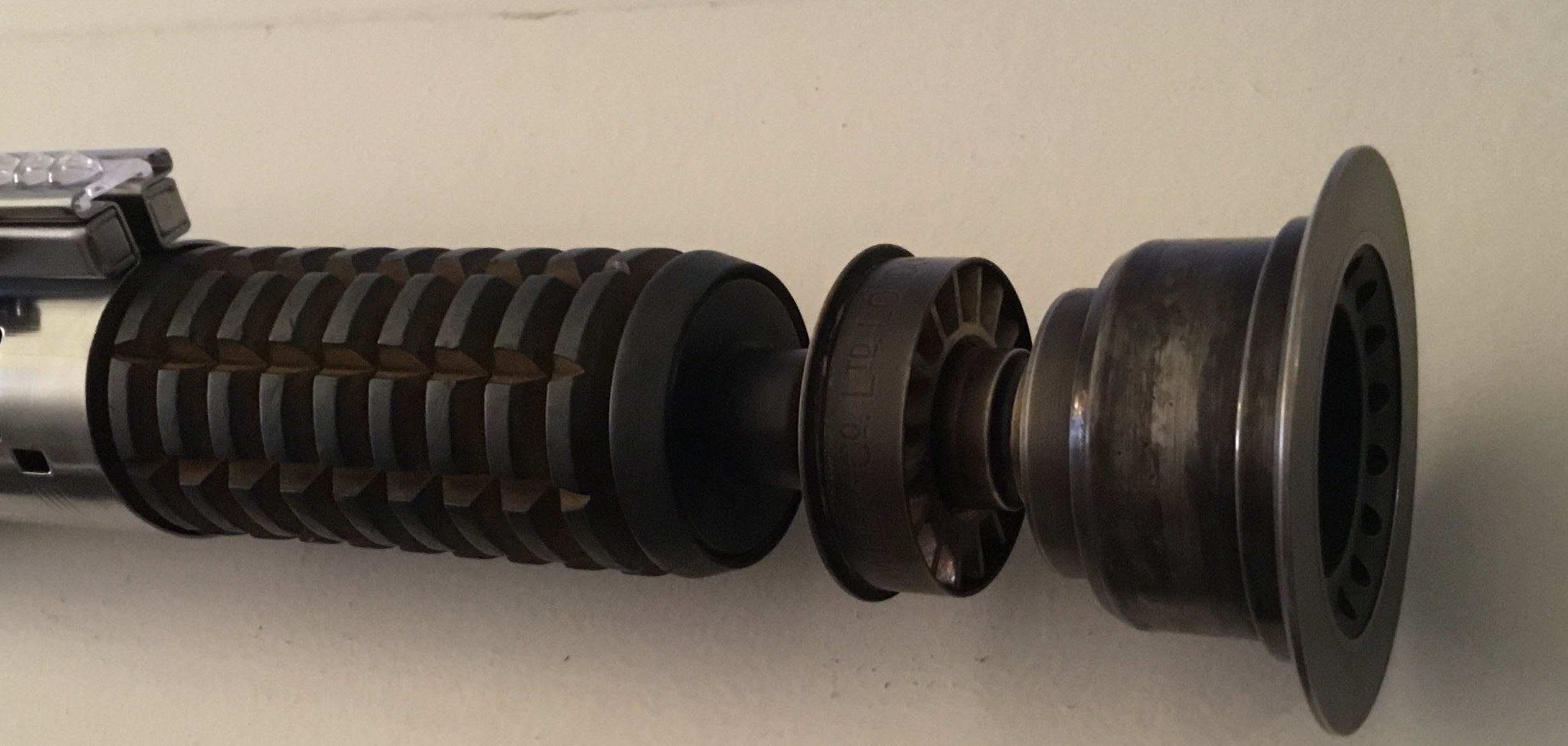

Disassembled the prop. Gave the grenade and booster a scrubbing to remove the past two weeks’ worth of rust buildup, then re-blued them once again. I’m really liking where this is going. Both parts are developing a patchy, textured appearance (including subtle rust spots) which really helps with the illusion of aging.
I also gave the central section of the threaded rod a shot of black paint. Roman’s steel FX spacer cage developed a bit of rust while the prop was assembled, so I’m currently stripping it with white vinegar before giving it a shot of black paint, as well. The threaded ends will then get a coat of oil to prevent them from rusting.

Hey, before I go to the trouble of trying to do it from scratch, has anyone made a template for the shredded metallic tape on the clamp?
I think DaveP had something for it on his website. I'm not 100% sure, a bunch of stuff was removed from the website but I'm pretty sure I remember seeing something for it.
Good luck on your build, beautiful work.
Haven’t had time to work on the clamp, but I’m also conflicted over getting it right. Don’t want to screw it up!
