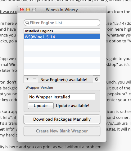

INSTALL PEPAKURA ON MAC
1. Make sure you have bought and downloaded Pepakura Viewer or Designer depending on what you exactly need and have the .EXE.
2. Go to http://wineskin.urgesoftware.com/tiki-index.php download and install the program from the DMG.
3. Launch Wineskin Winery. From here we'll need to grab a New Engine. Make sure you use 1.5.14 (do not select the AMDspeedhack) or else you'll never be able to select a default exe and have to go through the "install process" every time. From here highlight the 1.5.14 engine by clicking once and hit "Create New Blank Wrapper". Once you do this you'll name your app (call it Pepakura or whatever you'd like) the first time you'll receive notifications to install Wine Mono and Wine Gecko, go ahead and do this. Once it's finished you'll get the option to "View your wrapper in Finder" do this and just move it to your desktop.
4. Double click on the wrapper/app we created and click "Install Software", from here navigate to your pepakura installer.exe file and select it. From there you will install it like a normal Windows program. Deselect "Create Shortcut on Desktop" as it's useless in this case, if you forget it'll simply just create a .INK file you can delete later from your desktop.
5. You will receive an invalid error, don't worry about it just hit okay and Pepakura will launch, you will receive this error each time but don't be alarmed. Wineskin may be working in the background at this point, let it complete. At this point quit out of the Pepakura app you just created (CMD+Q). You should receive a notification that you need to select a default .exe. Make sure you select pepakura3.exe from the list. You can now relaunch Pepakura easily each time and enter your key code to unlock the full version, you will only have to enter your code once on the next launch.
6. You can now move your Pepakura application to your applications folder. The default icon is rather ugly, however you can change it. Right Click on your application and select "Get Info", if you click the icon it displays at the very top left hand corner, it'll highlight it with a blue outline. At this point you can save this to your desktop (it's a transparent PNG) https://dl.dropboxusercontent.com/u/2050866/Pepakura_Icon.png open it with preview, hit CMD+A (Select All), CMD+C (Copy), go to the "Get Info" window with the selected icon and hit CMD+V (Paste). It will now make this your icon. (You can do this with any icon you want for that matter, my hard drives are a bunch of avenger symbols.)
As far as I can tell all functionality is here and you can print as well without a problem.

Hi, I have the Pepakura exe and I downloaded Wine. I opened it and selected 1.5.14, but "Create New Blank Wrapper" is grayed out. The 1.5.14 engine is already highlighted, and I can't deselect or select it.
EDIT:
I figured it out, you have to hit the Update button.
Maybe you can find another download of wine to try? Sounds like it could be the software version, but I'm just guessing. Also saw this, don't know if it helps:
http://wineskin.urgesoftware.com/tiki-view_forum_thread.php?comments_parentId=3128

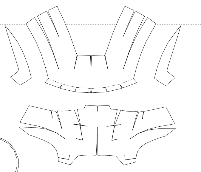

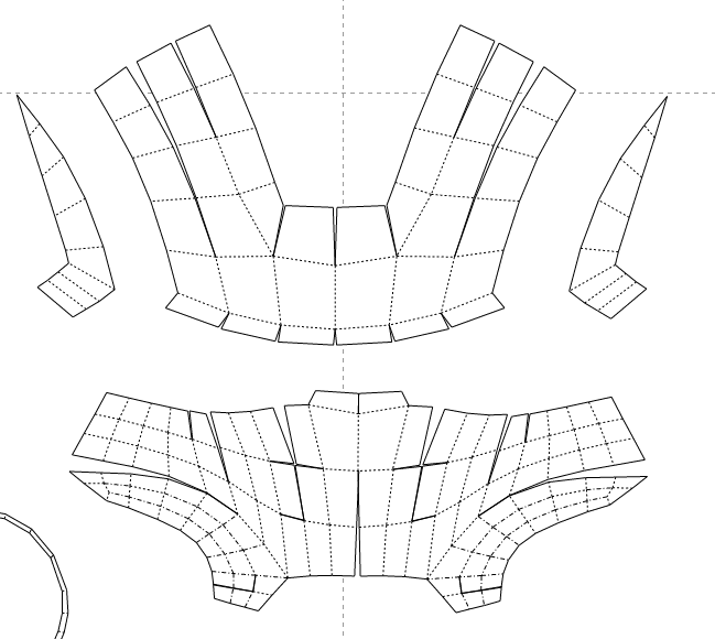

Question about foam unfolding: (My own model)
On unfolds like JFcustom's IM helmet, there are very few folds.
I can't get mine that clean, there are a lot more cuts:
Screen Shot 2015-10-19 at 2.25.58 PM.pngScreen Shot 2015-10-19 at 2.30.42 PM.png
If I just hide those lines and print in and cut it out like below, some subtle curves will be lost, is that unavoidable?

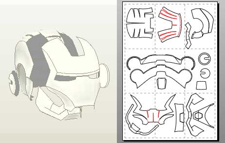

Quick instructions:
1) If this was originally a paper unfold, select undo unfold and make sure both boxes are unchecked, and select OK. Then select 3d menu>reset edge properties. Now select unfold again. This eliminates all of the settings for the paper unfold and gives you a fresh start.
2) After the model's been unfolded, hit ctl-e for the set edge color menu. Adjust the slider in the lower right down to 160 degrees. That will ignore all minor folds that can be ignore for a foam build.
3) 2d menu>join adjacent edges, just set this to .75 and hit OK. That will join up all of the gaps you would want in a paper unfold, but can be ignored in foam (it'll stretch the gaps)
4) Now unfold manually using join/disjoin and such to get the unfold the way you want it. You will occasionally want to repeat step 3 to make sure the adjacent edges you are creating as you unfold disappear if they are close enough together.
Before I start unfolding, I turn off show flaps and show edge ID if either one is on. You don't want the flaps anyways, and the edge ID function can slow your processor down if you zoom in on parts. I do turn the edge ID back on before printing though.
