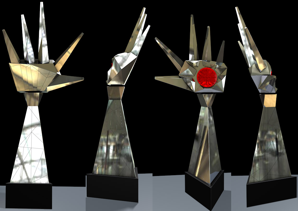

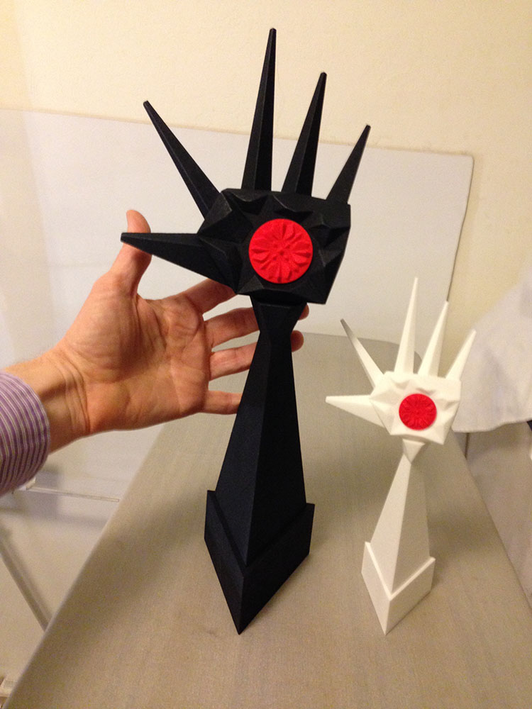

I have a couple of questions about Pepakura. I'm a 3D artist and I have made the Arcade Hand from Logan's Run. I've had 3D-printed a 9" and a 16" version. I have a Mac computer, and I have had no luck getting several versions of Winery/Wineskin to get the free version of Pepakura Designer to work: I don't want to get the paid version if I can't even get the free version functional. Anyone else had that same problem? What were your solutions?
Secondly, I want to convert the model to Pepakura because I want to take the output files and use them to have acrylic mirror pieces laser cut to fit, after which I can glue the cut mirror pieces onto the appropriate surfaces of the 3D prints. What sort of conversion needs to be done to the Pepakura files so they can be used for laser-cutting?
Thanks.

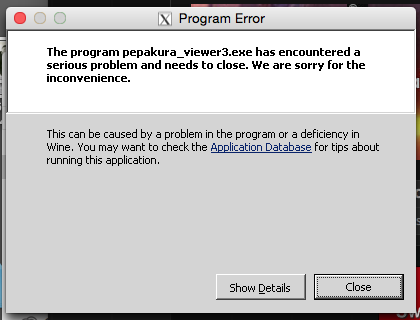

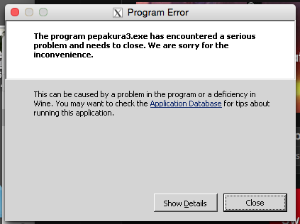

By the way, these are the error messages I get every time I try to open either Pepakura Designer or Pepakura Viewer on my Mac.
Screen Shot 2016-02-22 at 10.17.35 PM.pngScreen Shot 2016-02-22 at 10.15.05 PM.pngScreen Shot 2016-02-22 at 10.14.33 PM.pngScreen Shot 2016-02-22 at 10.14.19 PM.png
Finally had a breakthrough tonight. Previously I've been putting Wineskin and Pepakura in a folder together. Pepakura just wouldn't open. I happened to copy the Pepakura EXE into the Wineskin folder in Applications. From there it worked right away.
