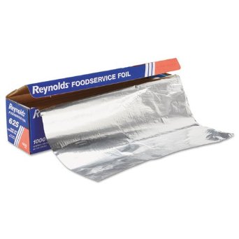

I used aluminum foil. If you need bigger, use cardboard from a box.

This stuff reynolds.jpgUsed for cooking, multiple layers of this can be rolled into a ball, an oval, it will hold it's shape. You can also use wire to make a skeletal shape.
