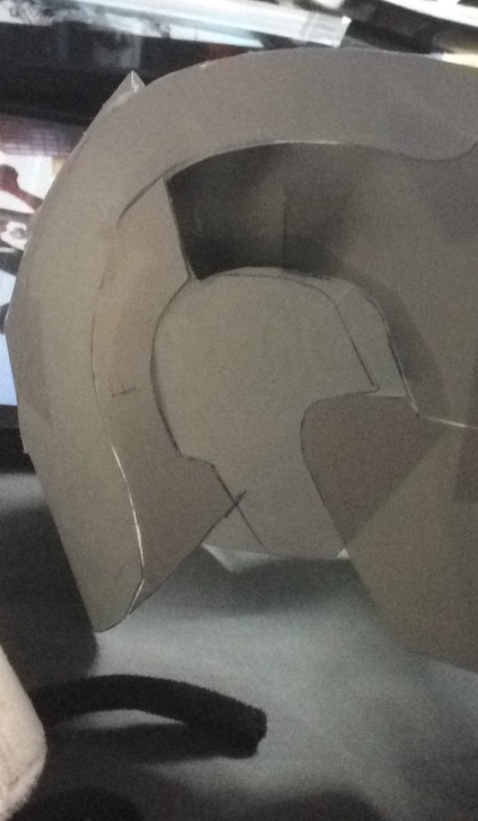

hey everyone, was wondering if anyone could help me out. The picture is of my star lord helmet. I used a pattern I found here, but when i glued everything together, my ears didn't fit. the pen is where it should line up. I double measured everything and just can not figure out what the problem is. I used poster board as cardboard was to hard for me to cut, and didn't want to commit to foam in case it didn't go well.

It's never going to line up perfectly when you assemble it, simply because the pieces aren't perfectly one-dimensional. You get shifts from thickness added when gluing flaps together, imperfections in how you aligned the pieces, etcetc...the former in particular is noticeable the thicker your materials are, and if you're using foam is always an issue (although you can compensate there with beveled cuts, so it works out). Also the pattern you're using may have been designed with a different material in mind, exaggerating the problem.
Just adjust the size of the piece so that it's right. Think of this artistically; you're going to have to deviate a little, it's not an exact science. It's not going to hurt anything. (Do be careful to try to keep things symmetric for something mirrored like this, though.)

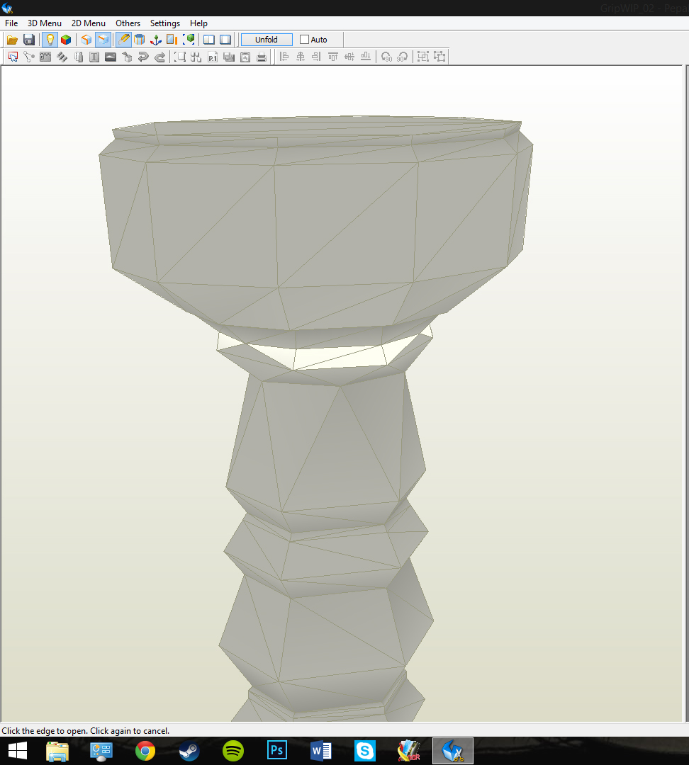

I'm having an issue with my unfolding process, and I can't quite pin down what is causing it, so I figured I'd ask here.
This is what my 3D Blender model (3ds file) looks like in Pepakura Designer 3. I can select ALL the edges EXCEPT for those around that white area. I have NO idea why that area is showing up like that. In Blender the model looks completely cohesive and fine, so I have no idea where the error is occurring.

Looks like you need to flip your normals in blender. Try going into blender, select all in edit mode and then flip normals, then export to obj.
Also, when you first load the model into Pepakura (as an OBJ/STL/etc. not a PDO), it will prompt you at one point to flip normals. Select yes, and it will reverse everything for you.
