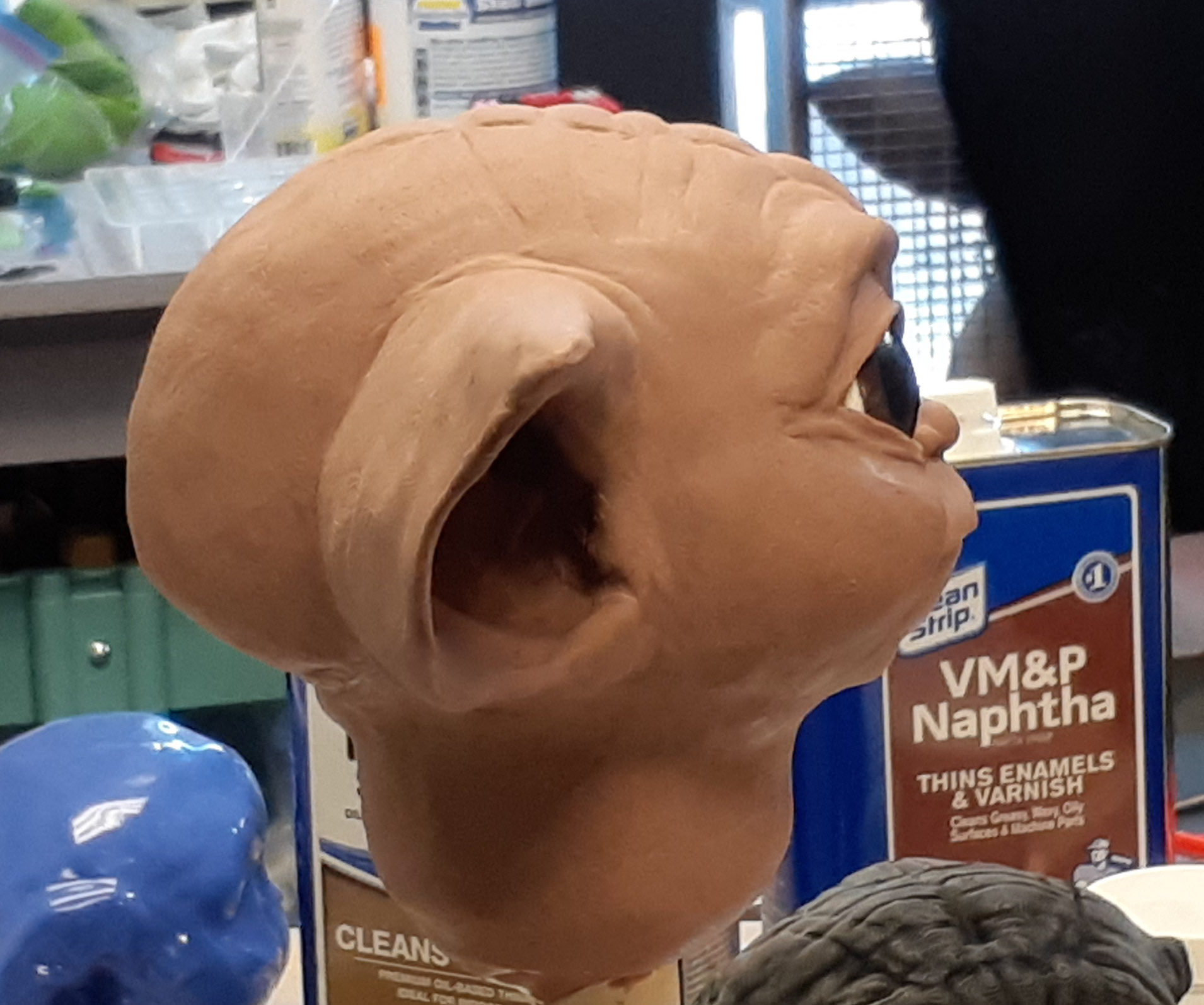

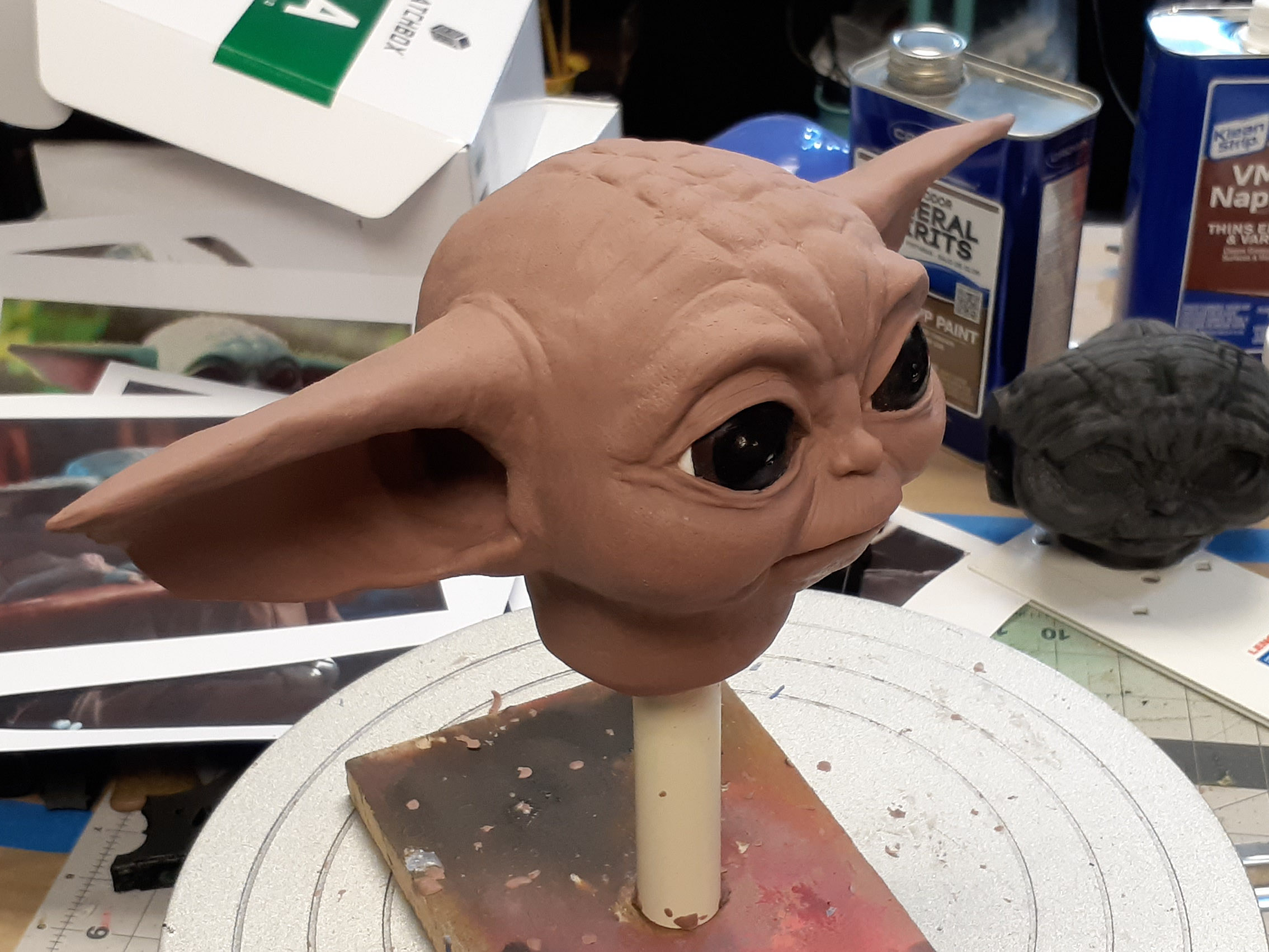

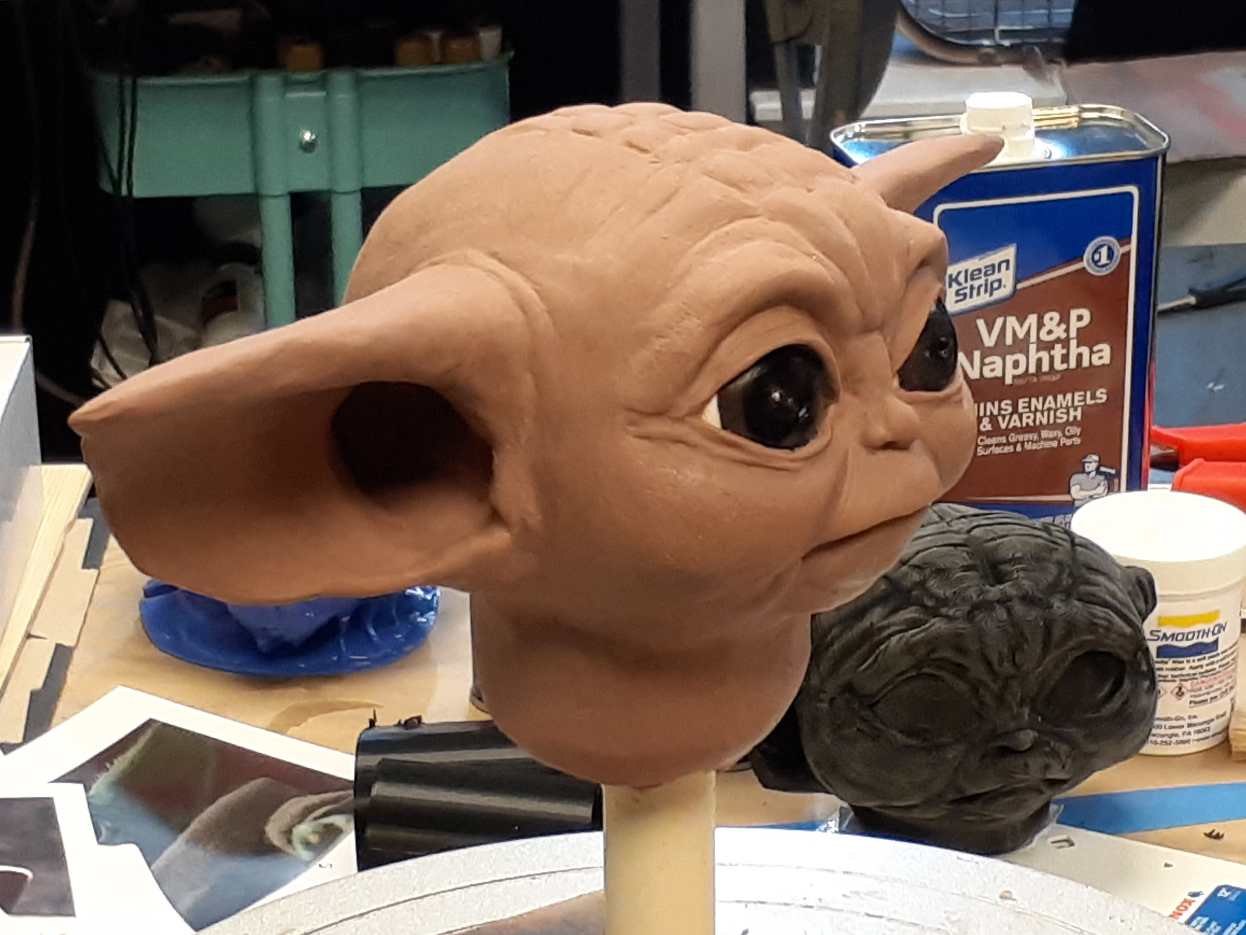

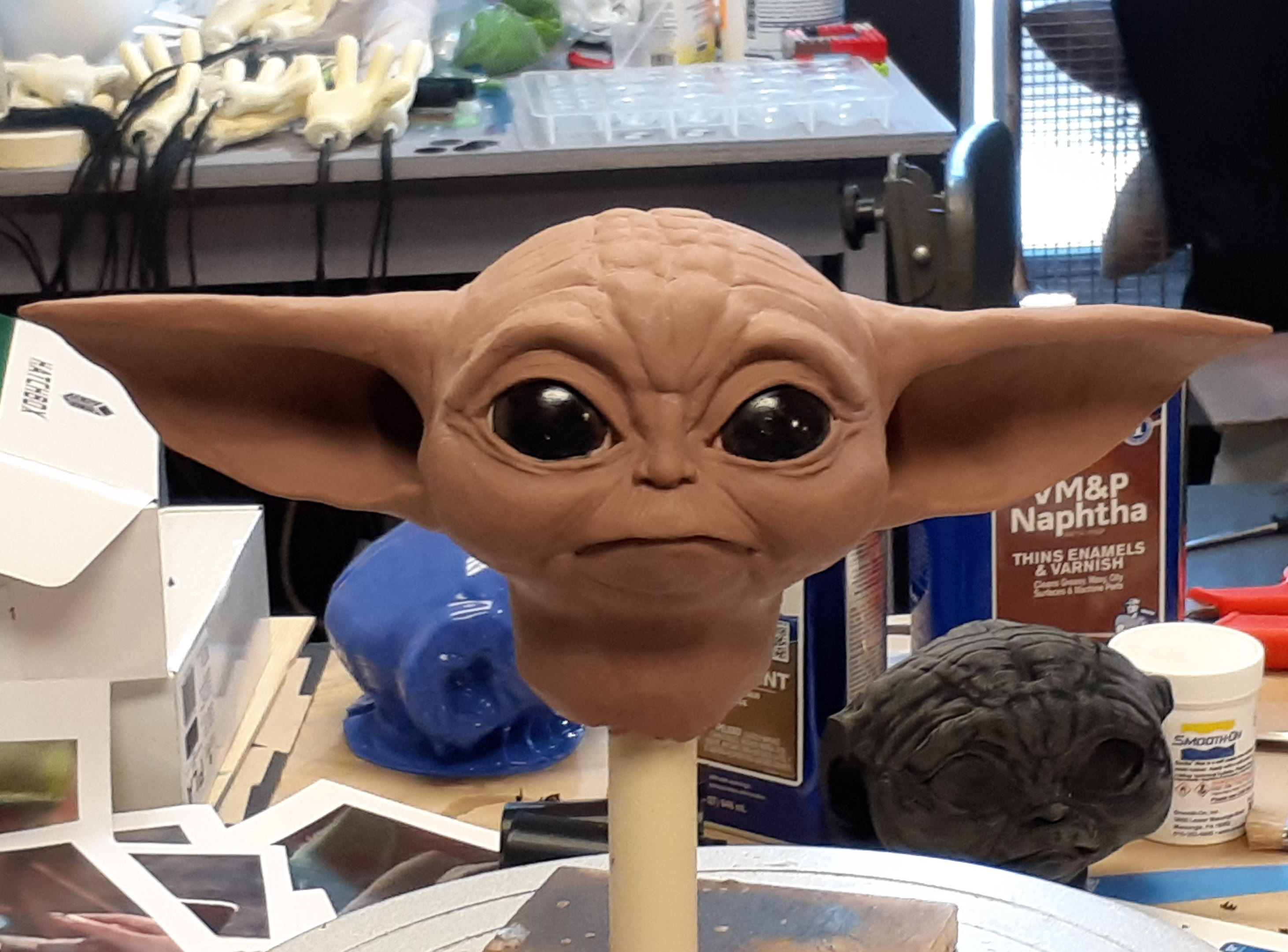

Here's the final sculpt with all revisions done texture cleaned up. The molding process begins in earnest tonight!

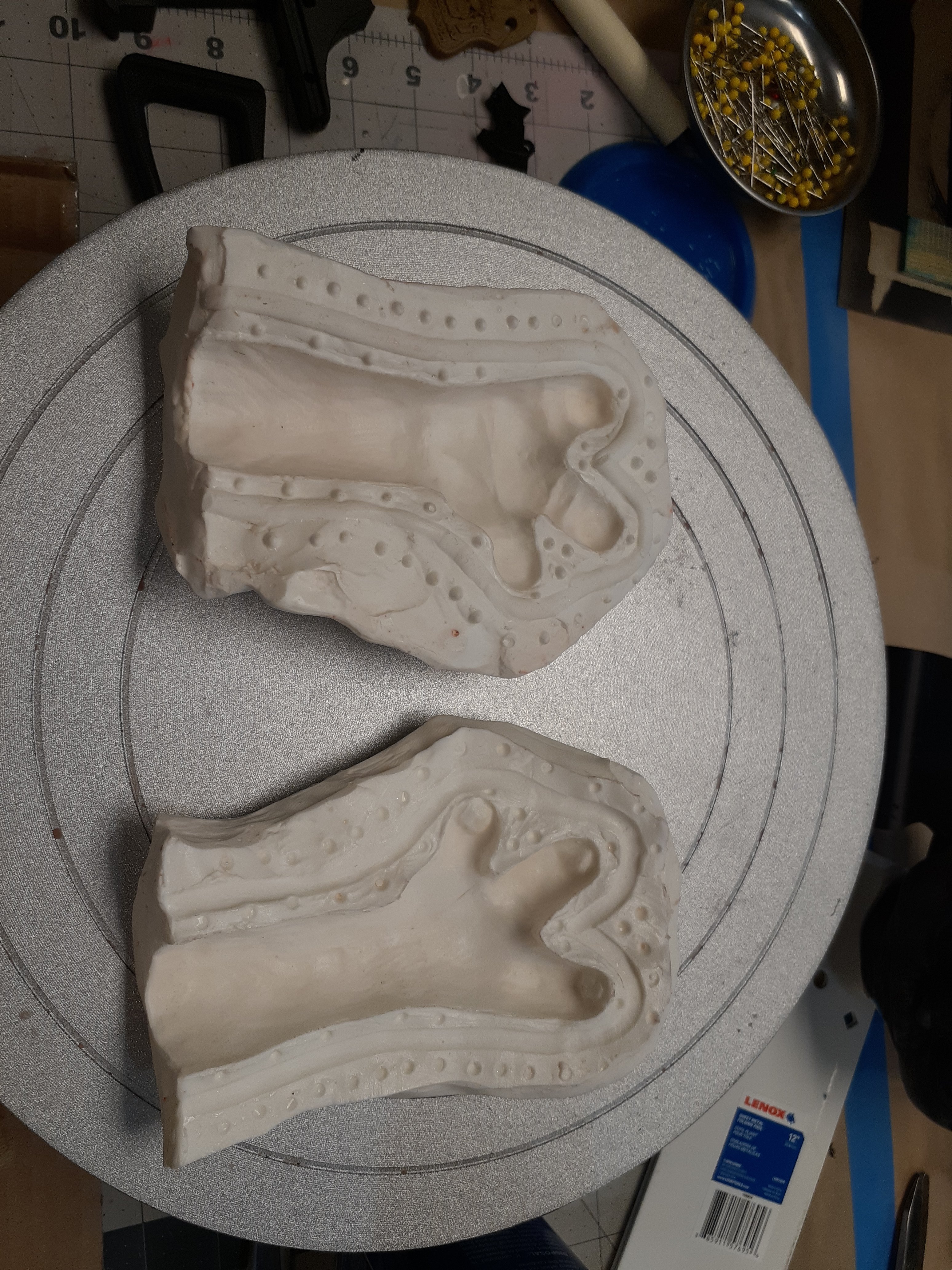

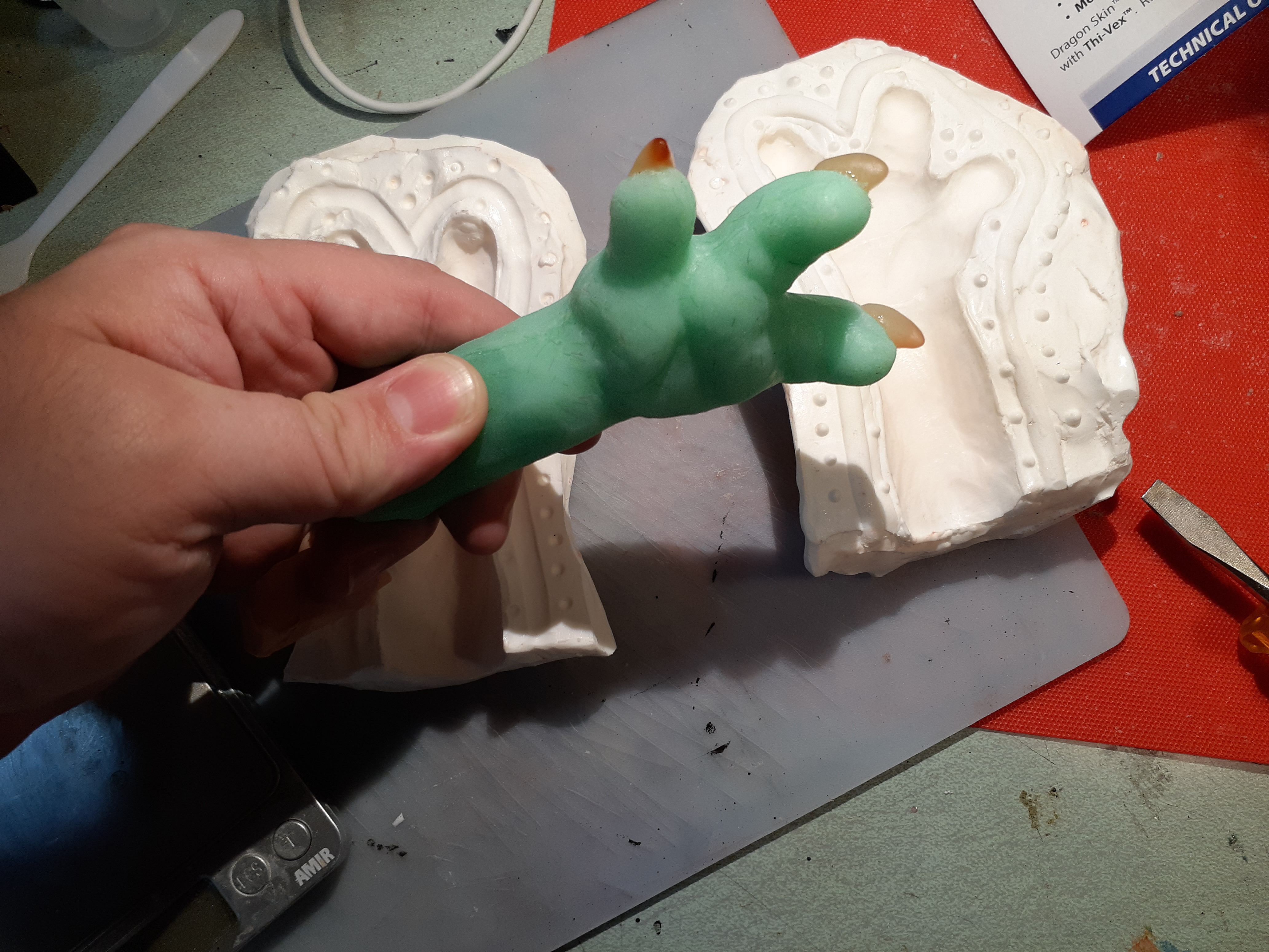

Thanks everyone for all the kind words - it's coming along. After some trial and error, I have a good process for the molds - using Smoothcast 65d in 4 layers with a clay part line, gave a very nice, very tight locking finished resin mold, perfect for casting silicon into. Was able to cast up a test hand in Dragon Skin Pro with coloring and flock combined. Also fashioned some nails from primo, baked em, and glued them in place with silpoxy. No paint on this yet, that will come after the other molds are finished! Still have to revise the color formula, and I have some smaller flock coming in to add to the overall pigmentation.
