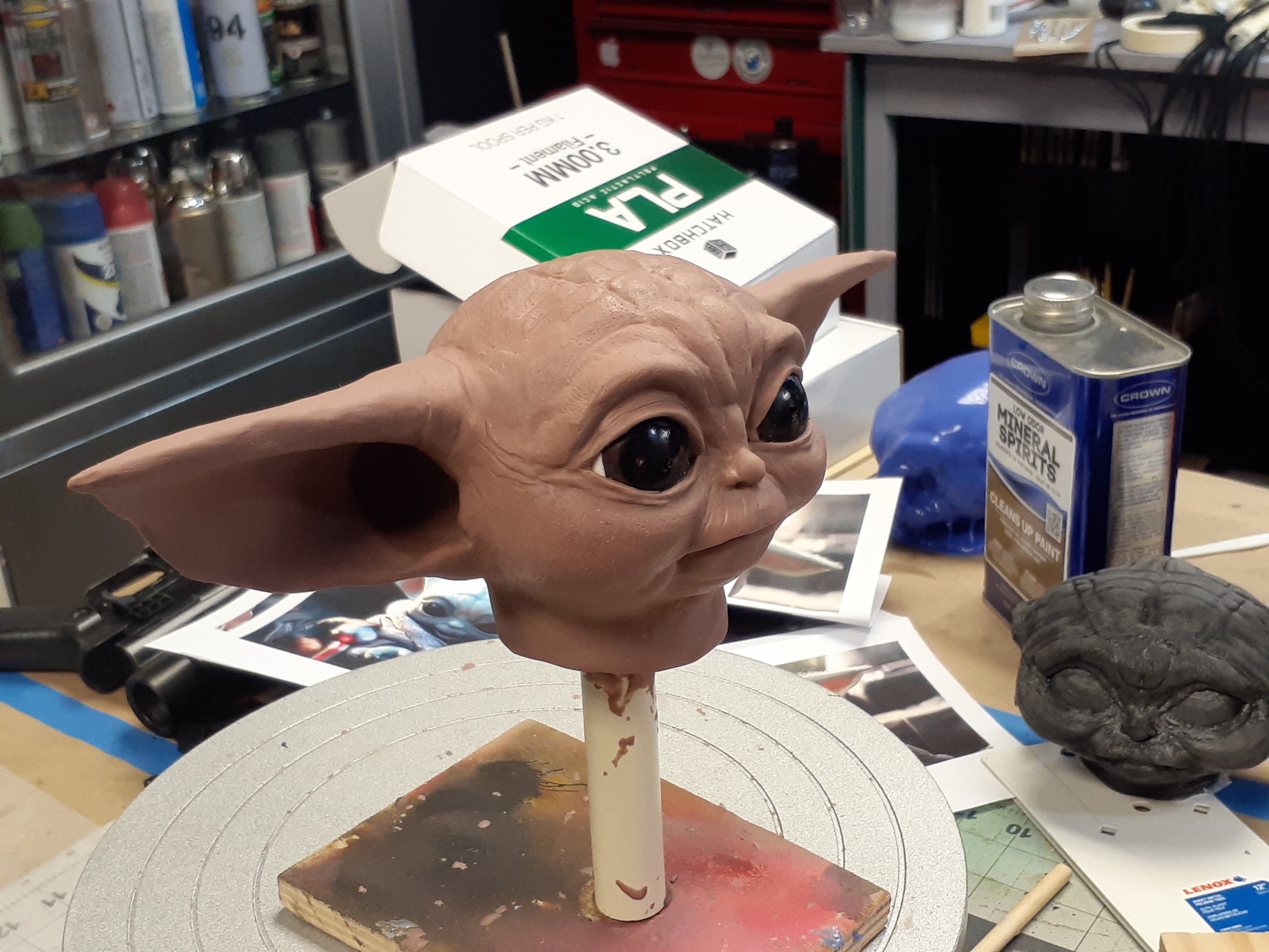

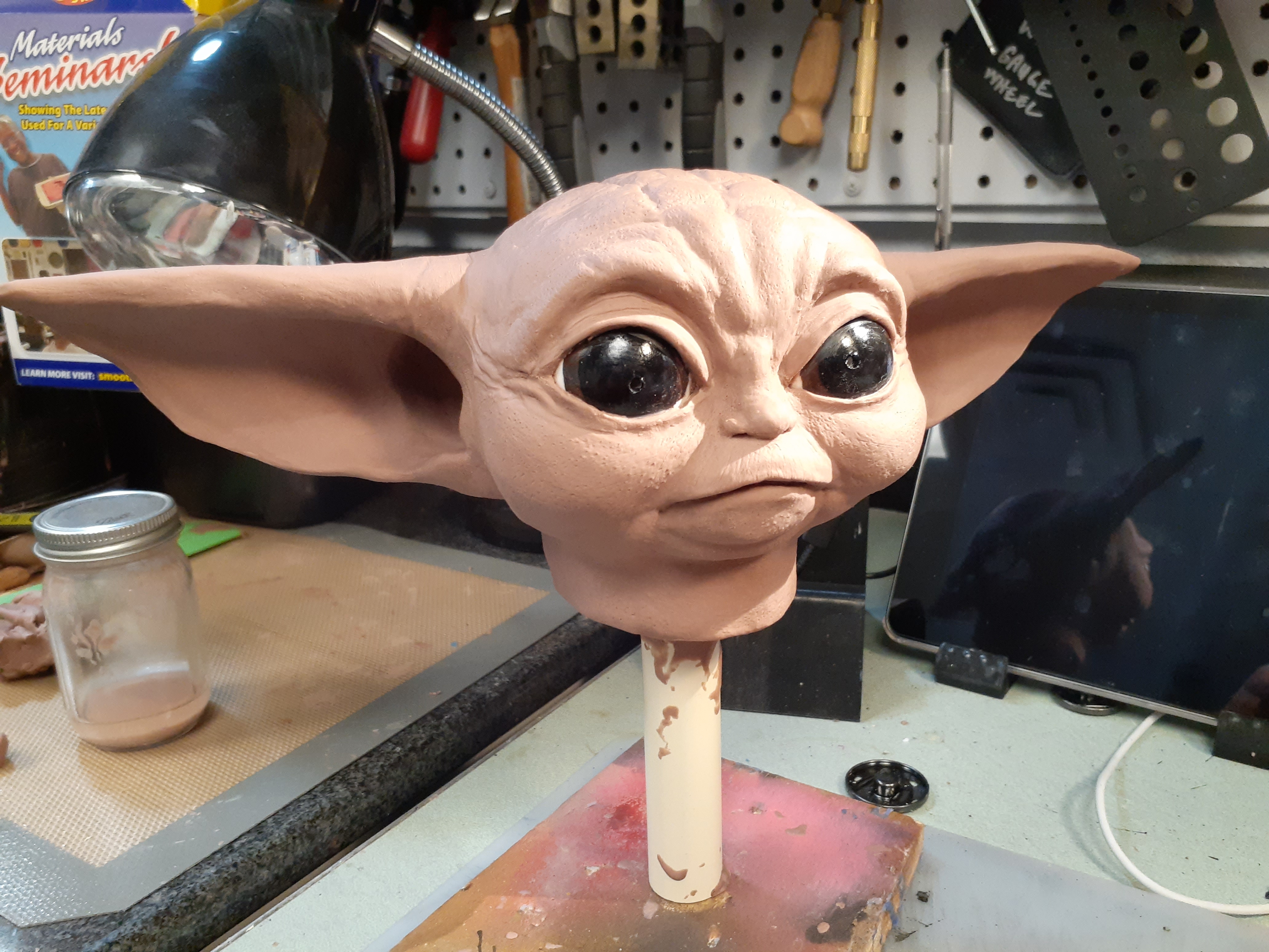

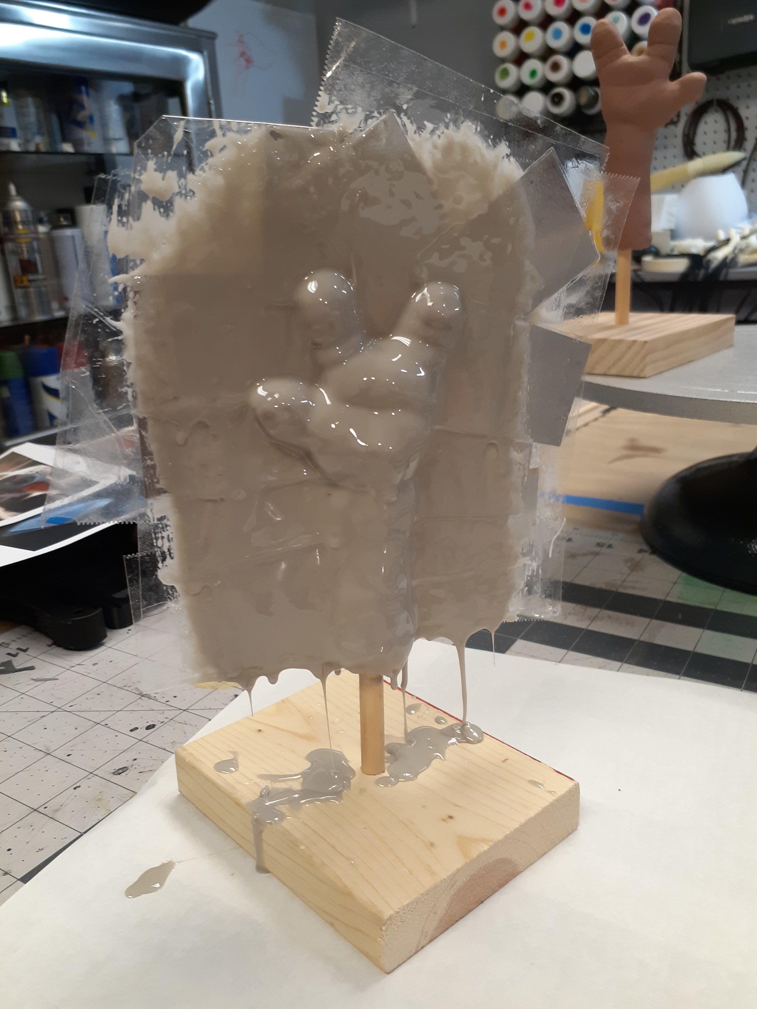

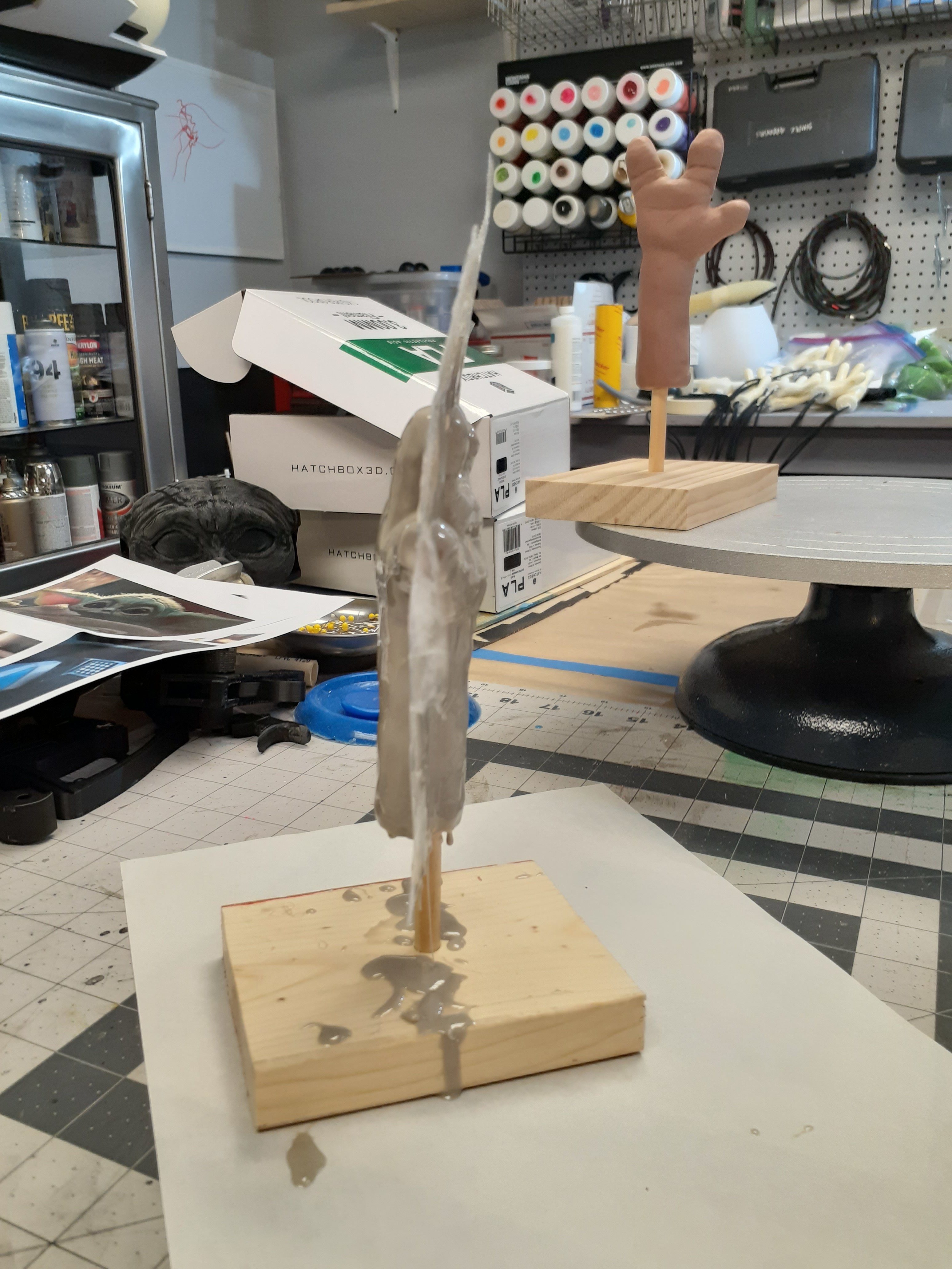

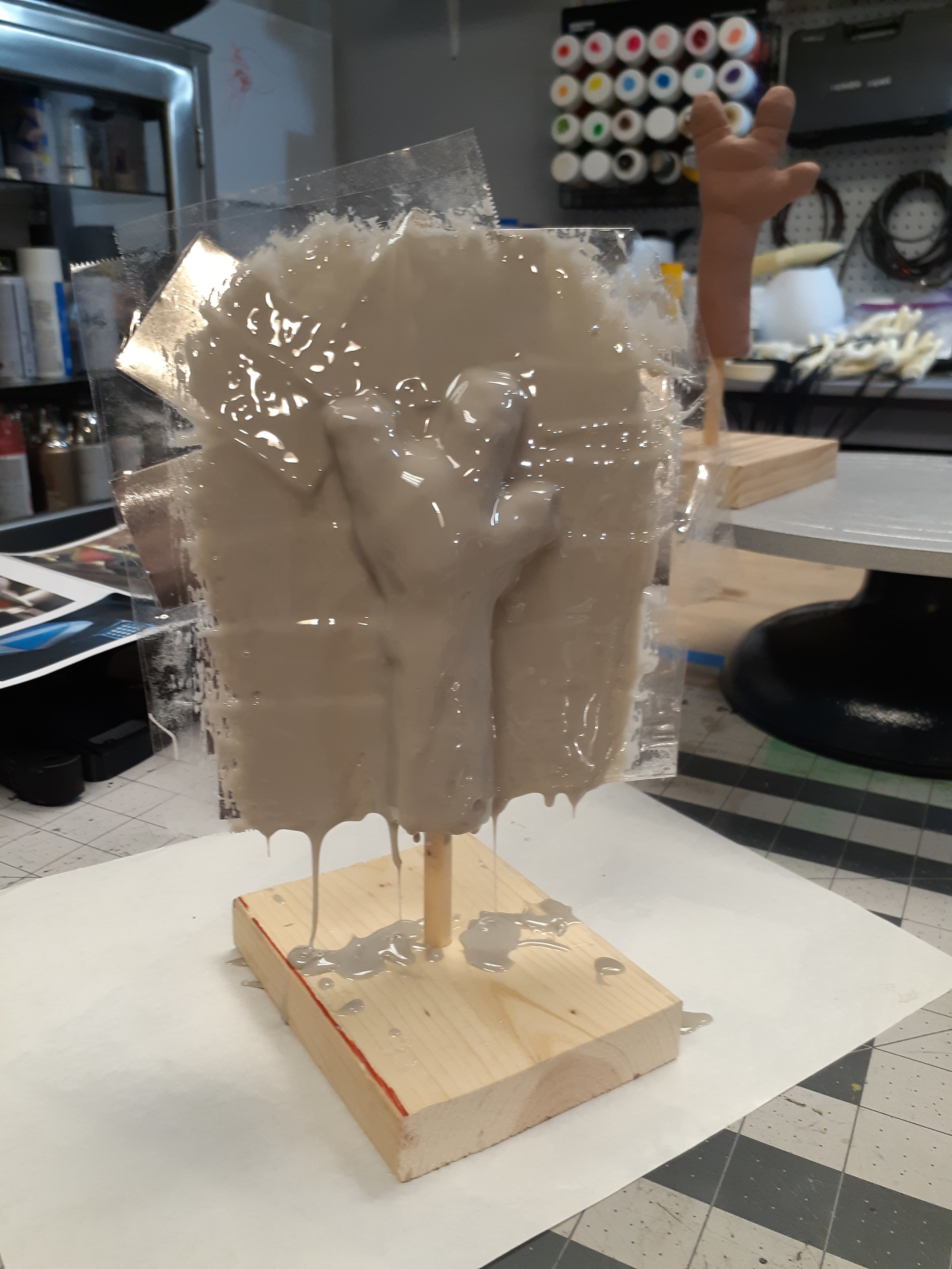

Did a little more tweaking to the lips, now it feels about 98%. Starting molding the left hand - aluminum sheet flashing for the part line, and Shell Shock Slow for the print coat and 2nd layer. 3rd layer will be Plasti-paste, then once it's all cured, time to demold and see how it went....

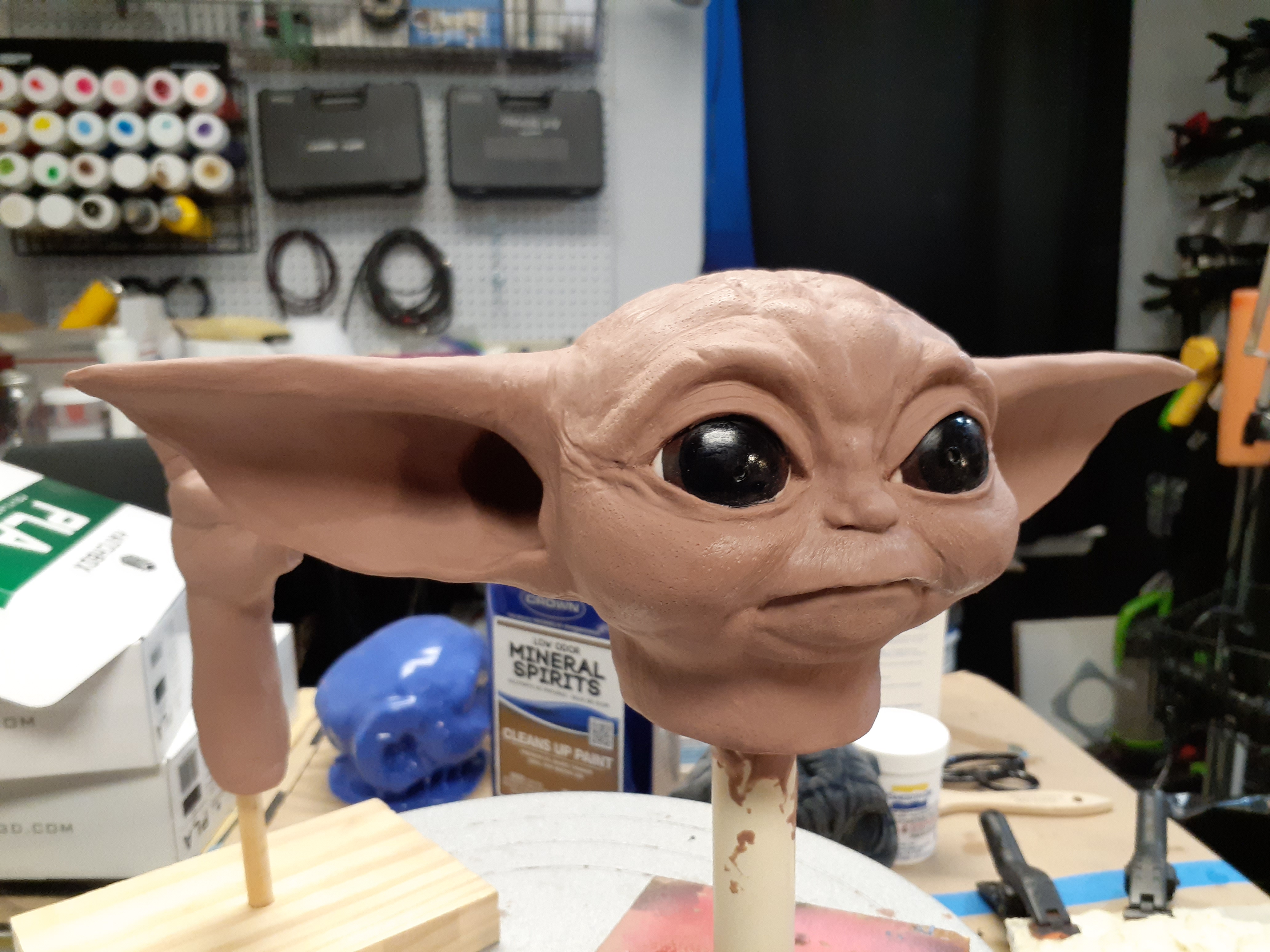

It is looking really good. I think that his mouth may still be a little too big and stick out a little too far. Looking at the pictures of the real animatronic, it seems to be smaller.
Heres a better pic, I've been referrencing this screen grab of the puppet to try and shave in the shape of the lip, the top seems to stick out a bit more than the bottom on the animatronic. Thoughts?

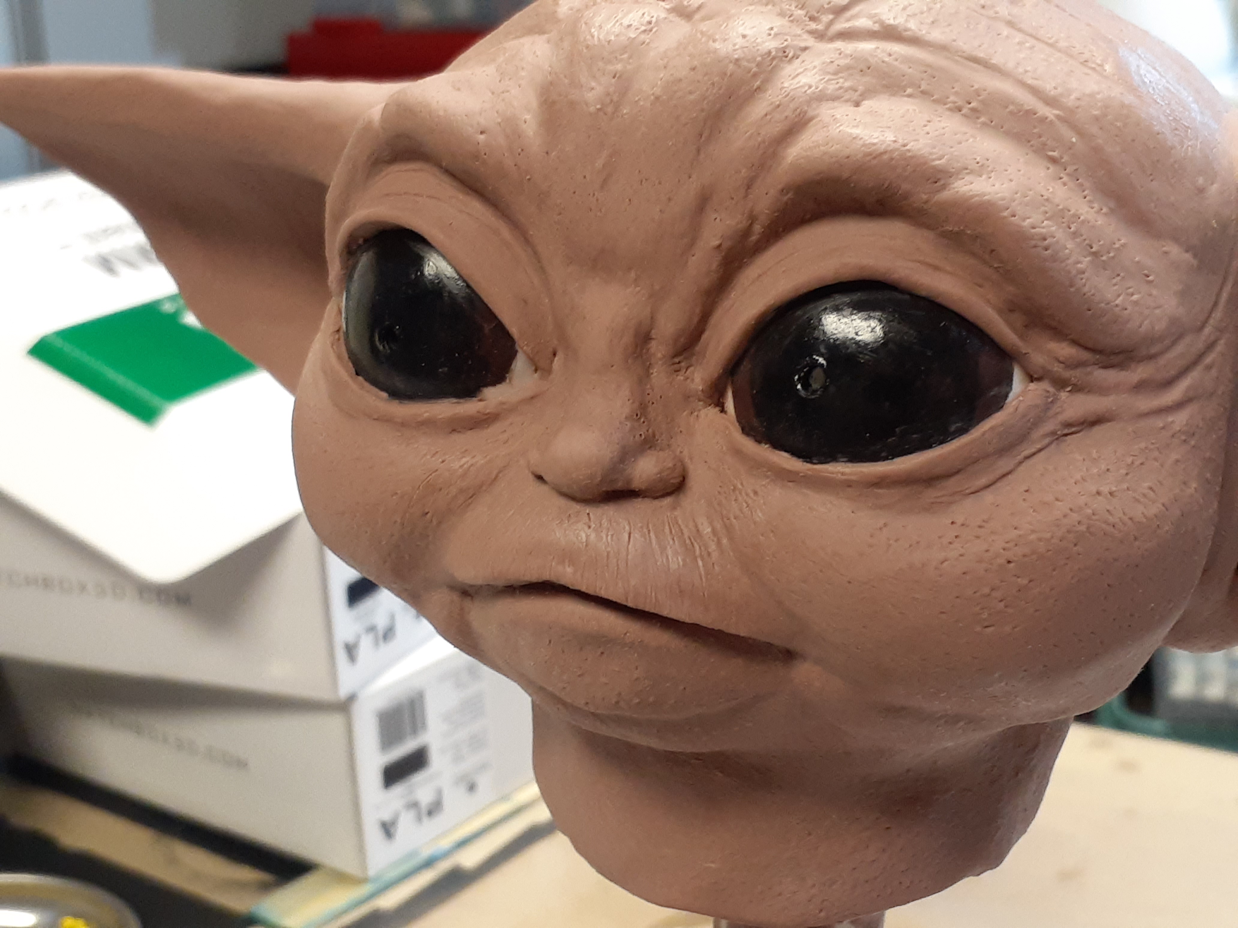

Biggest thing I am seeing is that it looks like your upper lip comes to a peak in the middle. But in the model I am only seeing it be rounded.
Also take a look at the corners of the mouth and the shapes they make. And the rounded shape of the laugh lines when they come off the nose.

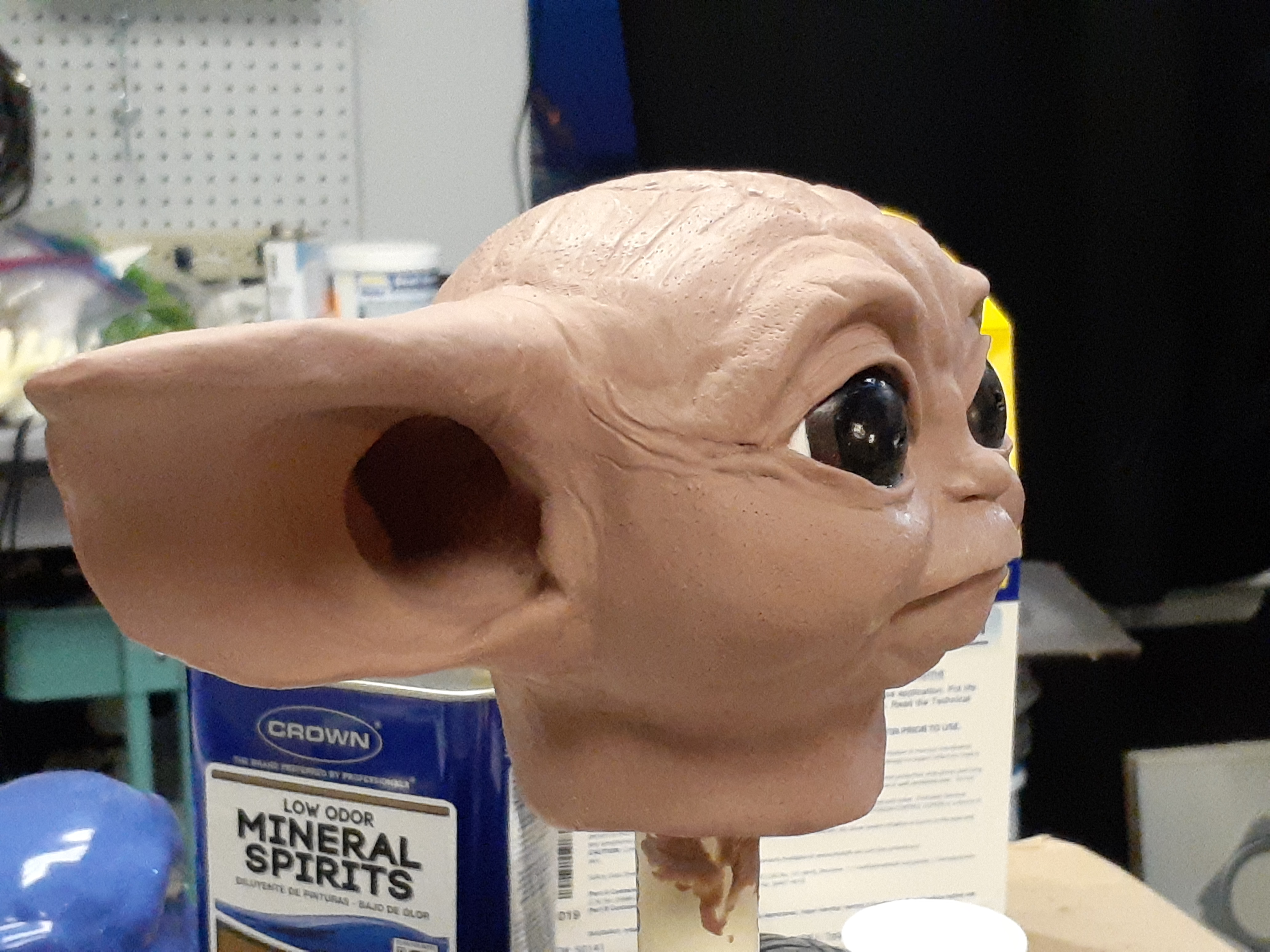

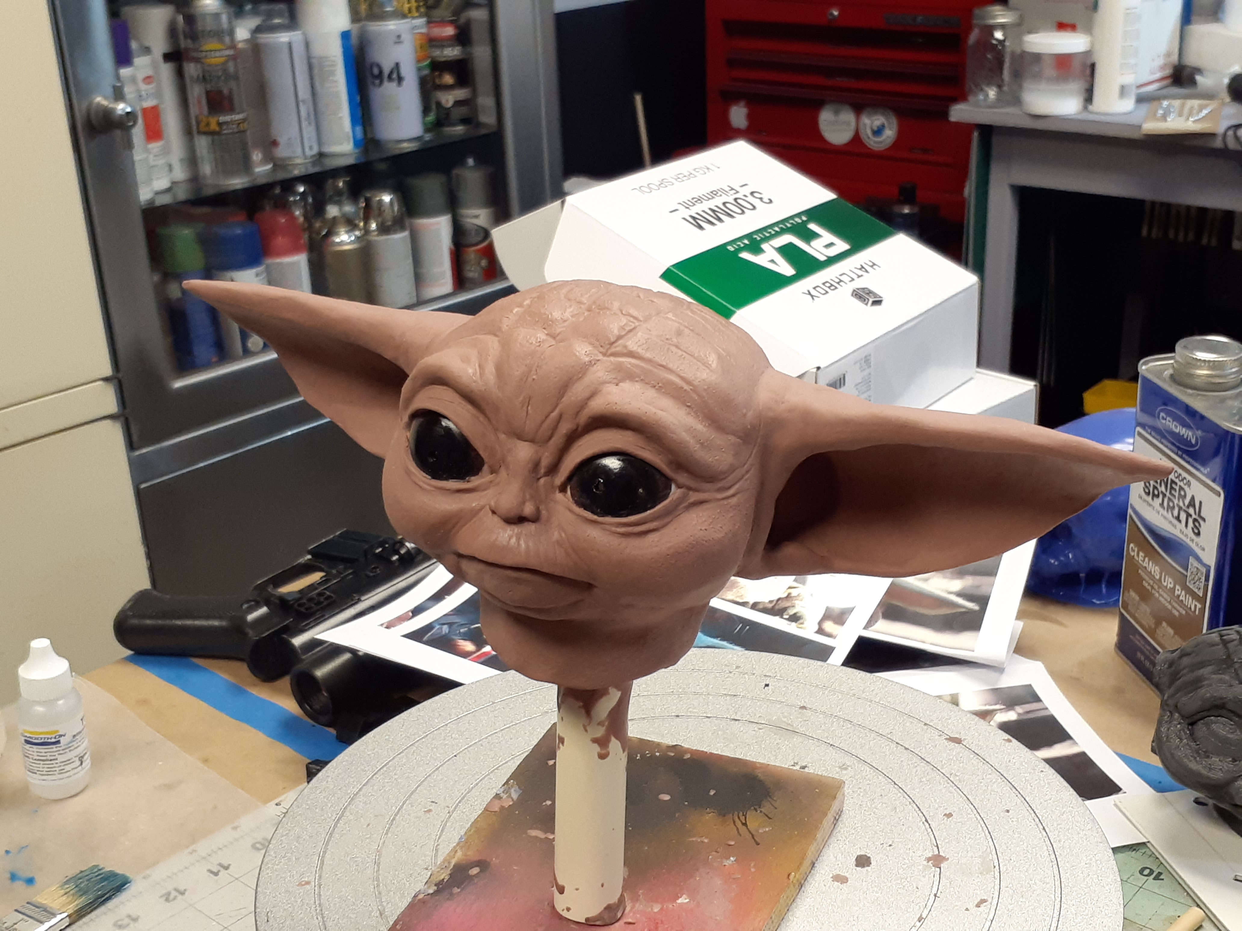

Alright, revised the lip more, I think I'm at the stopping point (otherwise I'll be sculpting away forever, ha ha). He looks really close I think. Now to consider approaches to molding him. I'm planning on doing a hard urethane mold so I can run silicon, though the test on the hand didn't go well, partially because I used some old PlastiPaste that was a bit off and cured too brittle, and the shim method on this little hands proved to be too much. So I'm going to do a traditional plastaline part line, brush up one side to thickness using several coats of 65D, then remove the plastaline and do the mated side. Fingers crossed....
