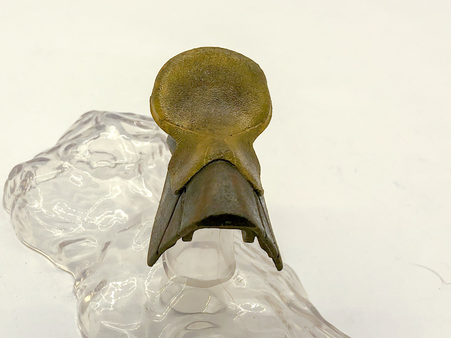

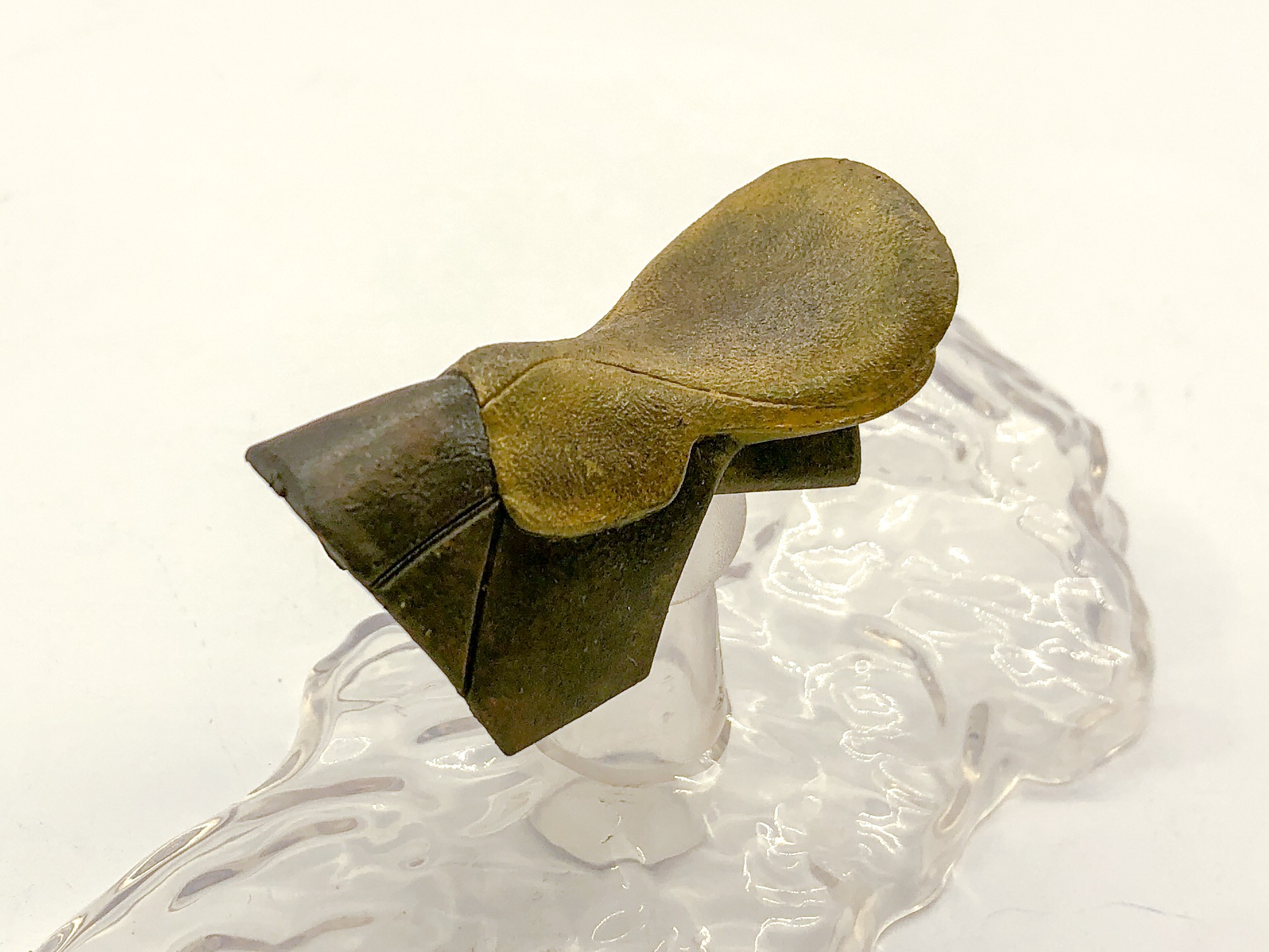

I use oils to get a leather look. Here's a seat I did for my Rey's Speeder repaint:
20190129_010656440_iOS.jpg 20190129_010711604_iOS.jpg 20190129_010719735_iOS.jpg

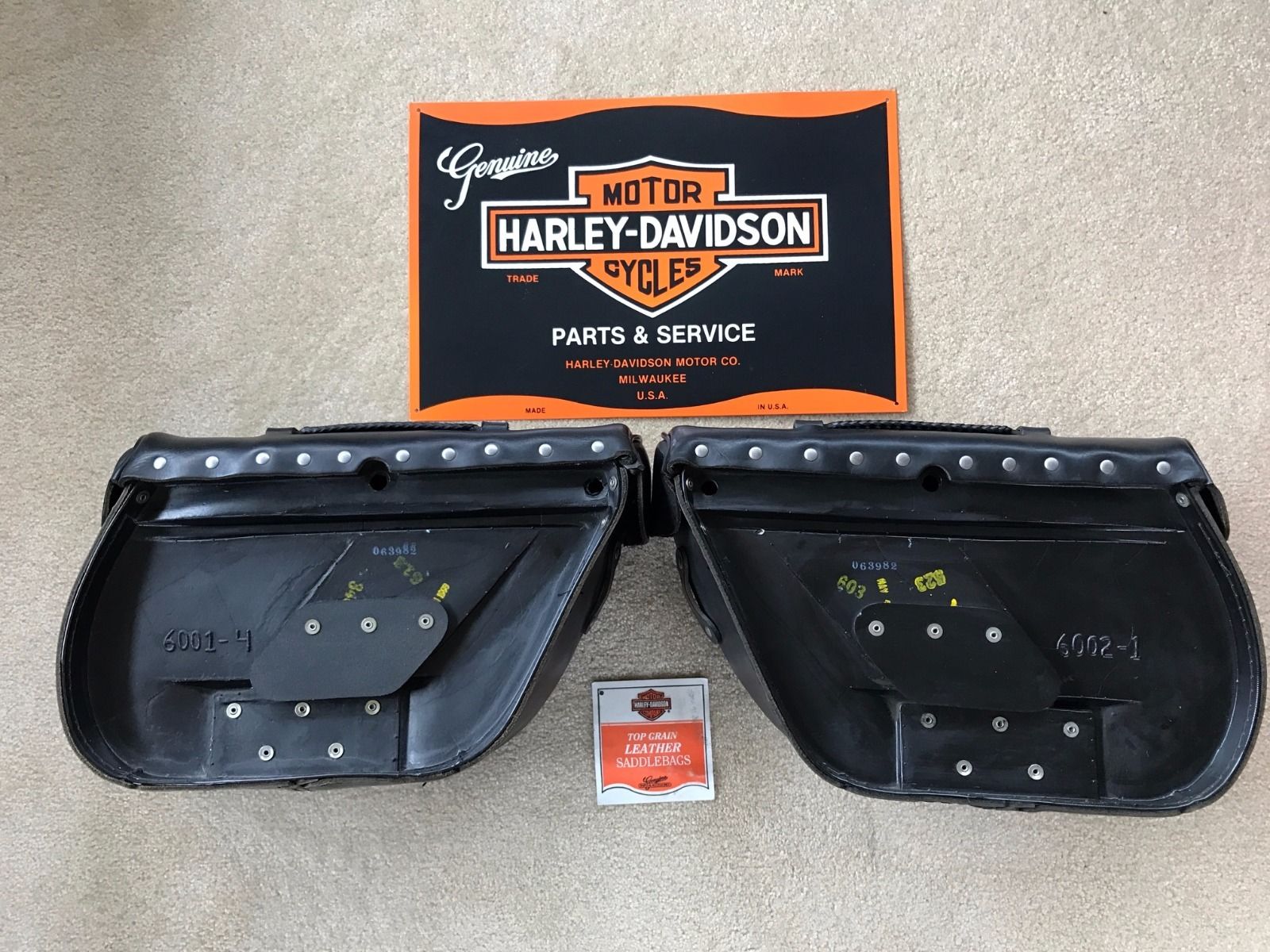

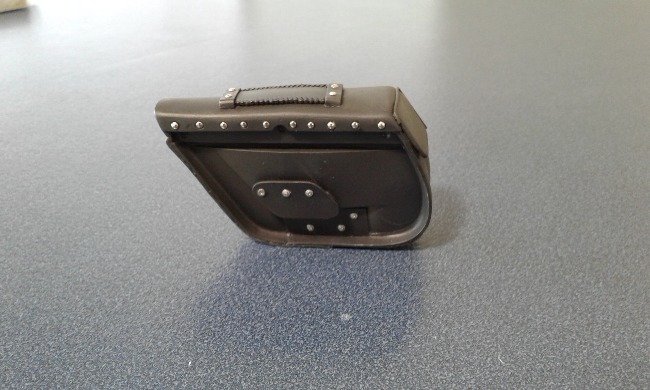

Saddlebag (mounting side) painted up. The quality of detailing is average as it won't be seen in the final assembly. This is a painting test using satin black enamel base, green/grey enamel washes (airbrushed on) and some eye make-up for shading/highlighting. Note that the inner surface on the real saddlebag is plastic, not leather.
I've included a shot of the full size saddlebag for comparative purposes.

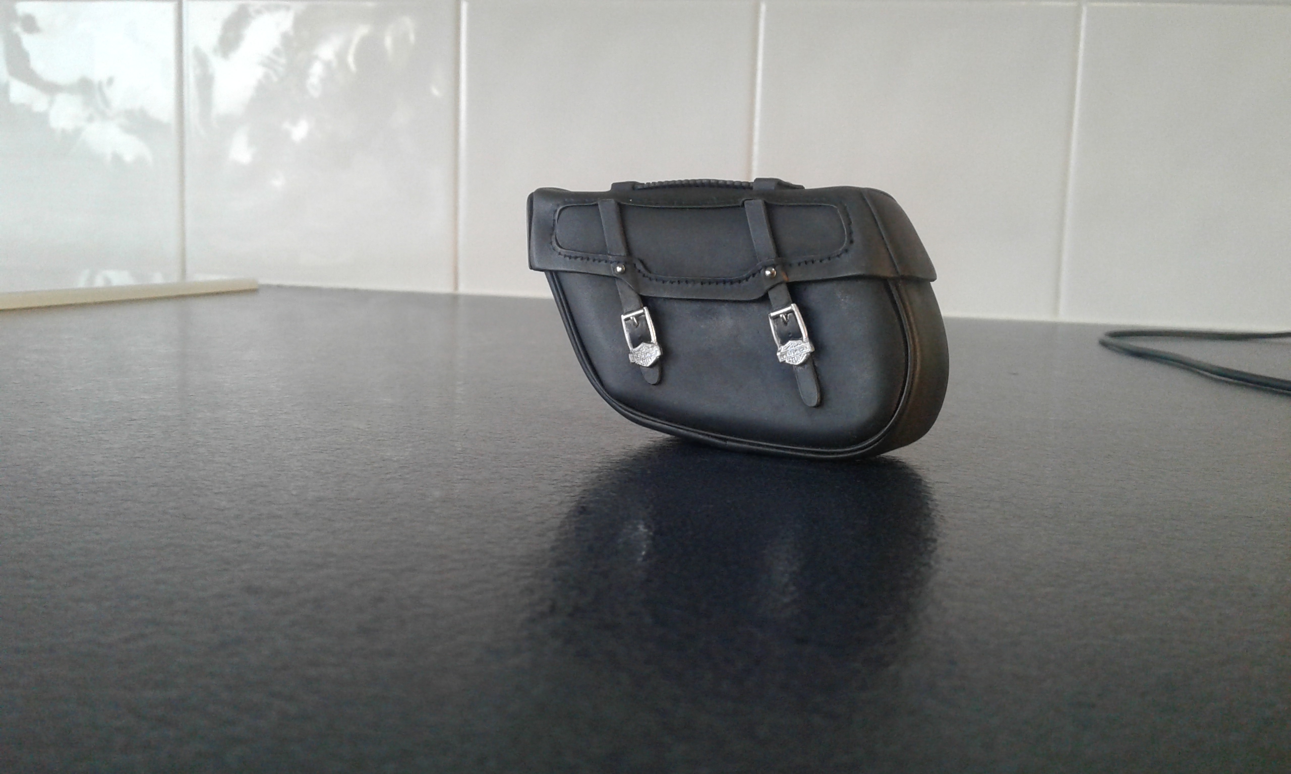

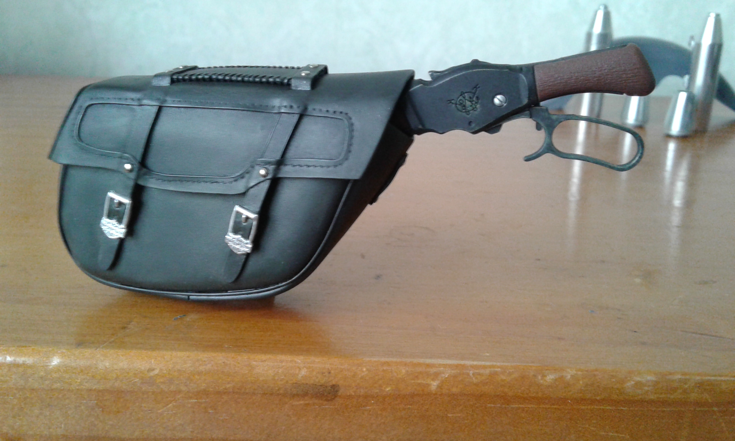

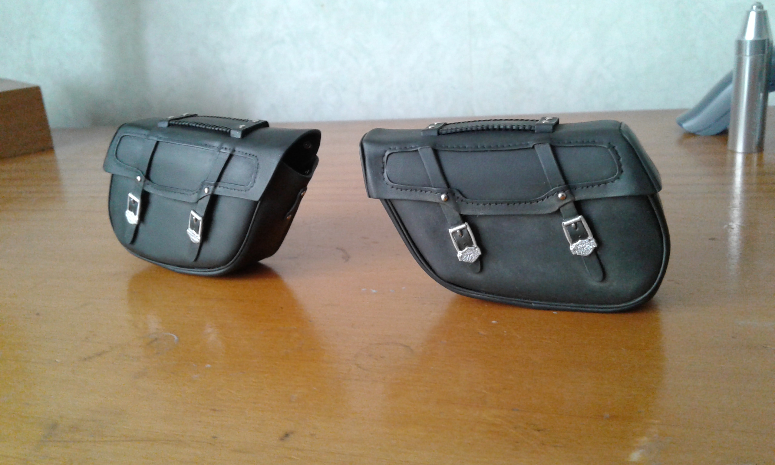

Both saddle-bags finished. And the Hot Toys sawn-off shotgun fits inside the customized saddle-bag and sits up at the right angle.

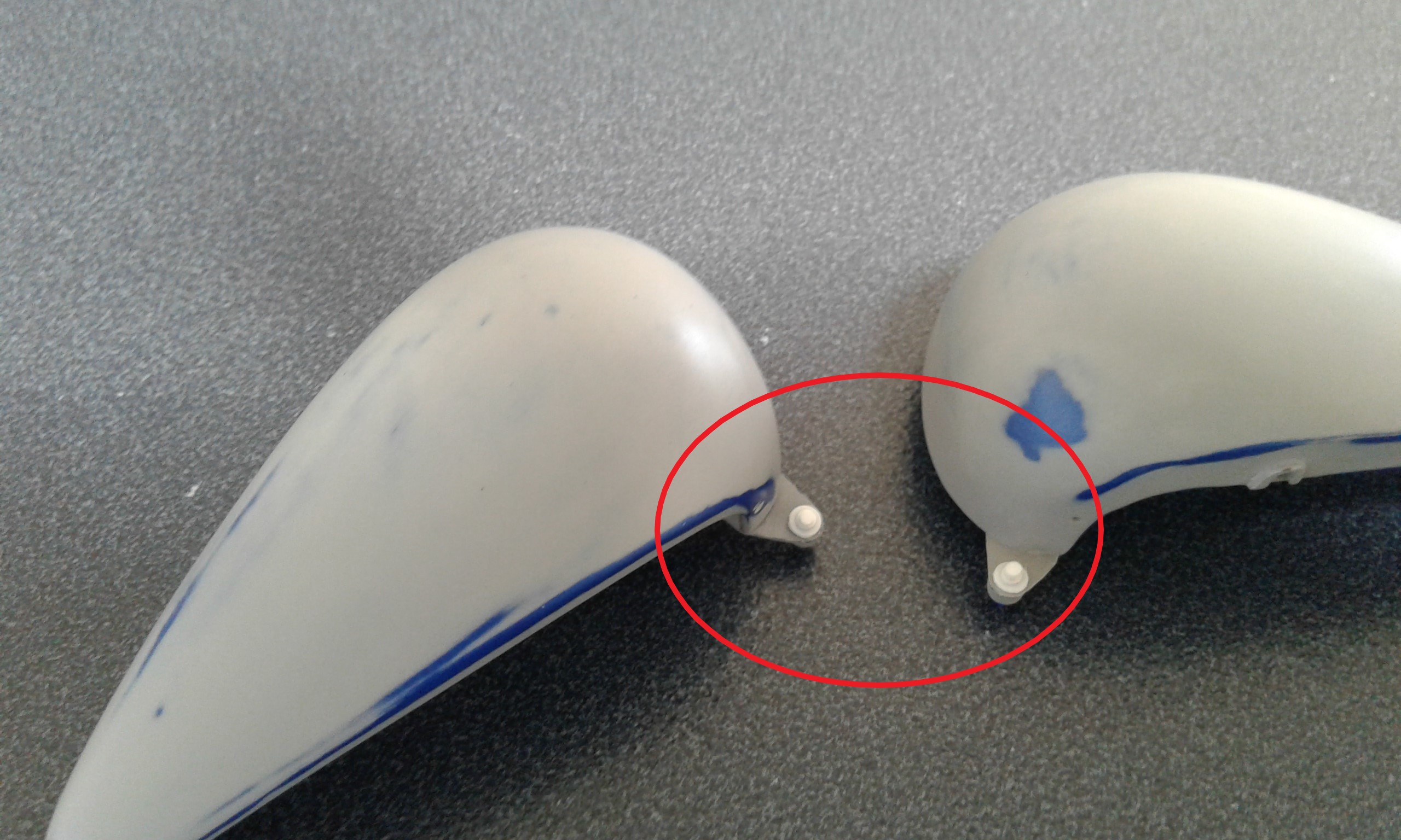

Gas tanks and front fender sprayed gloss black. The gas tank finish came straight out of the Tamiya ts14 can. Amazingly good finish from a spray can. Unfortunately lightning wouldn't strike twice when it came to the fender paint jobs. These I had to work at...spray, sand polish, then a light spray of highly thinned paint and some final polishing.
The rear fender is still a work in progress...

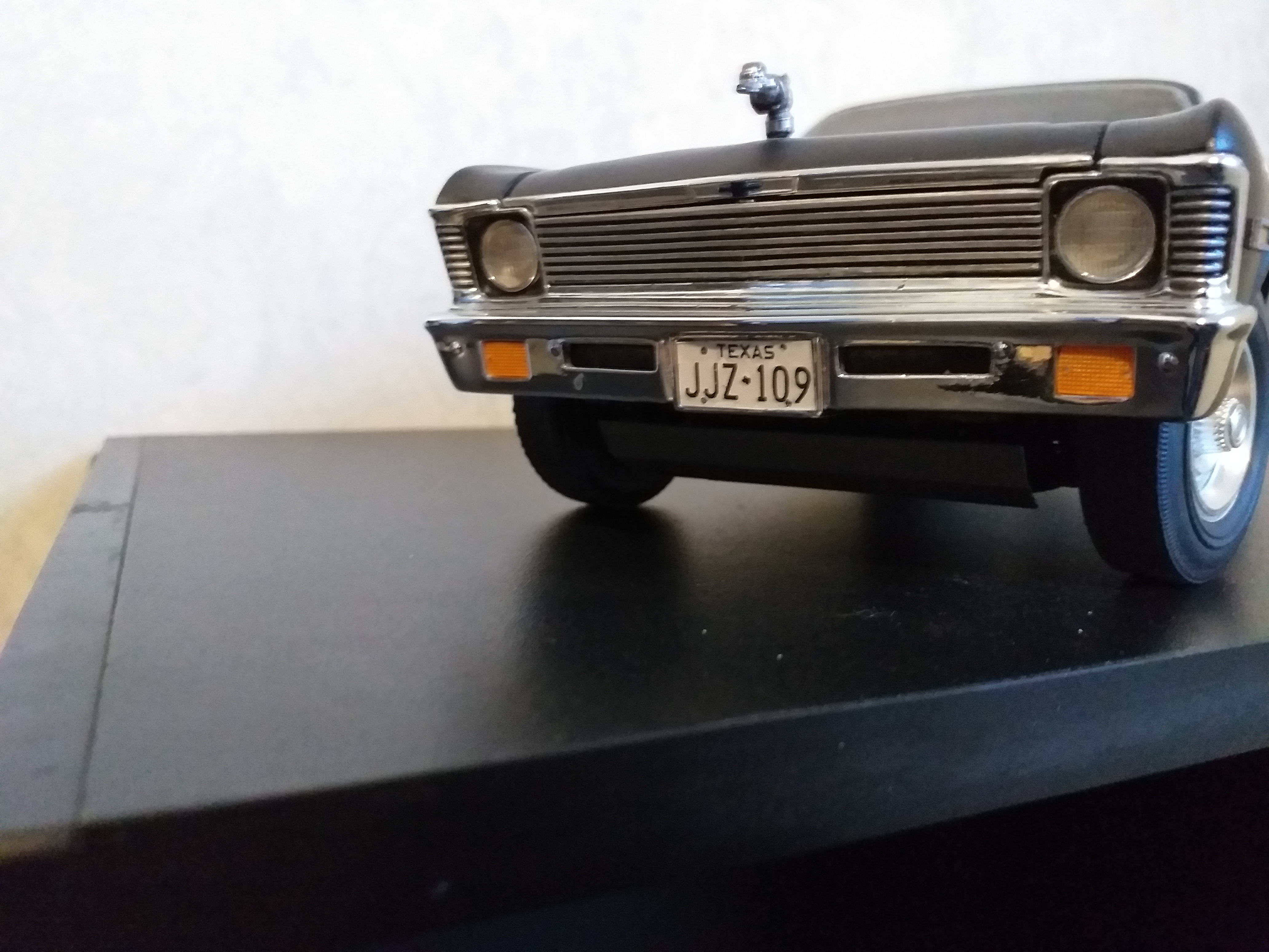

Totally unrelated but drawing on my photo-etching experience developed during this build. While I wait for some things to come together (decal related) I decided to replace the license plates on my 1/24th scale Chevy Nova from the film "Deathproof". If you've seen my earlier posts of that build, the plates needed work.
1. Find a good reference photo, 2. laser print onto transparency and iron the laser ink onto a piece of brass sheet. 3. Photo etch the brass sheet. 4. emboss a piece of aluminium oven tray onto the brass photo etch to make an actual embossed license plate. 5. Print a decal of the license plate on white decal paper and apply.

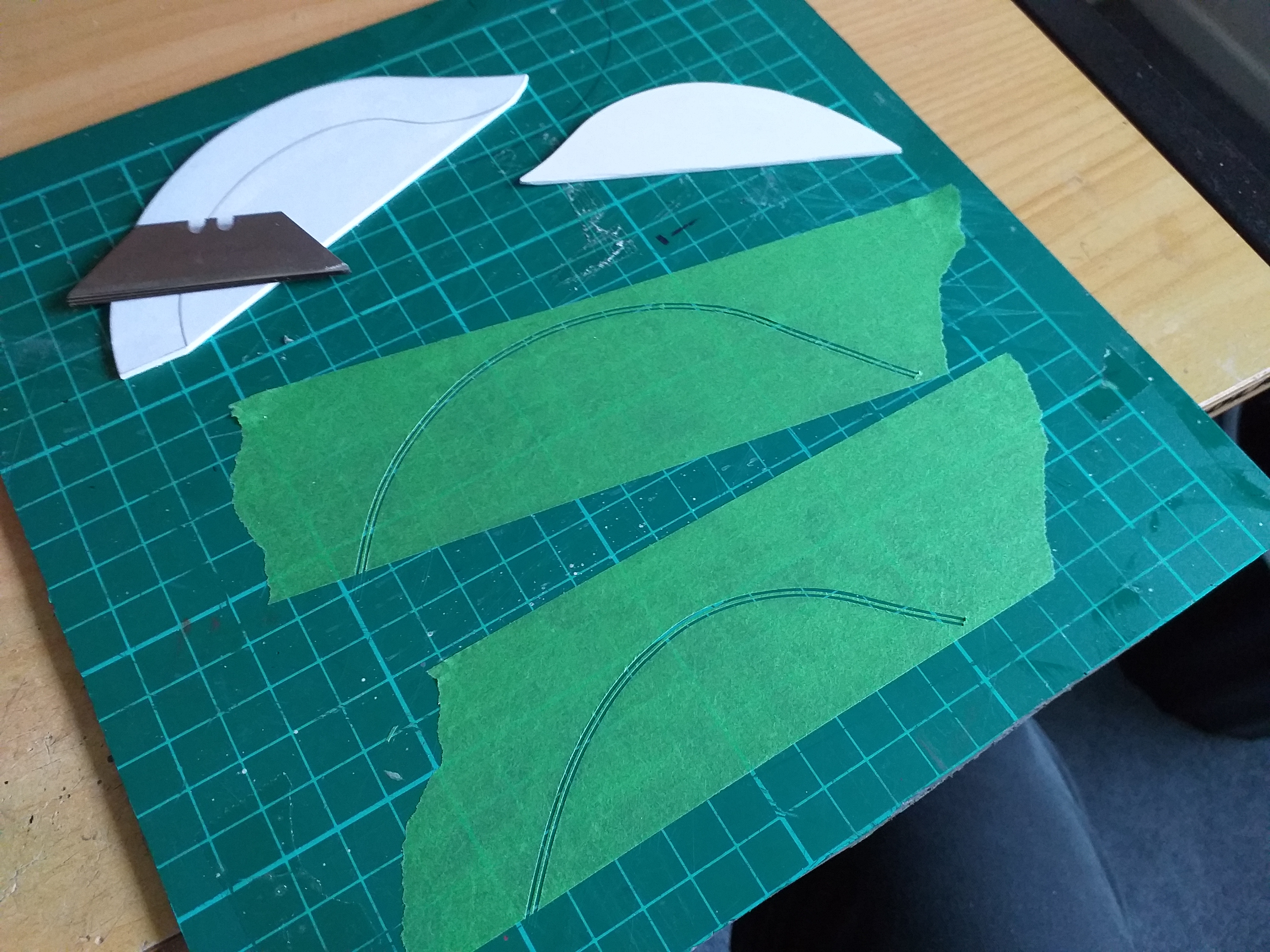

Hey Terminator! Here is a shot of my test-cutting pinstripe masks using the most primitive option: 4 Stanley blades held side by side!
I've looked at wet and dry transfers; I doubt from the lack of response to my inquiries that craft and signwriter cutting machines can cut 0.5mm wide pinstripes in a curved pattern.

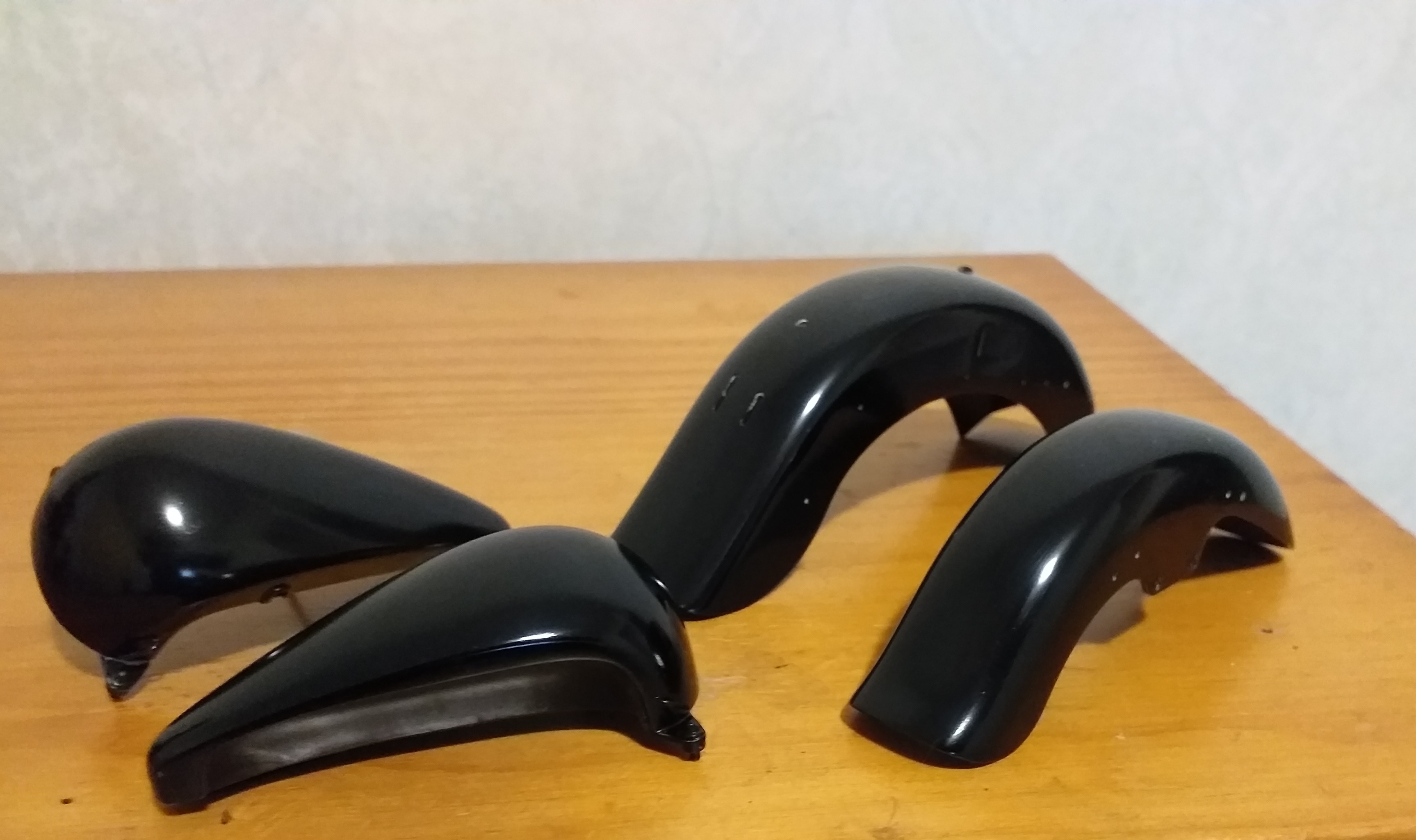

Fenders and gas tanks, painted with Tamiya TS14, then sanded and polished with a combination of non-scratch ceramic stove top cleaner, followed by Meguiars Scratch X2.0 and Tamiya finish polishing compound.
