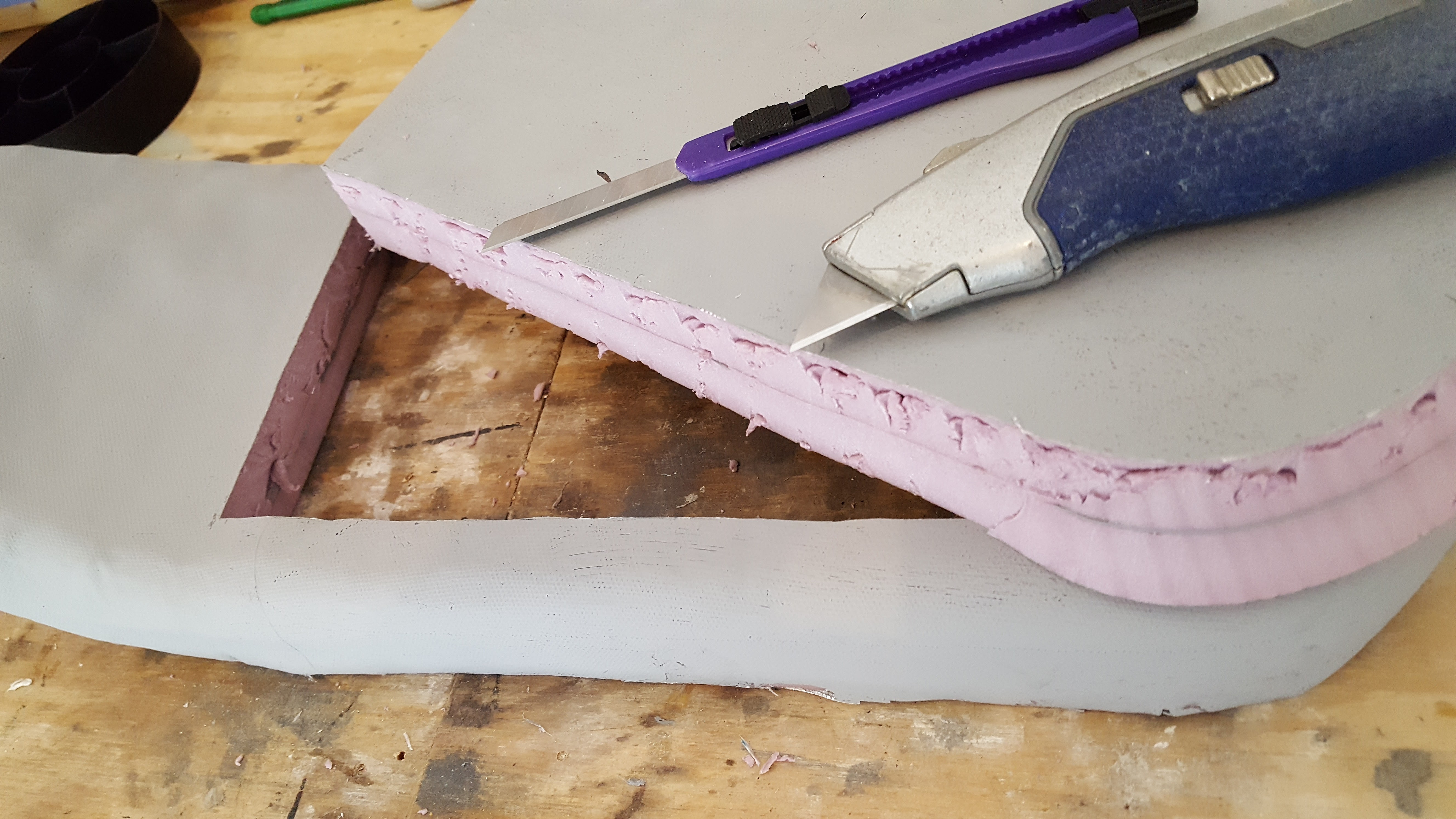

Taking the original foam seat I carved, I fiberglassed the seat to give it some rigidity and did something I'd not yet ever done with fiberglass. I refrained from filling the weave with filler and let the original fabric weave show through. I think it looks fantastic! I started by priming the seat for better paint adherence and then traced a line where the recessed panels will go:
Trim out the center panel. Incidentally, when cutting foamed fiberglass, I use a heavy-utility knife to cut through the fiberglass shell, and then follow the same cut with a rectractable hobby knife for the depth of the foam. Makes for easy work!
