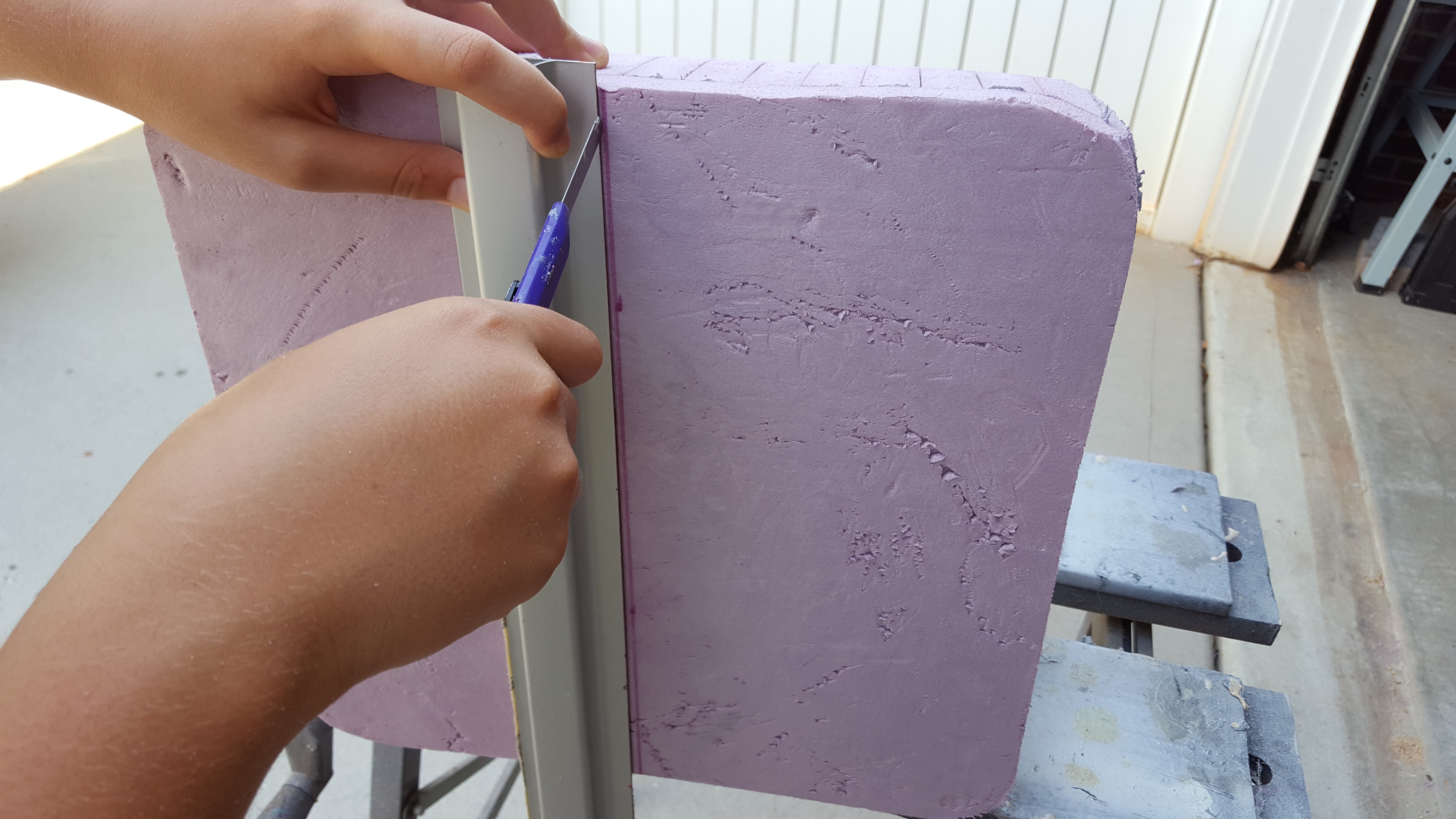

Installing the top deck comes next. the insets are built by cutting out the center panel and slightly lowering it and then regluing. Since it now hangs below the bottom, the center piece needs some slight shaving to sit flush.

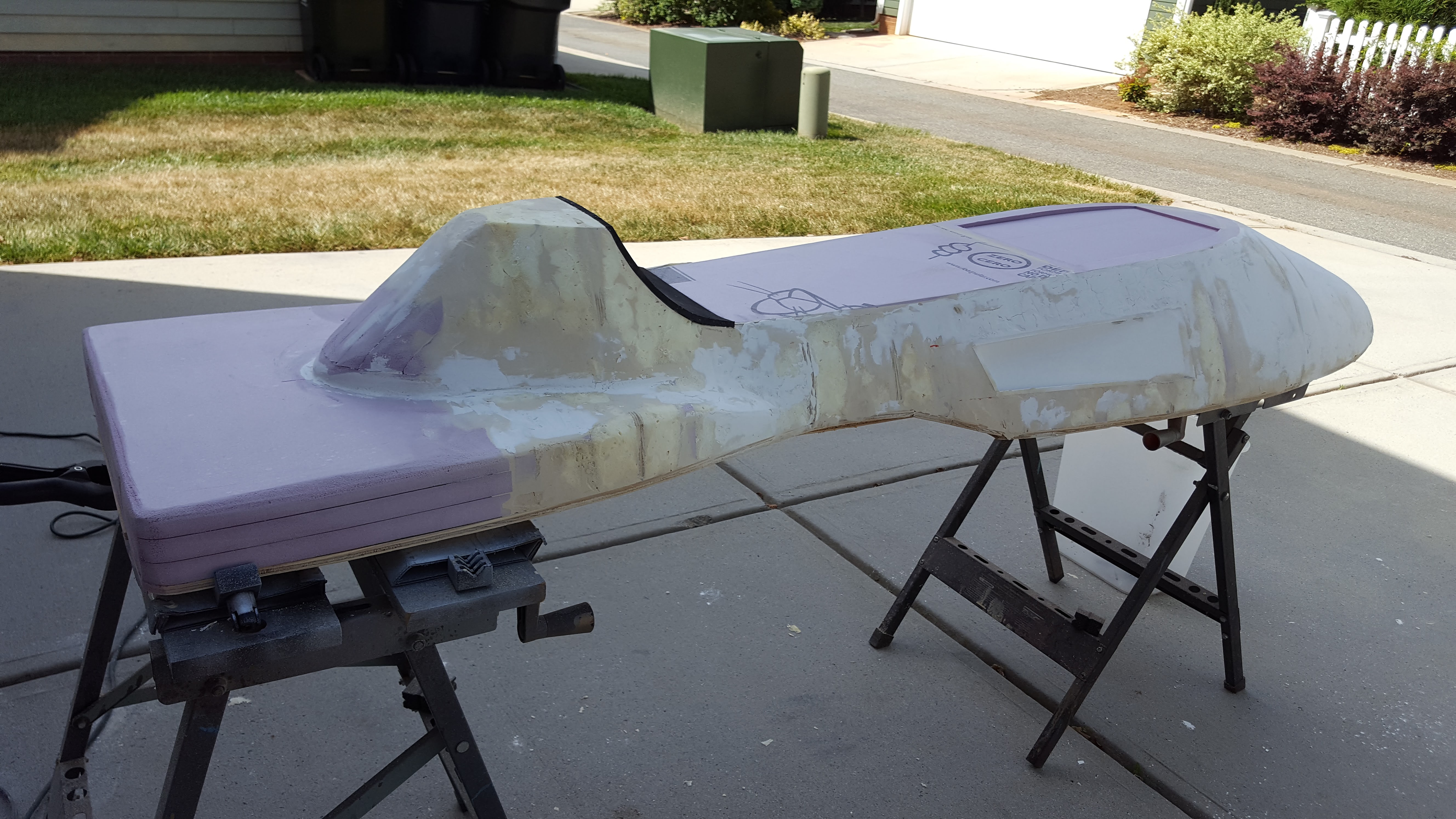

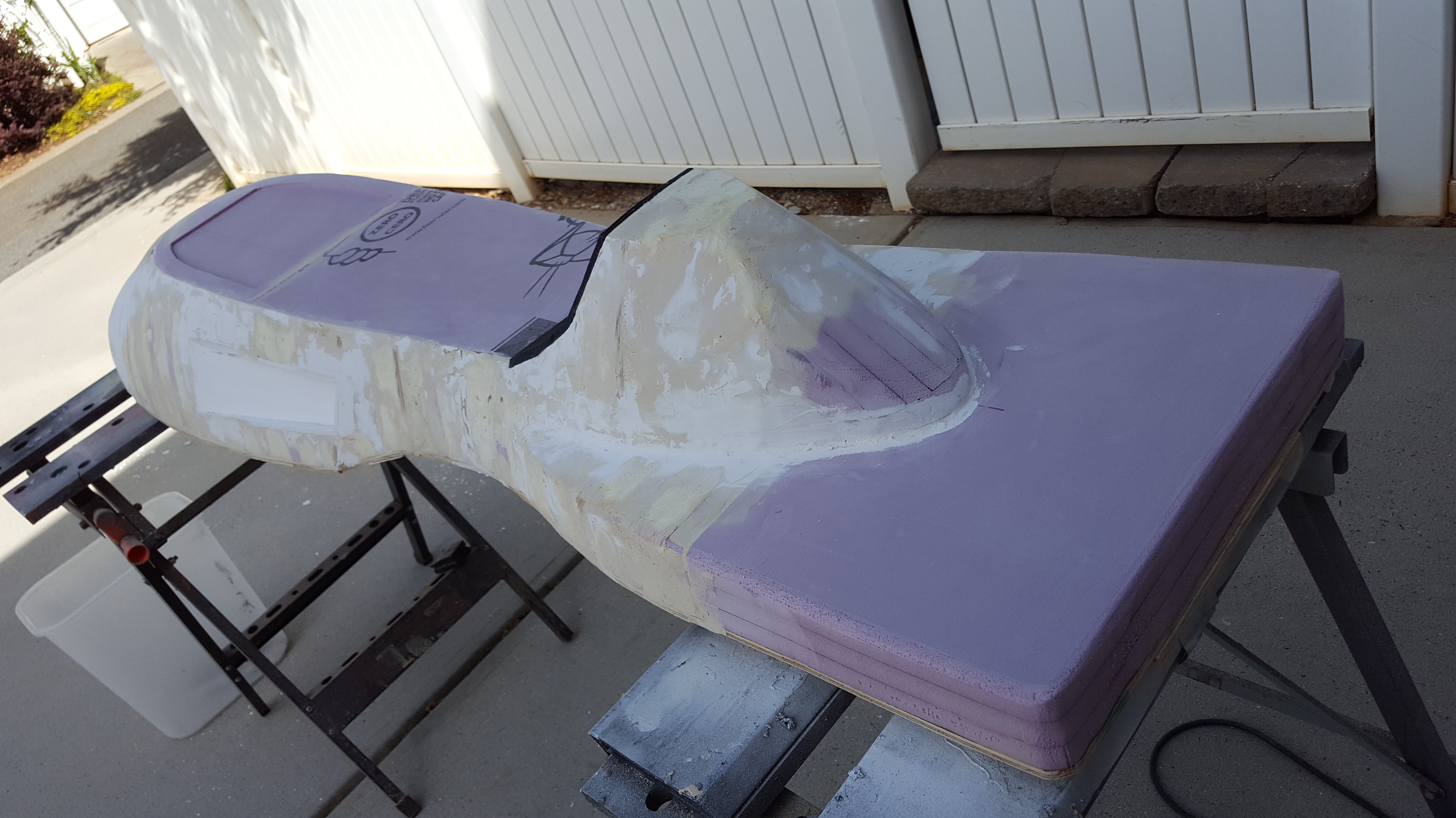

Sanding, sanding, and more sanding... The Sanding Speeder - errr, Speeder Bike is starting to take shape.
The edge of the top deck is also blended in with more putty at this stage.

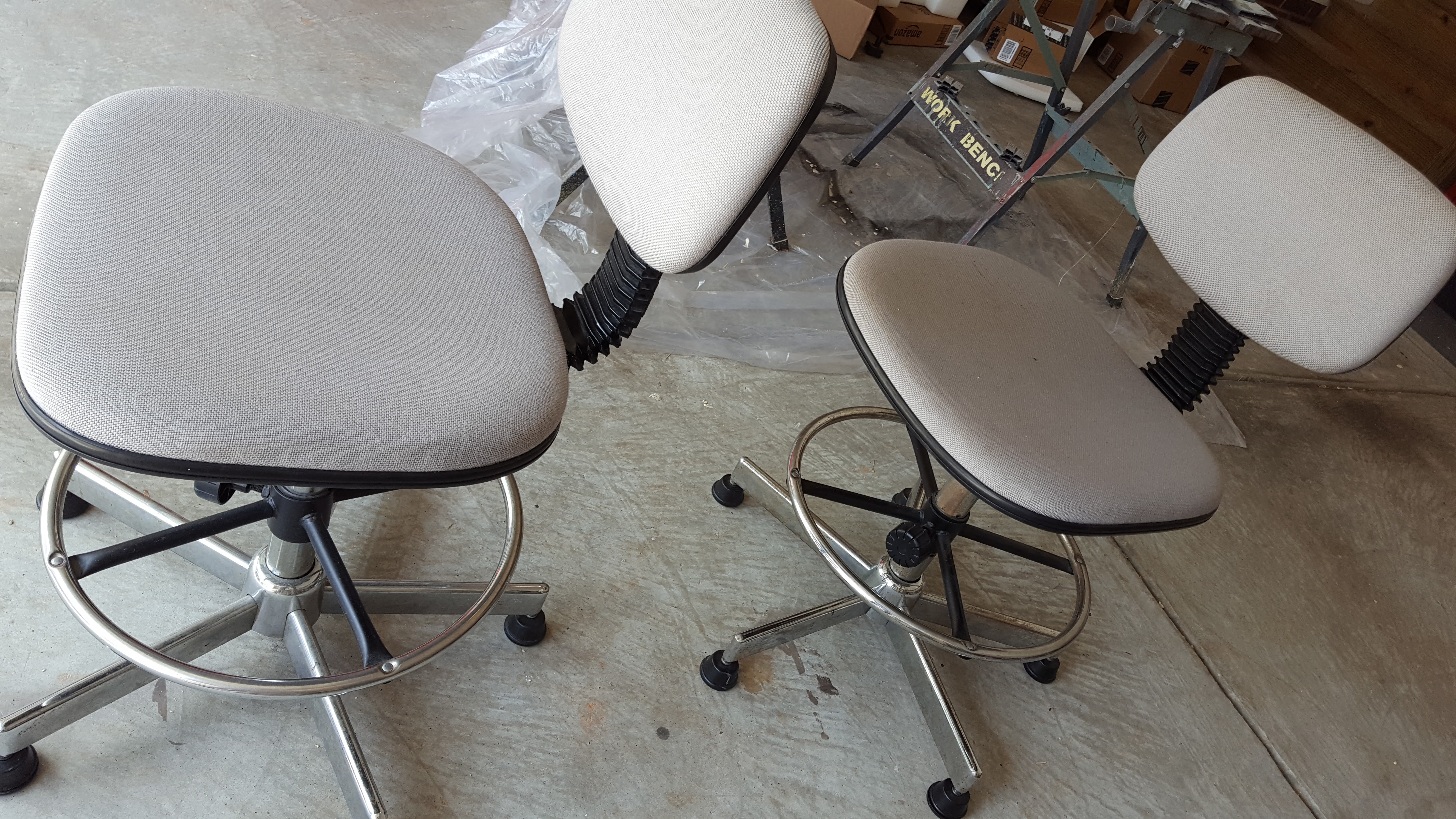

Picked up some spare parts at the second hand store for this build. We picked up these office chairs for $5 and will use the stands as the base for the speederbike and corrugated plastic sleeve as engine parts. Additionally, I picked up a some computer cable bundling tubes and plumbing parts for cheap as well.

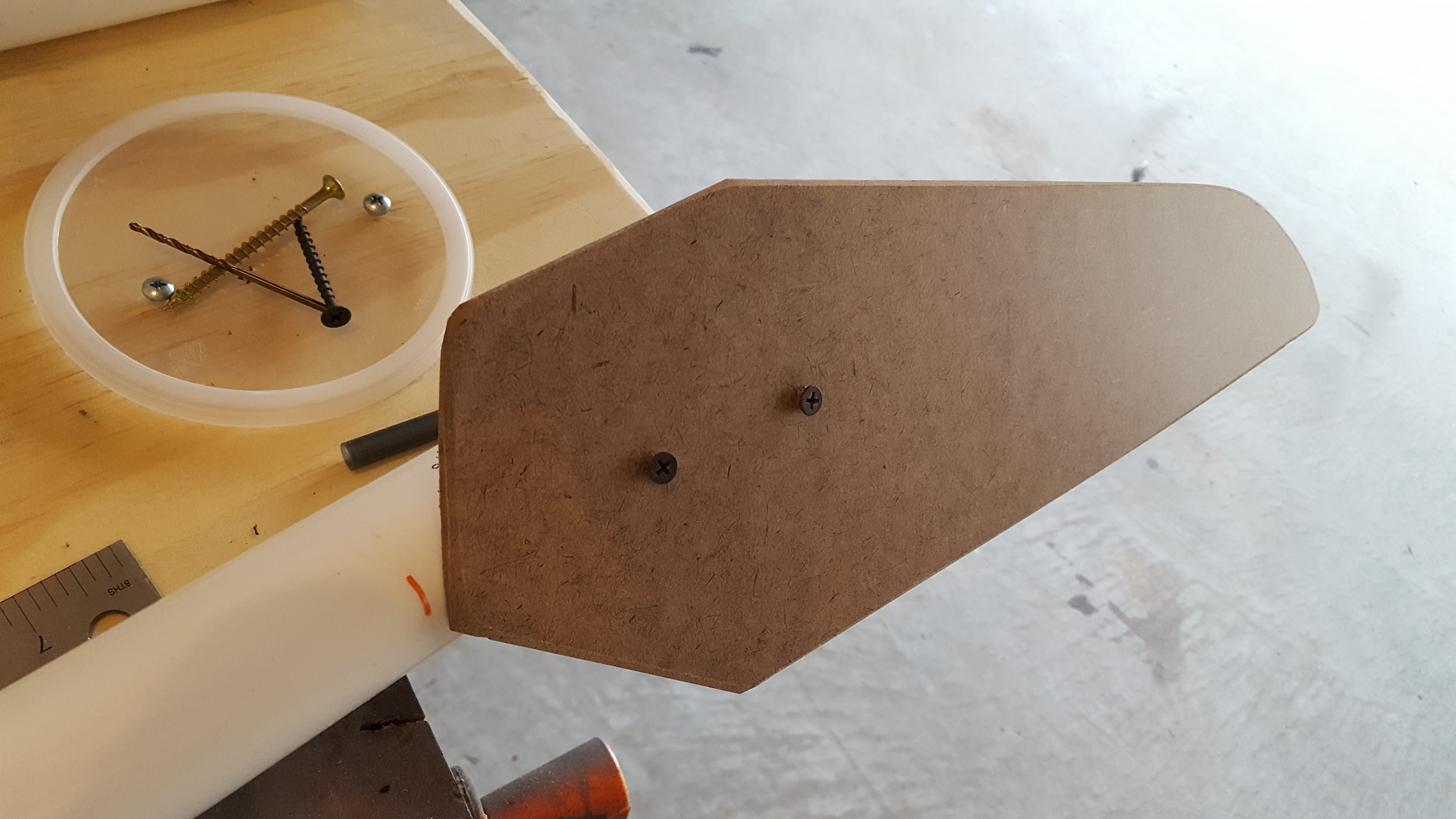

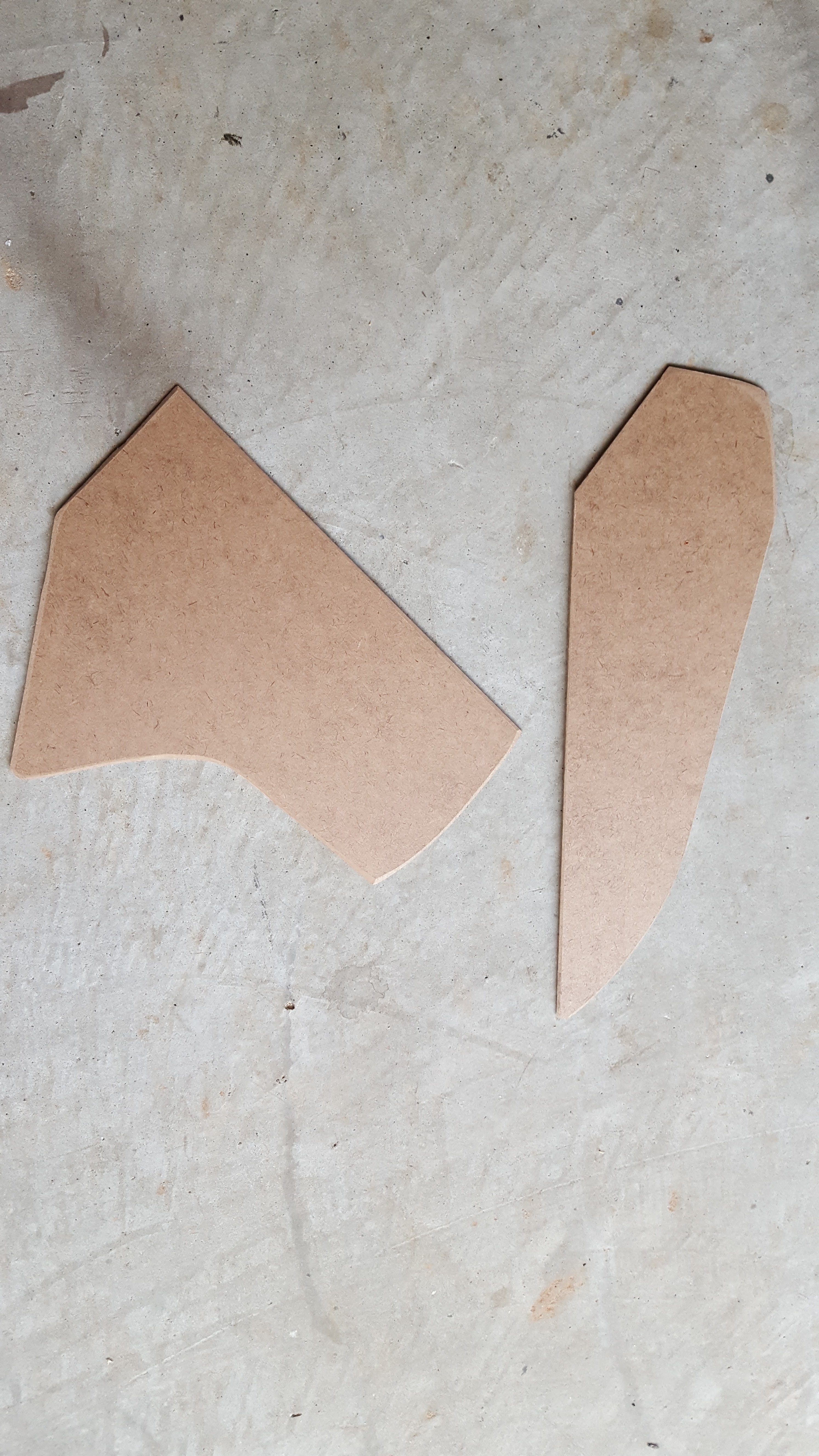

Using a sheet of masonite board, I projected some new patterns I drew up in order to maintain the scale profiles. Here are the front fins carved out with edges sanded.
