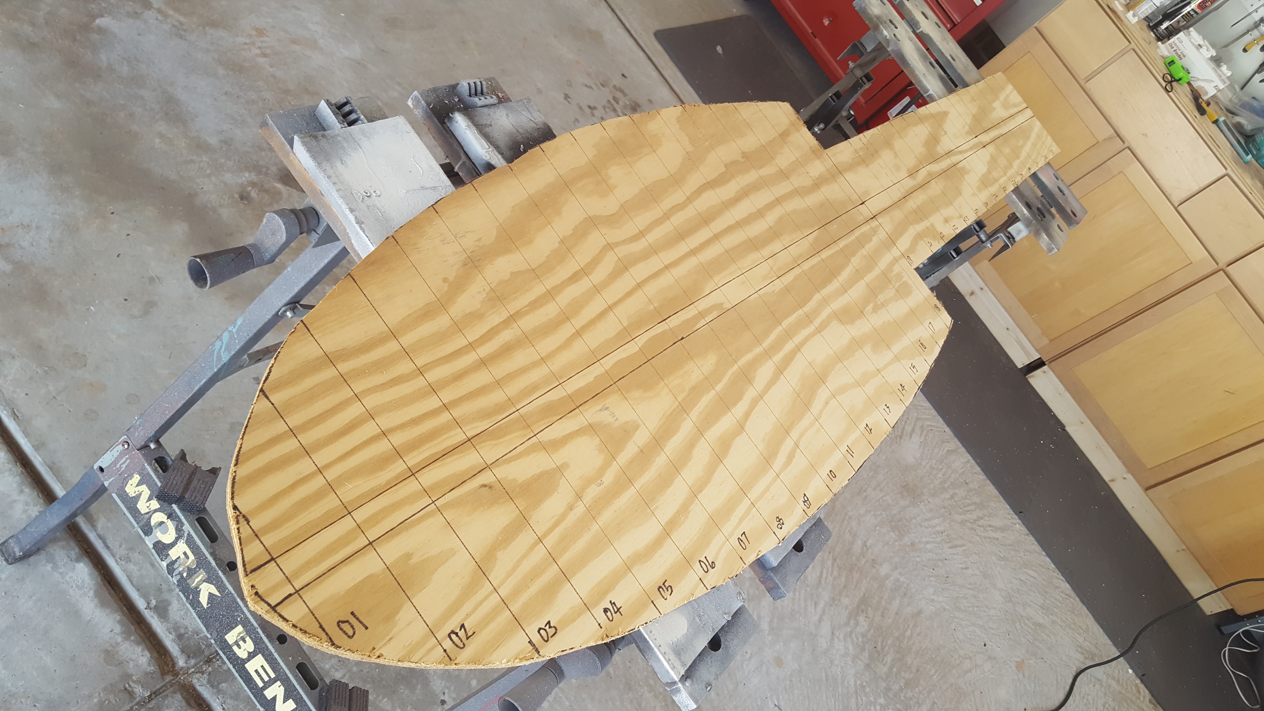

One of my more ambitious projects for the movie room and our Halloween event this year is a full-size speeder bike from ROTJ. My goal is to keep this project within a reasonable cost, lightweight and made out of simple materials and structure (i.e. wood/foam vs. aluminum/carbon).

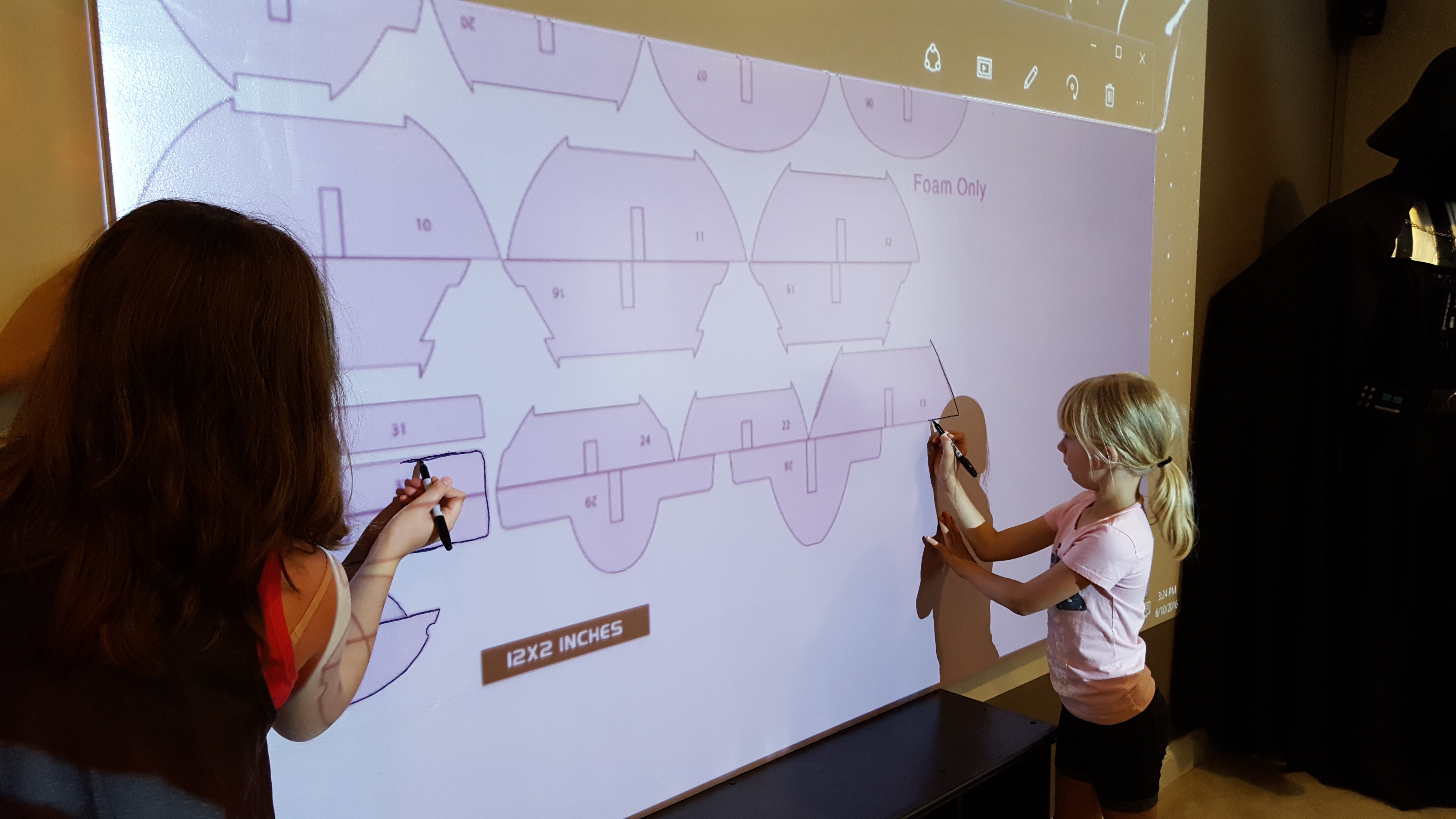

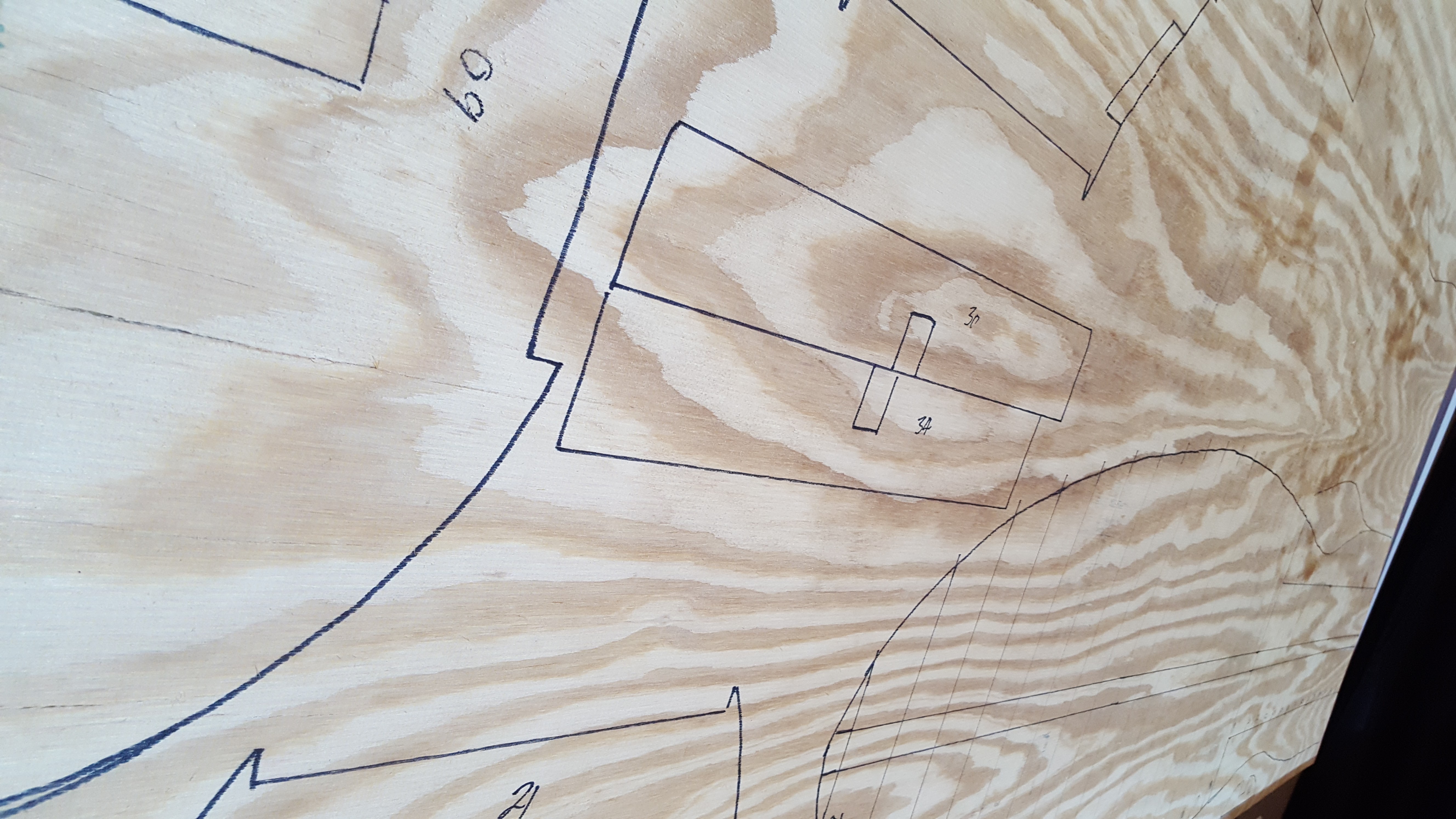

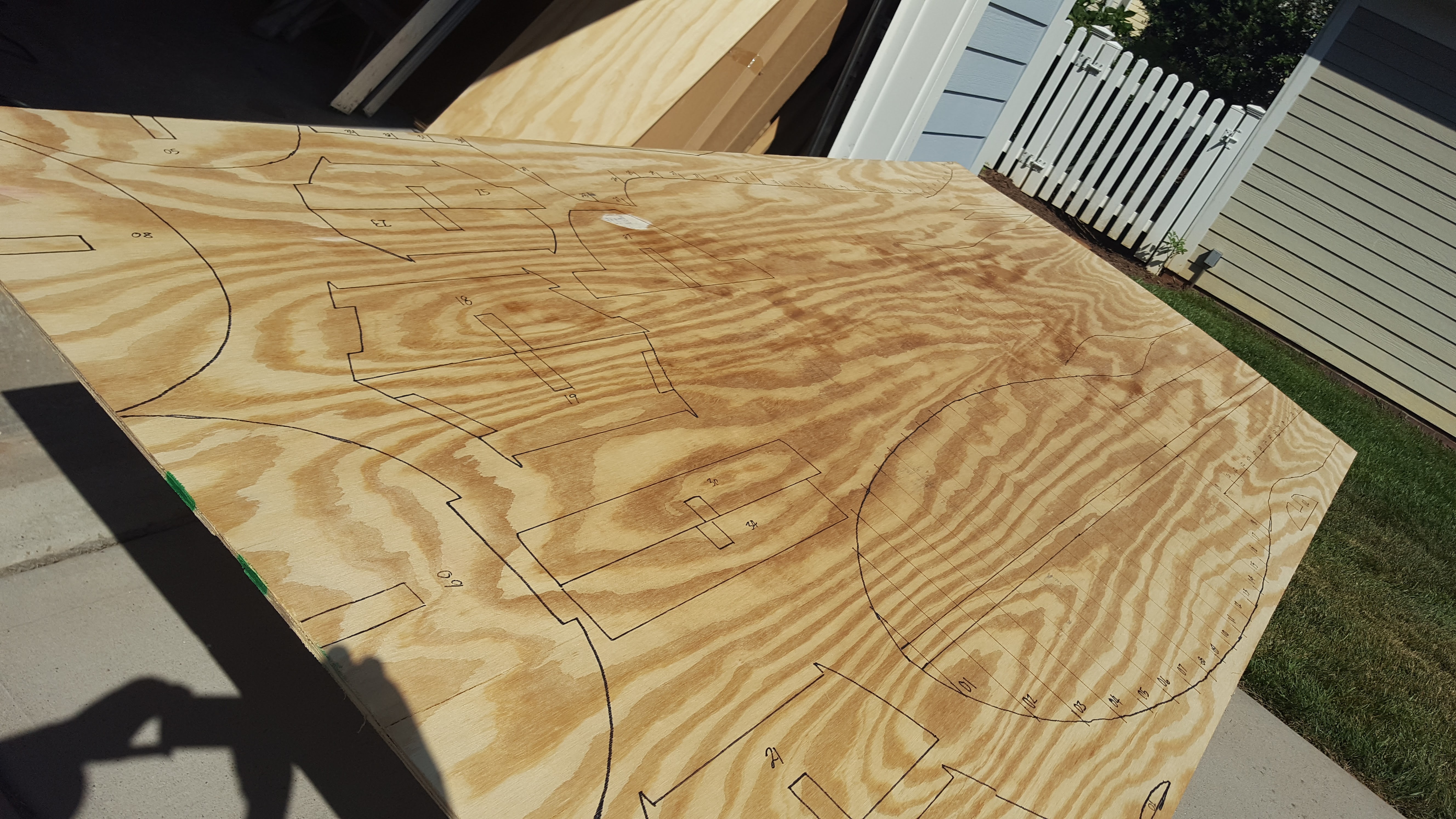

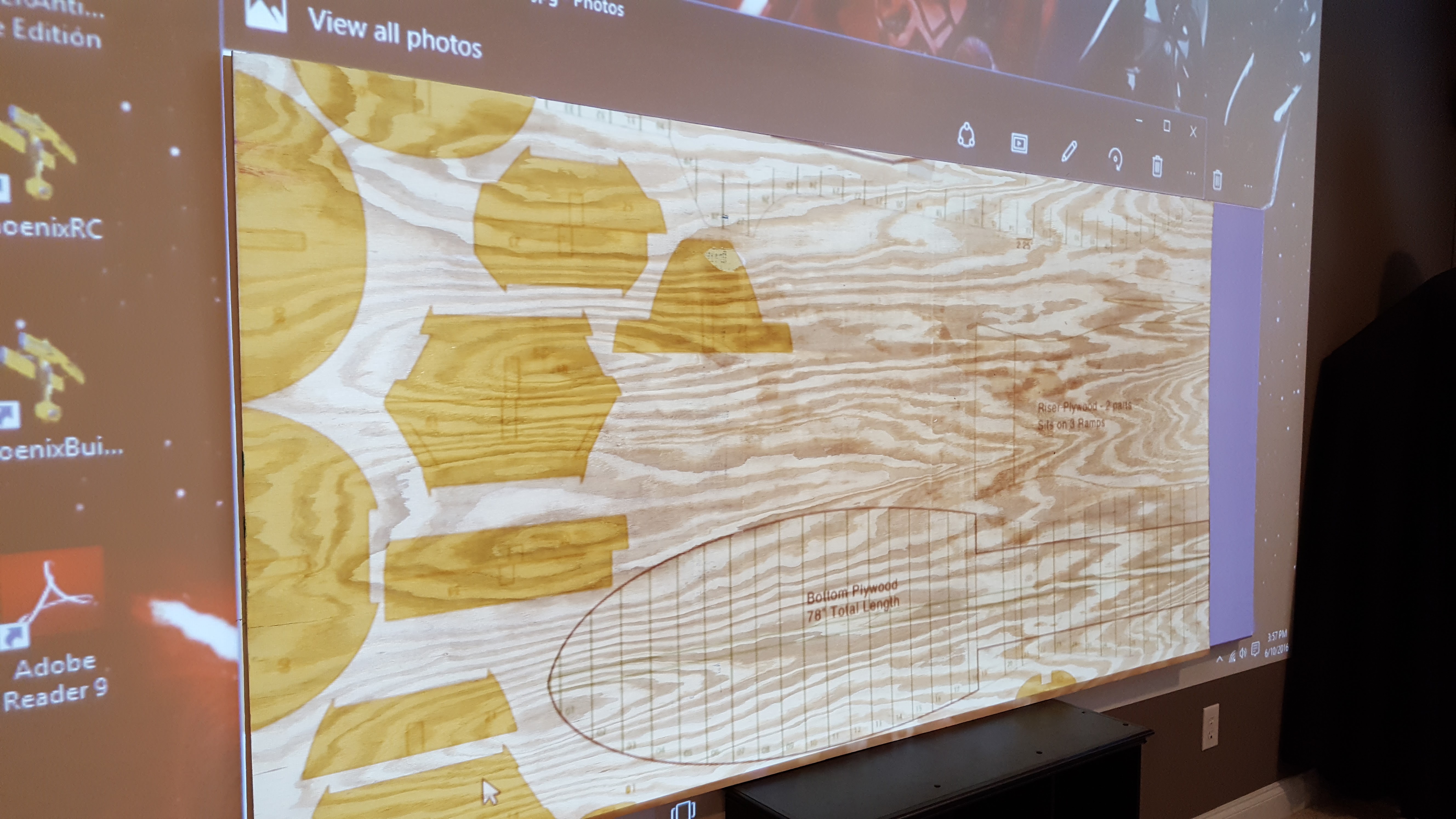

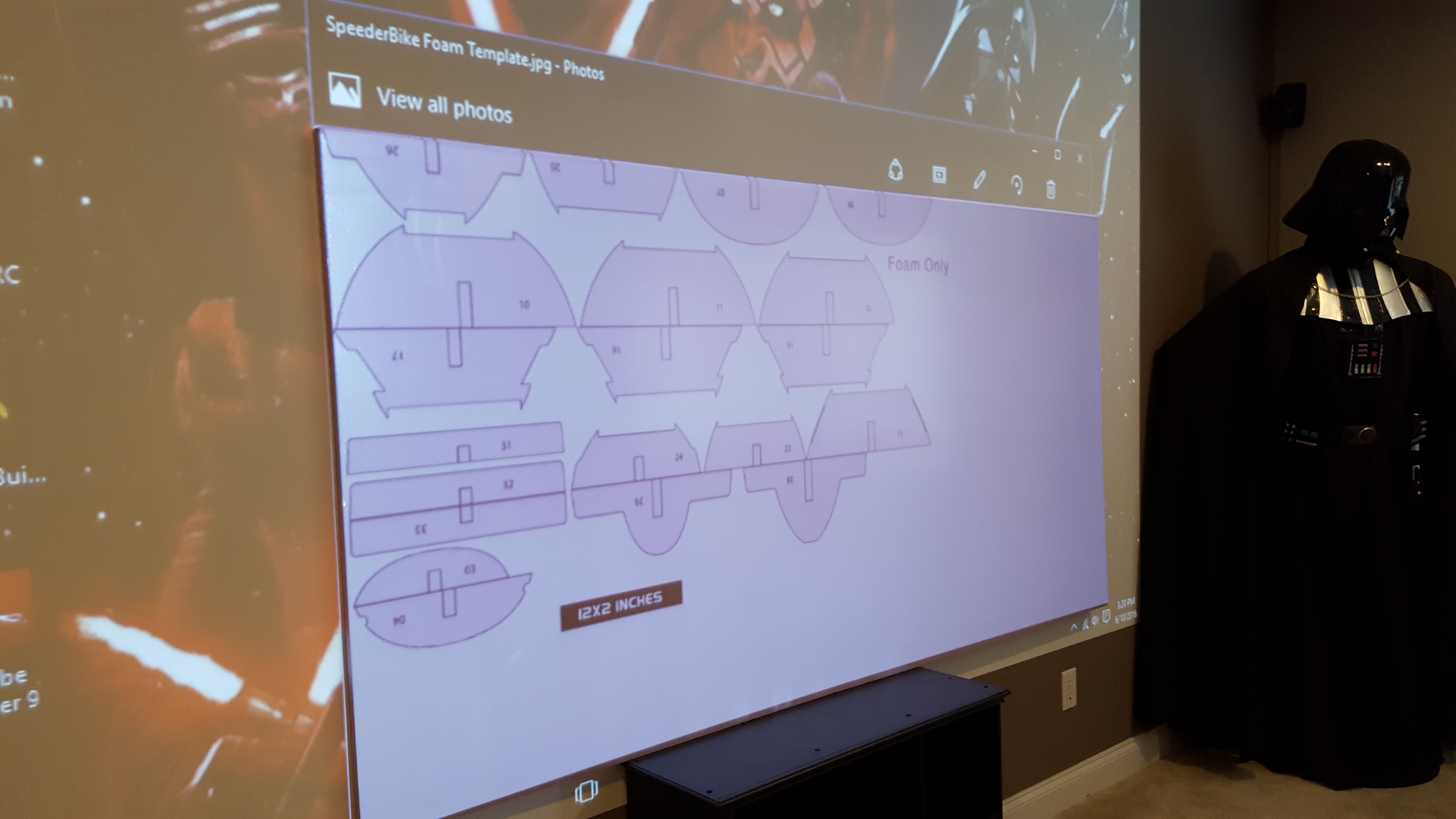

I started by gathering as many plans and profile views as possible and determined a significant number of discrepancies between the source materials (as always). Therefore, I set out to create my own plans and projected them onto the large sheets of foam and plywood.
Little Jawa helpers assisted in transferring the design to the building materials (pink builders foam and plywood).
Re: Star Wars Scout Trooper - Full Size Speed Bike Build
Exactly - the plans I drew were designed at 1" = 1'. That way at 11 feet, the plans fit on a letter size sheet to use in the garage and parts measurement became much more simplified.

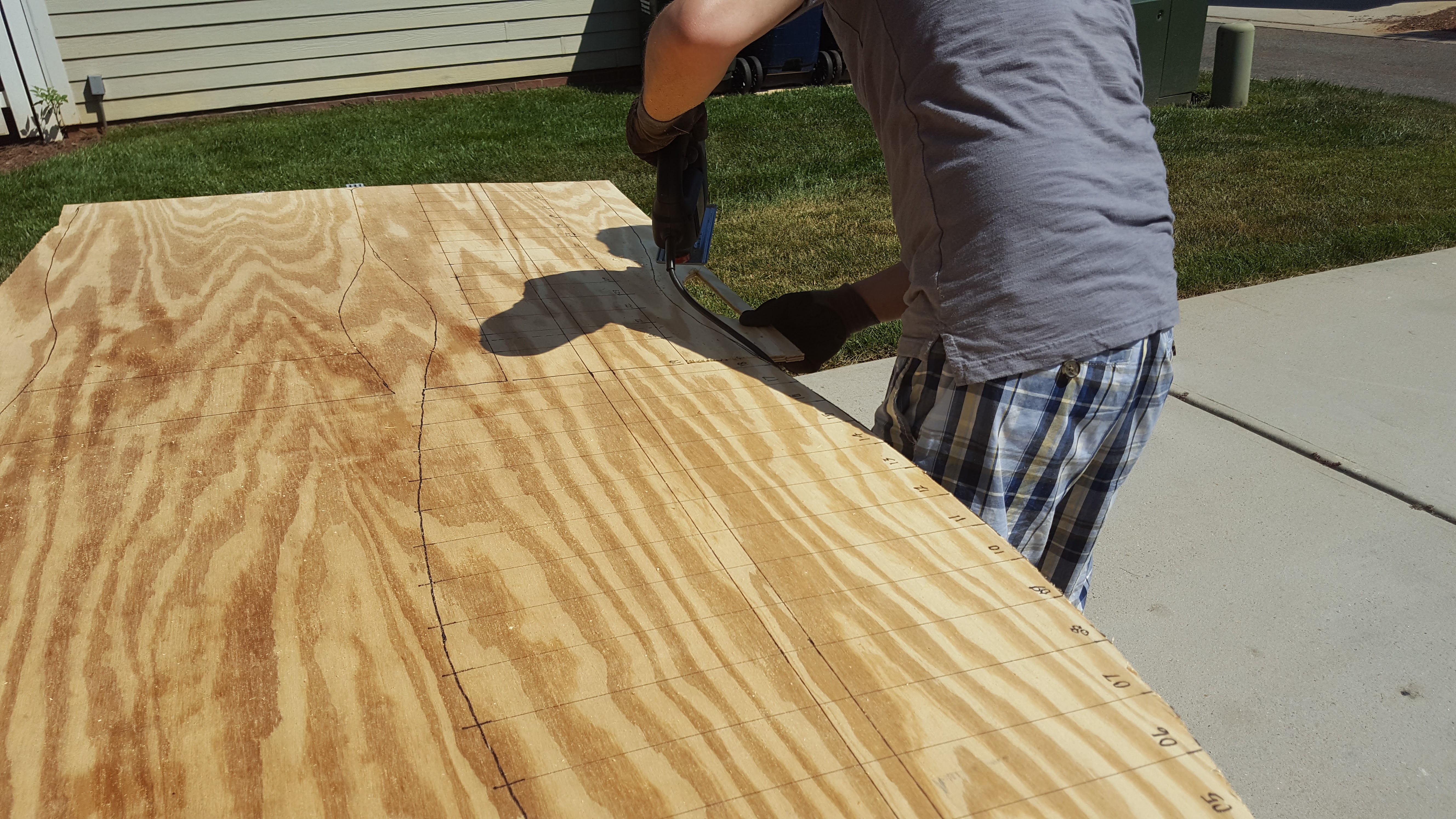

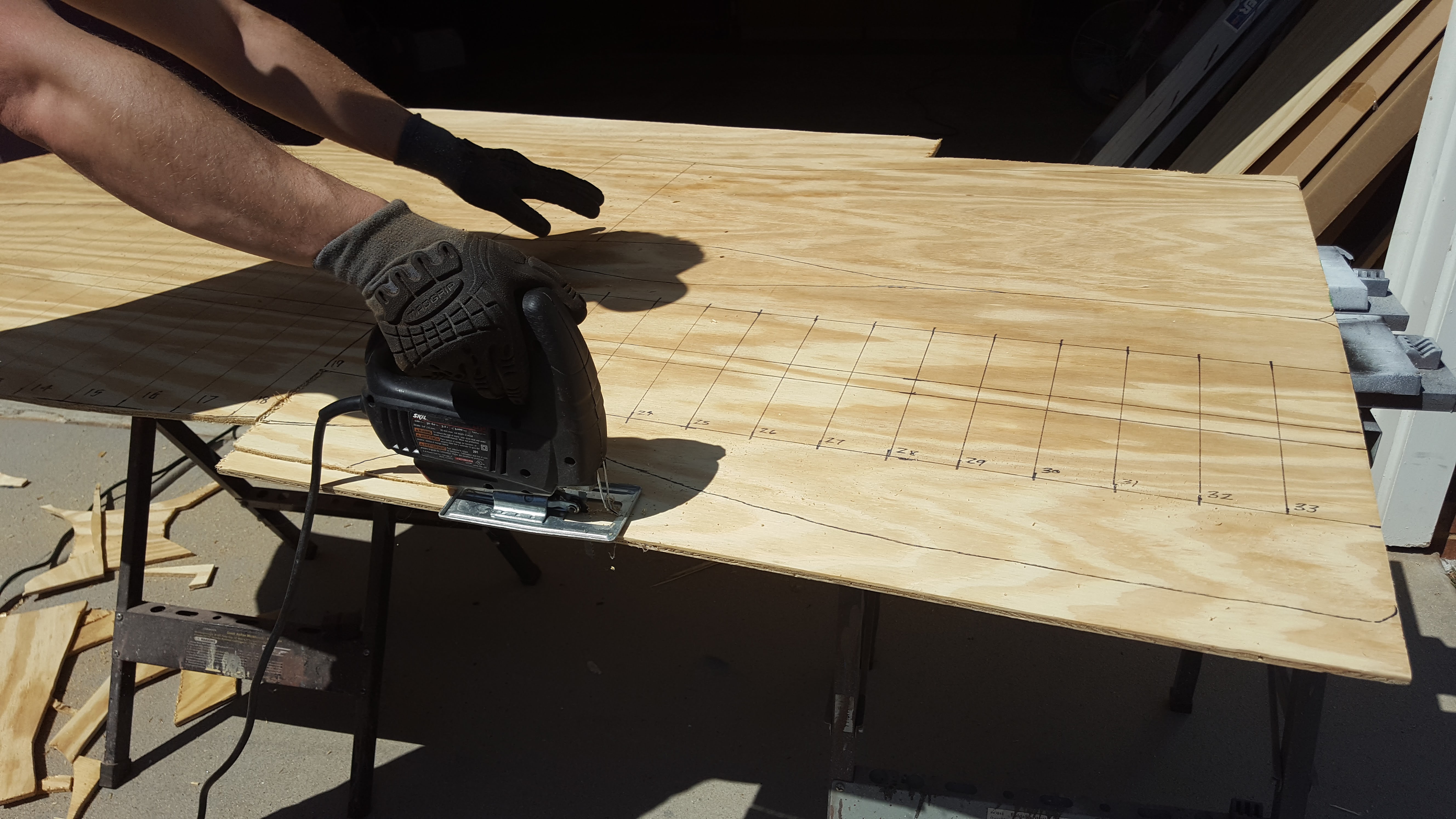

Step 2:
Cut out all of the parts with a jig saw. Making sure to stay within the lines helps to reduce sanding and filling later.

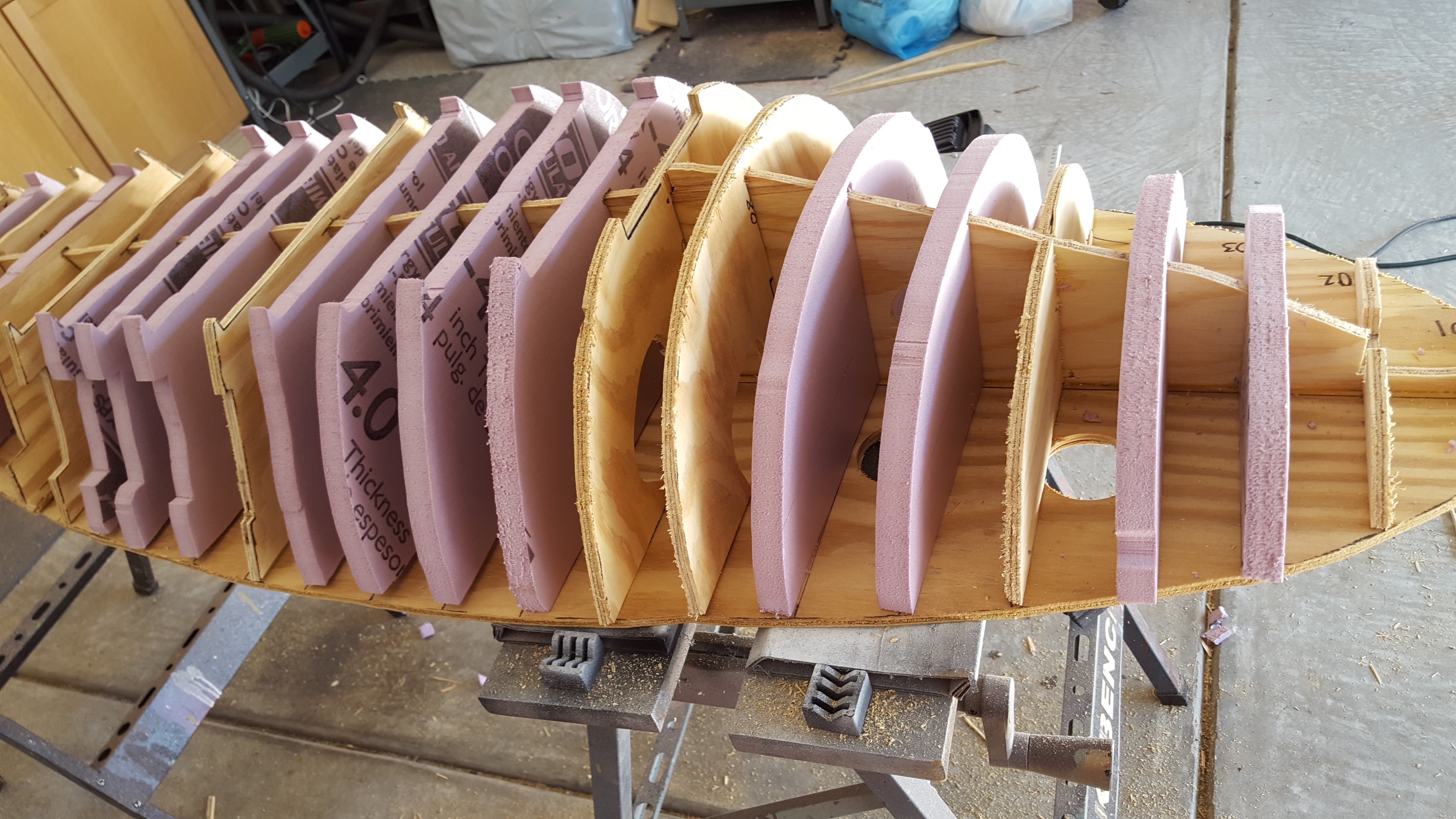

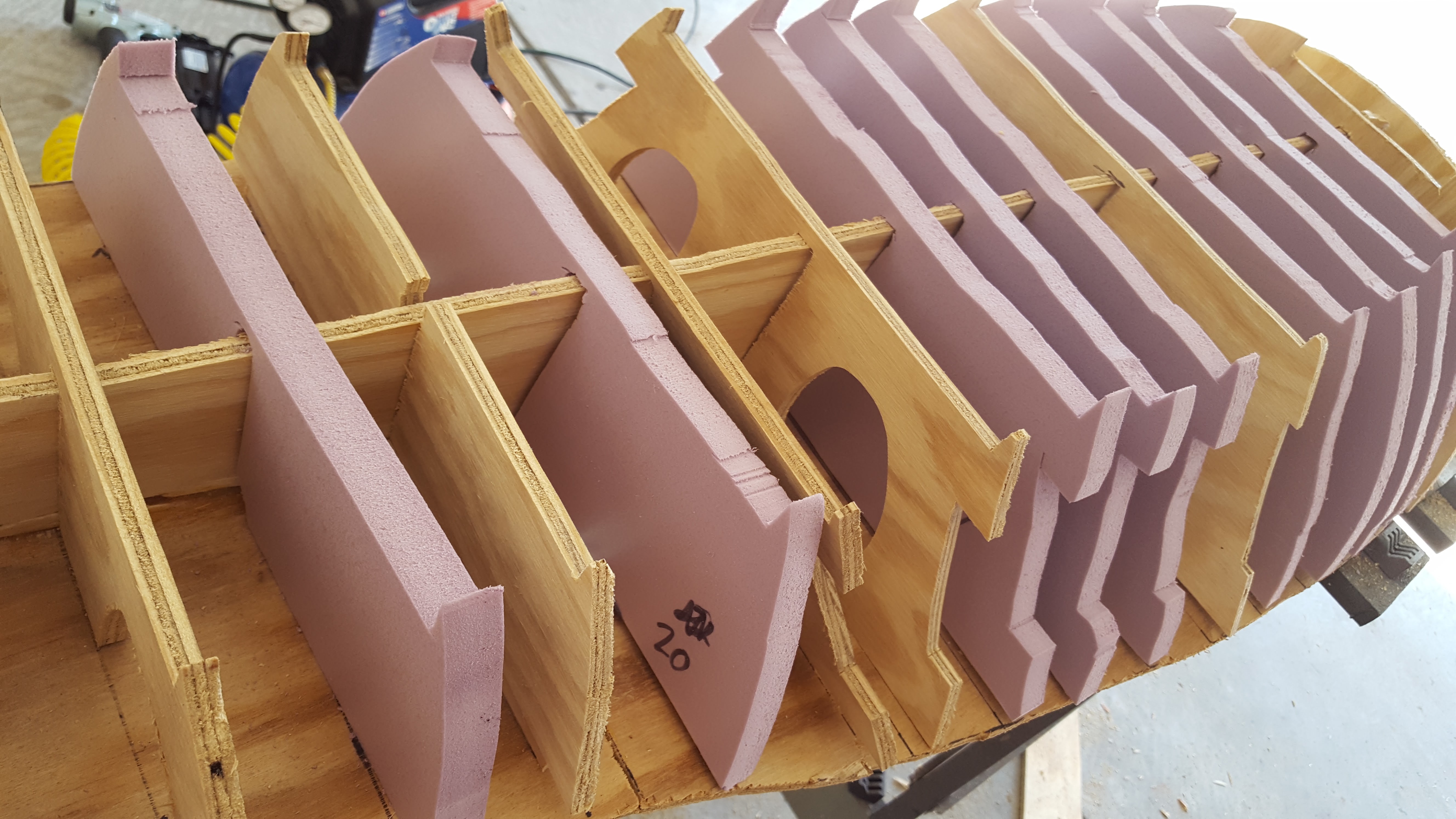

Step 3:
You'll notice the base of the speeder bike is not completely flat and includes some ramping shapes. I opted to build some elongated triangles for the shape changes, but to also incorporate a flat base for the mounting frames (office chair bases) to be secured. Holes were drilled in all the plywood pieces to help lighten the structure.

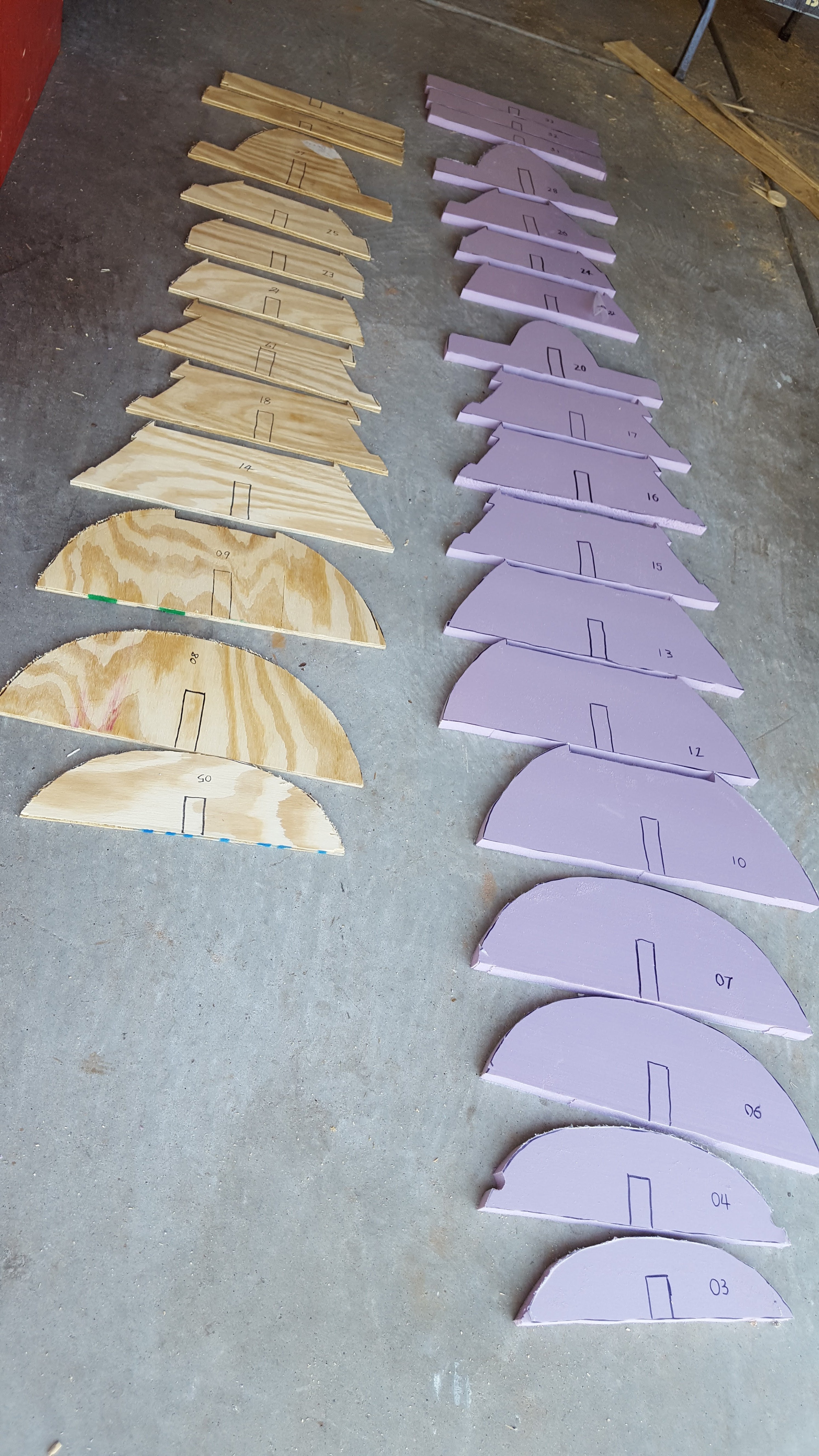

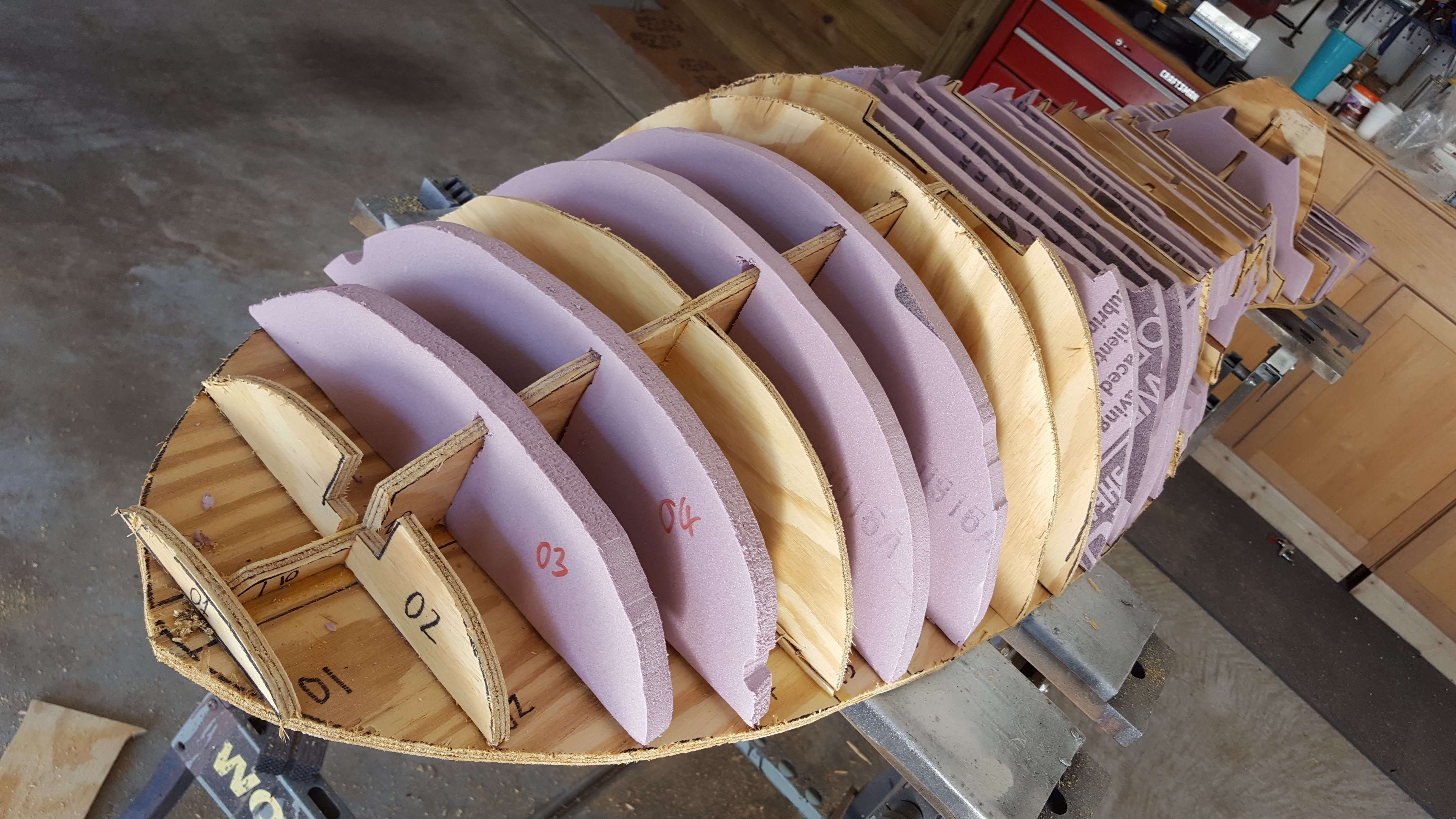

Step 4:

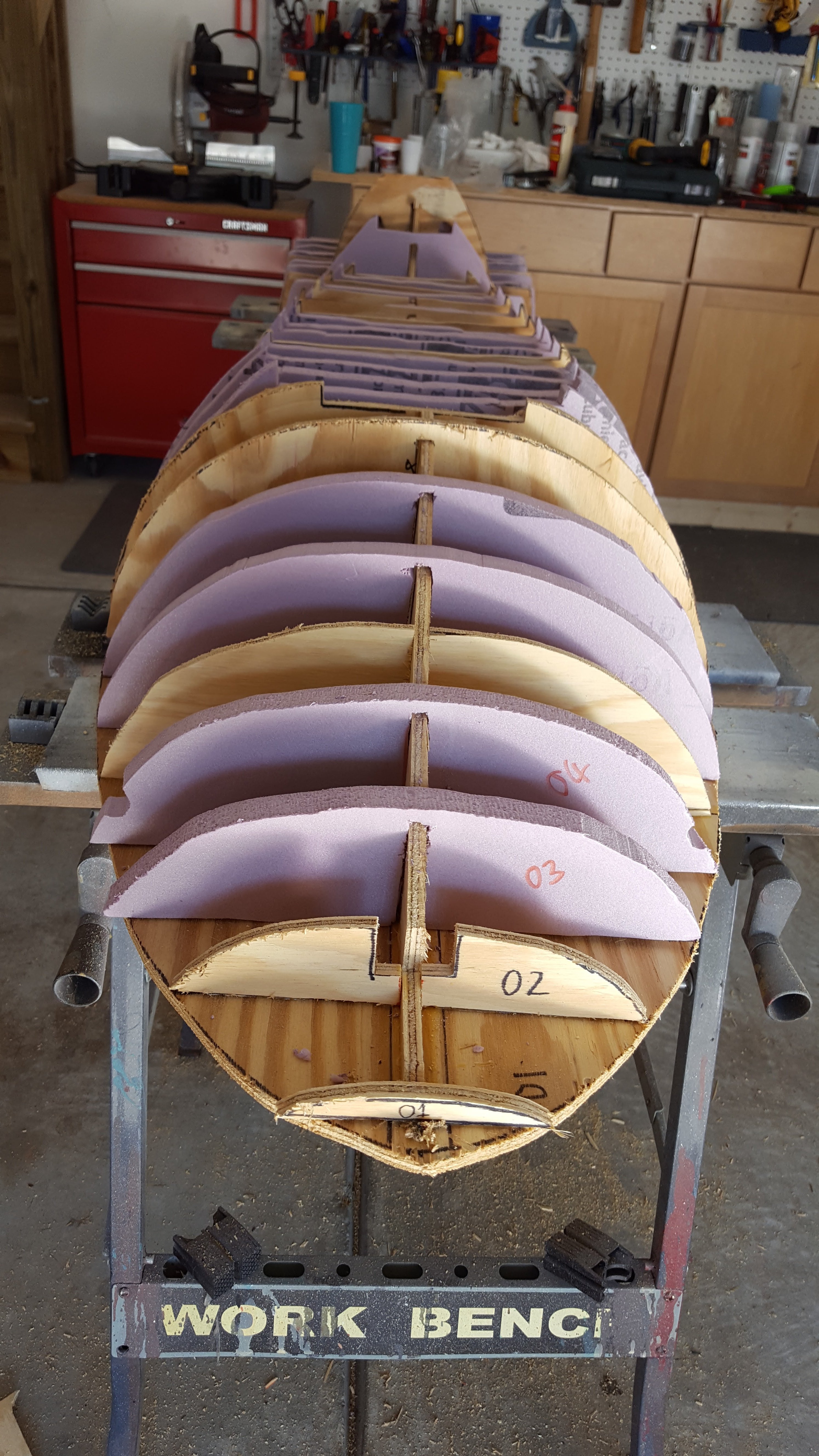

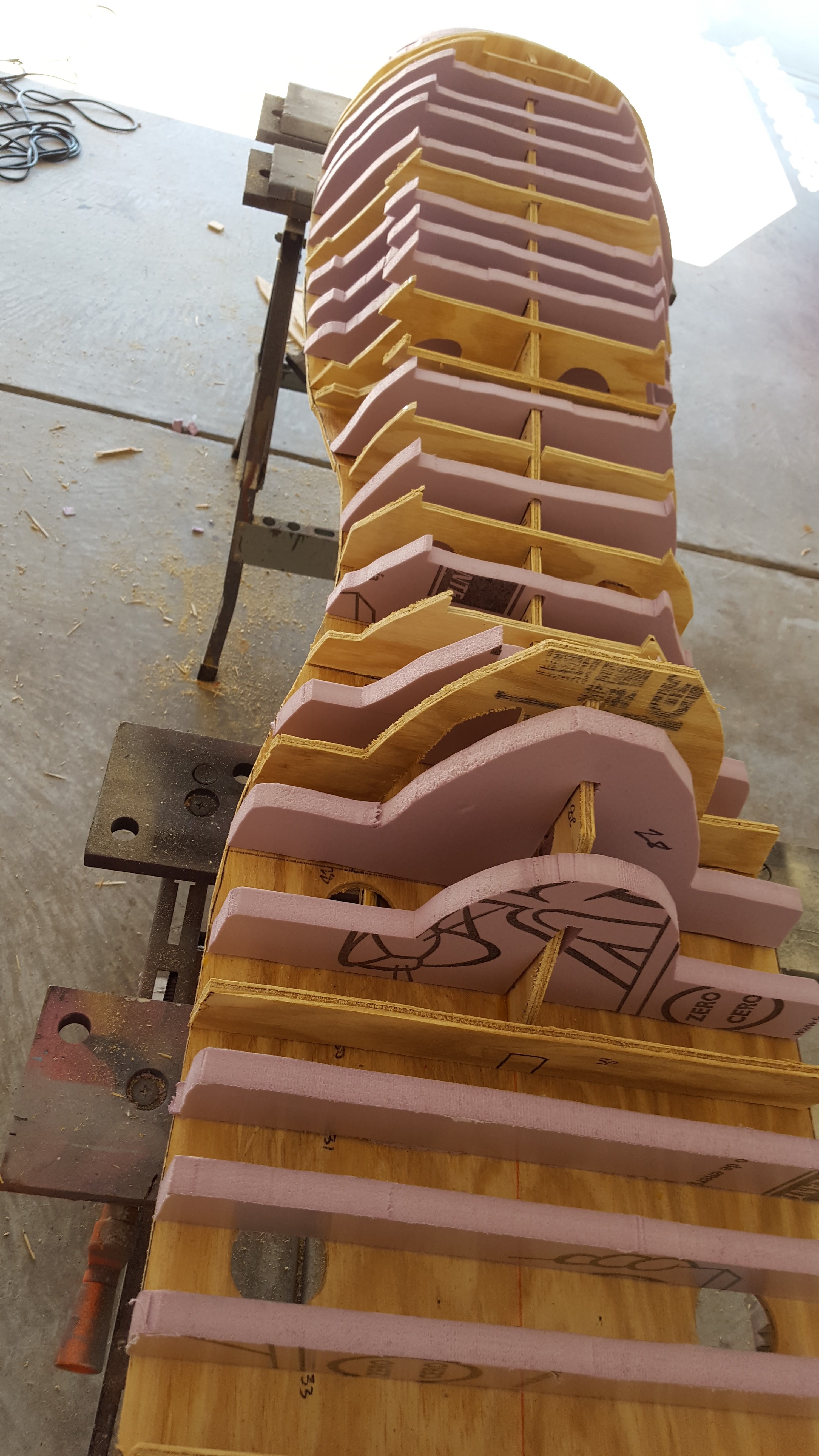

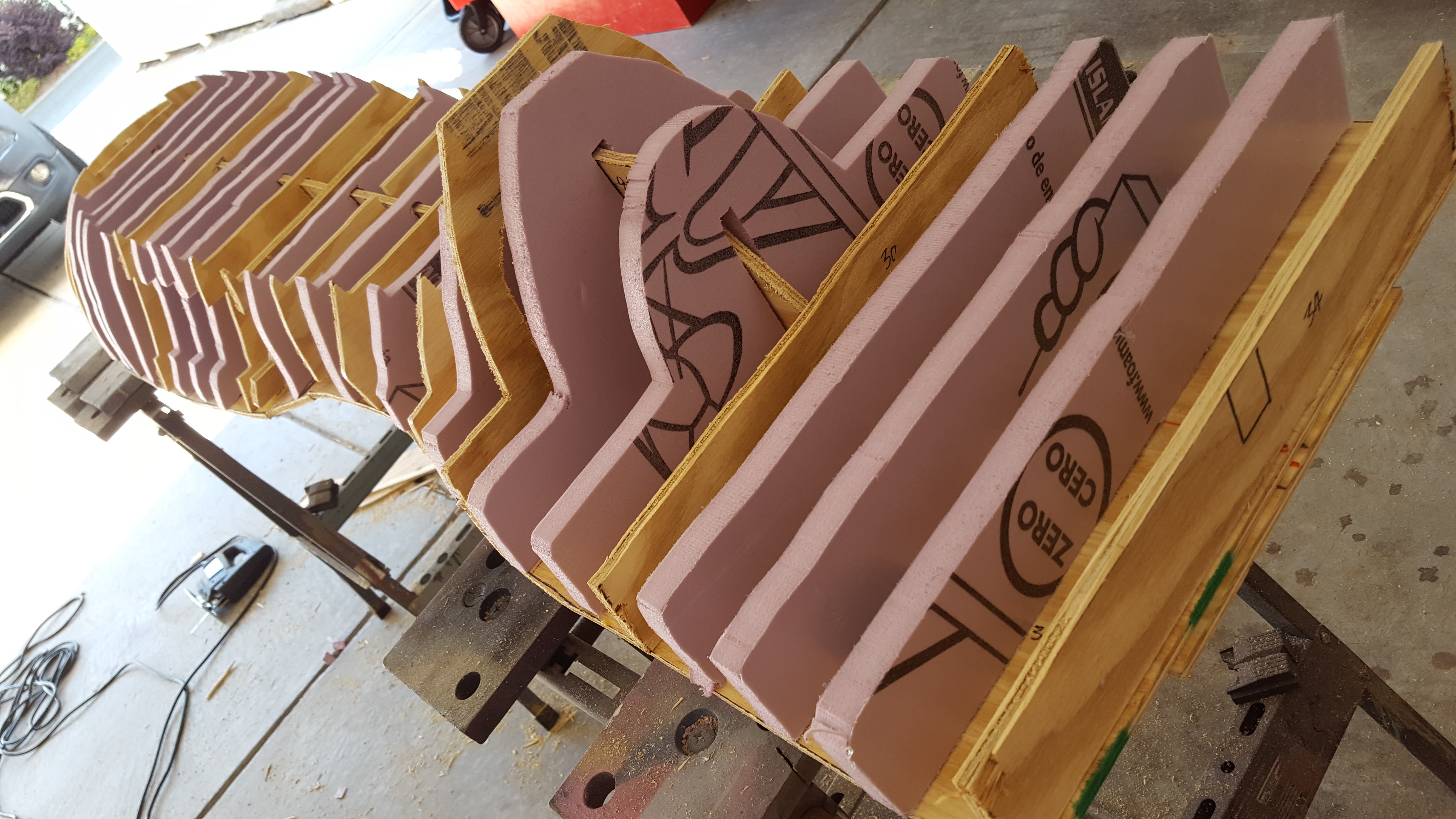

With the base prepped and ready, all the formers are aligned and put into order for assembly. I opted to use the plywood formers at the critical junction points (near handlebars, under seat, ends, etc) and used pink foam in between. There are still gaps in between, but we'll tackle those spaces later.
Step 5:

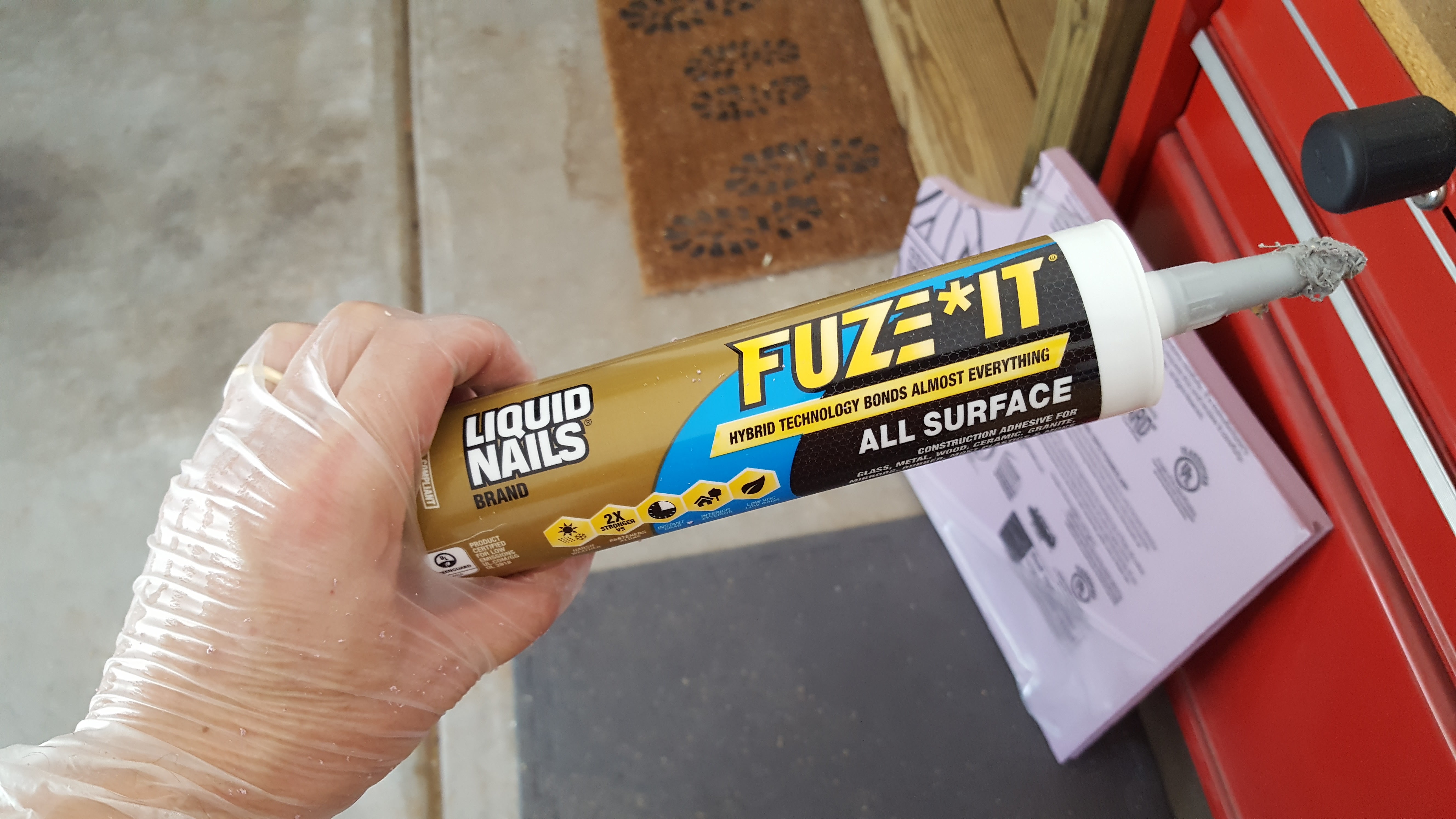

To adhere the formers to the base, I used Liquid Nails "FUZE IT" all-surface adhesive as it grabs fast, doesn't react the foam, and is fairly tough stuff. In case you glue the wrong the part down, this stuff can be cut up with a knife when cured (a few hours), so it's definitely not as solid as something like epoxy. Once the formers are setup, let them cure overnight to keep them from shifting.
It's at this point that the hair on the back of my neck begins to stand up! It's starting to look like a speeder bike!

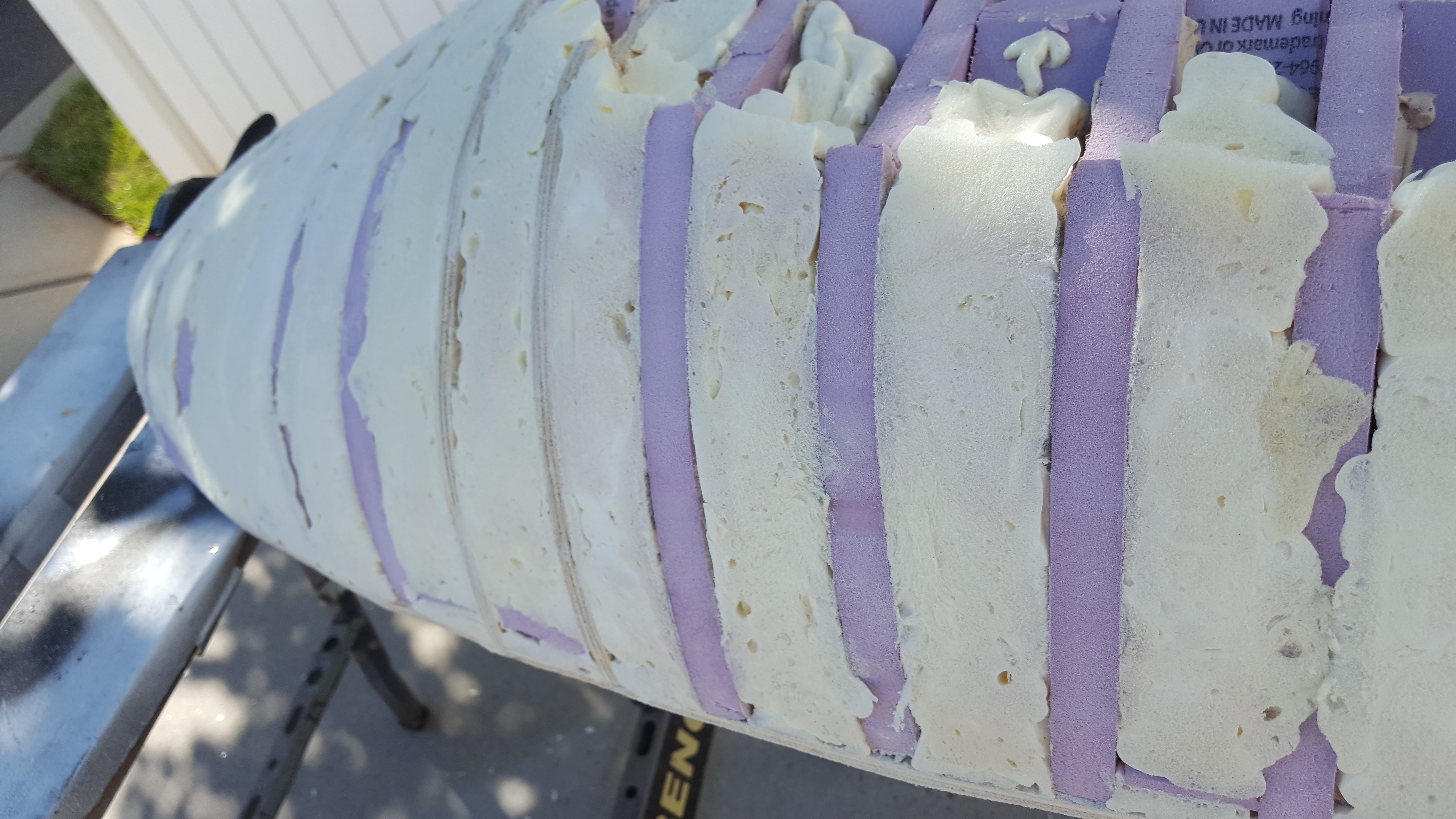

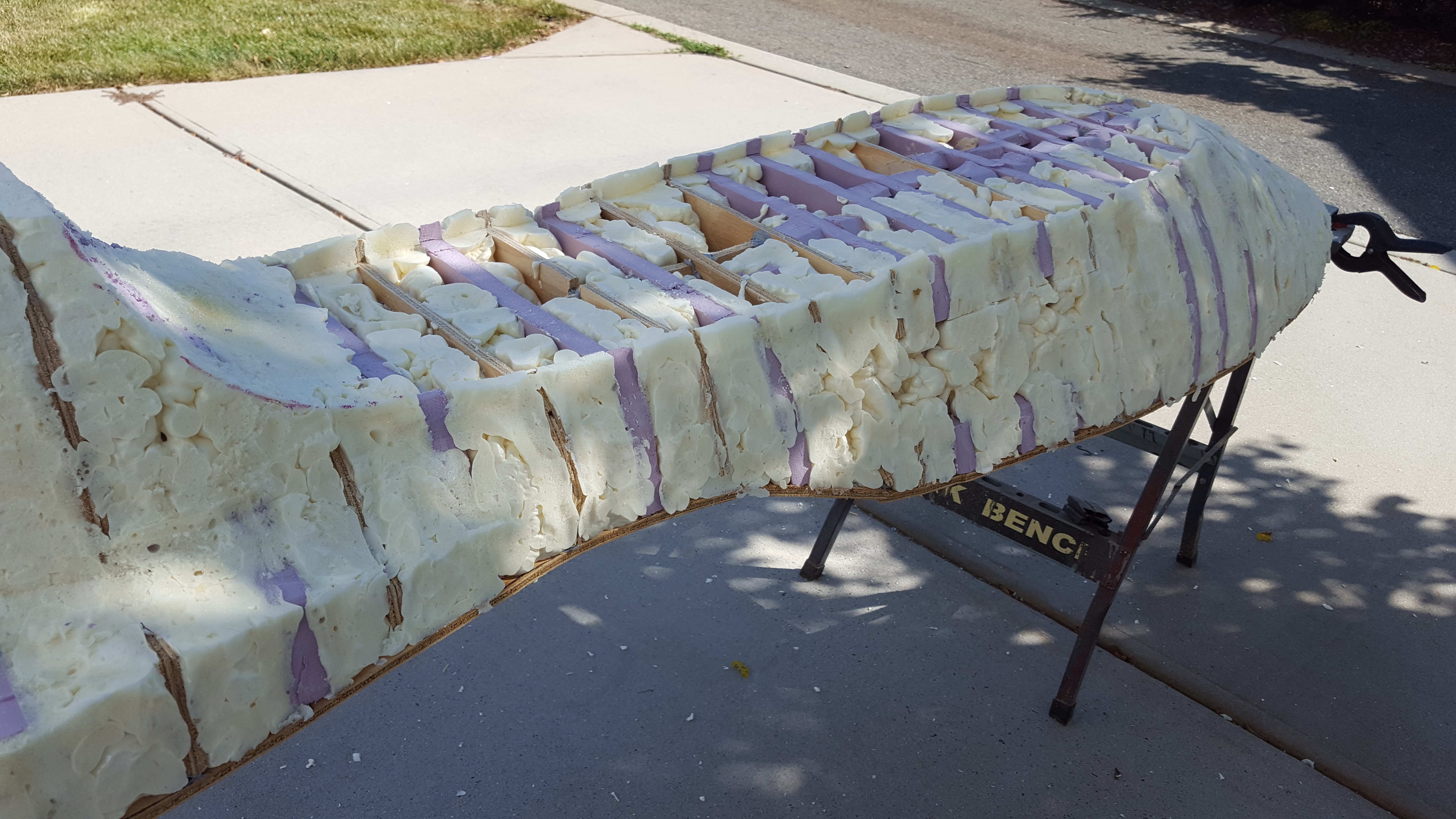

Step 6:

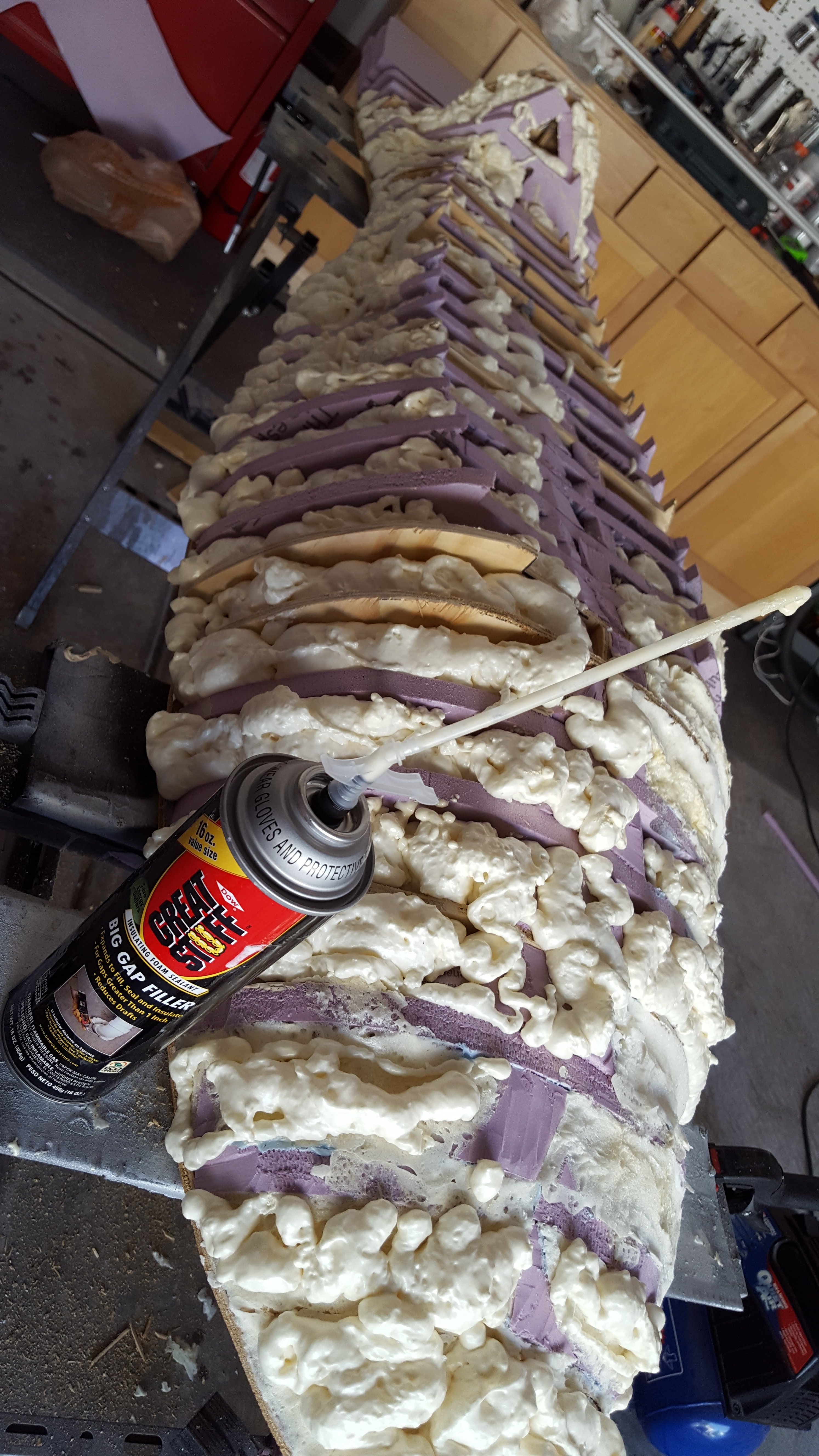

The gaps between the formers are filled with the Great Stuff expanding spray foam. I used both the normal and big gap filler types and would highly recommend staying with the normal gap filler for all these prop projects. Although its tempting to shoot the big gap filler all over since it fills bigger gaps faster (right?) - it actually continues to expand for days upon days, thus upsetting the cutting, sanding, and fiberglassing process. Trust me - and stick with the simple gap filler. Within the deep recesses, I layered scraps of foam so that I didn't have to use so much of the spray version. I ended up using 3 cans to fill all the remaining voids.
What a mess at this point!

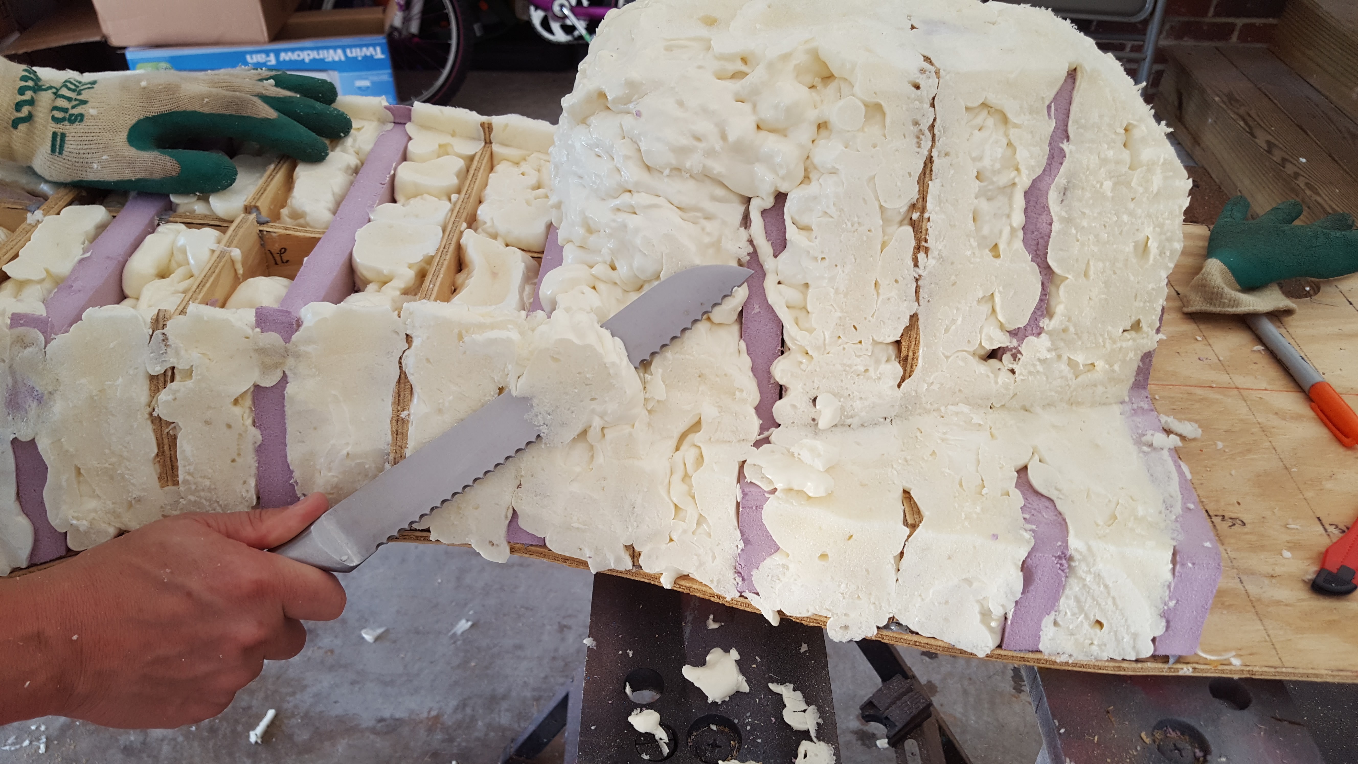

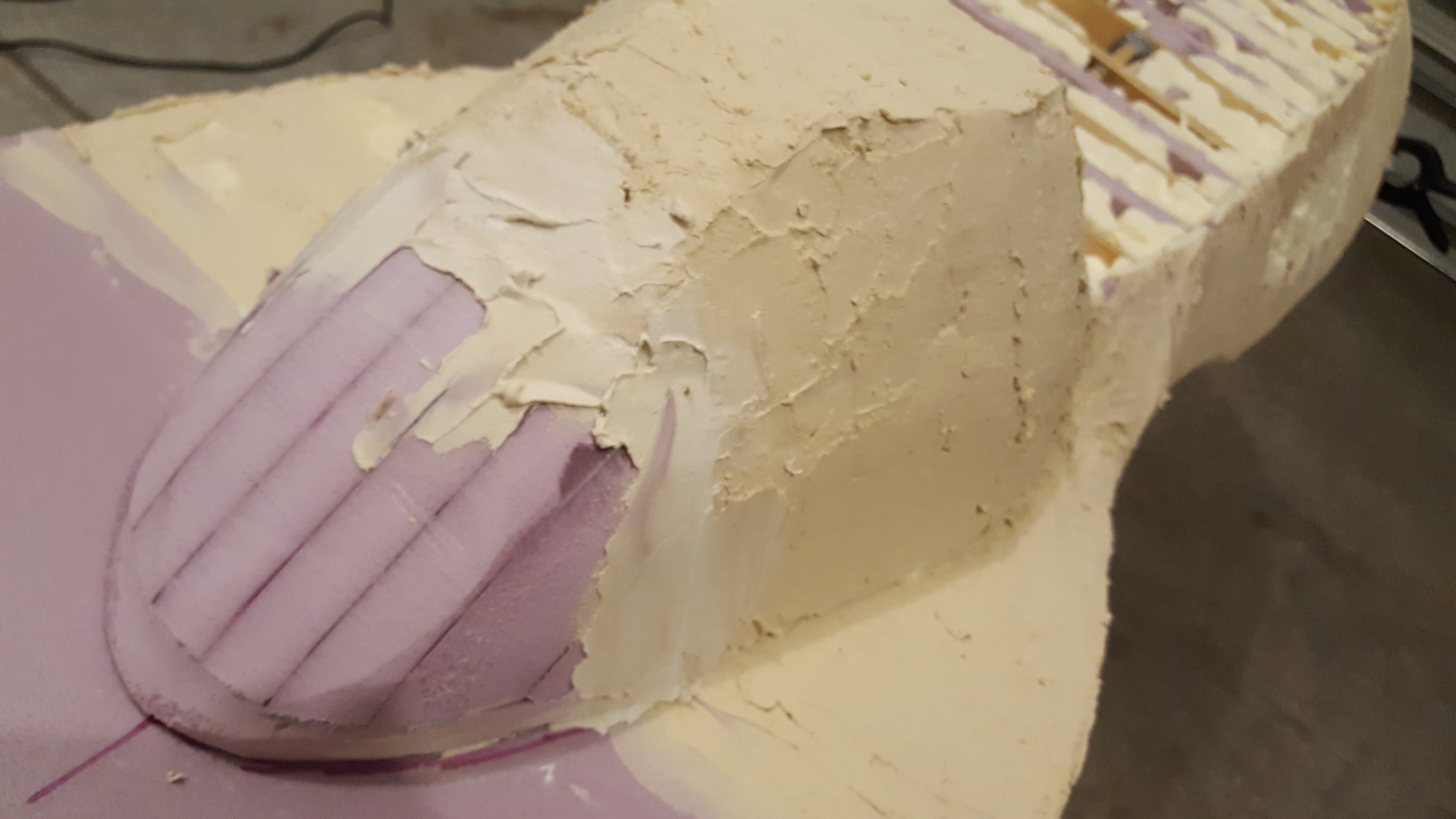

Step 7:

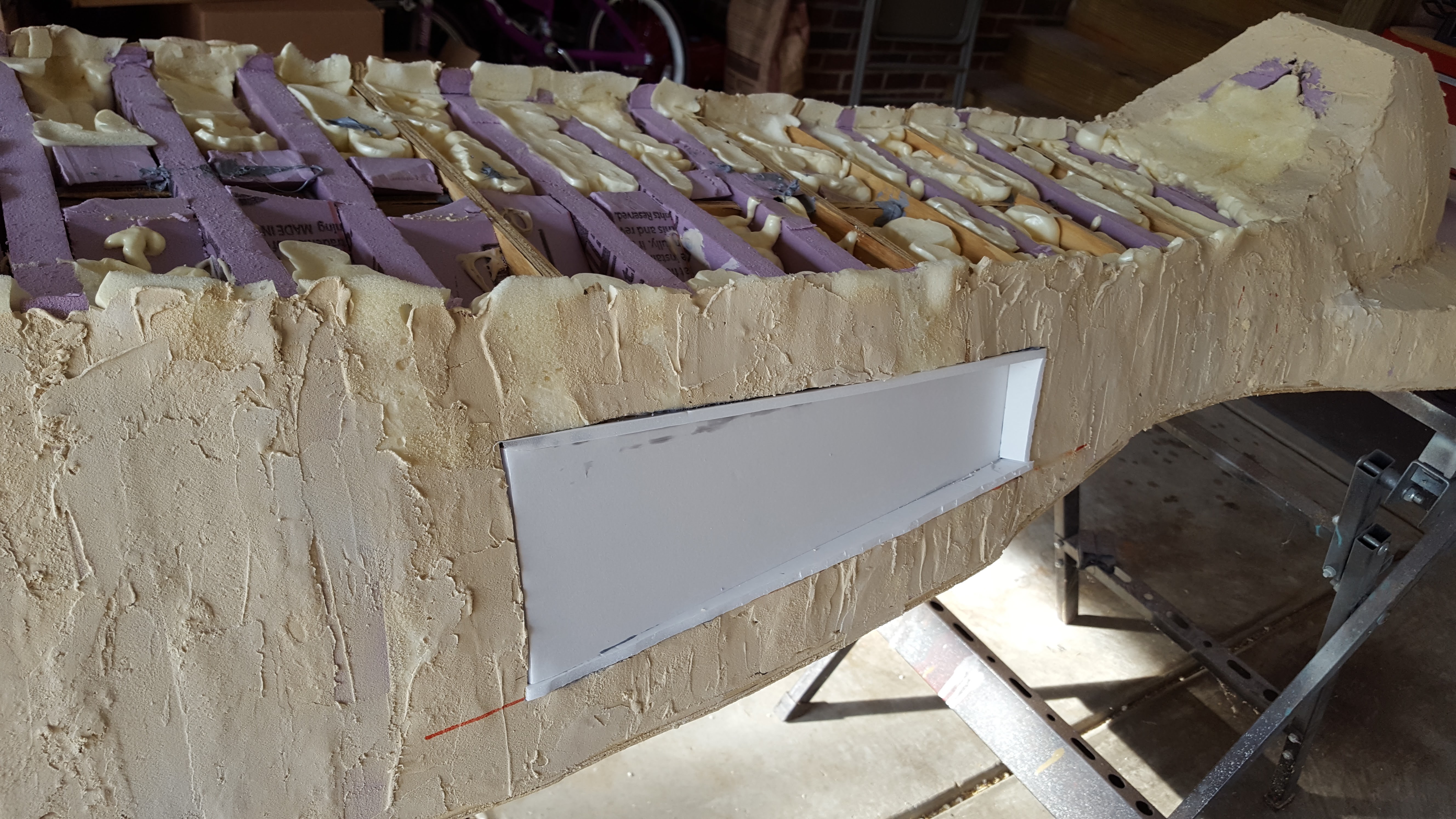

Cuts Just Like Butta'! Actually, using a bread knife and small box cutter, the foam does cut somewhat like butter. This takes some patience, time, and a large garbage can at your disposal. Making sure to not go too deep and keep things symmetrical - this is the key at this stage.
Step 7:
The intakes were lined with heavy foam core board to create nice flat surfaces (and sharp edges). They'll later receive a coat of epoxy to harden them up even more.
