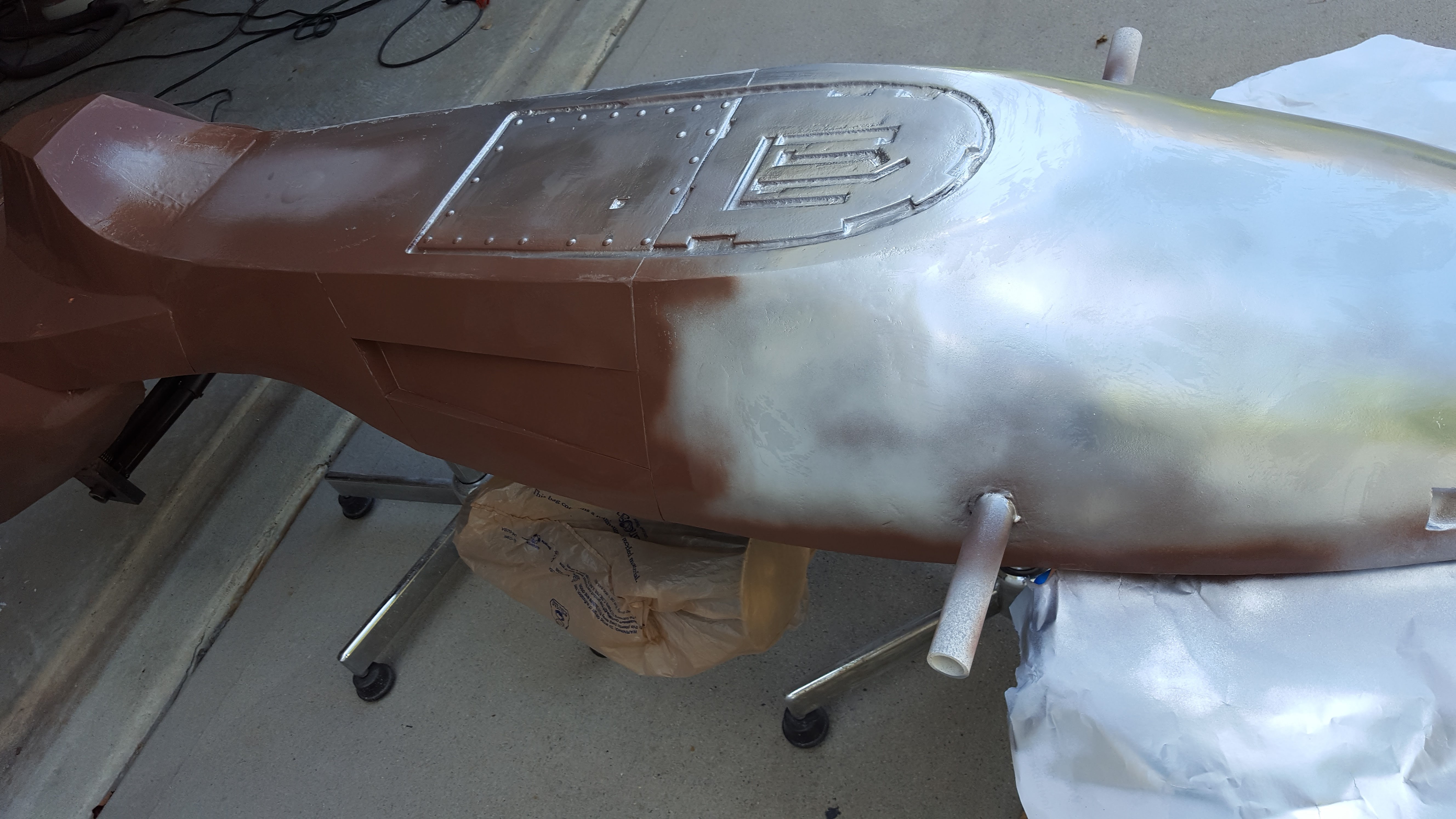

In order to create the paint chipping/weathered effect, I'm going to take a page from my model building efforts and lay down a coat of silver paint as the base. Even though I started with brown (wanted to check the hue), I will spray paint the whole bike in silver spray paint (Rustoleum) as base for the chipping effort.
Back to the silver paint technique - The key here is to let the silver dry completely and then work quickly on the next few steps. Here's a blast from the 80's - get out your can of Aqua Net Hairspray (Aersol) and saturate a paper towel. Dab the paper towel randomly over the silver paint. This will create a slight barrier between the silver and the body color. Once the hairspray dries (like 5 mins) - spray the top coat on immediately. Note, I'm not using acrylics here - I'm using spray paint lacquer on this project.
Dab it in a random pattern in the high-traffic areas (corners, edges, etc.)
Spray paint the final colors - in this case, I'm spraying a medium nutmeg brown with highlights of dark brown, bronze, olive, and a hint of black. Only rattle cans for this job, I left my airbrush in the house as it's waaaay too humid to airbrush acrylics.

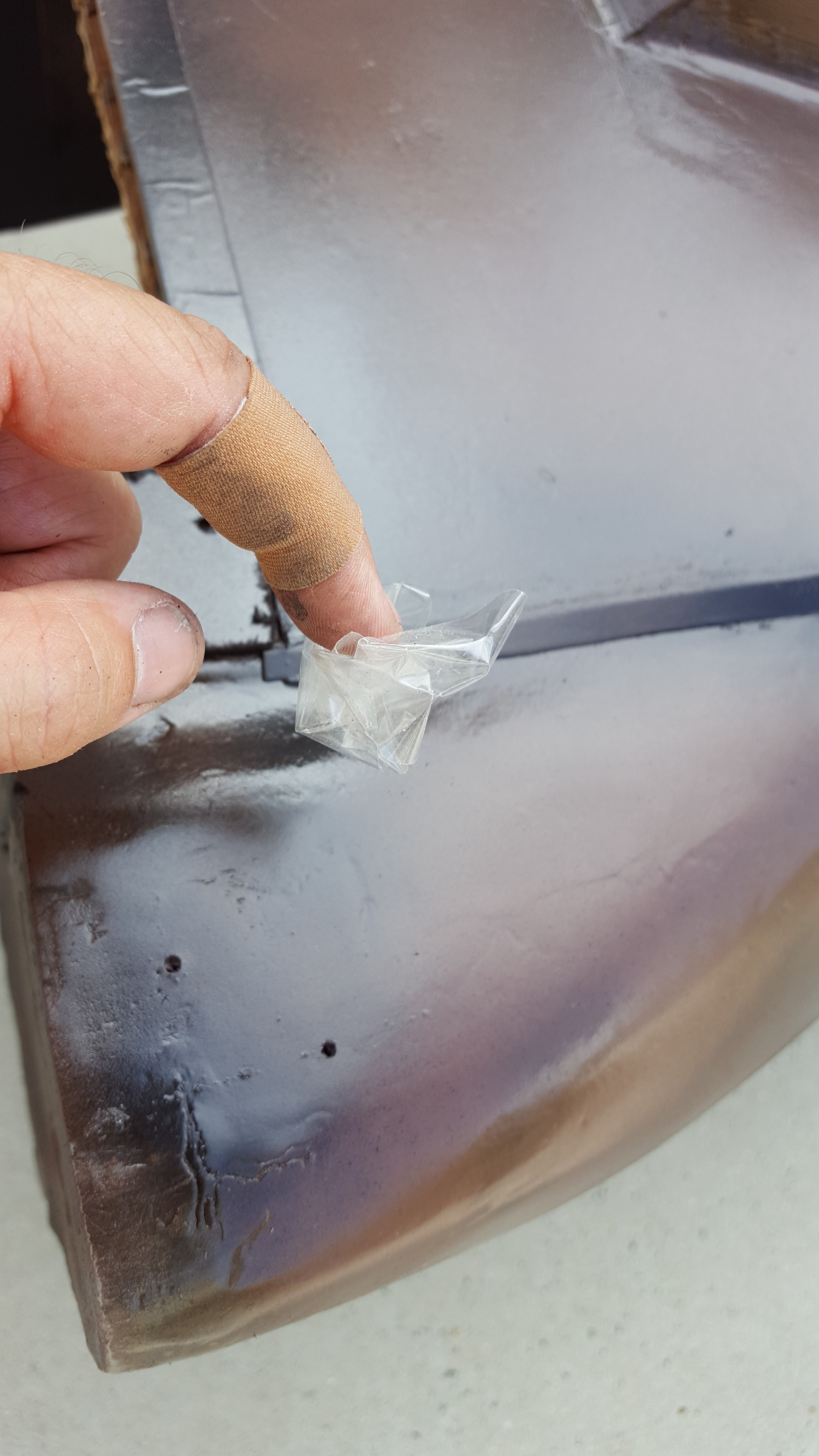

They key here is to let the brown paint set up just to where it's a bit tacky, but not full cured - perhaps 20-30 mins after painting. If you wait to long, better paints can adhere through the Aqua Net and the effect is lost.
So, here's what you'll need - a roll of clear packing tape and some heavy steel wool (to help add texture).
If you just lay the strip of tape down, you'll pull off a perfect rectangle of paint - definitely not the look we're going for here. It helps to wad the tape up and then pull it back apart to put some creases and wrinkles in it.
You can also impress the steel wool into the tape to create textures. Your fingernail and any other tool also work to create many effects.
In this case, less is more and it's easy to have too much fun and overdo it. But don't despair, you can always reshoot more topcoat color and peel again.

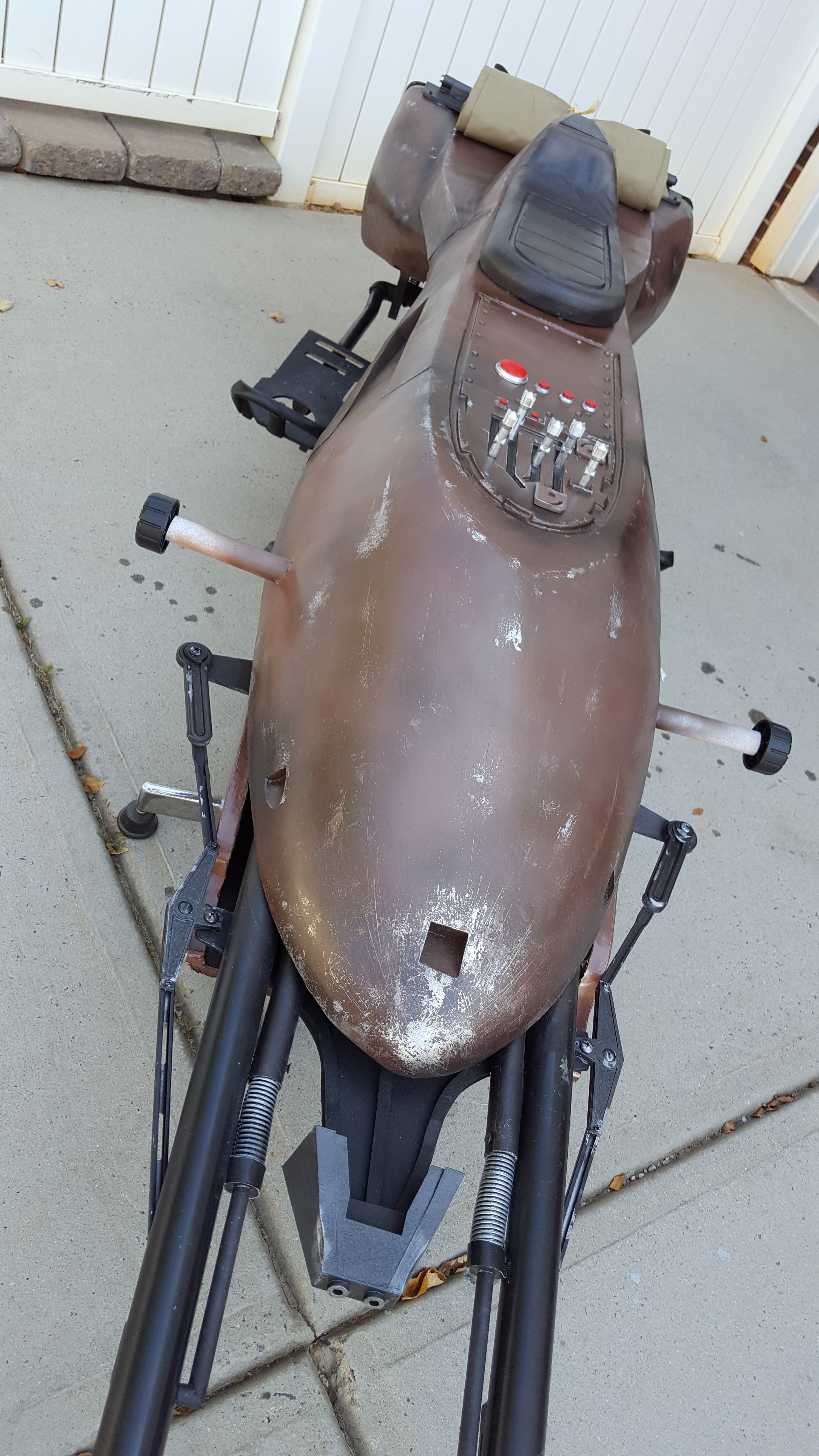

Start on one end and work around -
The steel wool also makes good scratch effects too -
The edges and high-spots are prime for chipped paint effects.
That looks about right -
Don't forget the tops of the rivets!
A quick dab of the paint and the paint is gone -
When flying around 300mph (according to the expanded universe) just a few feet from the ground with debris hitting all around, the integrity of the paint job begins to break down. And as with any weathering job, it's easy to over due the effect and sand blast the entire front. Taking a steel wool and depressing it into the tape creates an interesting mottle pattern to the front of the bike.
At this scale, it's difficult to make convincing paint scratch effects when painting "on" silver. Some light scratches with the steel wool cut thin scrapes of paint to reveal the silver underneath.

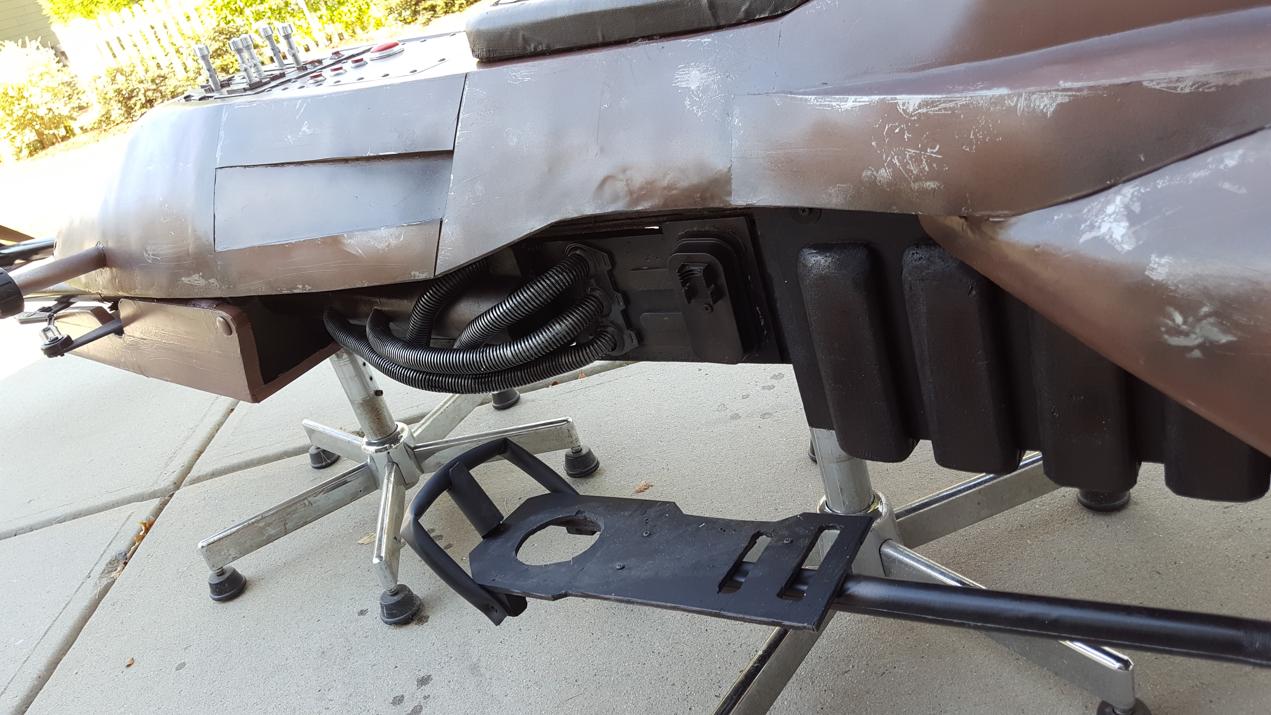

OK - let's keep going... The foot pedals are cut from plywood, with a PVC pole, a PVC center peg (heated and bent), and a toe frame from plastic drip line.
Installed! These actually actuate and retract up with a strong spring.

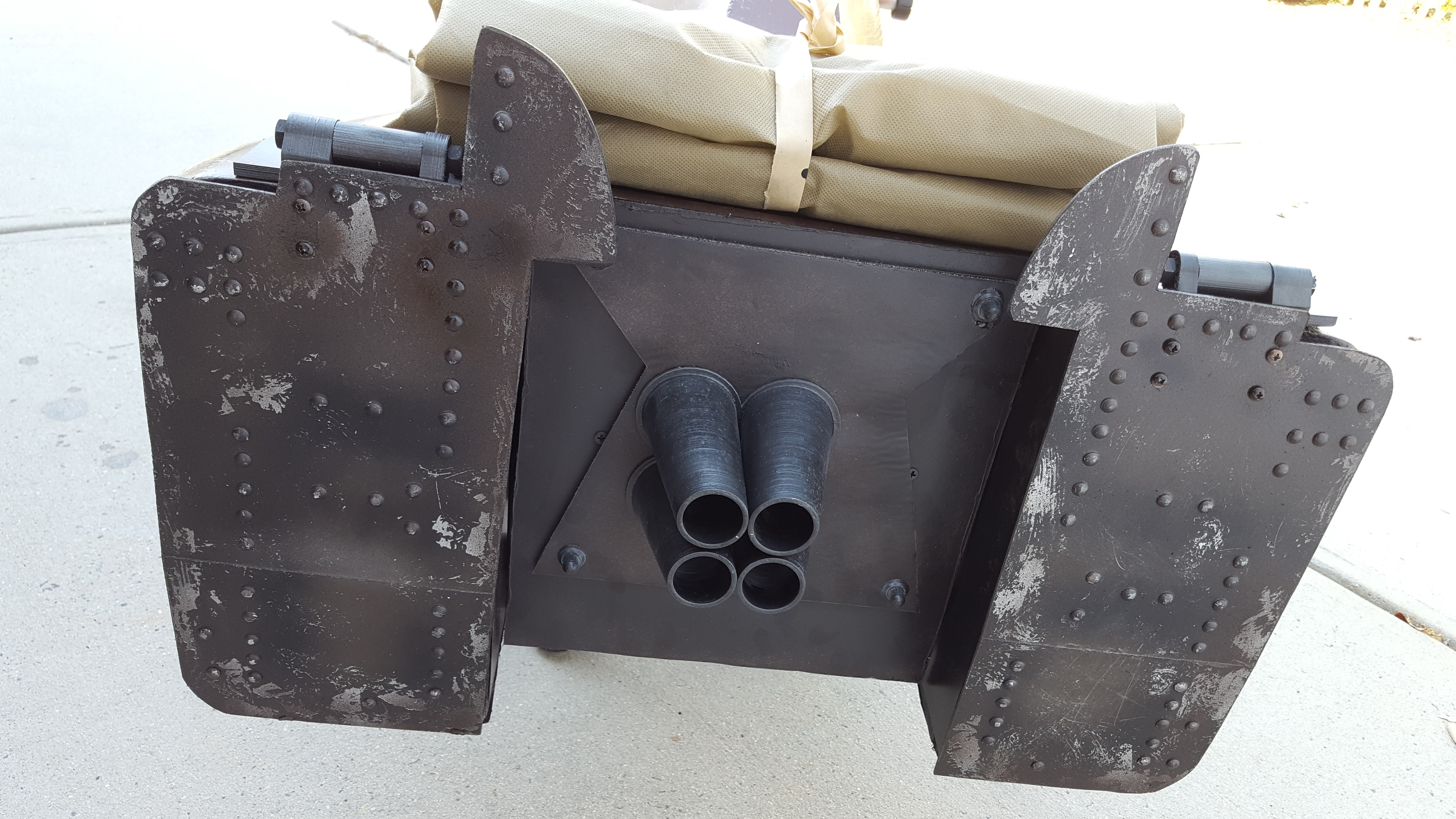

With my 3D printed hinge assembly installed, it's time to install the flaps! Using some trimmed masonite sections, small rubber sticker feet (for legs of chairs) are adhered into the pattern seen on the original -
Next step - you guessed it! Paint it silver, wait 30 minutes, then spray Aqua Net! You know this stuff smells different than it did in the 80's? Maybe I've been smelling too much spray paint lately, but it's definitely not the same... ;(
Once the Silver is fairly dry you can coat it in the top coat - in this case, I'm using a metallic bronze with an accent of black.
These two shots demonstrate how the silver looks before and after the silver is slightly toned down with the bronze metallizer:
Before:
After:
Installed on the new hinges!
