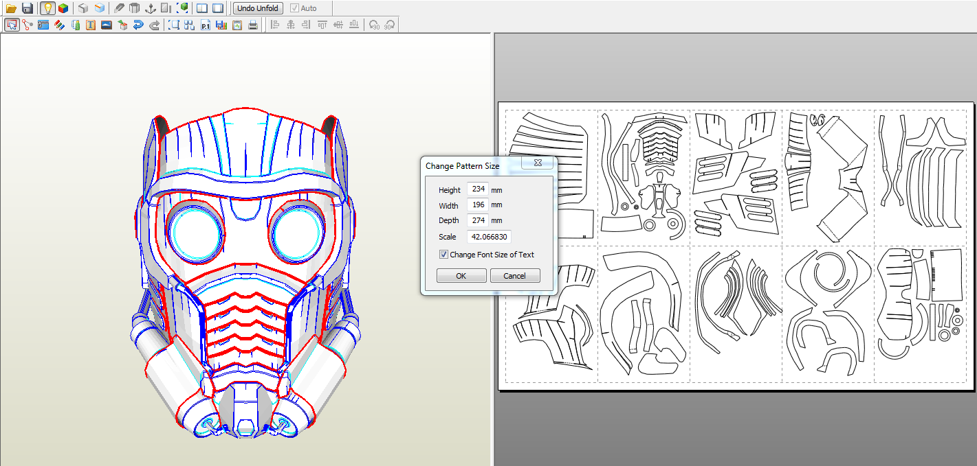

I'm not much an expert with foam yet, but have a half decent star lord helmet done. the pictures ive seen on these finished projects are amazing. using the unfold files. is this simply print everything out on paper and transfer to foam?
for the foam unfold, do you simply print to paper and transfer to the foam? and how do you know what size foam to use. im not seeing that on the pdo.
Print it on paper (you don't need to print both the "left" and "right" sides, since you can just print one and flip it over to trace it on the foam). Most people use floor mat foam - either the "puzzle piece" squares or a large roll. As long as it has one smooth side, you're good. You can use craft foam for the thinner details (I personally used it for the "mouth" pieces, since it was easier to cut breathing holes into it).
When you're sizing it for your head, add a bit of extra space to account for the fact that the foam is thicker than paper and therefore the inside of the helmet will end up a bit smaller than a paper version would (mine is slightly too small - I don't have space for electronics, whoops!).

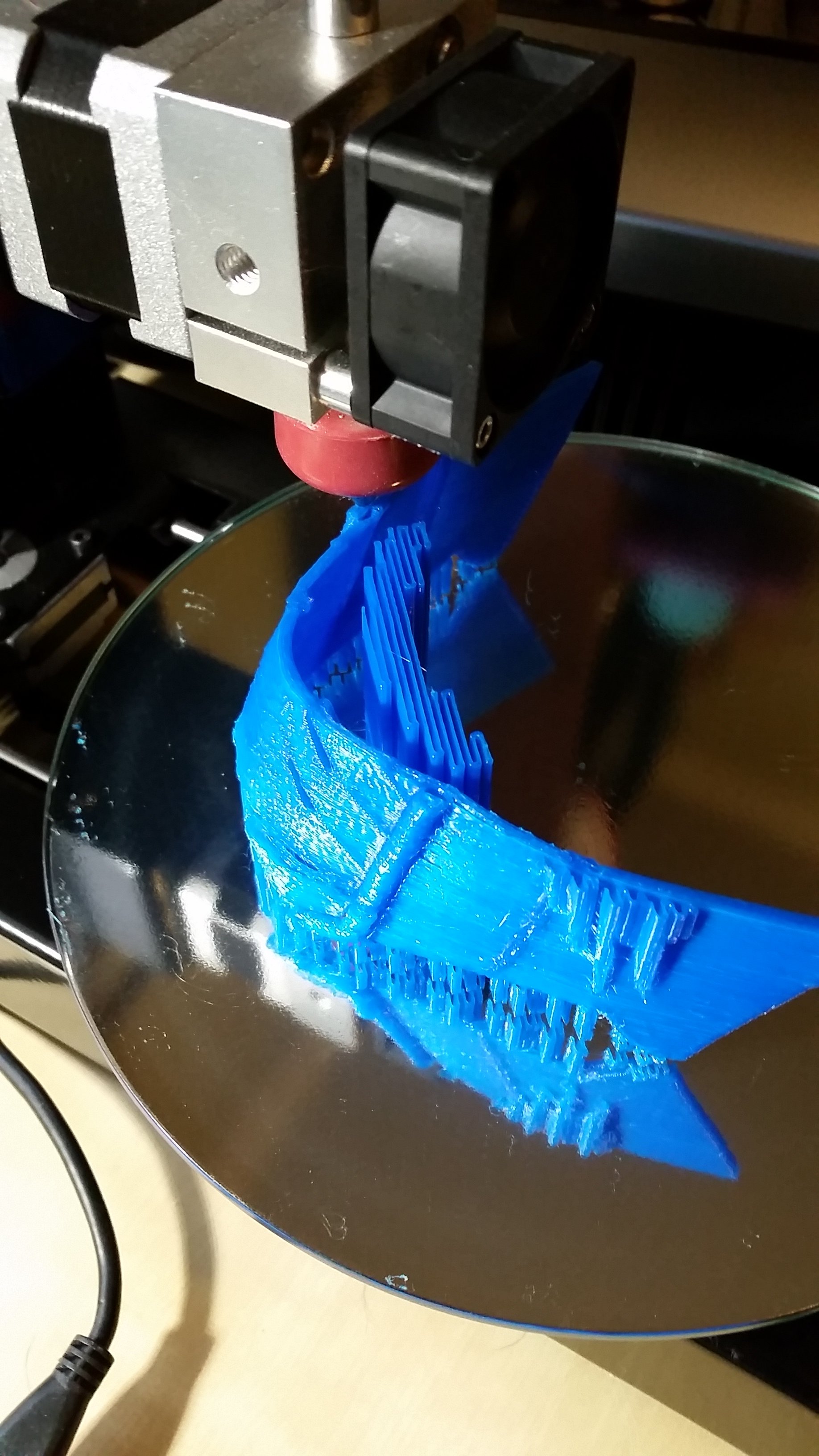

I'm printing on a Polar3D. 8" (round) x 6" high build area. Took about 2 hours. I accidentally broke the corner off while playing with it, but it's nothing some glue can't fix.
http://bit.ly/1lajF8n is my printer. I love it. $500 and it has a steel chassis and is ready to go out-of-the-box. I didn't want to waste time tinkering with a printer, I just wanted to print things.
I print on paper, cut it out, and then use a weak spray glue on the back of the paper, and glue it to the foam. I then cut around the paper and peel it off.

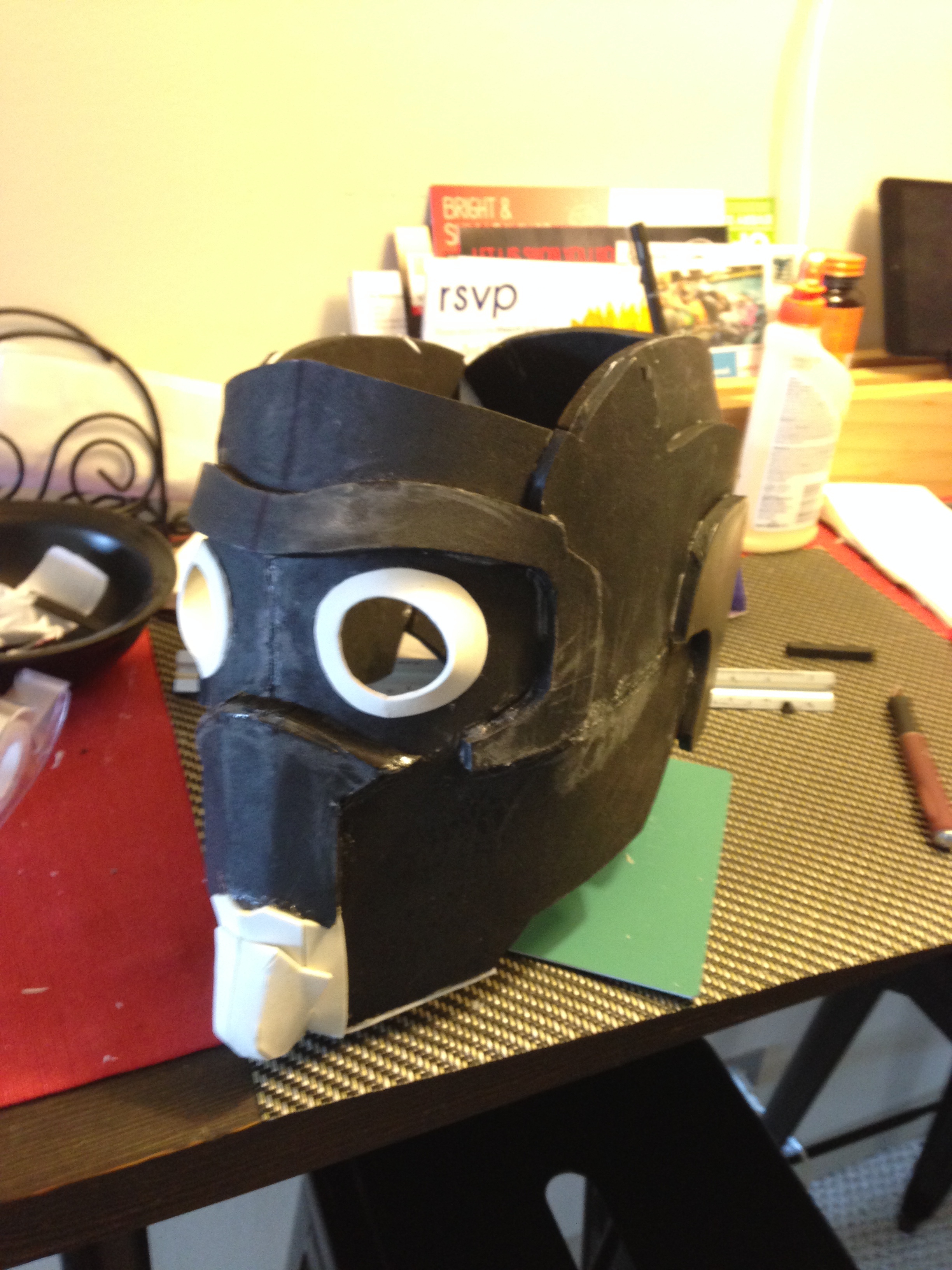

This is my foam mask so far, first time for me using foam and making a mask. Any tips on what to coat it with to help smooth it out?IMG_4812.JPG
