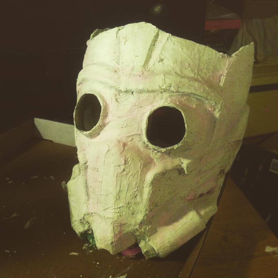

Because it was winter, I went with fumeless methods of hardening the pep. I tried EVERYTHING: spackle, patching plaster, Rock Hard, and wood filler. I sanded forever!

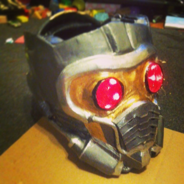

Eventually, I got to a point where I felt okay with the finish. I plastidipped the entire thing, then painted it with Rustoleum hammered pewter.

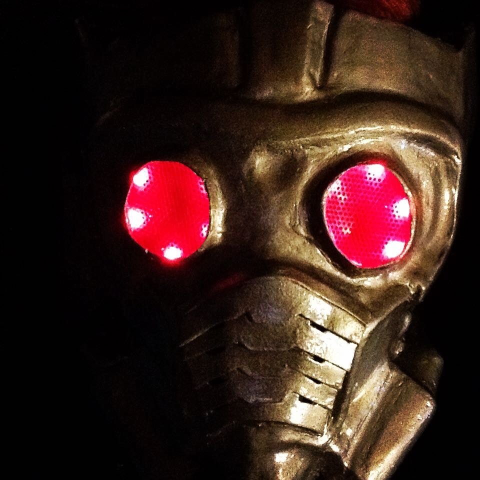

LIGHTS! The eye pieces were a 5 step process XD. I made circles from apoxie sculpt and then mounted round red lenses from a pair of Lennon glasses. The LED's are half of a 2 set pack I bought on amazon for like $5 dollars. and across the lenses, I placed window film (spidey lenses) that I painted red (with acrylic, like the cheapskate that I am). I then mounted the lenses and the LED set in the helmet, with the battery pack and switch easily accessible on the left hand side.

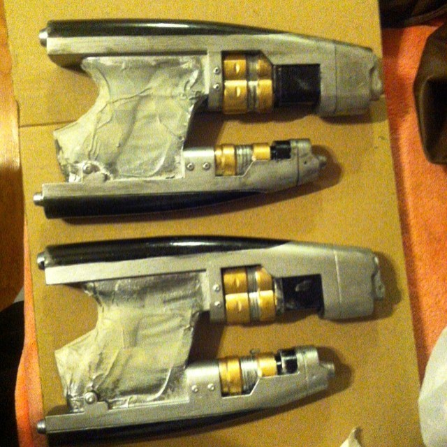

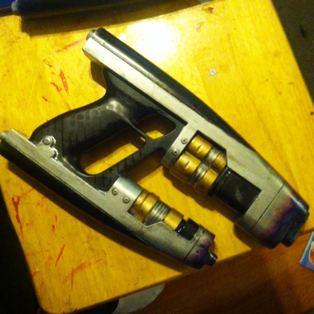

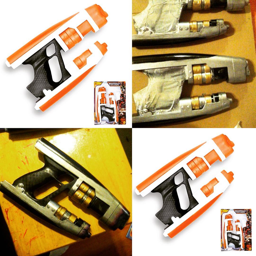

All the photos of the guns put into one shot. I was pressed for time and had 2 costumes to finish for the con, so I went with the Rubies guns. I primed them, then painted with enamels. Top right is unweathered. I then went over it with shoe polish. I did the heat scarring with a scrap of upholstery foam. The next photo is for detail.sorry for the small size.

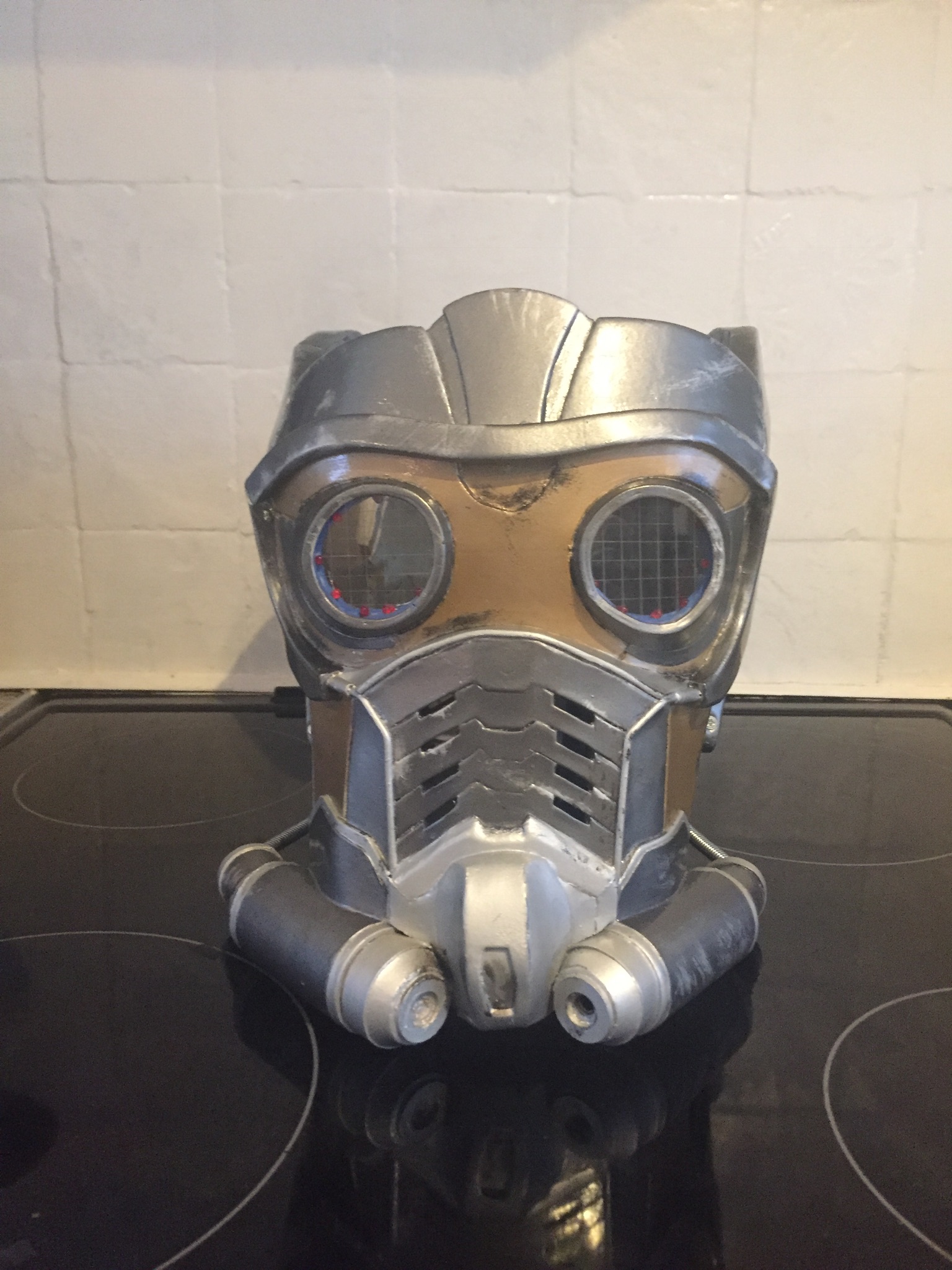

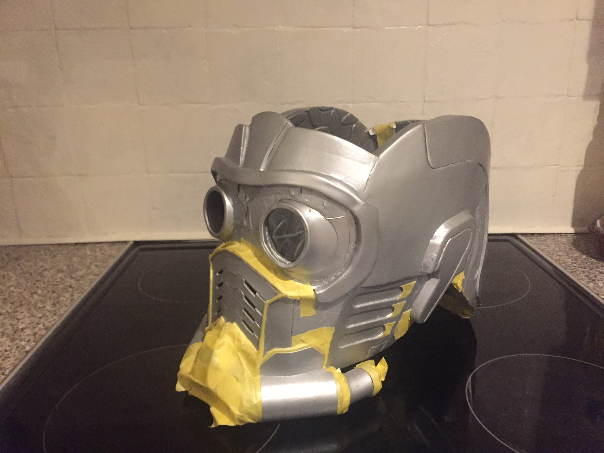

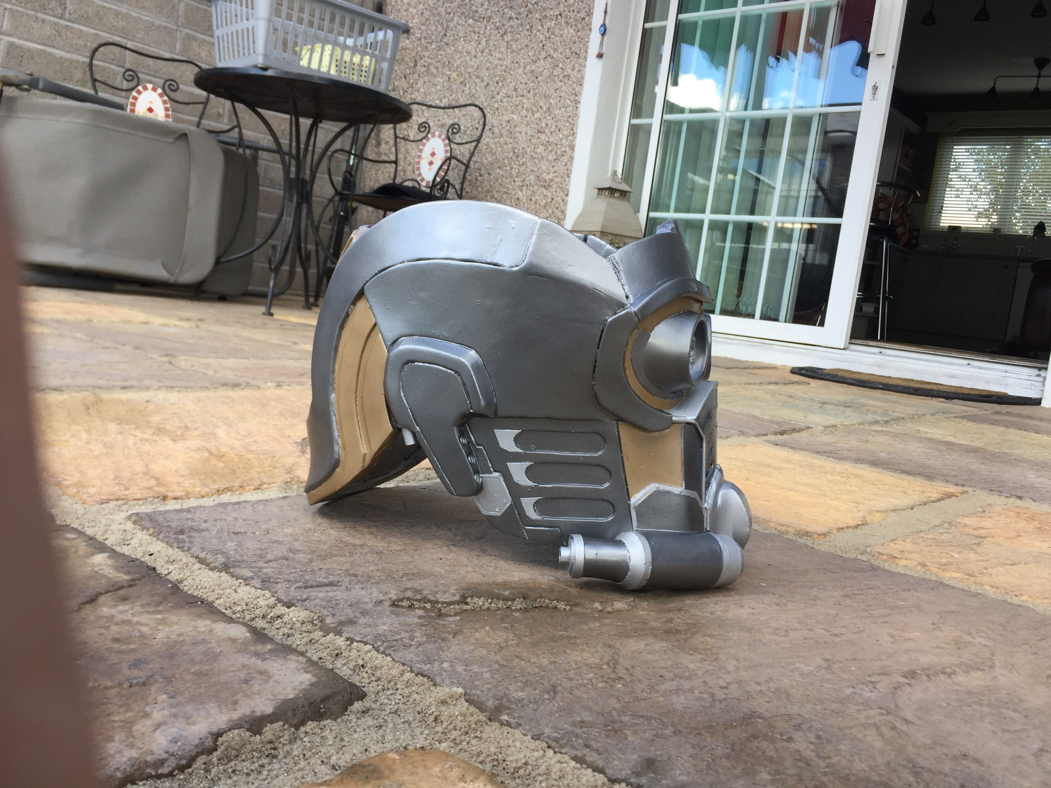

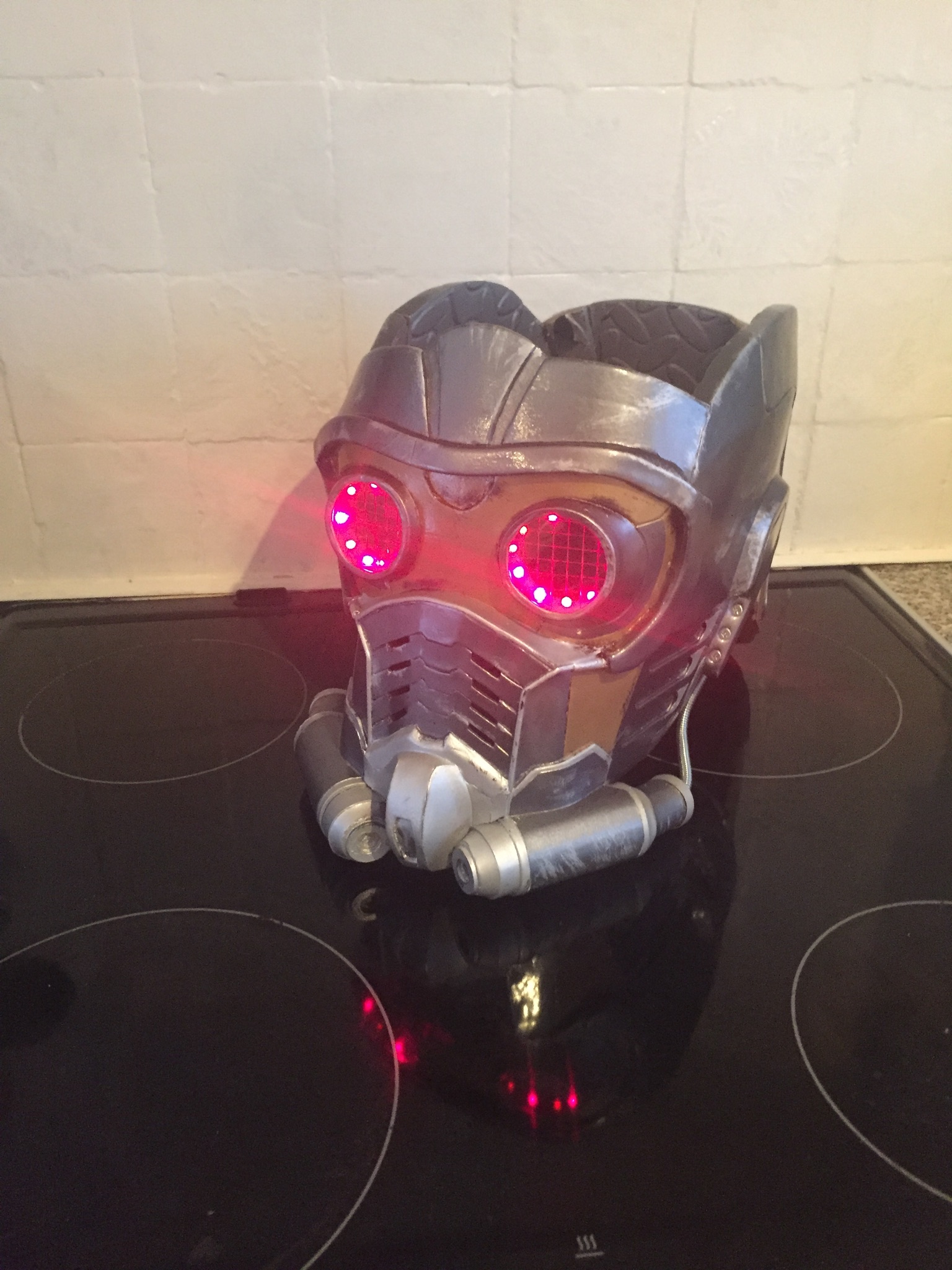

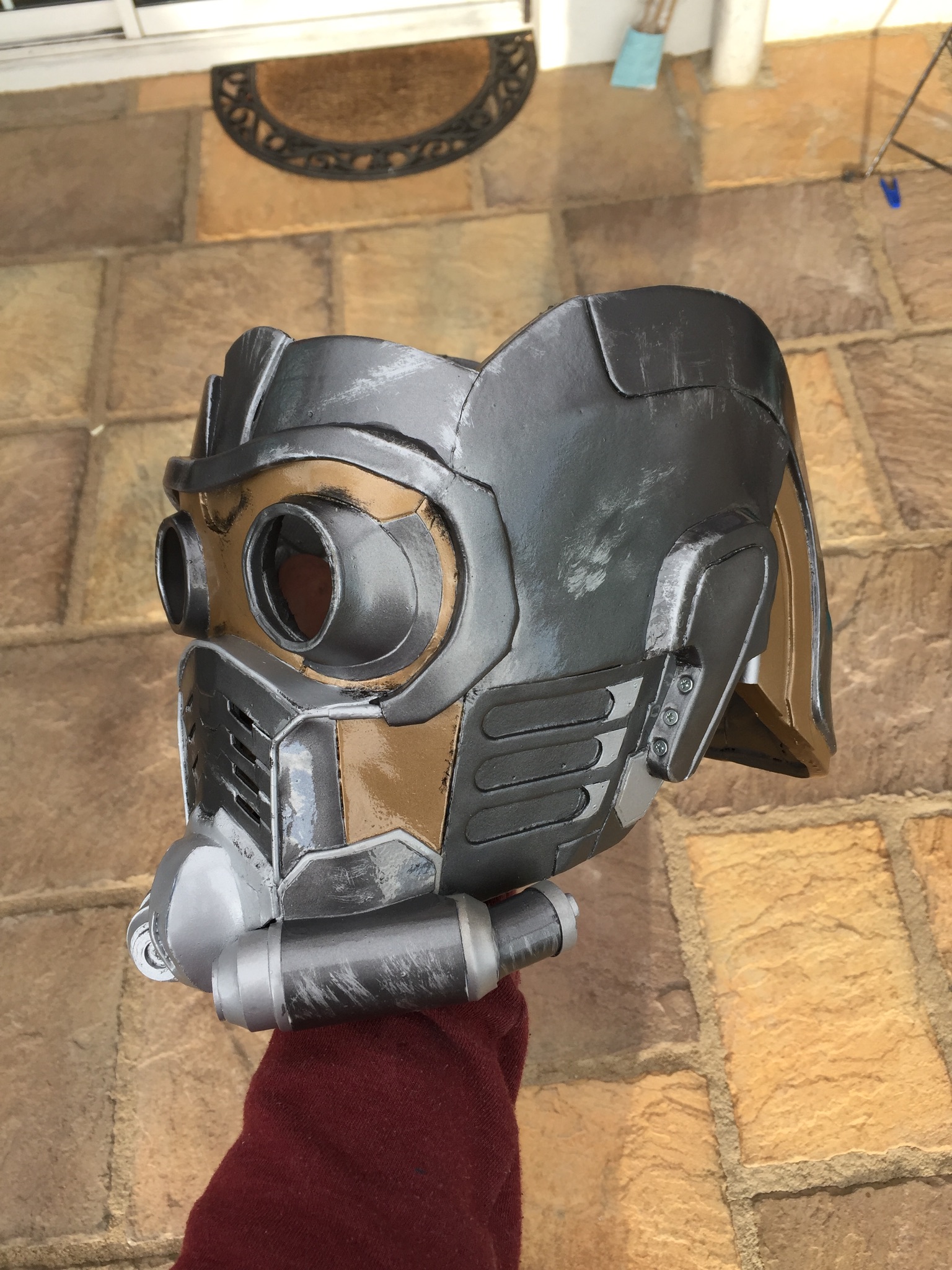

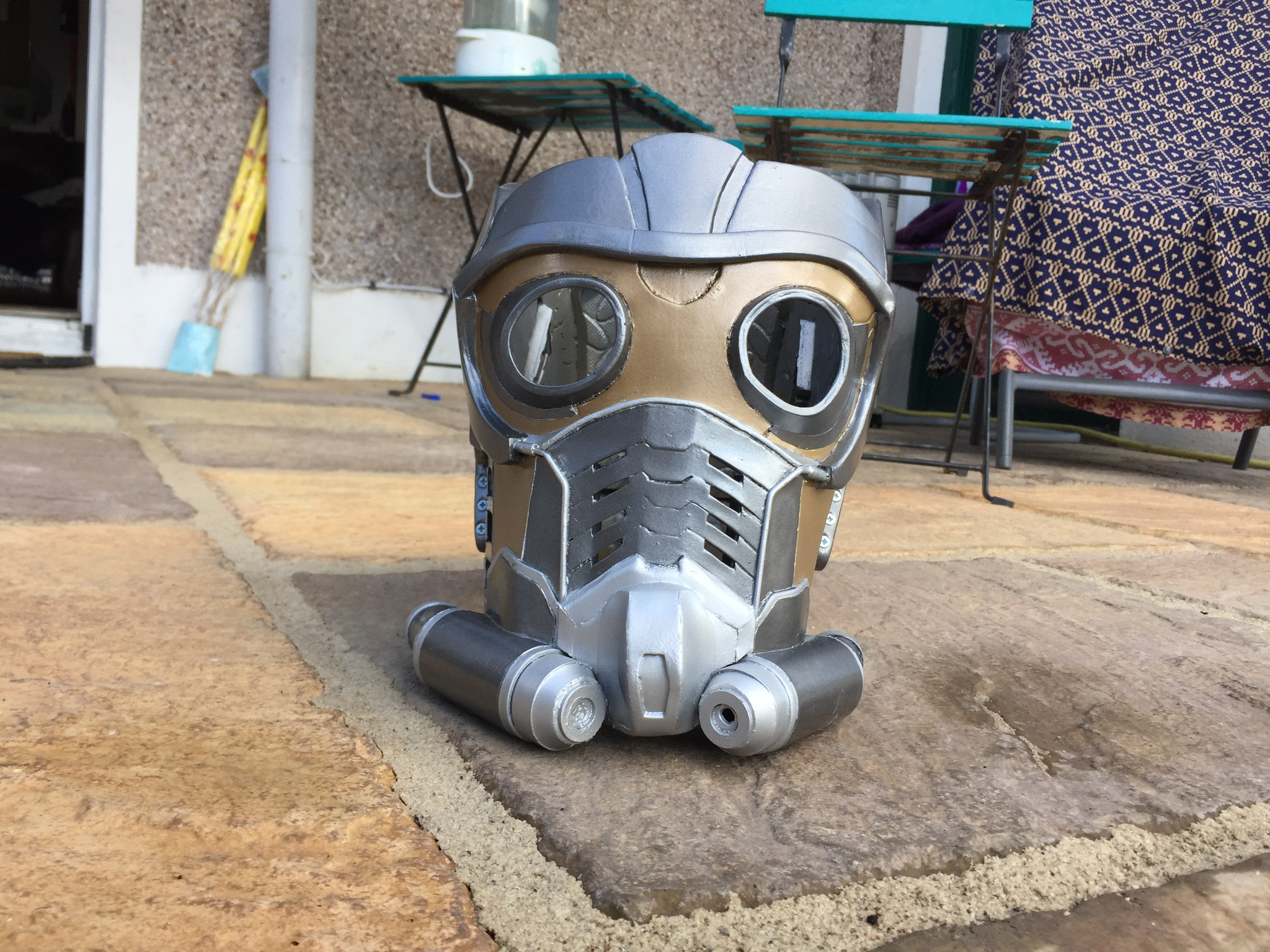

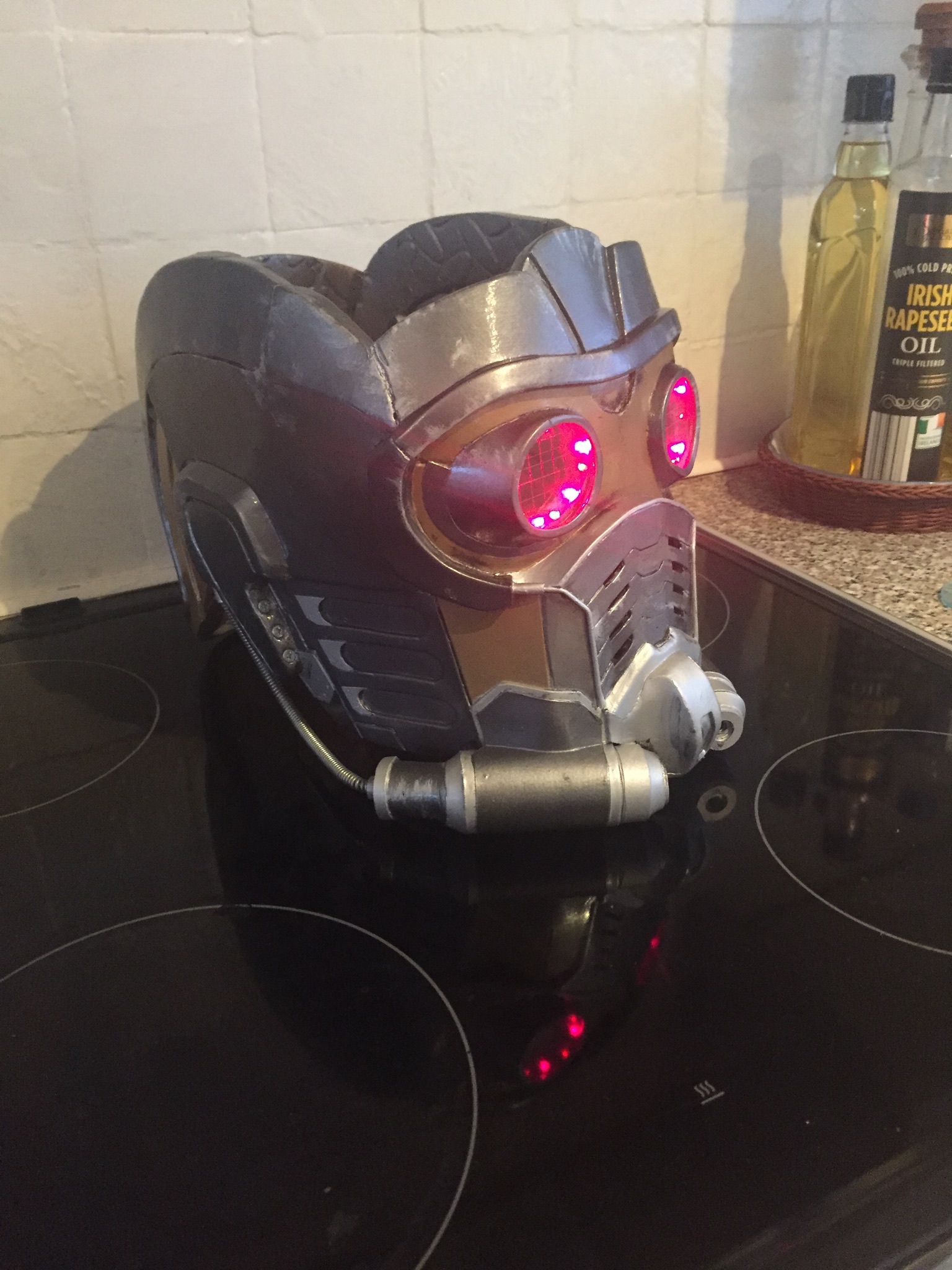

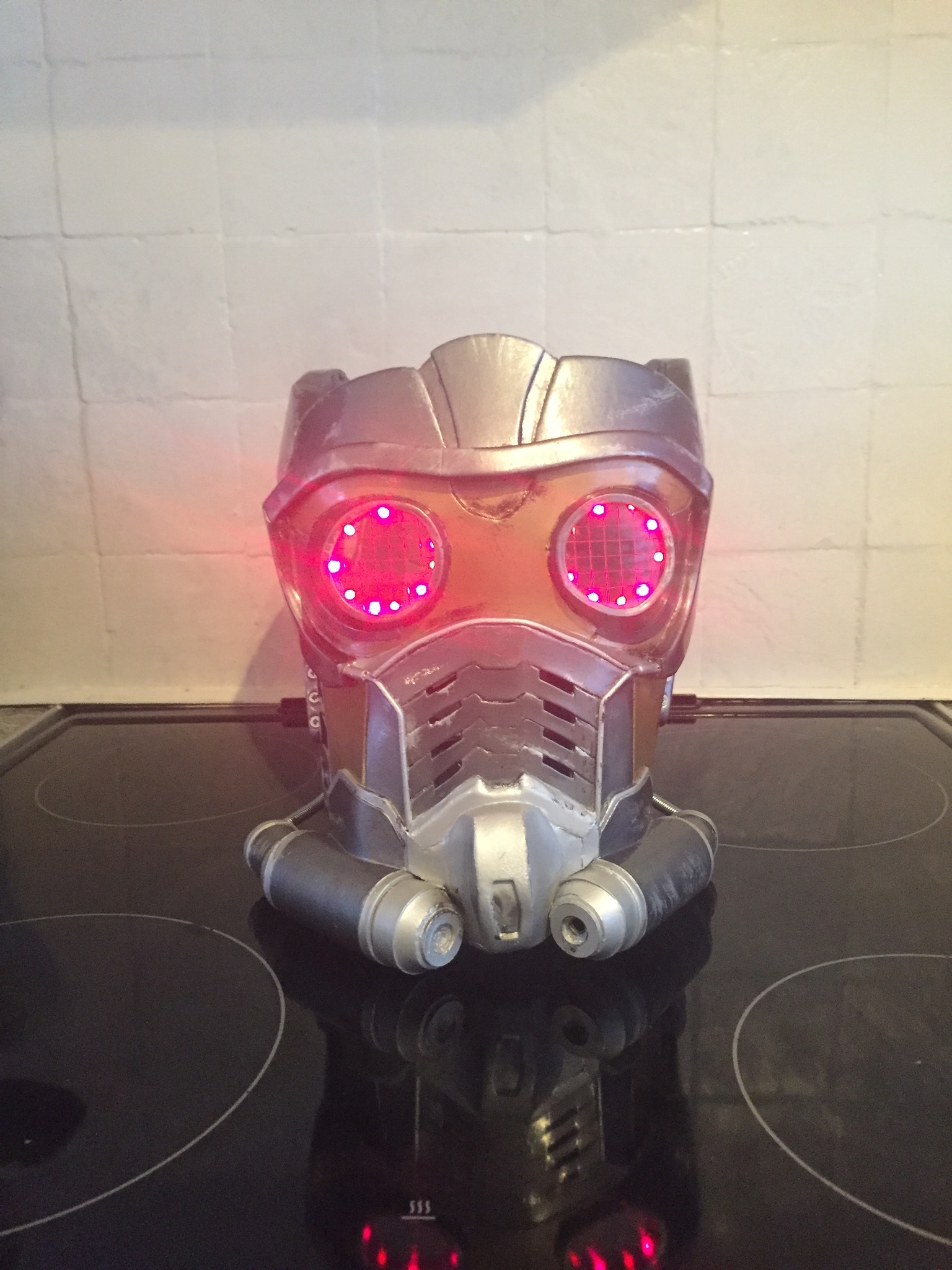

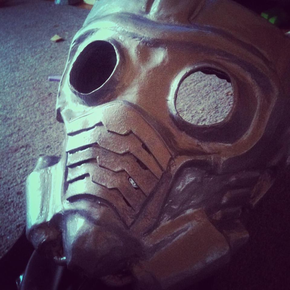

Sorry for resurrecting a dead thread but i've been looking for an answer to this for a while. I recently finished my foam helmet, partially based on the files here. have people found a good solution for the tubing and connections on each cheek?
I'm having trouble finding a nice simple solution for the little connections at each end of the tubes. they're quite distinctive and since they should be identical i'd rather find something i could re-purpose rather make them from scratch.
a few pictures taken so far:
I used aluminum wire inside small clear rubber tube. I can take pics if you want, but it's pretty simple and self-explanatory and it's not 100% perfect but it looks good.
Thanks for the quick answer. I didn't quite make myself clear though I think. What about the little connectors on each end of those cylinders? They're like the 90 degree elbows that curve the pipes back into the mask.
Maybe that is what you mean. The pics might help.
