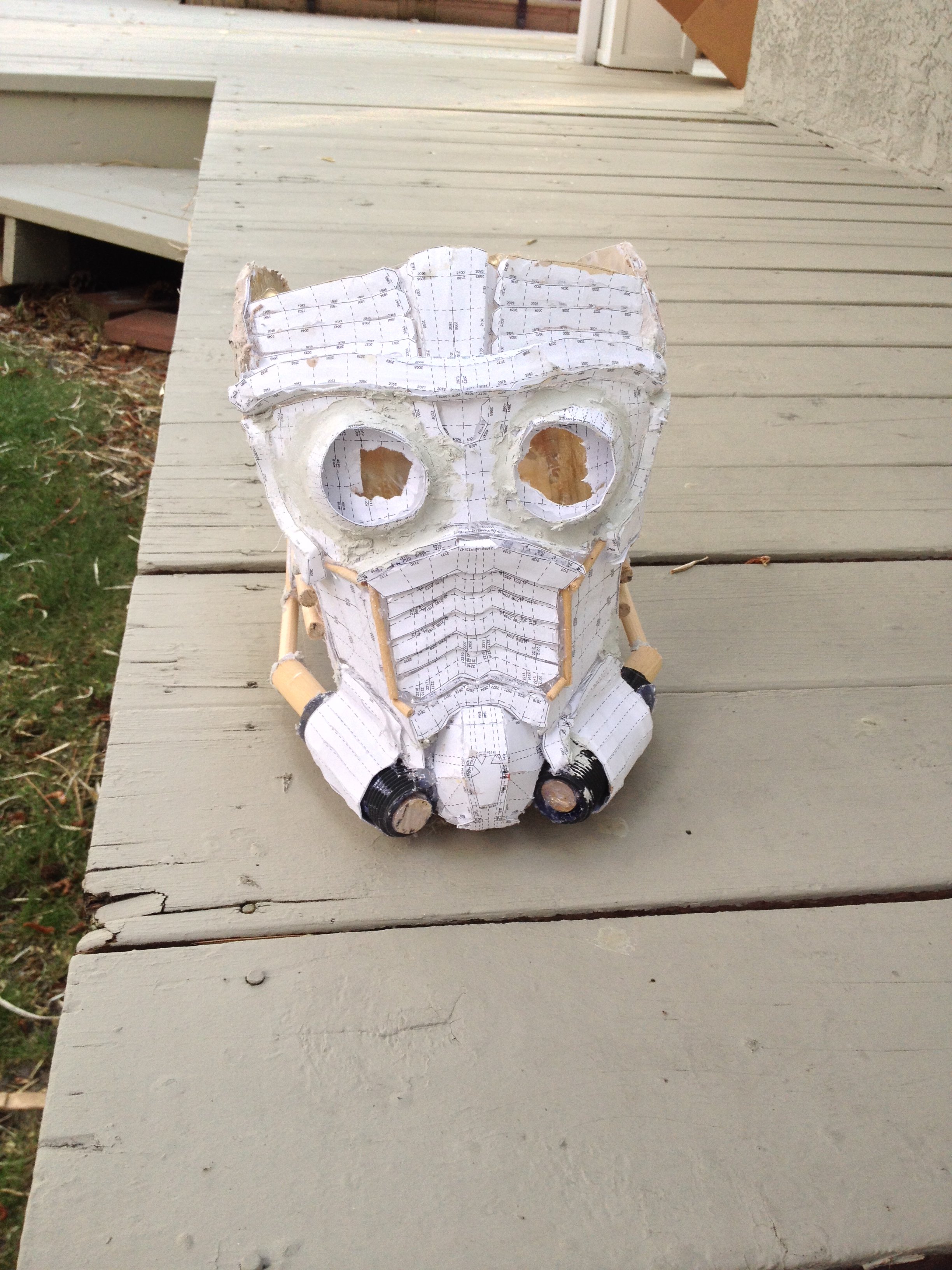

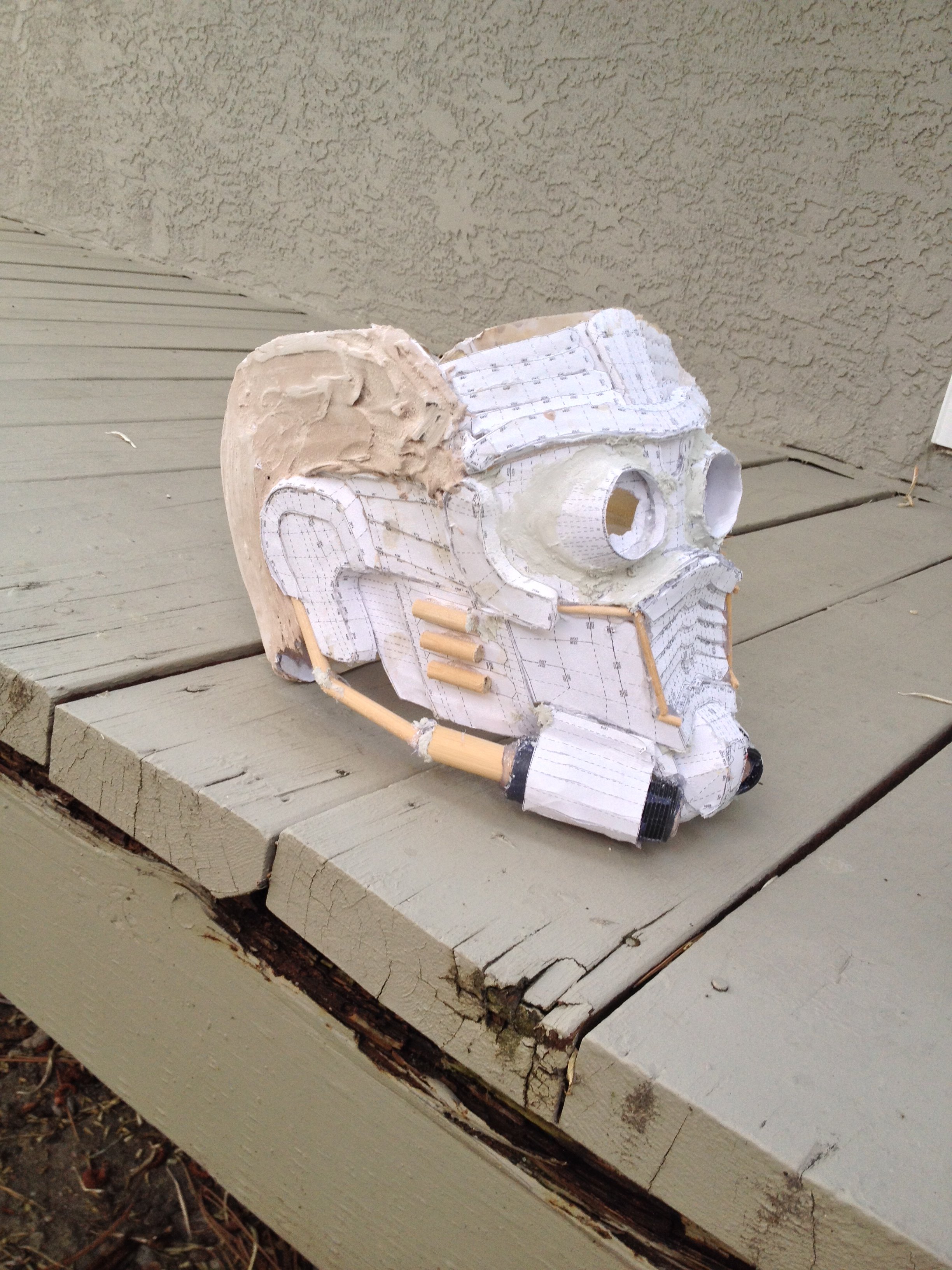

I've been building my own pepakura of the mask and had a few questions since this is my first time building anything like this.

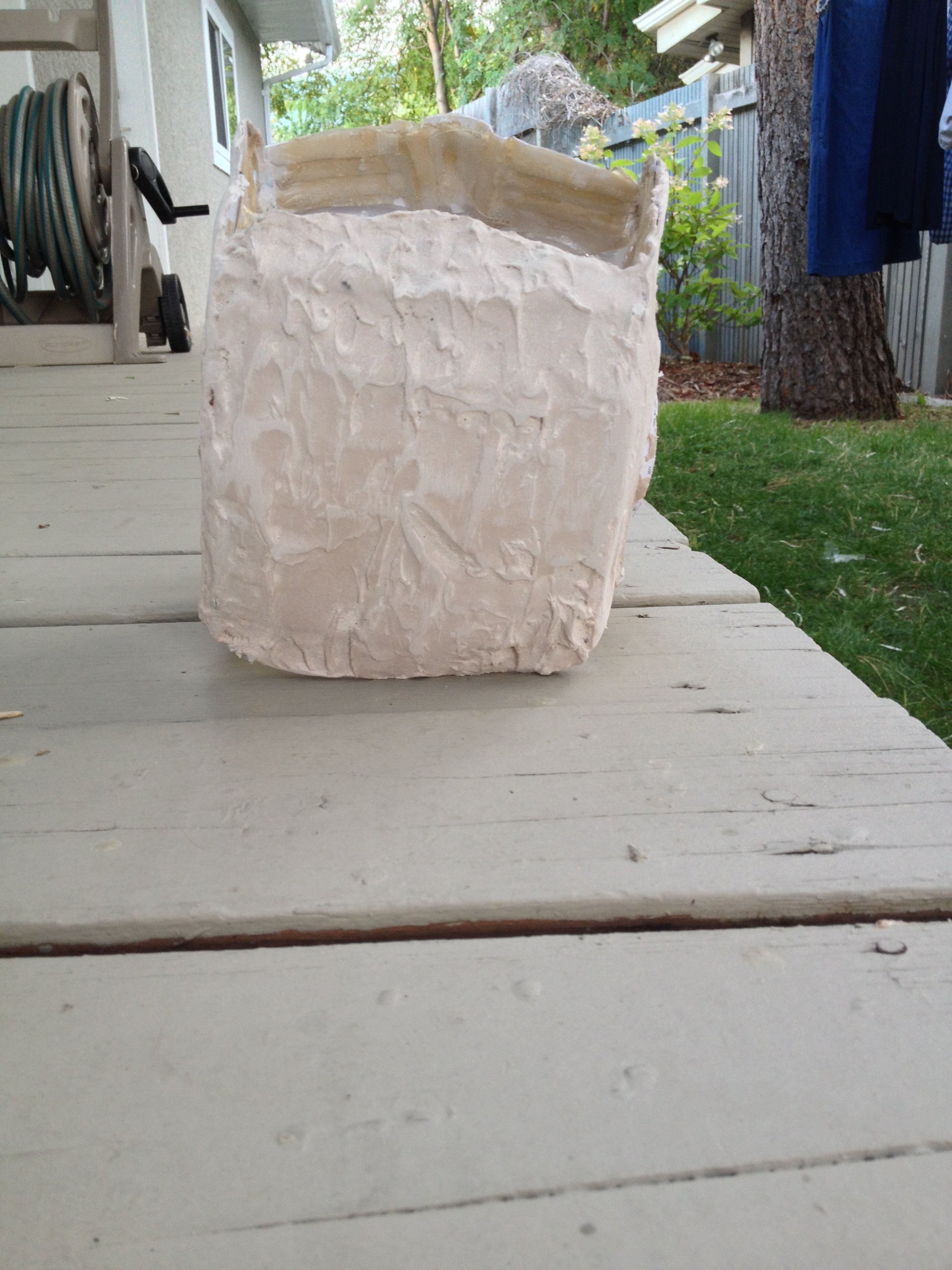

I fibreglassed the inside using the Bondo brand Fibreglass repair kit. I was wearing a respirator during the application of the stuff and i did it outside. The stuff smelled terrible for a day or so but never completely went away. I've been keeping it outside but i'm hesitant to even go near it without a respirator after everything i've read about the fumes. Anyhow its sat outside for a few days now but there is still a strong resin smell coming from it if i get within a foot from it. Can anyone tell me if the smell with go away or if there is anything i can do to eliminate it.
Anyway i've included some pictures of the mask as it is today. I started to Bondo the back so thats only the first coat. I constructed the tubes out of dowels and a pvc pipe. Overall i'm really happy with how its looking never mind how it smells.

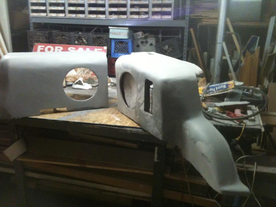

for fiberglass when it's fresh it is still going to have its unique smell. It should go away when you sand it. Ask me how I know.12100_773635355981621_1836491114_n.jpg1912164_779177112094112_8385272162819265938_n.jpg (sub boxes for my truck). right before I put them in I put some fiberglass resin on the back for reinforcement, and the smell stayed for a few weeks, because I never sanded it. The kit says to put 12 drops of hardener per batch. I always up the ante on the hardener. It never seems to dry completely the way the directions specify. To be dry to the touch it can take hours. Fiberglass is a very time consuming art.
for fiberglass when it's fresh it is still going to have its unique smell. It should go away when you sand it. Ask me how I know.View attachment 362915View attachment 362916 (sub boxes for my truck). right before I put them in I put some fiberglass resin on the back for reinforcement, and the smell stayed for a few weeks, because I never sanded it. The kit says to put 12 drops of hardener per batch. I always up the ante on the hardener. It never seems to dry completely the way the directions specify. To be dry to the touch it can take hours. Fiberglass is a very time consuming art.
So upping the hardener and sanding down the resin should remove said unique smell?
Yeah. the upper layer tends to be softer. when I was doing my stuff, the top layer would still be tacky, so I would sand it down and it became deglossed and it was dry to the touch. It should get you there. If that doesn't work in your case just give it some time and the smell will dissipate. personally the smell doesn't bother me. I just made sure to wear a dust mask when I was sanding. You're definitely taking the best safety measures for yourself in your situation so kudos.

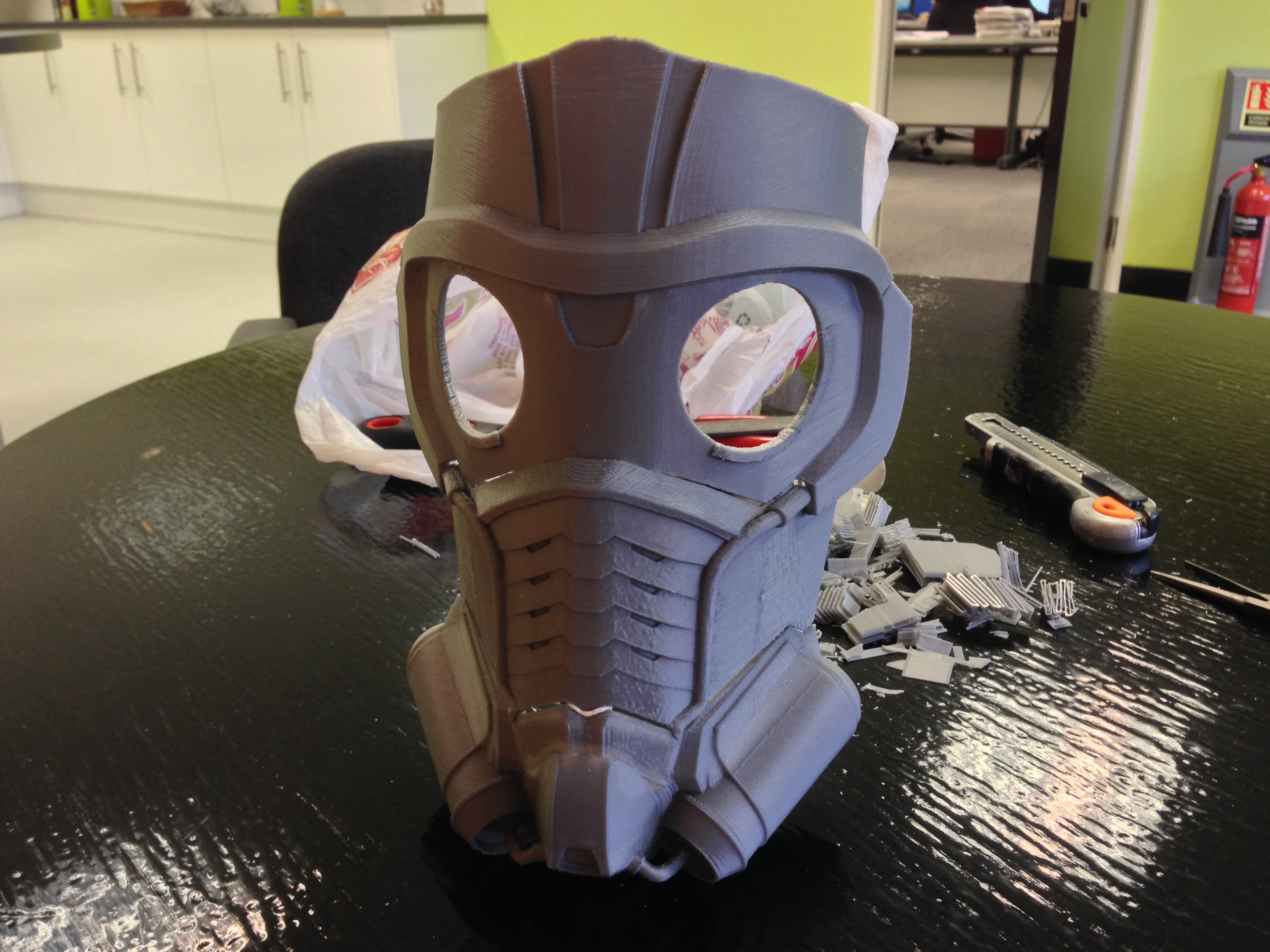

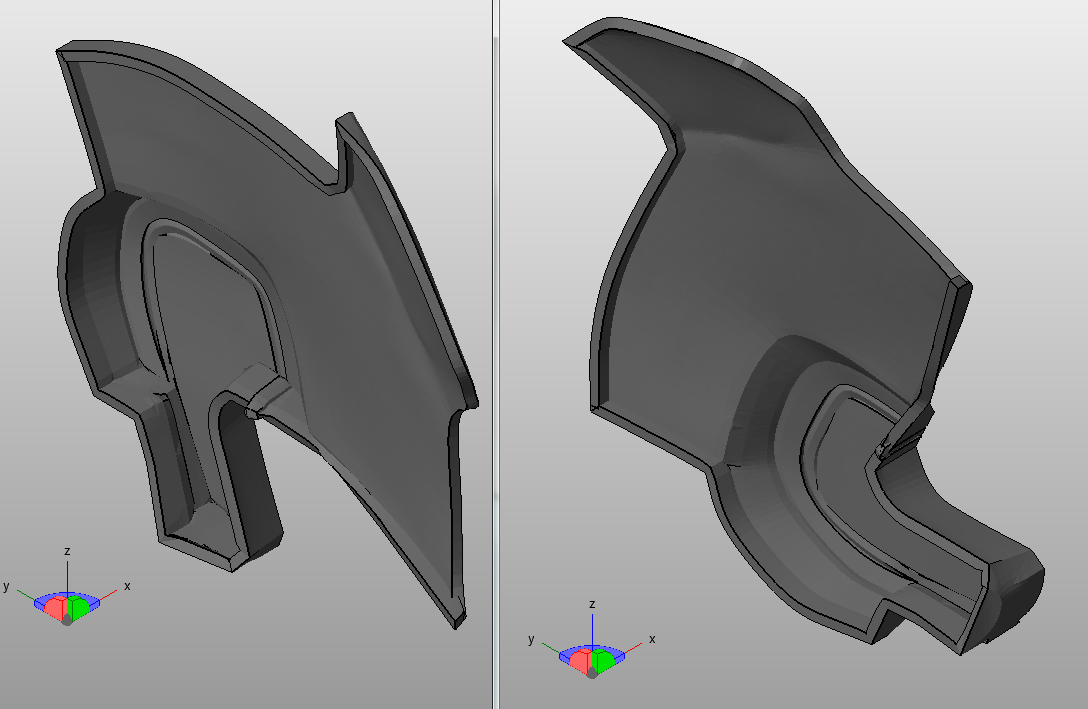

Just heads up guys, I've been looking at rotating my parts before printing to reduce print times and wastage. I've printed the front three pieces as they came as their orientation looked to be about right for efficiency.
I've now taken MASK_TEMPLE_LEFT and rotated it 90degrees and according to a gcode analyzer the print time has reduced by 3 hrs 45 mins and used 8 meters less filament. That's with raft and full support over 60 degrees.
Naturally the print lines will be in a different direction, but this won't matter if you're going to smooth it.
