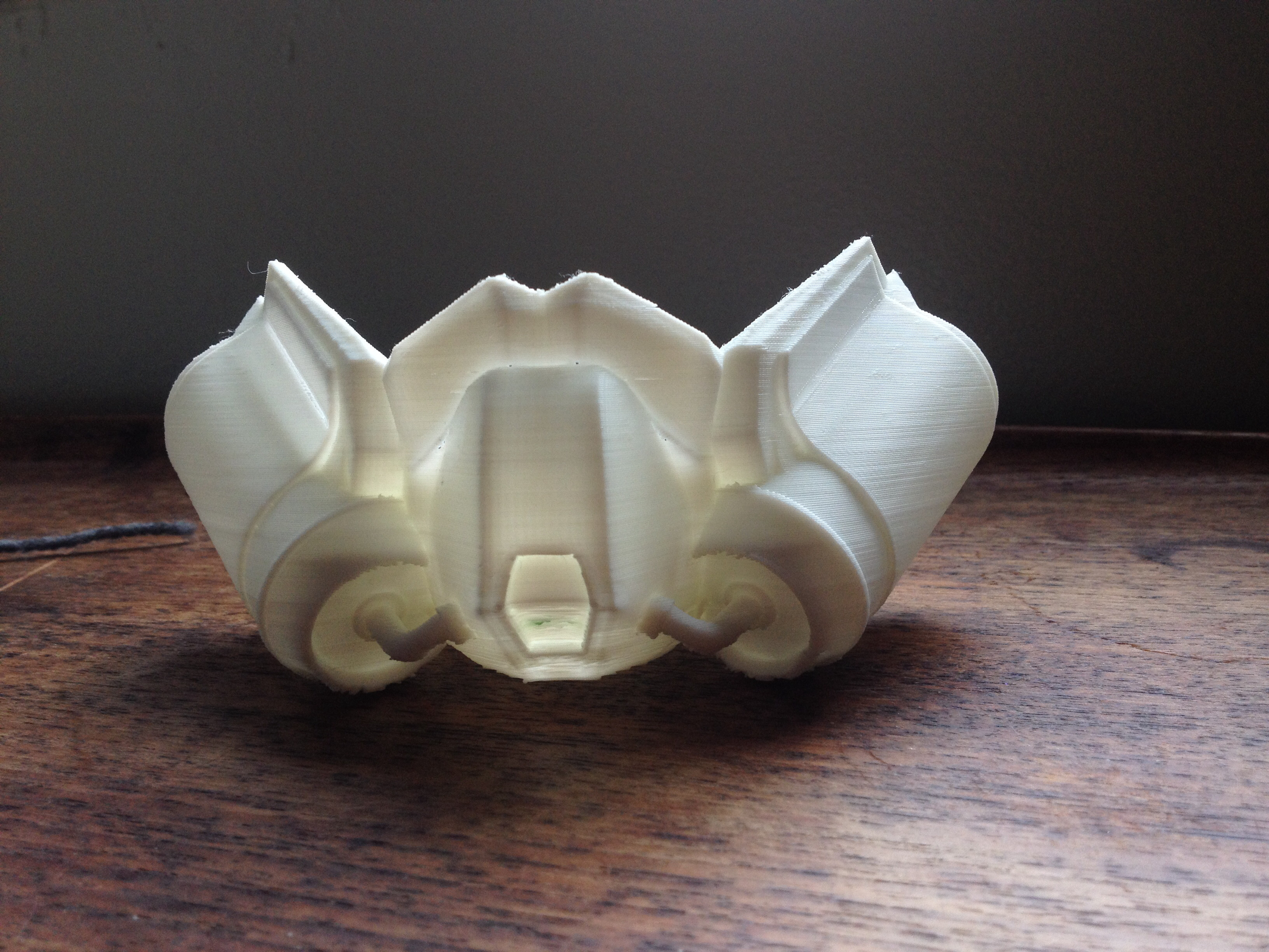

Longtime lurker, rarely feel like I have anything to add so almost never post, but figured I'd put up some print pics for a little change.
I'd forgotten to adjust the e_steps per mm on my printer for this white pla I got, so it was slightly underextruding and caused some janky sags on a few of the overhangs, mostly underneath the round parts. Since I'm going to fill and sand it anyway, I'm not too concerned.
.3mm resolution, 10% infill, white PLA, ~4 hour print
This was by far the most complicated thing I've printed so far, but I was getting so tired of little trinkets and calibration pieces I wanted to go all-out on something awesome. I also haven't played with support material too much, so learned a lot on that end as well.
Again, thanks a ton to Helagak for the models, they look great and print wonderfully. What a world we live in where an enthusiast on one part of the planet can create these wonderful objects and another enthusiast somewhere else can watch his creation come to life in their own living room!
Edit: I forgot to mention that I DID adjust the models to the suggested .88xxxx scale and comparing reference photos with the chin piece I printed, scale seems spot on! Can't wait to finish printing this beast!
