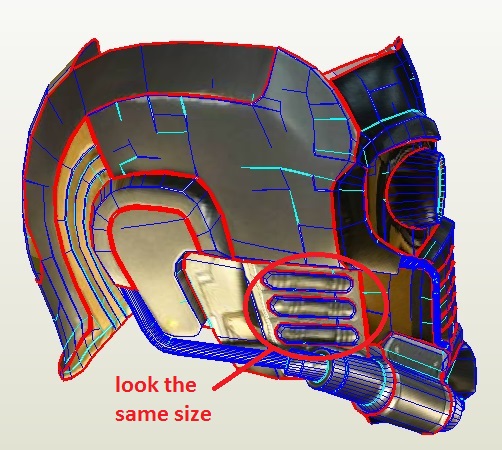

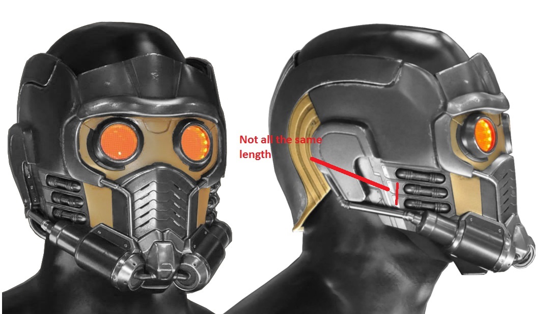

First, I give great thumbs up to Helagak for his work.
I have just one issue. The side pipes are not all the same. The all look the same on his Pep. Not trying to trash anyone and I am supah-dupah grateful for his work, but just wanted to mention this discrepancy.helside.jpghelsides.jpg

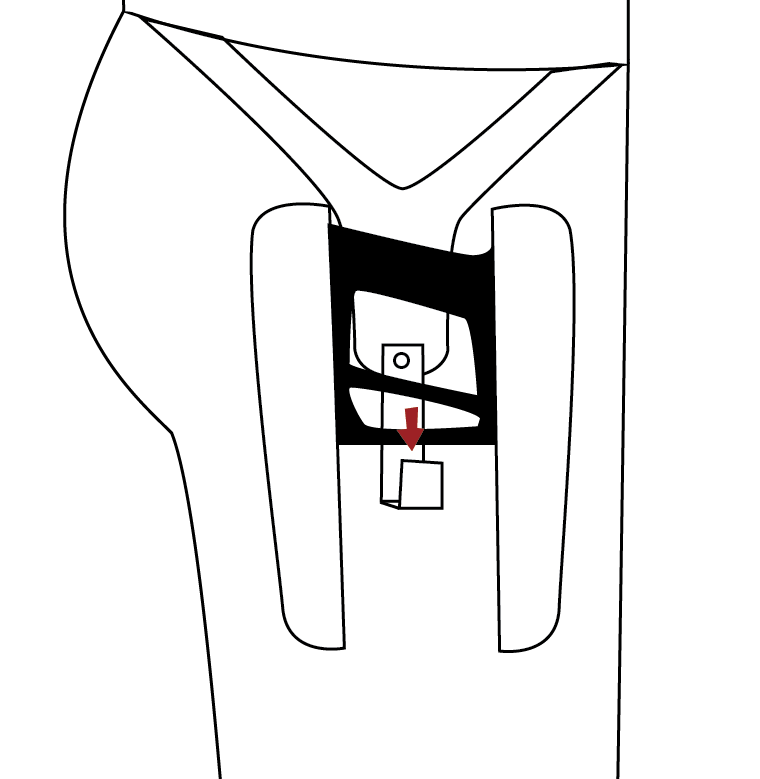

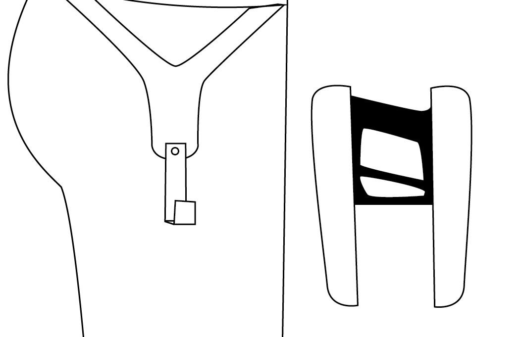

This was my plan. Some sort of strap that had a hook attached that the front hand guard could rest in.
Screen Shot 2014-07-07 at 1.56.36 PM.png Screen Shot 2014-07-07 at 1.57.34 PM.png
Excuse my 2 minute drawing from illustrator. But after seeing these pics, rather than just a strip, a full holster pad with an hook integrated in might be more accurate. but still, should it attach to the belt, or the pants or both??
From the behind the scene photo the way that the gun moves with the leg I assume the belt, holster, and leg padding are all attached together with some sort of clip
IronManic, I assumed the rendering is different from the actual one used but the only few clear shots I've seen of the holster are the same style as the rendering where it is tight up against the leg with no gapping while walking

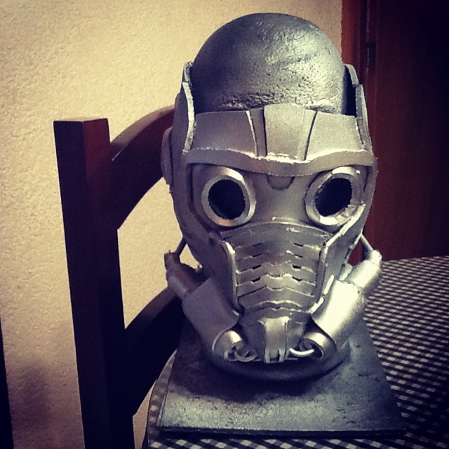

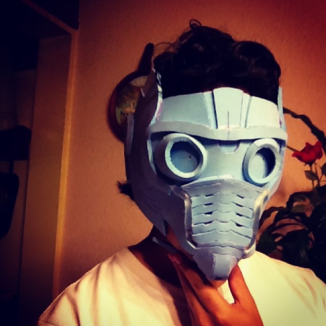

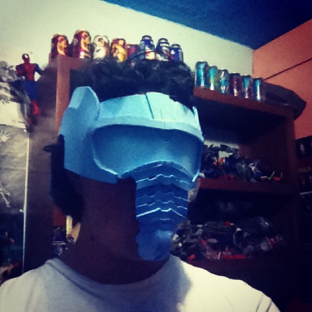

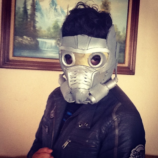

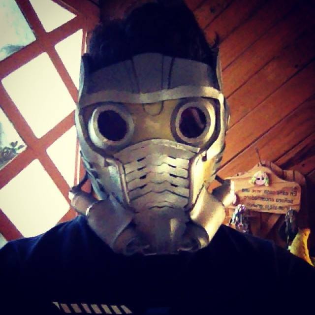

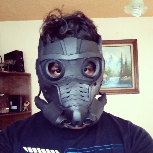

GUUUUUUYS! i finished! This is my Star-Lord Helmet thanks to all of you guys who helped in the made of the pep file. I used a foam bed for yoga or something like that, tubes from a breather that my grandma gave me (its ok she only use it to sleep), plasti-dip, gray metallic and gray pearl paint, some wires to fit the tubes, also light foam the one you can bought at your local stationer's shop, also the gold paint is from one of those cans of acrylic paint, the lenses are made of cellophane, amm i think thats all. If you wanna keep an eye on the process please feel free to visit my Facebook Page http://www.facebook.com/spinoprimeofficialpage
Here i was starting to build
Here it was almost done except the breathers
Completely done with Plasti-Dip already done too
Here with the metallic gray but it was kinda too shiny so i decided to buy another one more darker
And here all the paint is done (ignore the jacket, i still struggling about getting it)
And Finally the final product
View attachment 346553 View attachment 346554
thats the same way i did my holsters last summer when i had this first draft costume
Based on a quick scene in the IMAX preview, I'm leaning towards the leather pad being sewn on to the pants, so that's probably what I'll do

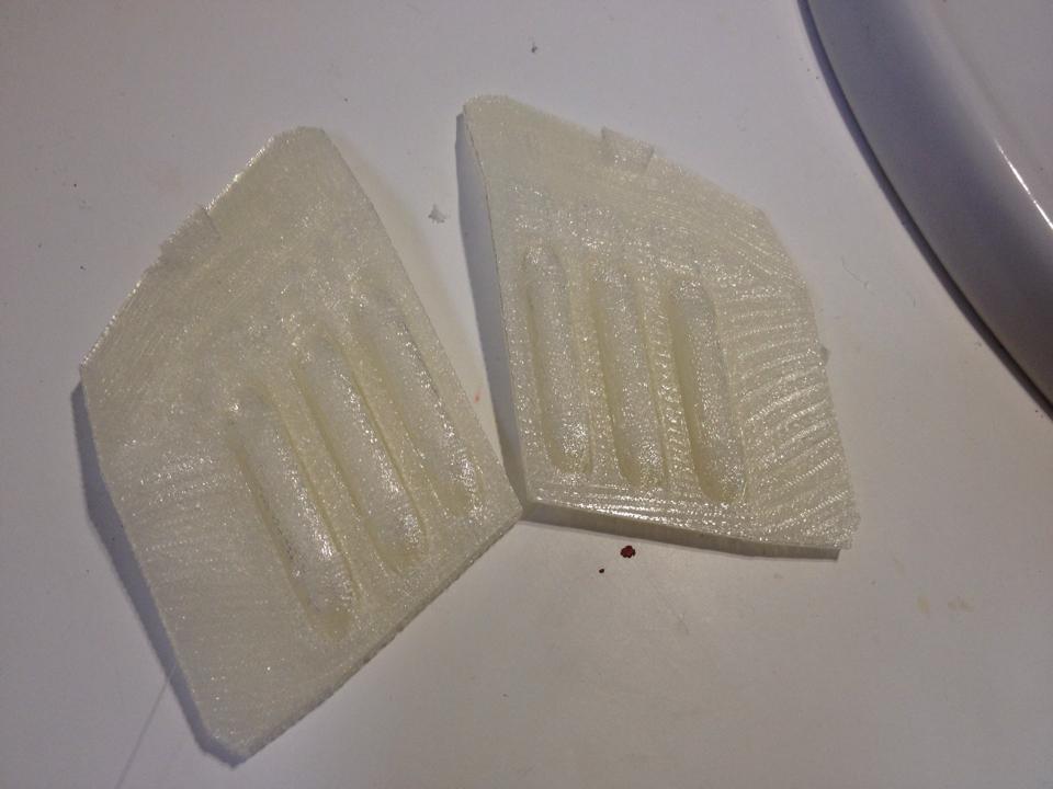

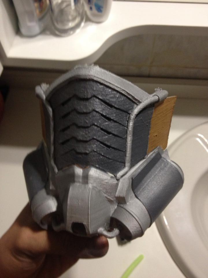

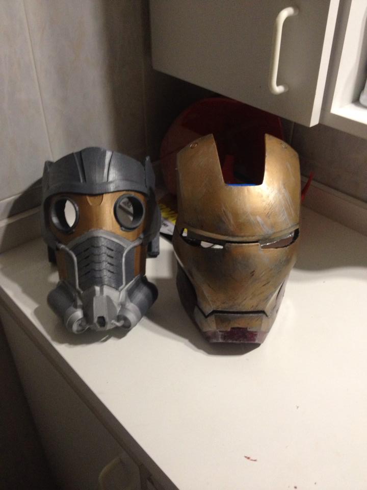

Hi Helagak im working on the star lord helmet paint right now.... let me share some pics!!!:thumbsup

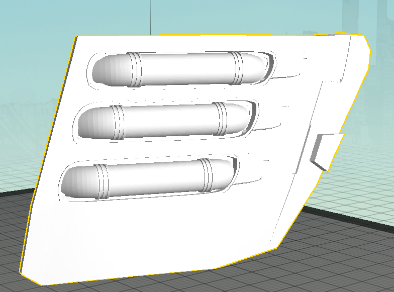

I got some problems to print this part
i cant print yet cause is so slim :( and is giving me troubles to print
@SpinoPrime Nice Foam Build!!
@jhondesousa sorry about that. It seems to be a tricky part to print. I was going to go back to the model and increase the thickness for you, but I left the jump drive with all my base models on the other side of the state this weekend!! x_x
One Idea i have it drop the piece into your slicing program (or netfabb would work well!) and orient it so it is standing straigt up (doesnt matter if its sitting nicely on the bed at this point!) then have it pointing directly in either the X or Y direction and the go and scale up the oppisite direction. this will in effect increase the thickness without effecting the other dimensions. Hope this can help.
