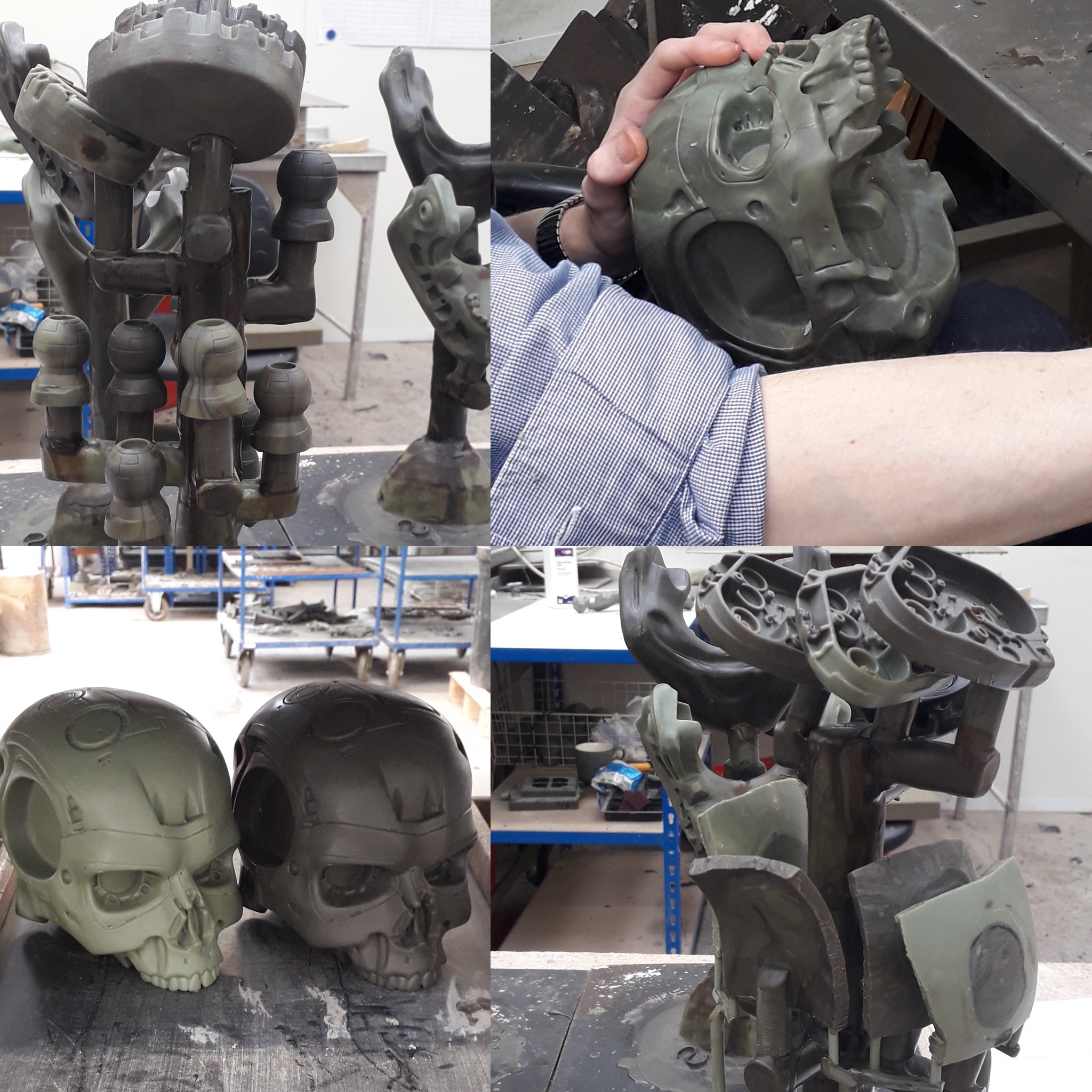

Using Mold Max 60 High heat silicone, I created molds from recast pieces of endo skeleton. I then cast pewter into the molds to create the individual parts.
As well as finding screen accurate parts to go with the parts I cast.

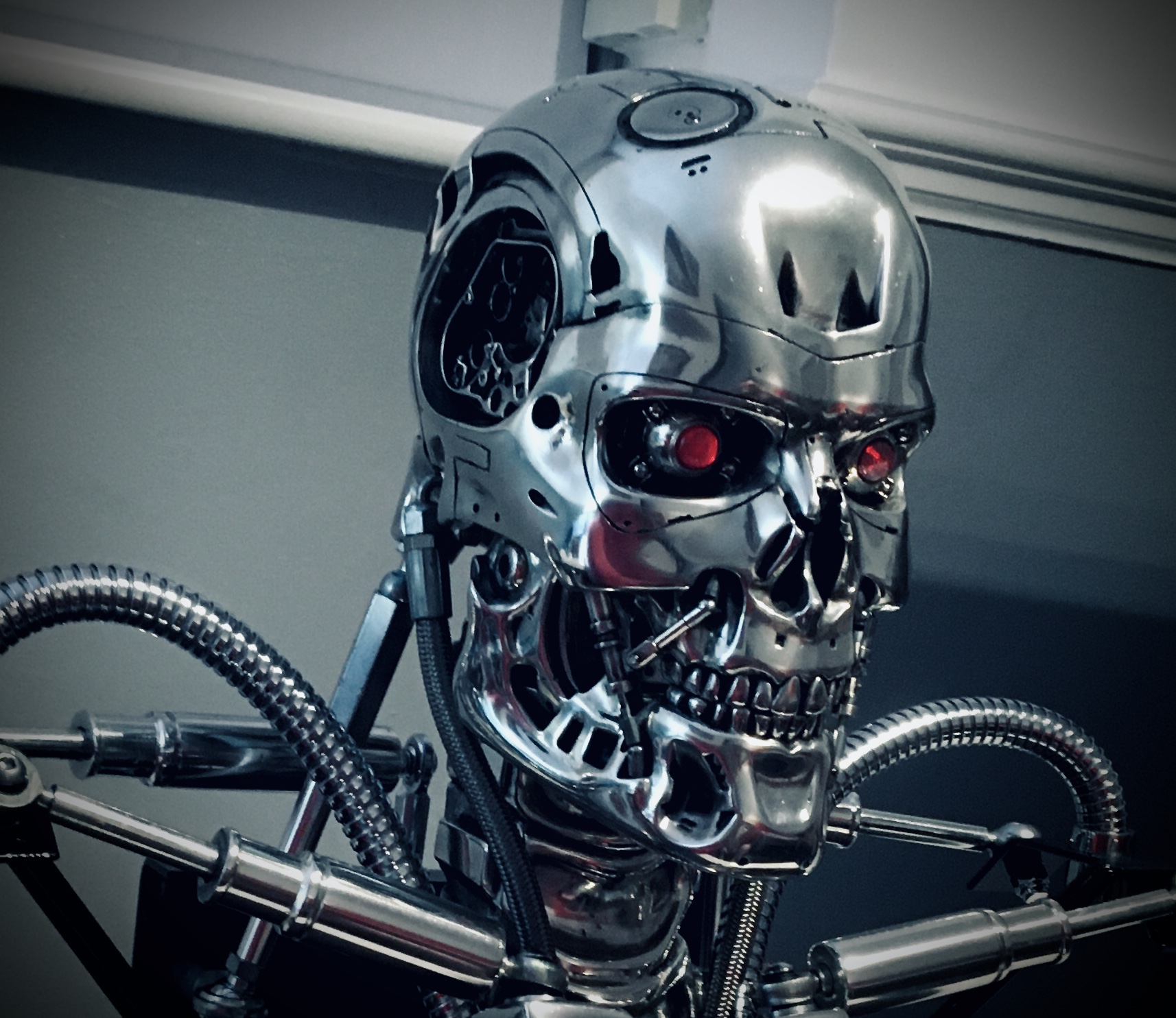

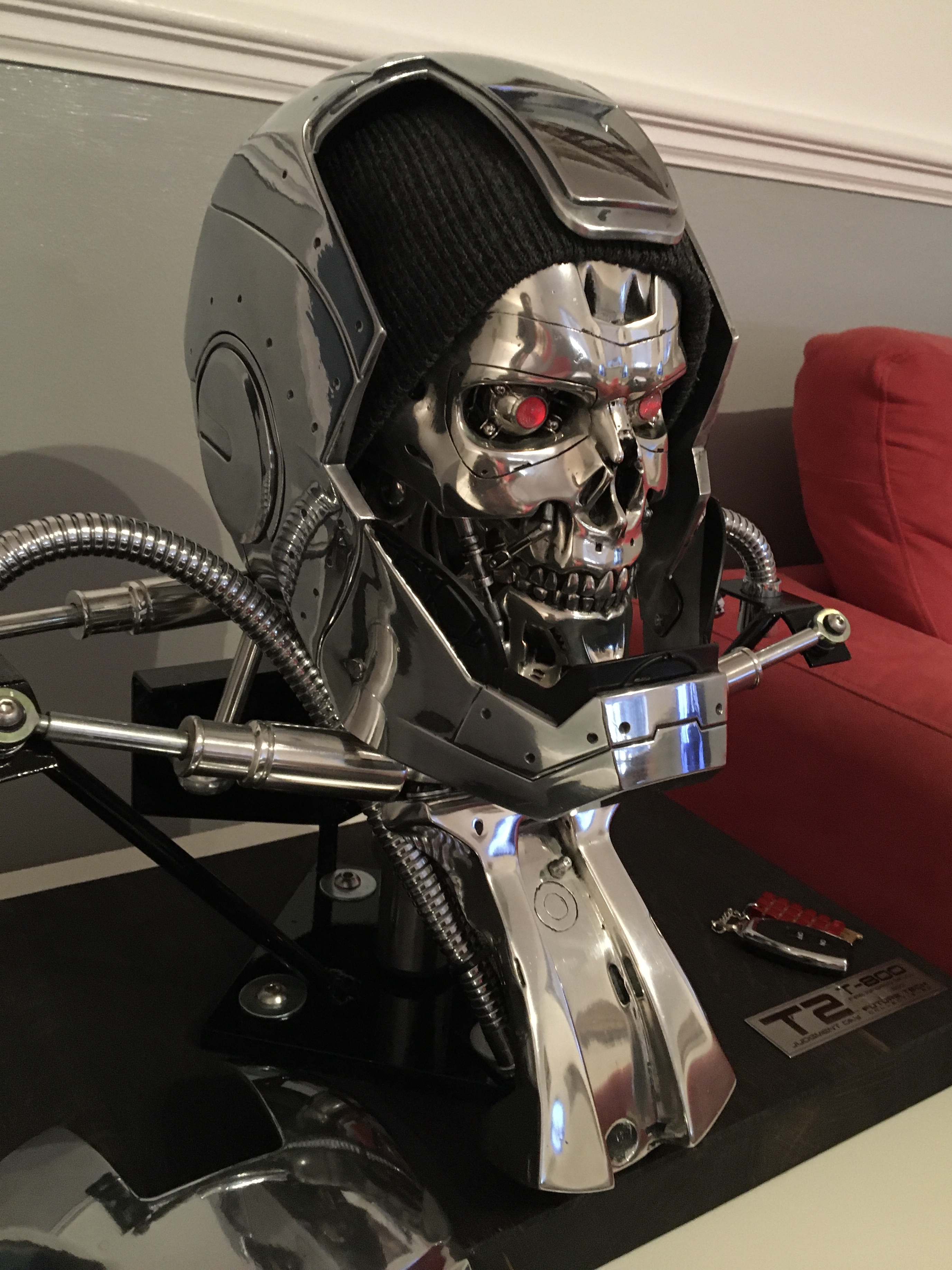

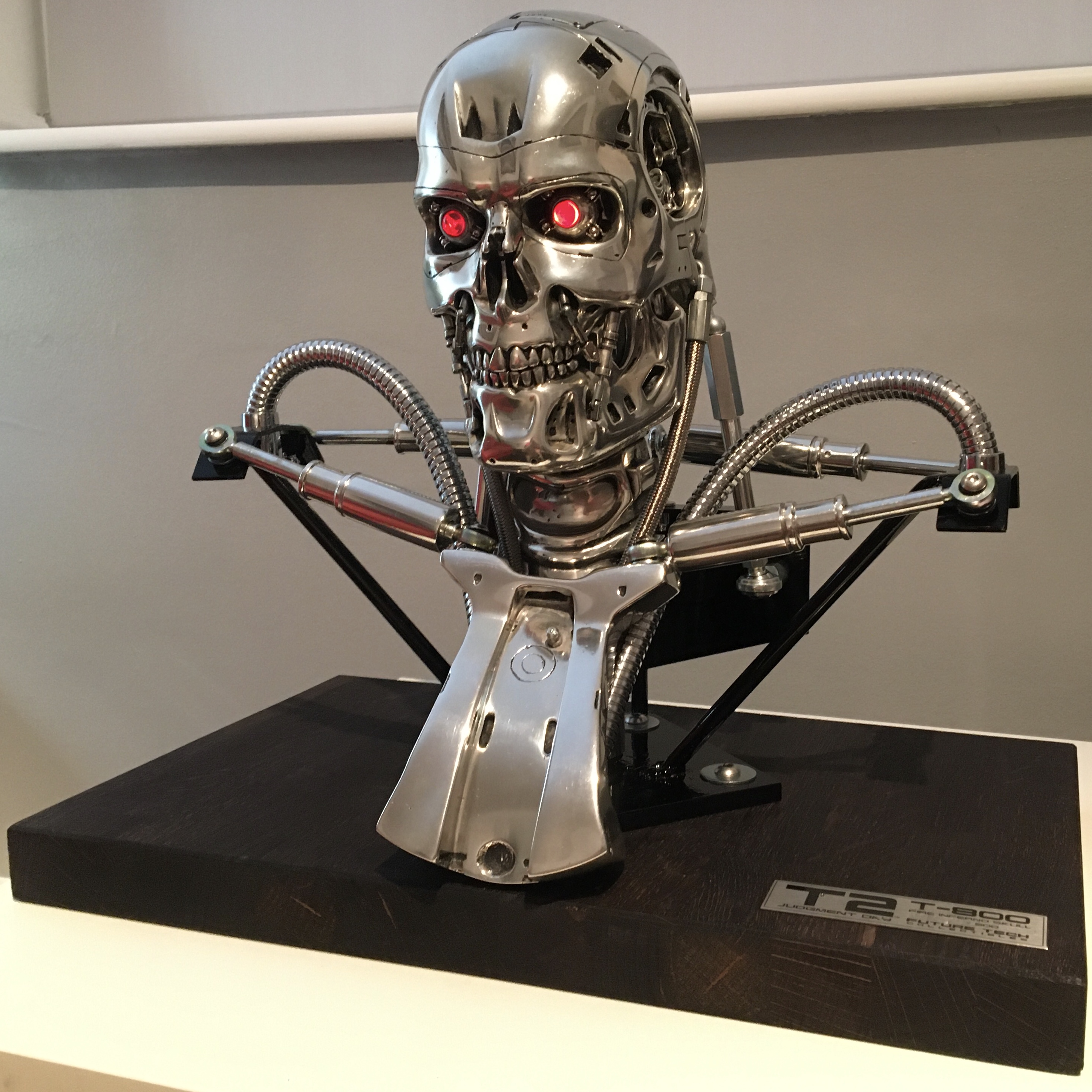

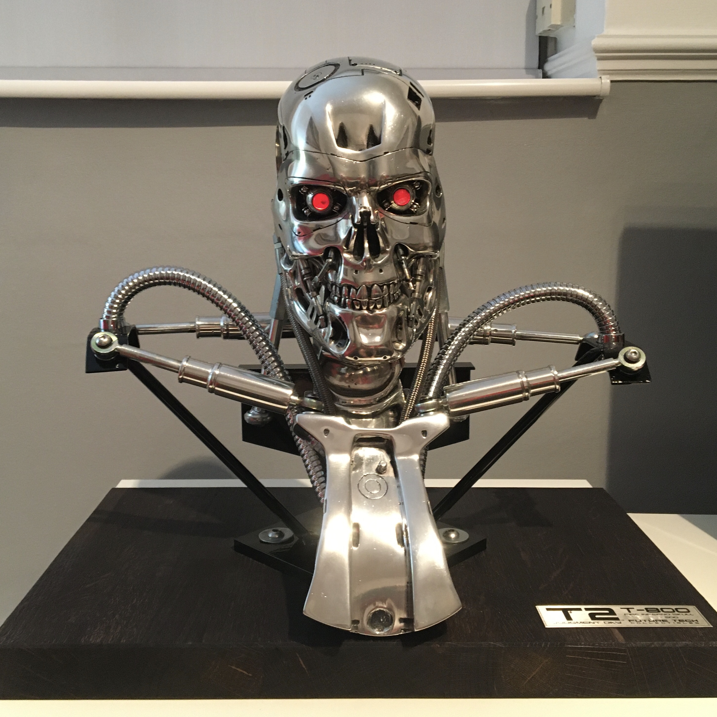

That was a while ago, I have finished the bust now. I spent a lot of time sanding a polishing. There are more updates further along. I have put some pictures below.
I can announce the new project I was working on, I have just finished the production piece. I am in talks for licensing and the website is almost ready to go live. It’s taken a huge amount of work but I’m finally nearing the launch.

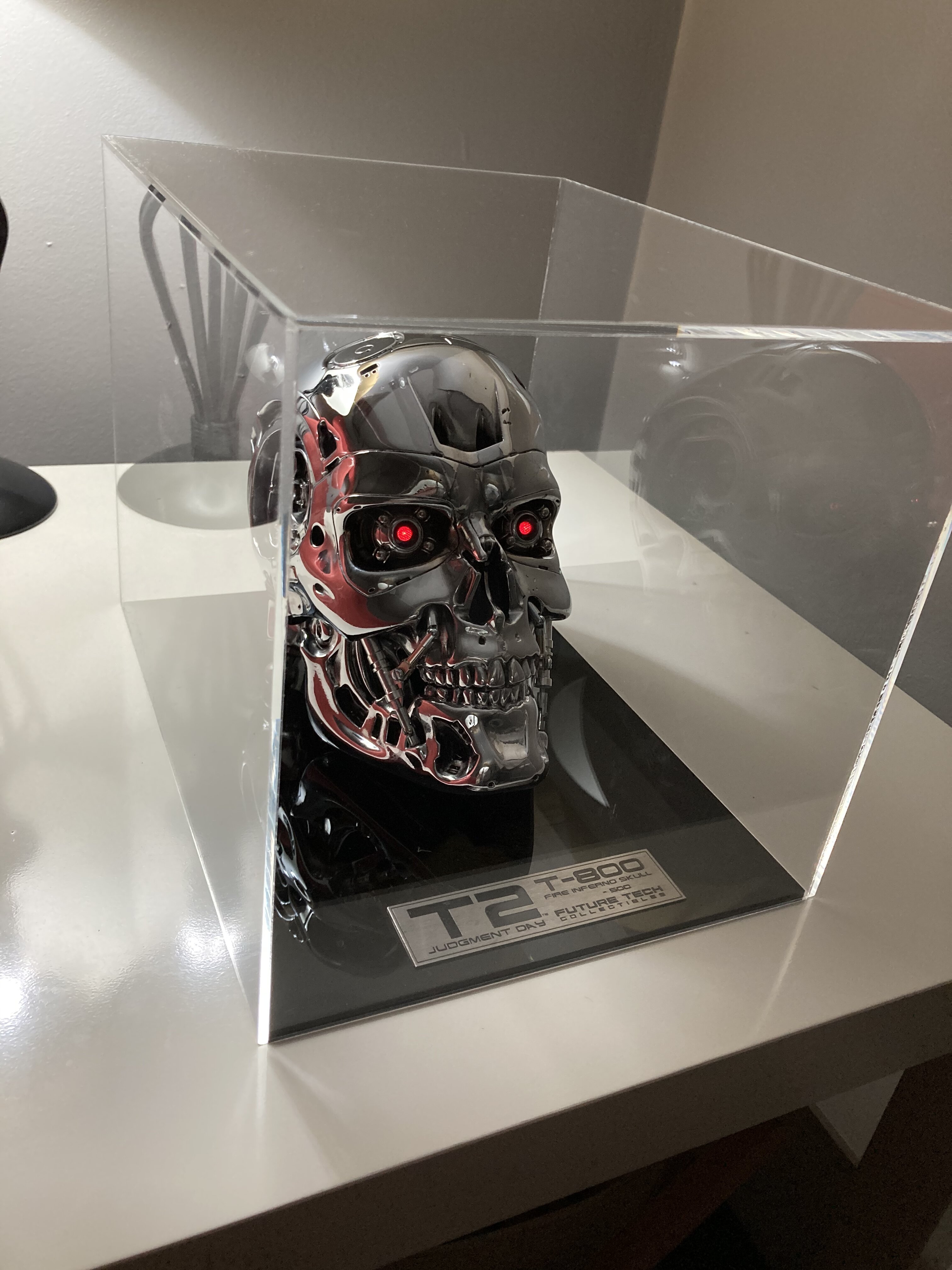

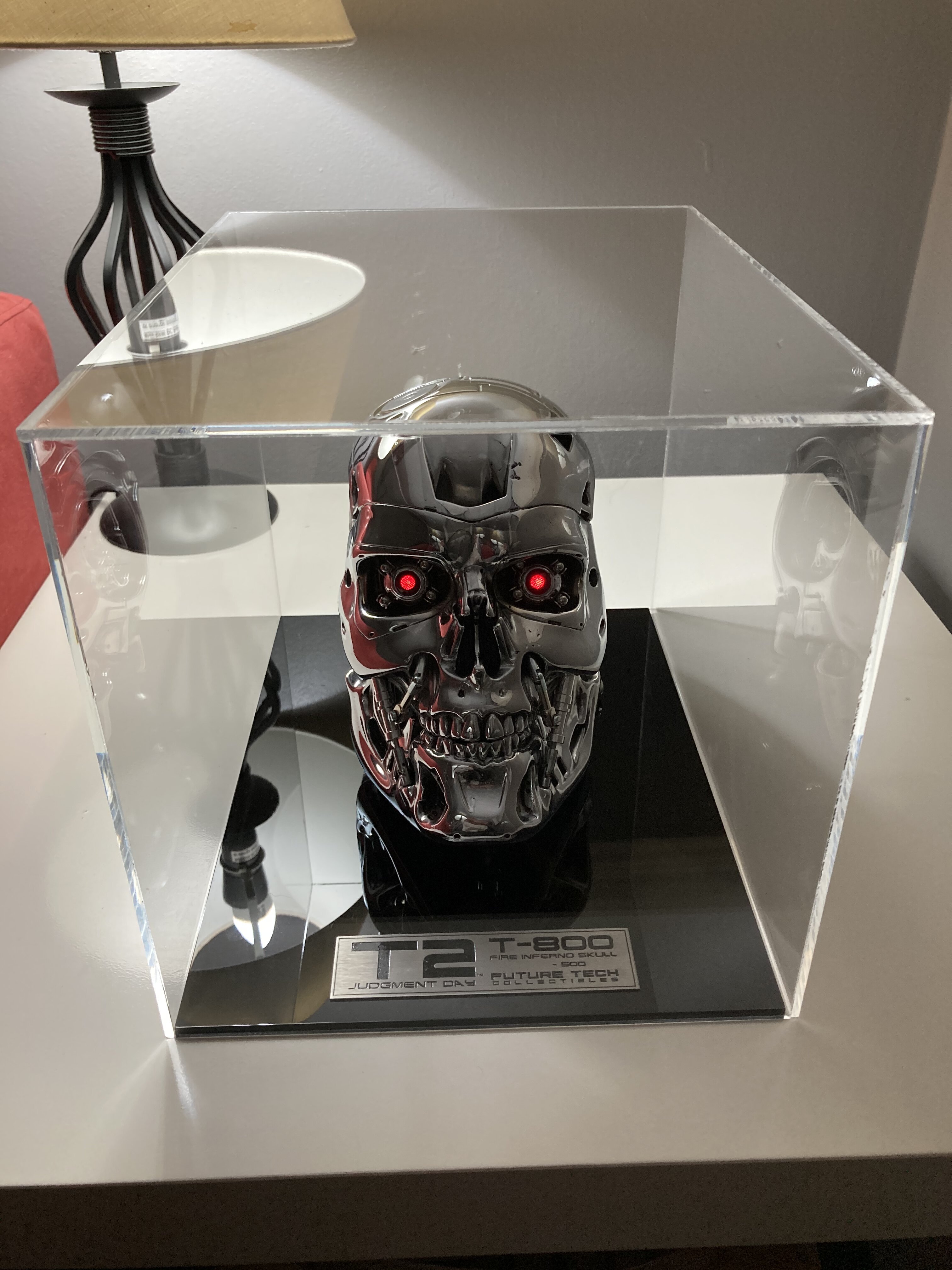

I have been keeping it a secret for a long time now, but I can finally show a picture as a teaser.
I have created my own collectible company to produce chrome plated, bronze cast Endo skulls. So other fans can have one of my Metal Endo skulls. I will share more information when I can.
As the first to reply I’d just like to say on everyone’s behalf “yes yes yes yes yes yes yes yes oh god YES!!”
That thing is absolutely beautiful. You’ve done the original vision very proud indeed.

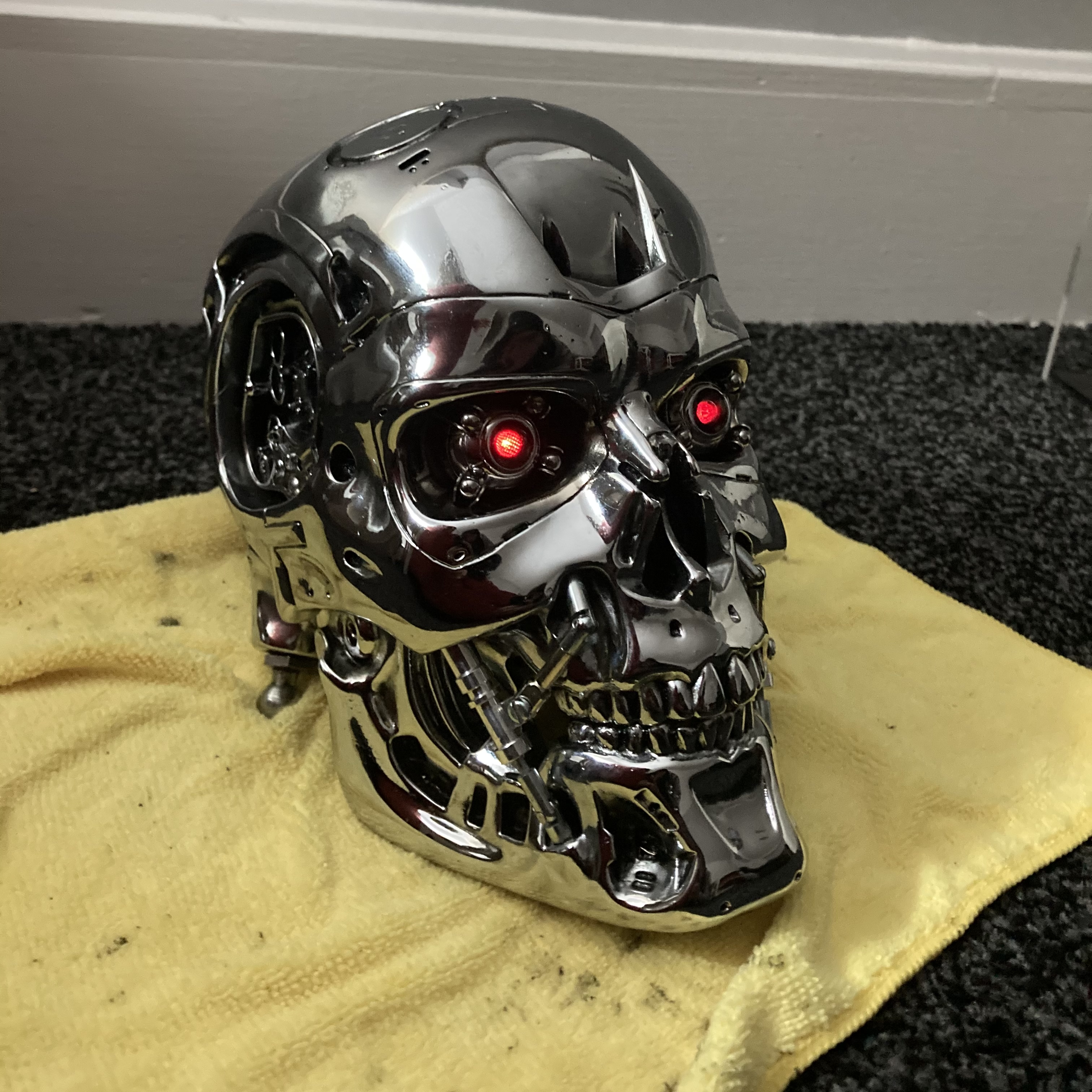

Thanks Jaz, yeah they are each created individually by hand. First using wax patterns, and then covered in a high heat coating and then vacuum cast in bronze. So each one will be unique, with the hand applied weathering and any natural slight pitting marks in the casting.
They come out beautiful after chrome plated.
Your chrome plating is really awesome and shiny.......and the skull......my god......absolutely stunning, really a gorgeous piece. you did an amazing work (y) :love:
How much extra finishing is needed before they can be chrome plated? What are the stages after?
There are a lot of stages...a mostly standard bronze casting process starting with my master, that then is copied and cast in wax then onto creating a mold for the bronze. Then the final casts need a little welding, drilling etc. They then get a lot of work done to them...clean up of sprue and vents etc.. then sanding and polishing, lots of sanding and polishing. They then get a nickel plate, then a chrome plate. A final polish. Eyes assembled and with clear resin and glass lenses. Then assembled and electronics put in.
