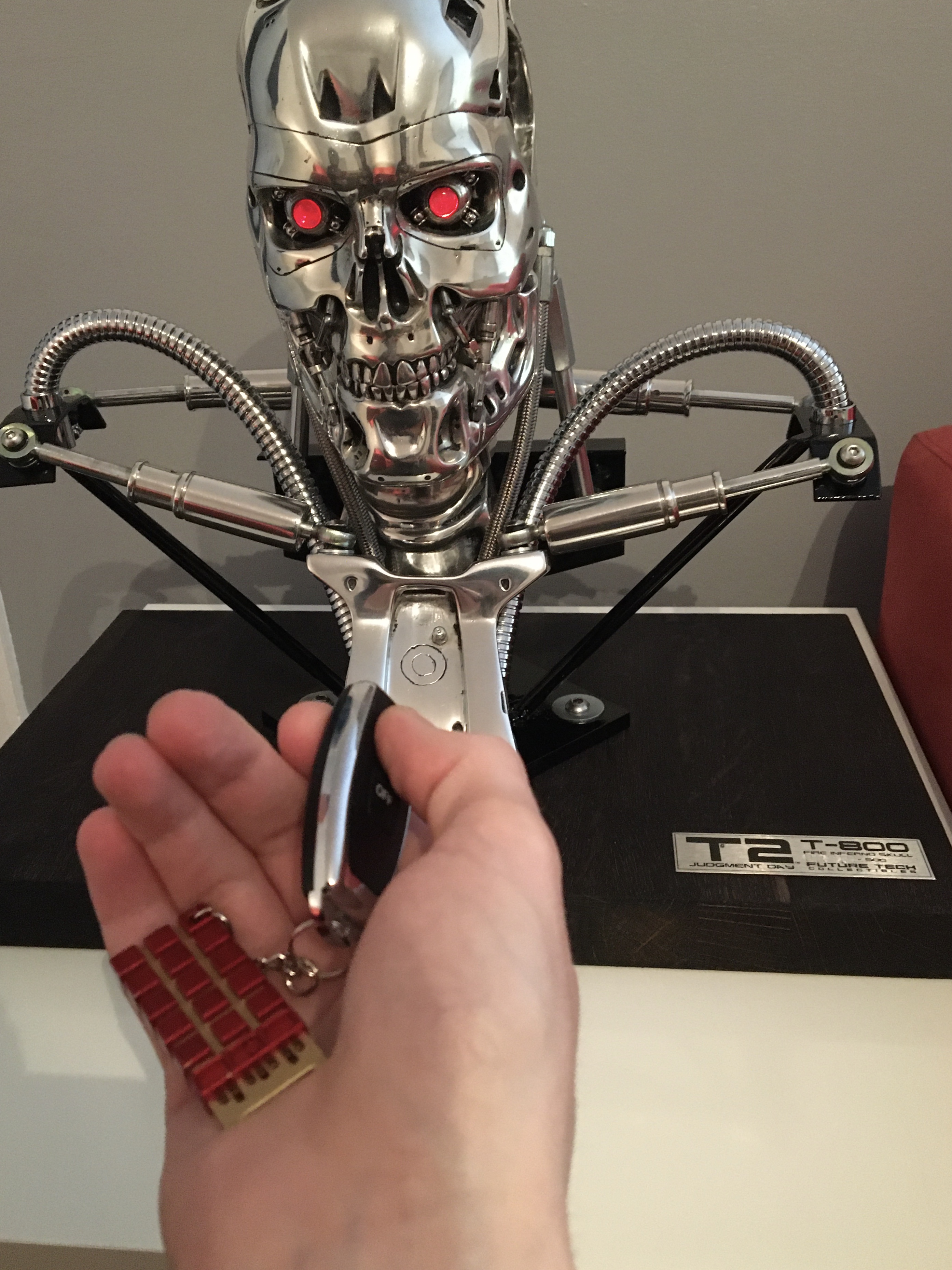

Solid Metal Terminator Pewter T-800 Bust Replica Prop (WIP)
Couple more shots

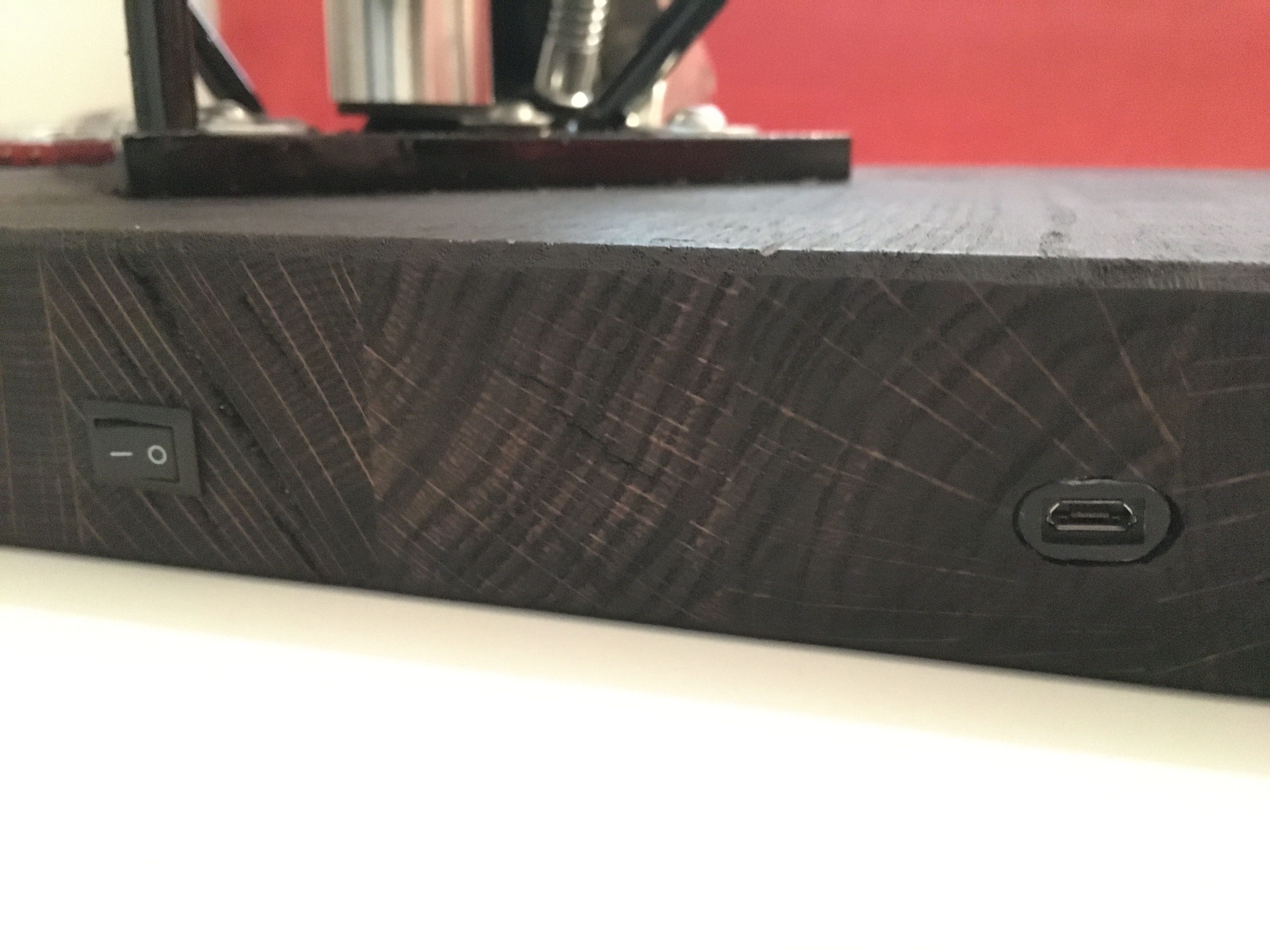

The back of the base has a kill switch for the electronics, also a micro USB charger for the lithium ion battery in the base.

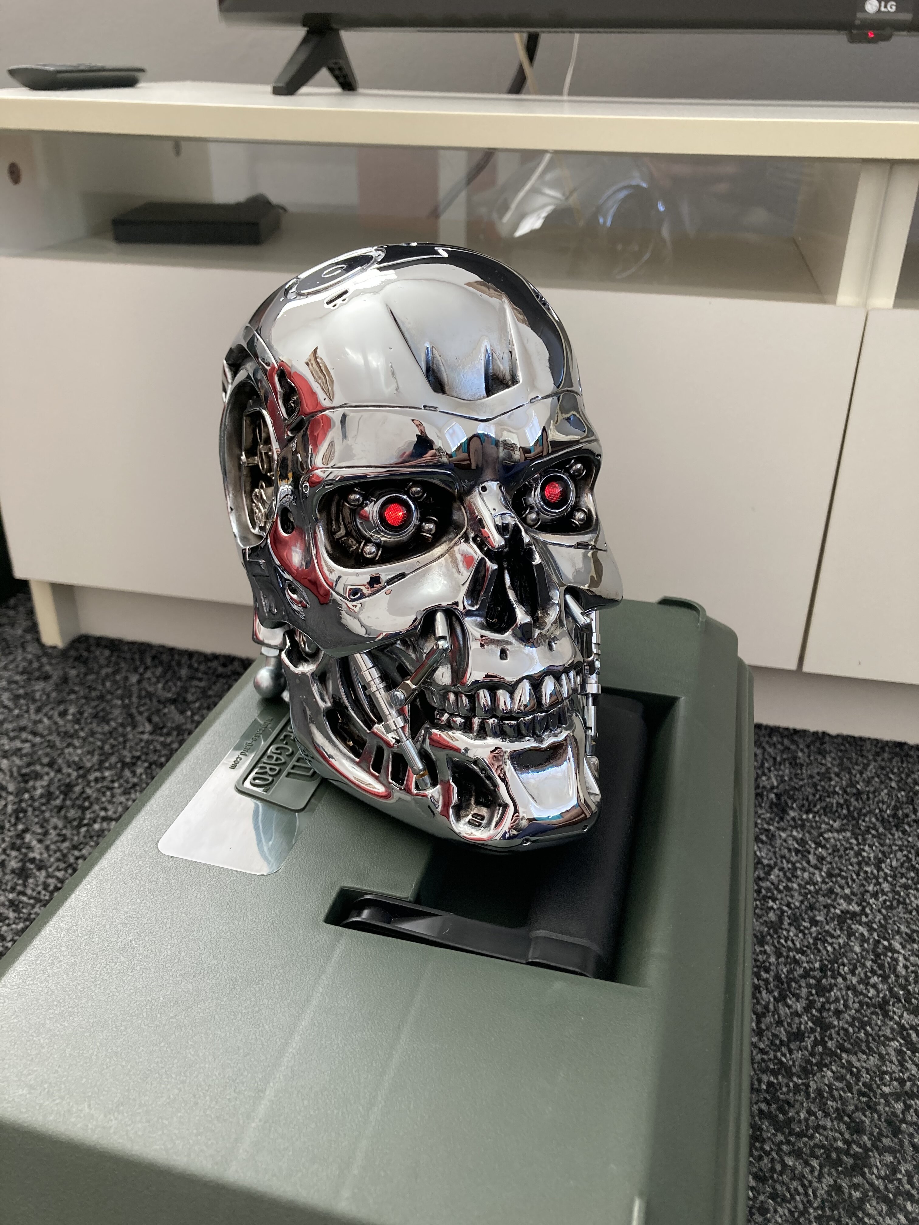

The T-800 eyes can be turned on using the chrome remote control that has a CPU chip keyring.

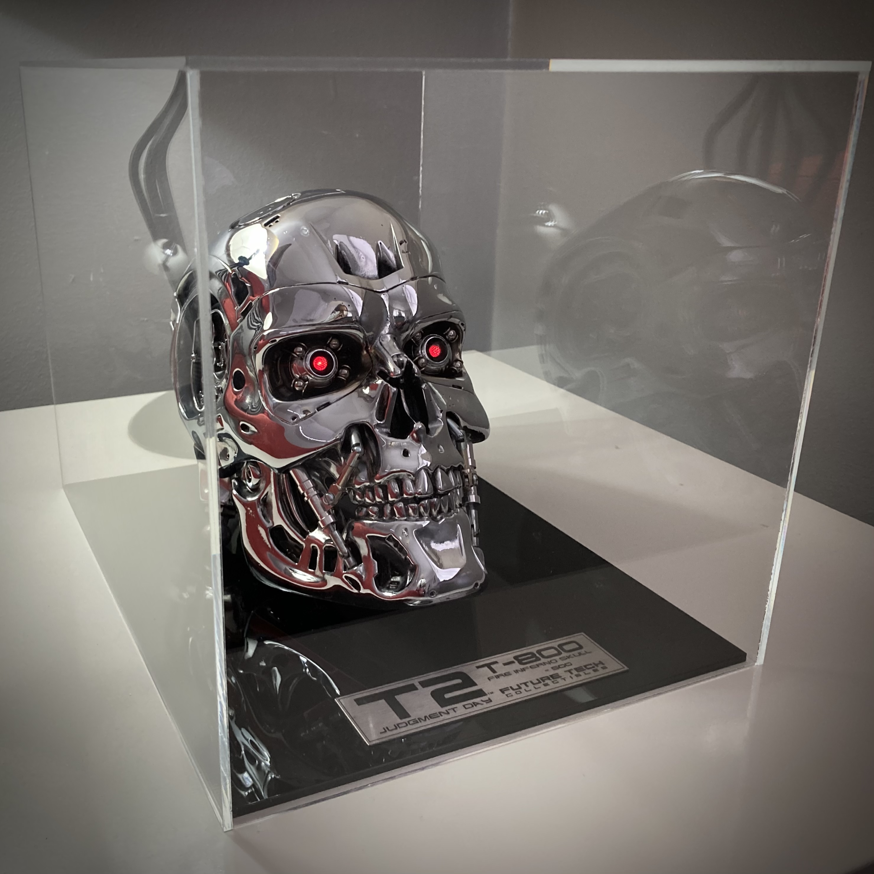

Also a shot from behind the bust.

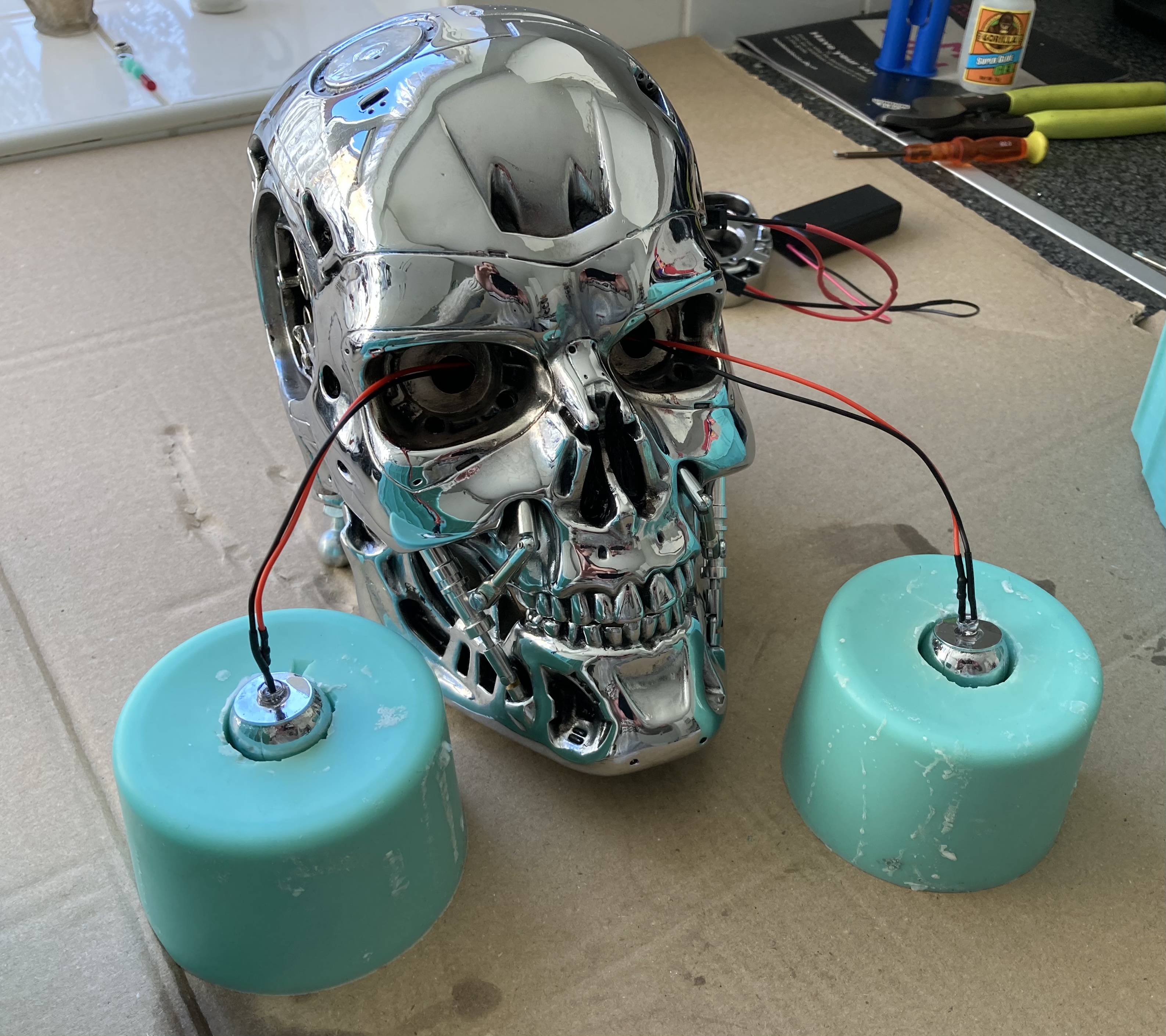

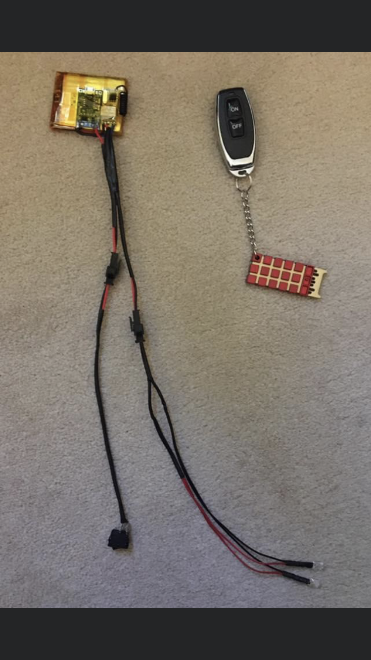

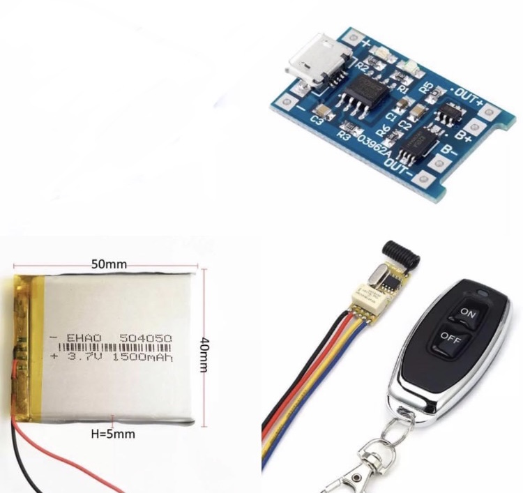

Excellent work on the bust. Could you show how you set up the rechargeable lithium ion battery and remote please? I just set up a 3D printed endo, and I would like to install red LEDs for the eyes without taking the head apart to change batteries. Having a remote is a great idea.
For the bust, I just bought the above parts on eBay, a little micro usb charging board, lithium ion battery and remote control with its receiver board. Soldered it all together with a couple leds.
