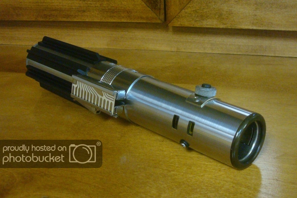

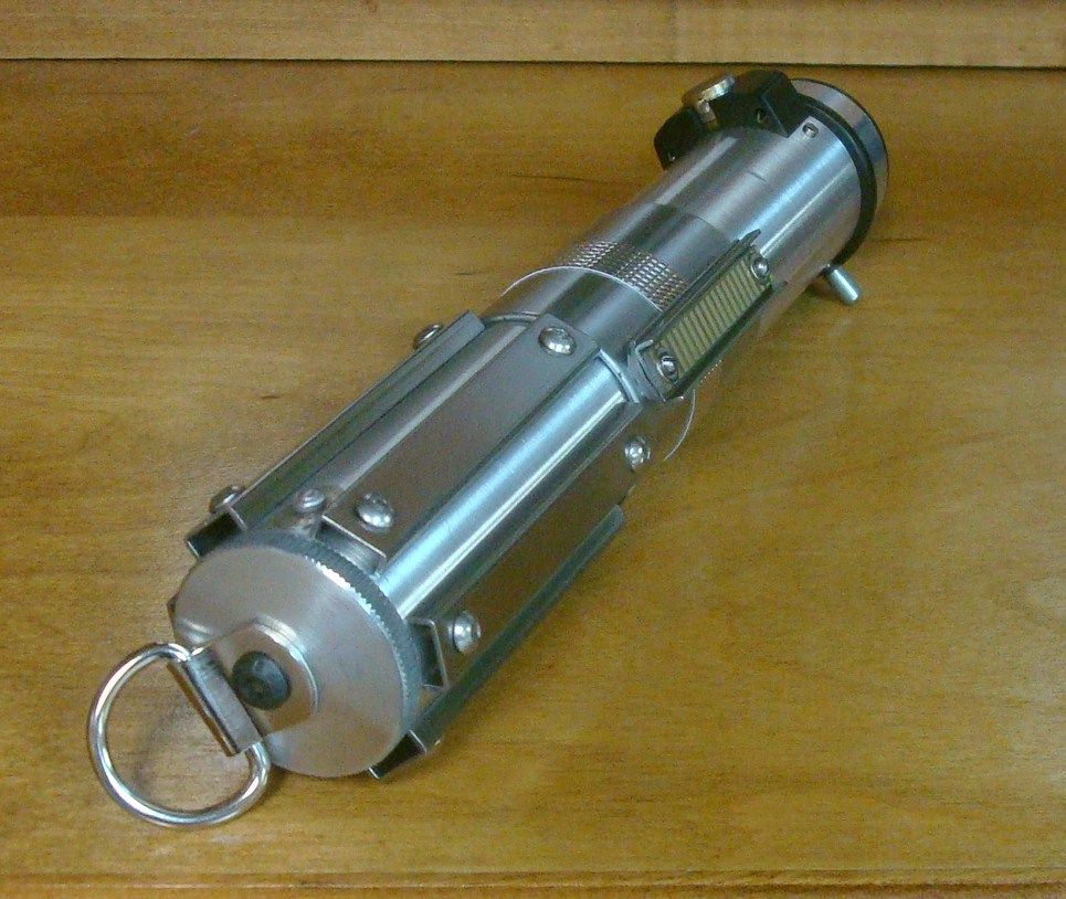

This Speedgun flash was in a lot of vintage 3 cell flashes and reflectors from a recent ebay purchase. It was originally last in line to convert, but for some reason it went right to the front.
The grips are my usual ones, everything drilled & tapped. The D-ring and the pieces of smooth/textured chrome tape came from The Custom Saber Shop.
The circuit board is cut from a a bunch of boards that I scavenged from work around 15 years ago. I had it bolted to the clamp bar all by itself and it looked "blah." A piece of my grip material turned upside down and put between the clamp bar and circuit board made it look right to me.
The piece in the emitter is from the lot of flashes/reflectors and it's held in place by the long greeblie on the bottom of the flash. It's threaded and it holds the emitter piece in like a set screw.
This flash tube got the same 220 grit/320 grit wet-sanding treatment, just like my King Sol saber a few posts back.
All in all a neat little saber that would look good in the hands of a Jedi that with a smaller build. These Speedguns are 9" long. I'm not including the extra length provided by the emitter addition.

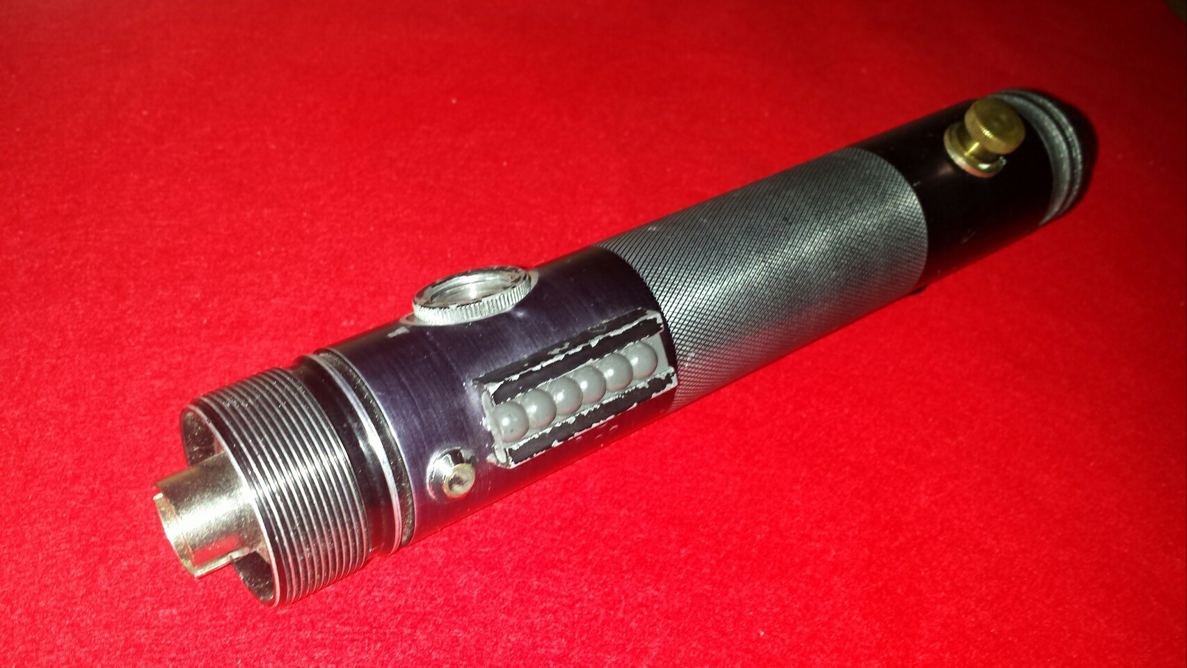

Hey everyone! I have recently gotten in to saber building. These are pics of my Mk III Nightsaber of Ultimate Truth, a commission for a bicycle game that I am a part of. In addition to machining all of the parts myself, I have also been working on a project I will tease right now. I am currently developing the TOSSP, The Open Source Saber Project. At the moment, I have completed a 10W, 4 channel (1 Amp on each channel), up to 8 LEDs per channel, with PWM dimming via an external microcontroller such as an arduino pro mini. This saber, has color changing, eventually will have color mixing for custom colors. After checking out the saber pics, check out the bicycle gang site. http://imgur.com/a/8n63G www.scul.org DSC_4697.JPGDSC_4707.JPGDSC_4703.JPG

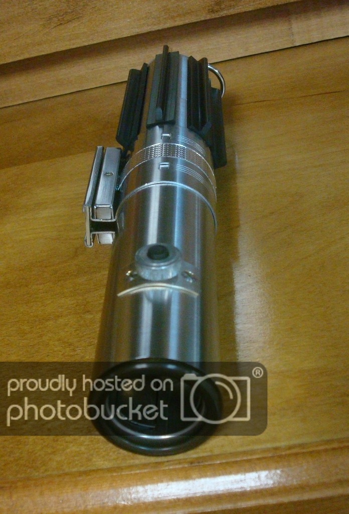

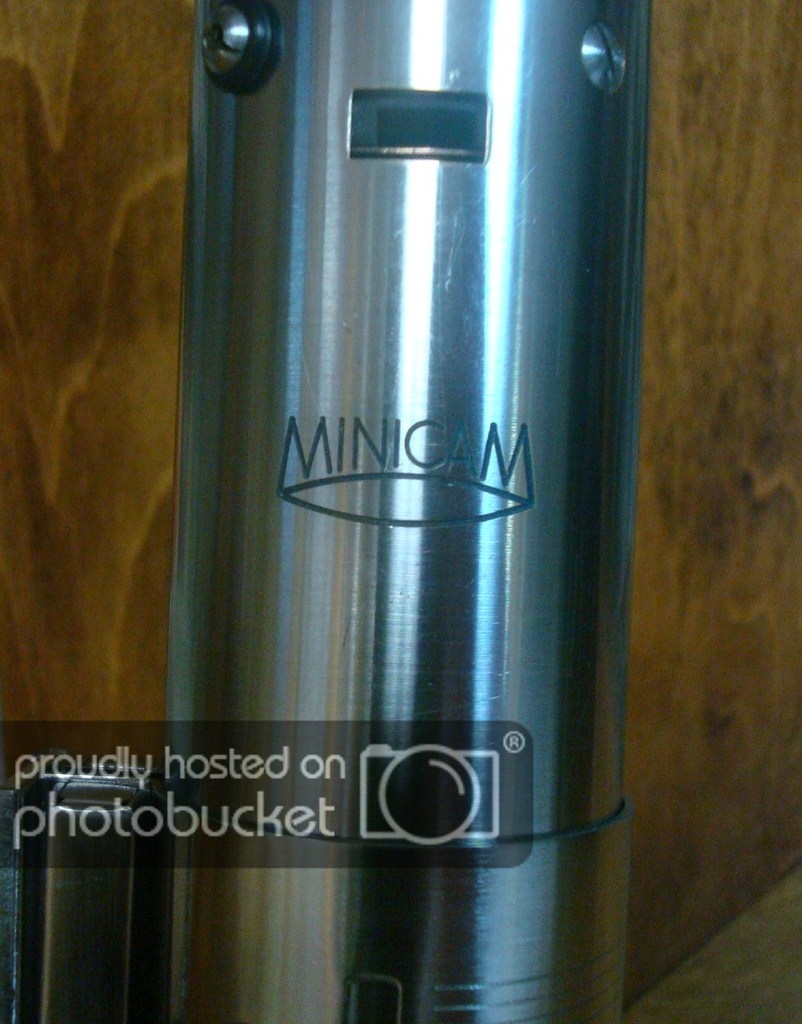

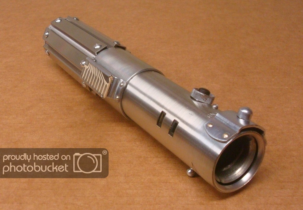

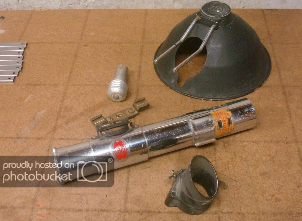

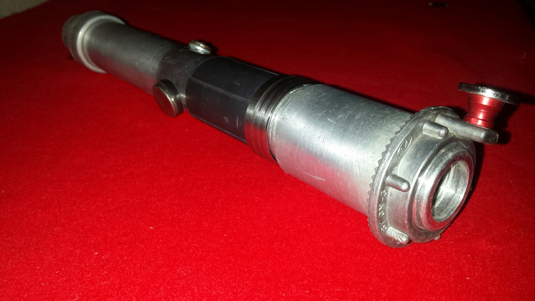

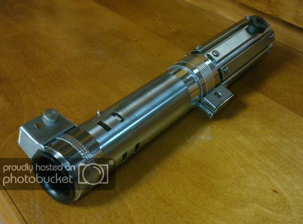

WRONG. ;) This is a 3 cell Minicam flash that I got in a lot of flashes on Ebay recently. It does look a lot like one of my converted peak flashes, though.
The flash had a lot of minor scratches. After disassembly, the main tube got turned in a piece of 3M brown scuffing pad, followed by wet-sanding with an old piece of 1000 grit sandpaper. Made it look nice.
The D-Ring, chrome textured tape, grips and replica Graflex clamp came from The Custom Saber Shop. The 7 grips are actually Blast-Tech grips (a nice suprise) and the clamp is from Parks, I'm guessing. These Parks clamps are out of spec, by the way. The bands are a little small when compared to a Romans Empire replica Graflex clamp.
The circuit board is from a Magnavox Odyssey2 video game cartridge, cut to properly fit in the wider gap of the Parks clamp.
The black button within the knurled knob near the emitter is not original to this flash. There used to be nothing except a little red button there and it looked very "blah," The pieces that make up the new button came from my greeblie stash. (vintage camera flash parts)
The D-ring is attached to an existing 1/4" X 20 threaded hole in the end cap.

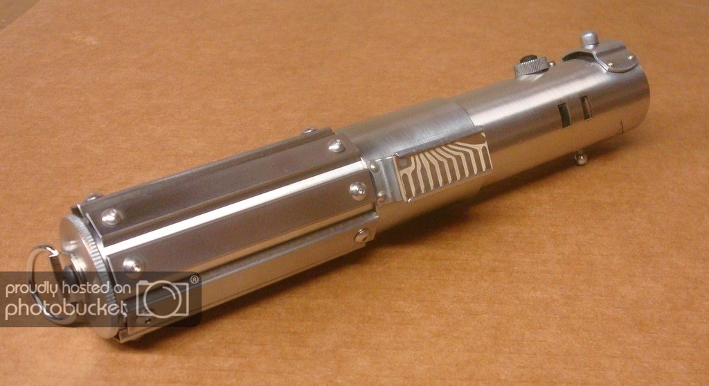

I made a jig on my borrowed drill press and drilled 32 stainless steel grips after cutting them to length last weekend. Enough for 4 custom sabers. One set is for my Hardware Brute 2.0 saber, another set was used on the custom below.

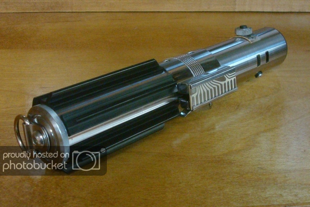

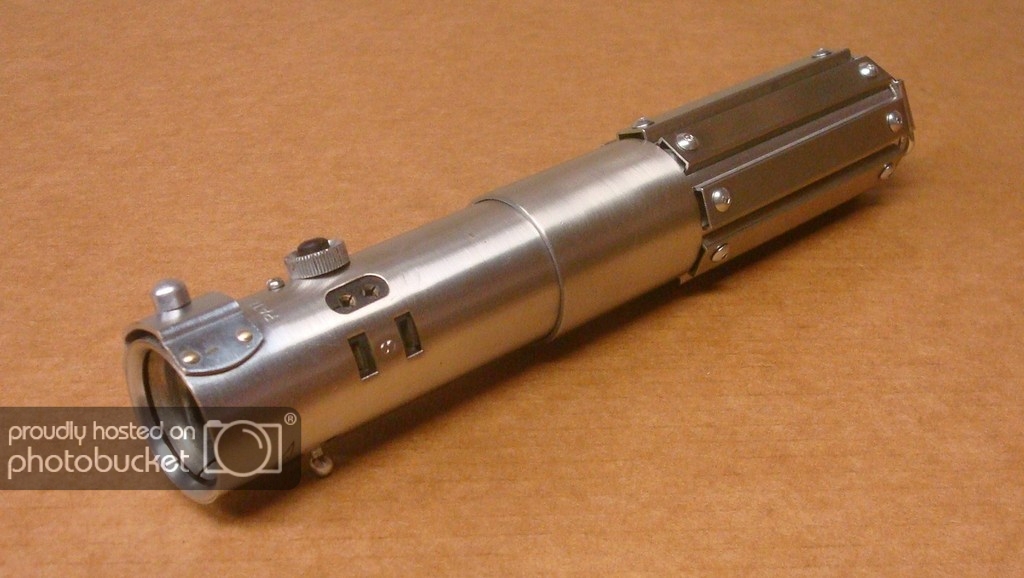

This Peak 3 cell came in an ebay lot of flashes purchased recently and I considered it to be a "beater." Lots of small dings and dents. The clamp is apparently an earlier version without the flip-lever. It looks like a King Sol clamp, but it isn't as wide. It was missing the endcap, but there are spares in my stash, so that was not a problem.
This one was kind of an oddball when compared to my other (nicer) Peak flashes, so I went in a slightly different direction with it.
My thought was "If I wanted to build a wearable Lightsaber prop to go with a jedi costume, what would I build?"
The first thing would be to use a Peak 3 cell, of course, and the second would be to make it sturdy. Everything bolted together and no risk of losing parts while wearing it.
The eight grips are my usual stainless steel ones, cut to 3-5/8". The D-ring came from The Custom Saber Shop and the circuit board is from a 1970's Magnavox Odyssey2 video game cartridge. Big thanks again to Dr. Talyn for finding these. :thumbsup They look great on custom sabers. It's hand-cut to fit tight in the clamp grooves, so no bolting/gluing needed.
I like using chrome textured tape on my customs, but that wouldn't survive while costuming, so it was left off.
The endcap is "pinned" to the tube under two of the grips, using two tiny 1/72 phillips head screws and flat washers. No chance of the endcap twisting loose while wearing it.

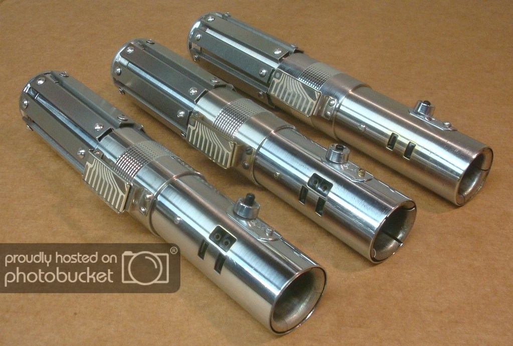

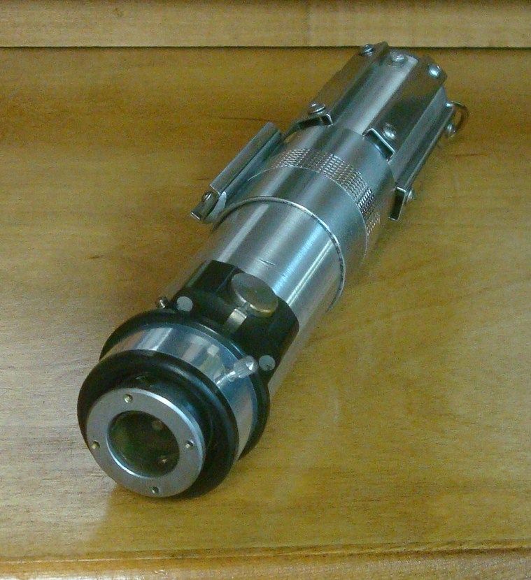

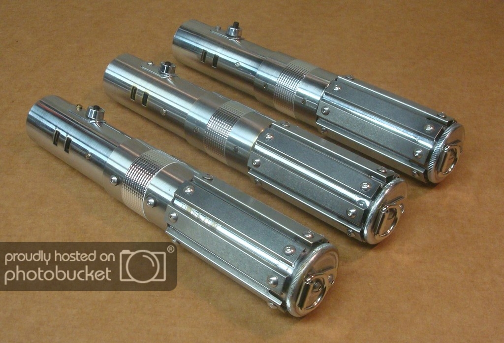

Finished up three more customs over the past few weeks. All started out as King Sol 3 cell flashes.
One was in excellent condition, one was in good condition with a few finish issues, and the third one was in pretty bad condition. One of the clamp's two set screws was gone and the other was loose, so it scratched up one side of the tube. I bought the rough one to get the clamp and shroud, but after cleaning it up, I thought it could still be made into a decent custom. Grips can (and did) cover up a lot of the scratches.
There's a few minor differences, but I was going for a similar look for all three. All the usual refinements, built sturdy as possible.
The nice one with the taller black button is the "hero" and the other two are "Stunts." :)

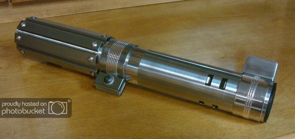

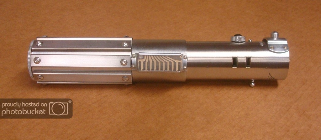

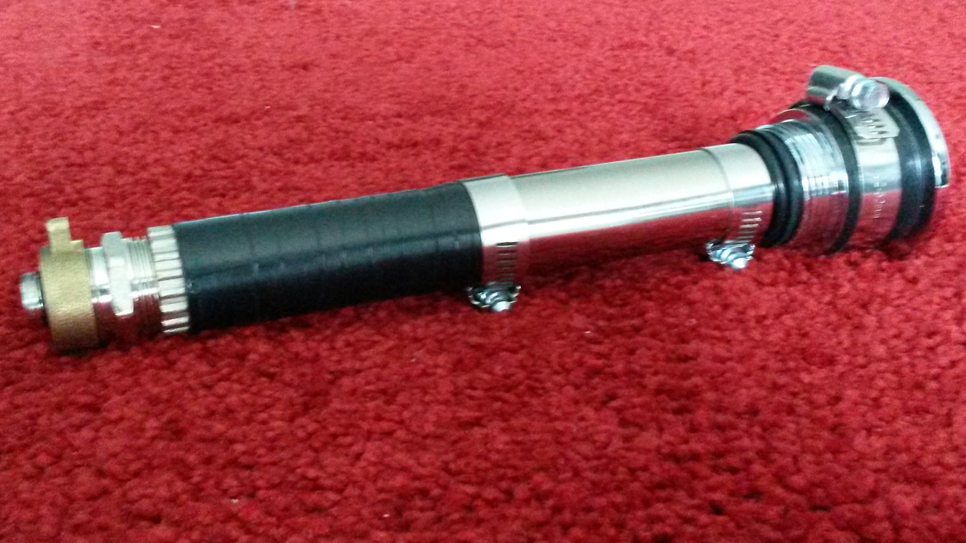

Back in post #248, I posted pics of my hardware "Brute" custom saber, which was loosely based on the Mara Jade Lightsaber. A few posts later, I had mentioned that I had enough parts in my greeblie stash to build another one. Here's the final result.
My original Brute saber is 12" long. This one was cut down to 11". The clamps are originally from a Heiland SOL and a Heiland Syncronar. The SOL clamps do not have sidebars, so those were fabricated from a couple pieces of 1/4" steel. The emitter/innards are from a Graflite slave flash. All of the rectanguler slots were cut with a dremel tool, along with a lot of hand-filing to match the sockets in the Graflite innards.

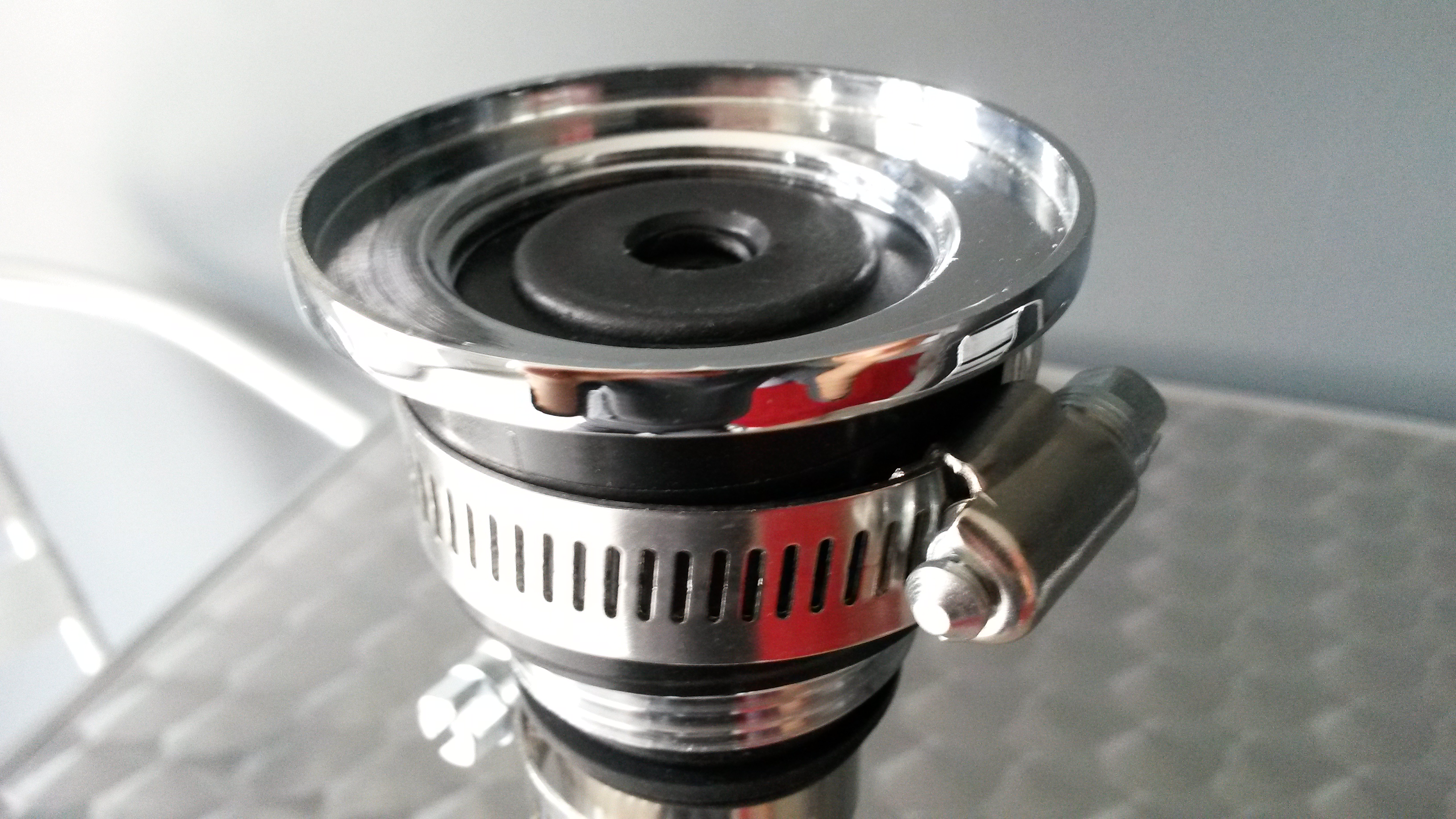

The circuit board in the forward clamp is from a section of a Magnavox Odyssey 2 video game cartridge that I normally do not use on my saber projects. The knob that holds it in place is from a Heiland shroud. The threads were the same, so no need to re-tap.
Total cost for this one was less than $20.00 just like my first version. The only actual purchases were the sink tube and the 16 stainless steel button-head allen head screws.

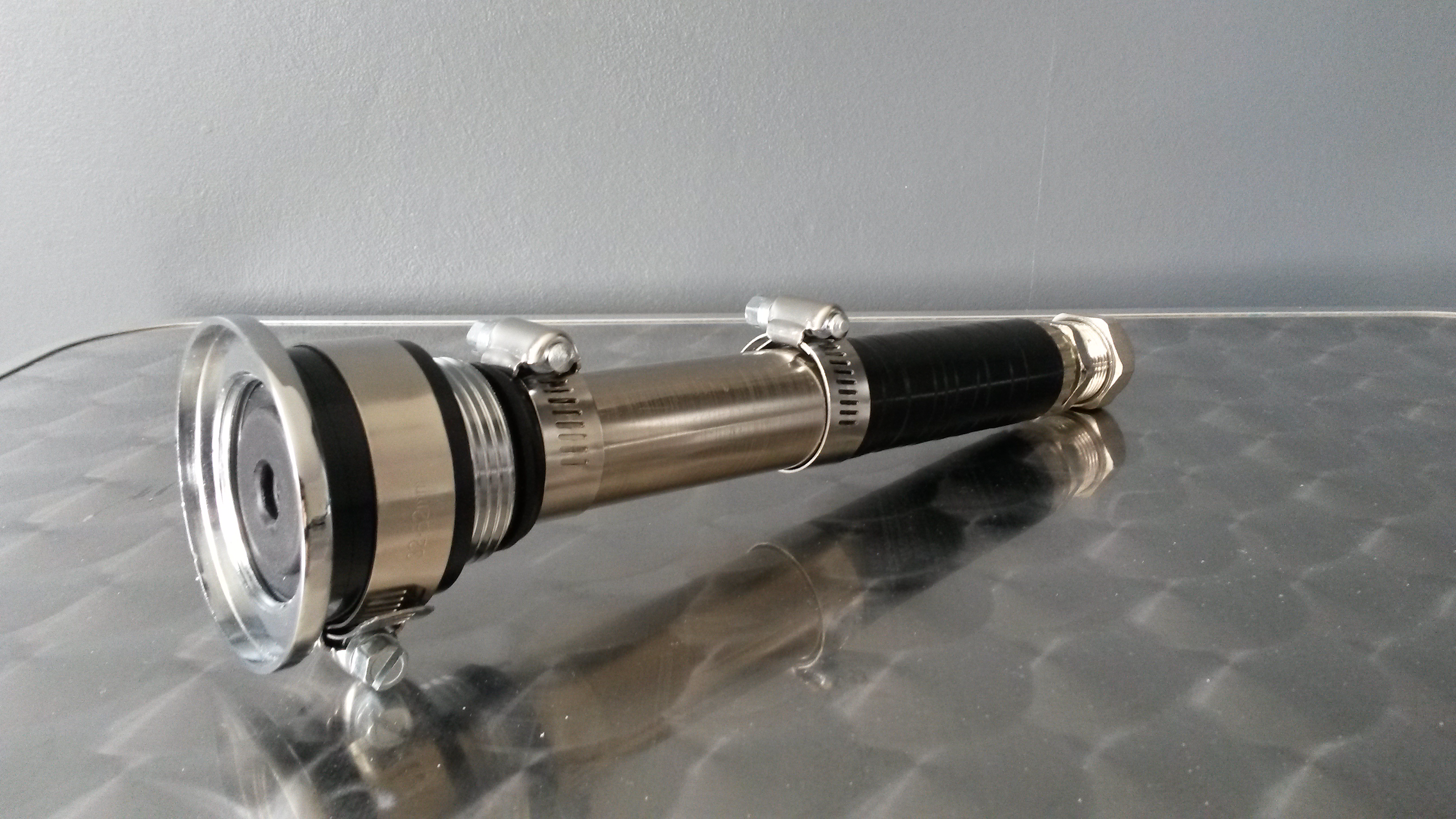

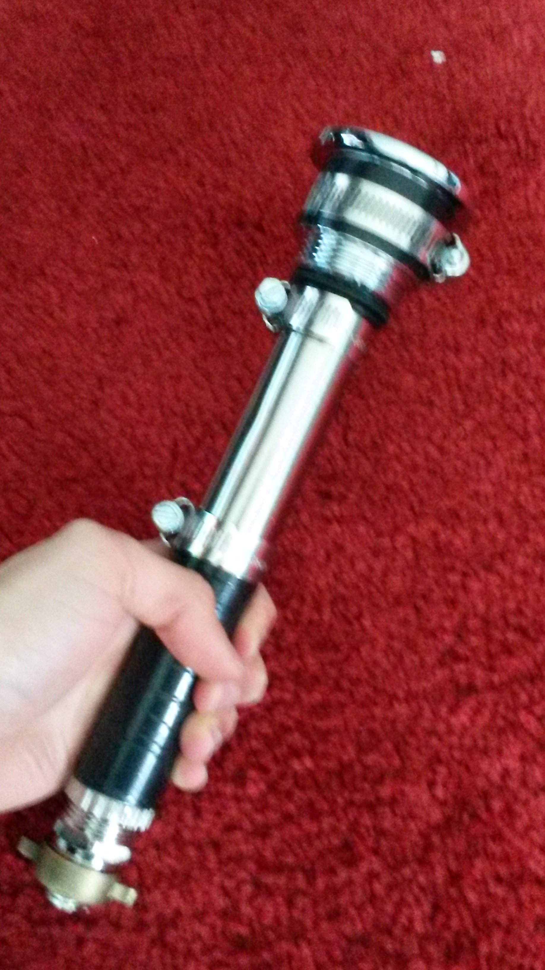

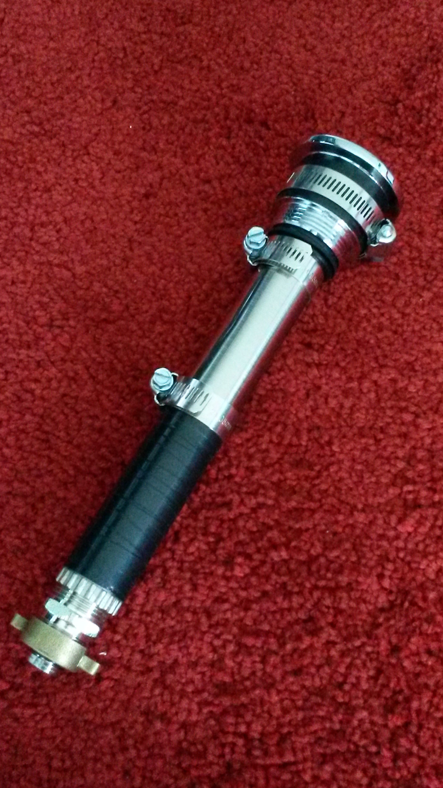

Hi guys !

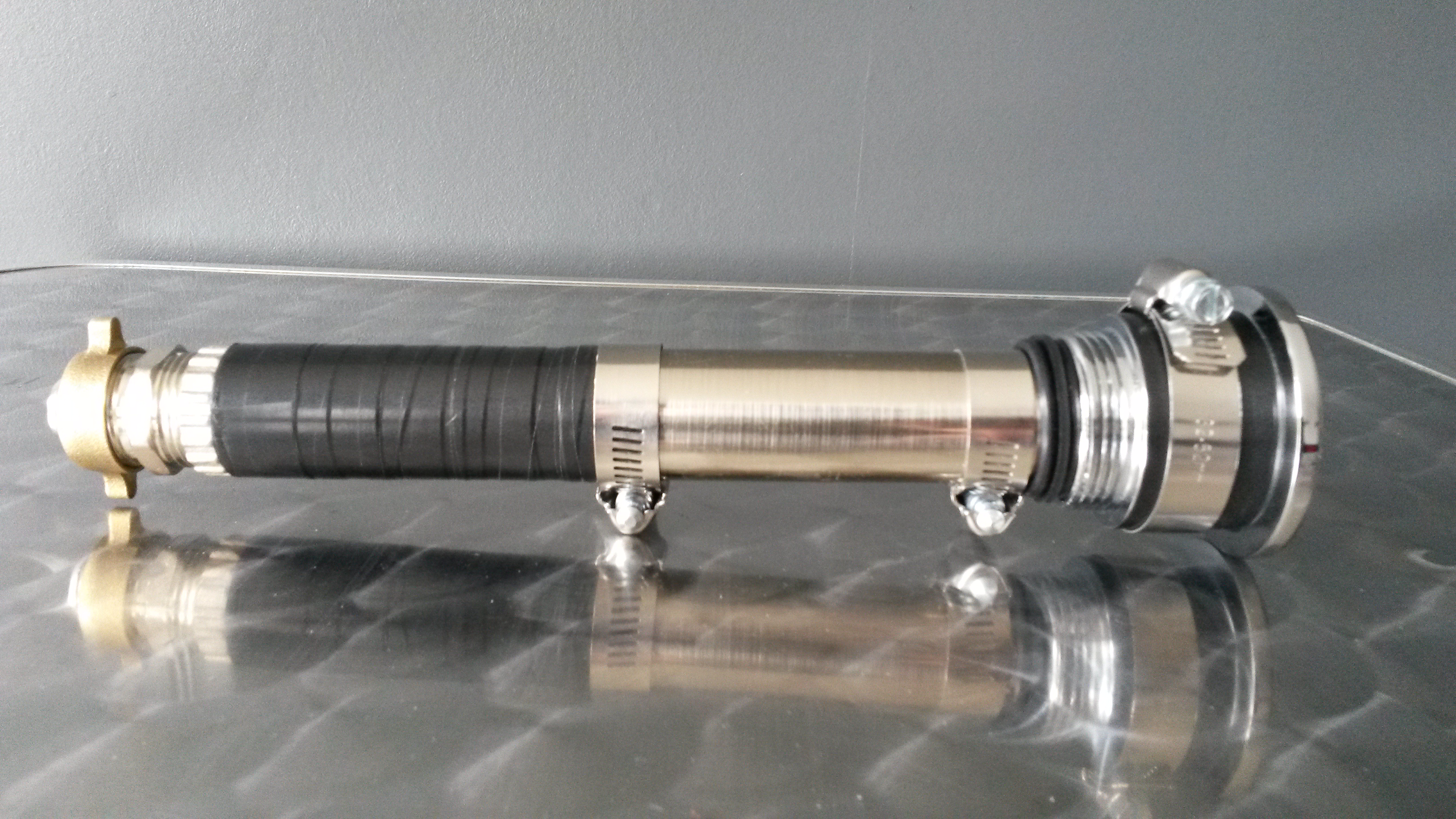

Here's my lightsaber:
This is the first one I've build. Of course it is not as good as someone we can see it but I think it is not bad !
It's a big one, a bit too big I think but I really like it. It is 27,2cm long. It looks like a big torch lamp :D !

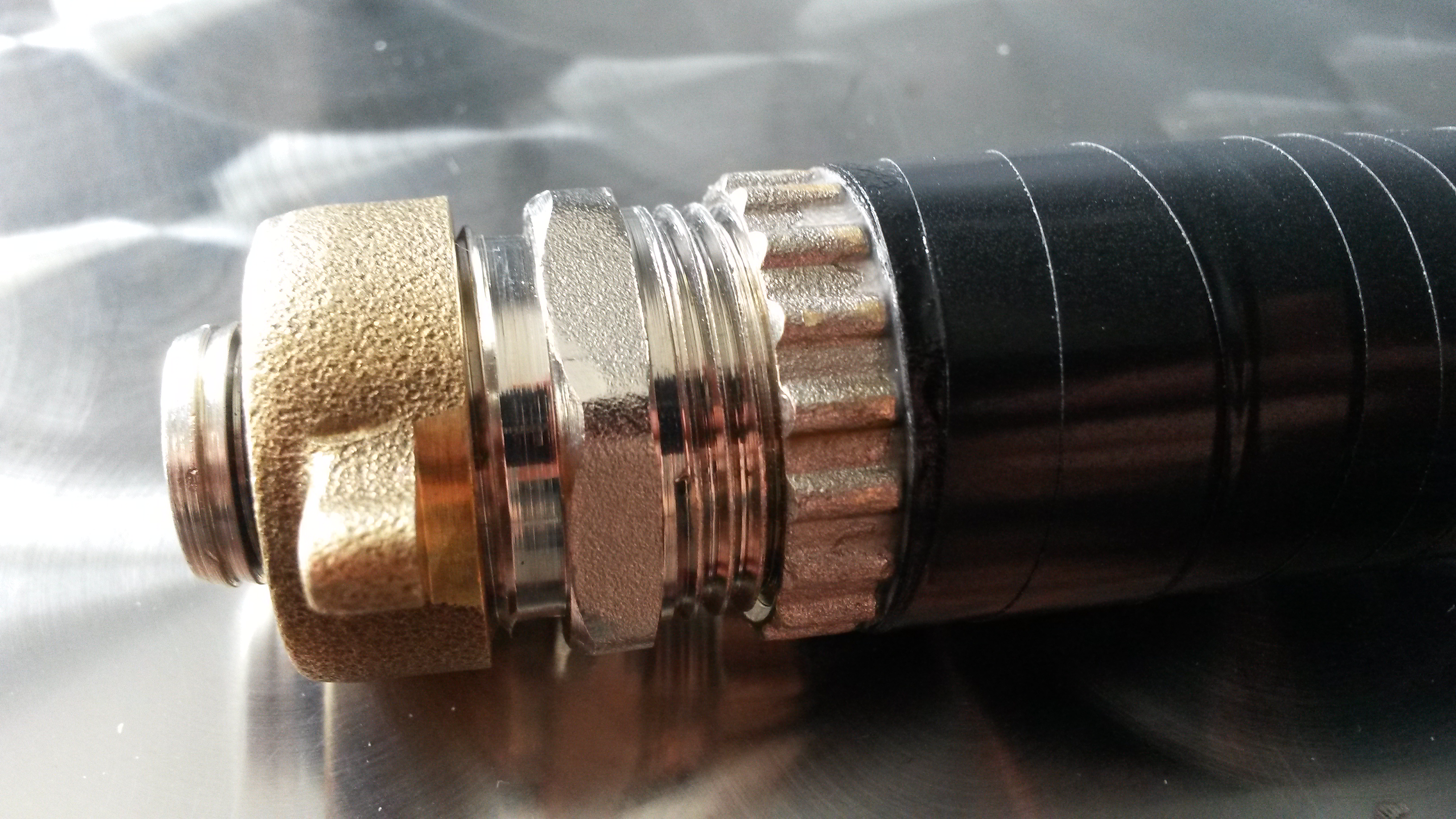

All made of silver and black part, there is a golden one at the pommel.
Here's a detail of the blade source:
And here of the pommel:
If you want to see more of it, and to see pics taken from the construction, here's my topic: http://www.therpf.com/showthread.php?t=246716

I feel your pommel is a bit to small thus giving the impression of a lightsaber not fully balanced in the Force ... perhaps a larger part could be sourced to add on?
Chaim
Chaim
Yes that's right the pommel is small. I wanted someone bigger but I found nothing at the hardware store... Yes it is possible to add another part to it (I have a big octogonal ring that could be nice but I prefer the actual version). However it is pretty balanced. It's heavier at the upper part (the shroud) but it is very confortable to take it in my hands so it's not really a problem. But as I said, there's still a hole under the pommel and I have to find something to pulg it. So maybe a new pommel will come later ;) .
