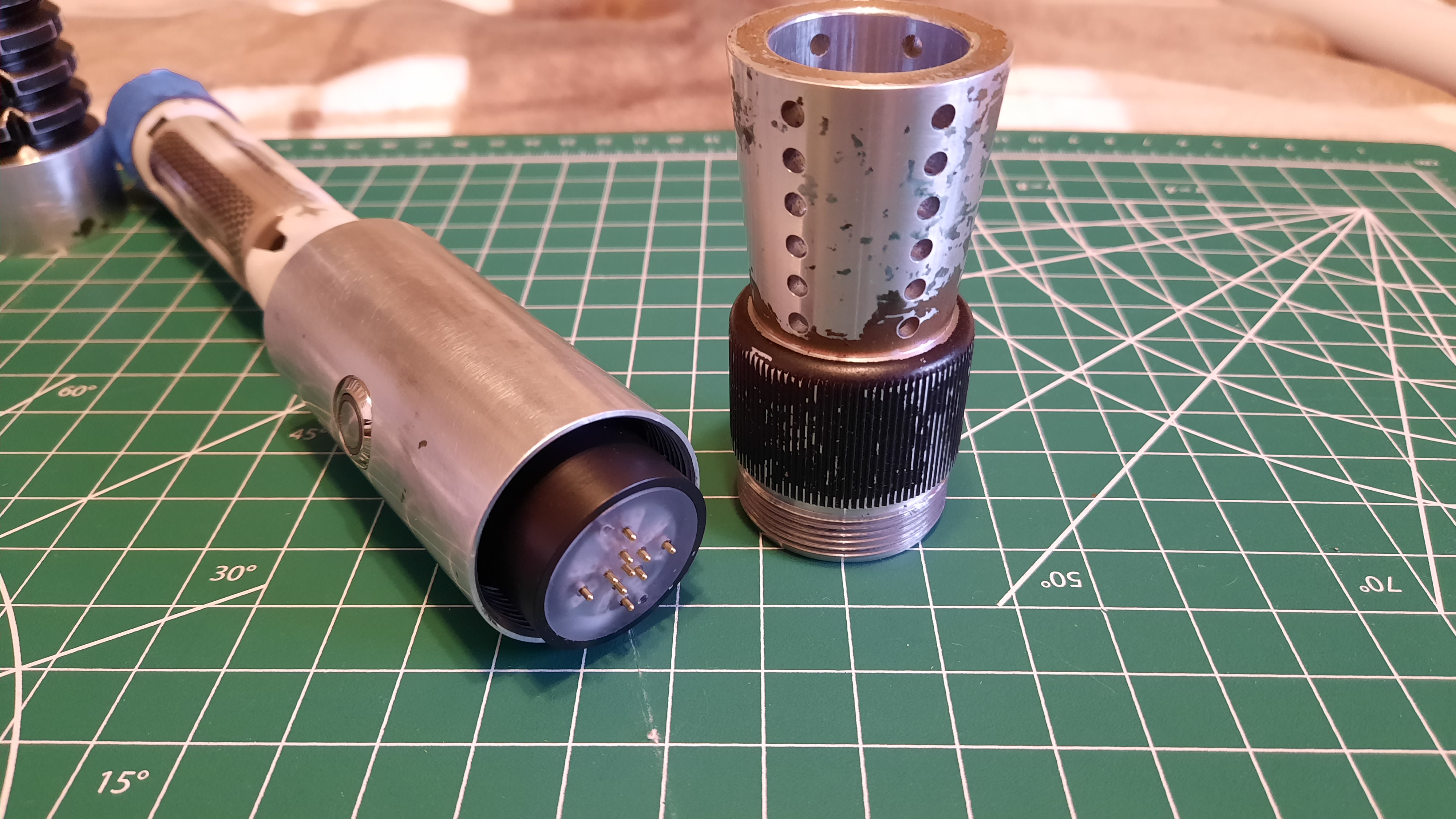

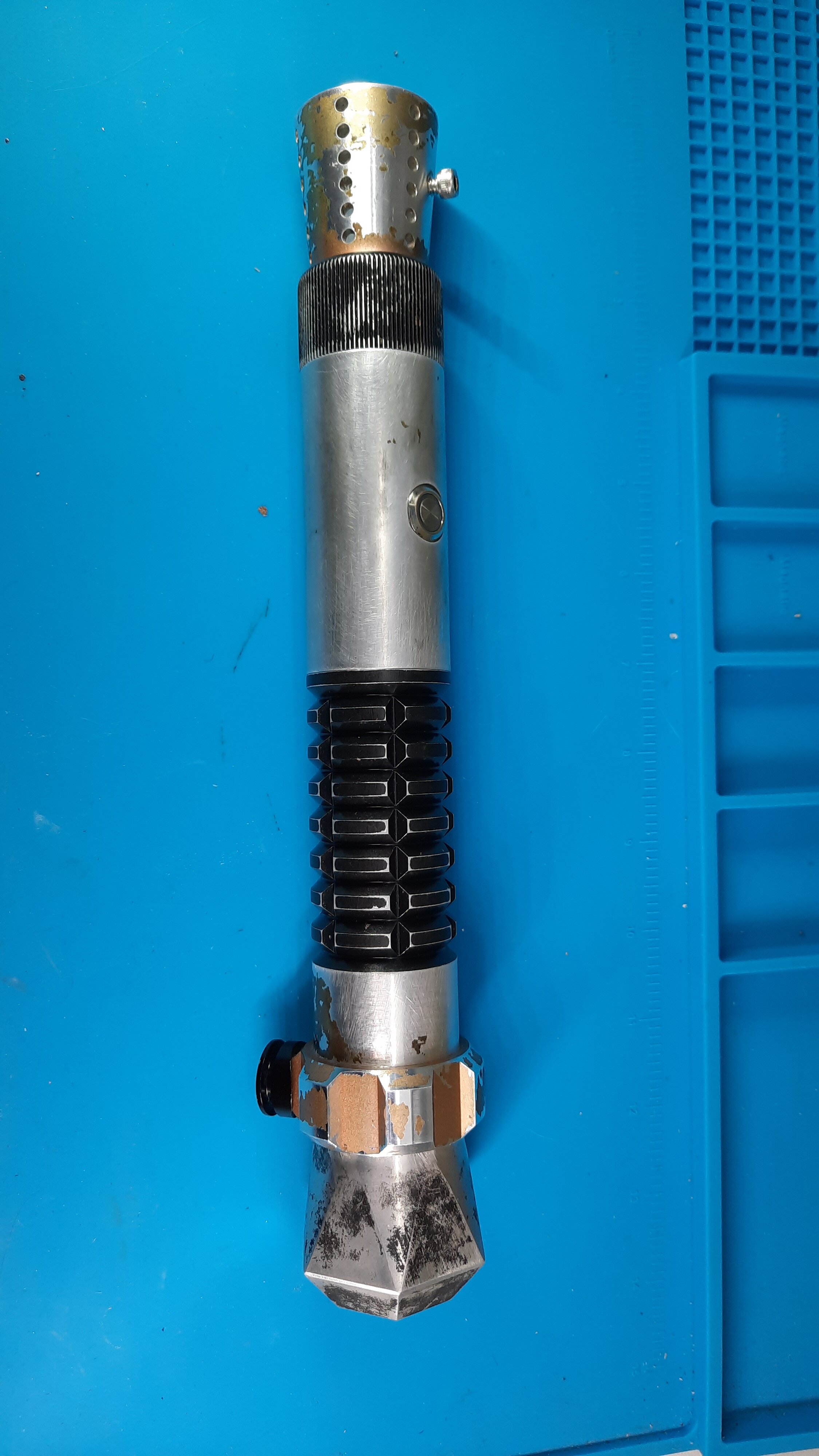

I have always wanted a roman MPP. But as far as i know, the grip was not open in the middle, instead just on the pommel right? Did you make yourself the bulb socket adapter as well?

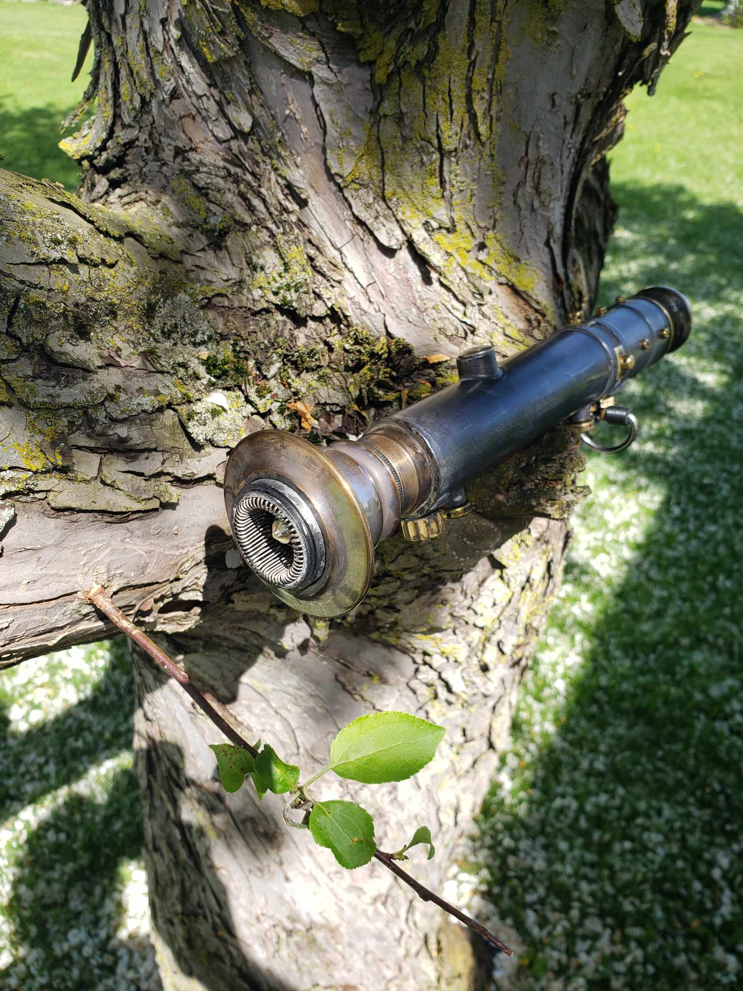

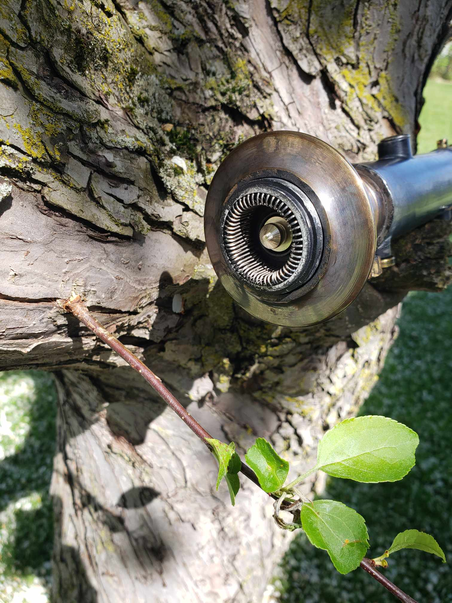

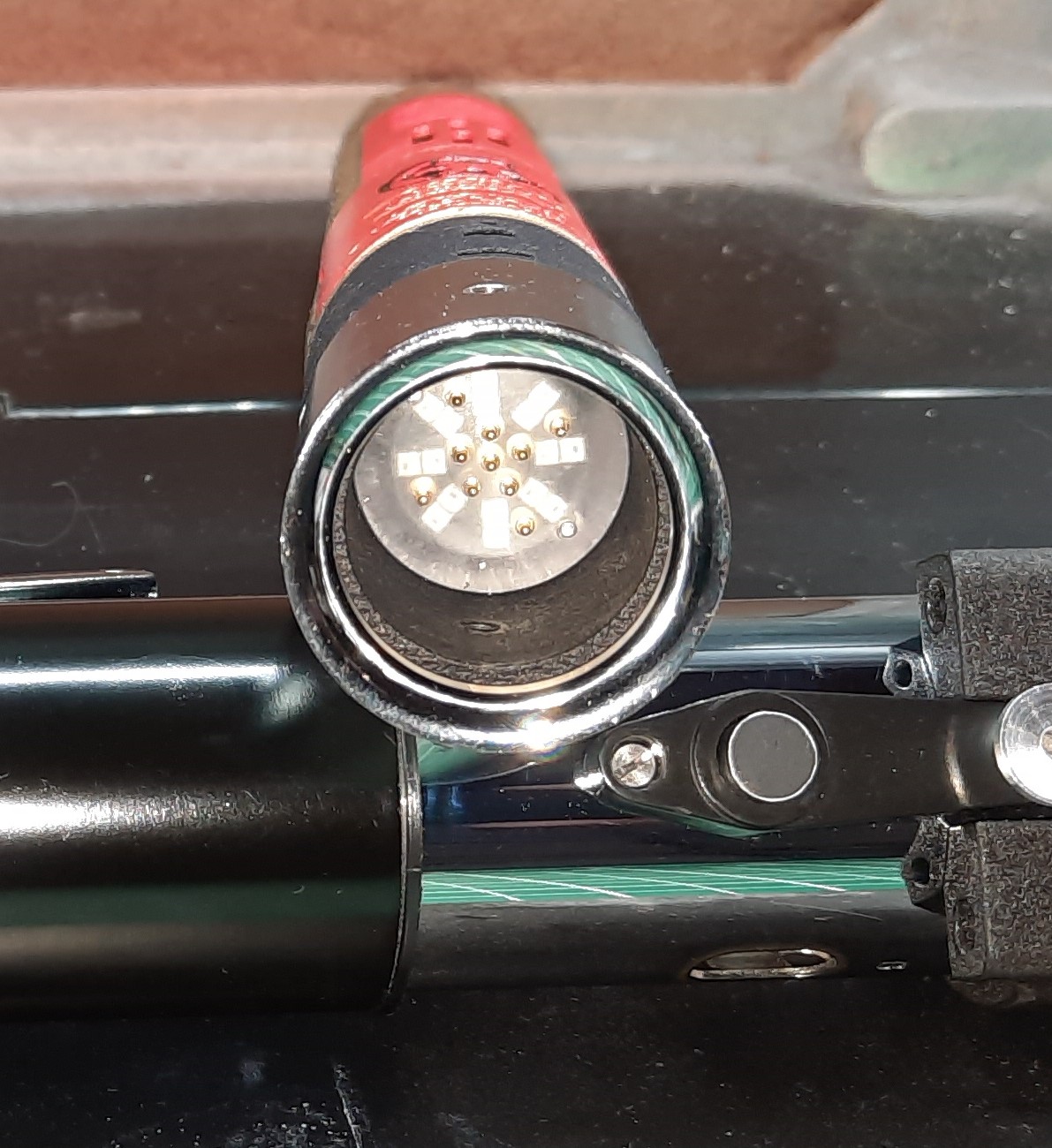

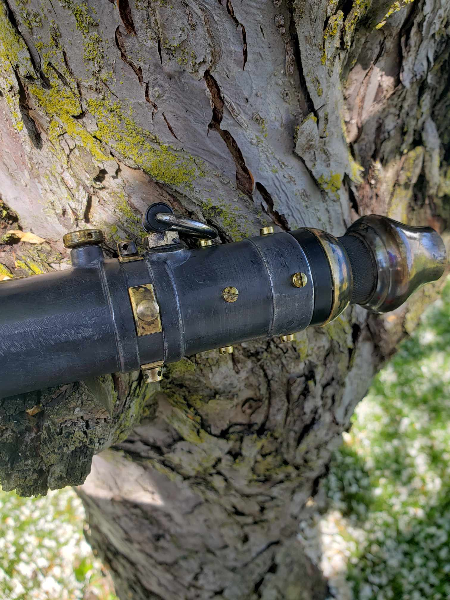

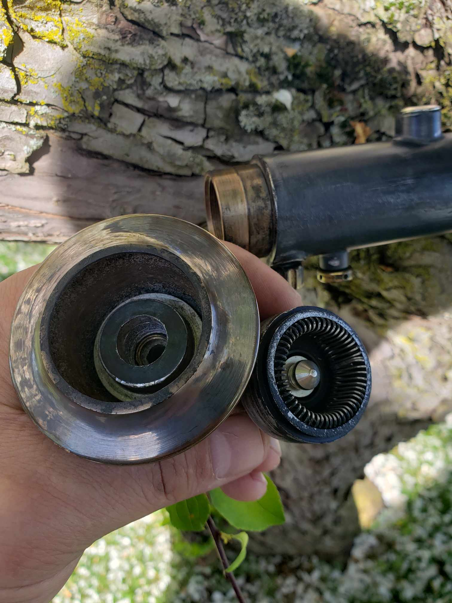

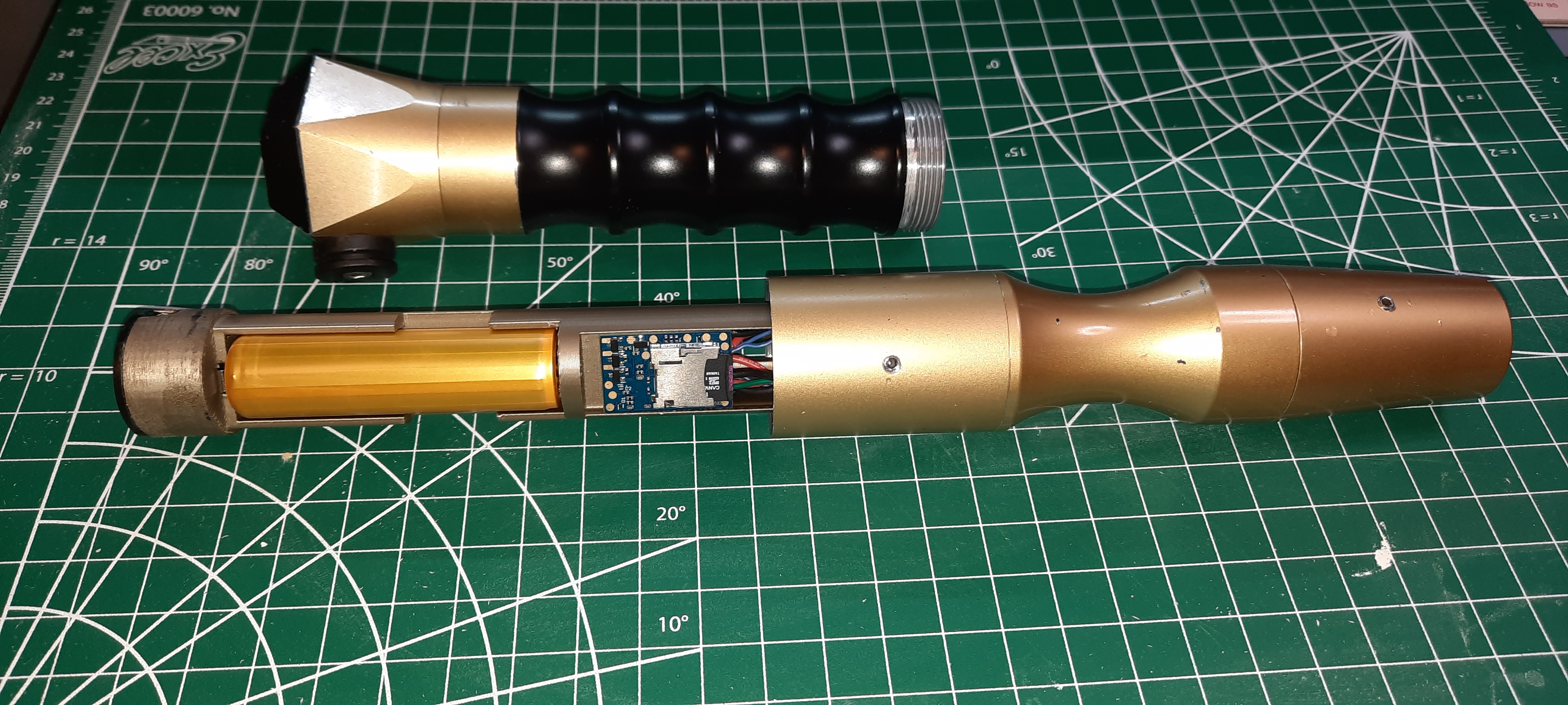

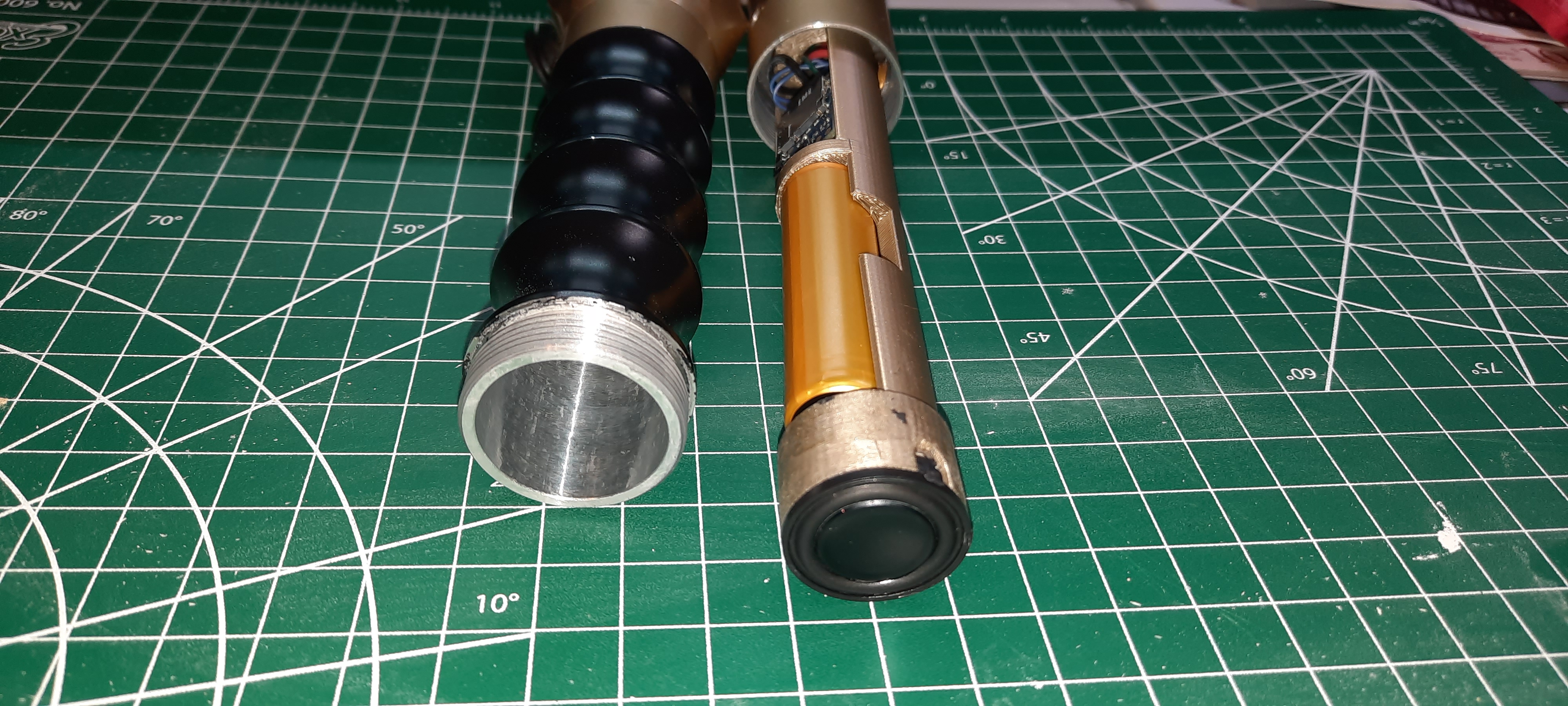

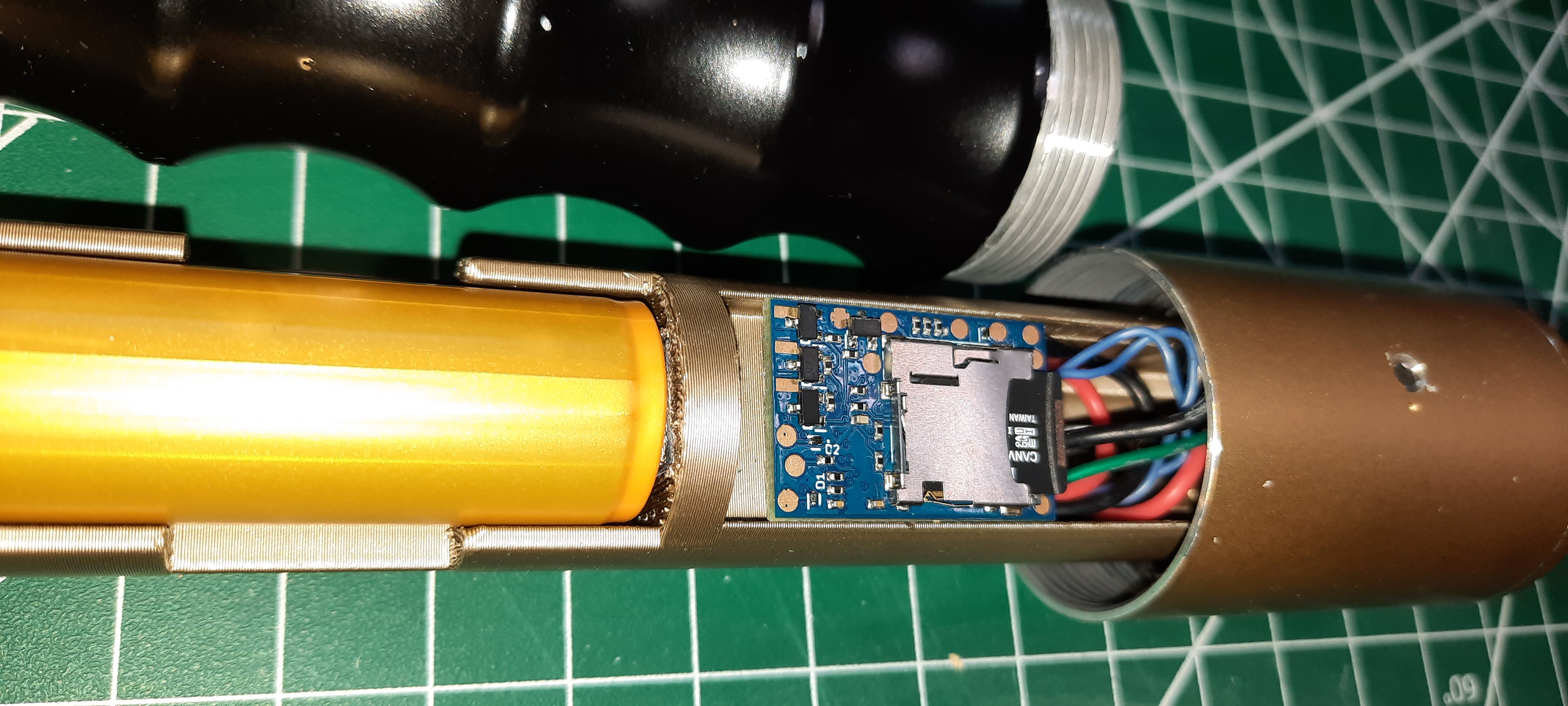

The Romans MPP barrel is open all the way through. The bulb socket will come out with the removal of a couple little screws. Then you need to separate the metal front from the plastic back. I just had to twist mine off. I've heard some people need to use a solvent to break the bond. The hard part is finding a blade holder. I finally found a solution on Shapeways with RJT Custom Sabers. They offer a blade holder for 1" or 7/8" blades. They also have electronics chassis.
The pictures are of the 1 inch RJT blade holder inserted in the back of the metal ring from roman's bulb socket. With the 7/8" holder you get to retain the cool looking metal spring.
RJT has a video on his youtube site that shows how it all goes together.

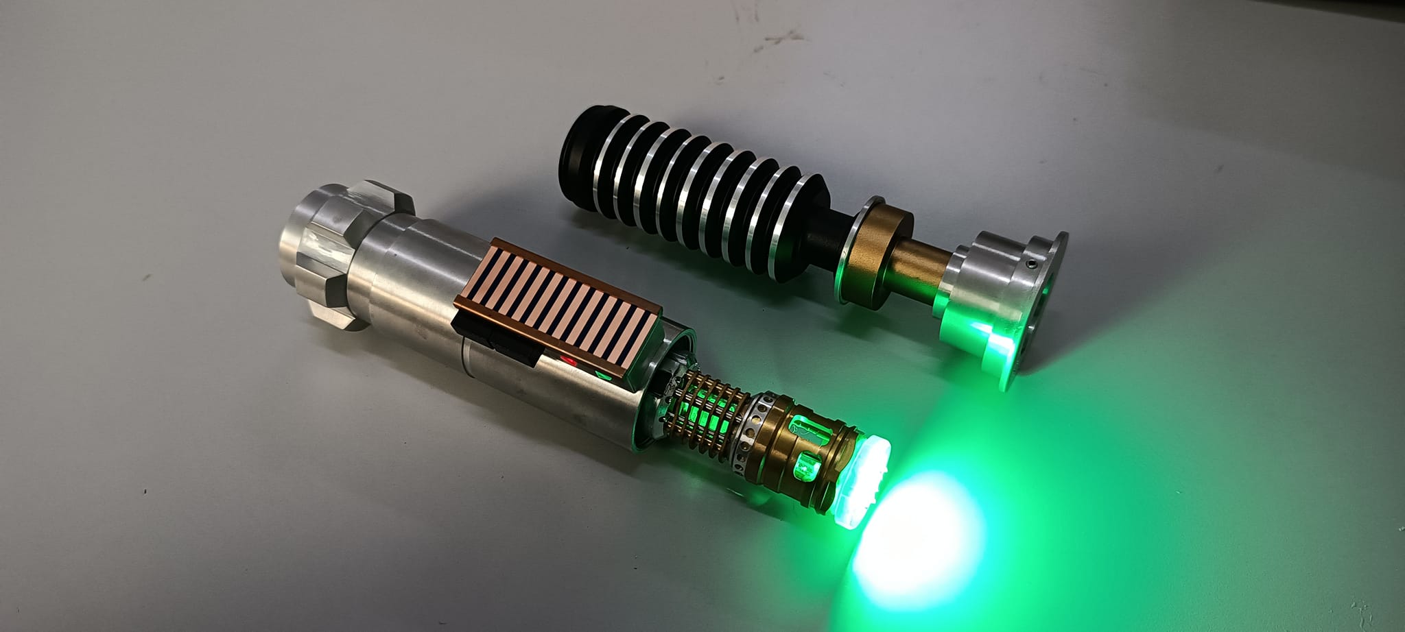

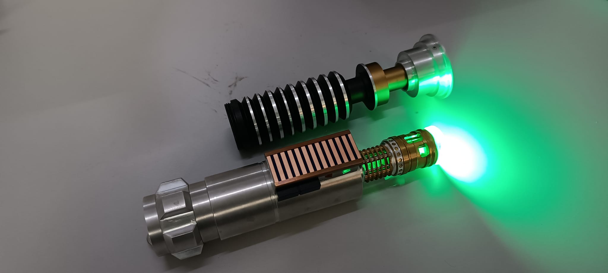

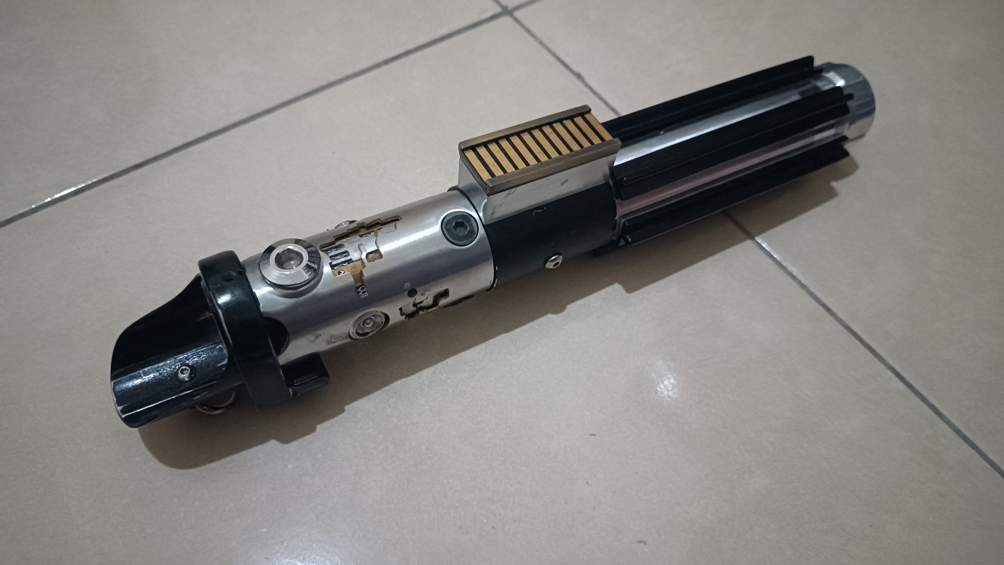

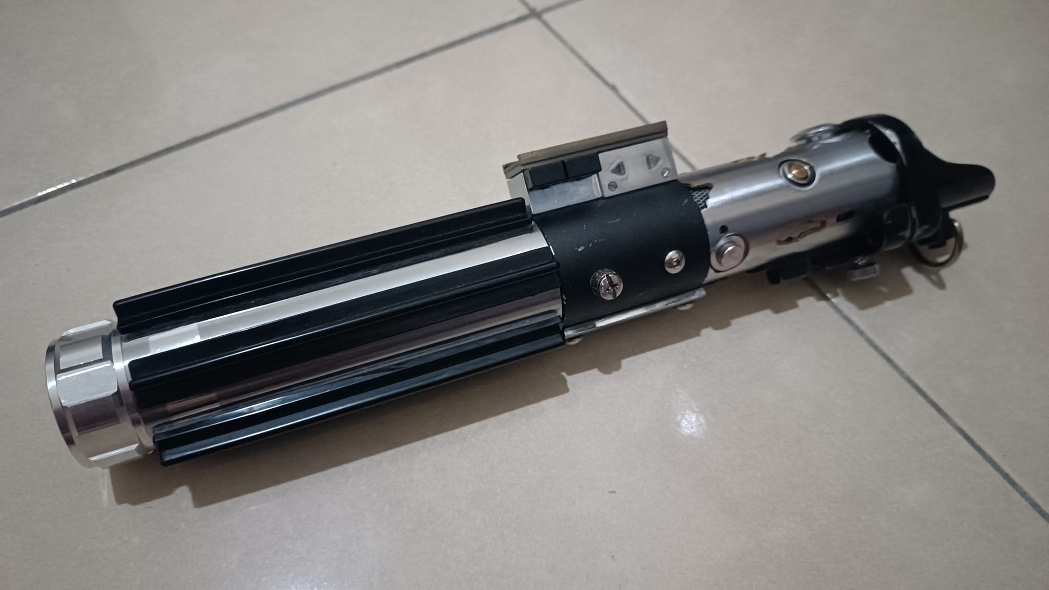

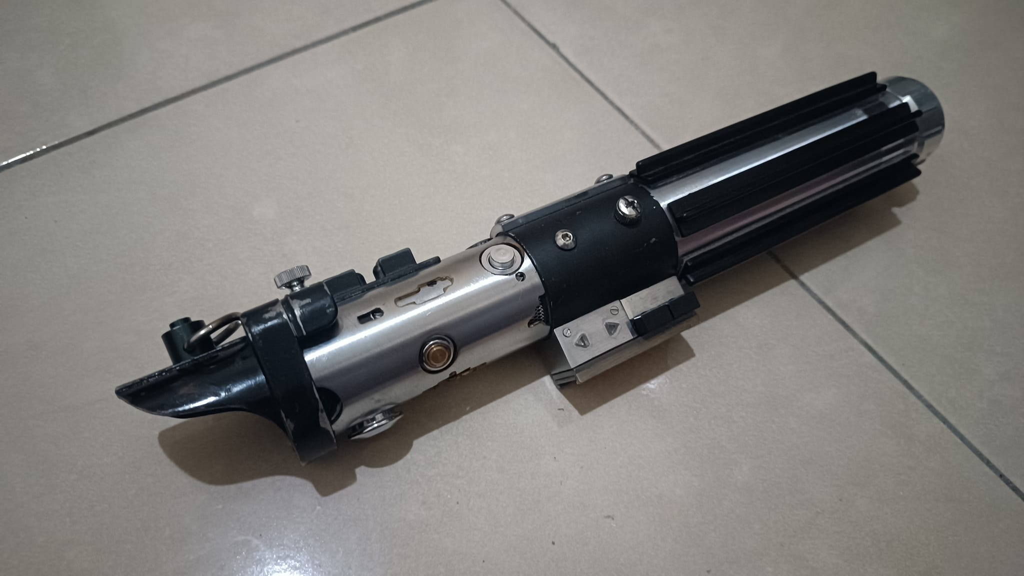

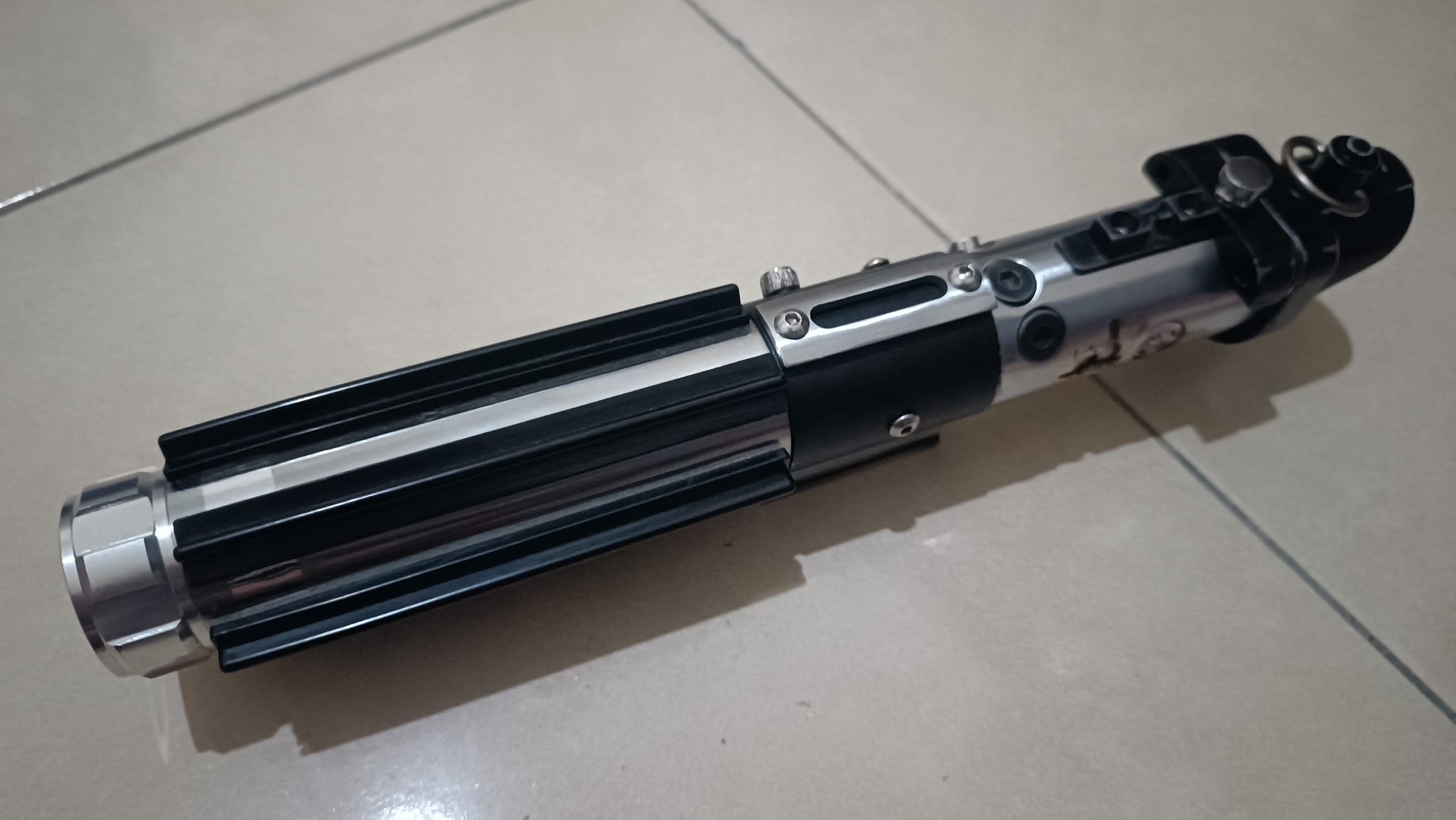

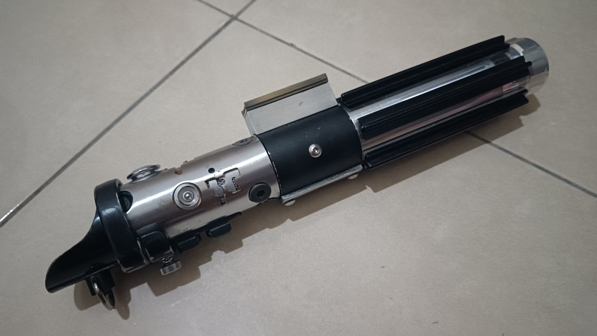

Anyway, I stumbled my old pictures of my previous project. A little bit of mash up between Episode VI (if im not mistaken) Vader and Luke Hero hilt that I am quite fond of. With some decorative window on the main body with functional switches on the body instead on the hero switch box. Installed with warsabers neocore.

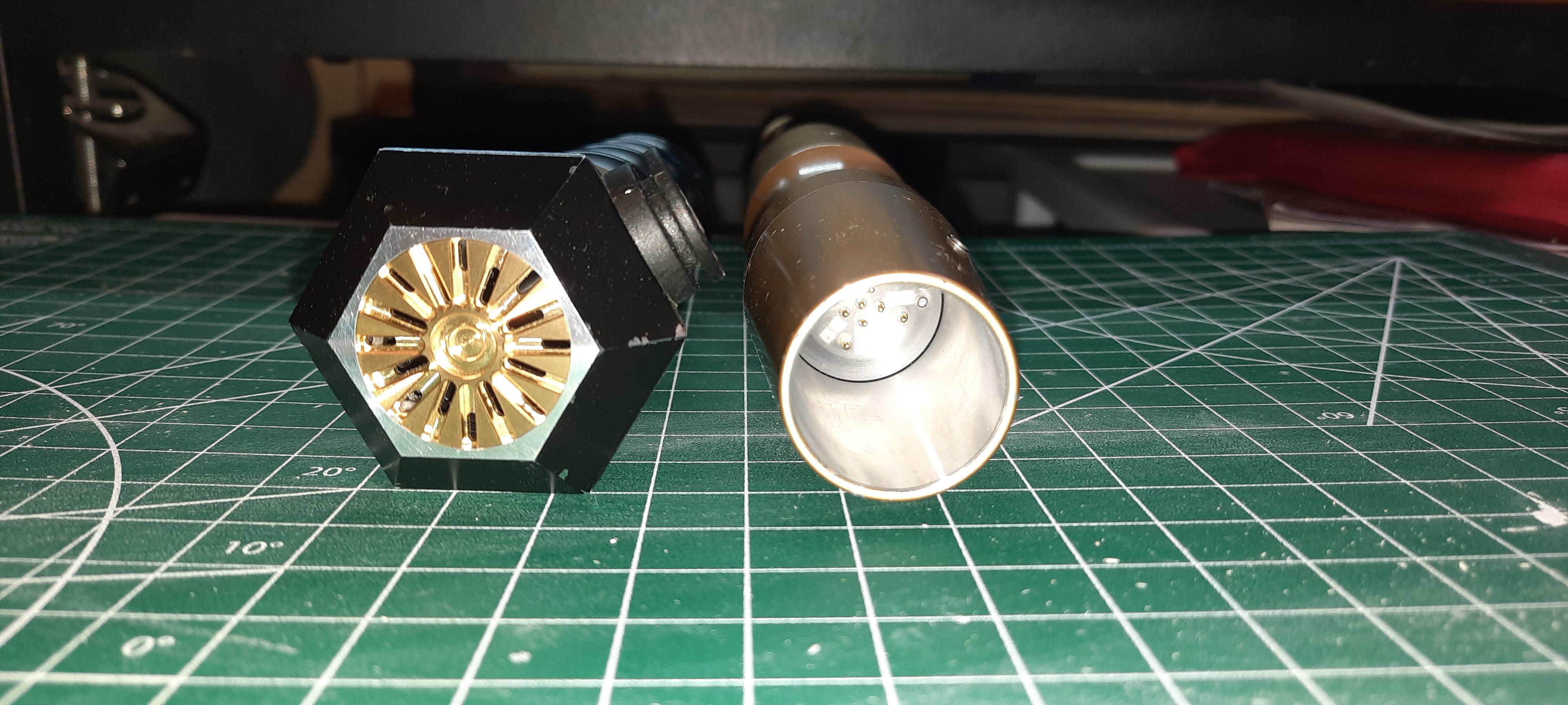

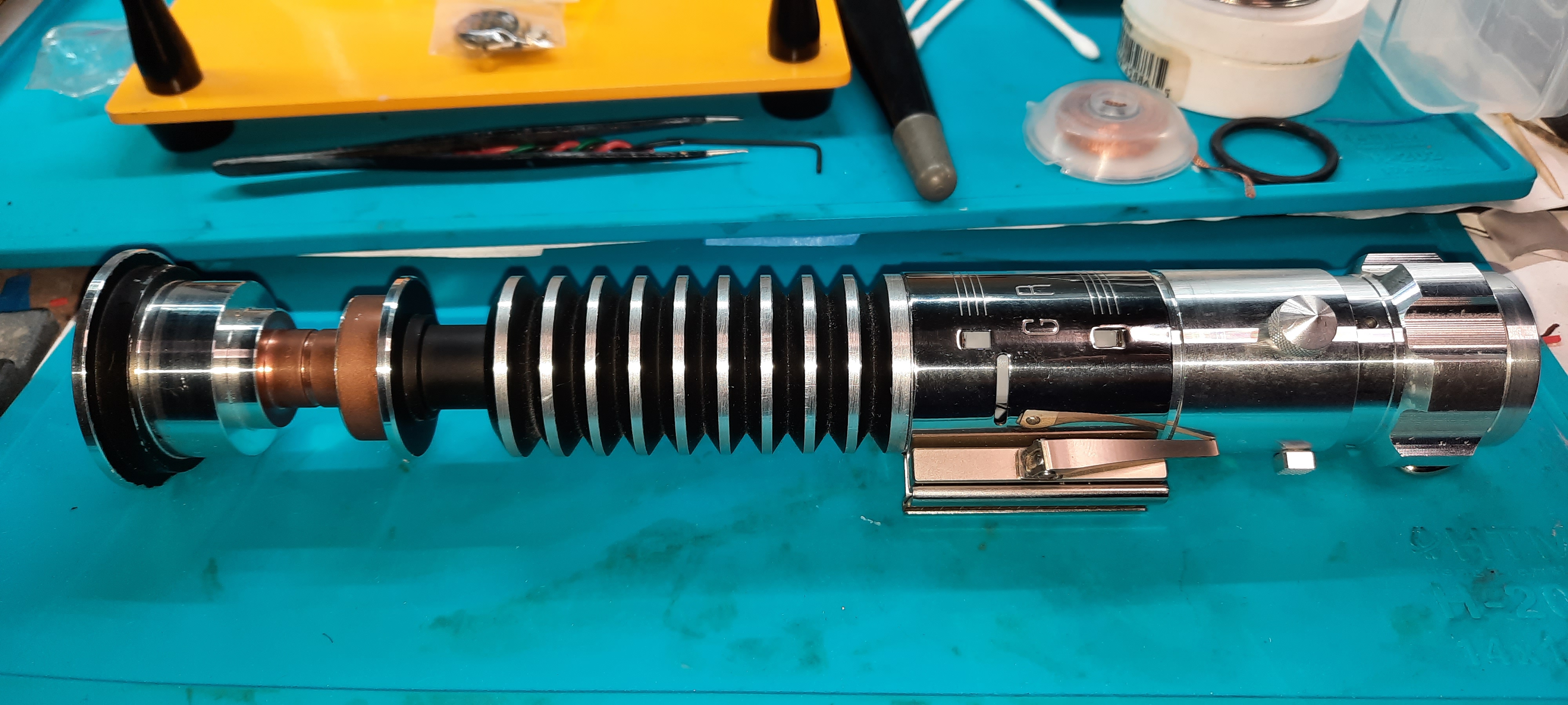

True, but its hard to get rid of the addiction and the collection grows even more together with the obsession. Haha. Another built that I'm quite fond of, although its more canon design.

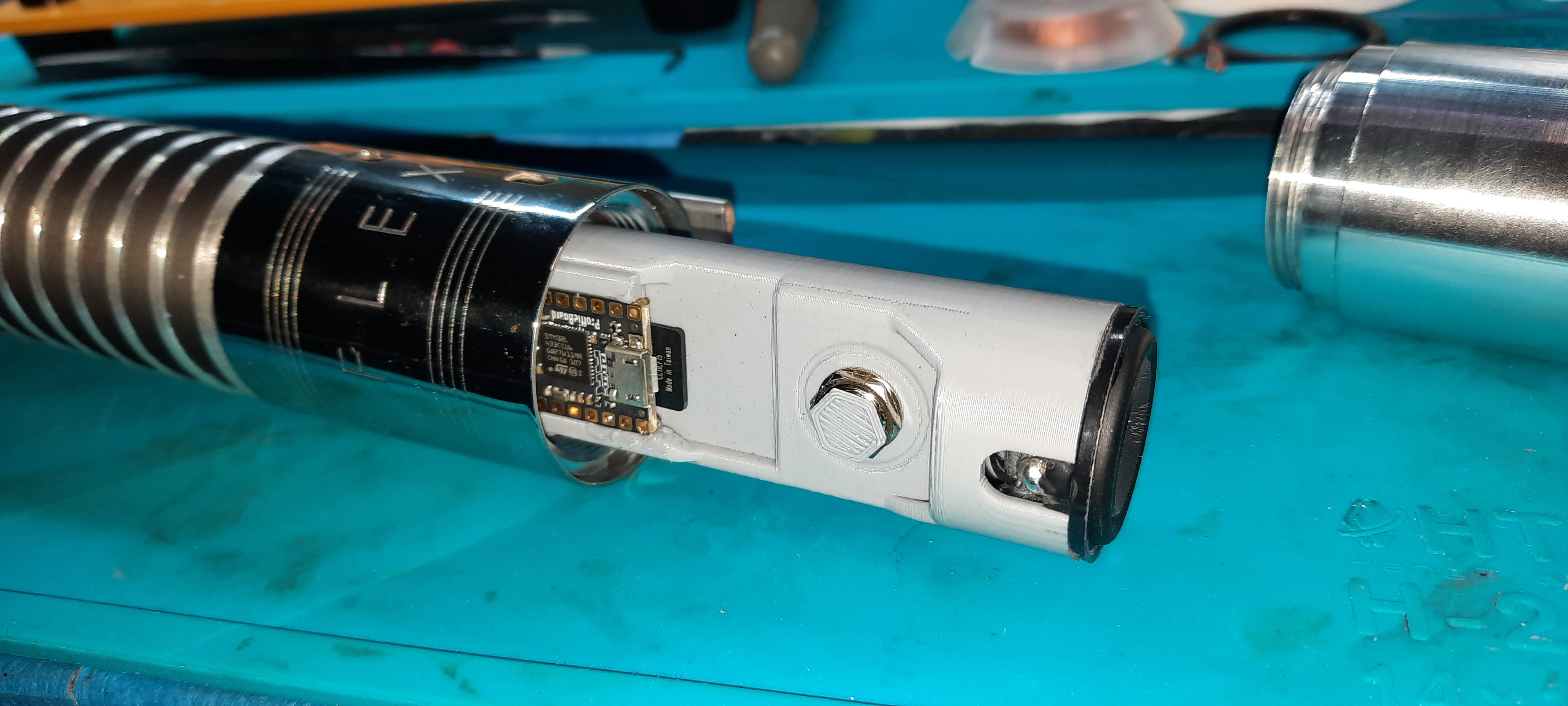

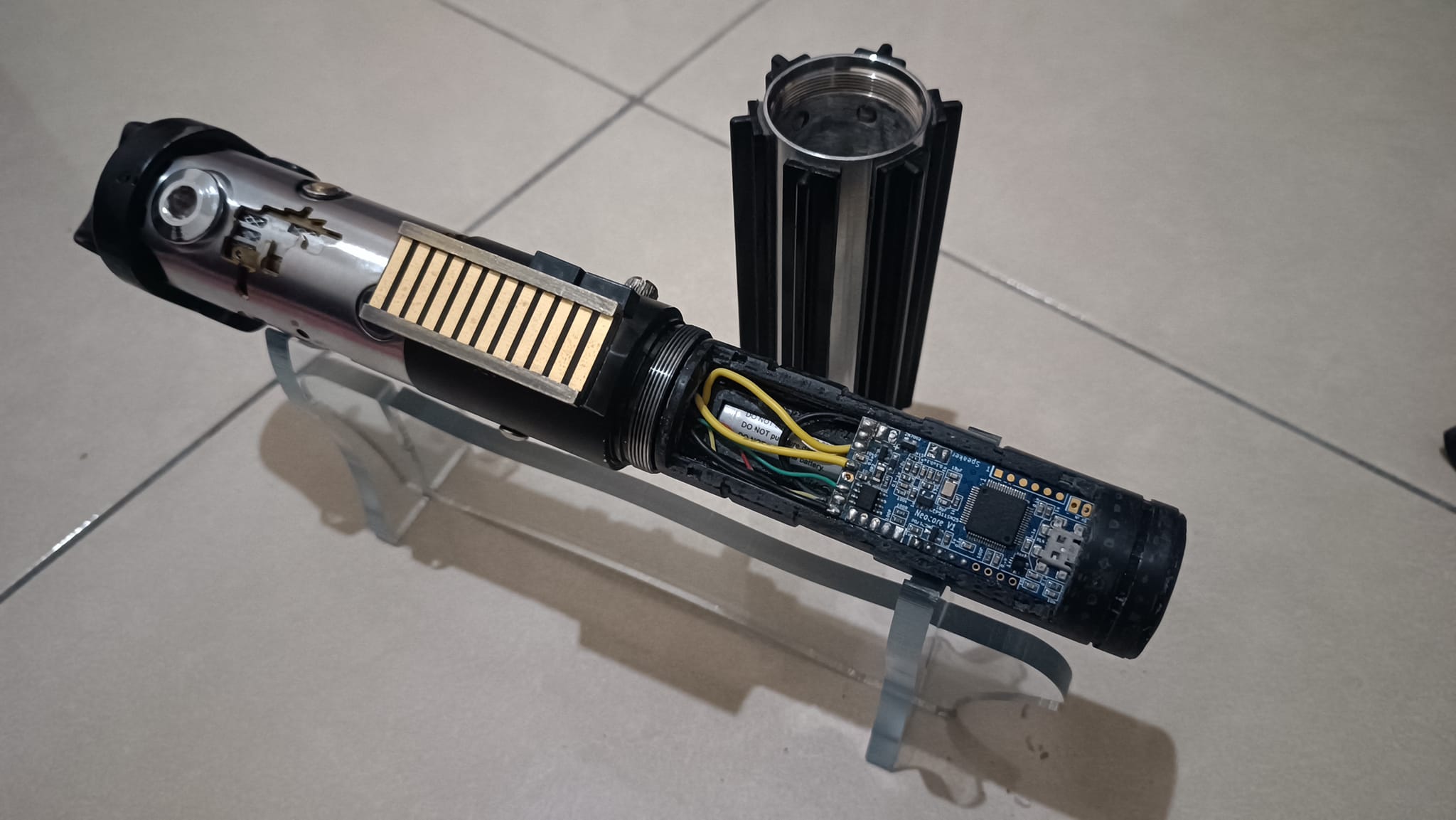

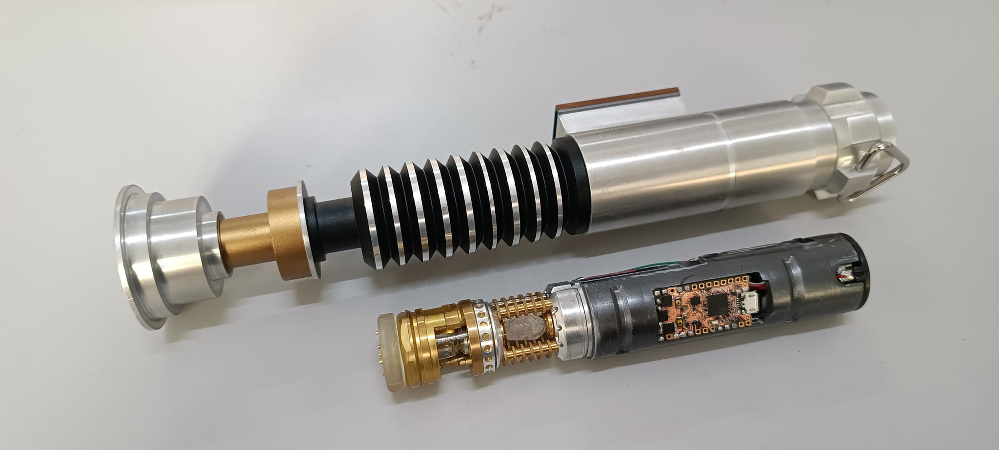

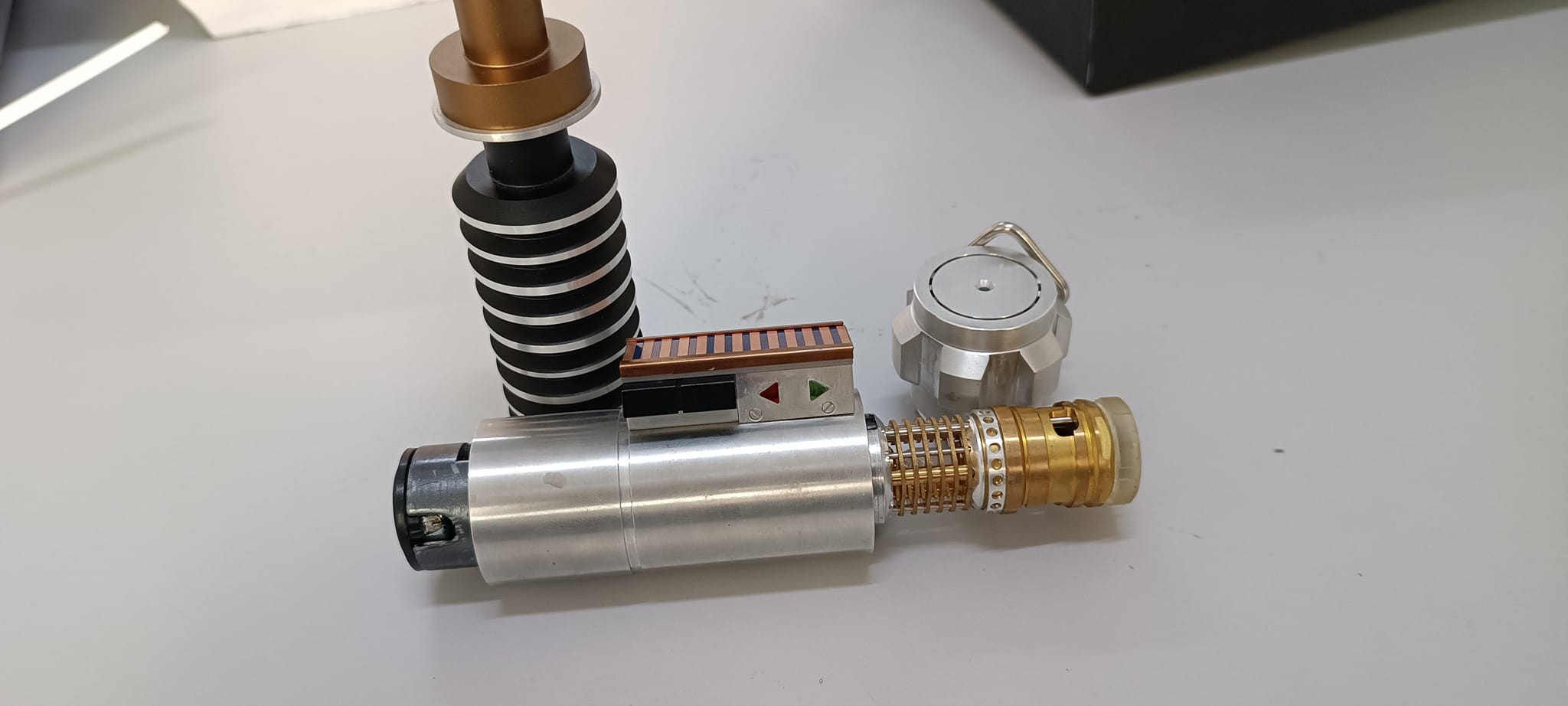

I have a Korbanth LS6 I had to have him install for me, Proffie 2.2. The chassis wasn't available to purchase separately.

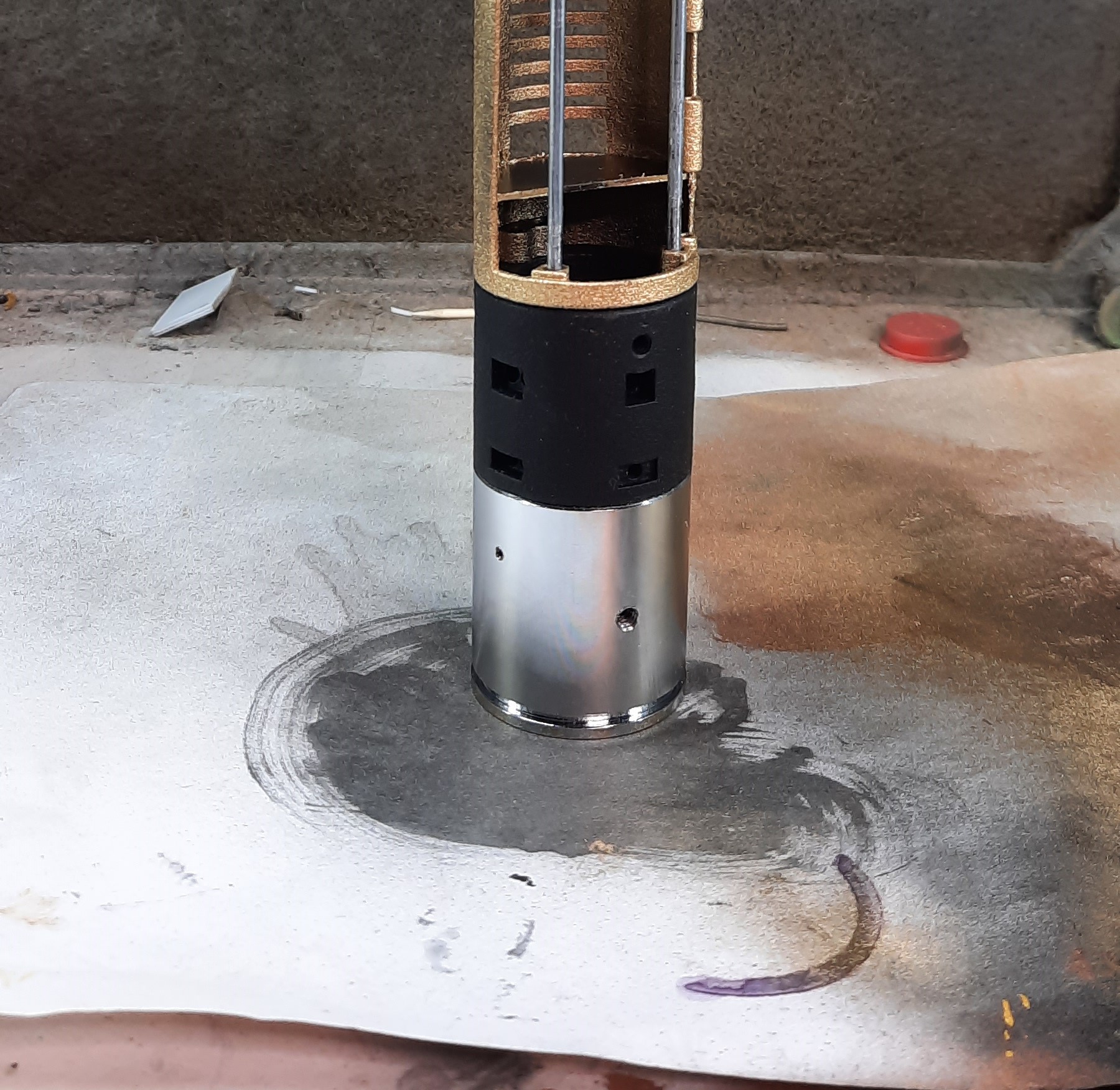

My first crystal chamber. 3D resin from shapeway. I got the chassis undecorated from Etsy.
I call it Battle Axe.

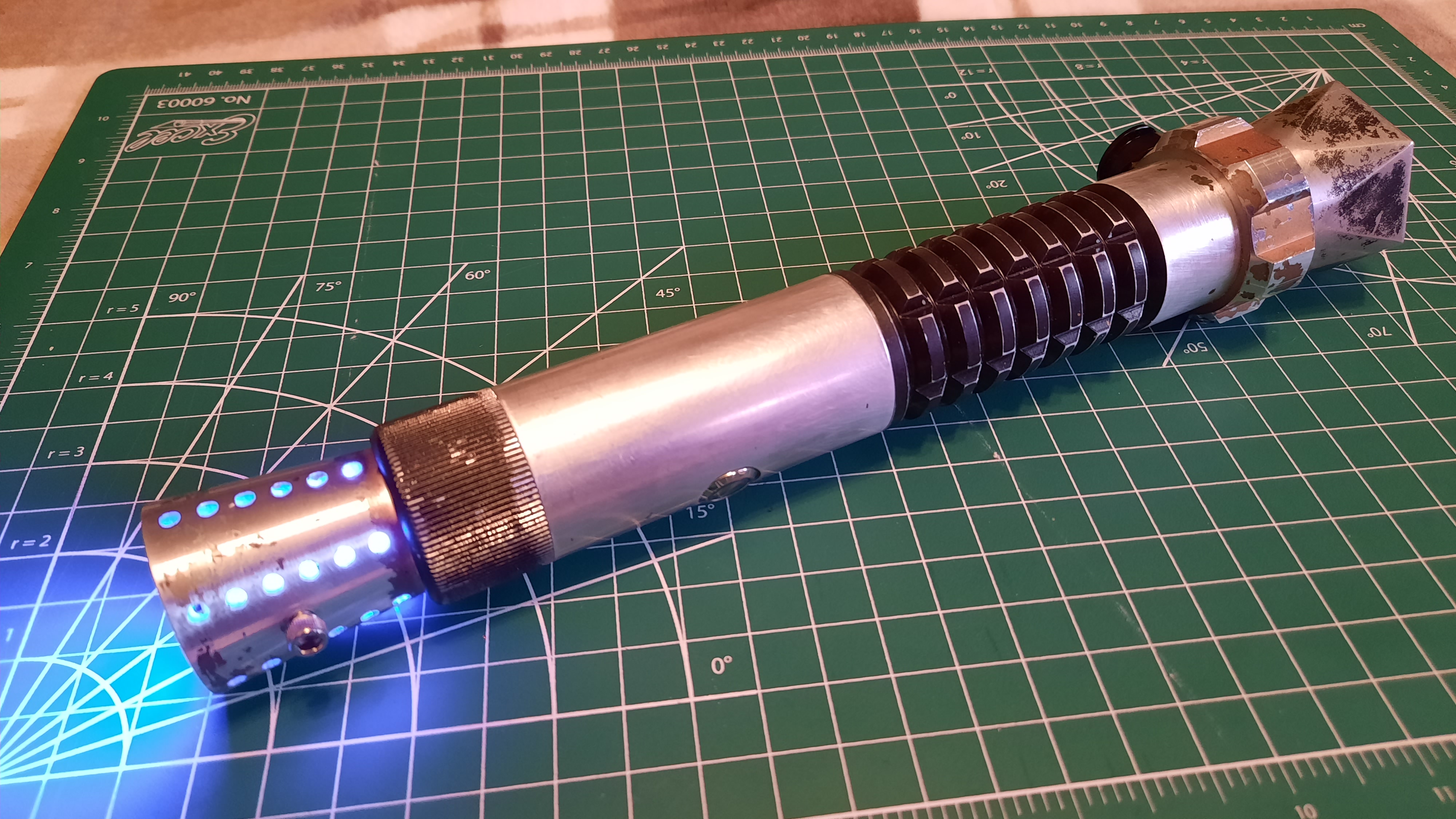

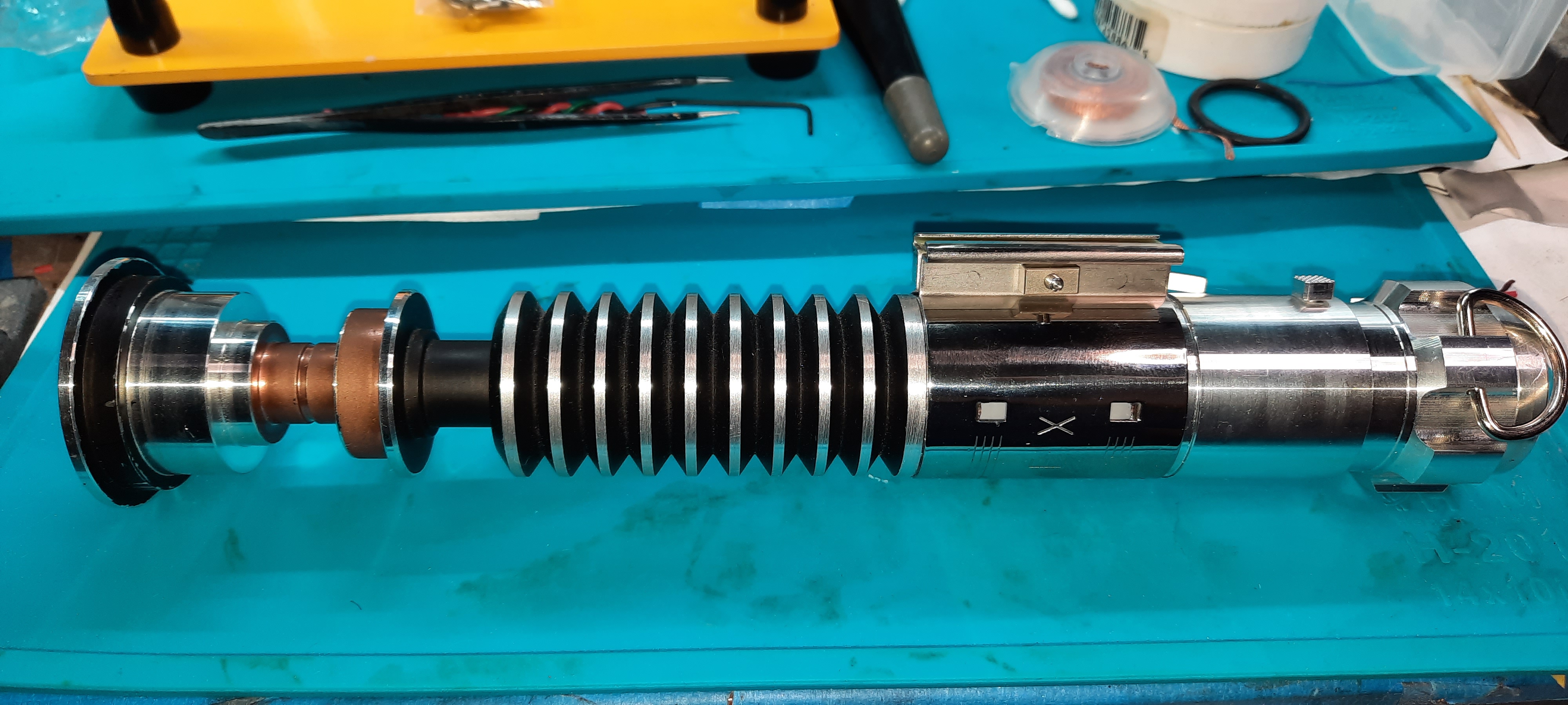

It's the Luke V2 V3 stunt basic saber. An older design for a more basic age.
Luke V2 and V3 stunt​

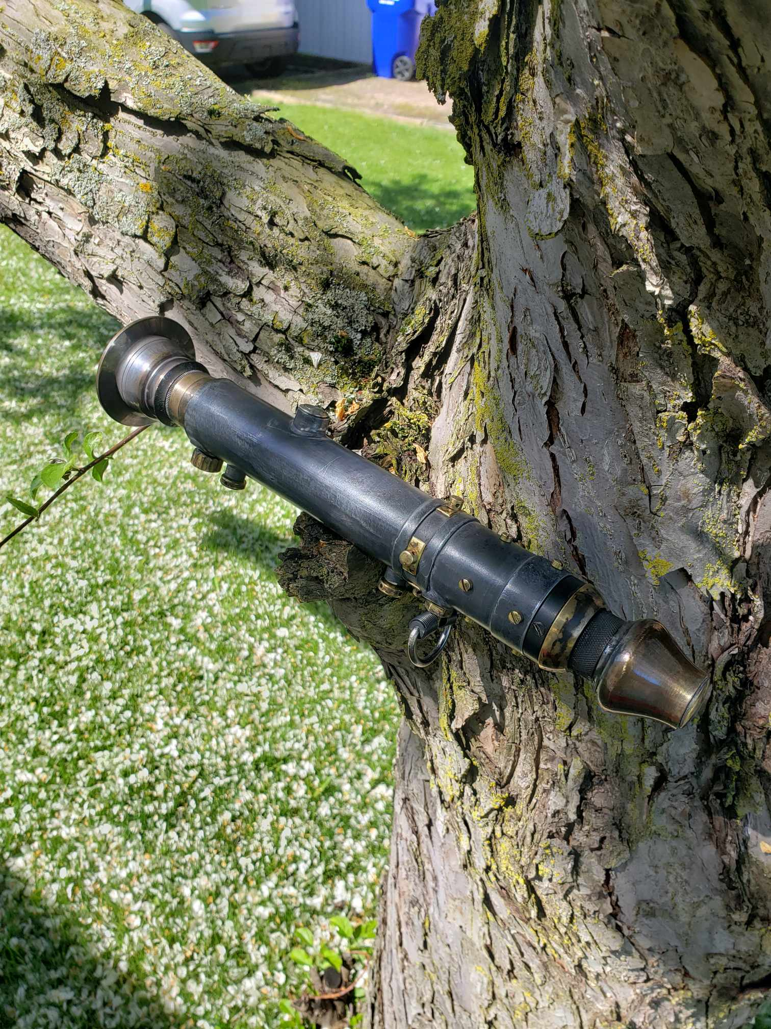

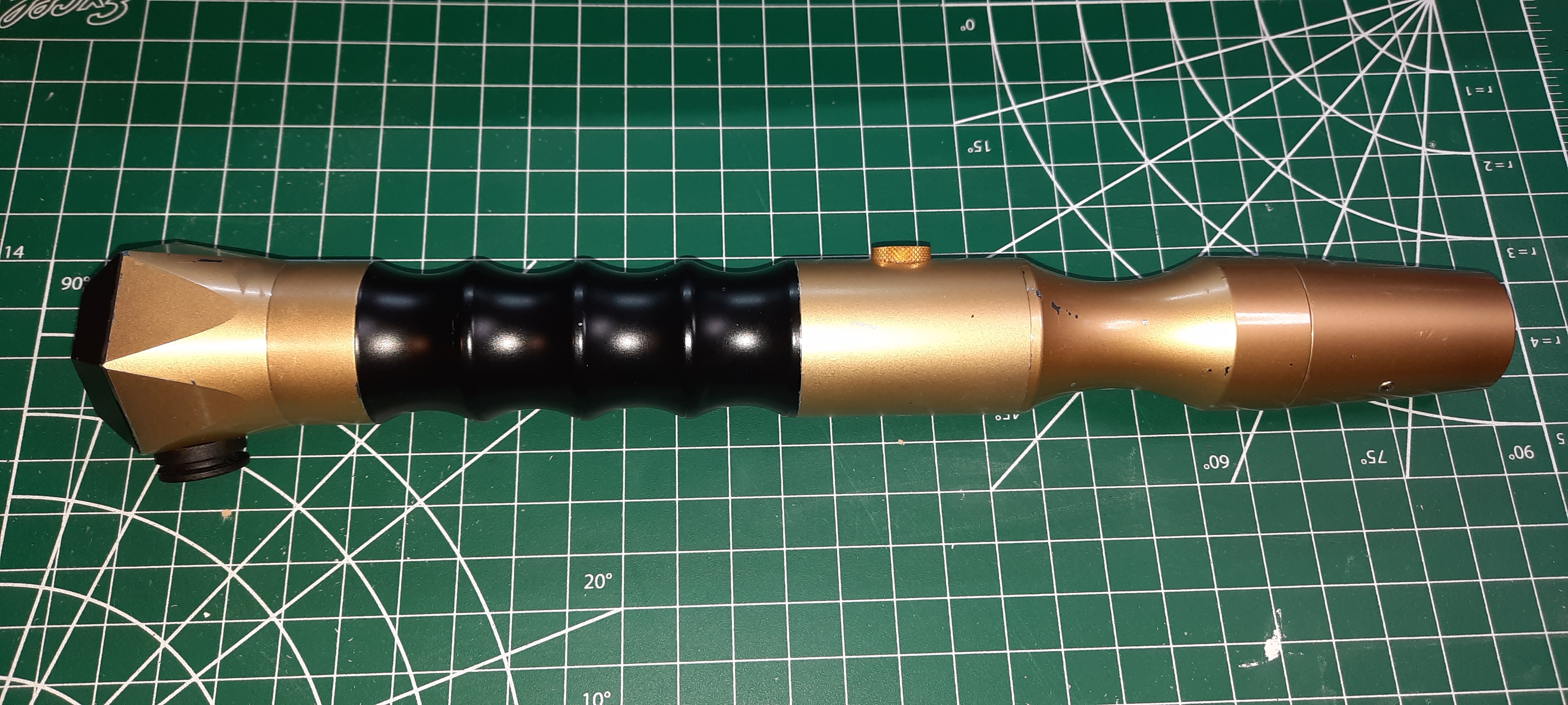

This is about as close to old/scrapyard tech as I've gotten. Just some TCSS sections with one of their prebuilt golden harvest chassis. And a fair bit of weathering.

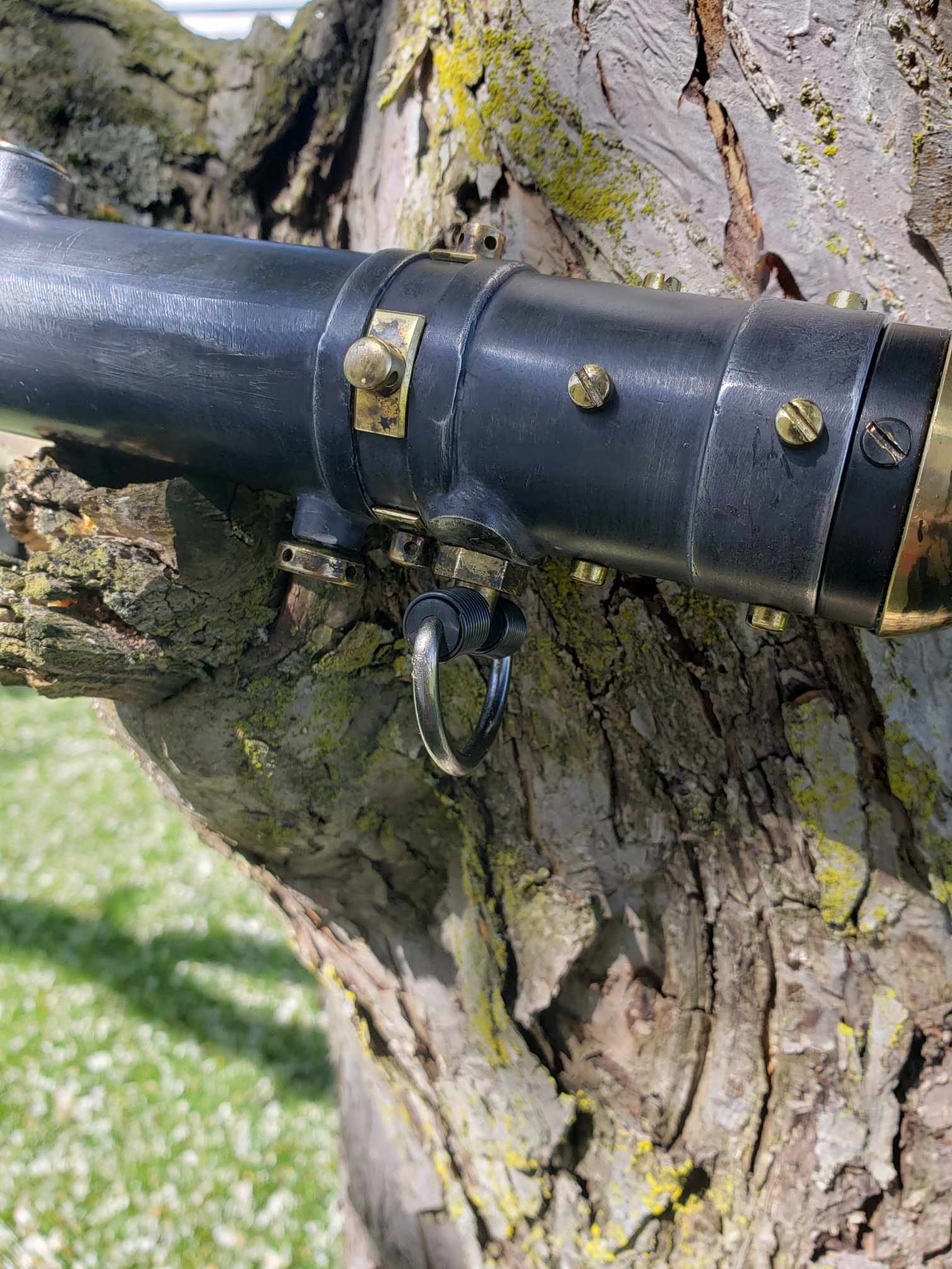

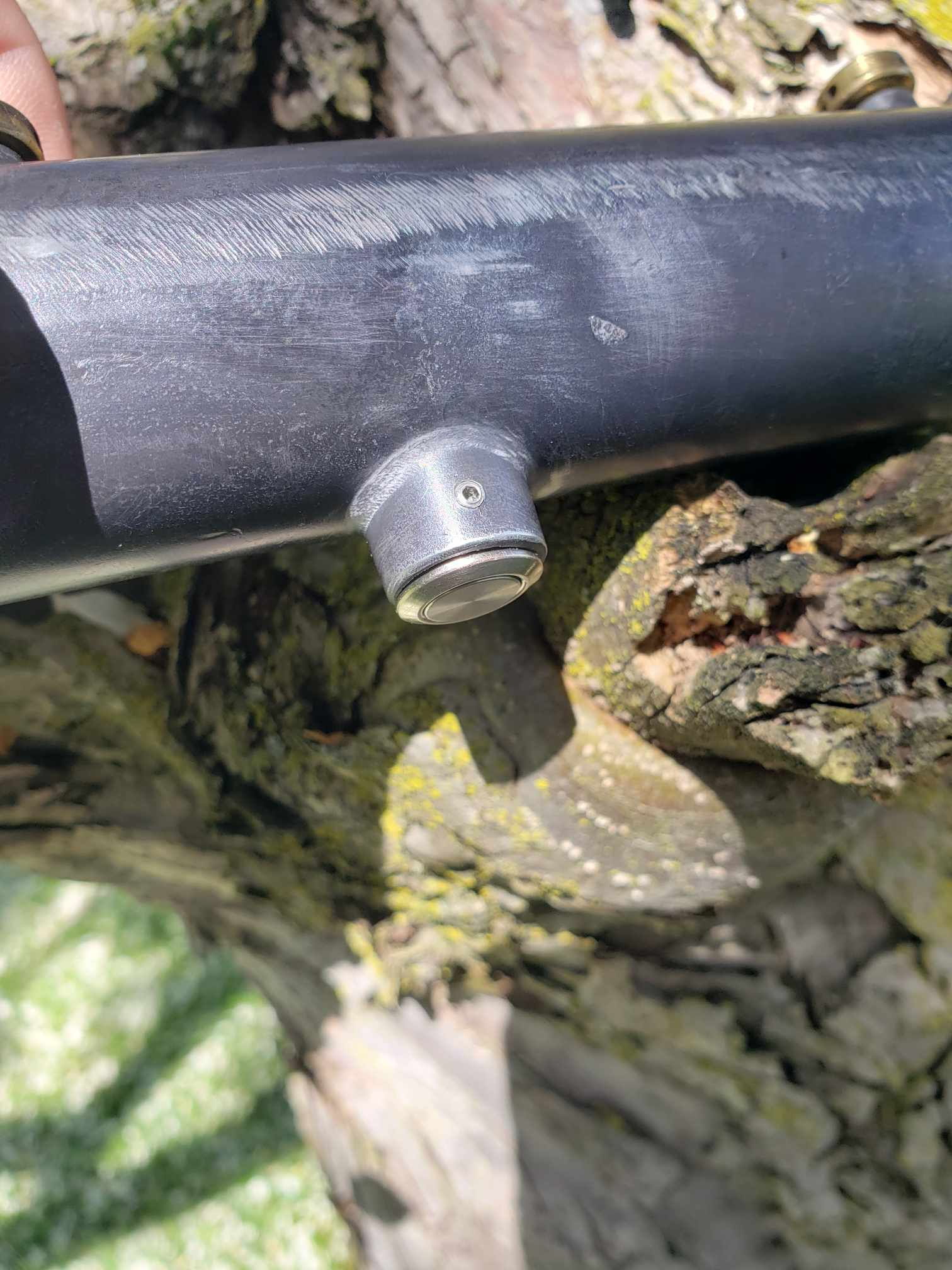

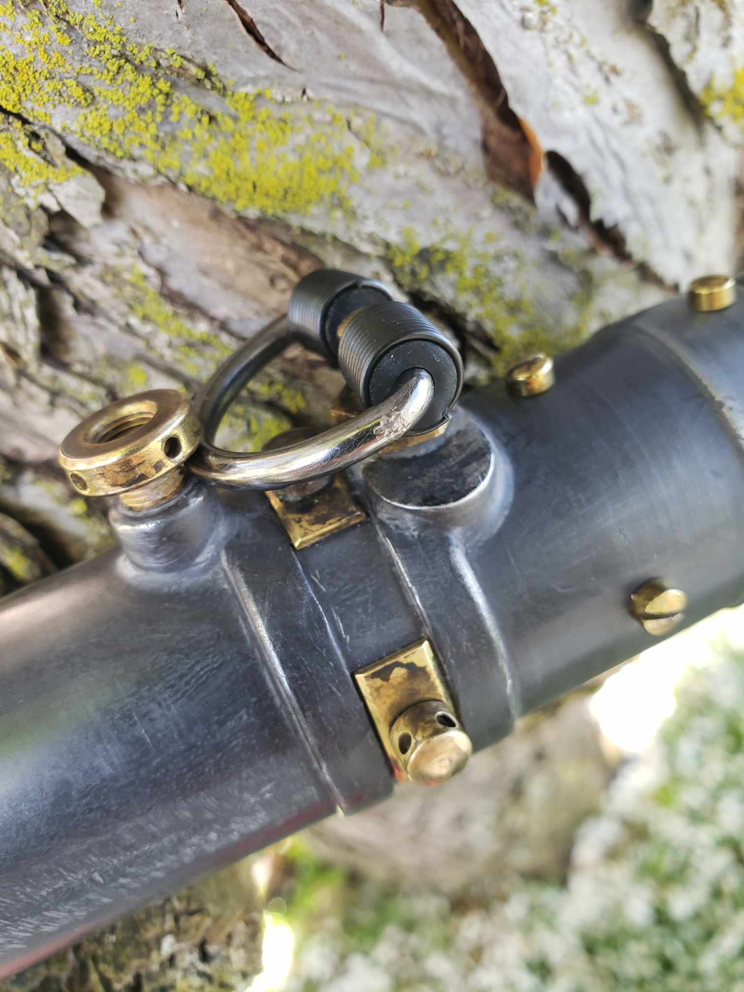

I was wondering, how did you do the weld seams on the button housing? Or is that real welding?
Are you talking about where the switch button is? if so, i did no welding at all to this. The base of this hilt is an antique surveyors scope that i modified and used some of its internal parts for greeblies and to house the emitter. I removed all the Cerakote paint as well{That is a pain to do, btw), and i chemically aged the whole hilt.

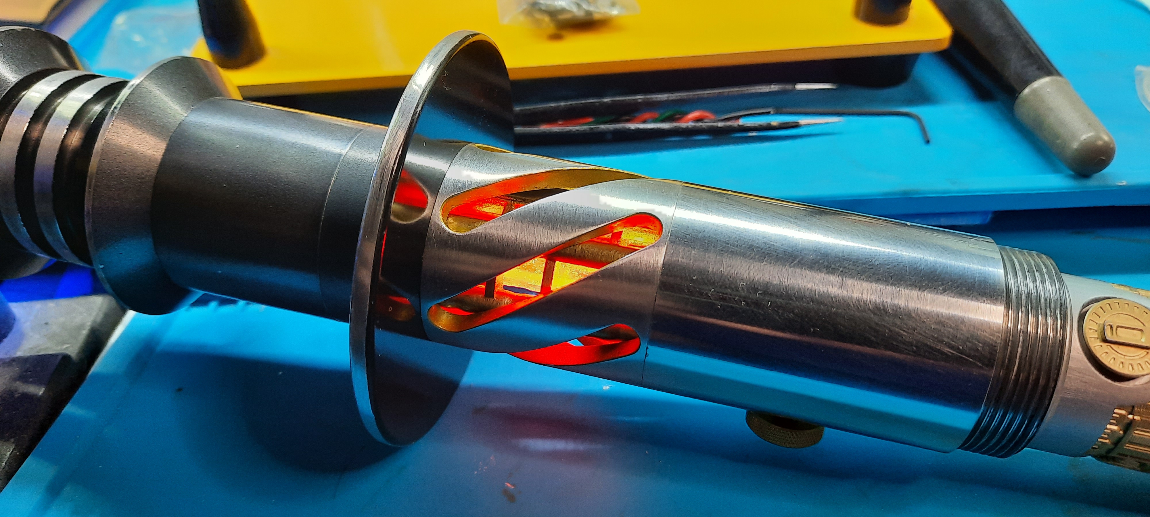

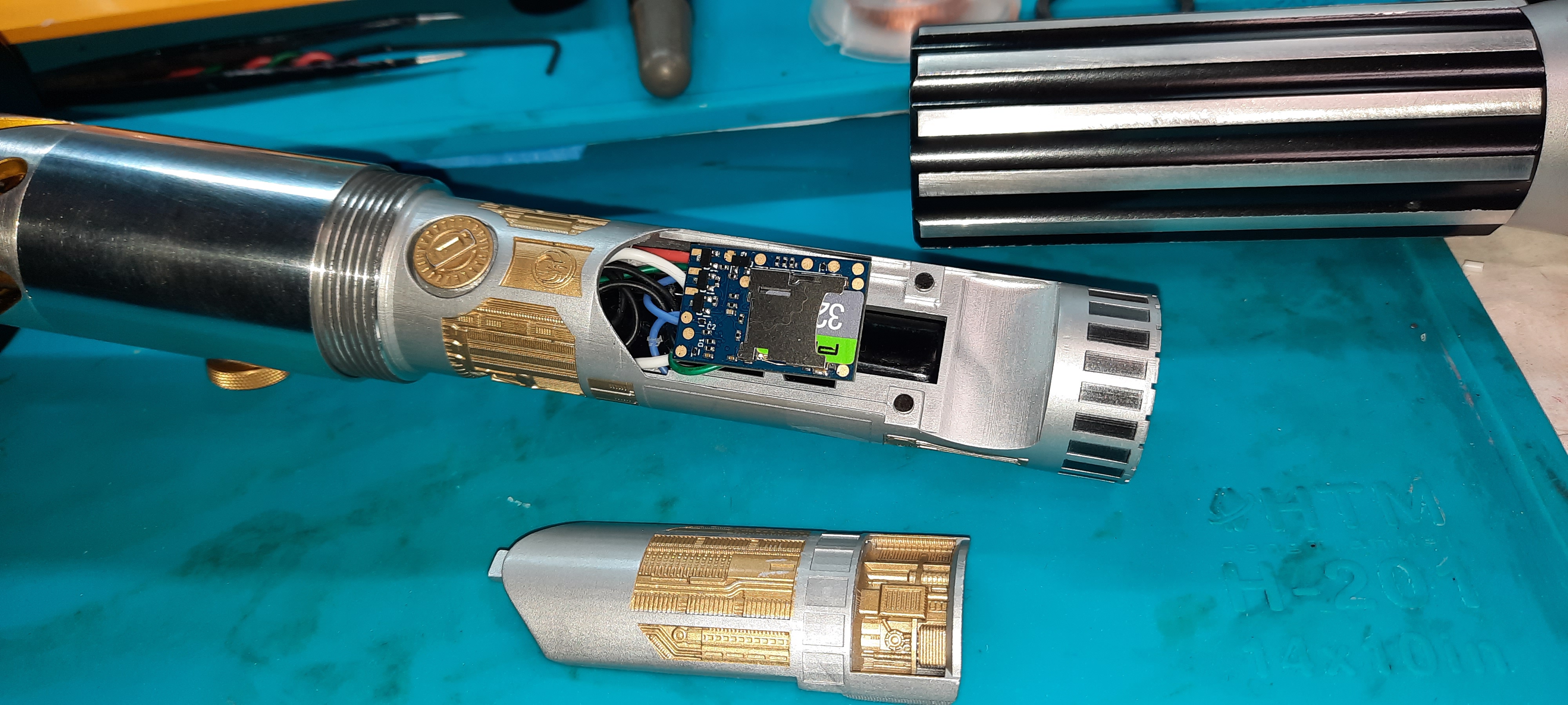

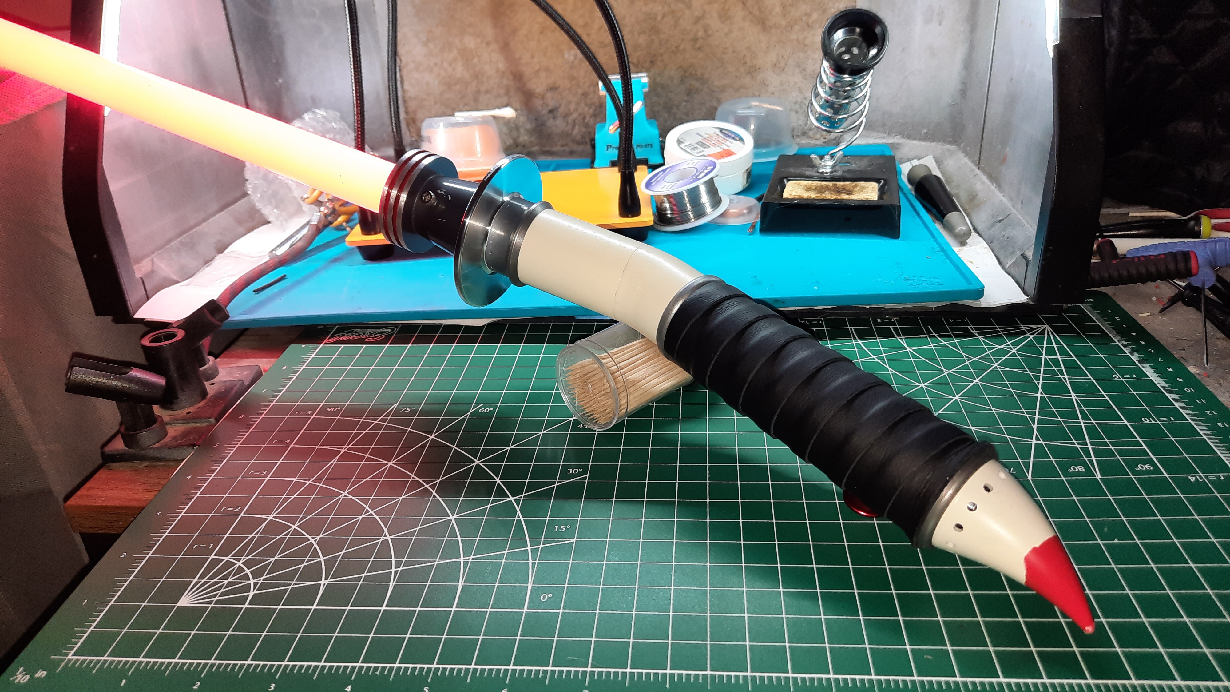

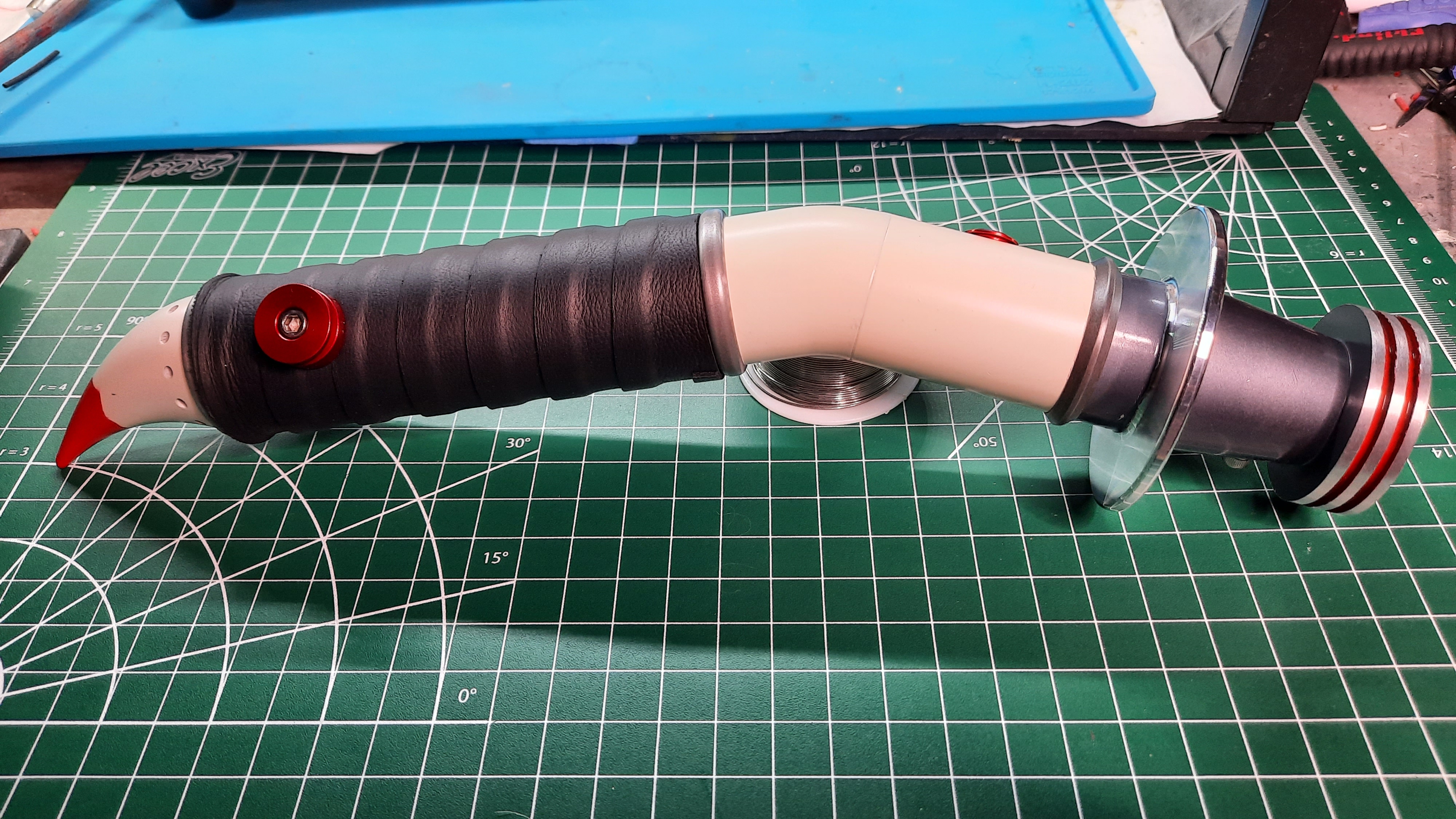

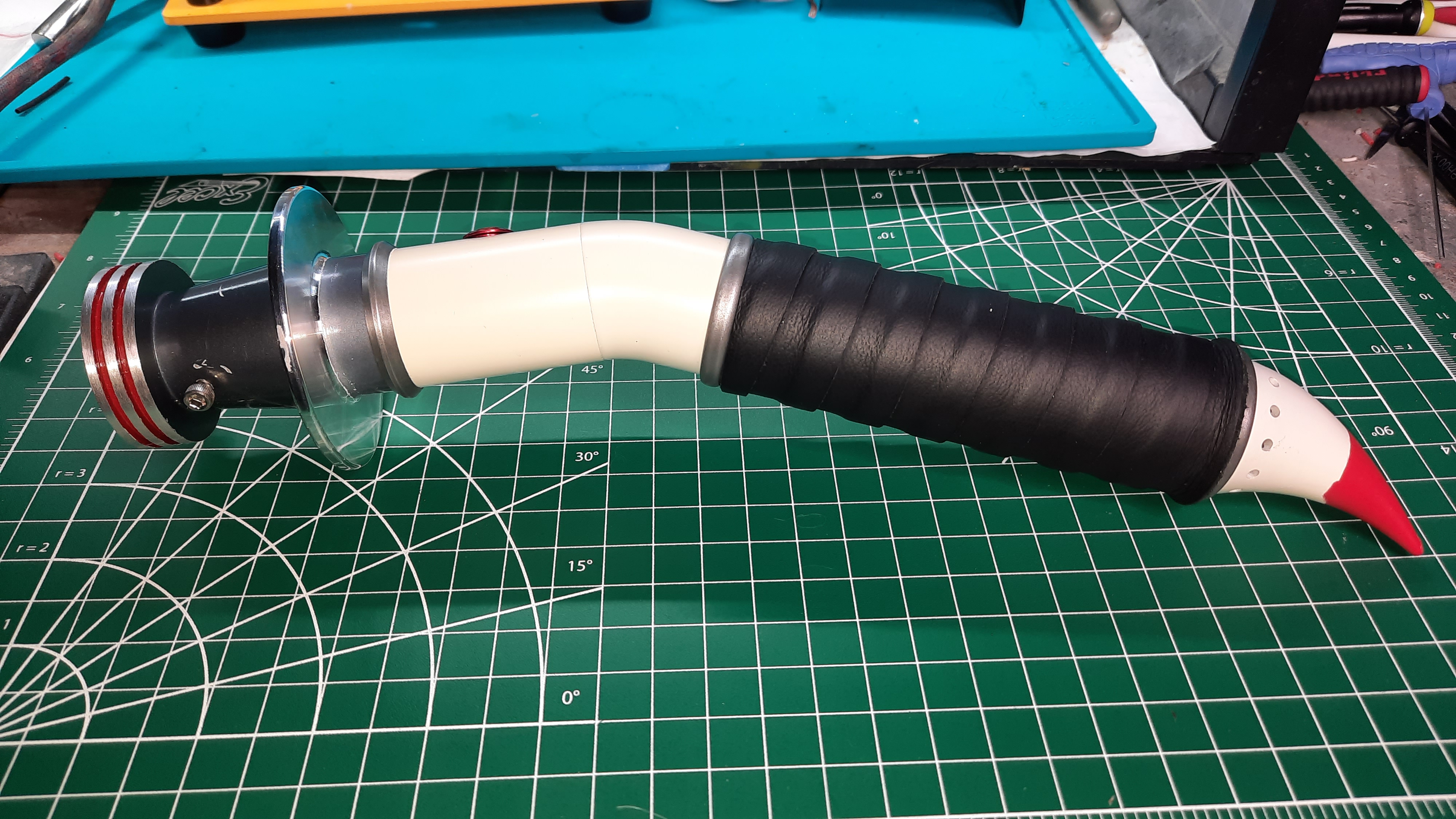

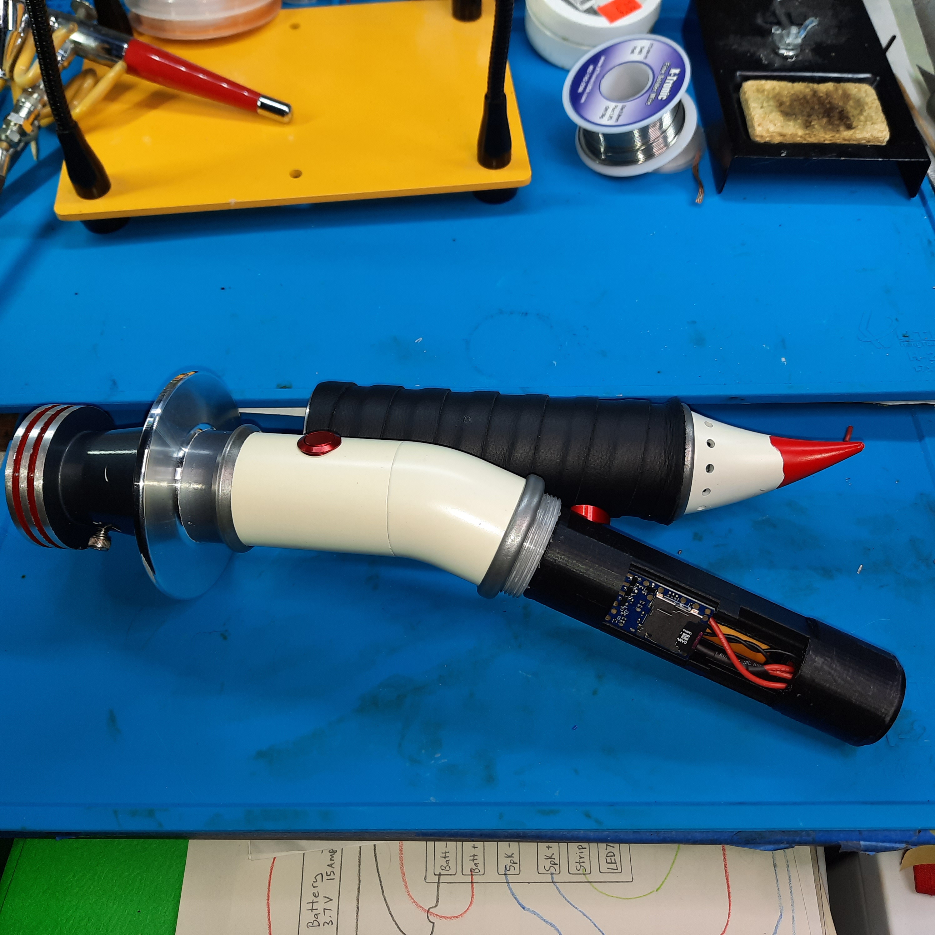

I just finished this one last week. I think I'll call it Dragon's Claw. It's an all TCSS parts build with a 3D printed chassis off Etsy and powered by a Golden Harvest v3 sound board. I changed the user interface voice to Darth Maul by downloading a new sound folder from the Sabertec website and added several new sound fonts from Kyberphonic and Ksith.

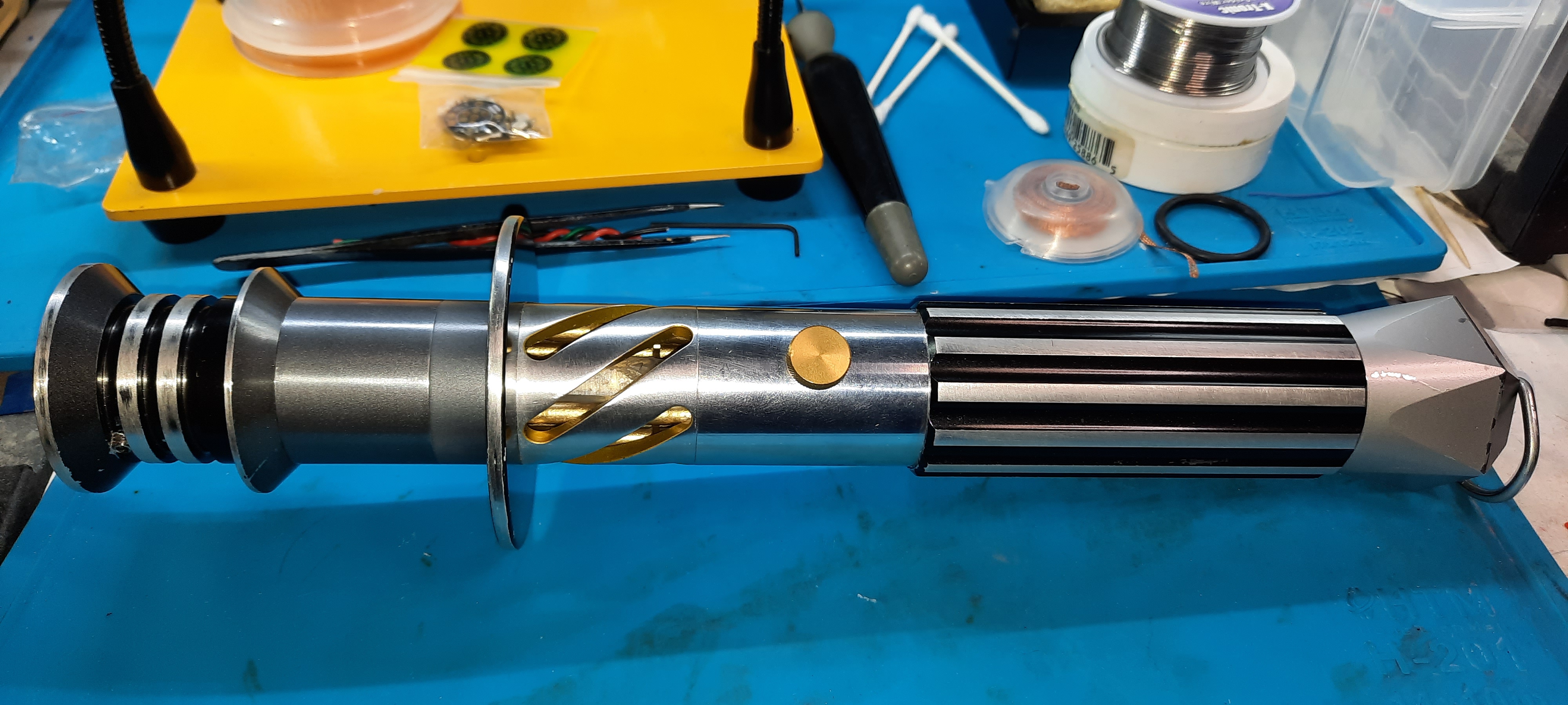

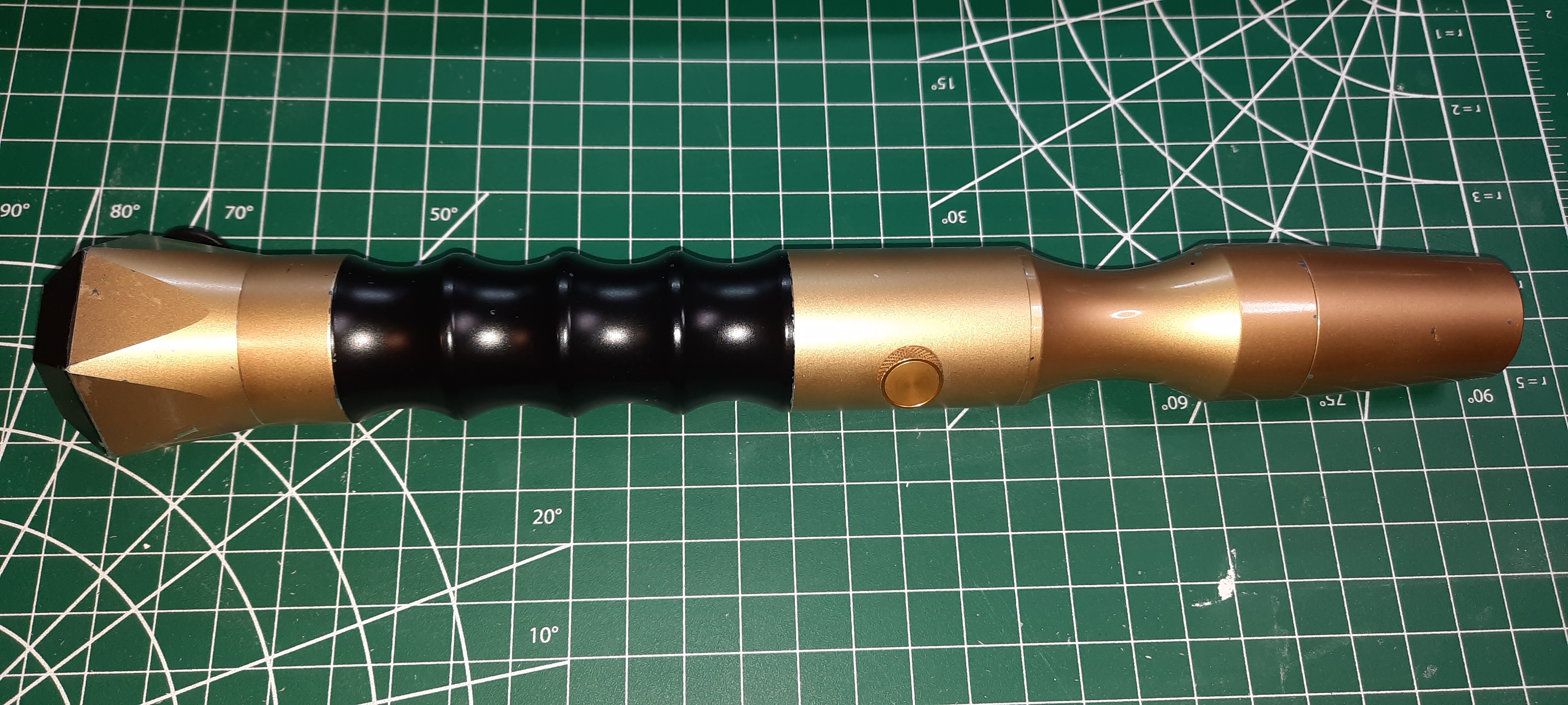

This is Goldenrod. Another TCSS parts build with a 1.1" universal removable chassis from Saber Bay in iridium gold PLA. She's rock'en the latest in Golden Harvest v3 blue boards and a 28mm Smugglers Outpost Dark Side speaker. The hilt side PCB is a ShtokCustomWorx piece.
I wanted a sleek minimalist looking saber that would look like something from the height of the Old Republic.
