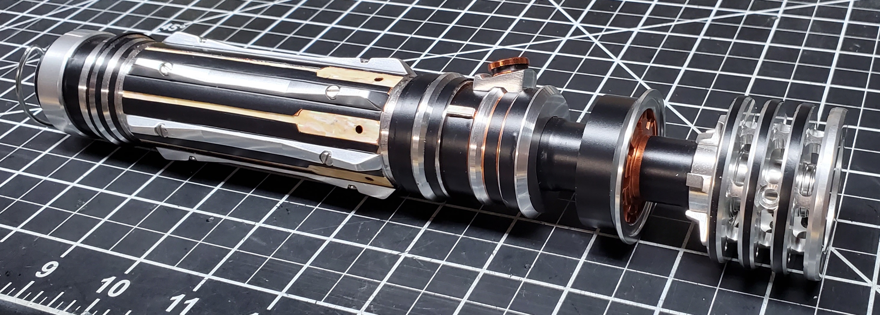

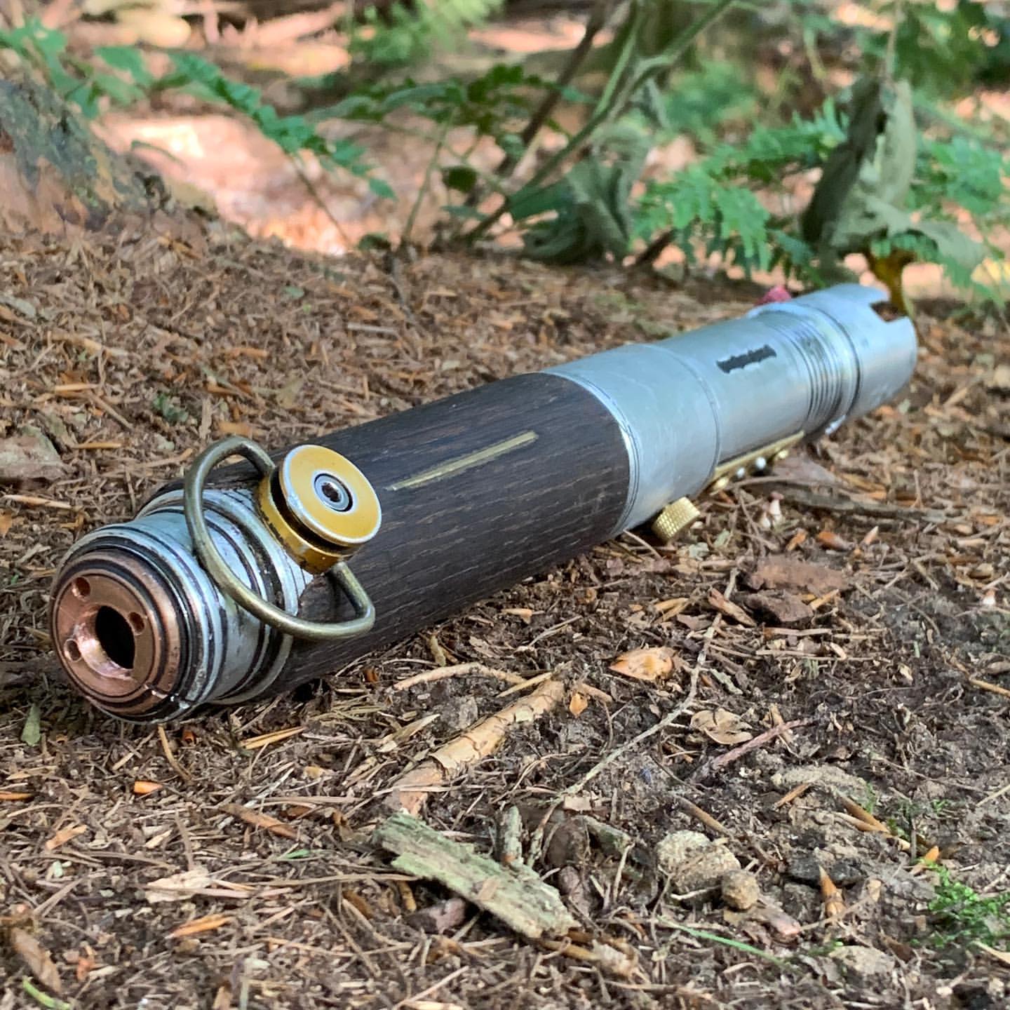

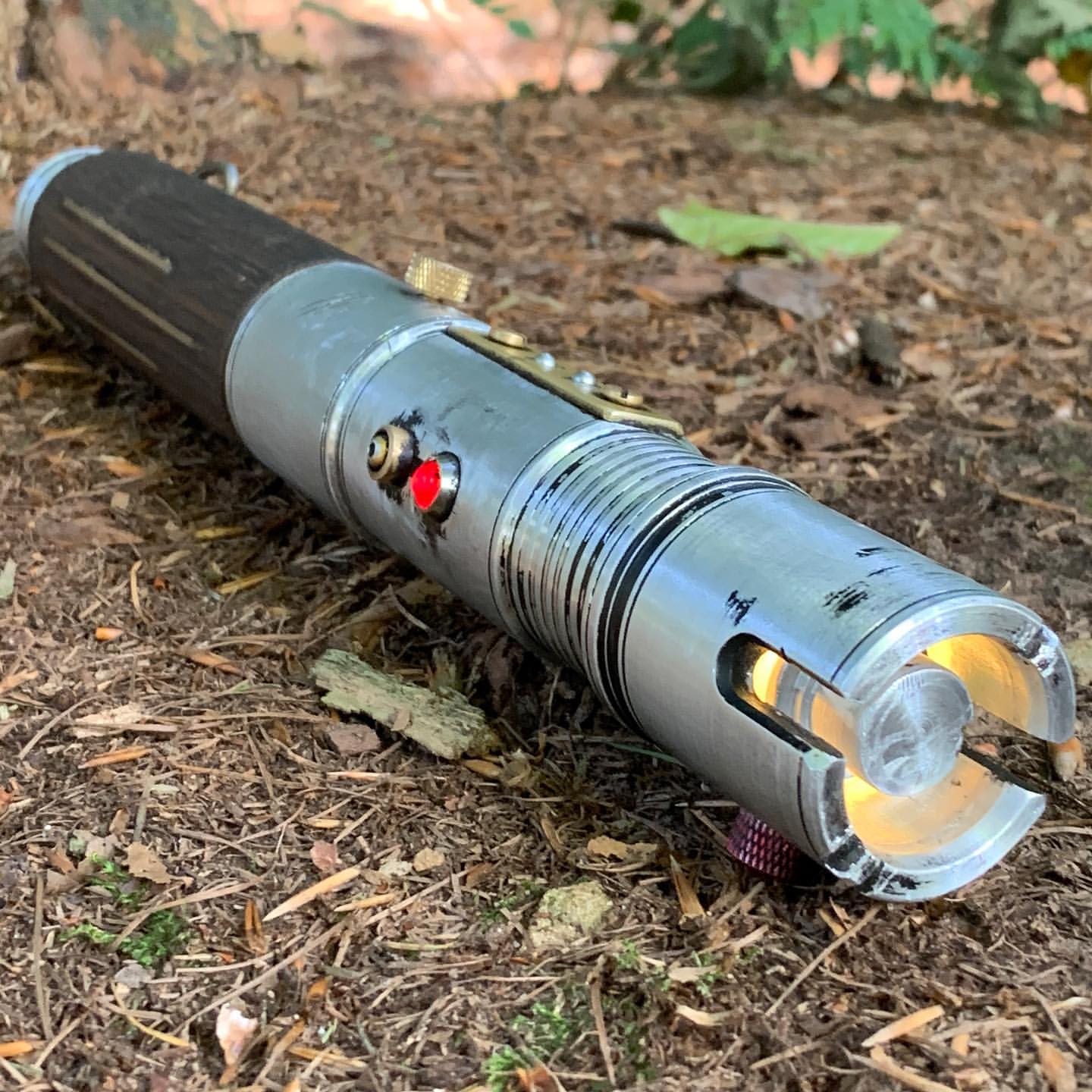

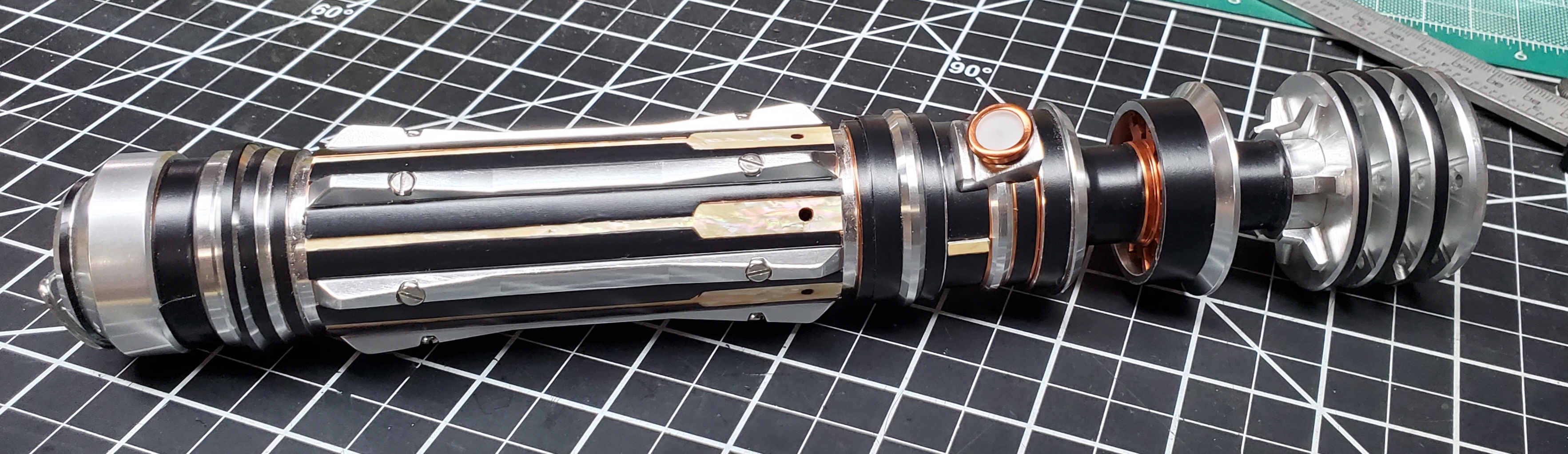

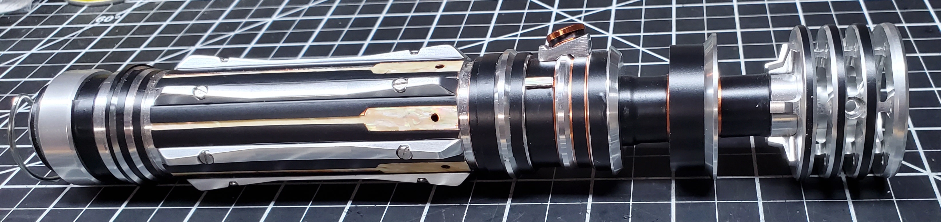

Hand made by Kennedy Custom Props to my specifications. I added the wood veneer with brass inlay. Proffie pixel, of course.

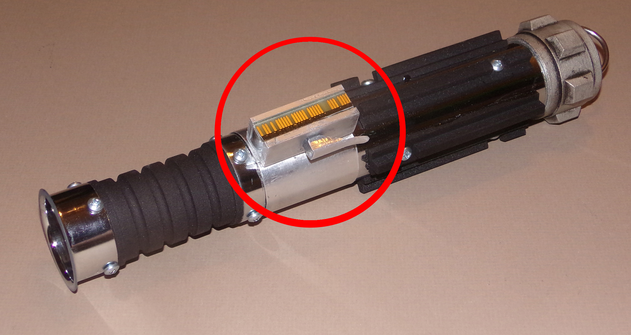

I'm about 60% into my next hardware build, but I'm having a hell of a time finding things that would serve as buttons, knobs, activation boxes, etc.
Does anyone have a go-to source for that kind of thing, or is my best bet to get those parts from TCSS?
I just use thin aluminum cut, bent and glued into place. Here is one of my old sabers that I used this on. The saber's not great, but you can see how the control box came out...

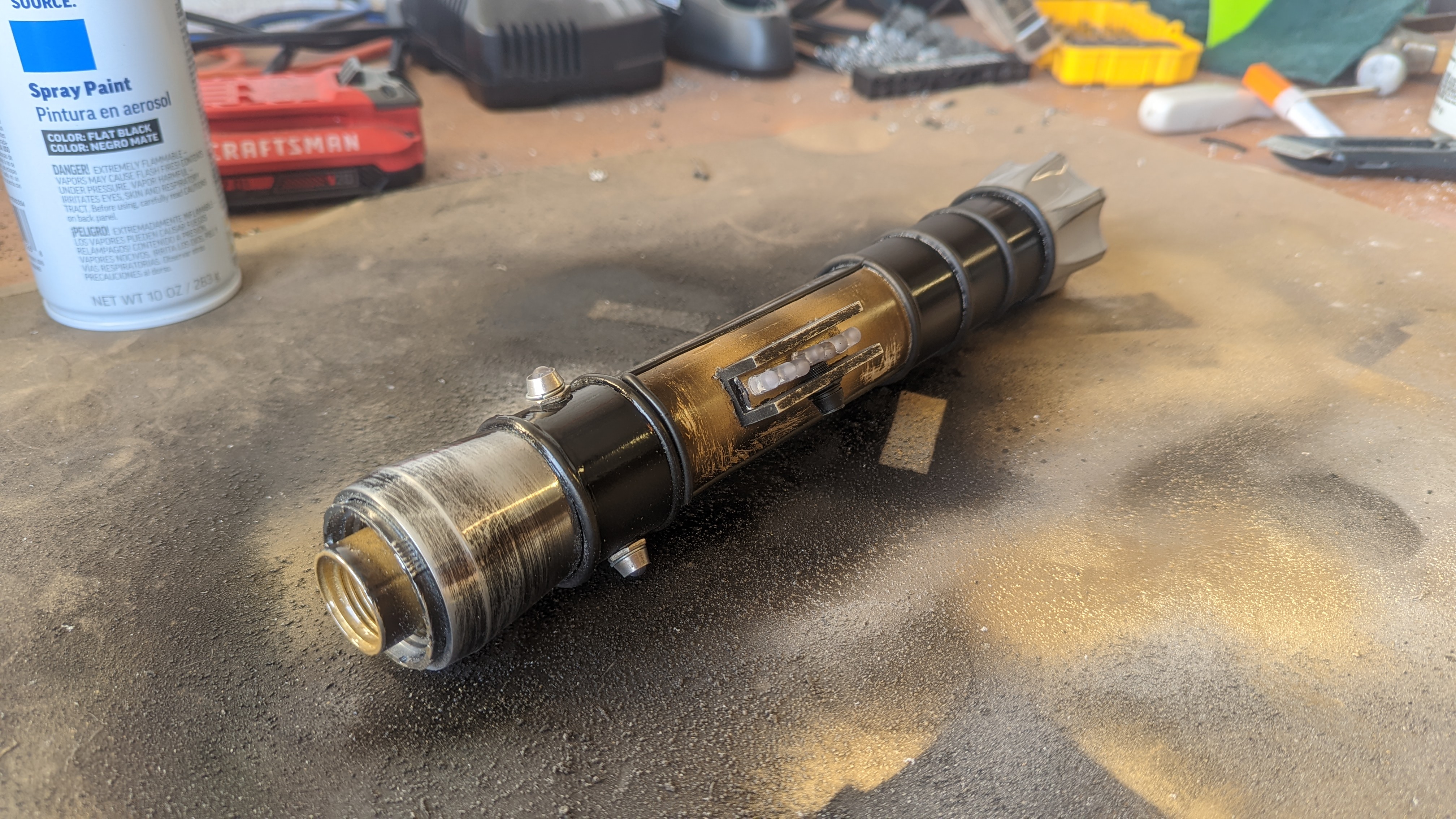

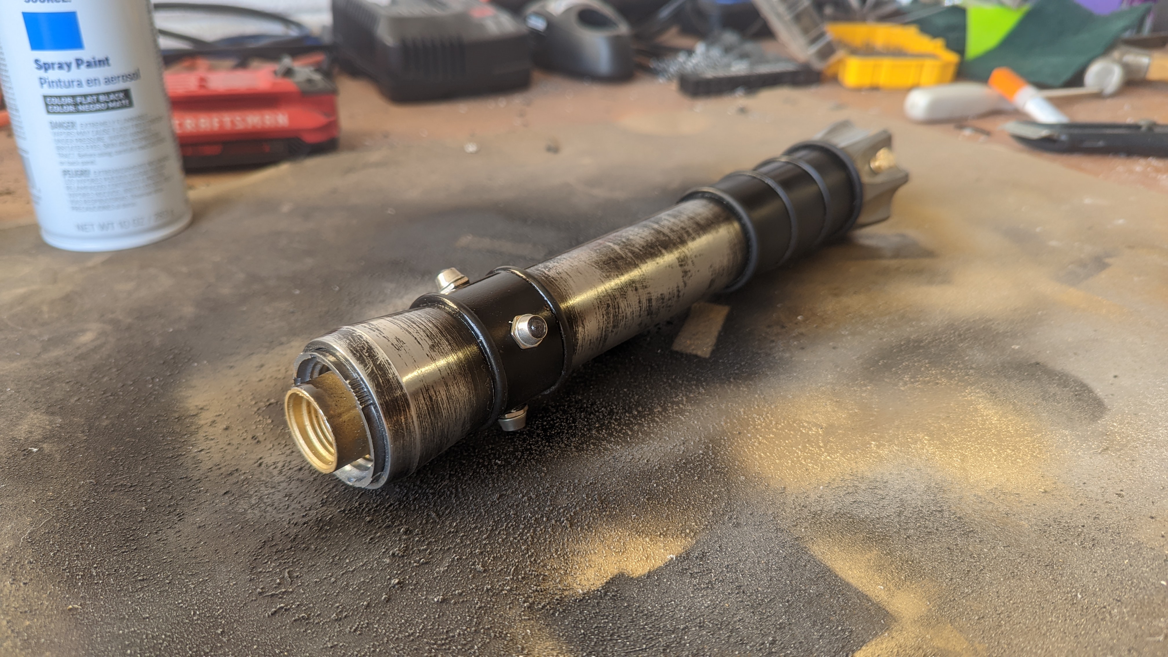

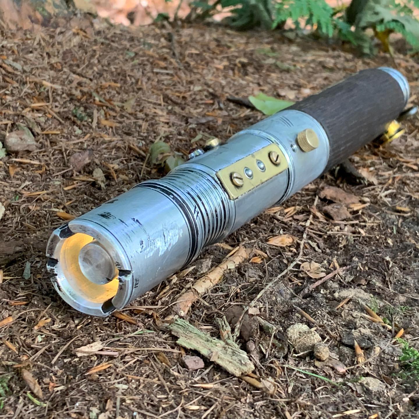

For all intents and purposes this guy is done. I will probably tinker with it in the future a bit, but it's good for now.
Standard sink tube body, pvc cut and painted for the grip and collar and the plate under the activation box.
Emitter is, again, a cheap shower head taken apart and jammed together the wrong way. Pommel is a shower knob, beat up and painted.
Used LEDs to fill the activation box, might look for a way to close the top and bottom eventually.
I am impatient, so some bits are not as lined up as I would like, but overall I'm pretty happy with how this one came out.
I am impatient, so some bits are not as lined up as I would like, but overall I'm pretty happy with how this one came out.View attachment 1600969View attachment 1600970
It always amazes me how good these hardware sabers can be made to look.
The weathering really makes it. I bought a bunch of cheap LEDs and LED bezels off Amazon because I needed some cheap doodads to embellish with.
I'm pretty sure that with more experience and better tools this could have been better, but I guess there's only one way to get there.

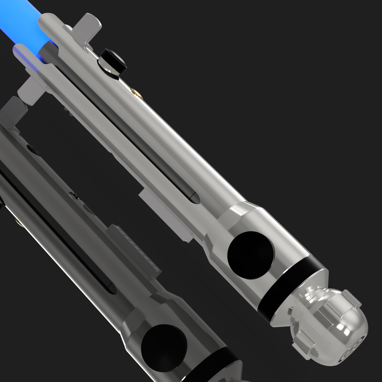

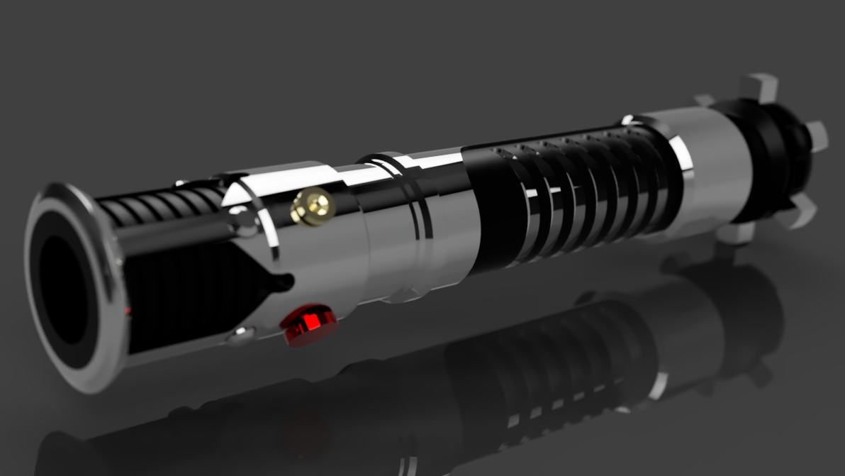

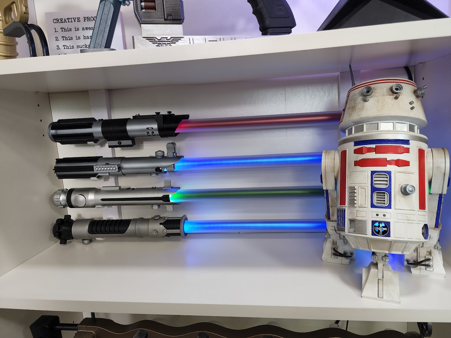

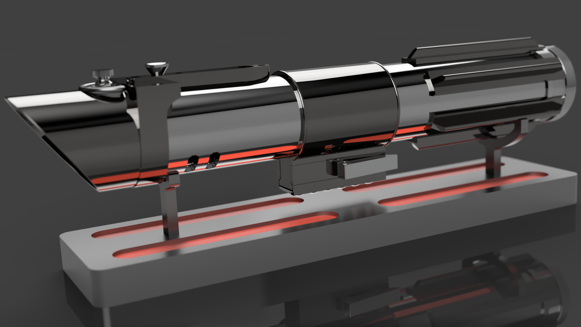

These are 4 battle ready 3D printed lightsabers I modeled over the last while. They are actually battle ready as they're cored with a 1/4in thick PVC sewer pipe with a 3D printed overlay shell, they can whack and take a whacking (as long as you don't hit the small 3D printed parts, which are replaceable). The top two have LGT Xenopixel kits and the bottom two smoothswing kits. The blades in the stand I made here light up from a 3W CREE leds in blade caps hidden behind the R5, since the electronics are in the caps I can have these small display blades in without having to remove the electronics when lighting them externally. The paint job isn't great, I'm doing another set up better as we speak, thought I would share, I'm proud of them :). I'll be releasing the models soon if anyone wants to try their hand at them, I'm still finalizing them all and making some instructions.
(edit: I attached renders if you want to see them up close)

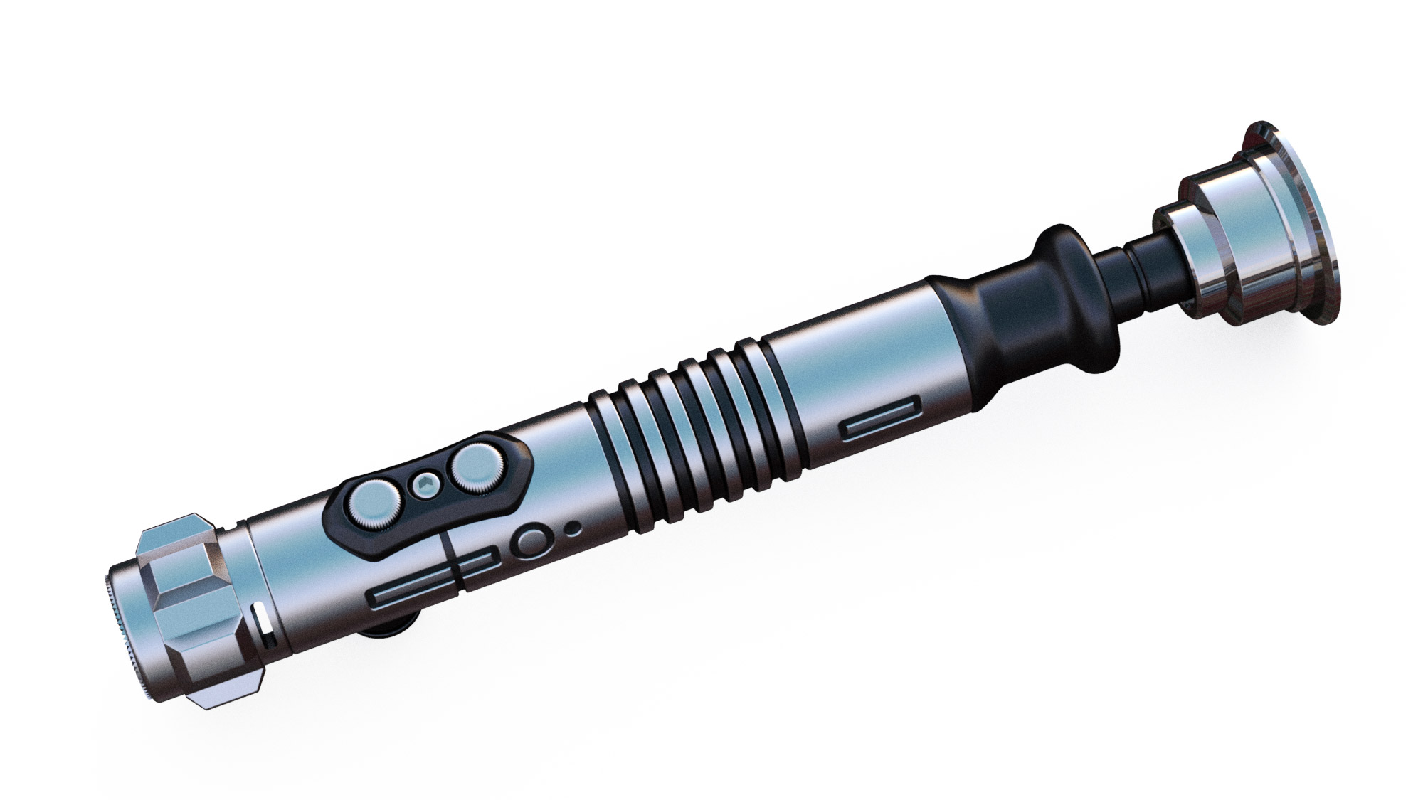

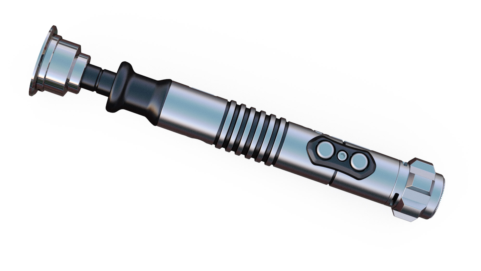

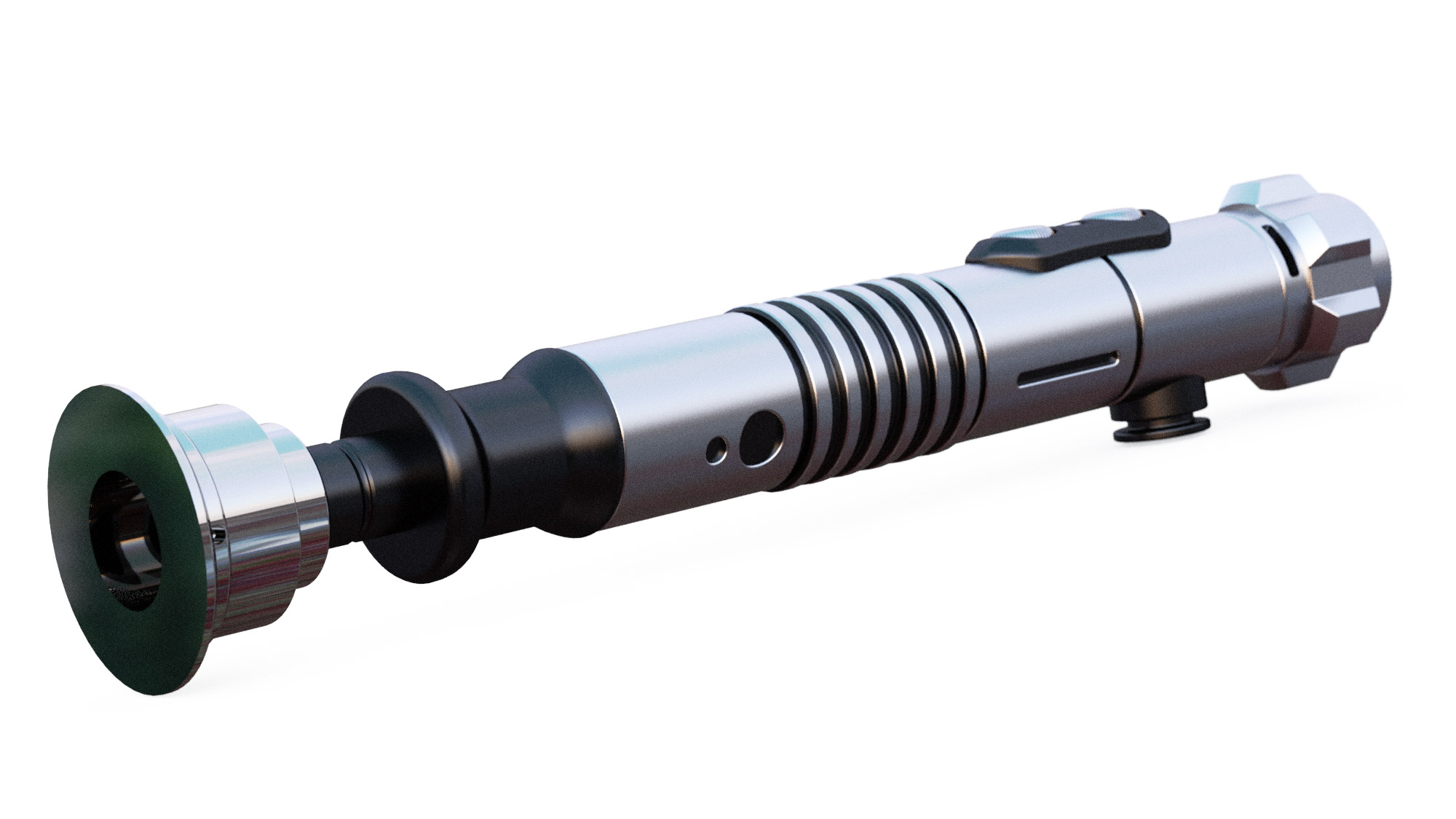

Thank you! The idea is to make something that would function well as a real weapon. It’s primarily meant to be used one handed, with the balance point at the choke. So it’s based on the “Ewan’s Favorite Lightsaber” hilt which is near perfect in this regard.
Then I added two Maul-style silver buttons are at the bottom end. Added the shield around them, and placed them far from the hand grip, to avoid accidents presses. Then I added some prequel style grips and grooves, and there it is!
