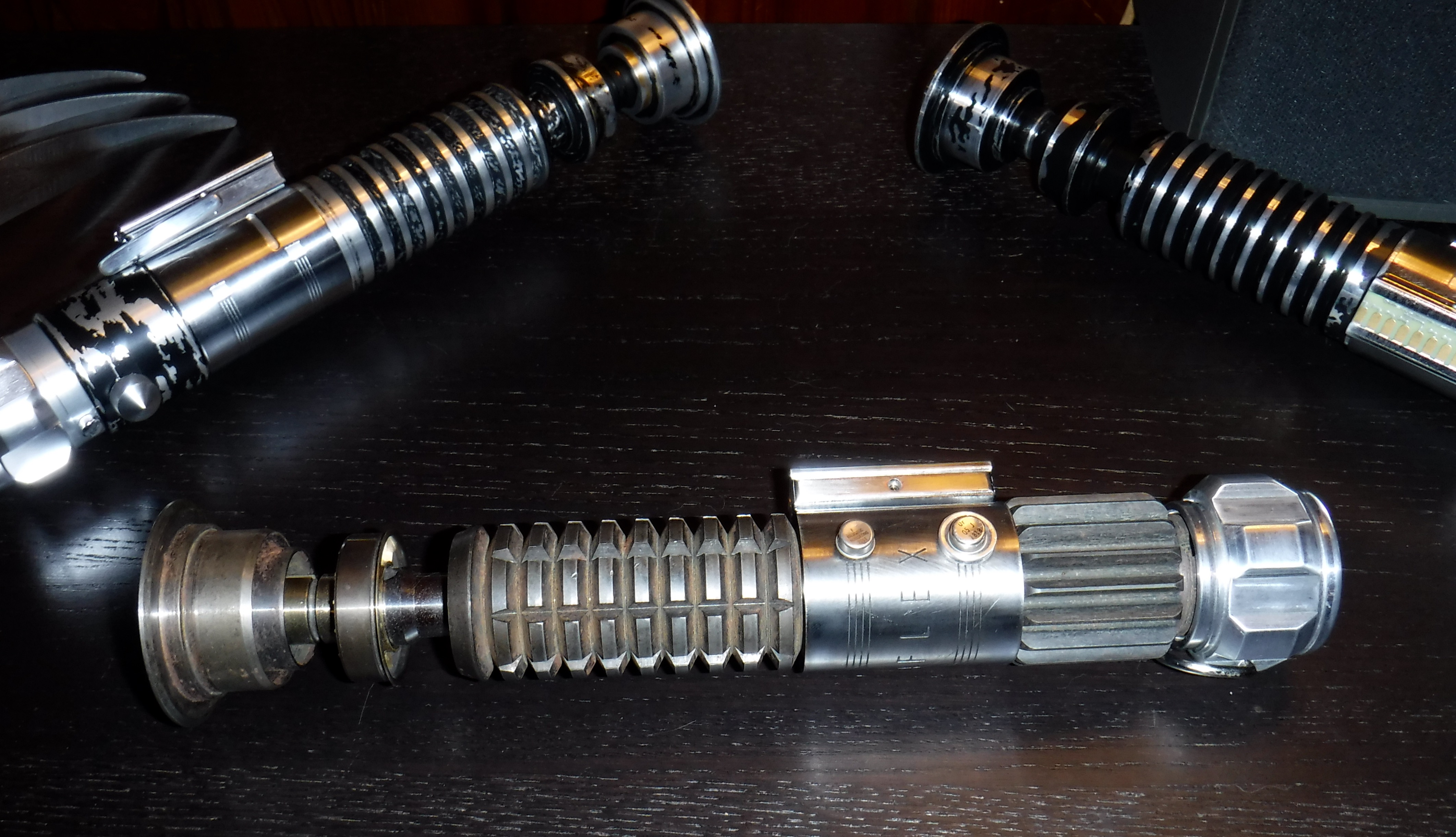

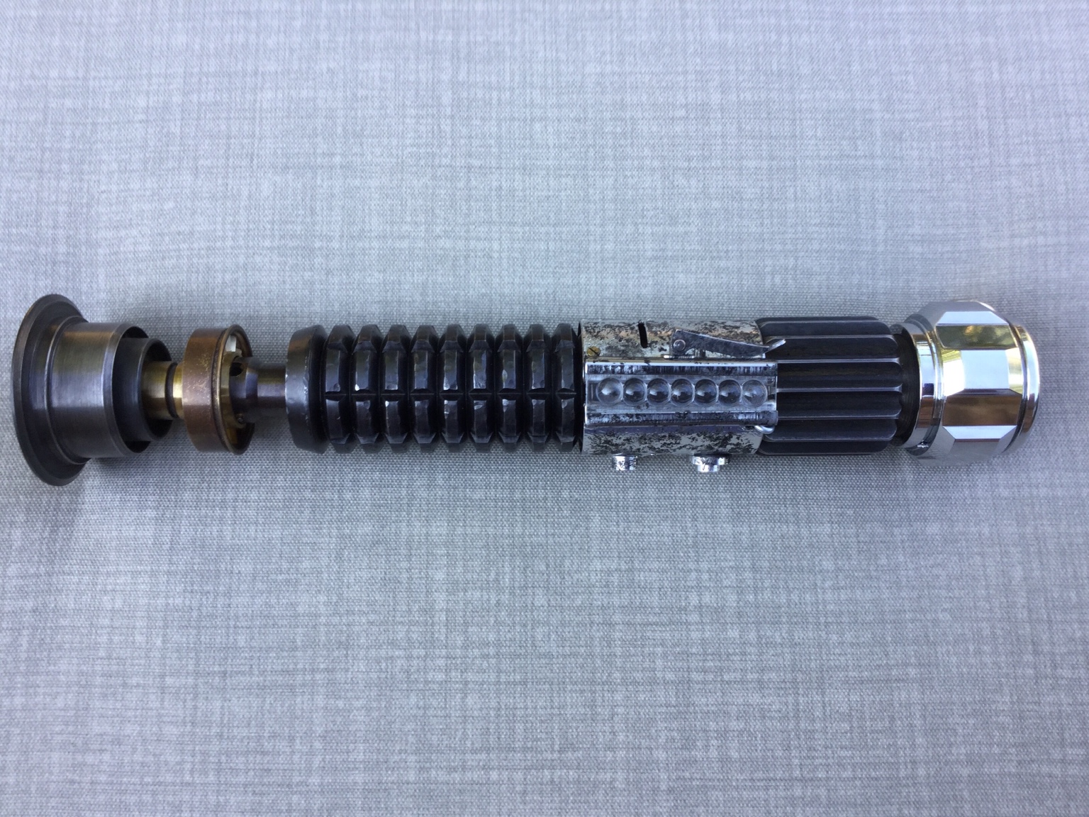

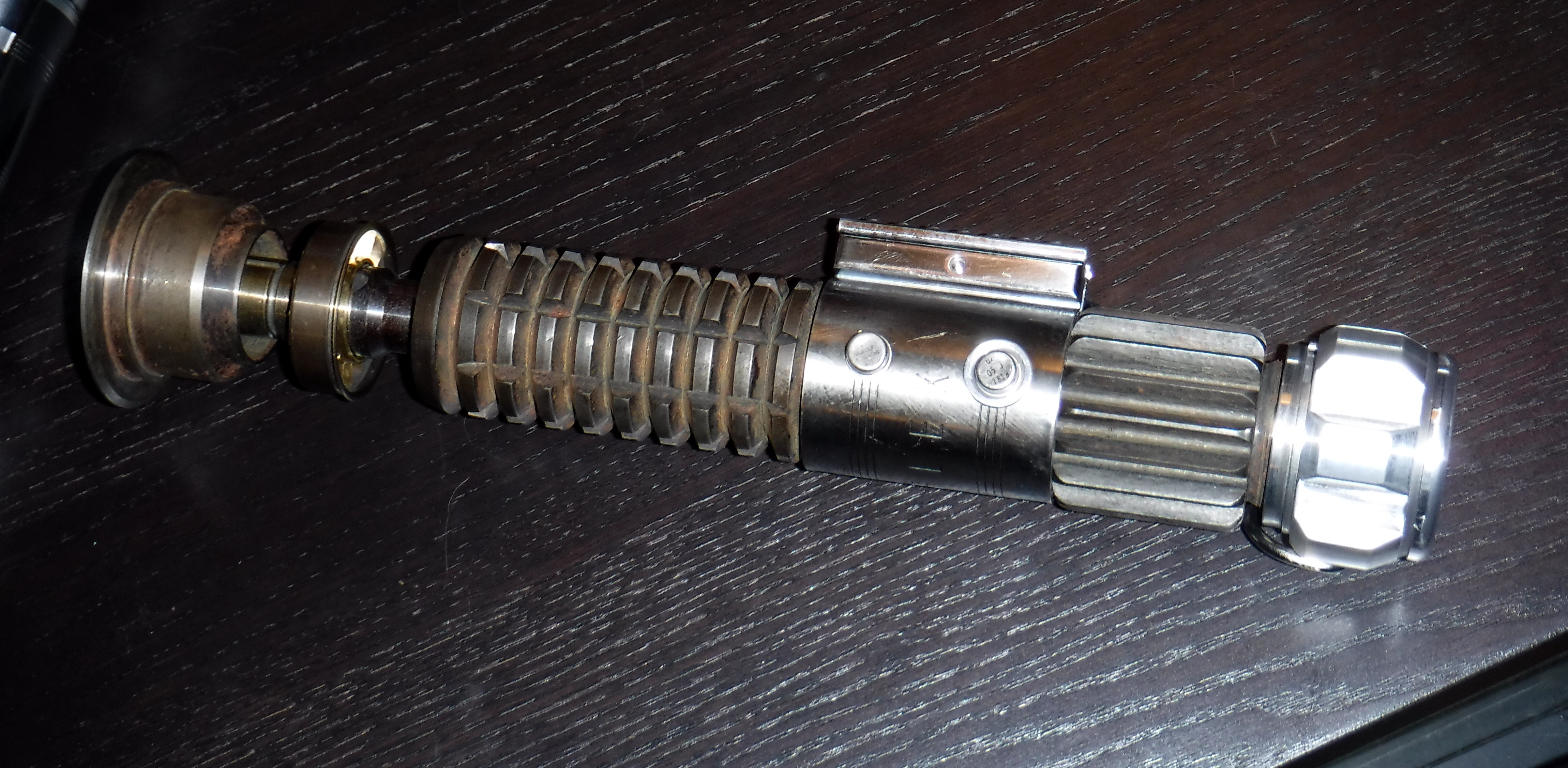

Finally completed my Roman MK1 build! I decided to do the chronicles version. Thanks to jameskenobi1138 for the advice on where to purchase the brass screws and amazing reference photos!
Sent from my iPad using Tapatalk

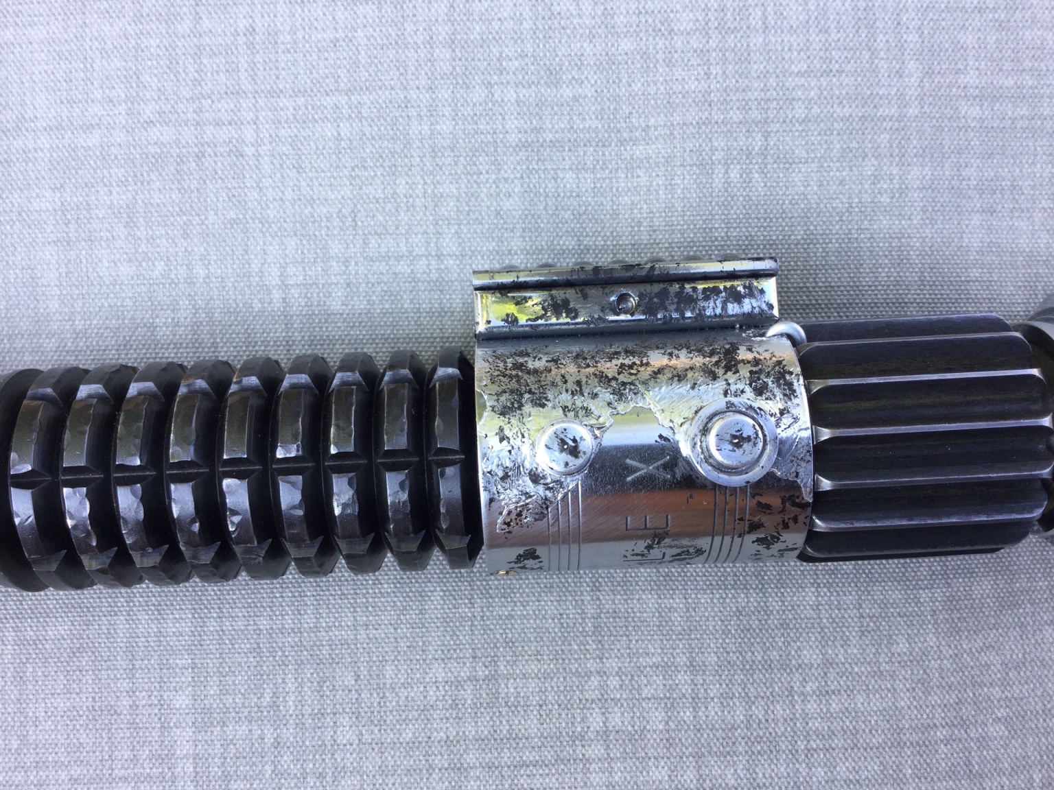

Amazing. What's the little wire of the bottom of the clamp that heads into the booster/ I was thinking of going in this direction, but there's too many little extra holes to make and that makes me nervous!
I used 14 gauge galvanized wire from Home Depot. I went ahead and drilled the booster and the clamp. I know James Kenobi uses a nail and just bends it over so as not to drill the booster. As long as you are using a drill press, then the install is pretty straightforward. I wouldn't recommend using a hand drill.

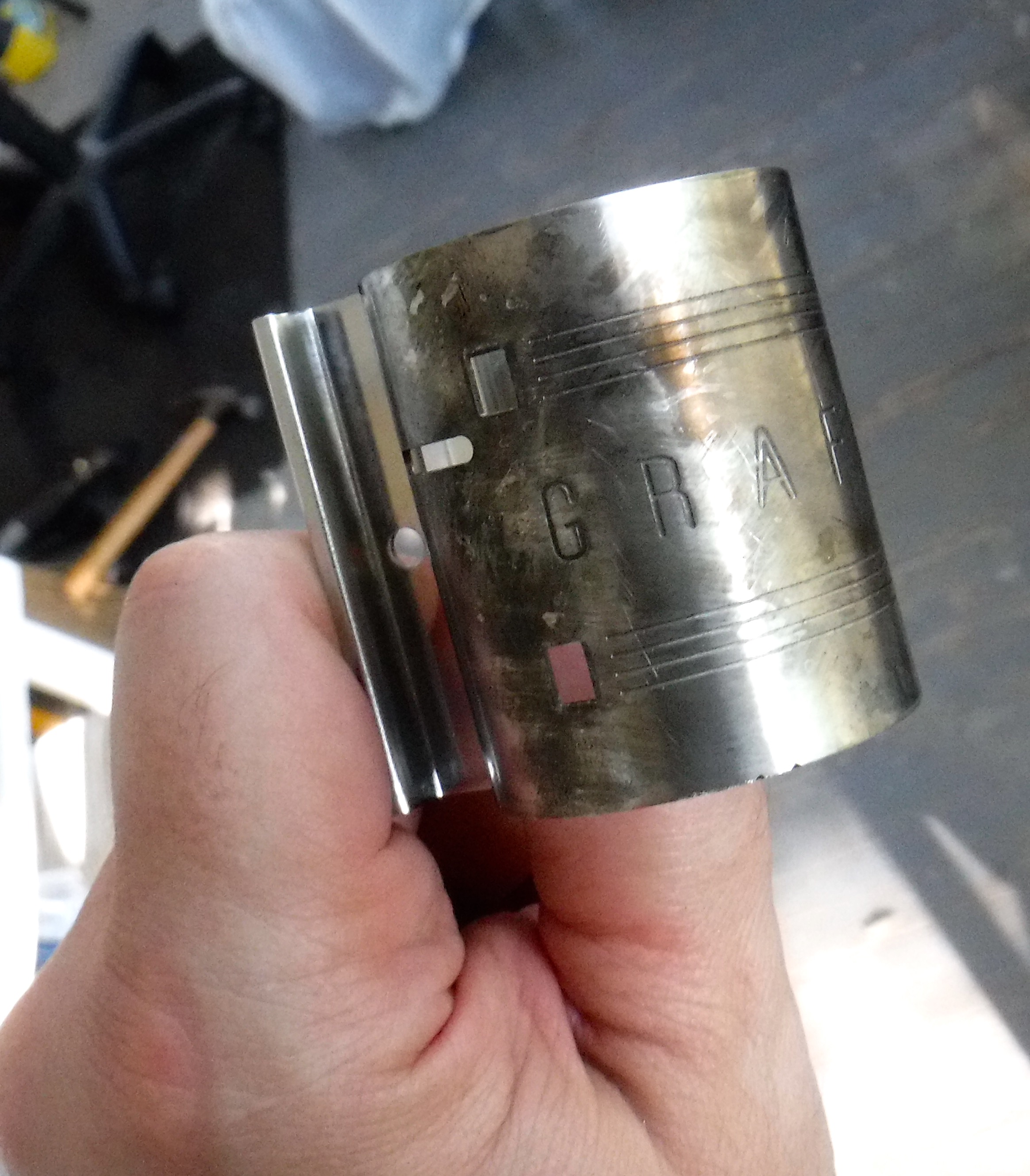

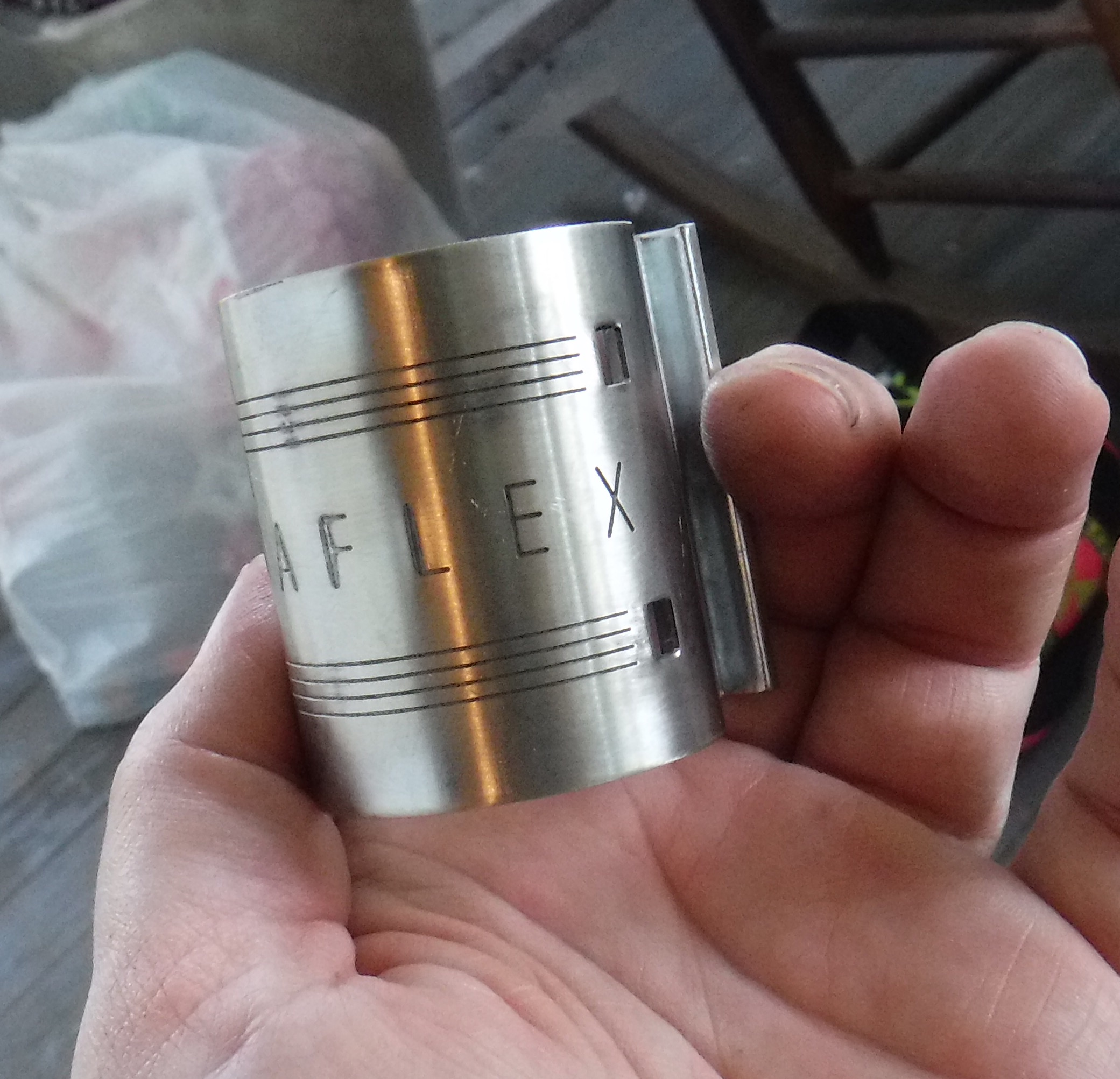

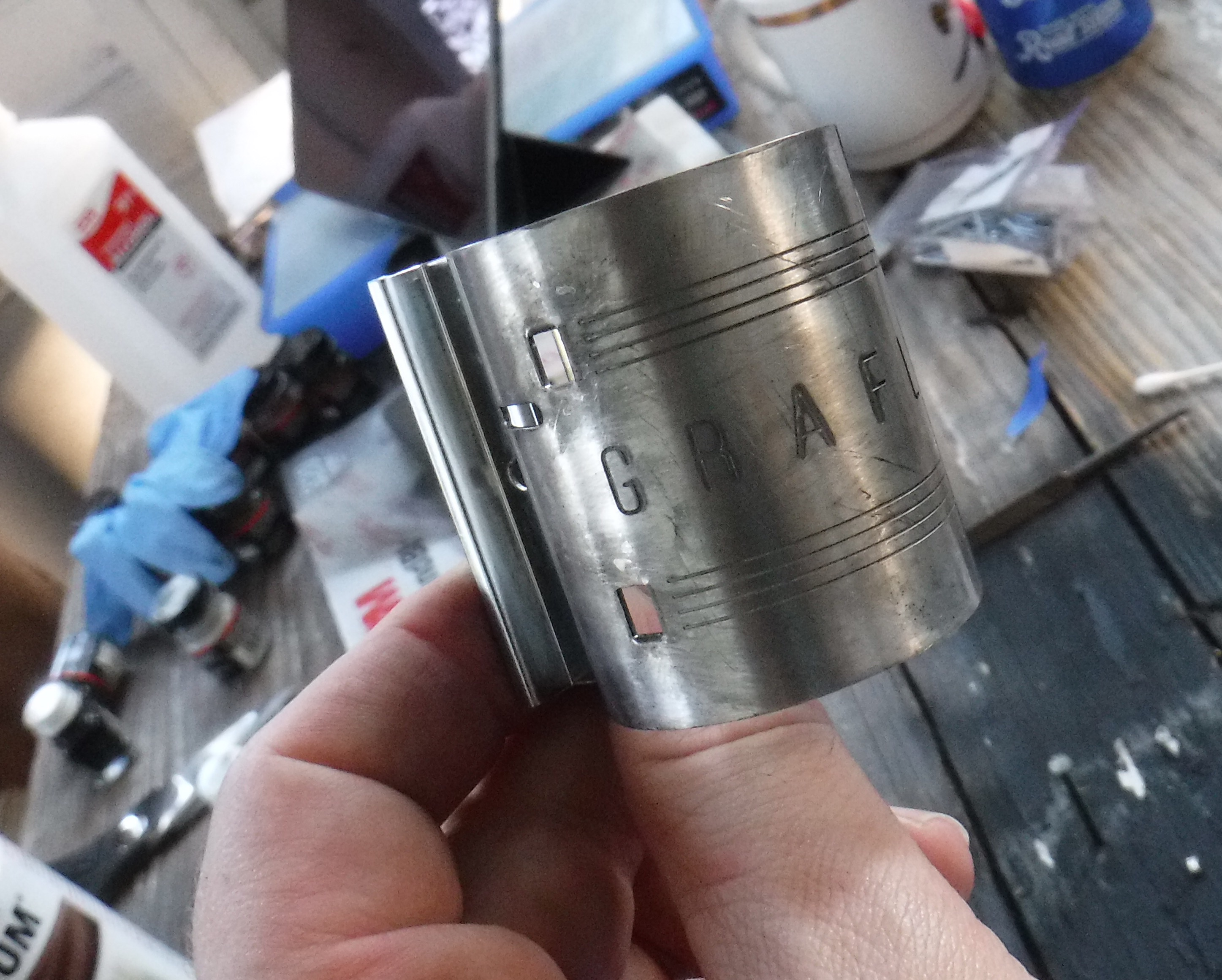

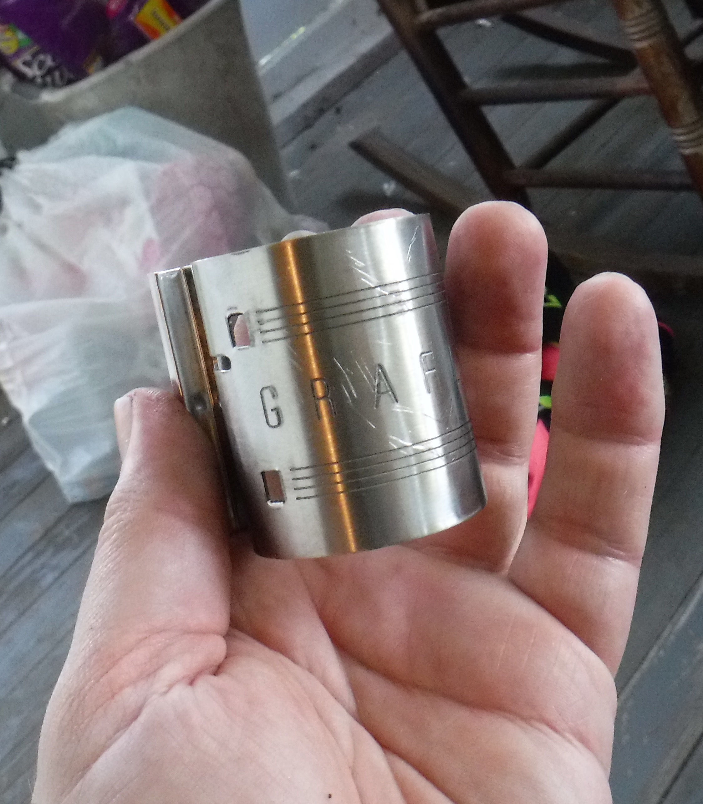

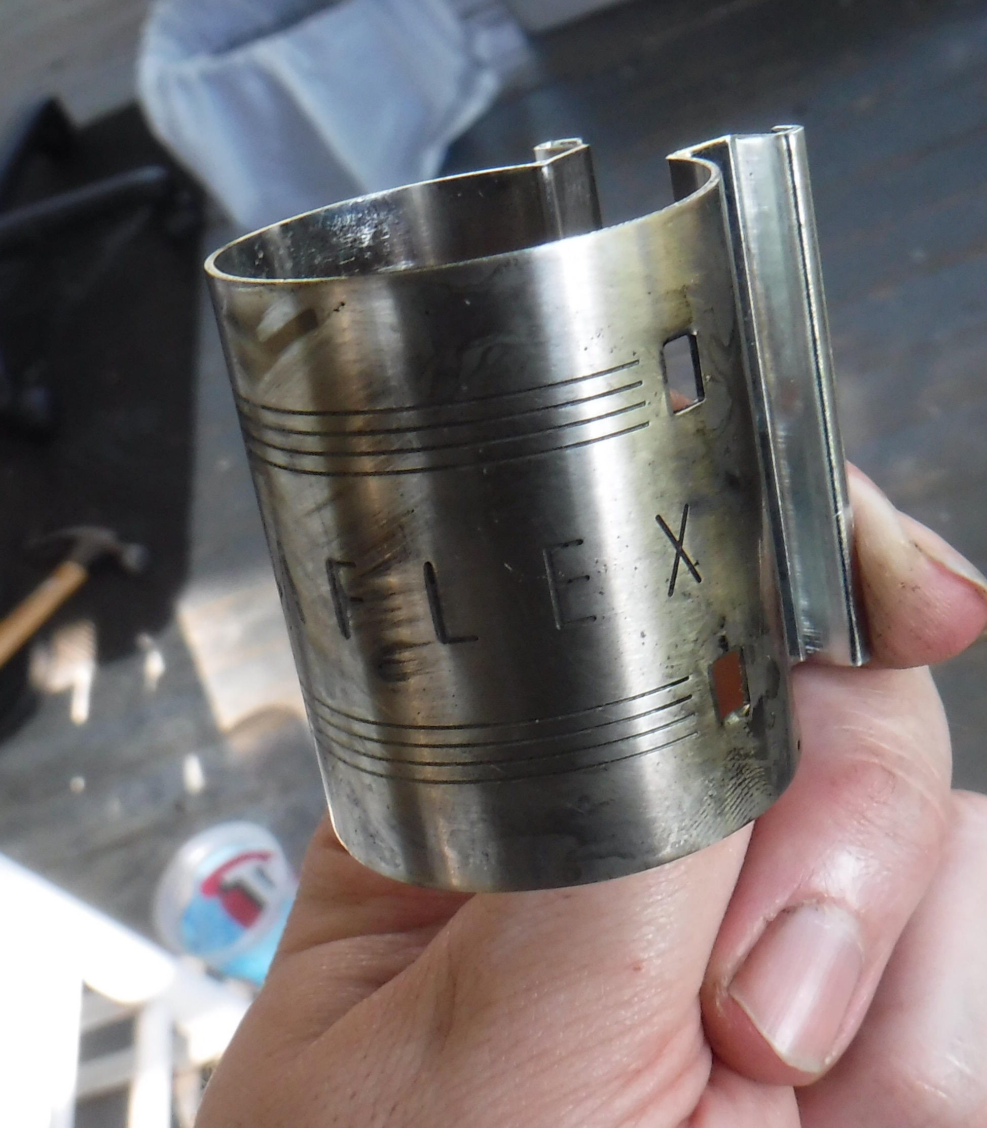

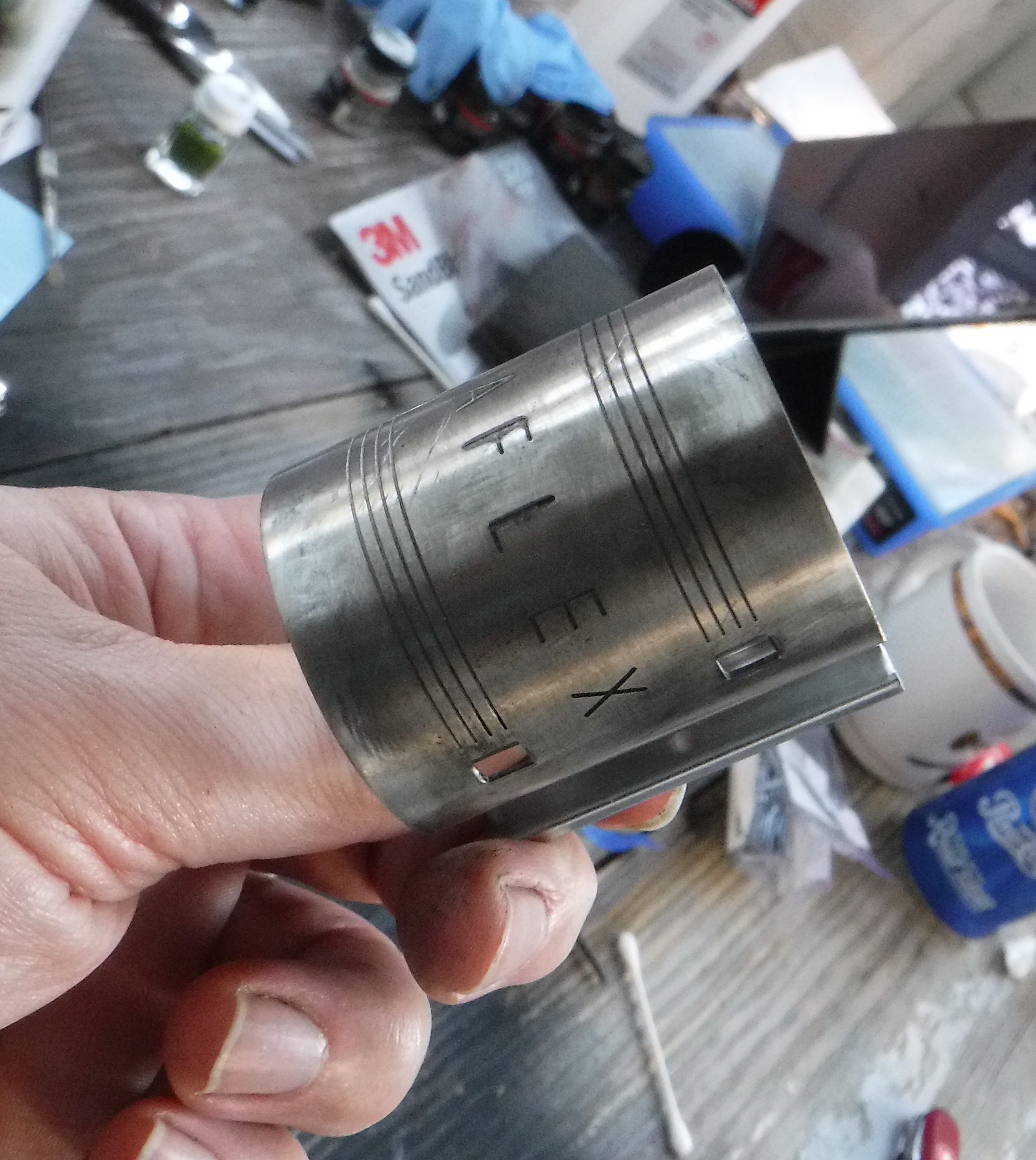

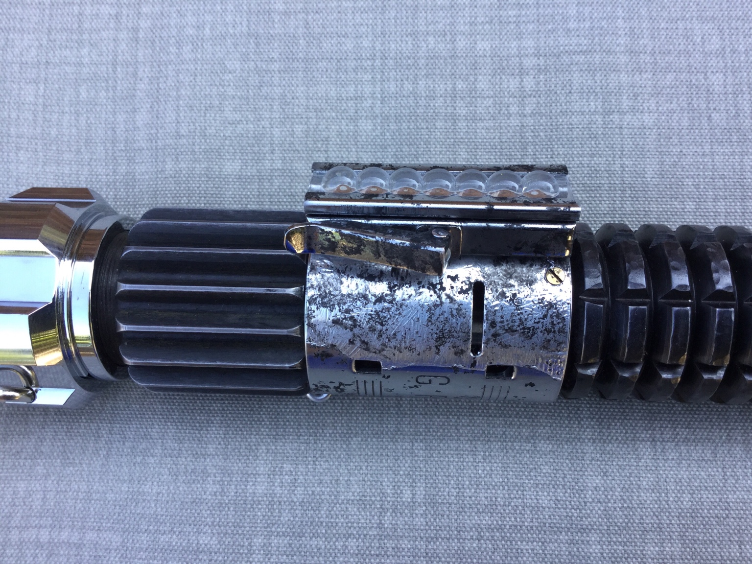

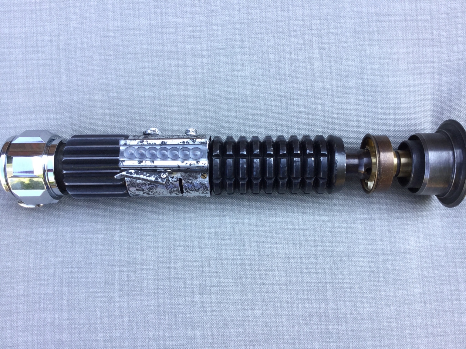

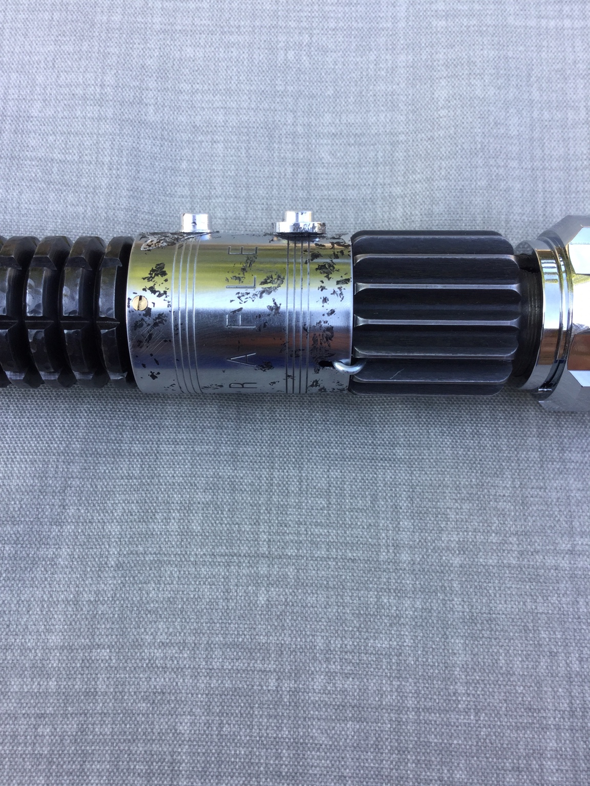

Here is some of my weathering I've done to my Romans GRAFLEX clamp. I took the shine off with 320grit a few weeks back.
View attachment 664710 View attachment 664711
I took a file to it, & later did some light scratching on some ruff concrete.
View attachment 664712 View attachment 664713
Then I took a lighter to it, & wiped It off with a rag soaked in vinegar multiple times.
View attachment 664714 View attachment 664715
Let it sit for a few hours, & voilà!
That came out great!,
russellsch, do you wet sand with 320? I want to bring down the shine on my Roman clamp but afraid of damaging it too much.
