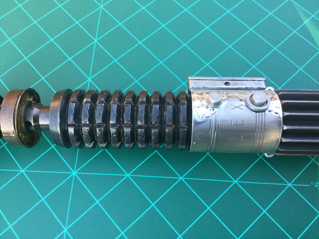

What process did you use on the emitter to get that more stripped look?
The emitter is one part I didn't completely reweather. That was pretty much all Roman. I just made some tweaks. If you have a steel balance pipe, perma blue and some fine steel wool can get you that look. Spinning the balance pipe on a drill and holding the steel wool to it would probably work.

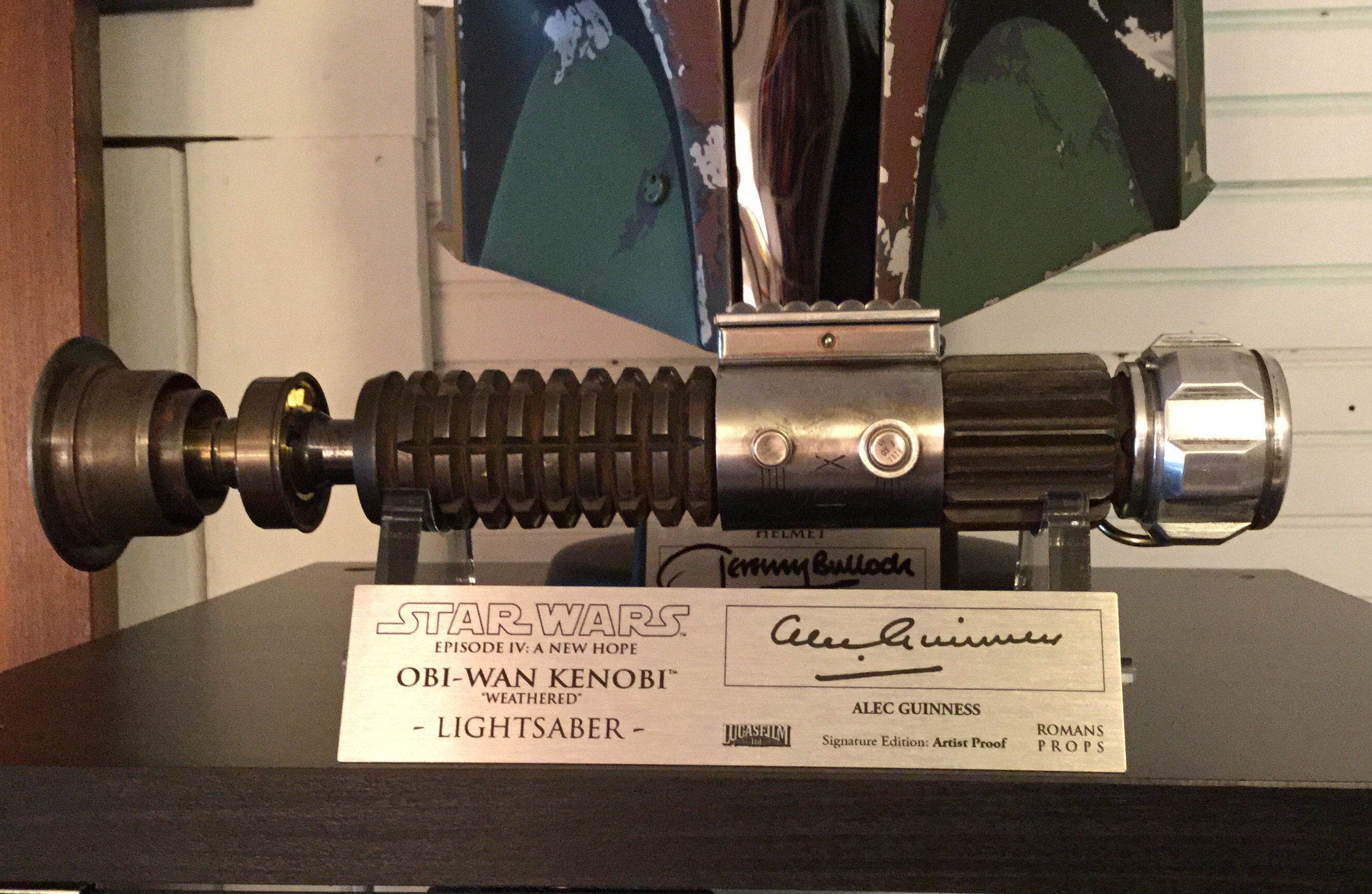

I got a few lightsaber stands from PastorJedi. These things are great! I'm finally able to break out the plaque I had made last year. The signature is fake (of course :p), but I don't care, I love it.

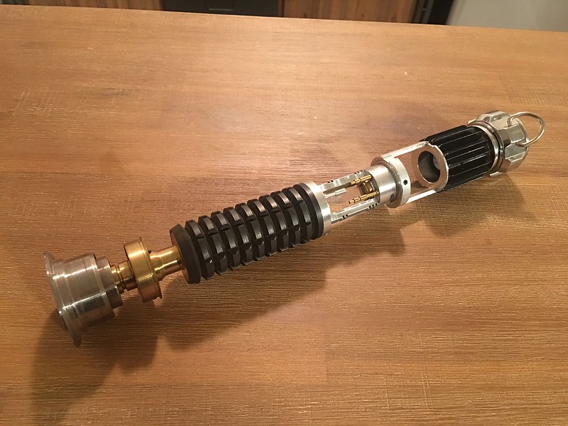

Here it with real transistors.

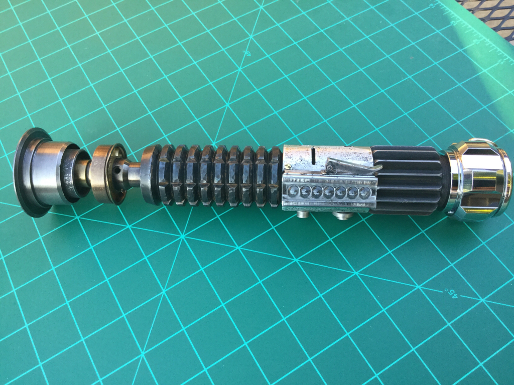

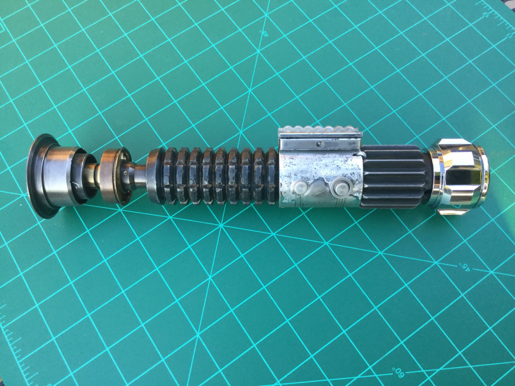

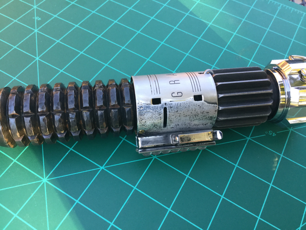

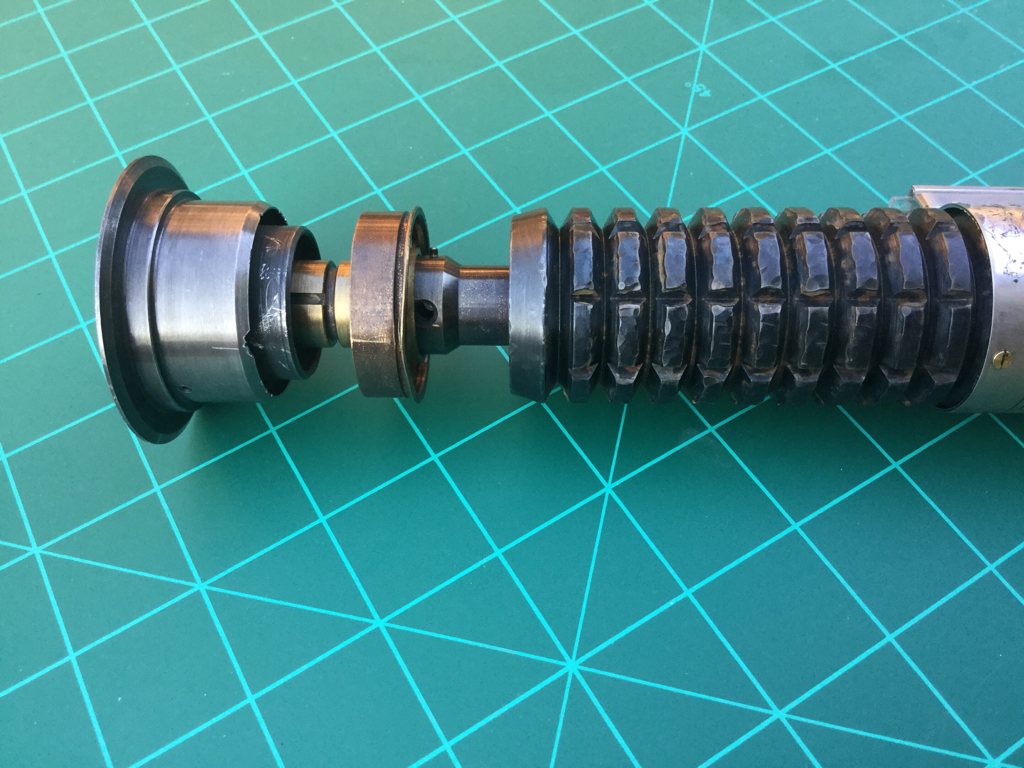

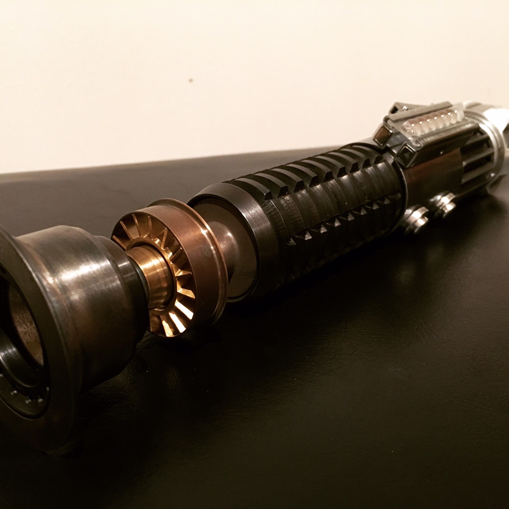

Here's some updated pics of my Chronicles version Roman MK1. I posted a few weeks ago, but decided I wasn't happy with it. I felt the paint job I did was rushed and sloppy. So I went back and sanded that down to a less heavy finish. Threw the transistors in some oven cleaner for about 15 minutes. Chunked up the base of the emitter, dinged the wind vane, sanded the clamp and soaked it with vinegar. Then finally, used a combination of peroxide, vinegar & salt to rust the grenade up a bit.
I feel this is one of those sabers that will always be a WIP, but I'm okay with it because I love to tinker. Thanks to russellsch for the clamp weathering tips and to everyone else here in the community! I learn so much from you guys everyday about this hobby-turned-passion!
Comments/suggestions are welcome!

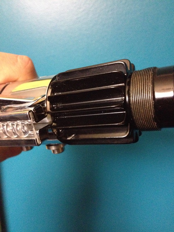

So I have a booster that I THINK is Russ rep ... I believe it's painted gloss black.
I want to weather/blue it, so the logical idea is to strip the paint and drop in bluing... but I know taking the paint off this is going to be a nightmare.
The last time I took paint of something like this I used paint thinner and 30 bucks in steel brush pieces for my dremmel.
There's GOT TO BE A BETTER WAY!
Any ideas out there?

Get yourself an actual paint stripper, either aerosol or liquid form. That paint should come right off.

I know this idea is an investment but it's the fastest way. A grinding wheel with a wire brush attachment takes just seconds to strip the paint off these boosters. Seconds...
Looks like I have a teecrooz solution coming... and this booster will go back in the box or paid forward at some point in time!
