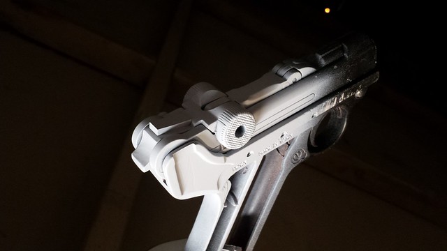

After this last set of images, (the bust) I think I have put together something very close. I want an opinion from the others, if I made a casting of the front barrel cover, would it fit all the WE Po8 Guns? I used the Dennix as my model. Obviously I may have to adjust things, and I have yet to put the allen head screws in, but I did my size renders based on the shots of her running in the trailer. Comments and critiques welcome.
[url]https://c4.staticflickr.com/9/8271/30029473555_90afcc2e91_k.jpg[/url]Jyn Erso Pistol 2 by Mal Keller, on Flickr
[url]https://c4.staticflickr.com/8/7505/30029473355_08db4129ec_k.jpg[/url]Jyn Erso Pistol 1 by Mal Keller, on Flickr
Are you thinking of offering the barrel extension cast for sale? I've got the Dennix and I'd order one of those in a heartbeat.

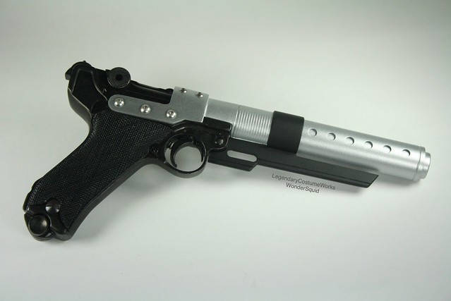

Now were talking. That shows some interesting details I think. It looks to me as if the side support flicks out at the rear of the gun after the last screw. Also I think there may be some detail (possibly thee barrel shroud) coming through the rear of the top support making a swoosh / sharks tooth ish shape on the side of the top, next to the moving mechanism. I was about to grind some parts today to put mine together, I'm sooo glad I didn't now, but I will soon. Nice one howlrunner.

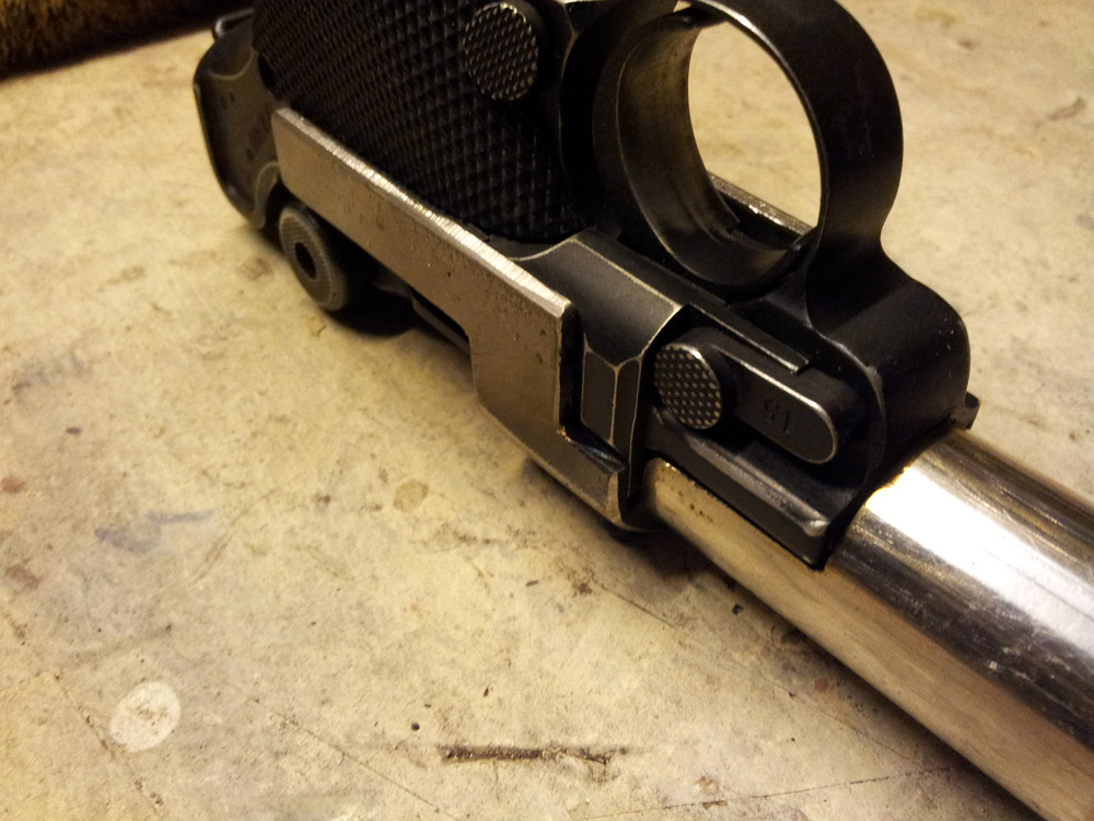

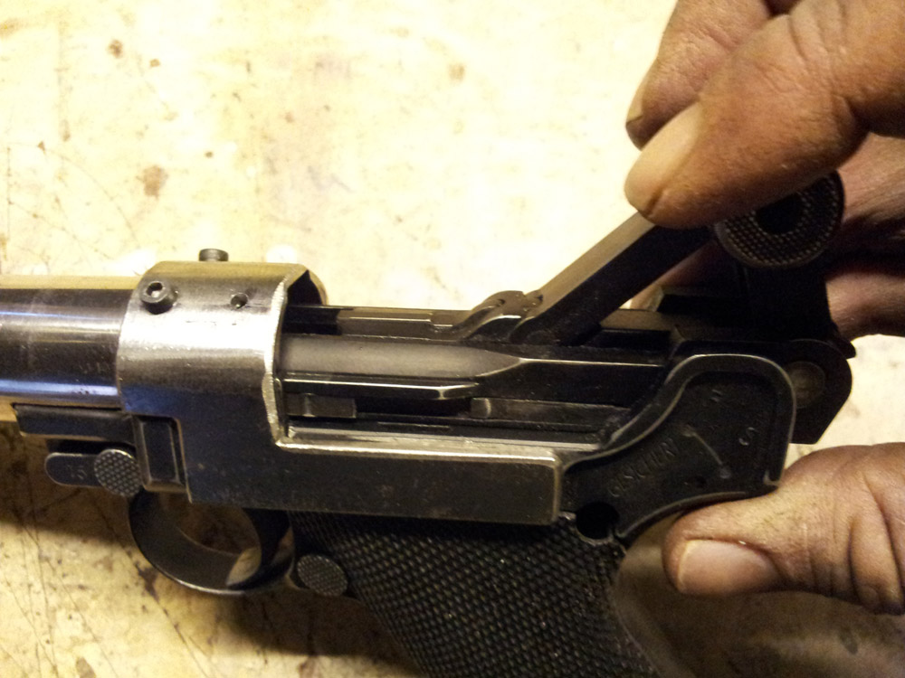

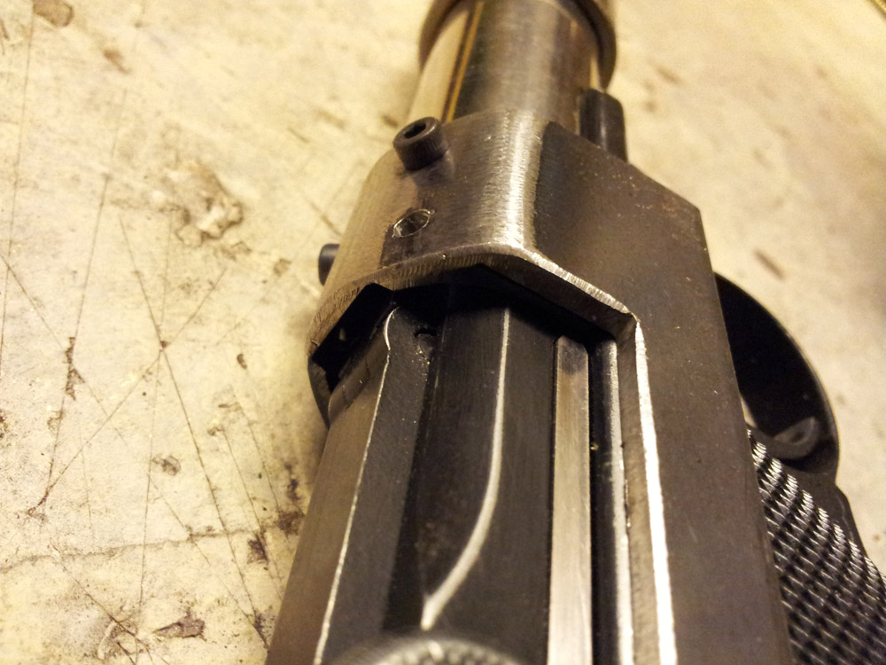

ive done a little more work on mine now ive seen this latest image. I an 99% convinced that the small sharks tooth shape behind the barrel cover is the shape of the material left after some filing has been done to the rear part of the receiver as it appears to follow the shape of the casting in that area and it also looks to me like there has been some material removed where it slides under the top mounting plate. Also I think the front part of the trigger may be missing to allow a screw to go in from the inside of the trigger guard into the rear of the lower barrel support..
I think I can see an edge in this image which could be the cut off trigger and a small bump inside the guard which could be a screw head of some sort.

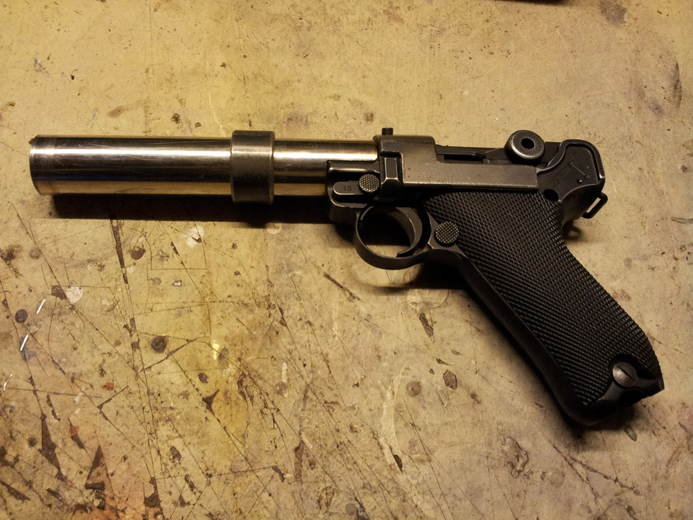

I have now got the barrel shroud mounted securely to my gun which still cycles without any interruption. I'll post images tomorrow.
wondersquid..I was wondering what the thickness of your front support under the barrel shroud is , as I need to drill and attach my support to the trigger guard.
I think mine will be about 8mm at the junction.
Cheers everyone.
Re: Rogue One Felicity Jones gun - ideas
Flyscriber Your metal shroud looks awesome, was it one piece you milled down, or did you bend it? My lower support is 1/8" thick.
