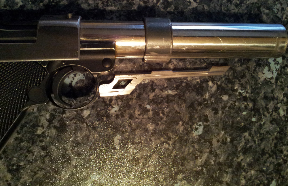

I will do a complete break down of the parts and dimensions once it is together and working, just in case I come across issues which may stear someone else in a wrong direction. I would hate for anyone to destroy their gun by following my mistakes. I've not made any just yet, but you never know.
I made a lower support rail for this one, it fits nice now, I just need to add some more thickness and detail to it with some small metal panels as it seems a little thin when its on there, and a decent clean up and polish before some paintint. Ive also cut a groove into the ring which will be welded onto the lower rail for strength, hopefully it will hold up under firing. Ive tested the action with co2 and it works great even without any fixation to the body as it fits so tight.

For the underbarrel rail, would JB Weld be sufficient to attach it to to lower barrel? There's not much surface area made more difficult by the fact it can't be attached to the frame to allow proper action. Wondering how I'm going to secure it without the ability to weld it.
Re: Rogue One Felicity Jones gun - ideas
HI there
ive just attached my lower rail with a screw through the front of the trigger guard into the back of the support. Don't go near it with a welder it wont work.

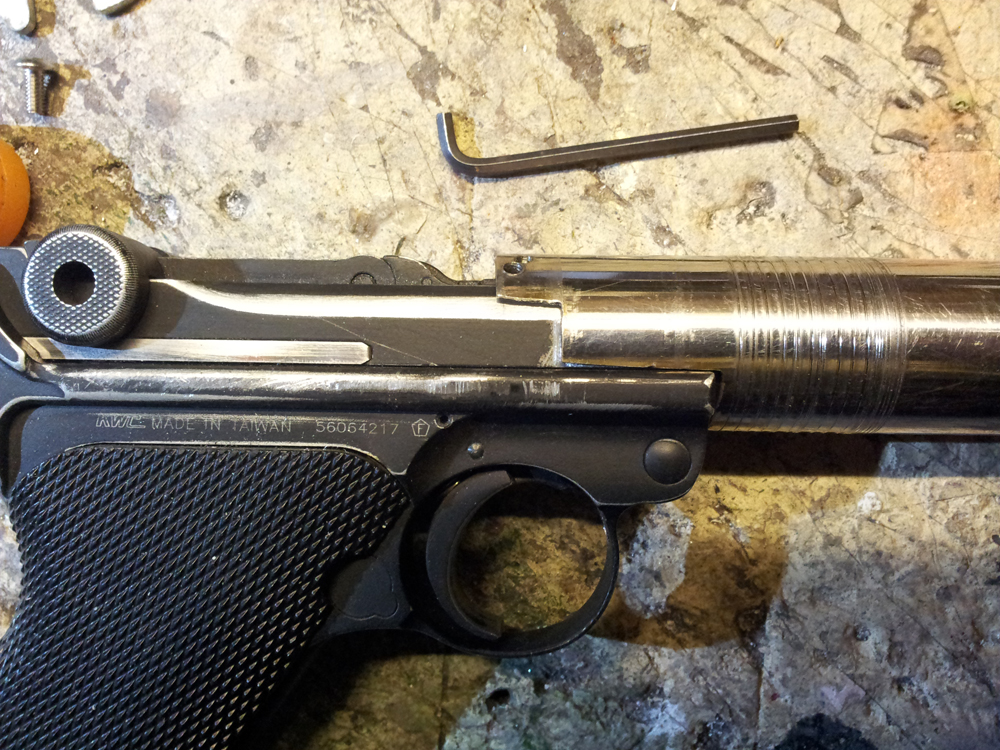

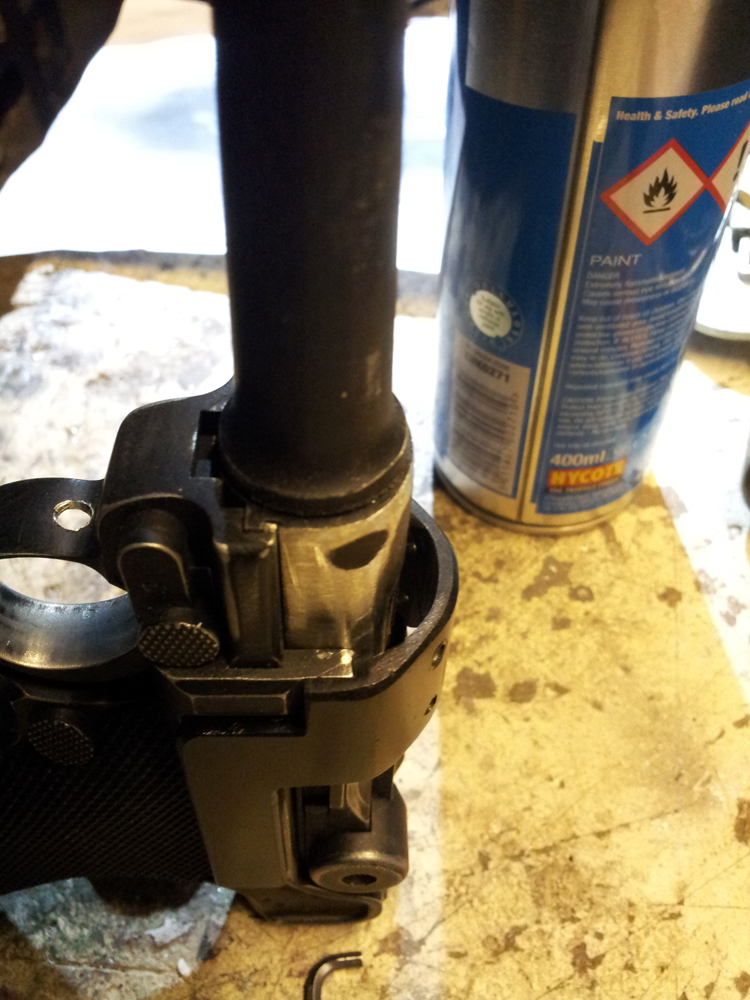

side 3.jpgthis is a shot without the barrel shroud in place
side 1.jpgthis is the barrel shroud without the top support showing the extra material I have removed from the side of the receiver to make the swoosh shape seen in the best image so far with jyn sitting showing the gun. I screwed up the circles around the shroud a bit as my pipe cutter was wandering a little on the stainless pipe. no machinery except a pillar drill makes it a bit hit and miss sometimes .

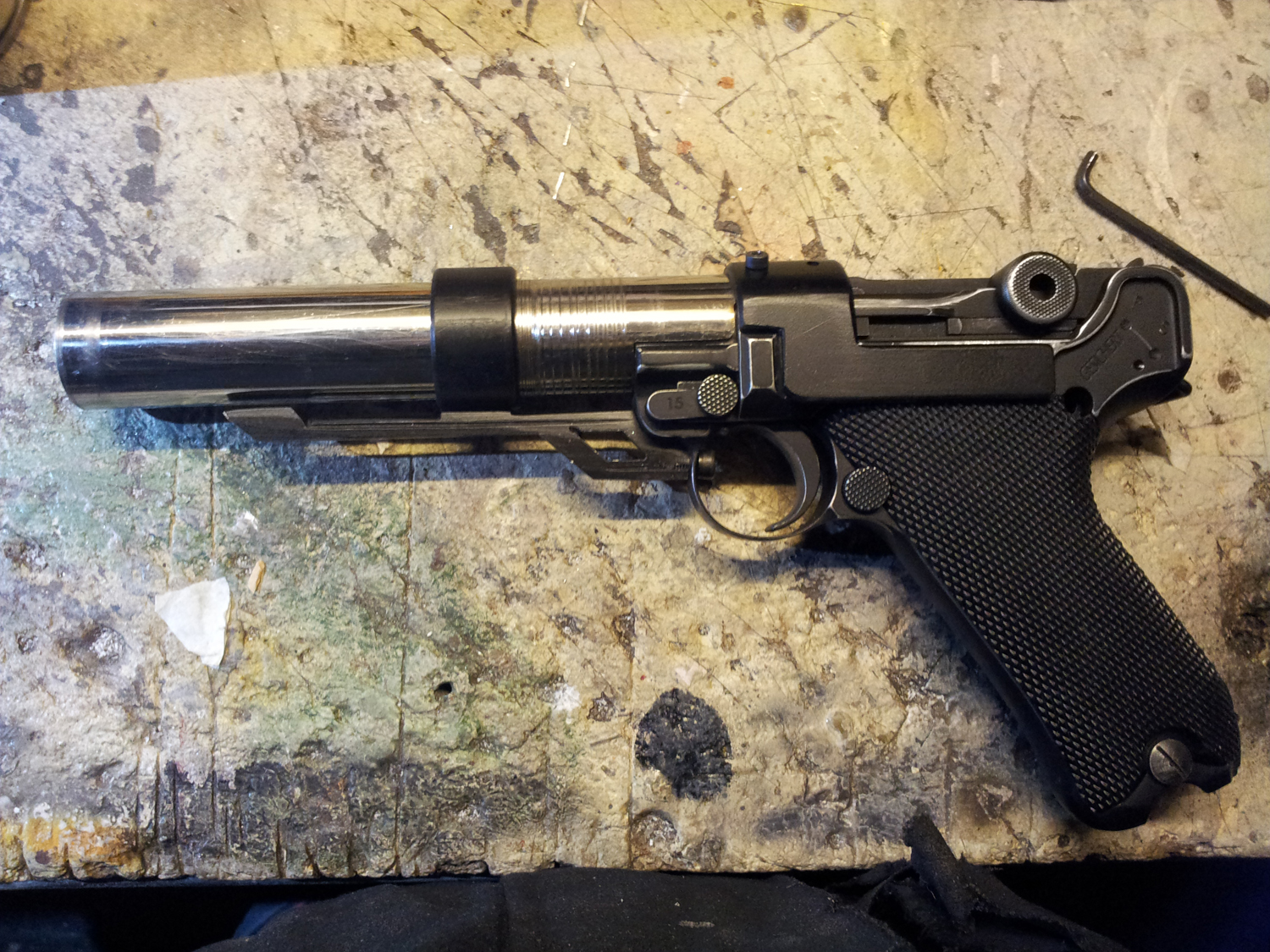

side 4.jpghere it is assembled again, I couldn't resist a bit of black paint, even though I need to do more welding to some of the metal add ons.

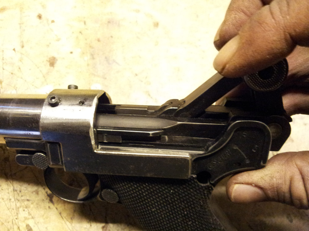

This assembly is to test the movement before I drill the final holes and add detailing. I haven't removed the front barrel assembly inside the shroud as I was thinking of making it a working airsoft at some point. when it is assembled I found that to center up the inner luger barrel the shroud needed to be slightly nose down, ie slightly out of line with the slide. I think this may be the case on the real gun as it looks a bit "bent" in some shots ive seen. we shall see soon :)
small slide.jpgseems to be ok, and it is solid now the lower rail is in place. so solid I think I should test fire it with some CO2.
ok im done for the day. it didn't explode or jam in any way, securing the whole thing with some small screws next should make this one tough blaster

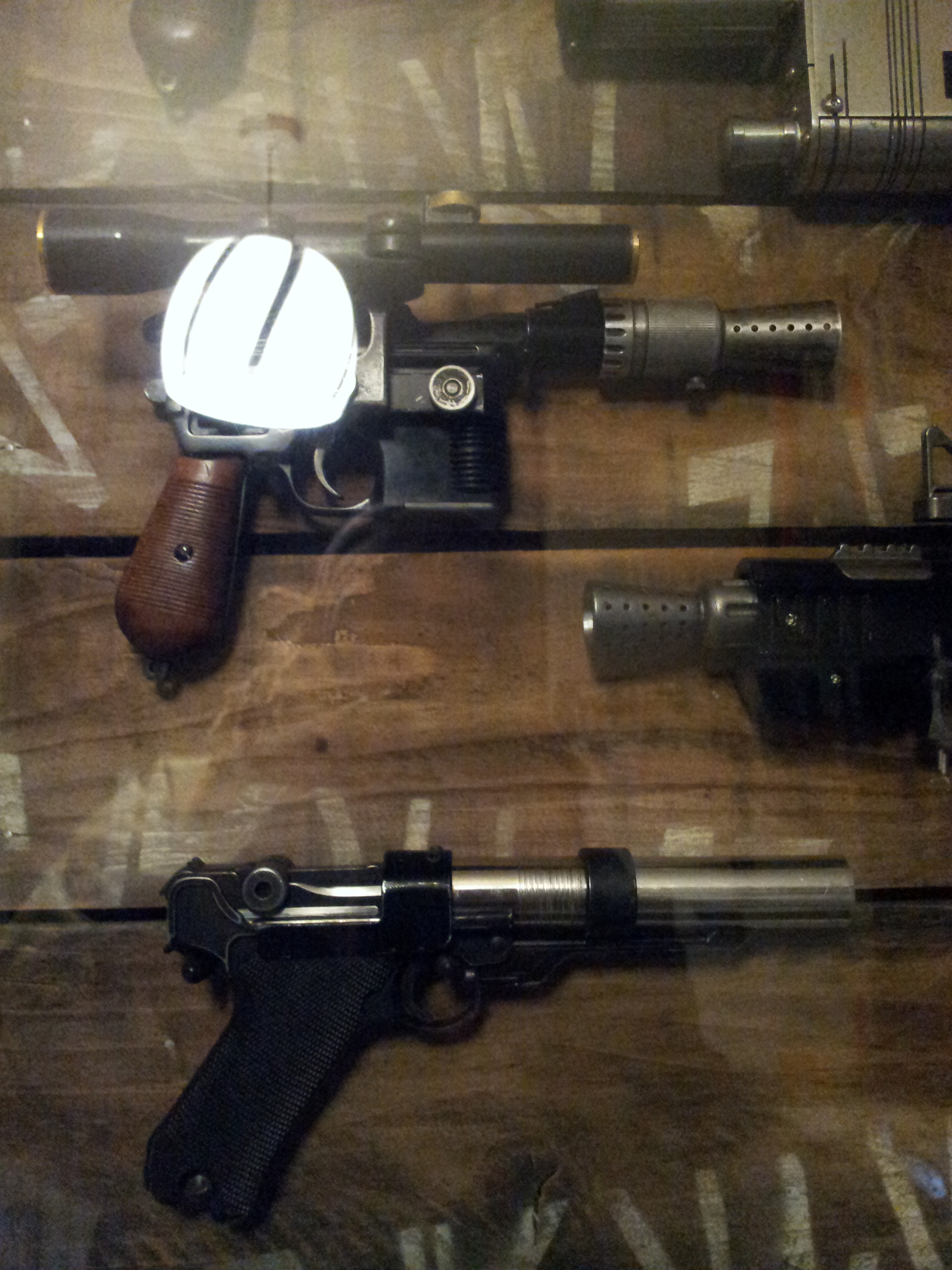

I just hung it up on my wall display. its looking better now.
