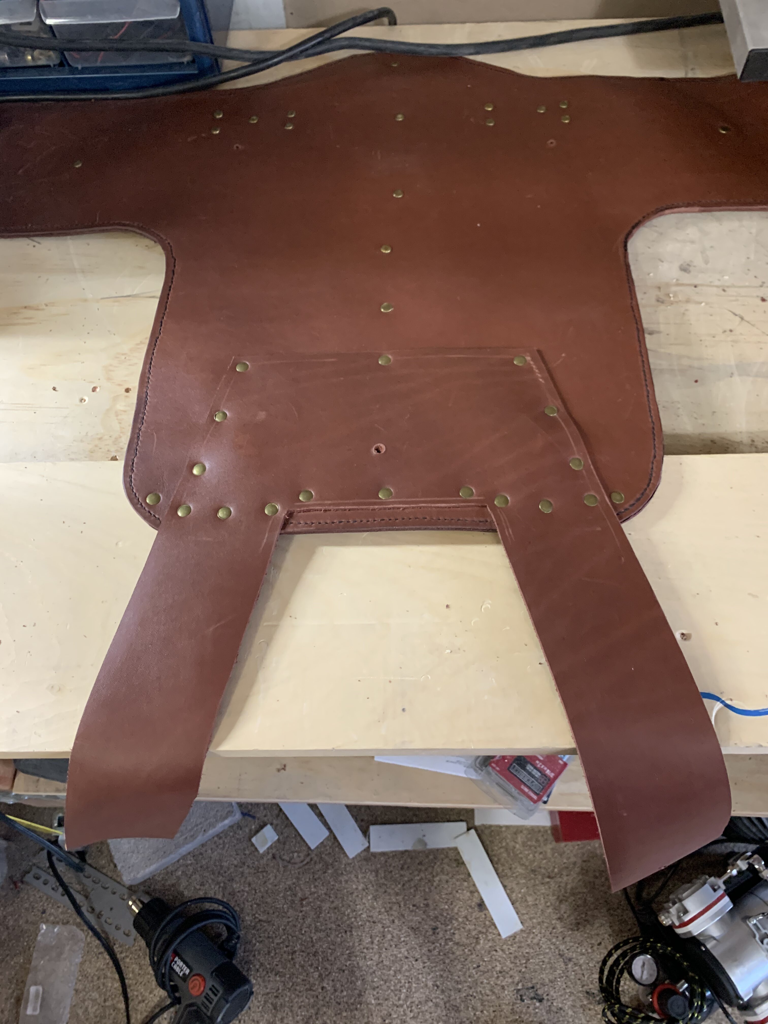

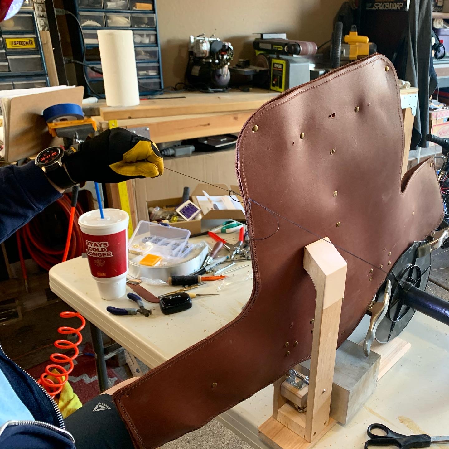

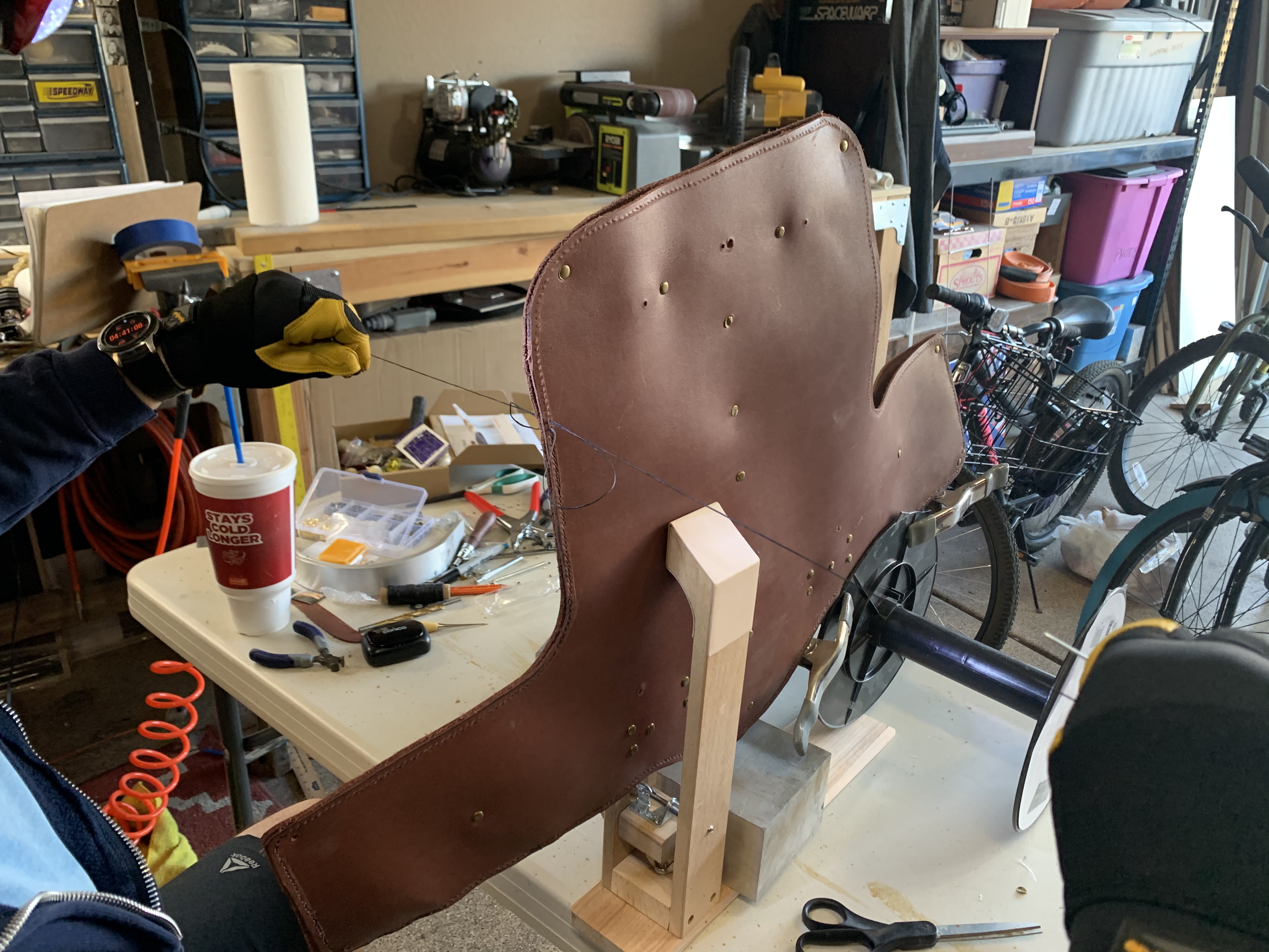

I've made some progress on the harness. I'm getting really close to being finished with it and I'm pretty happy with how it has turned out so far. This whole thing has been function over form and although it is not screen accurate, it works for my set up. To review, I modified a marching band drum brace and sandwiched it in between two pieces of leather.

I punched a BUNCH of holes to allow for needle and thread to pass through two thick layers of leather and began the long process of stitching the front and back halves together. To be clear, I've never done any leather work before so I'm sort of feeling my way along with the help of YouTube videos.

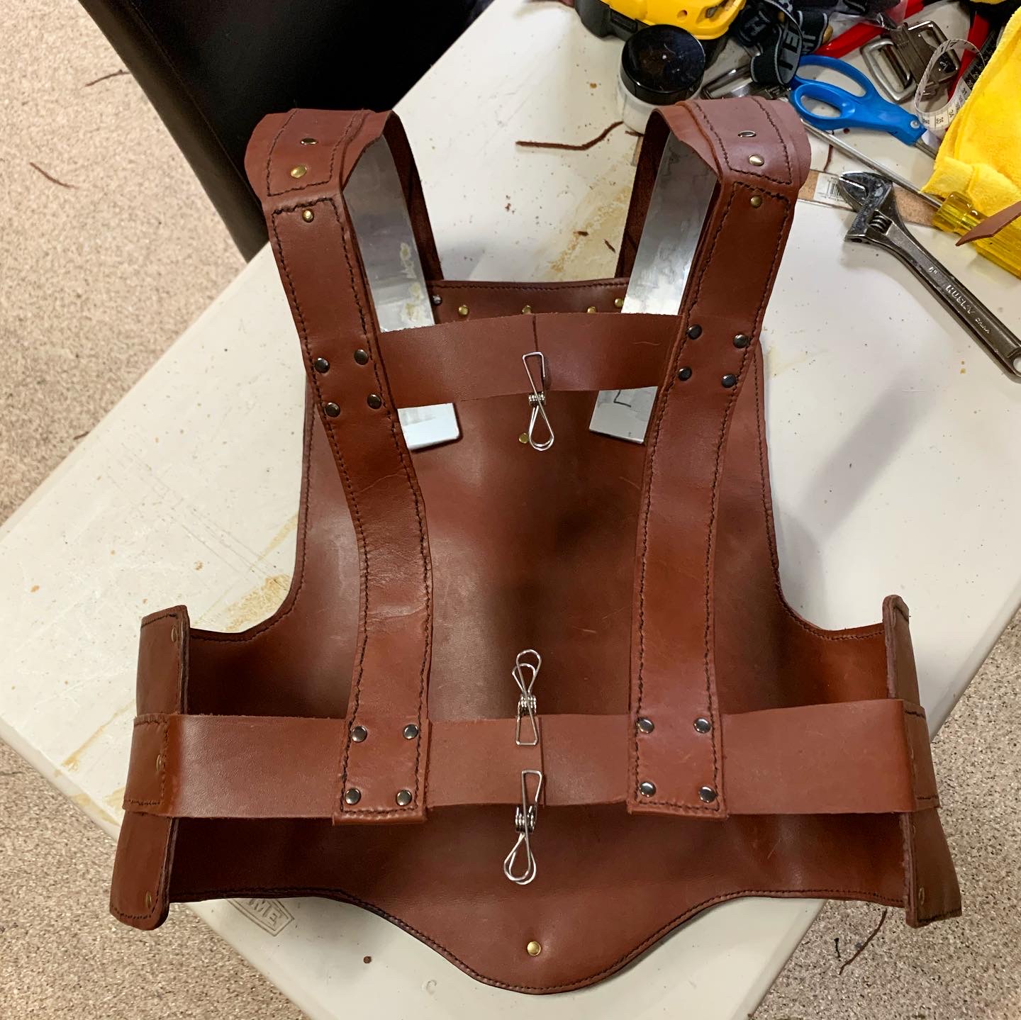

Here are some more progress shots. I added the shoulder straps and added the belt portion. Lots of rivets and even more stitching but it's coming right along. Up next: Buckles!

Watching this with great interest. Beautiful work so far. Curious on how you plan to cover the aluminum pieces over the shoulders. Will you pad them? What material will you use?
Good question! They will be partially covered once I make and install the back padding. The upper shoulder parts art not visible when the harness is worn but I'm going to chemically treat them with Aluminum Black solution so they are even less noticible.
Just a suggestion to save that expensive leather jacket. Cover the aluminum with chamois. Cheap enough at Walmart automotive. From your avatar, I see you are into aviation. Early goggles and helmets used chamois as anti chaff material. Would look retro on your harness.Contact cement could be used to hold in place. Most blackening solutions will wear off and I have never gotten good results from them.
Either way it is going to look great.
That's a great idea! I happen to have some lying around and I'll do just that. I thought about covering them somehow but never thought of using chamois. Thank you! I love this community!

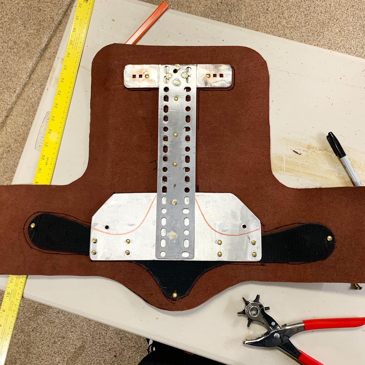

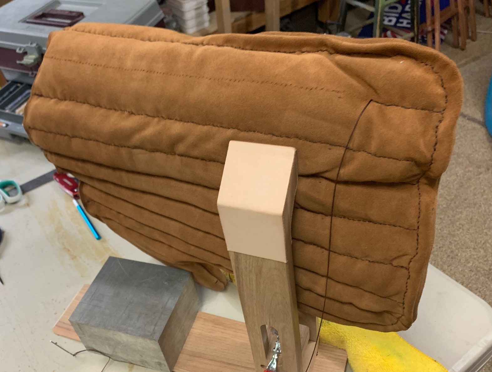

I made the inner padding out of suede. I figured, "Why not?" I think it turned out pretty good. It's a little hinky here and there but for me, it's perfectly imperfect. I plan on attaching it with snaps. I'm currently figuring out how to cover the aluminum straps pieces with chamois. More updates soon.
