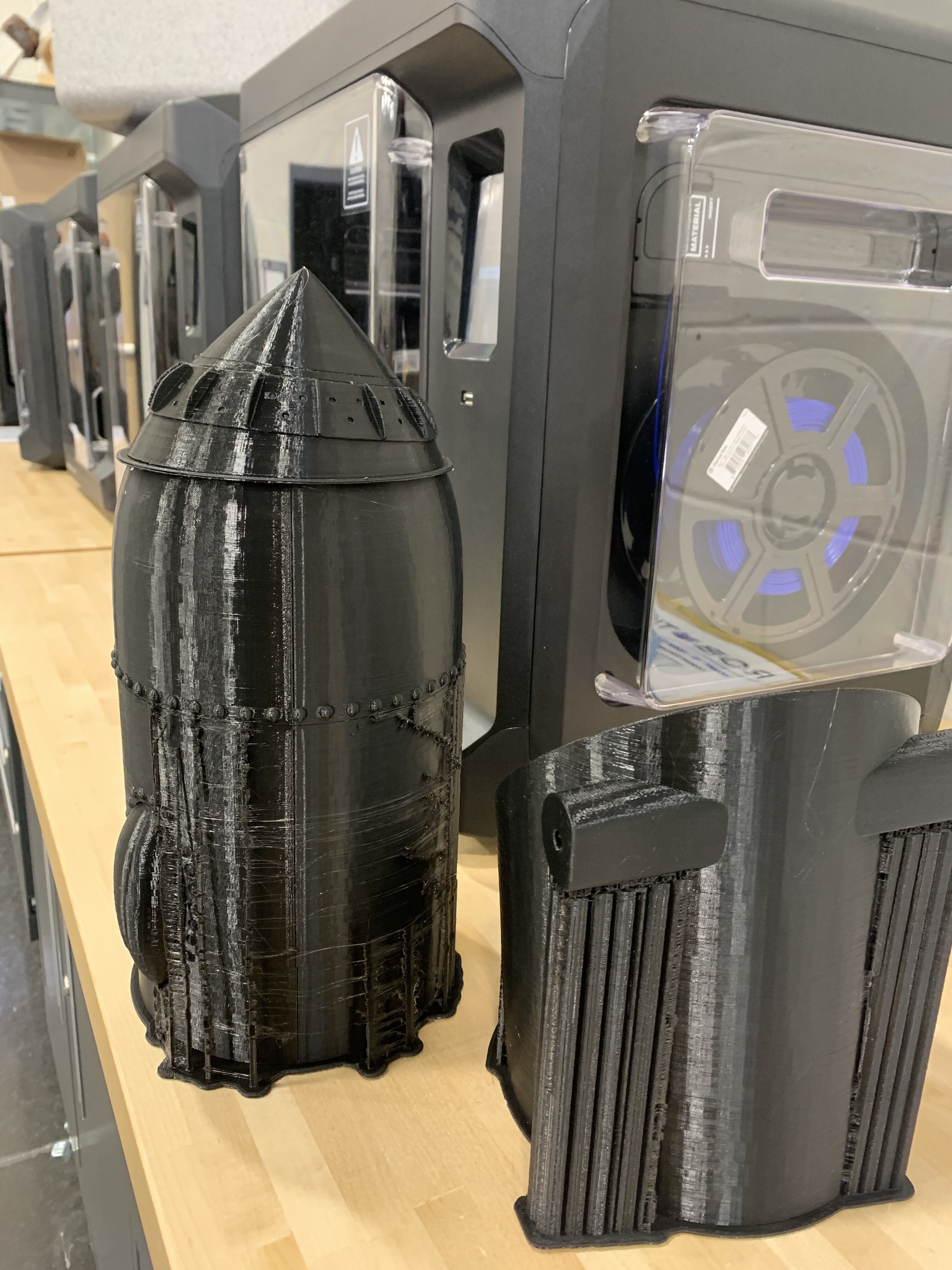

Up to you, but starting like this would give you a much better finished helmet. PLA is a nightmare to sand and getting it really smooth takes a huge effort.
Buttery smooth! Yeah, I’m going to reprint and try to get it smoother. That printer is doing some funky things and keeps jamming even though the extruder was changed out. Might need a total recalibration.
We started printing one of the jetpack tanks on a different printer and it looks like it’s coming out considerably smoother compared to the helmet.
My buddy helping me print thought we should try printing in ABS because of all the detail and smoothing out the print lines using the acetone method. Now I need to go back to reference photos to figure out where I need to break the supports off. I’m so confused!

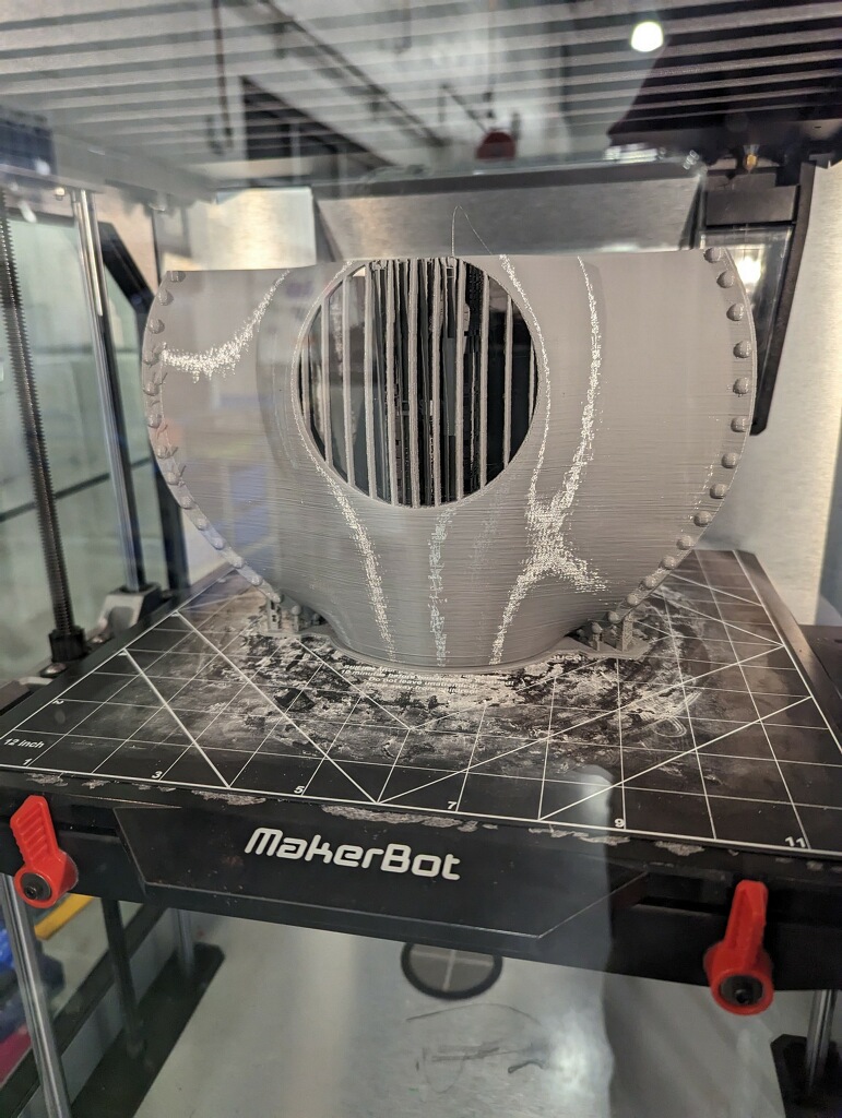

Any words of wisdom about how to slice this thing to print? I was thinking cut it straight in half (front side with vent, and back side). I’m not able to print this piece as a whole.

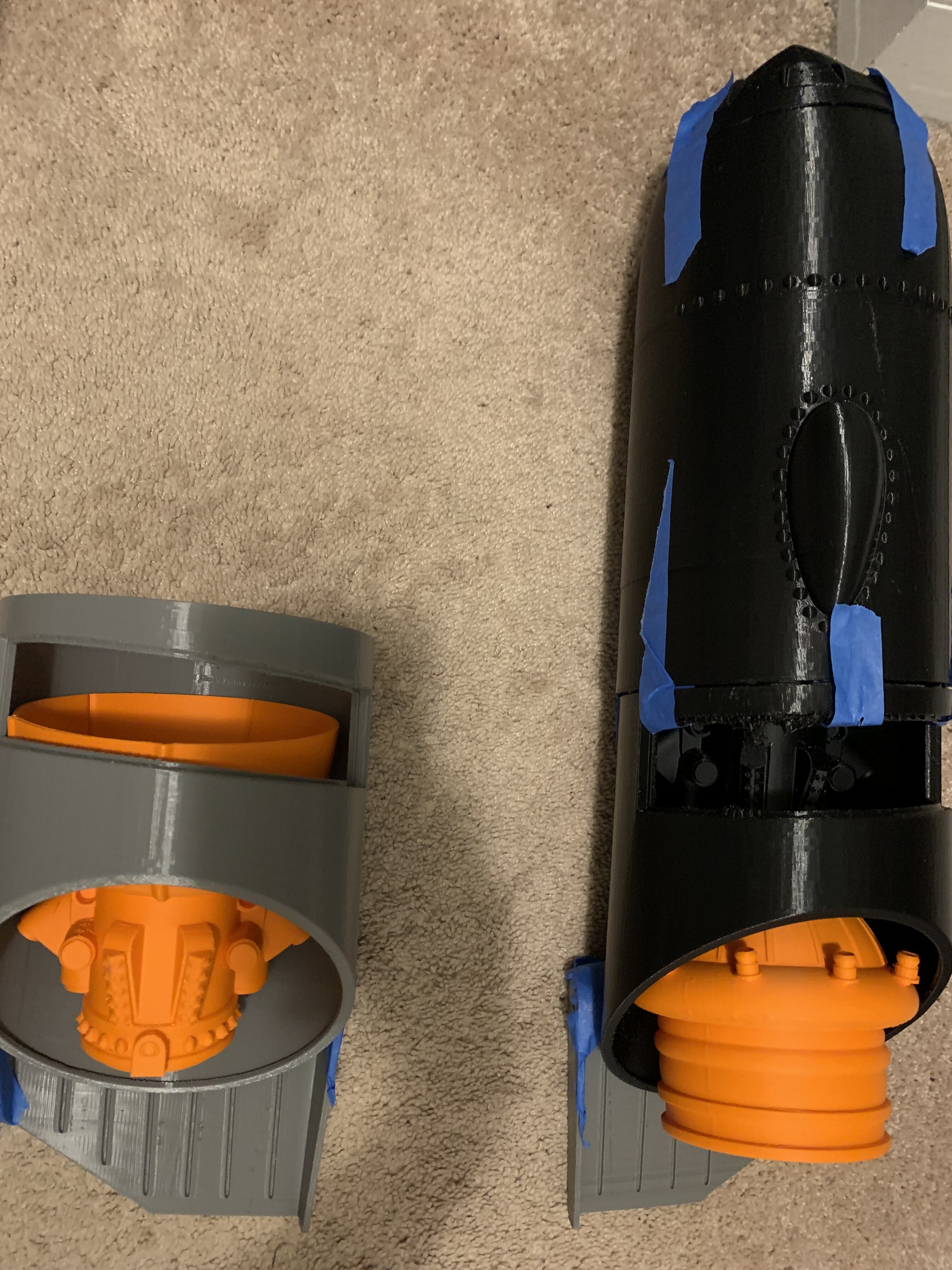

Slow progress but progress nonetheless. I wanted to tape together some of the pieces just so I felt like I was getting somewhere. Working on the middle rocket section now.
