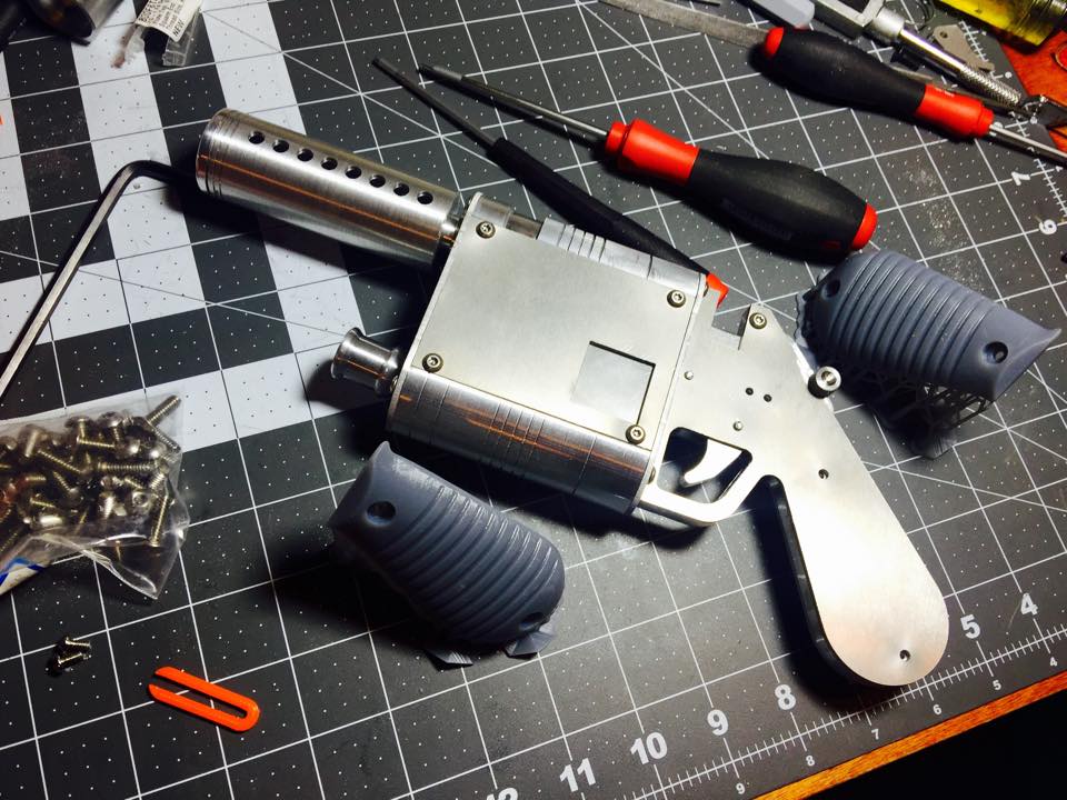

Lot more progress. Got all the metal parts finished. Just have to mill the slots in the side panel. I modeled and 3d printed the grips. I also just cleaned those up and got them ready for molding. Next video will show that and the assembly! Pretty excited its all coming together.
I've been following your build for the last week or so, amazing work. Your videos are really informative and entertaining. I've been planning to make a metal Rey gun myself, but I've only got a manual mill and lathe to work with and I'm not much good at 3d modeling. For the grips, I was planning to modify, mold, and cast the grips from an airsoft gun, but they just arrived and seem very small in comparison to the ones on my Denix Mauser. Any chance you could share the sizing of your grips somehow? I came up with the same barrel diameter you did, and I'm worried these grips I got will be disproportionate.
Beautiful. I want...so badly. Will have to make due with my 3d printer version for now.
I used Denix and Dark engergy grips as a base for sizing then modeled my own from scratch to be exact fit for the frames. I can prob cast an extra set once i get to that point if your interested. They would be very close to the size of typical mouser grips. So if your airsoft ones are smaller than denix they are "probably" too small, at least based on my measurements.

So close!.. I got all my waterjet parts back. I made the safety, printed, molded and cast the grips. Finally a near complete blaster. Feels real nice in the hand. Has a nice hefty feel! I just have to do a couple odds and ends and then polish and weather. I bought the digital version TFA and been watching it frame by frame. I have 2 small accuracy tweaks to make and i think its spot on :)
I´m sorry to say that, but Denix grips are the bulkiest of all known Mauser copies. Way to big, considered the size of real grips.
And as these grips seem to be based on the airsoft version (Modell 712 Schnellfeuer instead of C96), visible due to the much fewer groves, i assume your grips are noticeable to big. And if you based your overall dimensions on those grips ........
I did have to scale them "SLIGHTLY" down but barely. They are def a good amount thinner as I'm sure you can tell in my video vs denix grips. I feel like they have to be pretty close where they are because they are in good proportion to rest of the parts when overlayed on all of the reference pics. And the total length of the 2 i made are right around 11" - 11.2ish" which seems to gel closely with Justinian's report that the accurate length is 11". And if they are still a little too big maybe I also just got lucky with the rest because i did notice on his blueprint he has a little more metal showing around the edge of the grips.
