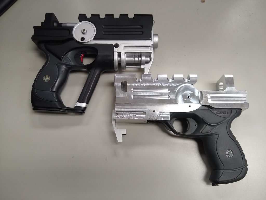

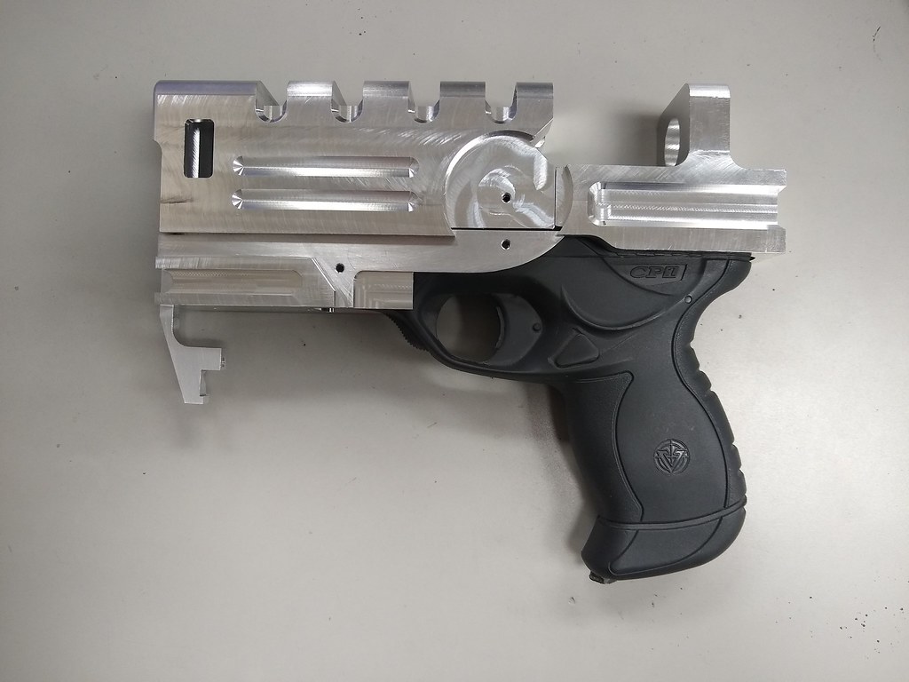

I got all 4 CNCed pieces machined. They need the holes reamed and tapped still and some minor fitting, but it's coming together.
oh my god this is super fast and super awesome! this is the best 5th element blaster I have ever seen! I'm so jealous right now!
congrats (y)
Thank you!
It's unfortunately going to start slowing down a little. It took me months to model the gun and program the CNC, running the machine was the fast part. Now I've got to turn all the other parts on a manual lathe, modify the resin gun, and rapid prototype the grip frame a bunch of times until it fits.

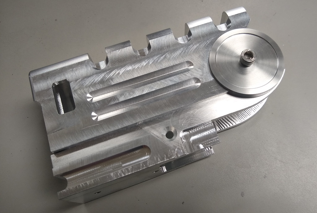

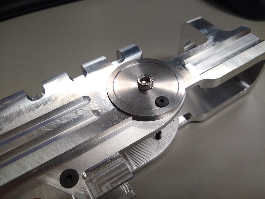

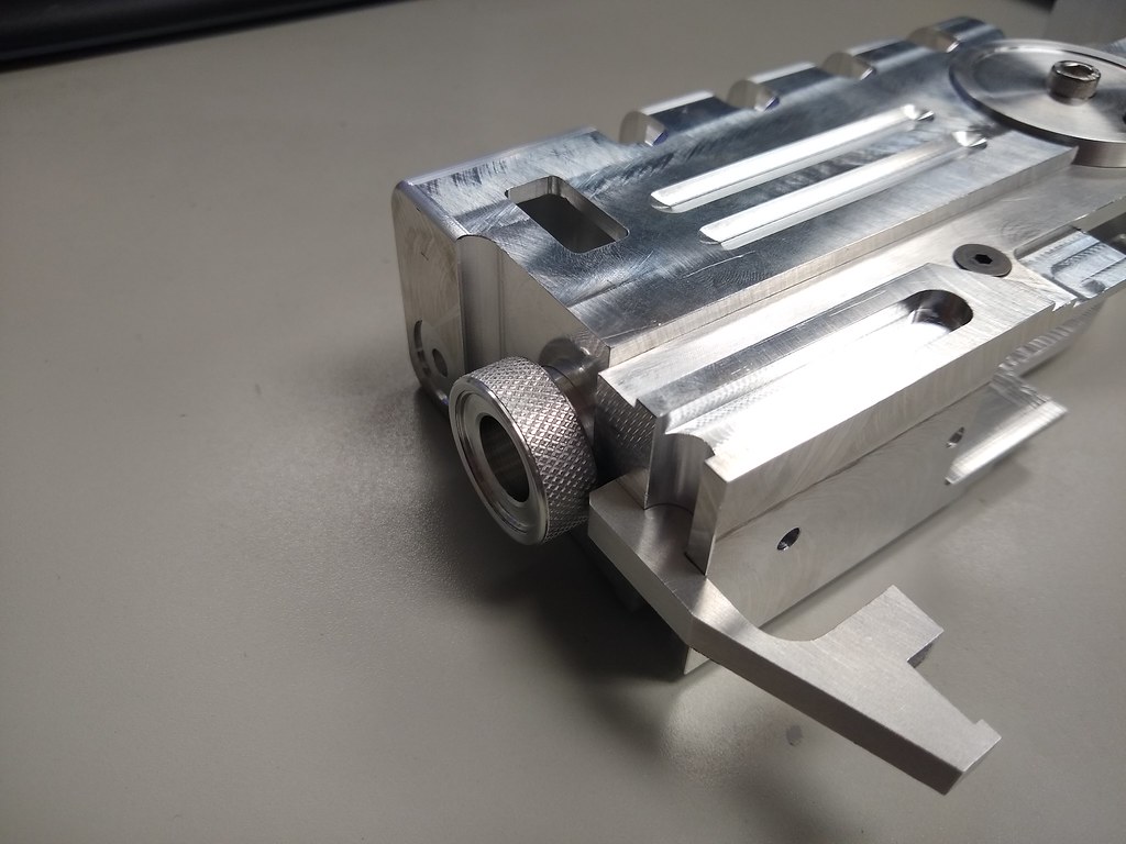

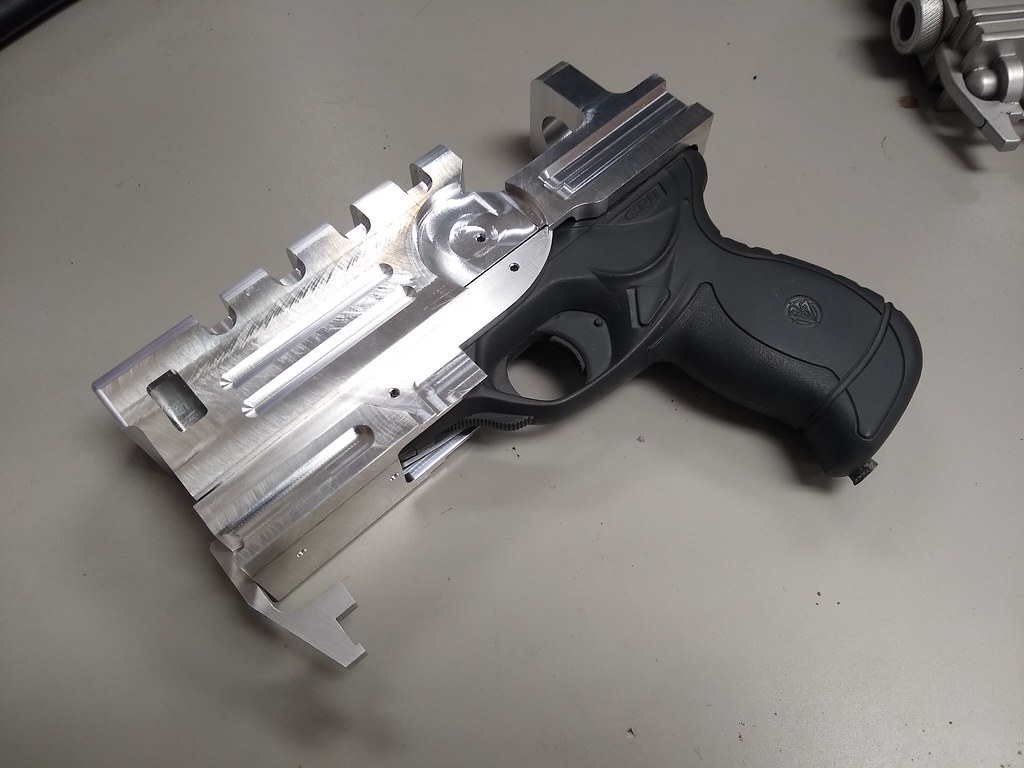

I got a little more work done today than I expected. The two side plates and the barrel are done.
I have to do some fitting on the pockets for each disk. This is my first project on the CNC machine and I didn't know to compensate for tool wear, so all of my pockets ended up being a couple thousandths of an inch too small. Shouldn't take too long though. I'm planning to start on the large turned piece at the front on Monday, but I'll have to stop short of finishing it until the radius bit I ordered for the lathe shows up.
