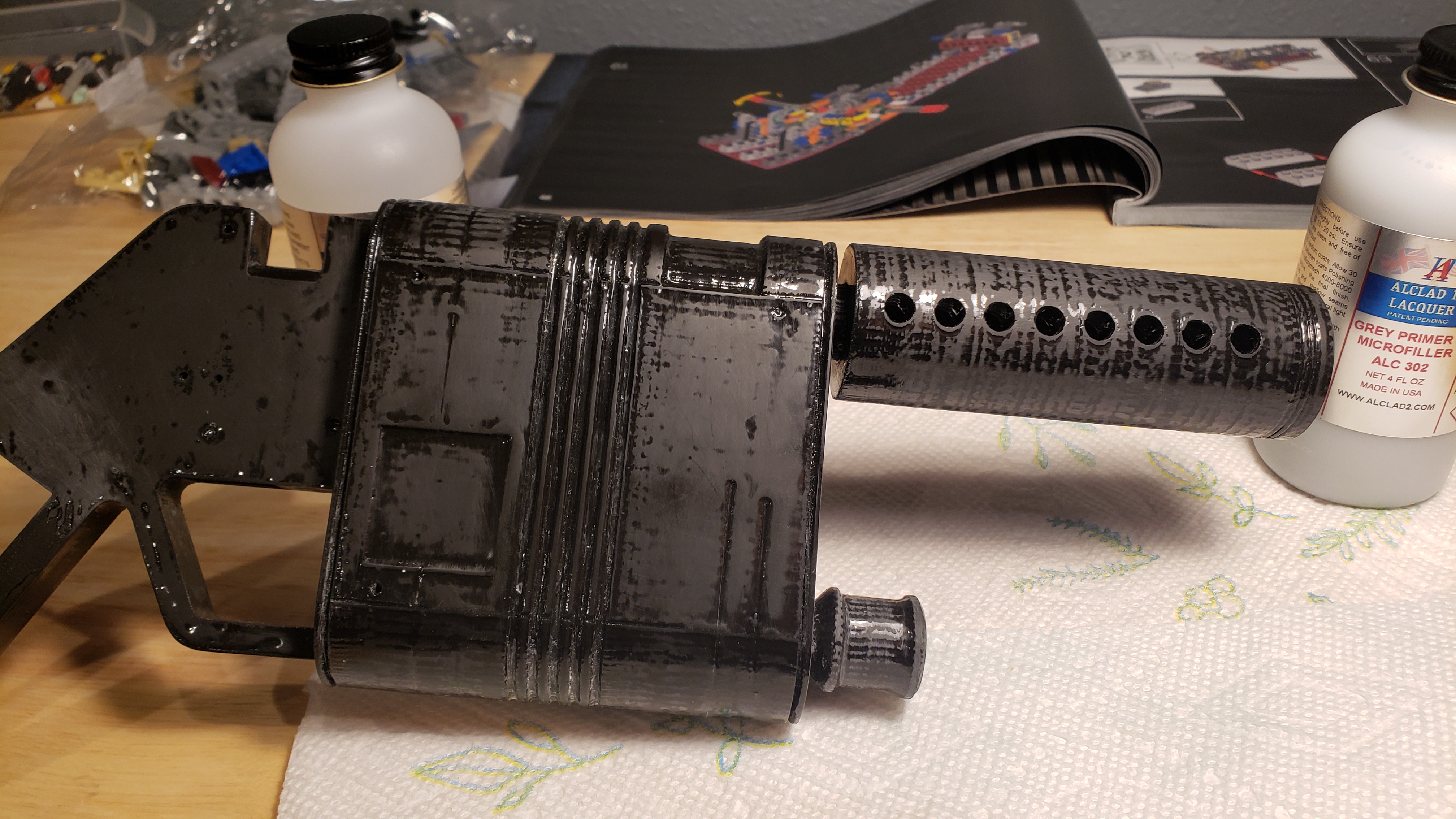

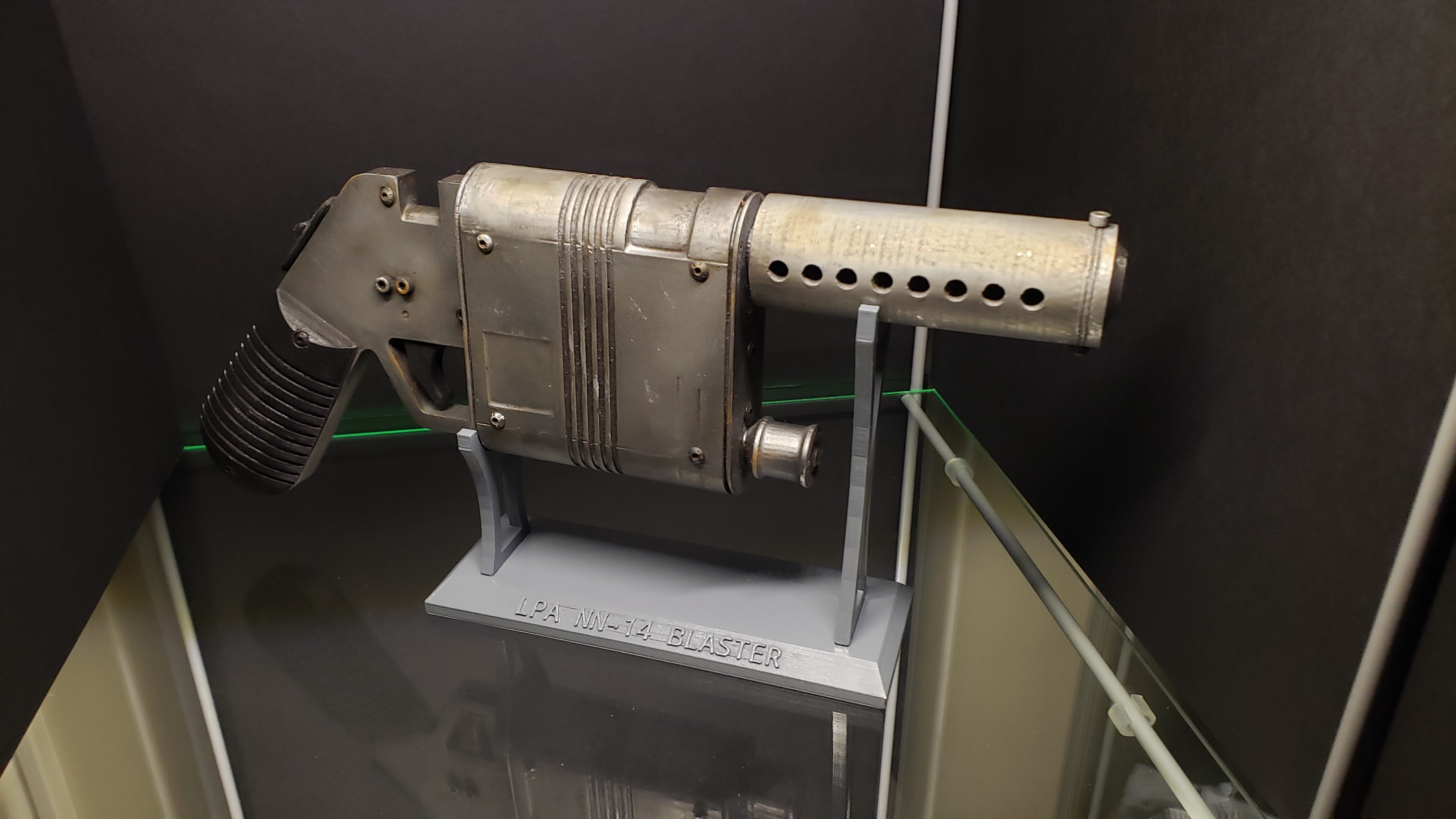

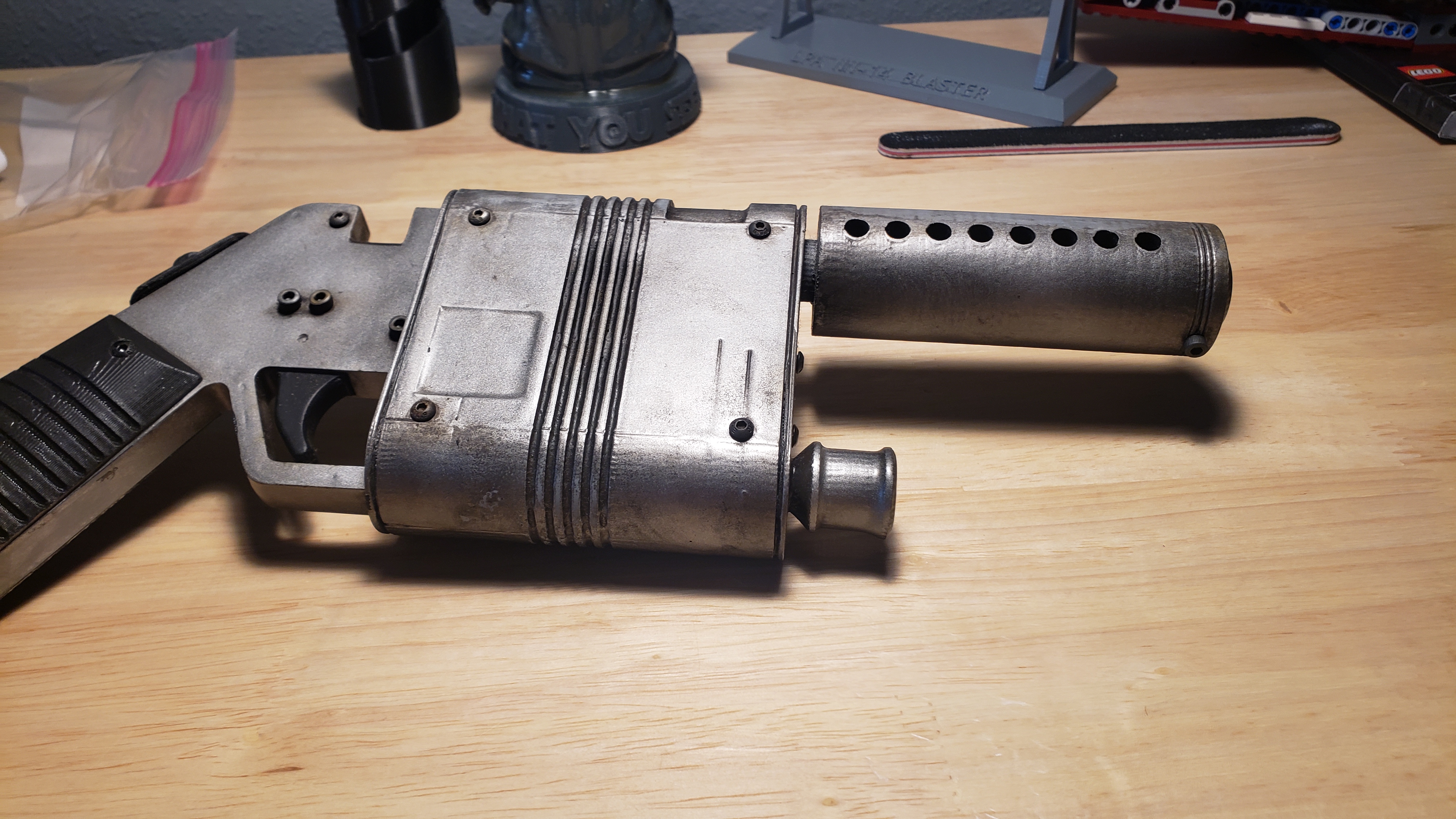

Here is the first prop I have ever made, it's Rey's blaster, and below is the basic process I used to get the final finish. I did have some kind of issue on the top where the paint just came right off. I am not 100% sure that the Alclad Gloss Klear Kote is all that durable. I did let it dry for about 2 weeks but the thinner I used for the oil paint ate right threw in a few spots, but others it was fine so I may have also just not coated it very well.

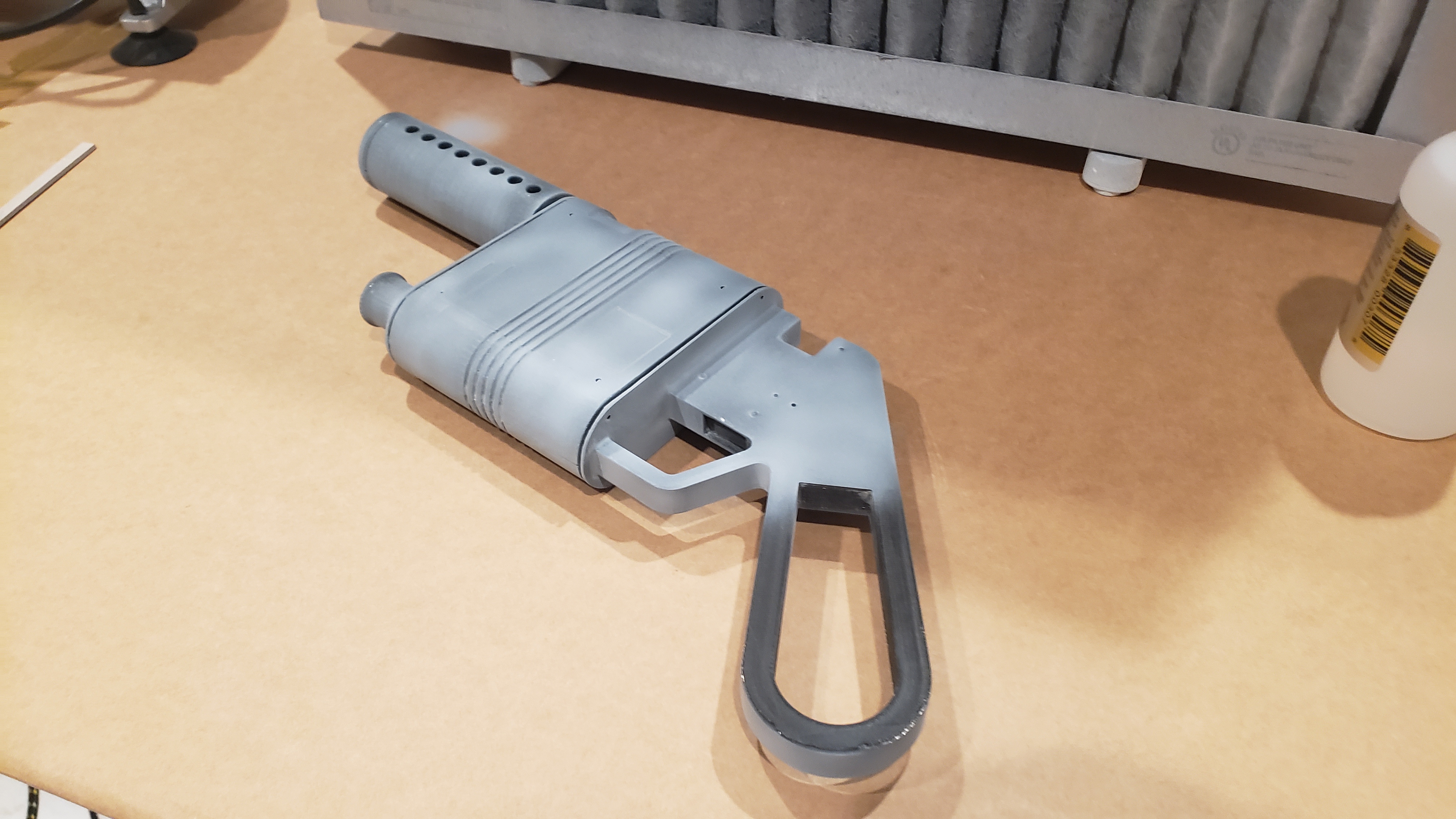

Next, I coated it in Epoxy Resin to fill in all the gaps:
Then I used Alclad micro filler primer to prep it for paint.
I don't have any in-between pictures but the rest of the process after the primer was:
Basecoat of Alclad Gloss Black Base
Alclad Klear Kote
Alclad Polished Aluminum
More Klear Kote
Finally, weathered it with some oil paints.
I was actually pretty happy with the end result, right before I weathered. I did not expect the thinned oil paint to eat through right down to the primer as it did, but that is what my next step is all about experimentation.
I am going to attempt to re-paint the top to see if I can get it to blend. The nice thing about these Alcald Lacquer's is that they go on amazing! They are a bit of a pain to airbrush from a cleaning perspective (as I think is true with all lacquers) but the finish is pretty amazing.

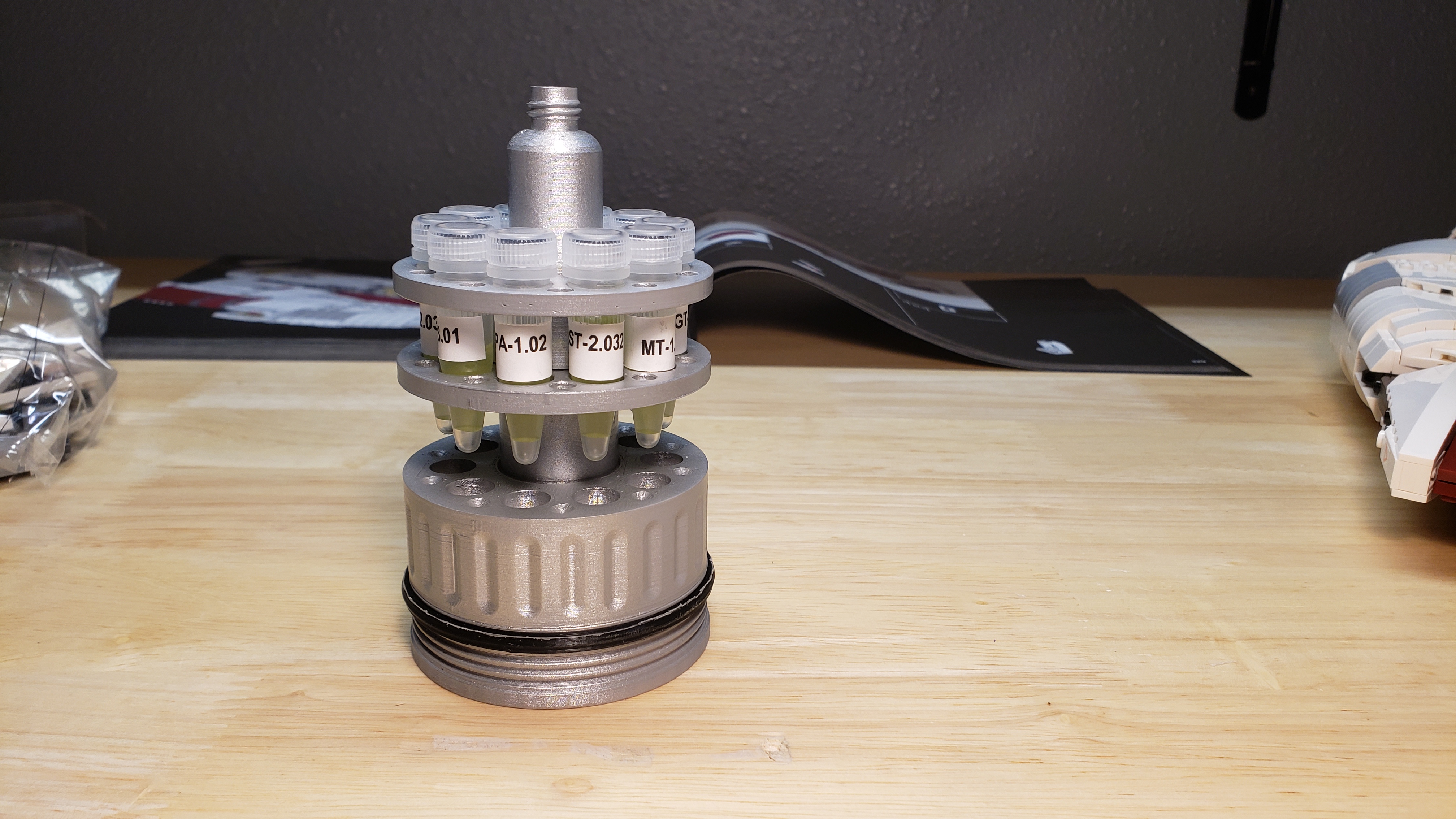

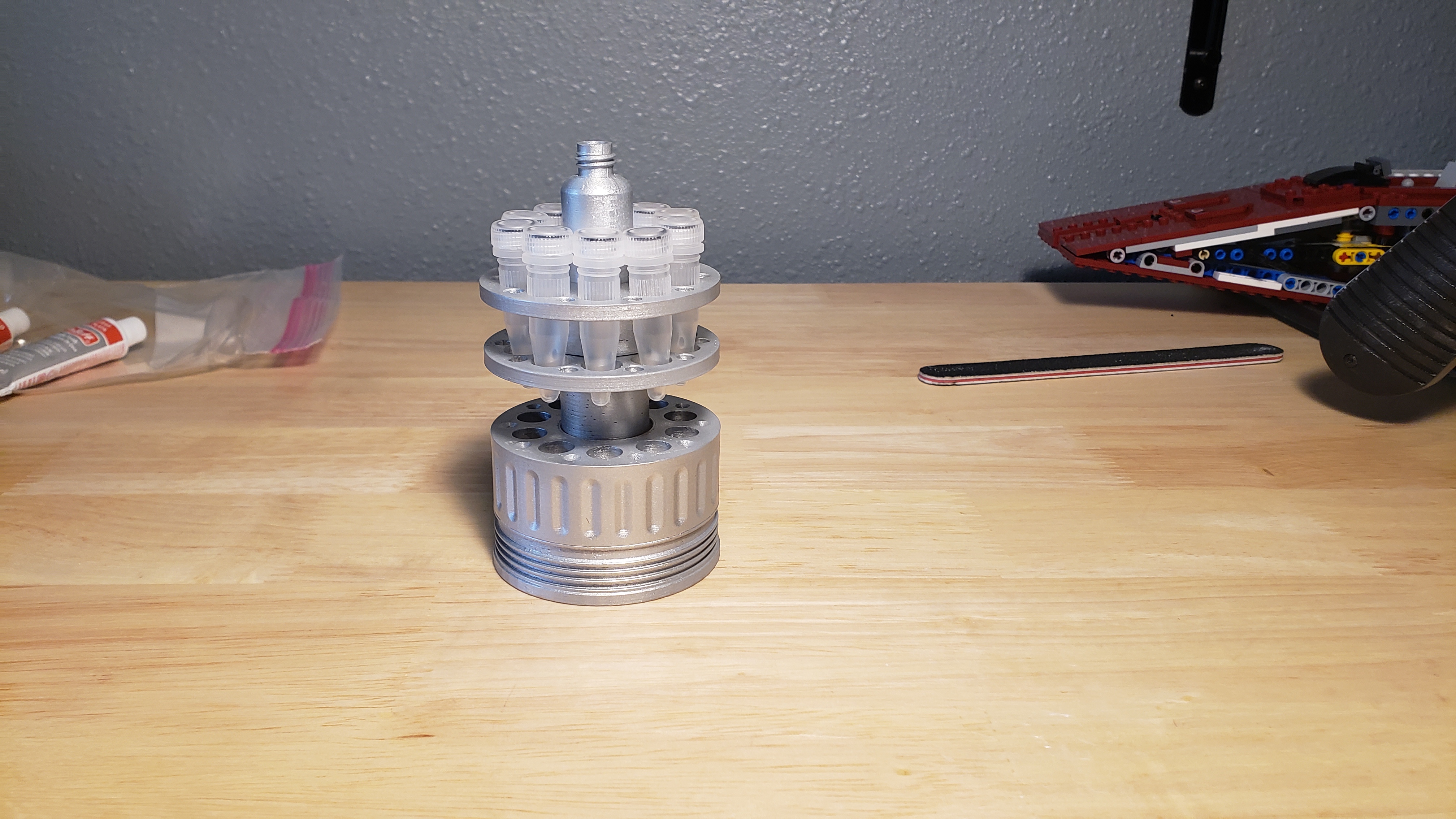

My son's favorite movie is Jurassic Park so I knew we had to build the embryo transport cryo-canister next. This paint was much simpler. I did not epoxy coat this one and just used the following process:
Tamiya Surface Primer
Tamiya Chrome Silver (this also went on really nice with the airbrush)
Tamiya TS-13 Clear.
The finish is pretty nice, it's just to sit on his shelf in his bedroom so I was not looking for something that would look all that authentic, and this project is not done as we have to label and fill up the containers but he loves it and at the end of the day it's what really matters in this case :)

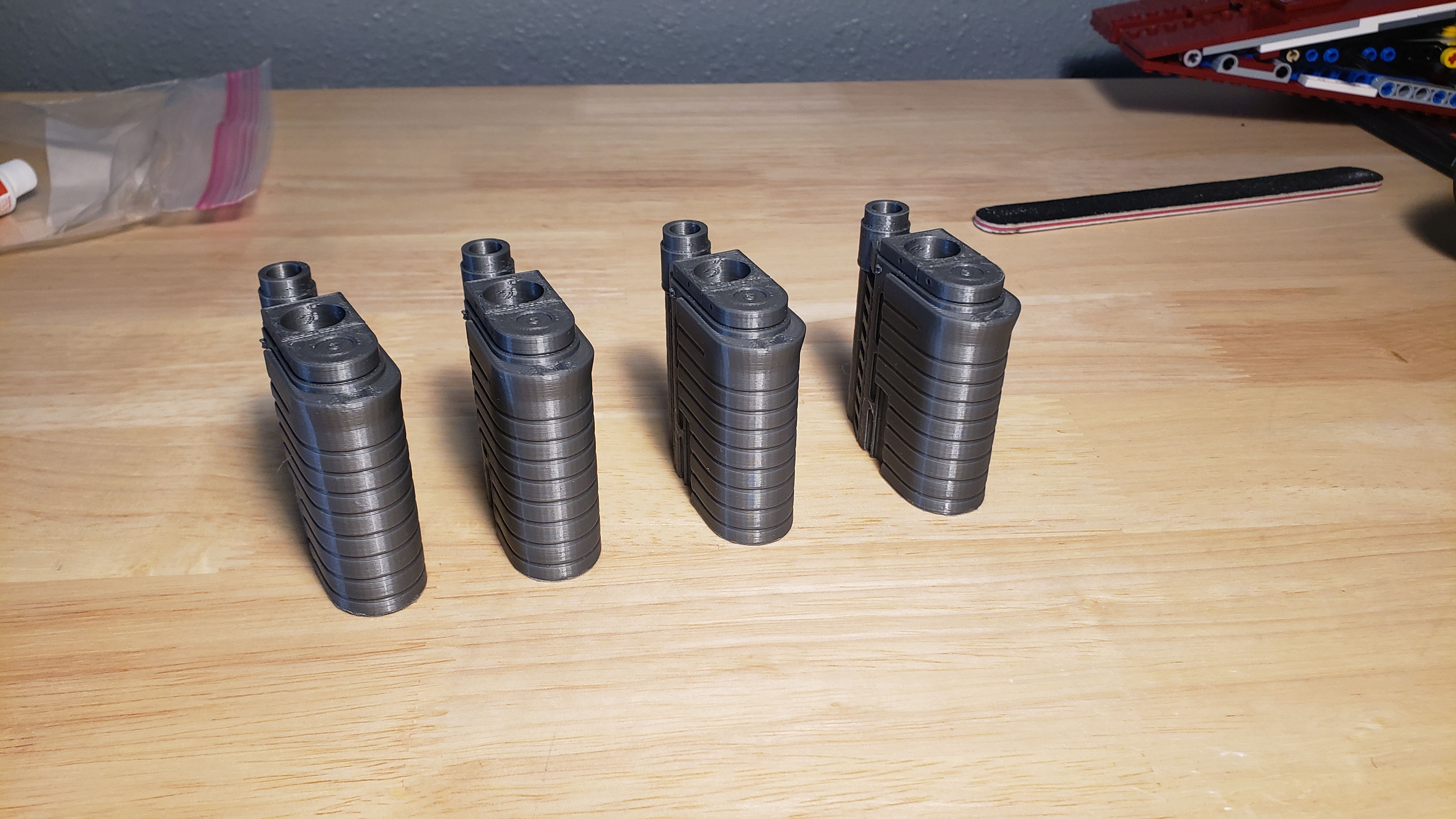

I scaled down the front of an M41A pulse rifle from Alien and these are going to be my test subjects.
For each of these different prints, I will try 4 different processes to finish them. While I understand every project is different and the paint approach will also differ, I am just trying to get a general overall feel for the initial finishing processes for these types of props and how the resins, prints, primers, etc. all work together.
Here are my thought processes so far for each of the finishes, if this changes I will update what I did for the final product:
Experiment 1:
Resin coat
1/2 with Alclad Lacquer
1/2 with Tamiya Metallic Grey
Experiment 2:
Resin coat
Alclad Base Coat (no primer)
Experiment 3:
No resin
Alcald Black Primer and Microfiller
Experiment 4:
No resin
Straight Rub'n Buff.
And since I had issues with the weathering, I will attempt to weather all of them with my typical thinned oil paints to see how they work.
If you have any suggestions on what you do for metal finishes please share!!

But, that Jurassic cryo-can has a super hard finish. Not sure if it’s the Tamiya paint along with the Tamiya top coat (or the fact it was not resin coated) but it’s very durable. That is really the question I hope to answer for some of my future projects.

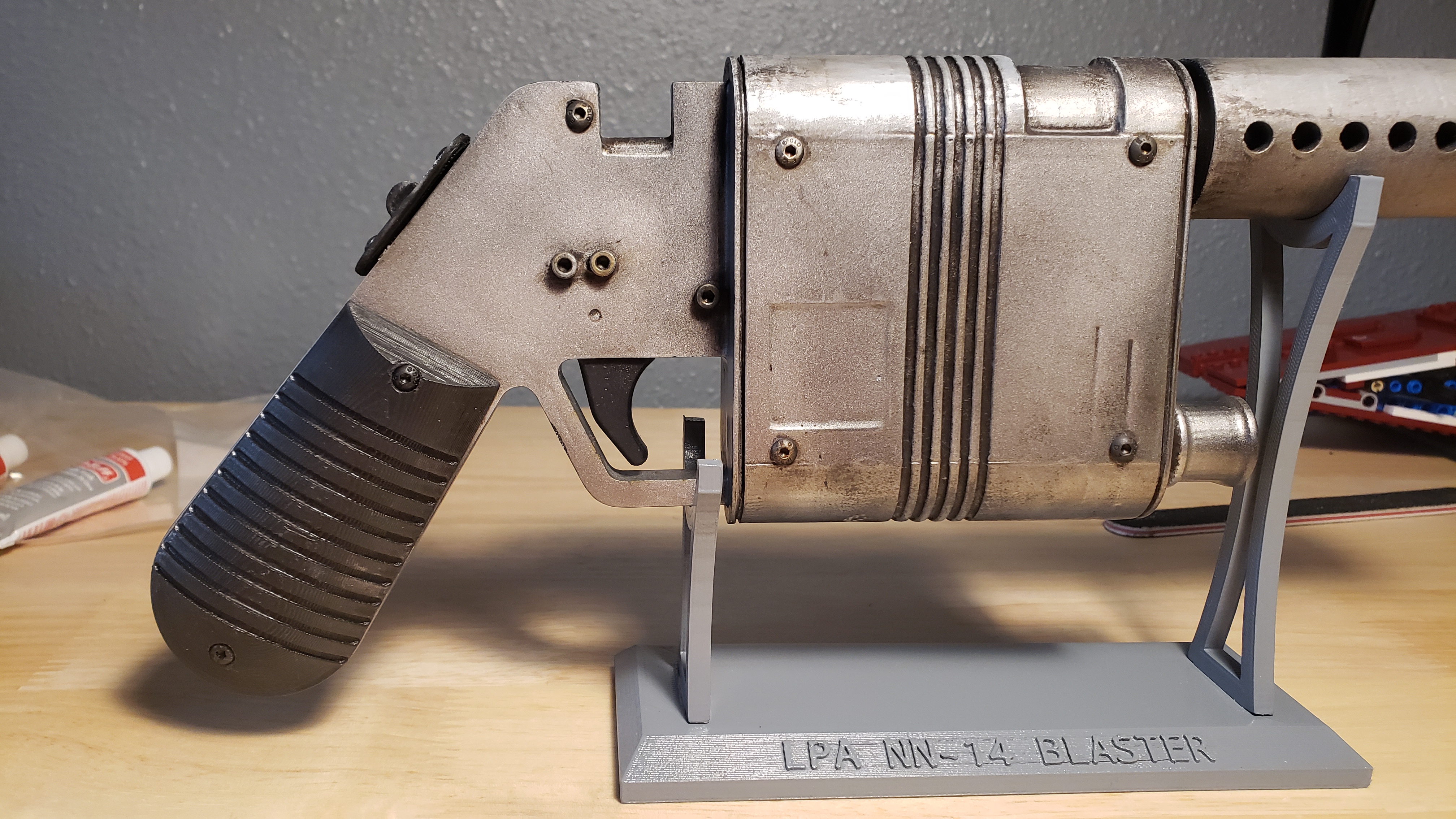

I ended up finishing my blaster and used Tamiya Clear, it seemed to hold up really well against the weathering. I also finshed my tests and will post those pics soon.
Gun looks a little odd on top, I think the camera is picking up something from the LED lighting in my cabinet.
