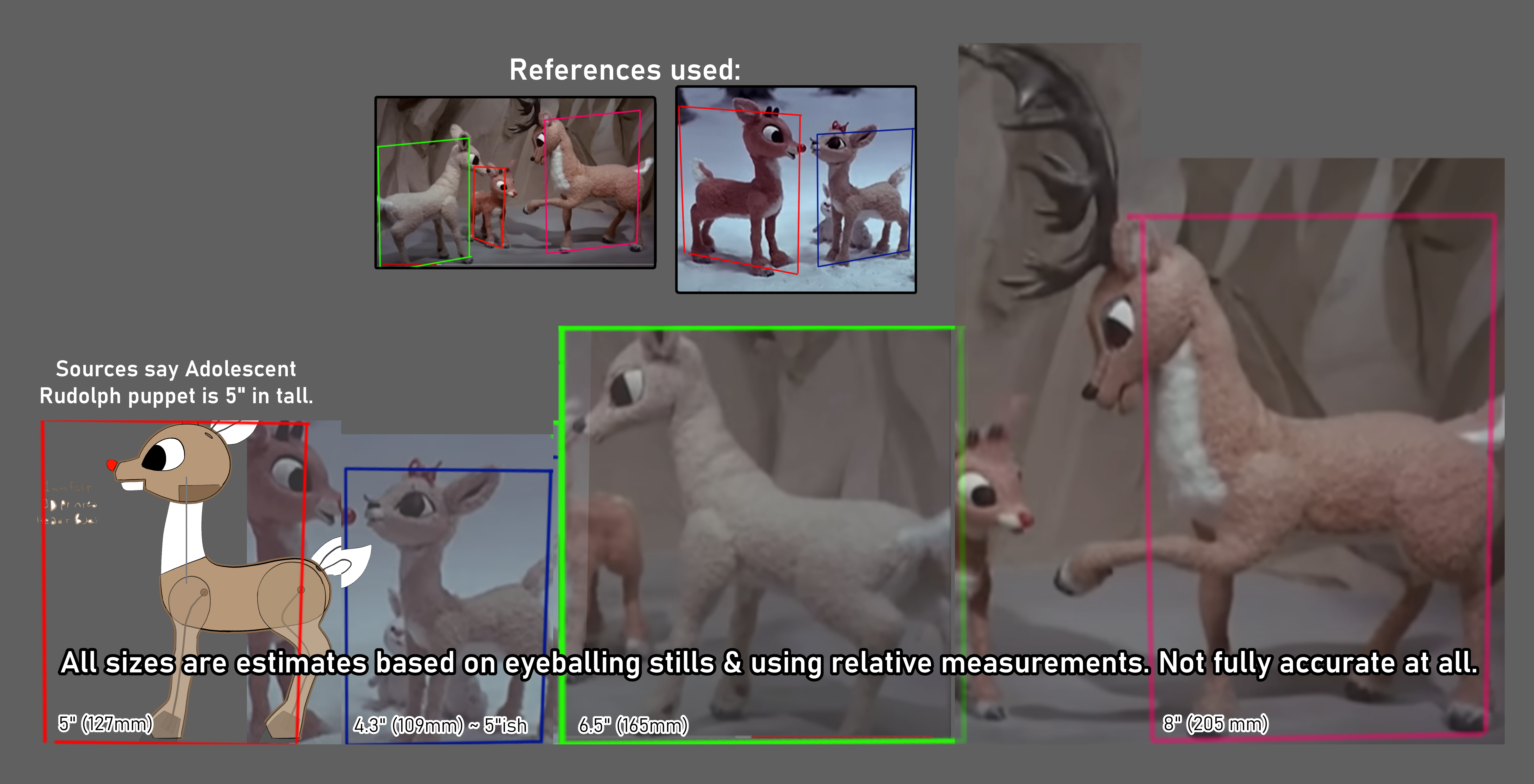

So I've yoinked some screengrabs from the film on youtube and done simple very rough and lazy relative measurements of the characters based on the 5" Rudolph.
The mockup is very crude I'm tired from a long Christmas Day of socializing but also wanna get this jump started so it's a low energy low effort starting point hahaha. Can't be bothered for graphic design for my own silly projects.
Obviously these heights are not particularly accurate since I'm just eyeballing things and know nothing about camera lenses and how they effect the perspective of scenes which impact the way you can measure things.

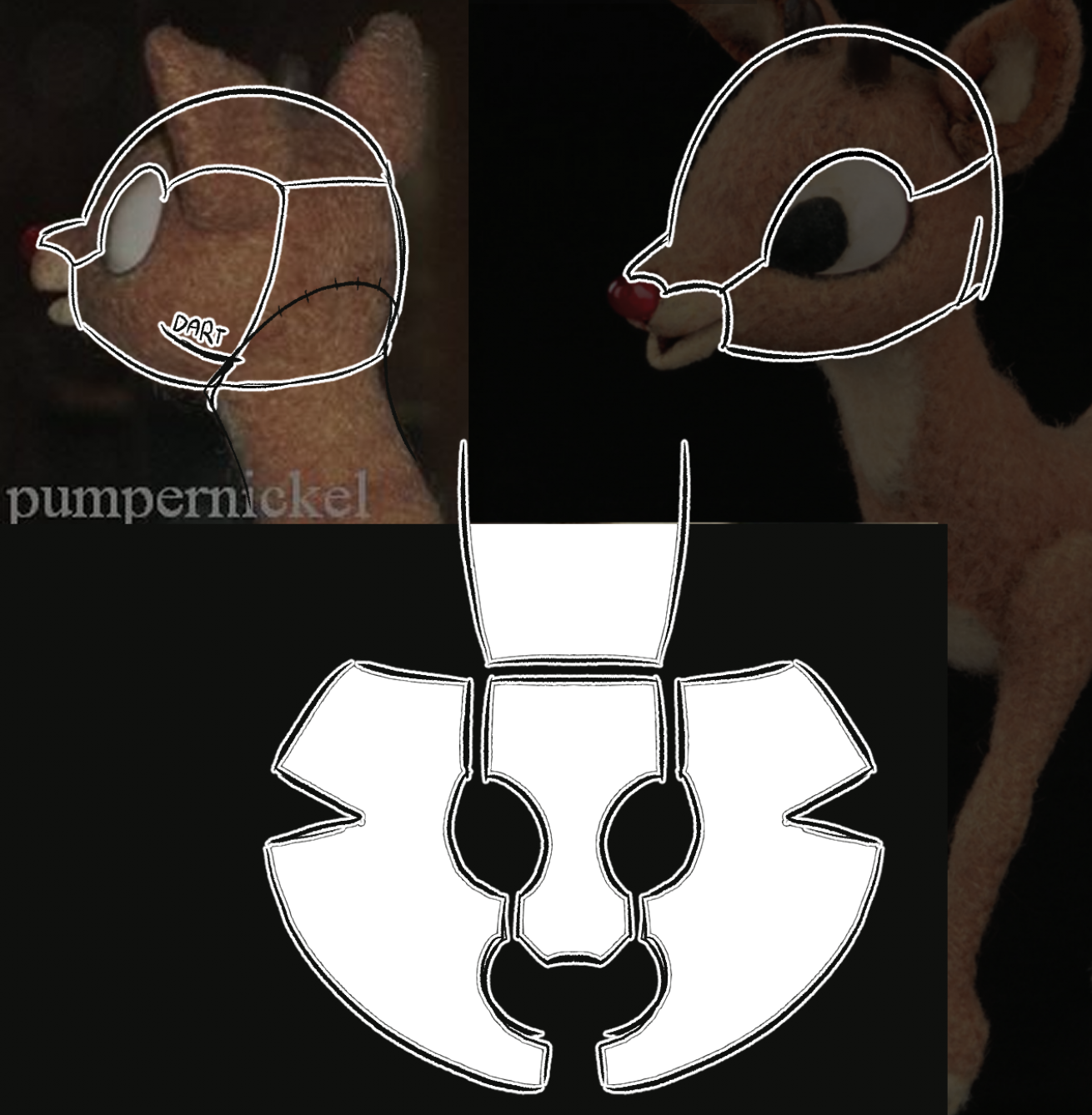

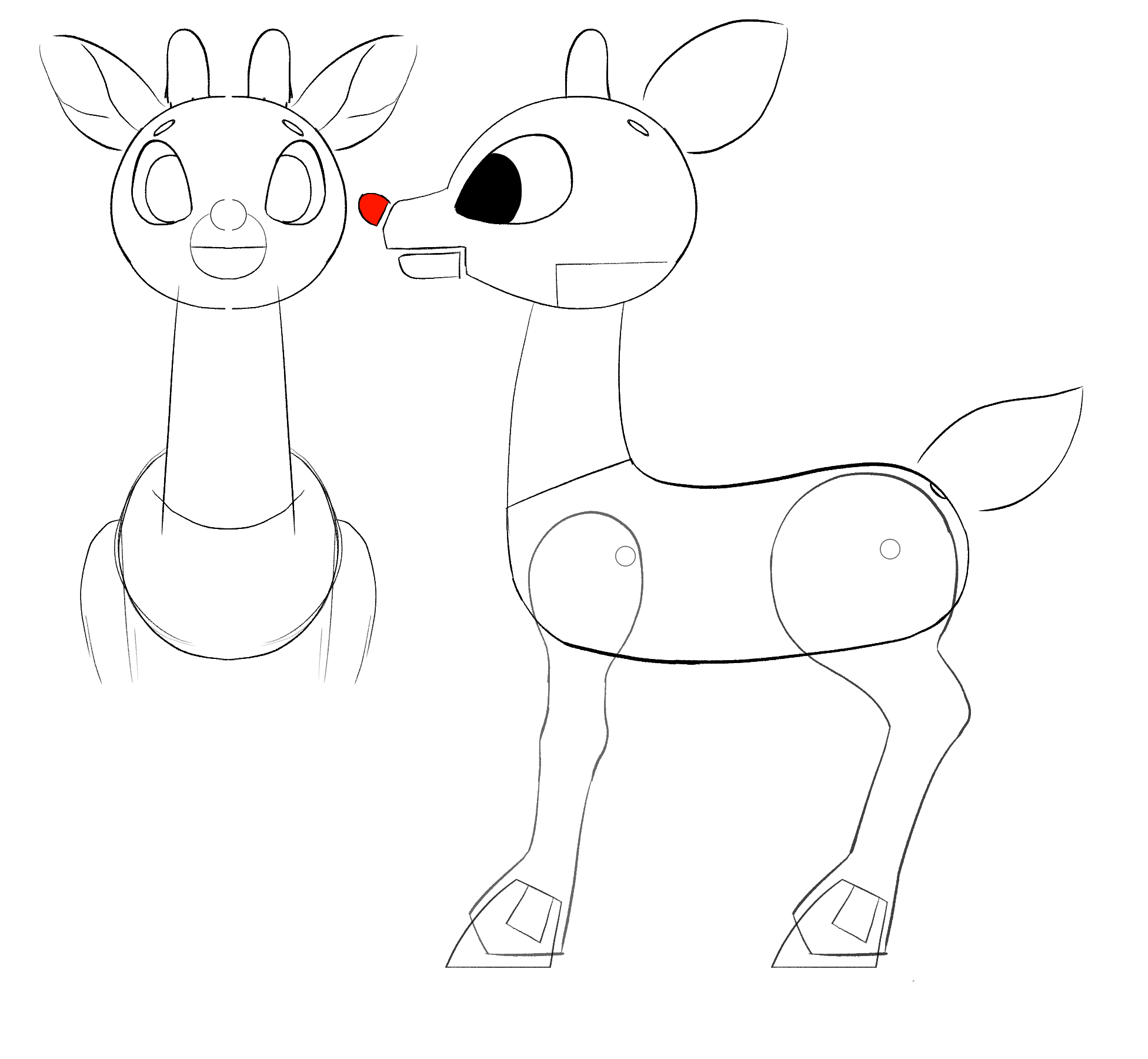

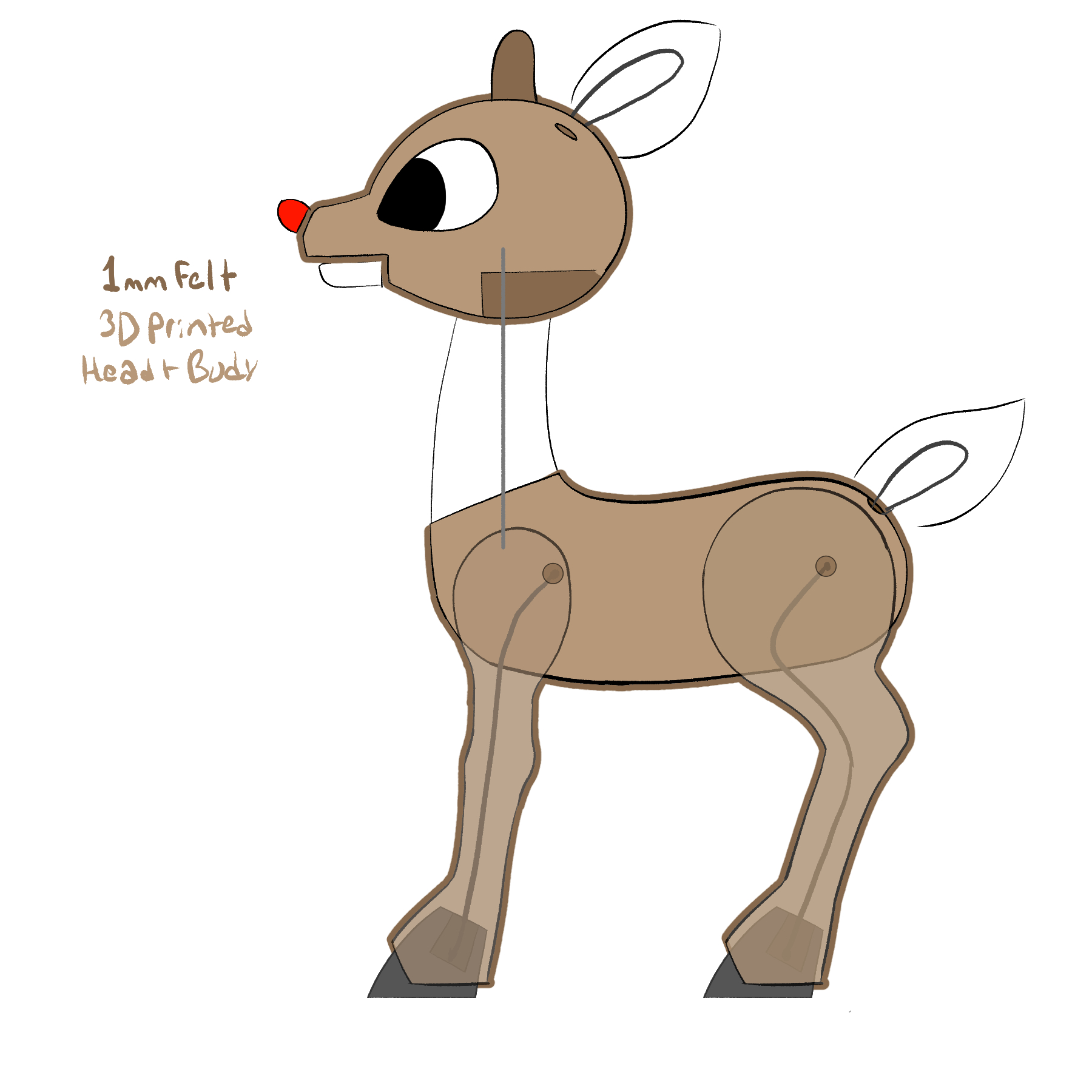

Here's my initial draft plans for making a similar Rudolph Replica.
It's VERY wiggly as I was using my brother's surface pro and I am not at ALL used to handling a surface, I use my Kamvas 13 pro normally.

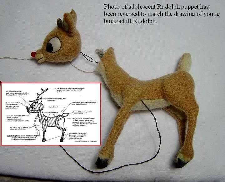

Based on this photograph of the puppet and the diagram next to it.
View attachment 1773150View attachment 1773149
The book that people have mentioned here looks like it says the artists used 3mm wire and another size for the smaller parts like the mouth or so. I just wrote down floral wire as that's what I have on hand for my needle felting projects.
The neck was a type of foam I believe, but batting would probably work well.
The legs, depending on the scale will probably be better and more easily done with batting than foam, in my opinion.
You might not even need to fill them with anything more than a few tufts of polyfil, but that'd depend entirely on the thickness of the felt you use for the fur "skin". I am havign a hard time visualising the actual scale these are at, in my head they always seemed MUCH smaller somehow!
The "Wood" I figured we can 3D print for an easier time, as I do not have any experience with carving wood, and I am an illustrator and 3D artist so. I just would use what I know.

My brother refined it based on screengrabs and less on photos of the restored puppet.
View attachment 1773152View attachment 1773153
I initially thought they had been needle felted, but you can definitely see the tension of sewing thread on the puppets in the film and photos of the restored Rudolph.
We'll be trying to compensate the thickness of 1-2mm felt for the base "wood" parts, and were discussing ways the wire may be attached for a sturdy-ish build.
Like using the wire as S-hooks in the hooves or just glueing it right in like "pinning" a figure.
The originals legs seemed to be quite fragile, and I figure a way to prevent that for fun christmas decoration posing would be to have 1 wire per 2 legs instead of 1 wire per leg.
Running the wire through the "wooden" part of the body. That way no ends really would break or pull out of the body easily.
The legs would mostly just be sewn, no 3D printing of a base form needed. And it'd likely be a pretty simple pattern to sew.

Anyway, yeah I think the one on the right would be larger, due to the scaling thing I talked about. When he's with his parents, Santa, the Coach, etc, they would need a smaller puppet than in a shot all by himself or with Hermy.

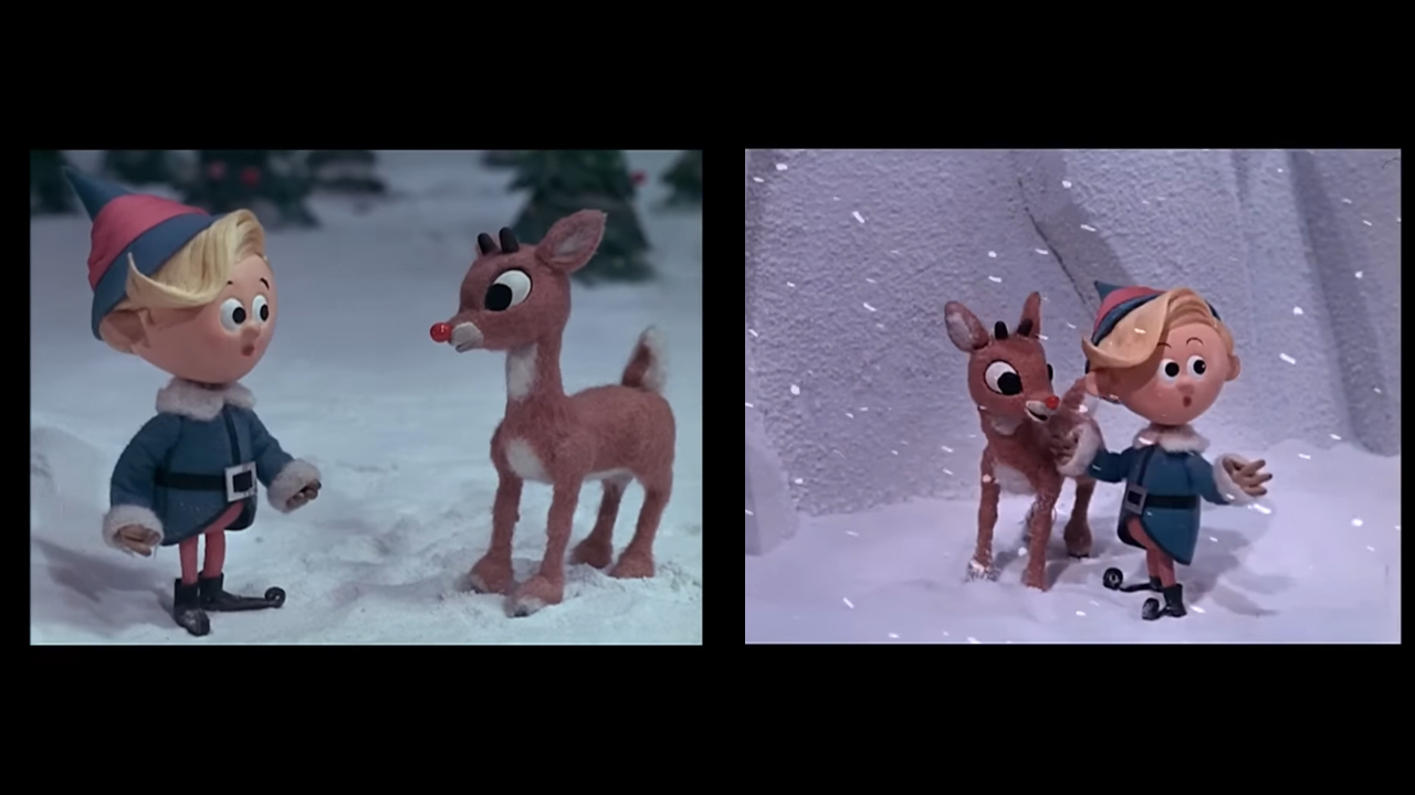

Comparison:
When comparing the two, we can see a few key similarities. His right antler is slightly tilted, the edge of the hole where is nose is placed goes slightly outward in the exact same spot, and his head shape is the same. Also, when the puppet was getting restored, it was discovered that he had a flying rig on the side of his body. A hole that would be used to stick a kicksdtand when animating him. It will help support his weight when moving. I think this pretty much confirms that this restored puppet is one of the two screen used puppets.
As for what you said about the scale of the puppets and sets, I think it's important to remember that these sets weren't tiny and allowed for a lot of close up shots without interrupting the sets. I've studied the scenes a lot as I too want to be an animator someday. The only time they use different puppets is when Bumble is on screen with them. That's when they use miniatures. They didn't create larger puppets for up close shots of Rudolph and Hermey. That wouldn't really be a smart move as that would mean they would have to create entirely whole new upscaled sets to match the size of the characters. This would make the production of the film more lengthy. Also the Rudolph that you say is larger can be seen with the large character Yukon and Rudolph would still appear small. What you said is an interesting thought, but it's not likely to be the case.
Also the two Rudolph puppets are seen in close up shots with the same Hermey puppet. So this way we know that they are around the same in size.

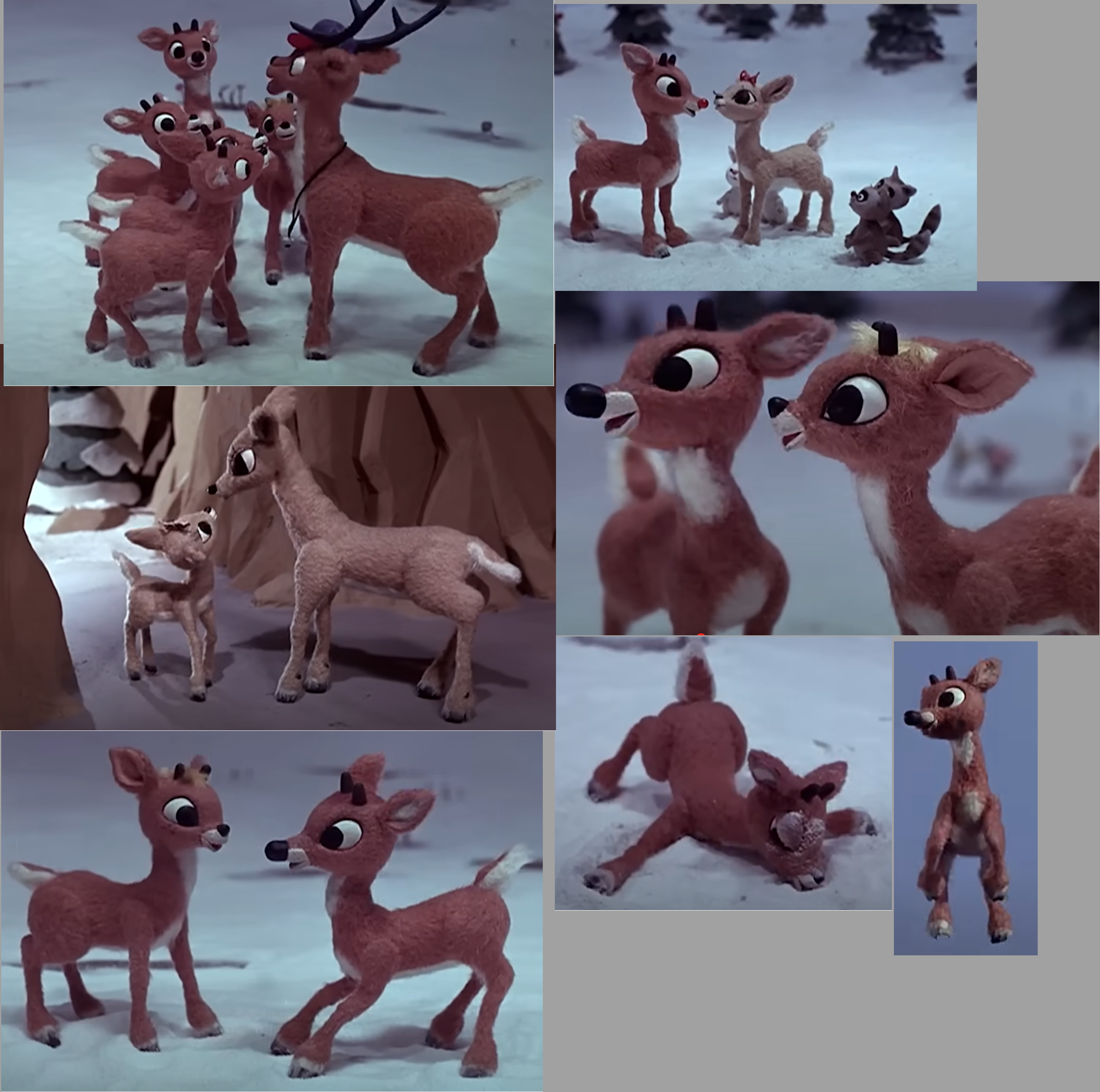

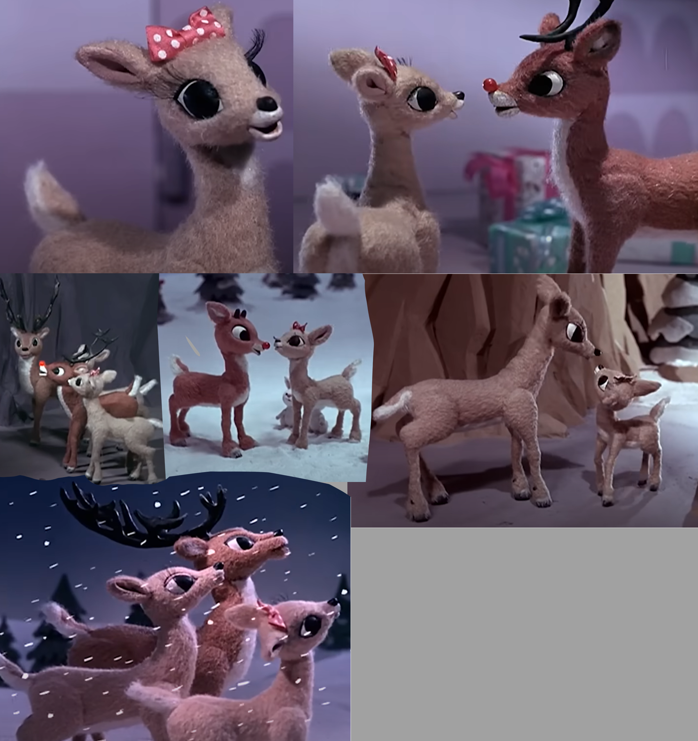

Anywho, here are some reference images from the film itself for various reindeer in case anyone might find them helpful. :)
I also had a small image of 3 Rudolph Puppets (The two Adolescent Rudolphs and Adult/Big Rudolph) I personally don't want to make little baby Rudolph as much as I want to make the other versions so I didn't grab any shots of him.
With the knowledge that the screen used Rudolph was 6" and not 5" (I read an article somewhere that casually mentioned he was 5" so that's where I got it from.) I'll make sure to scale things up for a 6" Adolescent Rudolph. :)
It looks like to me there were 3 different ages of Rudolph puppets; a new born, an adolescent and an adult. So, were there multiples puppets for each age?
Going solely by scrubbing through the movie, I believe for the most part there was only 1 puppet for adult Rudolph. (But I wasn't paying attention to any distance shots so it's very likely/possible that there is a smaller scale one for distance shots and when they're with Bumble!) I'll give the film a look through some time later maybe.

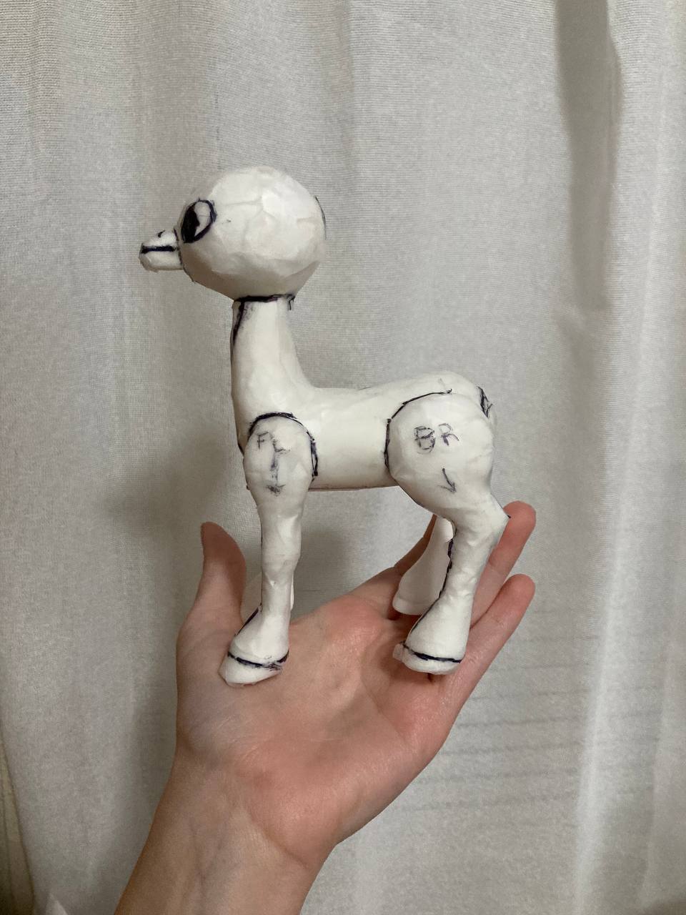

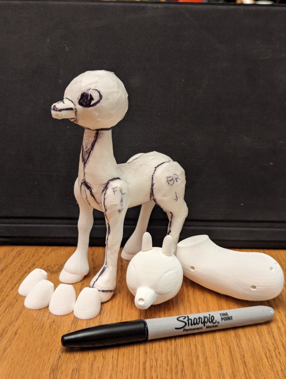

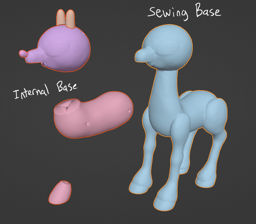

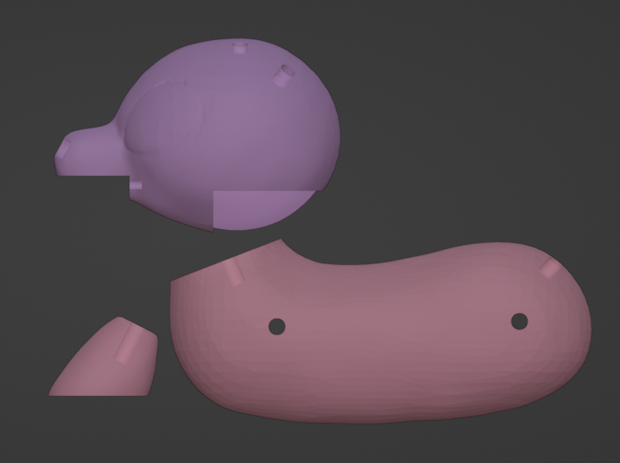

I've blocked out a quick 3D model to test with:
3D printed base for the internal parts
And a Sewing Base static model "figure" I can use to make a sewing pattern off of.

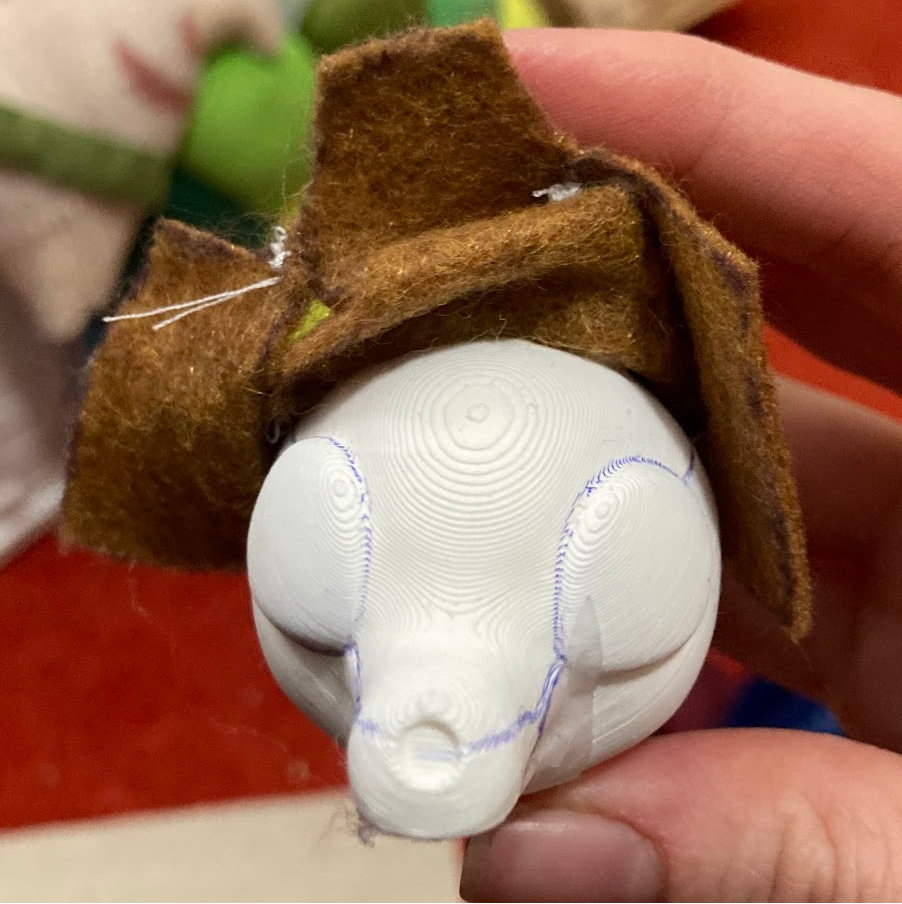

your hooves should be cylinders. The white felt goes around half of it, then the brown overlaps the white at the top and that's what gives the ankles their contour. Trial and error discovery. Also make a depression in the head about 1/2 mm deep that is larger than the white of the eye. The brown felt goes down into that depression and the white goes over that in the depression. Makes it look like his eye is in his head and not on his head. Also trial and error. I love your idea of a 3D print for the head and torso however!!! brilliant.
OH I didn't even THINK about sinking the eye sockets. Thanks for bringing that up!
I assumed I might be able to use something thin enough to put on top of the felt but not sure. If you use felt it'll defintely bulge the eyes. Otherwise you could leave an eye hole in the felt to set a small sclera piece into.
And looking at the screenshots alongside your comment to make the hooves more oval shaped checks out. They do look thinner from the front view on that scene with rudolph flying. I just got so used to seeing those clonkers from the side I wanted to make them wide and clonky from the front view too!
For now here's my rough base for patterning the "pelt". I left the legs on the model on so I can get a good feel for where they'll be placed in relation to the pattern, and it helps me find the tummy section for the white fur so I don't make it too wide and go up his sides too high.
Since I already printed a set of clonker hooves, I can just make this a random original reindeer and not Rudolph, since their faces vary a bit, a hoof variation won't be too bad. Little background deer for future Rudolph then. Or even repurpose the wide hooves into horse hooves and make a horse head for it later. Why not? I don't want to waste plastic to go into a landfill!

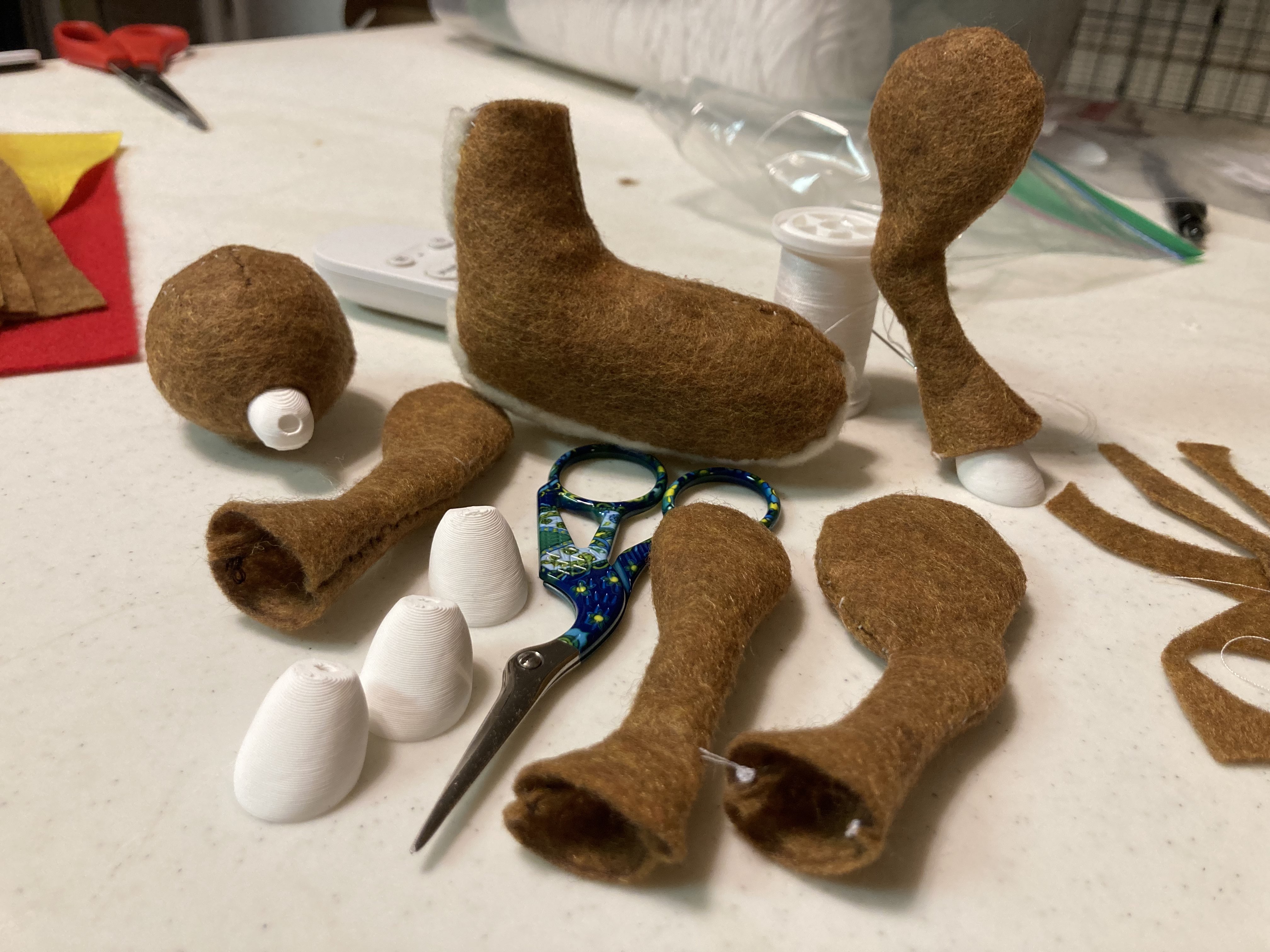

View attachment 1774365View attachment 1774366View attachment 1774367

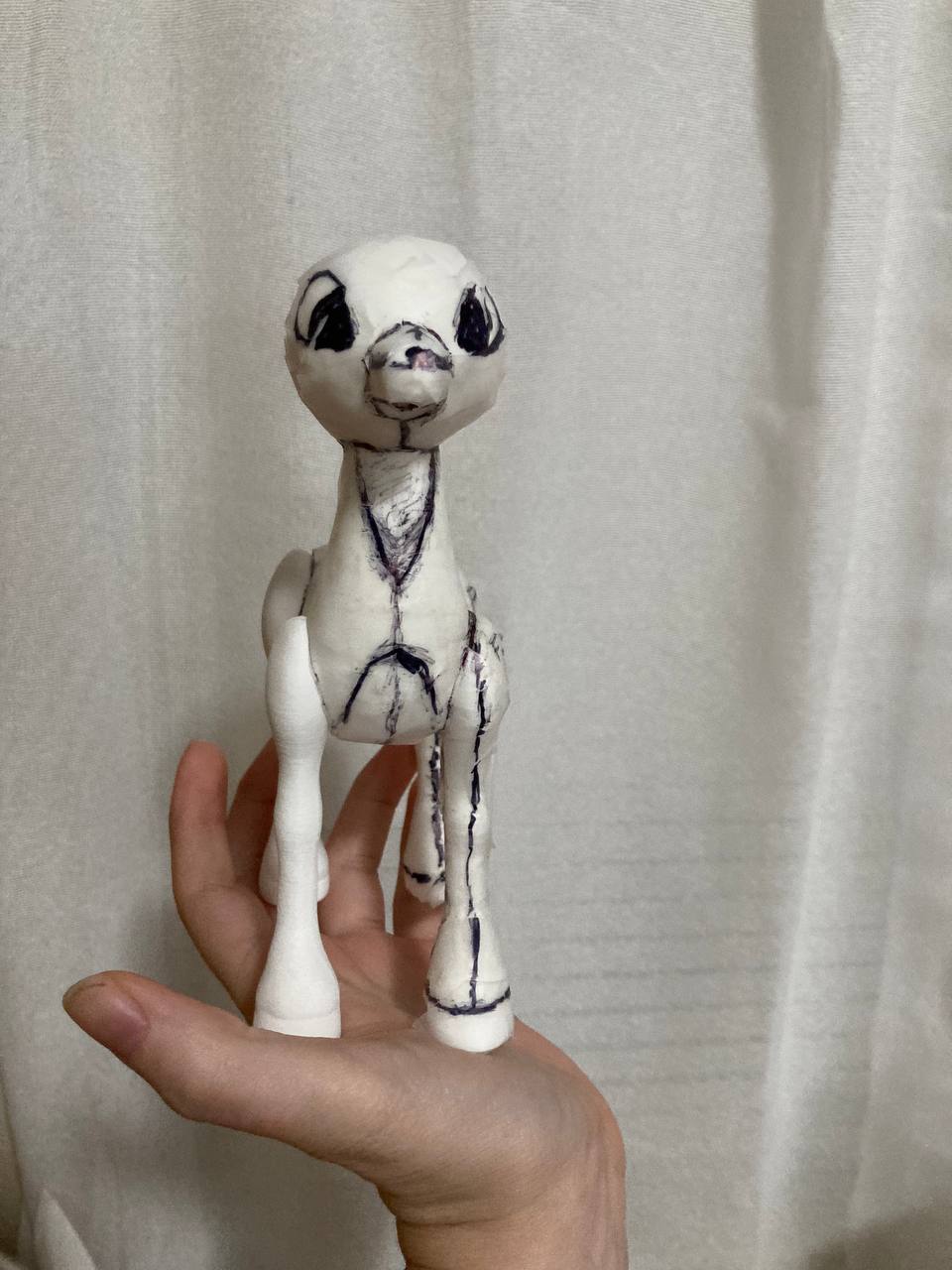

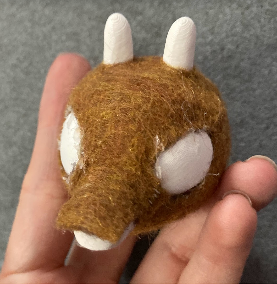

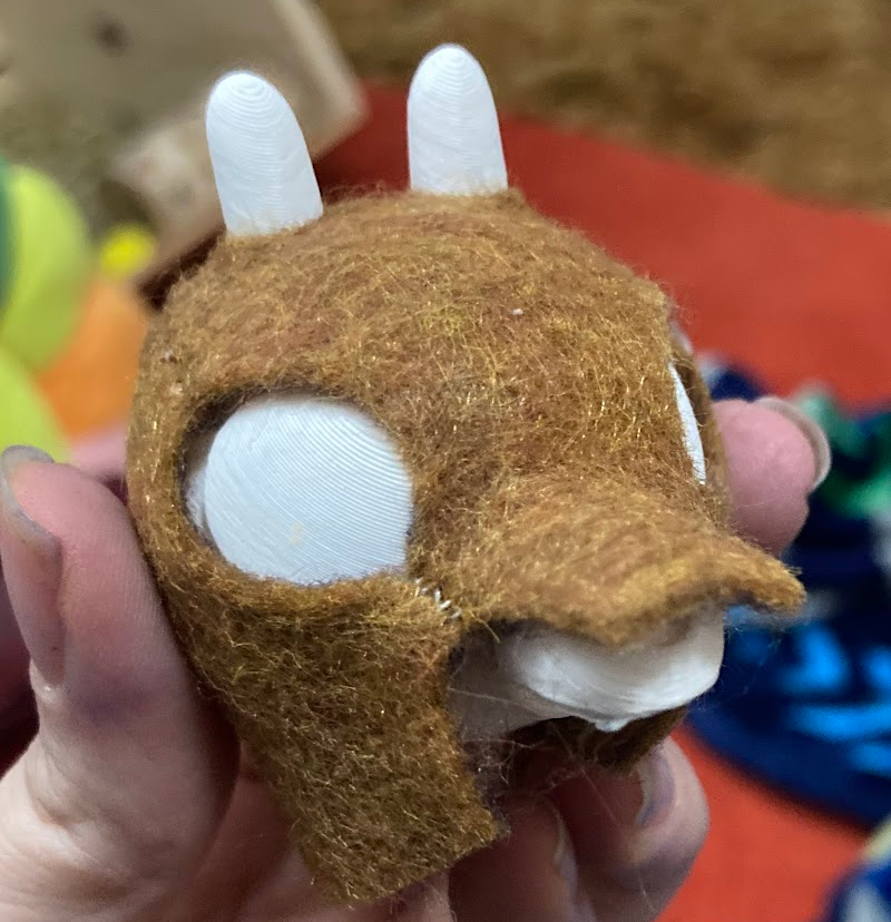

We Def. Need to sink the eye sockets and push the eye out in out new prototype I think Rudy also needs a lil more booty, and the horns should be sculpted into the head as well.

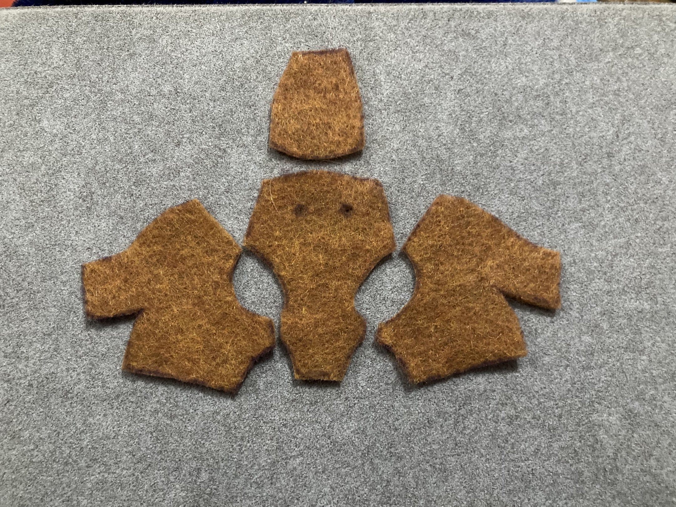

We've been patterning and testing, and while we whipped up a Rudolph, we FINALLY found some awesome references on page 20! With it, I've been able to get a WAY Better idea of how the head patterning works! In hindsight, this is OBVIOUS. This head follows a similar simple pattern as a lot of vintage toys from japan made from felt in the 60s-70s had to begin with. I'm assuming the head follows a pattern that is vaguely something like this (Artistic rendering below, dont try to use the pattern, it wont line up), what I'm unsure about is if the head back piece swings to under the chin, or if the side pieces connect under the chin. I'm guessing the latter as it's one less seam the camera's have to worry about. Though if anyone has a shot of Rudolph or any deer from below, please hmu!
Below is our "Dummy" Rudolph, we worked on today to test the pattern. The pattern needs a LOT of revisions, and simplifications. I come from a plush toy making background, and added a few too many darts and too much seam allowance making his legs too thick.
For anyone interested, the revised head pattern turned out like this:
I need to redo the eye shape and make it have a sharper point as well as puff out even further off of the head.

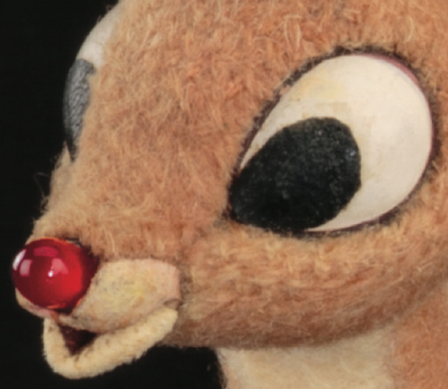

Looking at the photos, Rudolph's eyes are sculpted with his head from wood and painted, the edges of the eyes look to be painted/colored black with a felt tip marker as well! You can just barely see the felt lifting up at the top of his eye. The fur was likely applied on with the same kind of yellowing glue they used to slick Santa's beard after being sewn. (I would guess a craft or tacky glue.?)
The "fur" felt was also applied on top of the leather/vinyl they used for Rudolph's mouth.
Instead of sewing, could they have possibly just used contact cement? That's how a lot of regular puppets are made - fleece to foam using contact cement (Barge).
