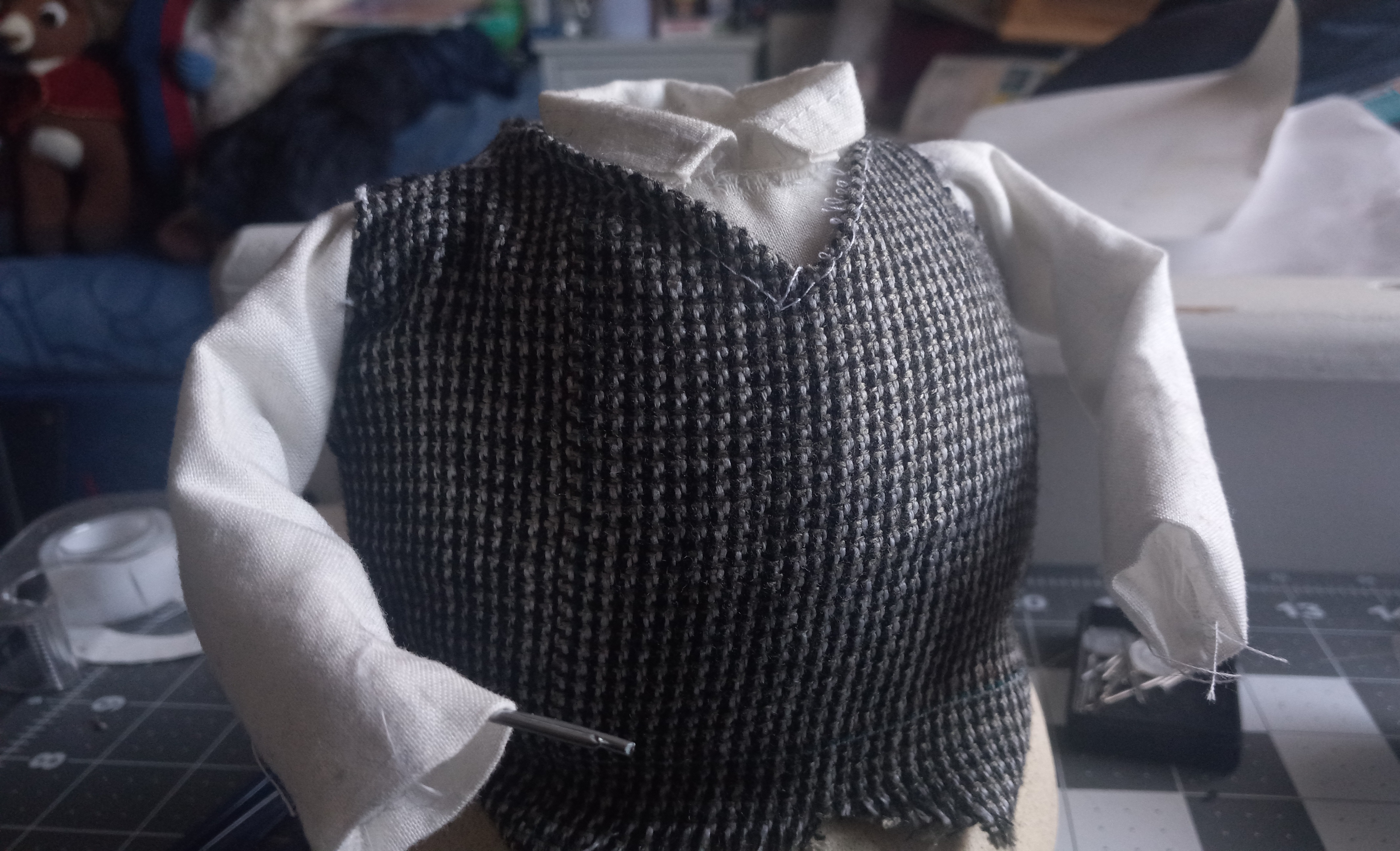

Happy Thanksgiving everyone! I wanted to share some recent progress. I'm off for break so I have had some time to work on Sam and gather some materials for Hermey. Here is what I got done.
I was finally able to work on some more of the clothing of Sam. The vest is made out of an old jacket I got at a thrift store. I'm going to be dyeing the vest green sometime soon. I hope I can figure out embroidery for the vest pattern.

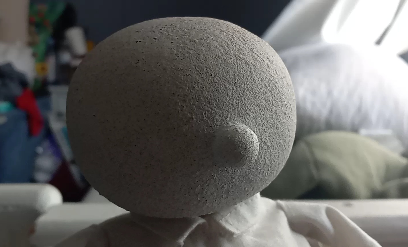

I was able to find a a mix of paints that allow for a nice snow like texture. It's no yet painted white.
I've been trying to get as close to the texture of the puppet as possible. I didn't feel I was able to achieve this well on my last Sam replica. However, this time I think I did a much better job.

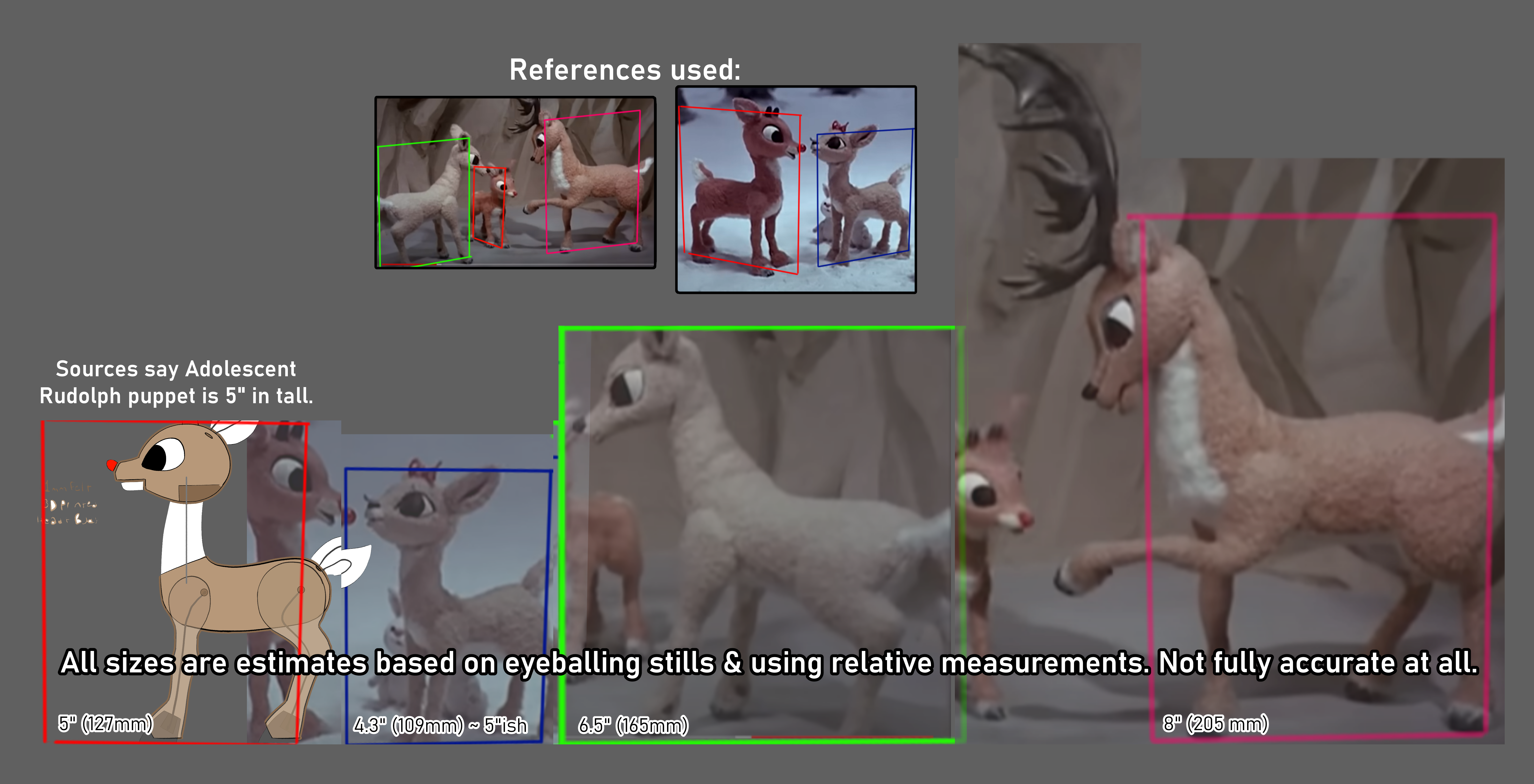

So I've yoinked some screengrabs from the film on youtube and done simple very rough and lazy relative measurements of the characters based on the 5" Rudolph.
The mockup is very crude I'm tired from a long Christmas Day of socializing but also wanna get this jump started so it's a low energy low effort starting point hahaha. Can't be bothered for graphic design for my own silly projects.
Obviously these heights are not particularly accurate since I'm just eyeballing things and know nothing about camera lenses and how they effect the perspective of scenes which impact the way you can measure things.

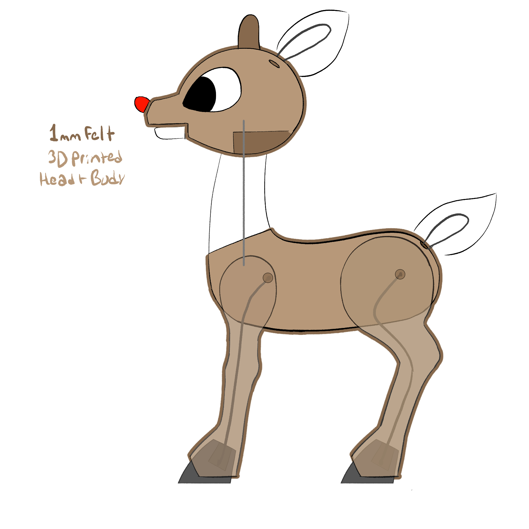

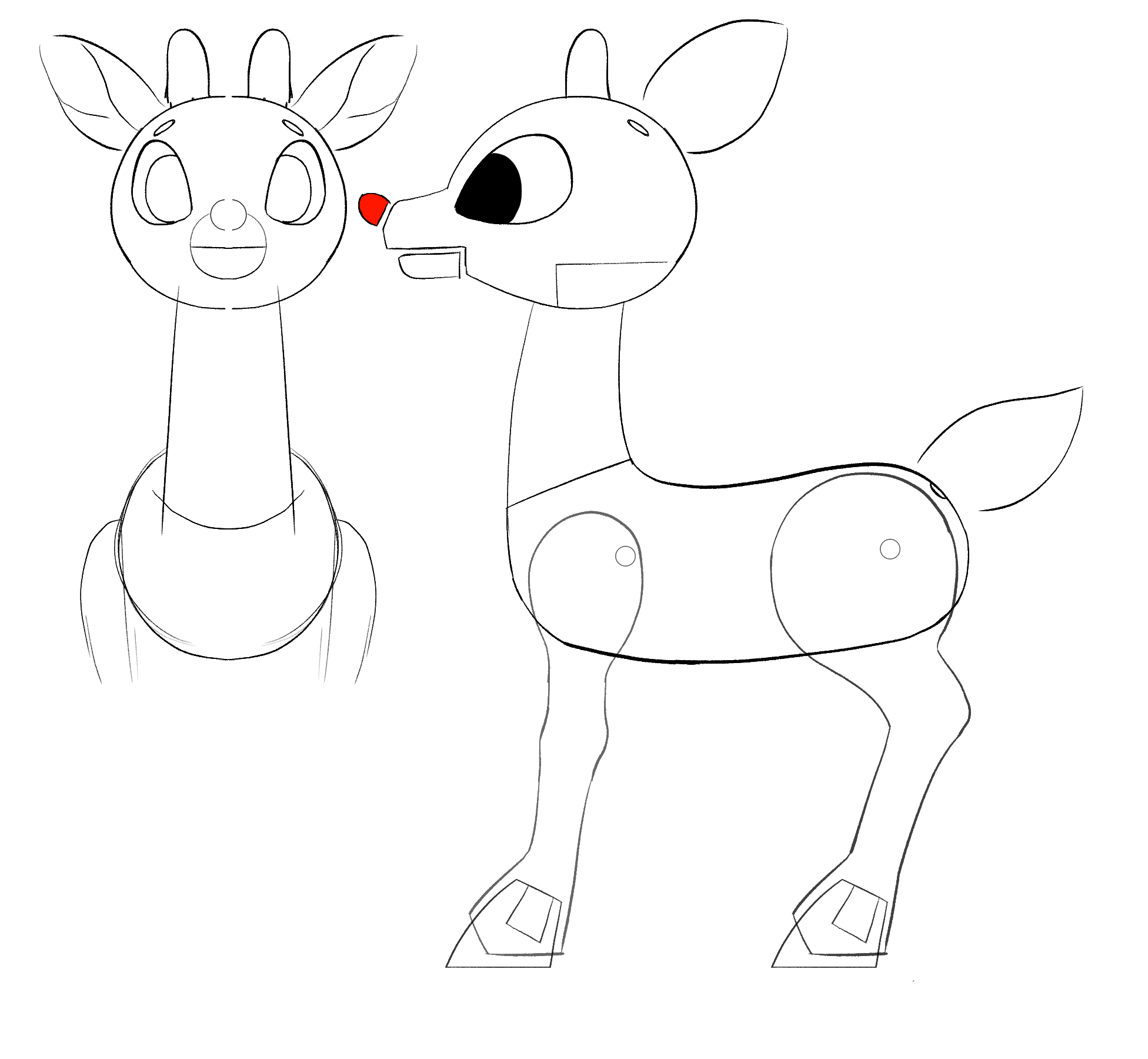

Here's my initial draft plans for making a similar Rudolph Replica.
It's VERY wiggly as I was using my brother's surface pro and I am not at ALL used to handling a surface, I use my Kamvas 13 pro normally.
Based on this photograph of the puppet and the diagram next to it.

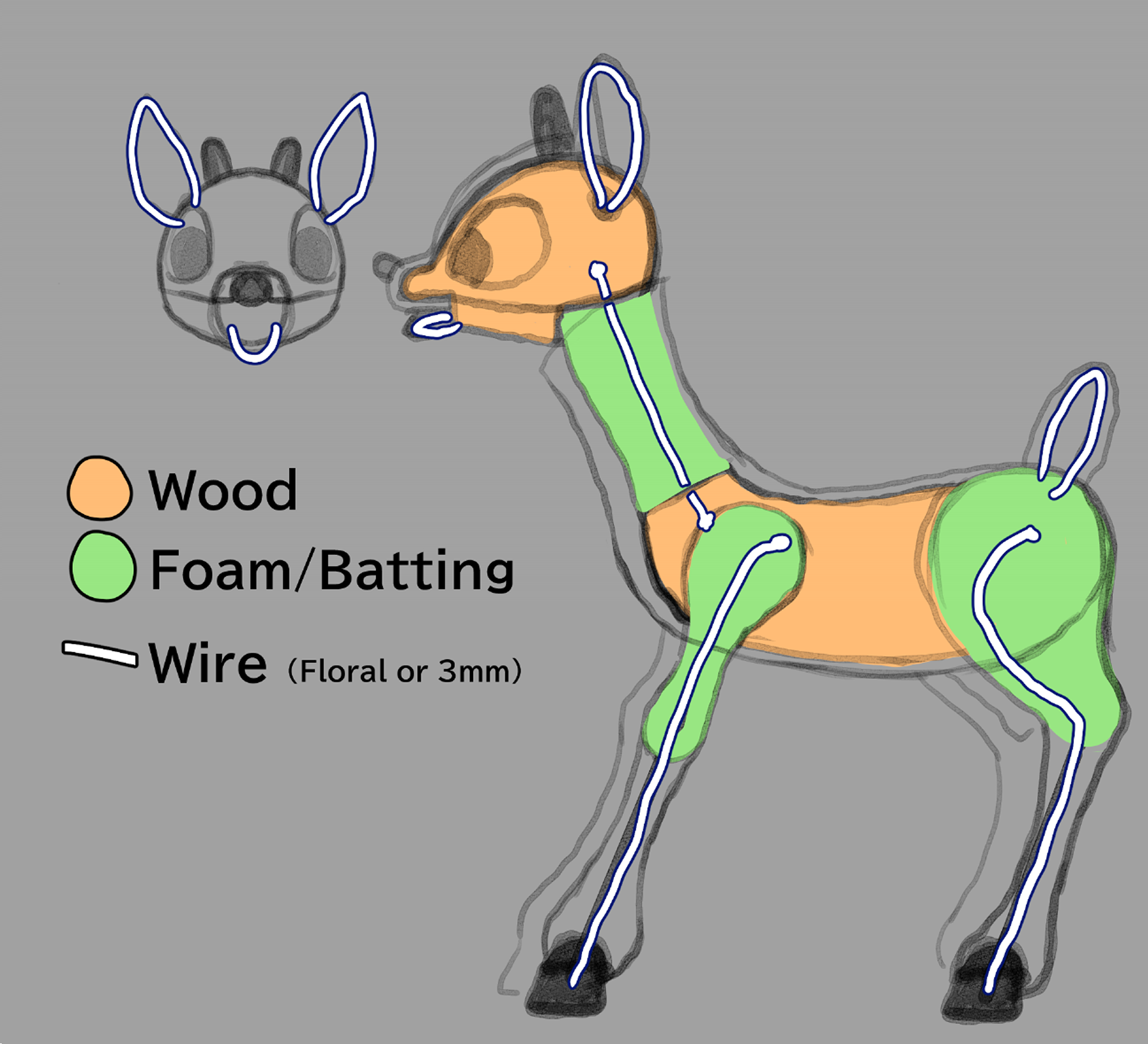

The book that people have mentioned here looks like it says the artists used 3mm wire and another size for the smaller parts like the mouth or so. I just wrote down floral wire as that's what I have on hand for my needle felting projects.
The neck was a type of foam I believe, but batting would probably work well.
The legs, depending on the scale will probably be better and more easily done with batting than foam, in my opinion.
You might not even need to fill them with anything more than a few tufts of polyfil, but that'd depend entirely on the thickness of the felt you use for the fur "skin". I am havign a hard time visualising the actual scale these are at, in my head they always seemed MUCH smaller somehow!
The "Wood" I figured we can 3D print for an easier time, as I do not have any experience with carving wood, and I am an illustrator and 3D artist so. I just would use what I know.
These would be less "Traditional" replicas and more displyable props done efficiently as we'd like to make several different characters and handle them often for fun. That also can make them more accesible since we could share the 3D model file so others can print it to jump start their own builds! :)

My brother refined it based on screengrabs and less on photos of the restored puppet.
I initially thought they had been needle felted, but you can definitely see the tension of sewing thread on the puppets in the film and photos of the restored Rudolph.
We'll be trying to compensate the thickness of 1-2mm felt for the base "wood" parts, and were discussing ways the wire may be attached for a sturdy-ish build.
Like using the wire as S-hooks in the hooves or just glueing it right in like "pinning" a figure.
The originals legs seemed to be quite fragile, and I figure a way to prevent that for fun christmas decoration posing would be to have 1 wire per 2 legs instead of 1 wire per leg.
Running the wire through the "wooden" part of the body. That way no ends really would break or pull out of the body easily.
The legs would mostly just be sewn, no 3D printing of a base form needed. And it'd likely be a pretty simple pattern to sew.

What's tricky is that there were different scale puppets. For instance, when Rudolph and Hermy are in shot with Cornelius, they are smaller than the puppets used when they have their own two-shots or closeups. And even smaller ones when anyone is seen alongside Bumble.
Oh yeaaaah. I forgot about the shots with Bumble. I was focusing on the closeups since that's where I could see more of the details, especially from a youtube upload haha.
Guess I won't worry too much about super accurate sizes since I only want to make a set based on the 5" Rudolph puppet.
I'll just stick with my "close enough" estimates and leave it at that then! :>

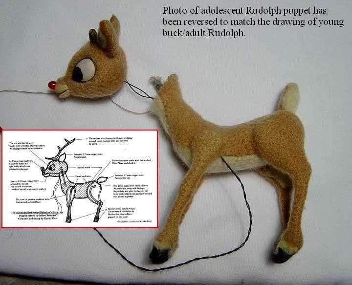

Well we know that there are actually two Rudolph puppets for the main age we see him in. Someone by the name SpyrofoamKyle pointed this out in 2020 on the thread.
Here's a side by side comparison of the two they shared. The one that is seen on the right is in scenes like the misfit song, the reindeer games, and there's always tomorrow. The one on the left is used in scenes like trying on the fake nose, meeting Yukon Cornelius, Rudolph strikes out on his own. (This might not be entirely right as I'm trying to remember off the top of my head. I might look back at it later.
The one on the left is the one I decided to base my replica off of. It's important to know the difference between the two so your reference is of one instead of the other. Otherwise it may get confusing. I think that's why the Rudolph that was restored looks a bit off. They used reference photos of the Rudolph seen on the right when the puppet they had was the one on the left.
Since we know that the Rudolph that was restored is on the left, we know the hight of that one. 6 inches.
We can use this to help us determine the height of the other puppets.
I thought it was determined recently that the found/restored/displayed puppets turned out to be not screen used, that they were for publicity stills. I don't have a reference though.
Anyway, yeah I think the one on the right would be larger, due to the scaling thing I talked about. When he's with his parents, Santa, the Coach, etc, they would need a smaller puppet than in a shot all by himself or with Hermy.
