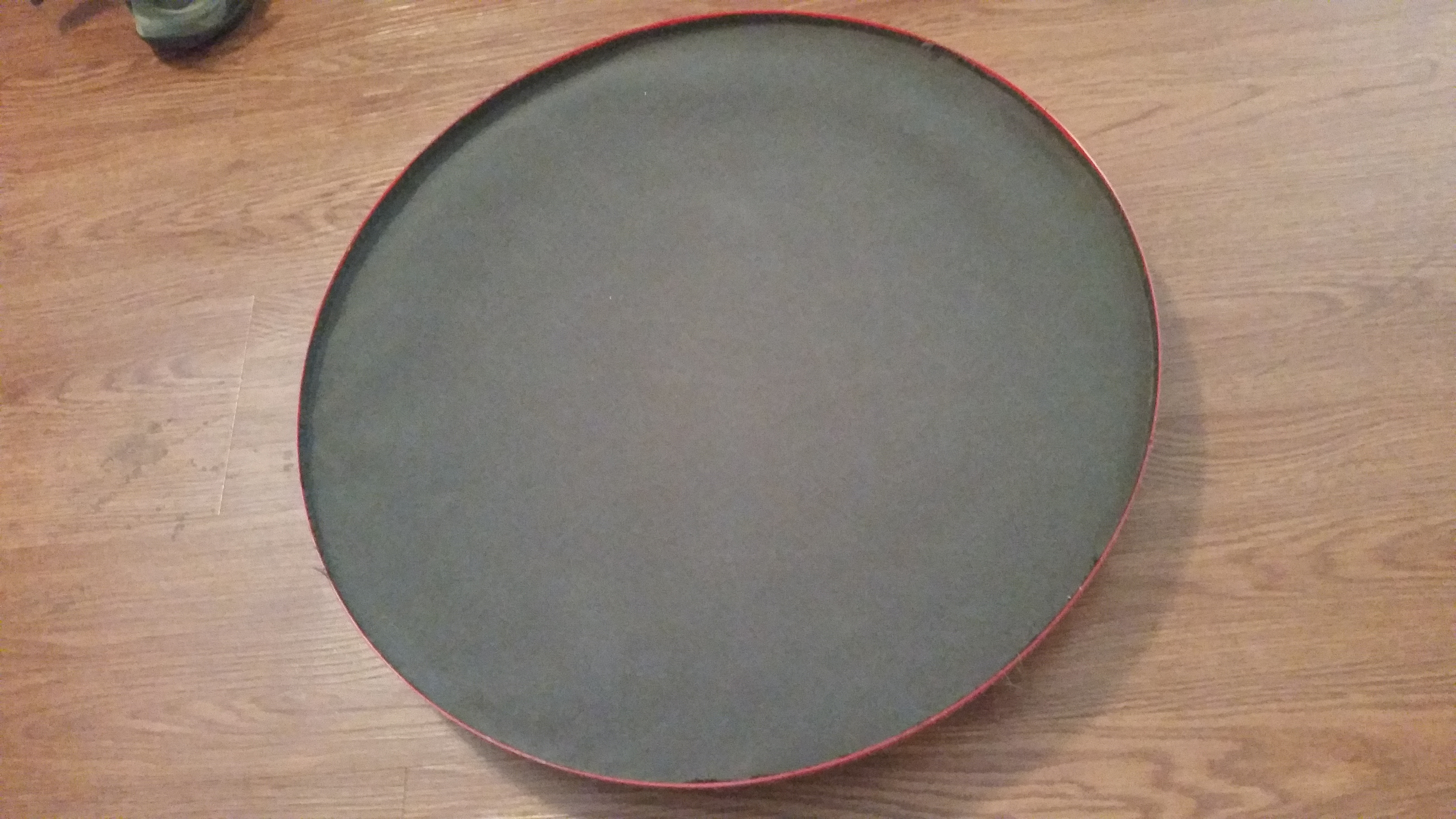

The back of the shield has a polyester fabric layer glued into the rim, with a foam insert inside between it and the plastic. I'm not super worried about being screen accurate on the back side so I'm just leaving it there. I think it probably looks cleaner like that than if it were removed anyway.

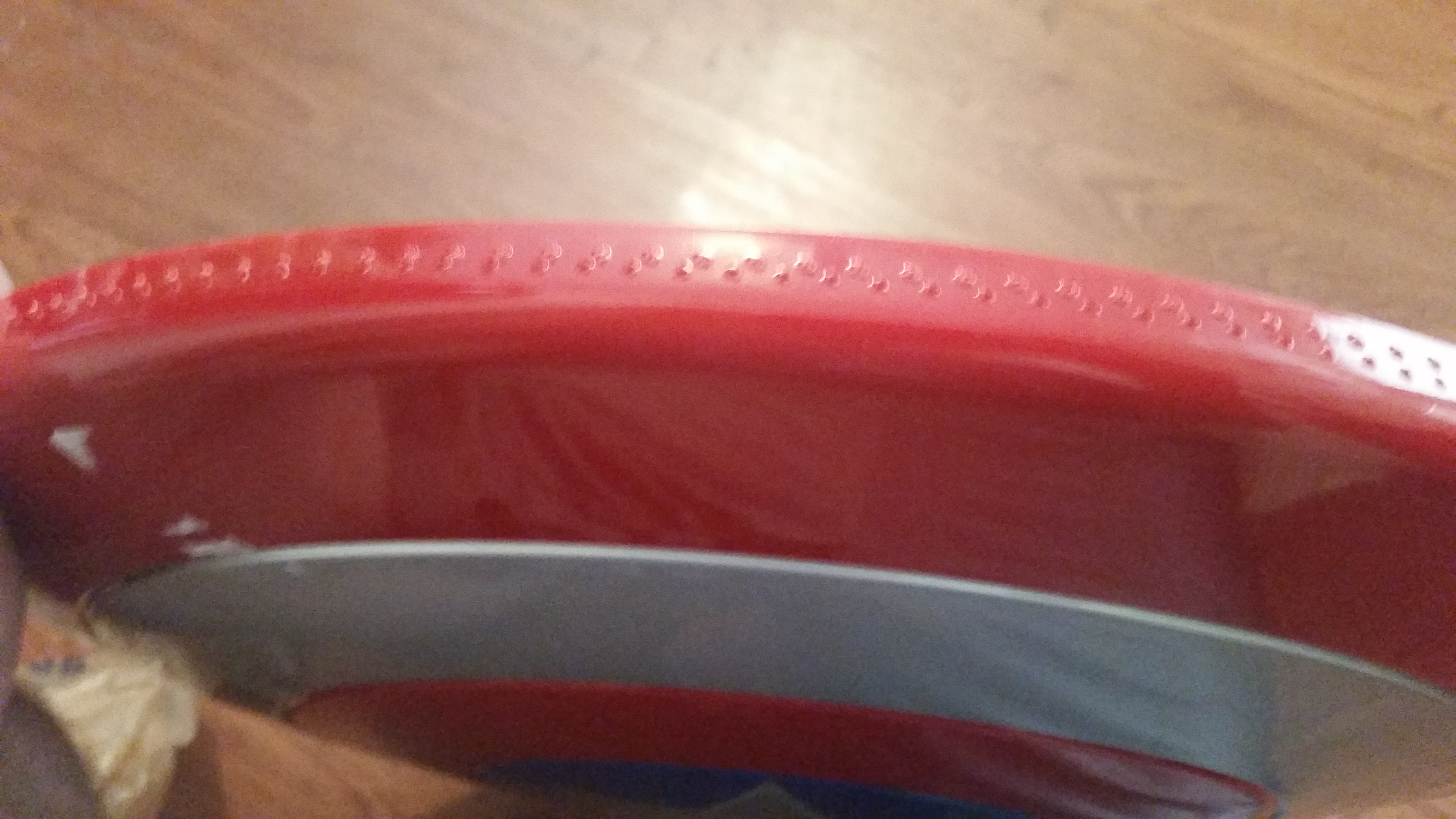

The main problem with this one is that the sewing during production has left small holes in the outer rim of the plastic (which quite frankly, is impressive. Industrial sewing machines must be absolute mechanical beasts in order to punch through that thing). Each hole is raised due to how the needle must have gone through, which makes the outer rim look and feel rough/bumpy.

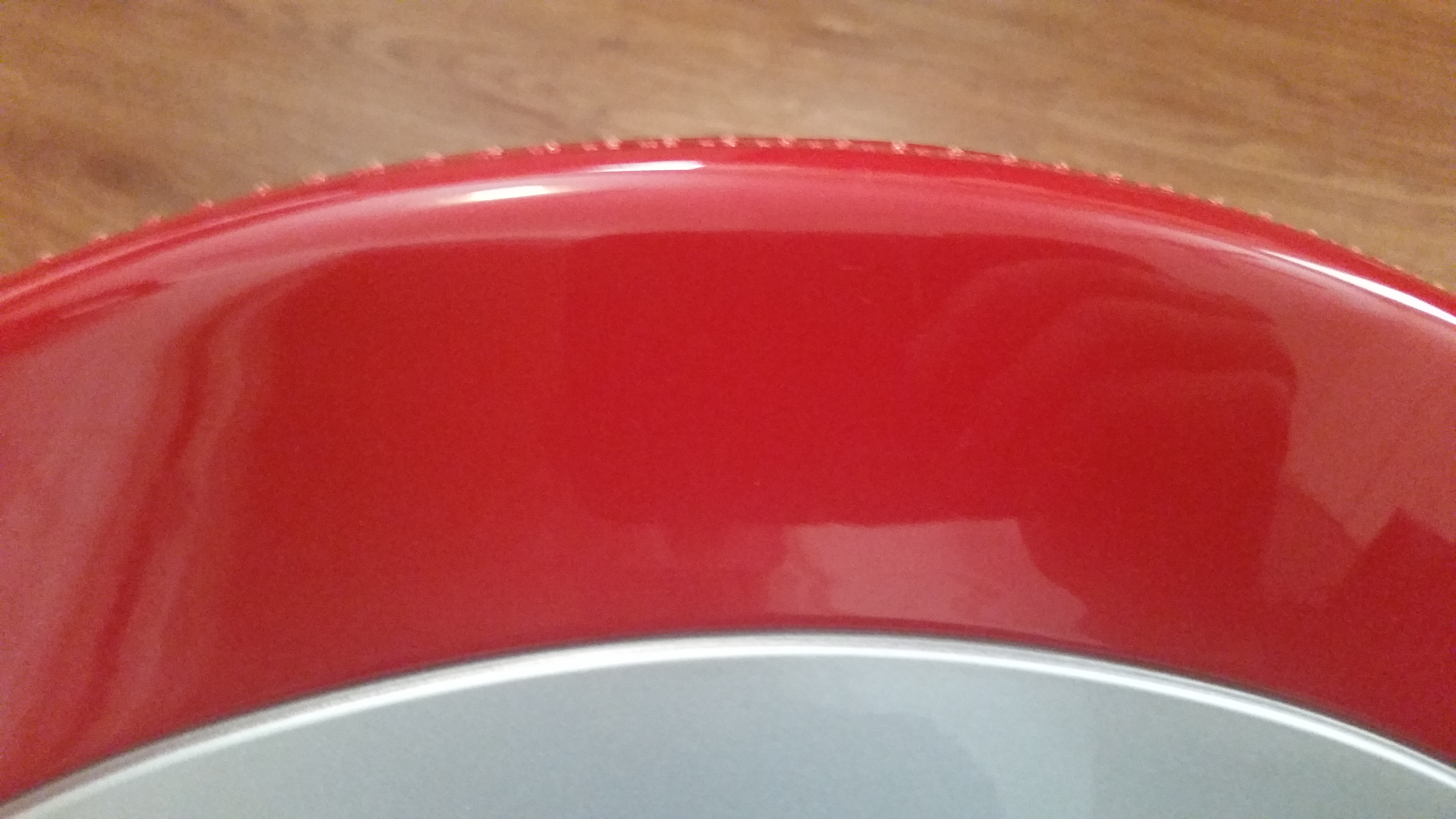

To solve this you can just sand it down. The plastic seems to be red all the way through so discoloration isn't much of an issue. I started with 150 grit and went all the way up to wet-sanding with 600 grit.
The result is very nice, smooth, and even. The rim may have a bit of a different finish now, more satin/matte than the rest, but you'll barely even be able to notice it. As you can see in this pic, it's visually still a bit polka-dotted from those holes though. It is at this point that a perfectionist may want to consider doing some body work and repainting, or trimming the rim off completely, etc. I don't think it's a big deal though and I'm fine with just leaving it as is

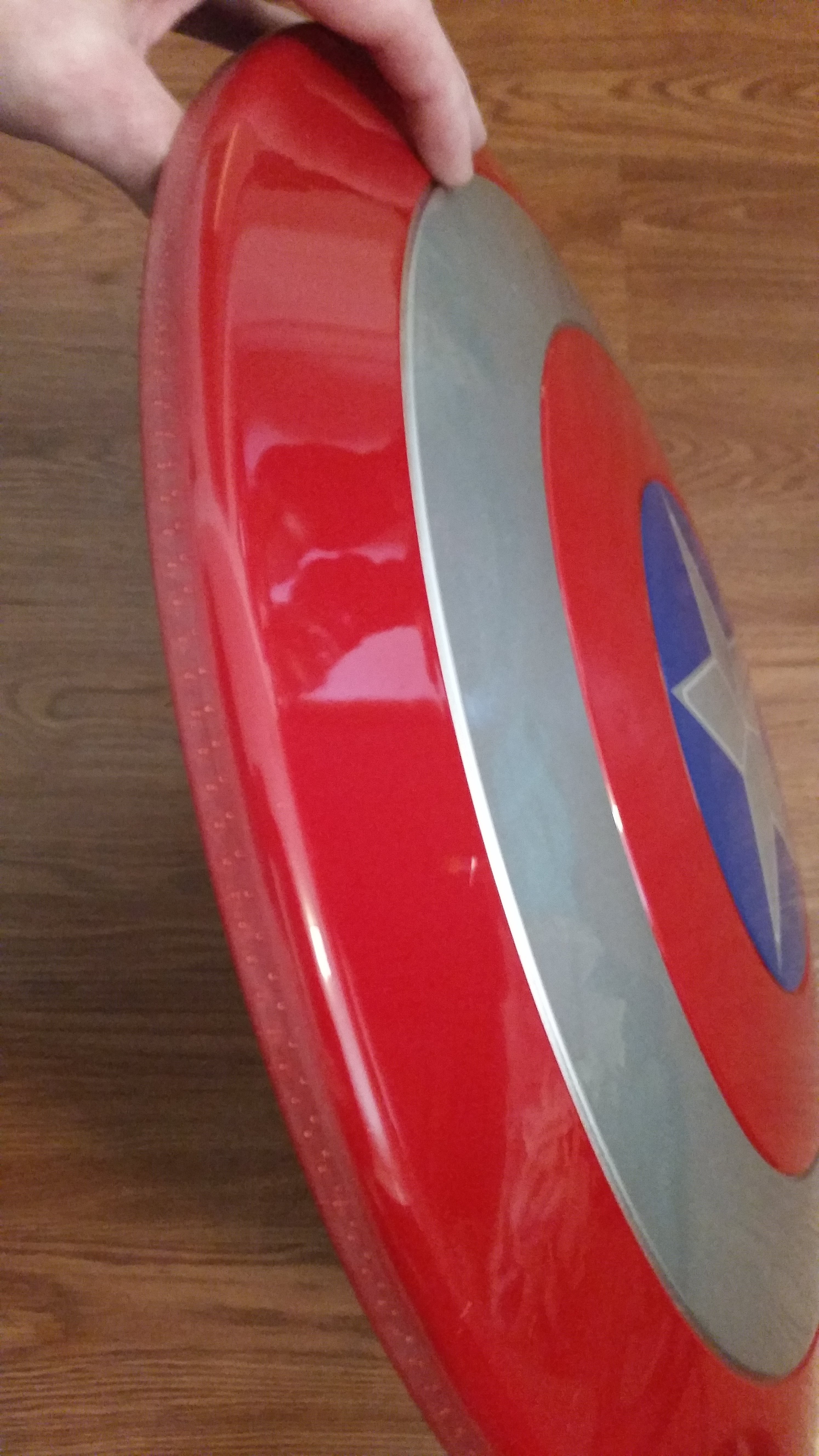

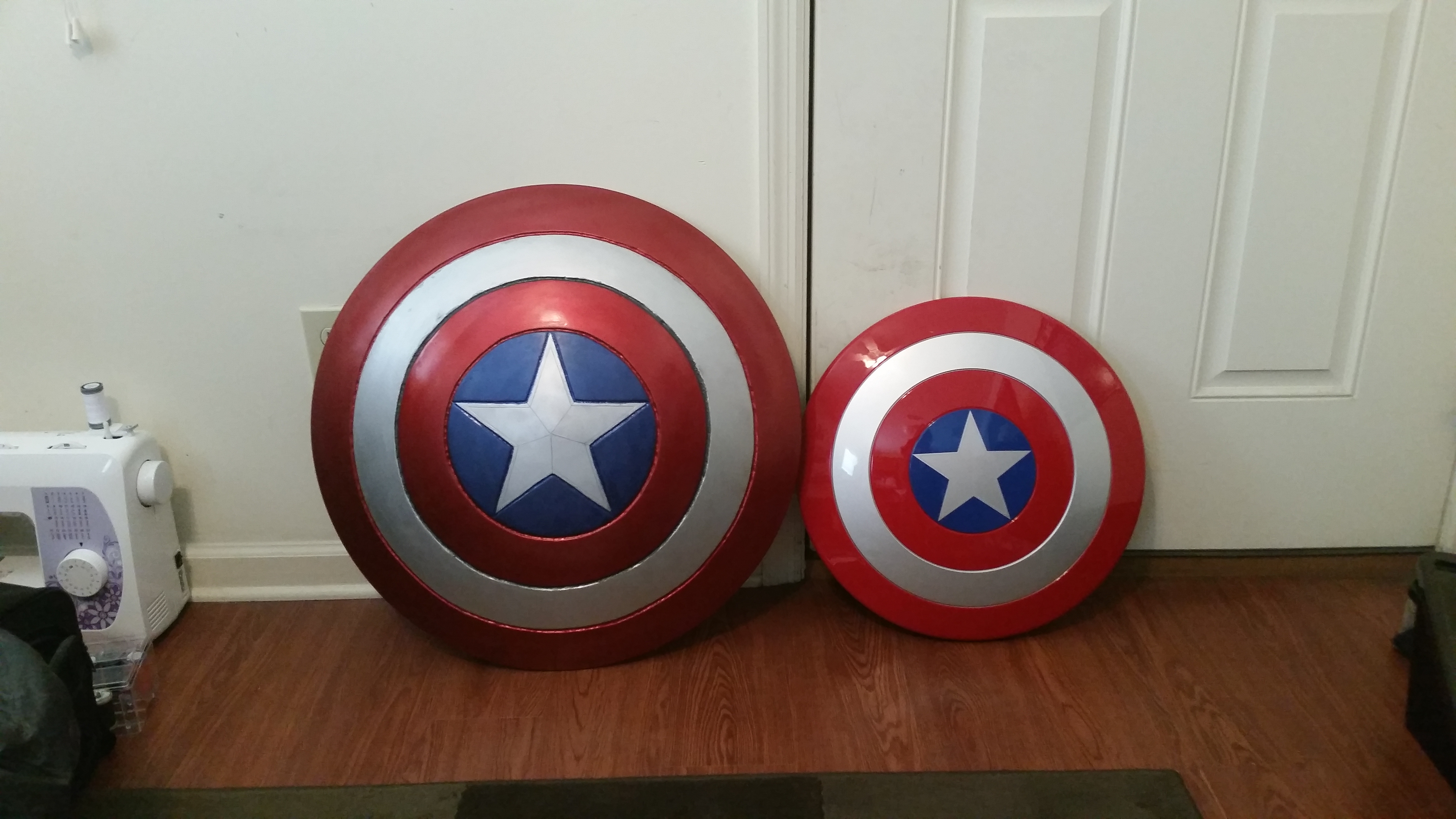

After spraying it with some Goo Gone to get off leftover adhesive residue from multiple previous price stickers, and giving it a good soapy wash, it's looking pretty great. I'll update again when I figure out how I'm going to do the arm straps on the back; I'm waiting to start that step until my suit comes in the mail so I can see what the harness is like and how I want to attach the shield to it. For comparison, here's a picture of it next to my (very slightly battle damaged) 25" MH saucer sled shield:
I think the paintjob on this one is awesome, it lacks a "spun metal" look but has a high-gloss finish . The silver is very metallic, the blue and red have a small hint of metallic in them. The shades of the colors are the same that you find on most standard MCU cap merchandise; I painted my sled shield in somewhat dark/muted shades to fit in with the on-screen aesthetic of Age of Ultron and Civil War, but as you can tell this one's a little more vibrant. However, in the right lighting the colors do look nice and deep.
