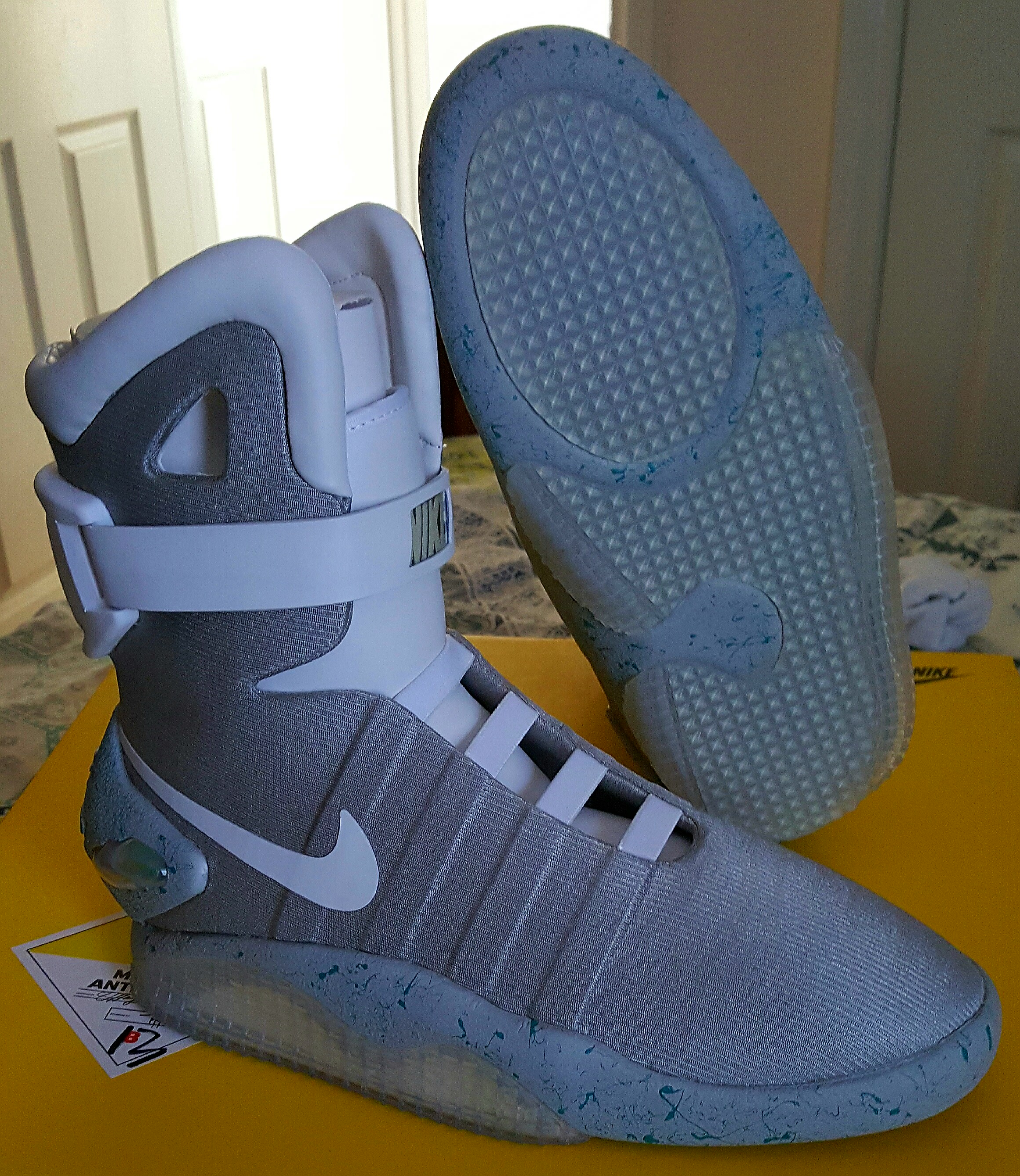

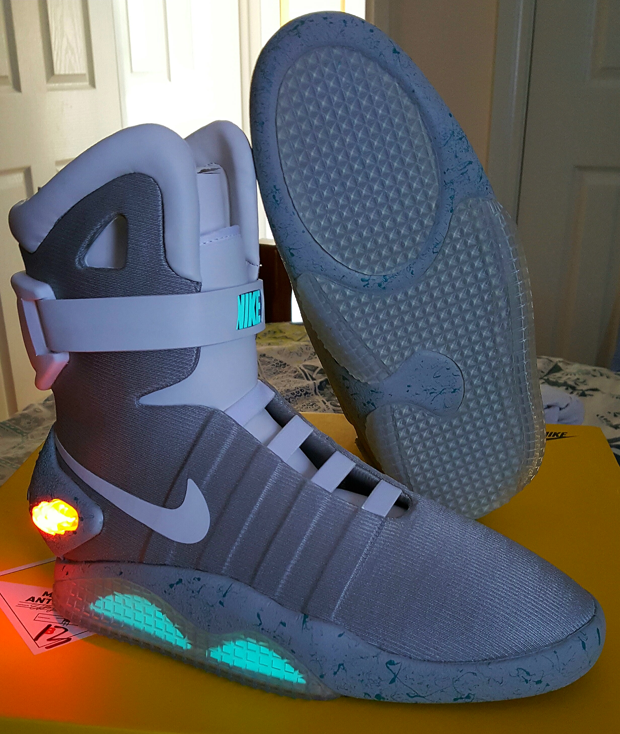

For those who prefer the clear sole look, I gave my V3s a hit with seaglow today. They came out super clear. I'm very pleased with the results :cool
View attachment 689513View attachment 689514
This does look really cool, but I can see the original cross sectional colour along the edge of the outrigger. How long does that last? It has to be quicker and easier tore-do this than make new clear soles like I am currently doing.
With some Jordans I've done this with previously it will usually hold its clear look for up to a few months before it starts to yellow again. But when that happens you can of course give them another coat of seaglow. It will also depend on how your shoes are either stored or worn i.e. UV, if you get the soles wet etc. Its best to do it before the get too yellow otherwise you need to do continual coats of seaglow to penetrate the soles adequately

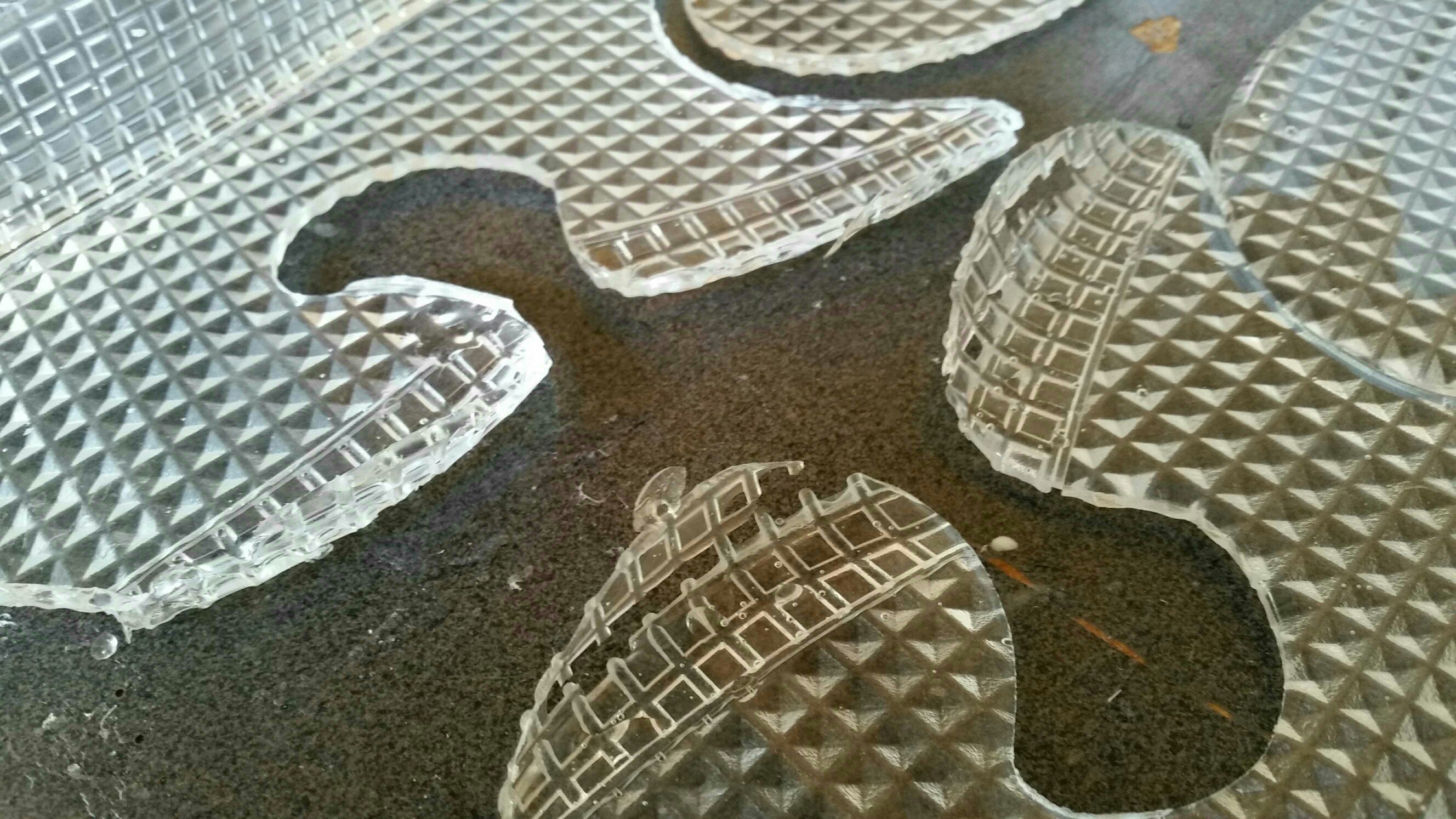

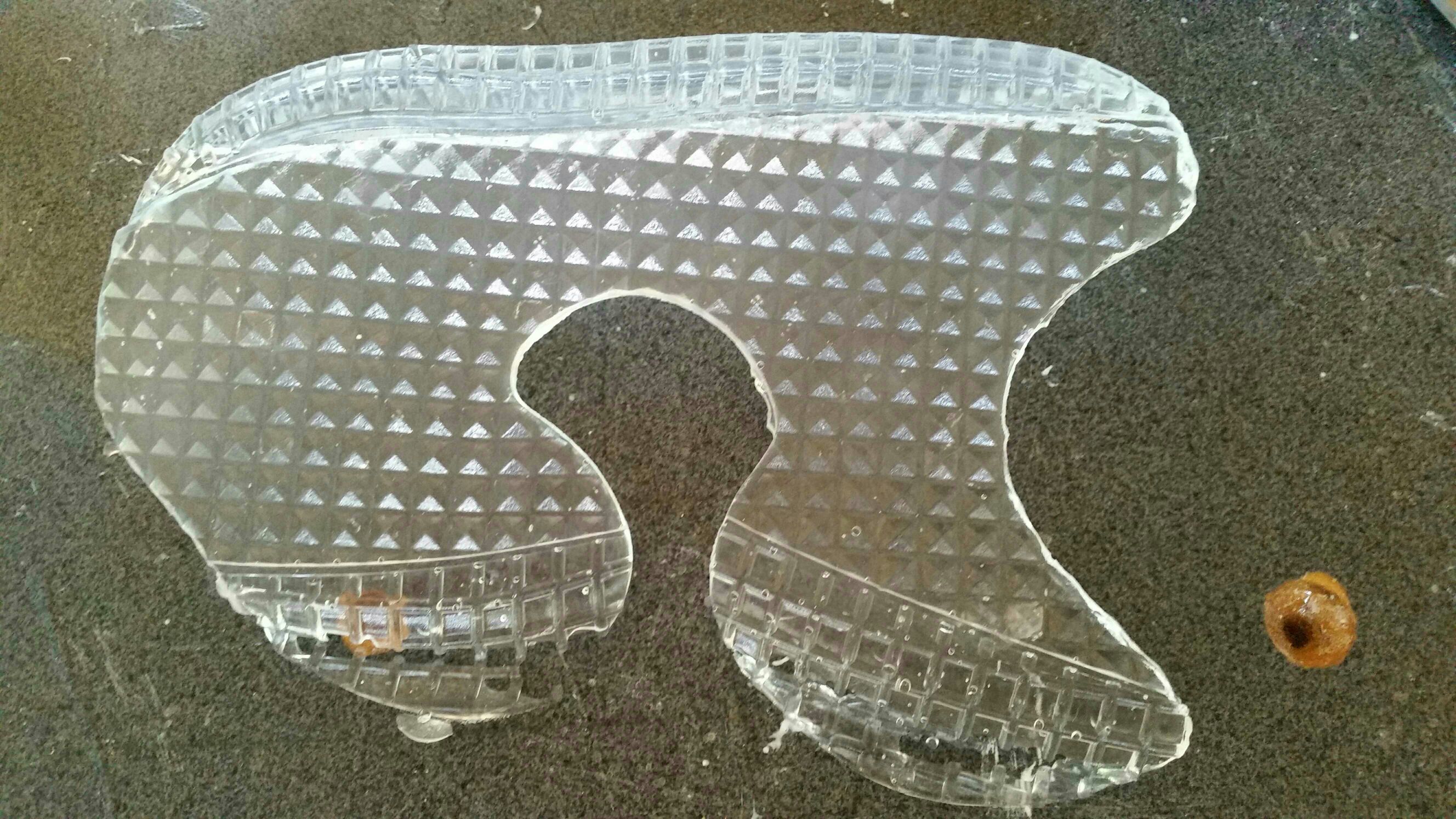

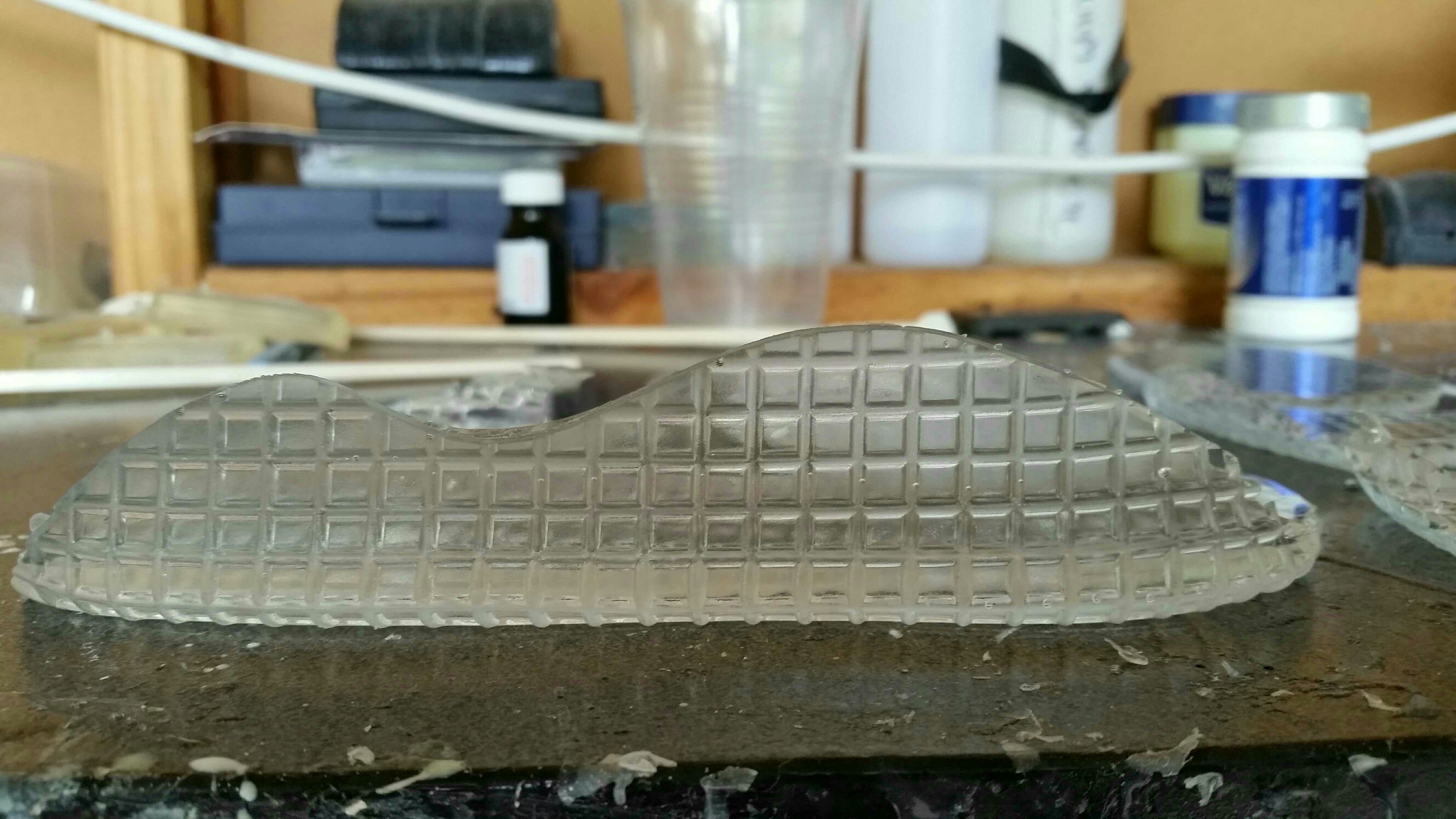

I am not sure how many more times I need to say this. The yellowing of the rubber is ALL THE WAY THROUGH THE CROSS SECTION. It is not progressive by layers because it is transparent and light can reach the CORE. It is progressive by the way it darkens - IE, the more exposure, the darker it gets, but the whole thing darkens, not just the outside.
The rubber on the V2s was not clear to begin with. I found the product at my supplier and it is called TRANS-AMBER meaning "translucent amber" rubber. It has the same A65 Shore hardness as the clear PU I use on my soles. The difference is, this stuff bends without breaking. The PU is flexible, but has limits before it breaks. The ONLY WAY to make it look clear is to add blue pigment to it and hope it comes blue and not greenish. Getting an icy-blue is not easy. You also need a separate UV stabilizer which is also AMBER in colour.
I am not sure what the V3 rubber is yet, but I am sure I will find a similar product soon.

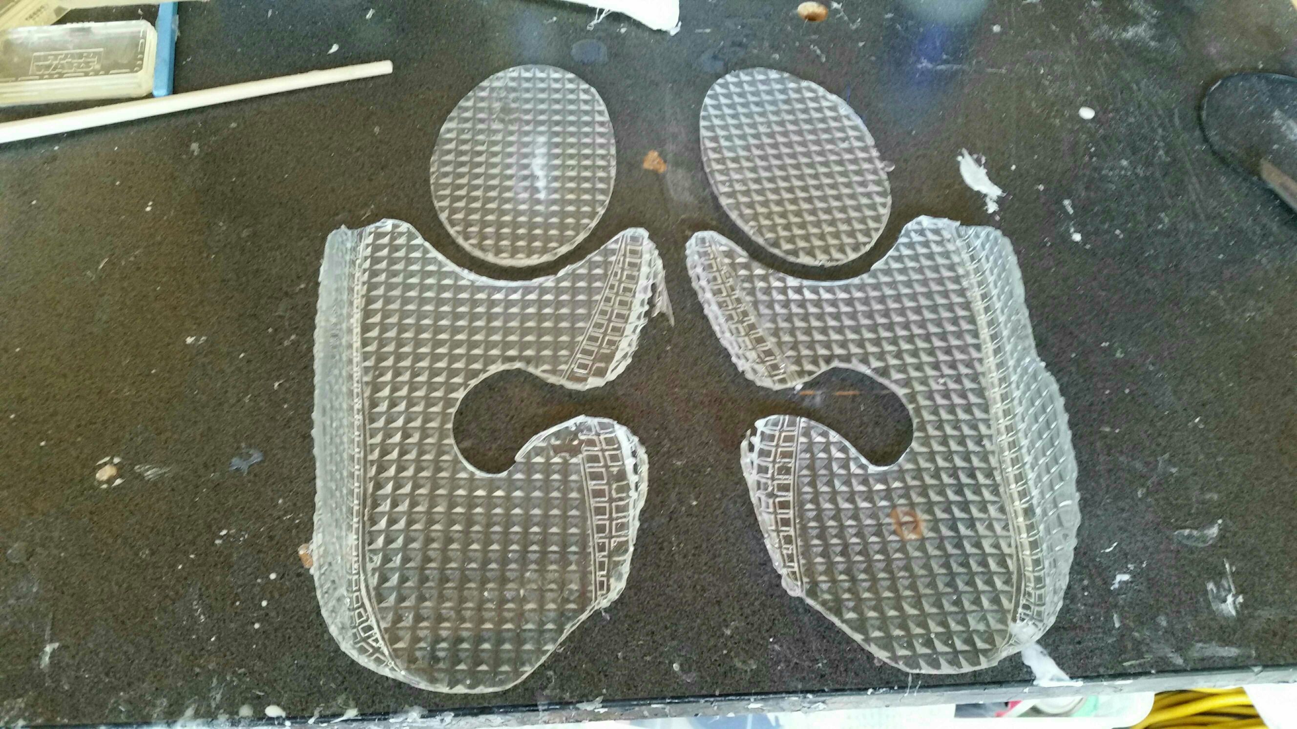

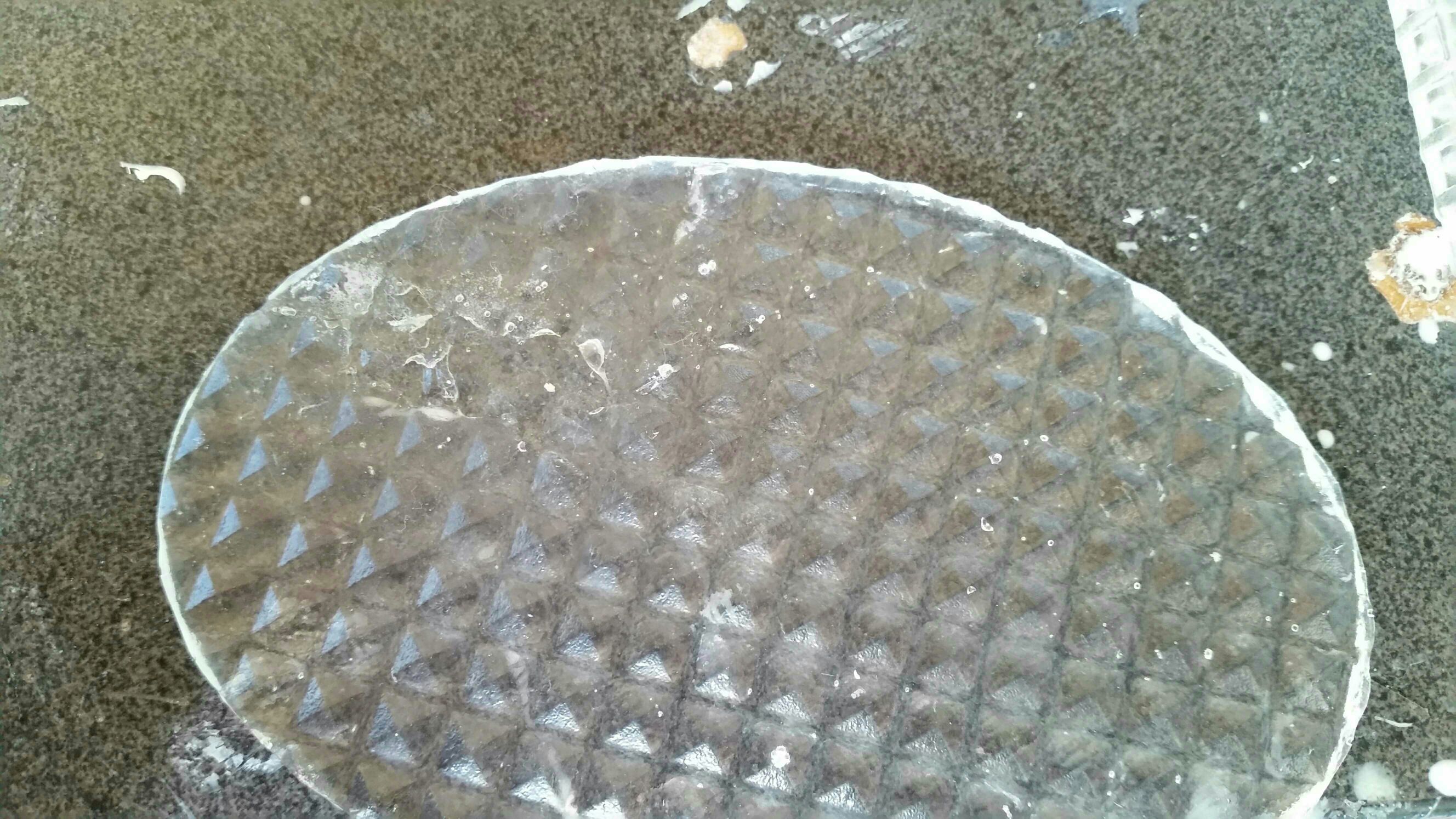

Anyway, I probably demolded this too early, but it would seem that I need to make a new pair of molds. I will have to buy Type F cat for the silicone.
Some of the parts did not form 100%.
There appears to have been a contamination as well.
If at first you don't succeed....
Sent from my SM-G900I using Tapatalk
On a good note, looking at all the parts I have made, I do have an almost perfect pair of outer wings. I have 1 set of perfect inner wings and the pyramid tread is the same size as the pyramid mat I used last time. I have enough mat to make all the tread parts. So all I really need is that 2nd set of inner wings.

Not a bad first try!
Maybe you'd be better off doing what you did with the second round of V2 soles and making them in parts rather than one big segment?

Yeah making them in parts would be easier but if I can work out what I need to do, I should be able to pour as a single part with the same clarity of the parts I did for the V2.
