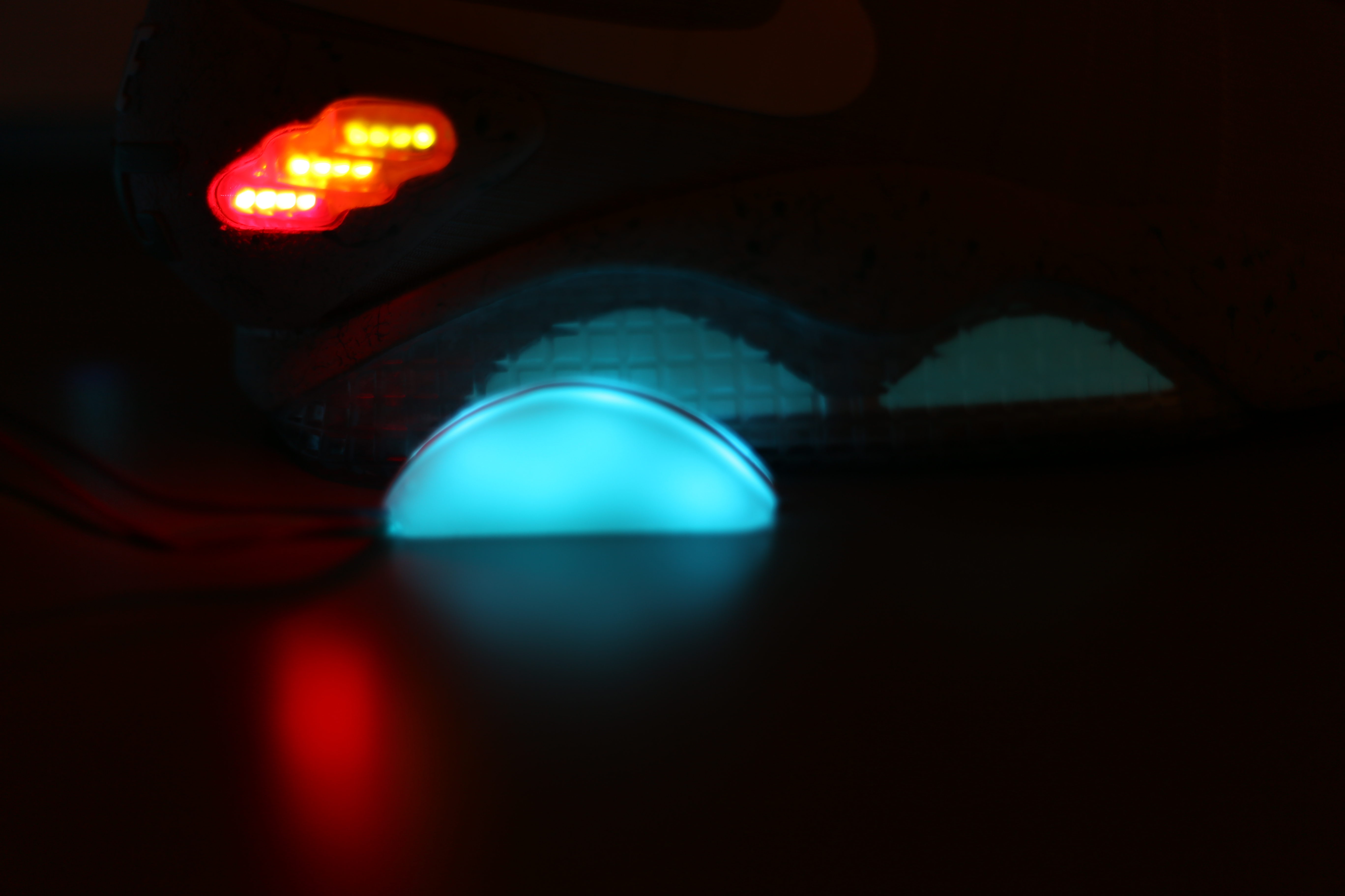

@WizardBTTF - One of the benefits from the side mounting of this product might be affecting the intensity of the light.
Here is the discussion I offered Wizard yesterday. The light tunnel material is pretty shocking in how well it transmits light despite curves and bends in the tube.
There is an acrylic maker with a product that can be edge-lit and diffuses throughout. I will probably get some to fiddle with in the future. I considered that "light tunnel" material which were 2 mm thick tubes could carry the light from 5 mm RGBs located elsewhere. This is the acrylic:

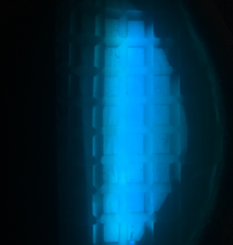

Tried a side lit cast just to see, this was side lit with only 6 SMD LEDS. Still a few hot spots that annoy me, this was just regular casting resin with some white pigment added. The hot spots look worse in the photos then in person since I turned the camera iso really low to capture them. I think with a few more tests I'll be able to get it as even/smooth as an EL panel.

I'd probably suggest an SMD size like 5050 RGB, I am just using normal 5050 RGB leds for the domes, They have a wider view angle then most 3mm-5mm leds so they diffuse more over the same distance too. This isn't the same seller but its the same basic type I like to use, ebay item number: 122177307114 (I like the epistar brand more, but can't remember exactly where I get them off the top of my head)

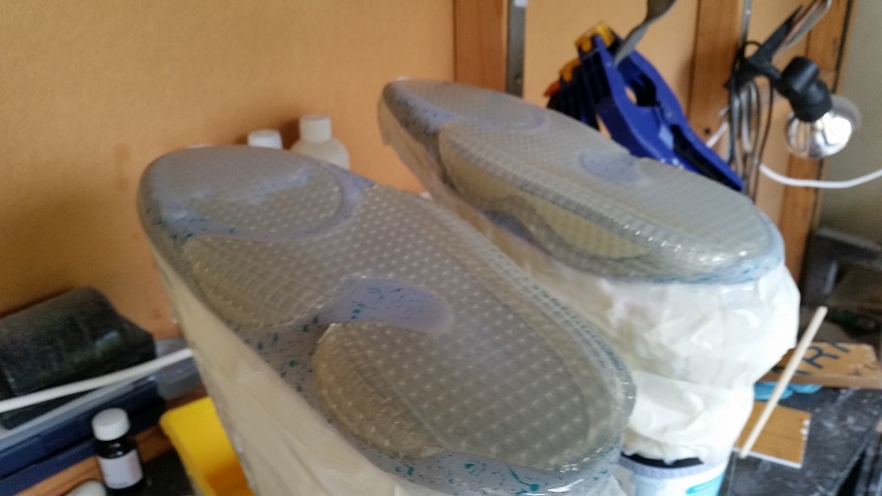

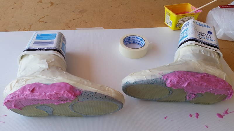

I have made a start on my new clears for the V3. Rather than pull the shoe apart, I am going to be molding this as a glove and jacket system, slush cast a master parts and then make official molds after I am happy with the casts in D65 plastic. That way I can wear my shoes in the meantime. Yes I am learning.

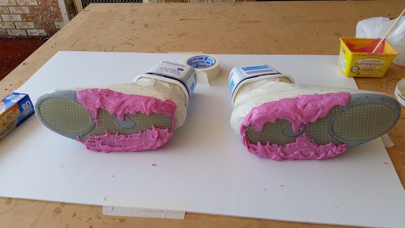

I started with a product normally used for lifecasts called Pinysil OddBod. This is semi gel state product designed to cling to vertical surfaces. It can capture great detail, but because it was so dam hot today (37C) and this stuff's pot life is too short to degas, so it can trap air and I also had to mix it is smaller batches and could cover the shoe in one go.

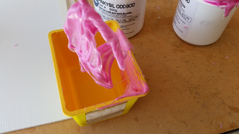

If you mix your silicone properly, the left overs should just peel out of the mix pot when it is cured. The same goes for the parts where it should just peel off like a skin.

As you can see from this close up, air bubbles. So I am rejecting these molds.
attachment.php
2nd attempt using the good stuff.
attachment.php
attachment.php
This is Vario-40. This stuff has a really long potfife (again shortened by the heat of today) but still long enough to degas. Unlike the OddBod which wants to glug out, the Vario is quite thin and pours in a thin stream. If a bubble is created by over pour (pouring over itself), it will generally rise and pop on its own with this stuff and why I love it so much. It self levels and has a shore of A40 vs OddBods A25.

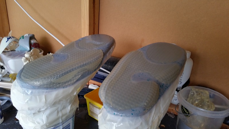

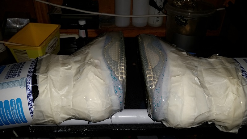

What I have done here is to make a complete "print coat" (only 100g per shoe). This will take a few hours to set up, so I won't be able to do any more on them until tomorrow. Tomorrow, I mix up more and I simply pour layers until I get about 1/4 thick on the base, then I turn the shoes on their sides. I can add the next layer every 20min, so should be able to knock these out by tomorrow after noon. Notice no bubbles on the print coat. This means the final mold will be perfect. YAY!

Checked the silicone and it is already set up, so I decided to mix up 50g and pour it over the side parts to help thicken them up. It is now 9PM here, so no more until tomorrow.

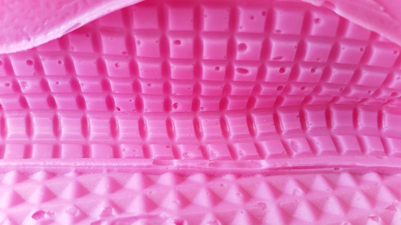

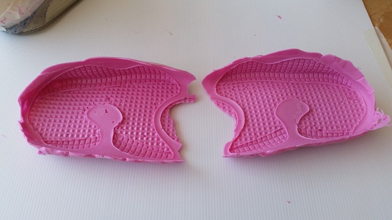

http://www.therpf.com/attachment.php?attachmentid=688469&d=1481010204
http://www.therpf.com/attachment.php?attachmentid=688470&d=1481010204
http://www.therpf.com/attachment.php?attachmentid=688471&d=1481010204

The bottom part of your panels are brighter then the top. This is what I meant by hot spots, as in the whole part isn't 100% lit evenly like the EL panels are. Not hating on yah man, I said yours looks good. I am guessing you have the neopixel bar tilted back to give it more of back glow? It looks good, wasn't trying to be confrontational man. And I appreciate you offering me your material, nothing against you bro I just like figuring things out on my own. :thumbsup
