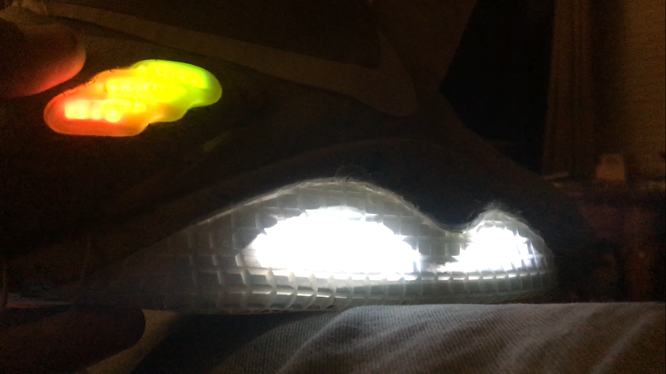

Way too bright will be drawing it back a bit to prolong battery life. Still a really early test, but really shows how easily LEDS can outshine the EL panels.
Excellent work mate. Looks like you've diffused it nicely! What did you end up using, or is it a secret recipe? :-D

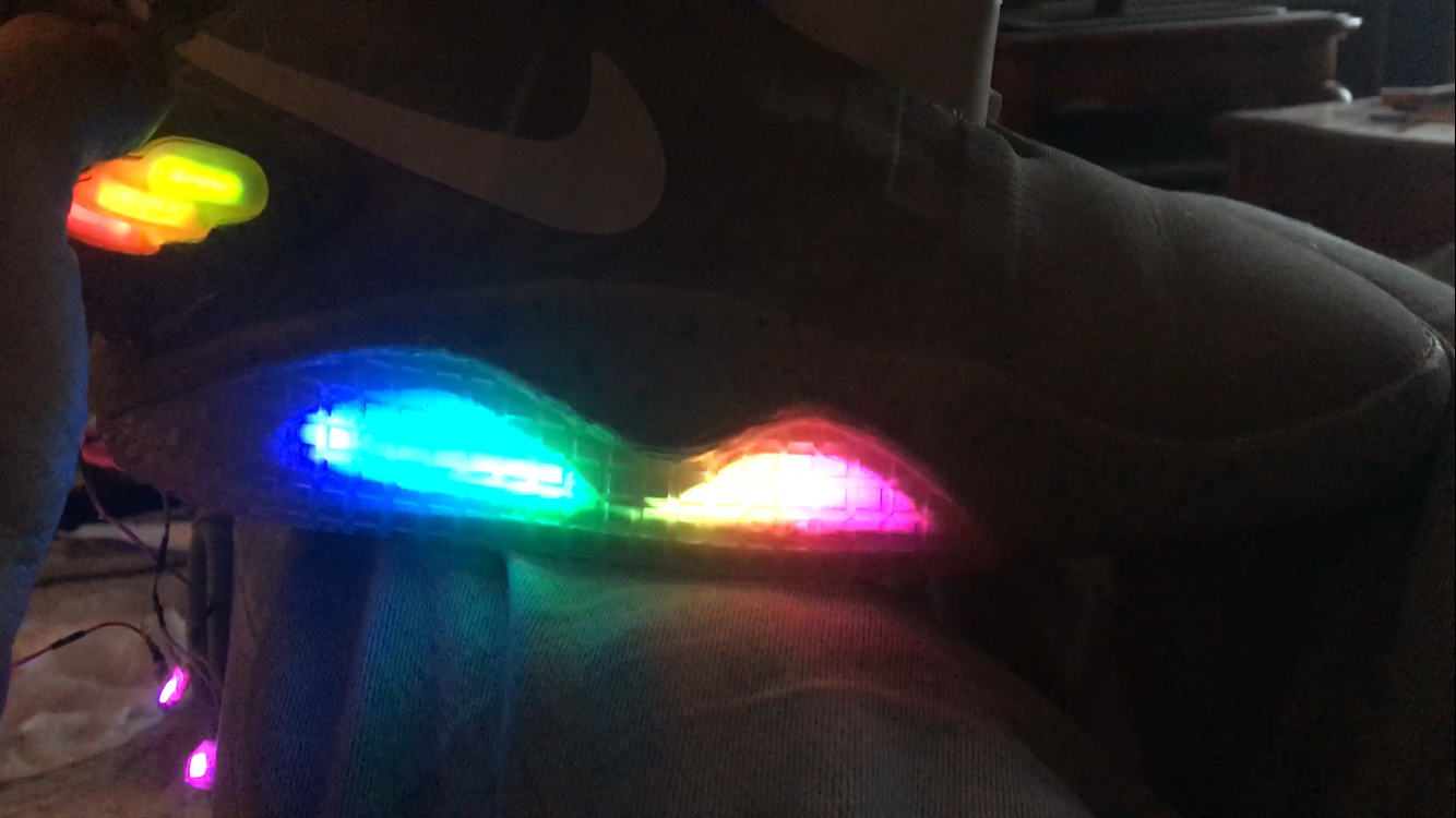

The game has changed guys. Think of me as your doc brown. And I'll take you to the future.
Perfect colors.

Strap controls. Led strobe if you want in bubble or color change in sole.

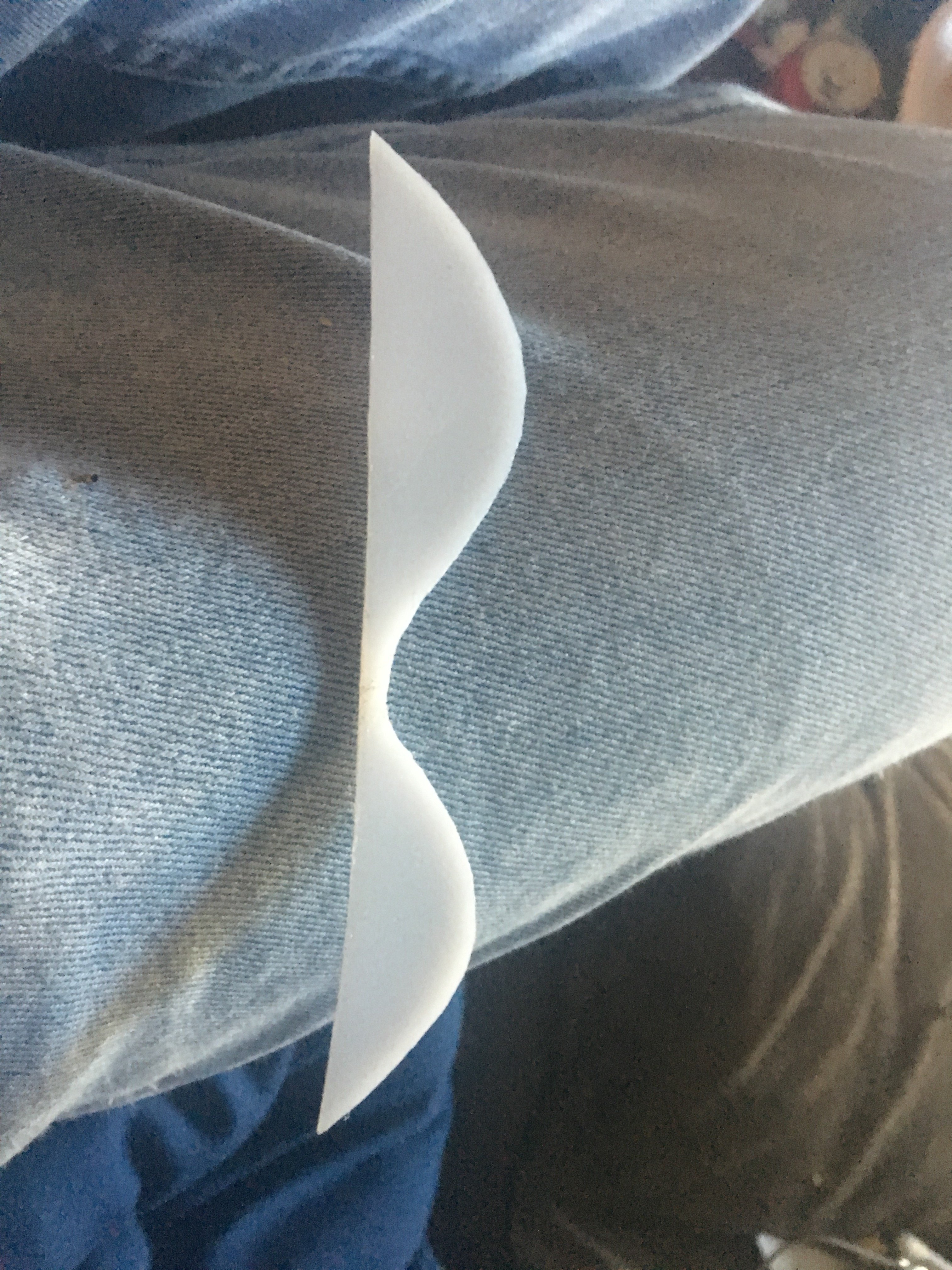

What exactly is that made of and how to you have the LEDs positioned so that it defuses then equally through the panel?
Looks like a piece of white/milky semi-transparent thin plastic, then a 8x neopixel stick behind it. Something like this will have hot spots, but it does overall look pretty clean.
