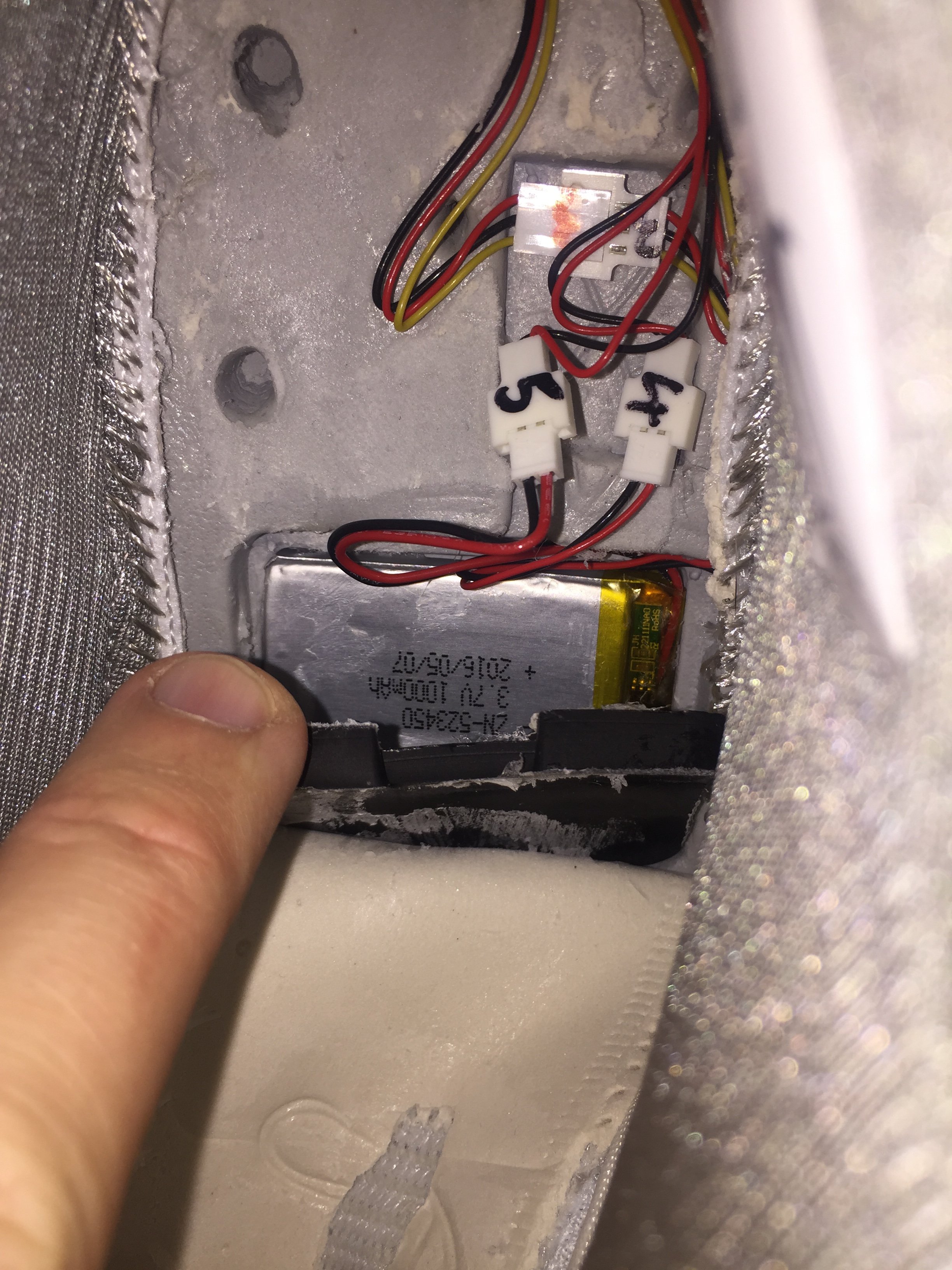

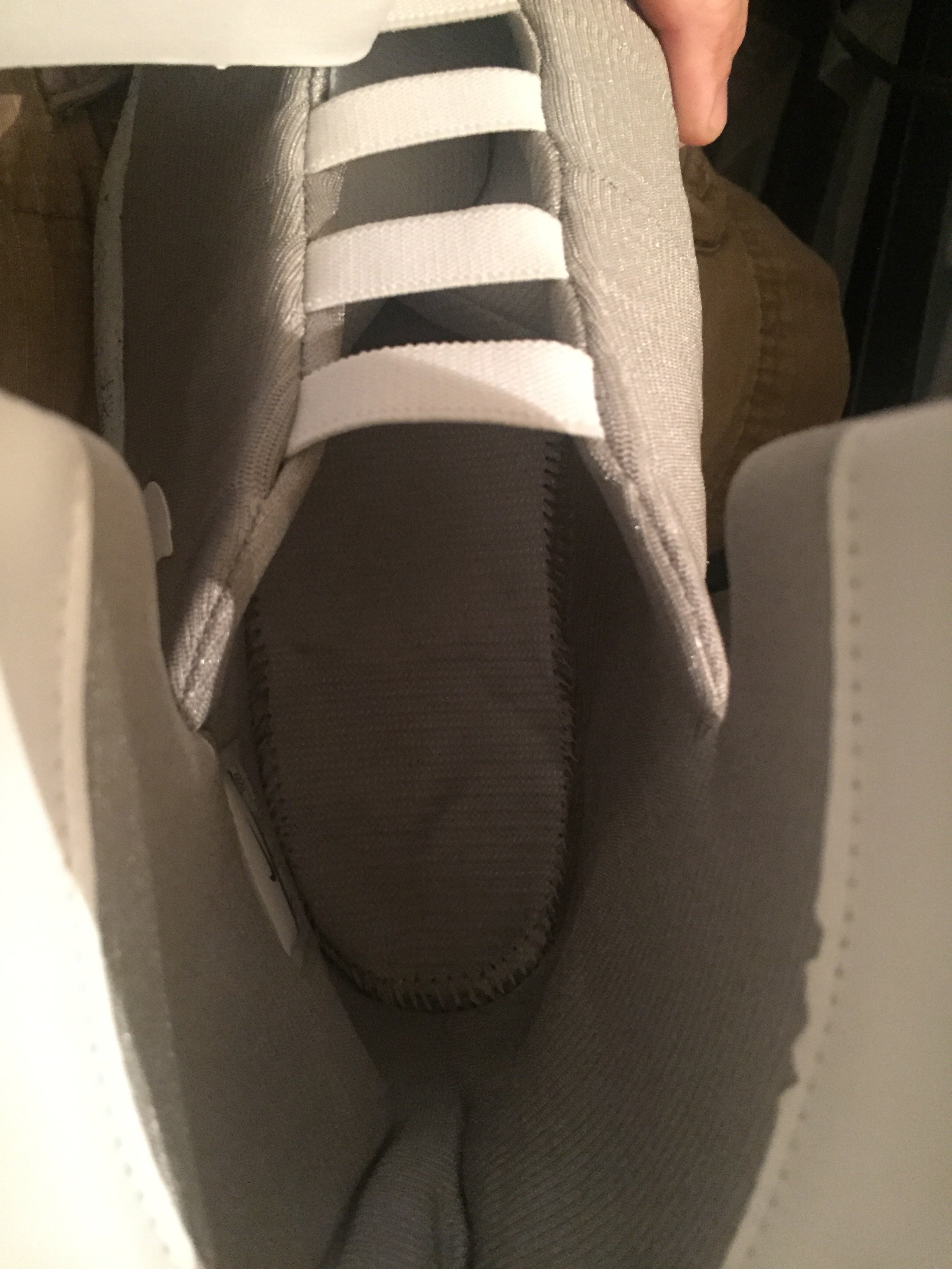

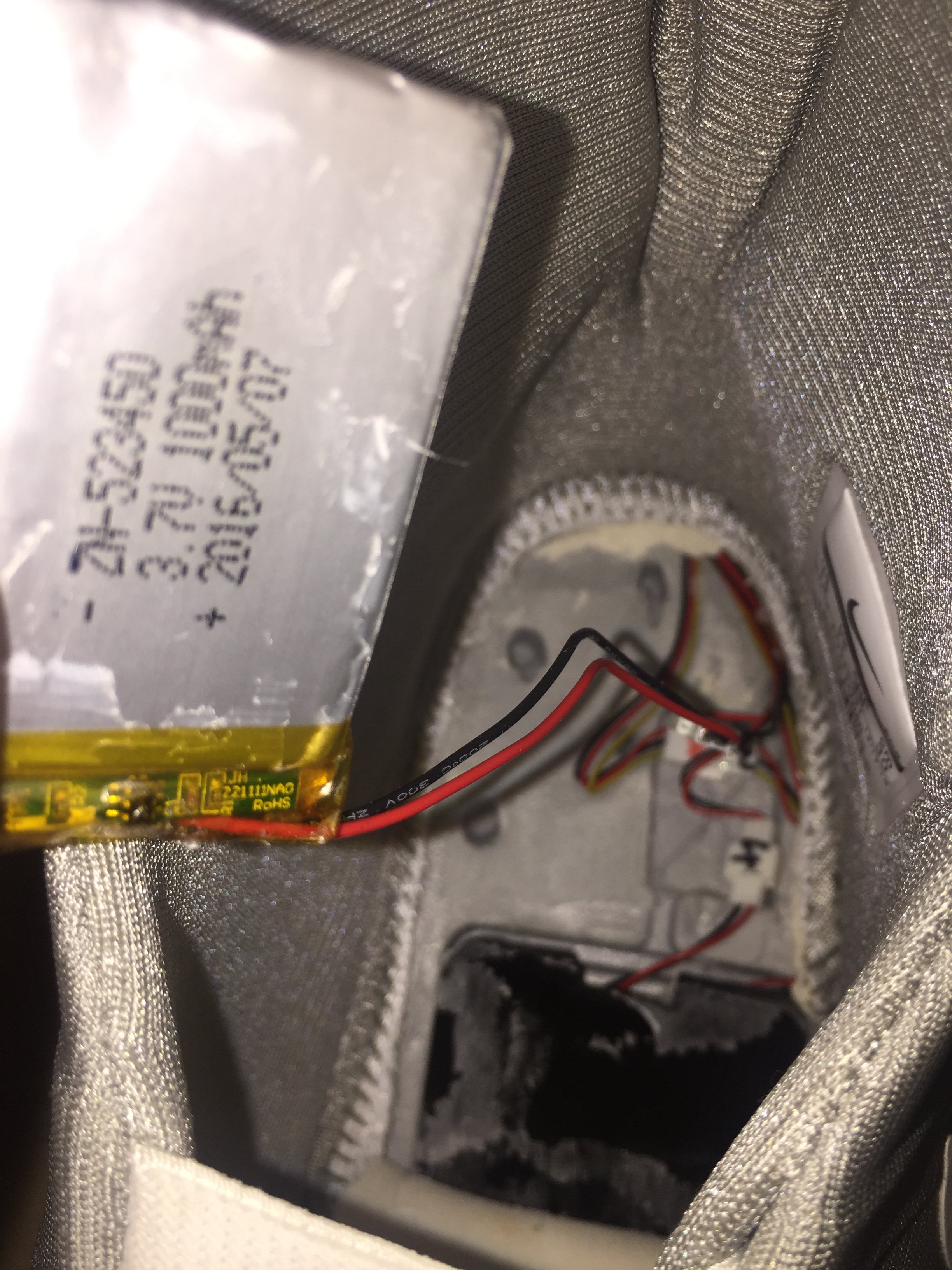

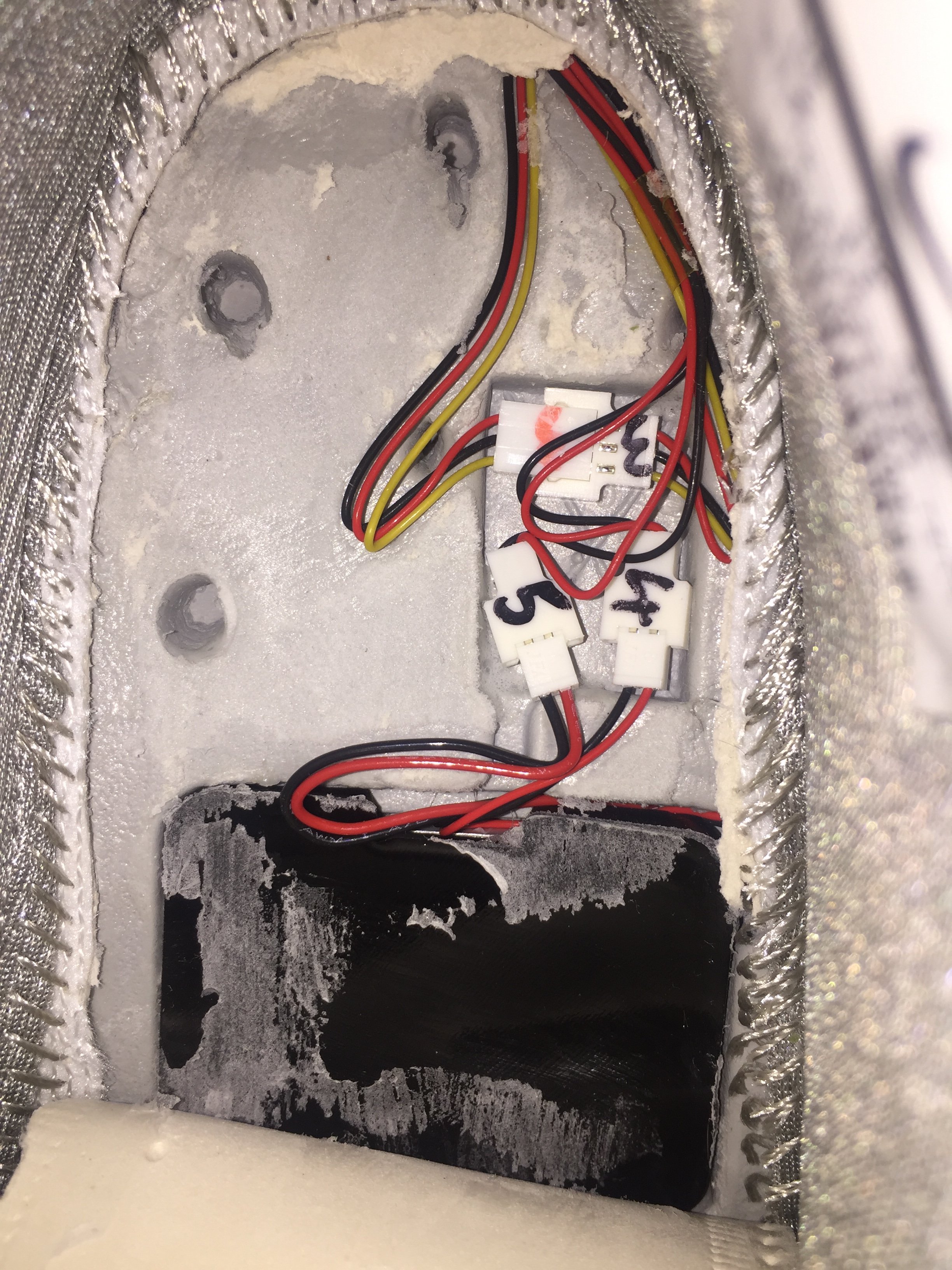

Jedifyfe was it you that documented removing the batteries from the V3s by cutting open the sole from the inside of the shoe?
@Jedifyfe was it you that documented removing the batteries from the V3s by cutting open the sole from the inside of the shoe?
@Jedyfife, did you also made a video of the method to open the midsoles to replace the EL panels ?
I will be making a video soon.
That will be awesome.
Didn't you post photos to? Something about having to cut the fabric in the sole?
Where the battery in the V2 was just slightly forward of the heel , these are more forward, like under the arch?
Yes. If you list up the unsole, you will see the white sewn on undersole. Cut around the edges with a very sharp Xacto knife. Be careful not to plunge the knife too deep as the wires are just under this part. You can then lift up this part to reveal the wires and black plastic cover to the battery, near the center of the shoe. Under that black plastic cover is the Li Ion battery.
