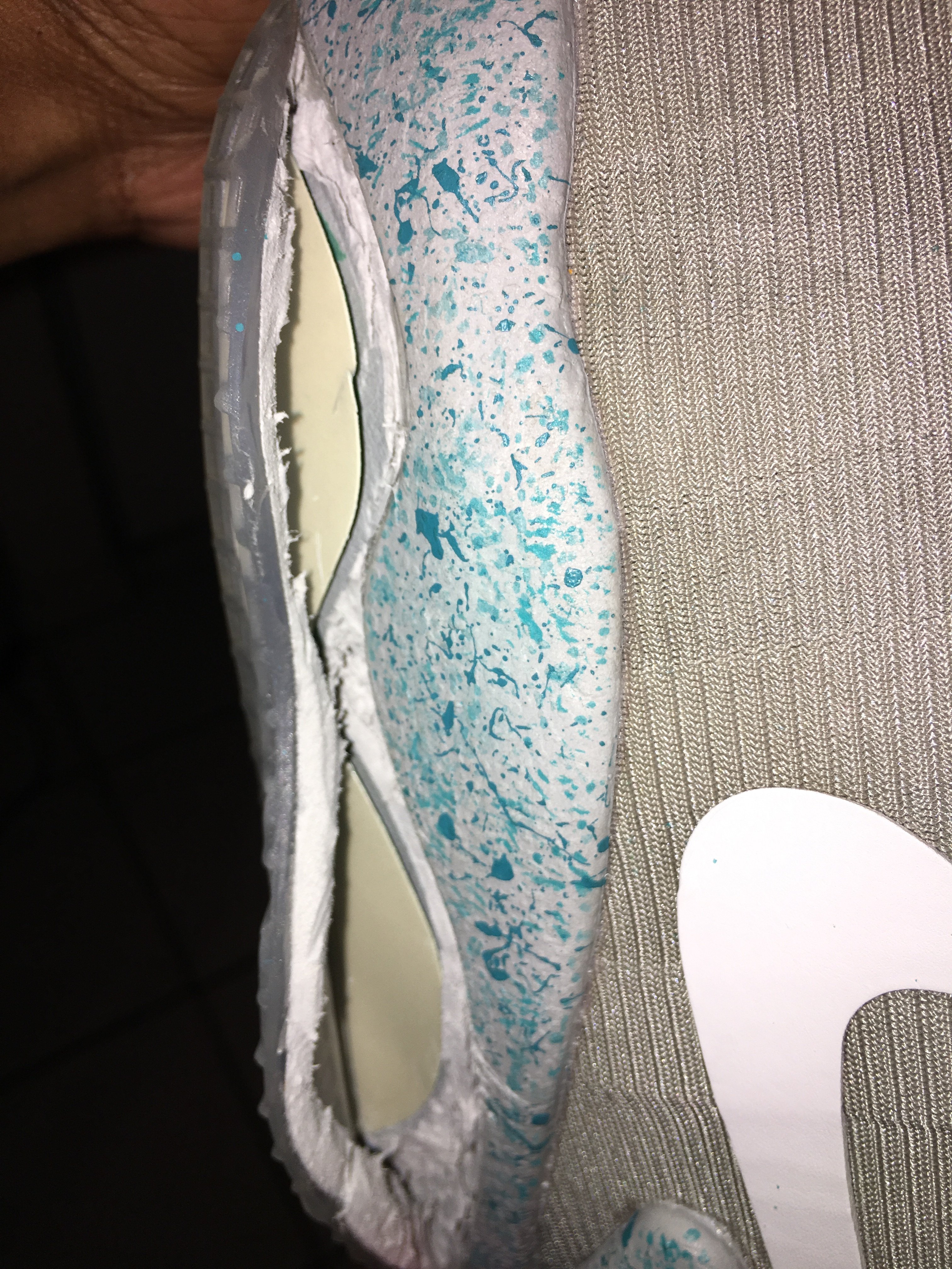

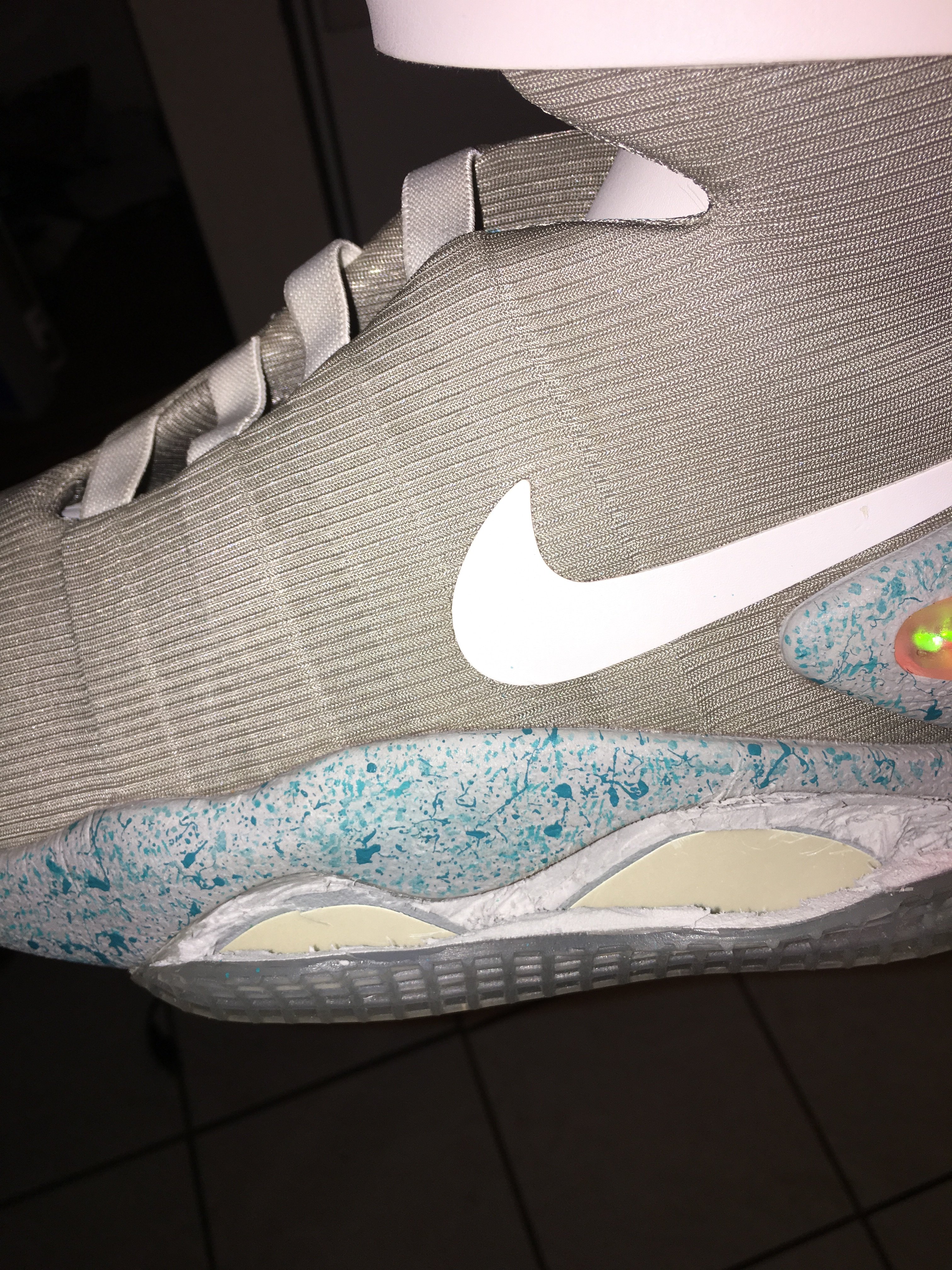

So the front half of the EL panel failed so I opened up the sole on these since I have a discounted replacement pair on the way. From my observation, the wire tape is on the back half of the panel, instead having it on the front half of the panel as well. The front panel isn't nearly as secure as the back half of the panel. So the stress from walking causes the panel to come out of pocket and that's why the panel ends up failing. All these need are some replacement panels and they should be good to go.
Before anyone else cuts open the sole...you should really try leaving it in the sun for a few hours. Or use a heat gun, you should be able to peel off the sole without cutting it.

Is it possible this would damage the electronics?
I used heat guns on V2s with perfectly working electronics and they still worked after removing the soles.
