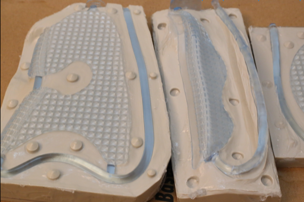

@Nzfly Here are the soles and partial molds, there are 3 clear parts which make up each shoe. Molding and casting is very rewarding and I really enjoy it, I love to see more people get into it and start making their own stuff! However, if you have no experience I would not recommend this to be your first molding project. Thin parts, the finish really matters, clear (will show bubbles)...and the originals are flexible. All of this has to be taken into consideration when molding these. The main issue probably being the bubbles, as @cavx said I have the equipment to make bubble free castings. Also as you said there is a learning curve, when I first started getting into molding and casting I wasted a ton of materials...which can be discouraging. If you stick to it and have the money to blow in the beginning you will eventually be able to make all kinds of stuff!
As far as selling these UV stable soles...How much interest is there in size US 10 and 10.5? I know the molds I have at the moment will fit 10 and 10.5 for sure...possibly 9.5. I can do completely water clear or as much blue tint as you want. (The ones In the photo look more blue in the photo then in person) As far as pricing goes they would probably be a little over the $100 mark for a set. Which is a bargin to what you would spend on molds and materials to make them yourself lol. I am still working on my own pairs, but soon if there is interest I can start getting size 10 and 10.5 and possibly 9.5 out there. Then later on could see about more sizes too.
