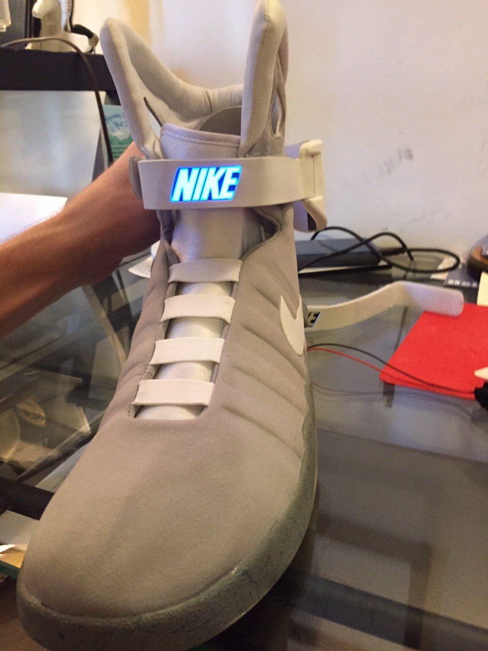

Well, before I went to anywhere else to get the NIKE logos printed, I decided to give Kinkos a shot. They struggled a bit to get things lined up, but we got one sheet that was good enough.
Got home, and threw them in. Really scary to mess with the Super 77 and didn't want to get the strap to get all messy. Didn't turn out "perfect," but I'm happy. Popped the MOD cherry and on to the next part.

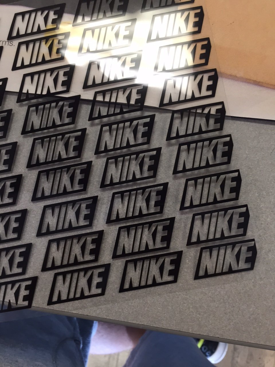

These look good. Did you print positive on the front or a reverse on the back? I used to print on the front, but it it then exposed and can be scratched off. Rear printing protects the print behind the plastic. The end result is still the same.
Thanks @cavx, they turned out pretty damn well, I'm just being critical. Overall I'm very happy.
I most definitely put the NIKE image into photoshop and reversed it. Then I printed it in reverse on the back. I foresaw the issue that if I did it positive on the front that it may get ruined and I can't be doing this multiple times.
I also, for an extra measure, put some clear packaging tape on the back to cover the ink to make sure nothing rubs away in the future.

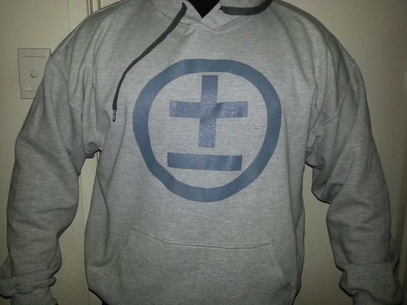

And slightly OT but still very BTTF, this is a prototype of the "nuetrality" logo Marty Jr has on his shirt. The same logo is also seen on a few other colour shirts including one of the two young boys playing the video game in the Cafe 80s.
attachment.php
This has been printed on a hoodie. The logo print is thick, almost puffy. It would need to be lightened for a white shirt, but would look very nice on a black shirt. I feel based on the quality of this, that I will have to get a few made up. Not sure of the price yet.
EmmaInCandyland sent me the graphic as a PDF, so thanks for that.
